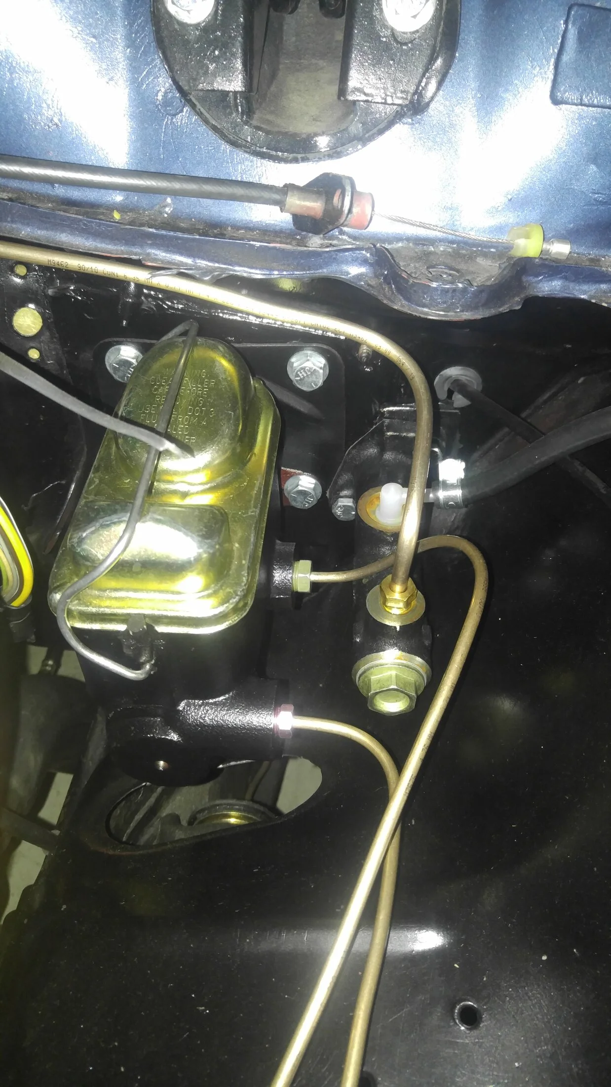

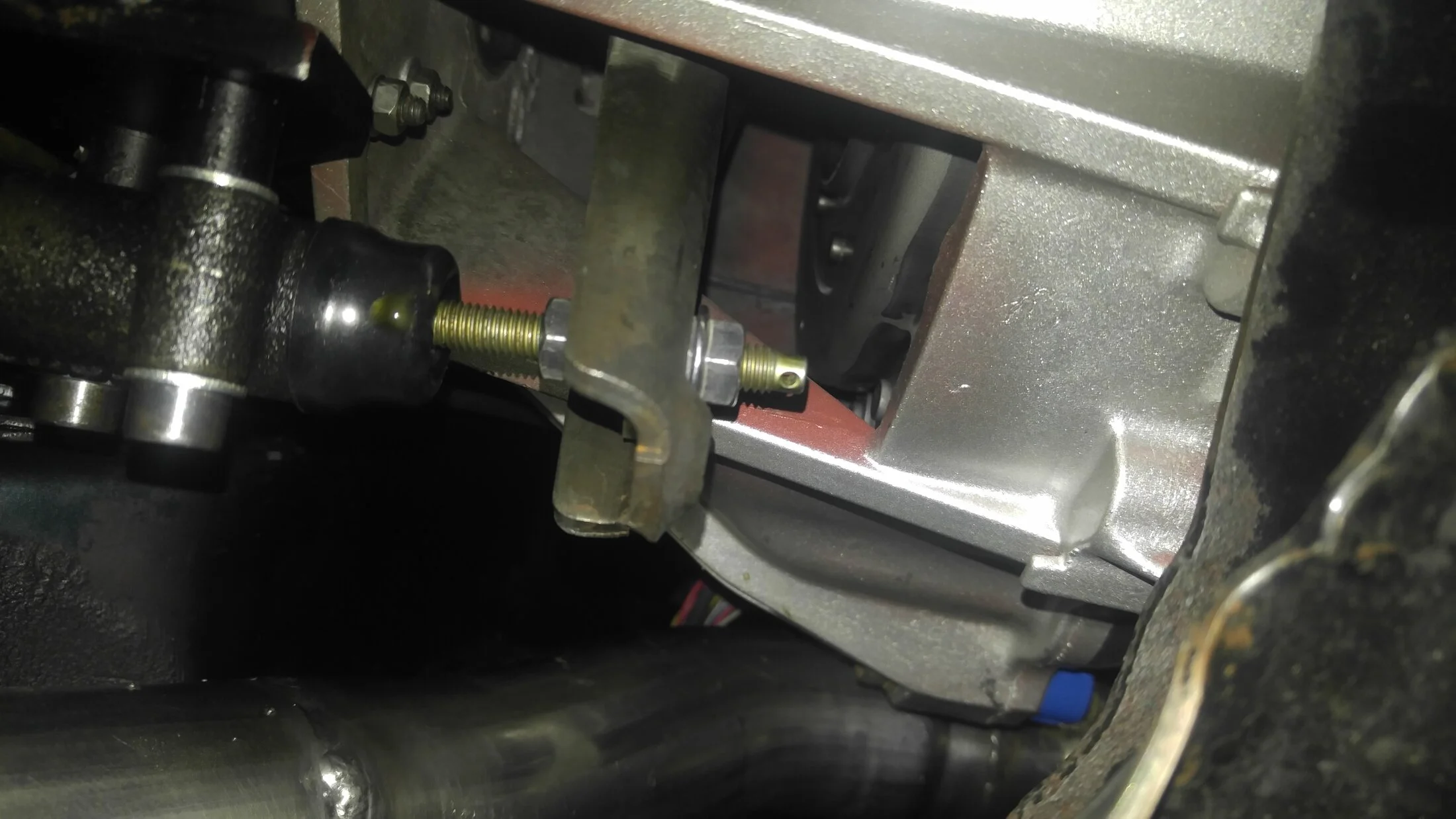

@Enzio has a T5 with a hydraulic clutch setup from - if I remember correctly - modern driveline. In his case, the master cylinder sits inside the car. I build my own setup with a Lada Niva hydraulic clutch system (its cheap) and my master cylinder sits in the engine bay. Both of us have the slave cylinder mounted at the bell housing still using the clutch fork.
A T5 is usually enough for handling the torque we have with a 302, especially because it is a light car. But I do not know what you plan with your engine...

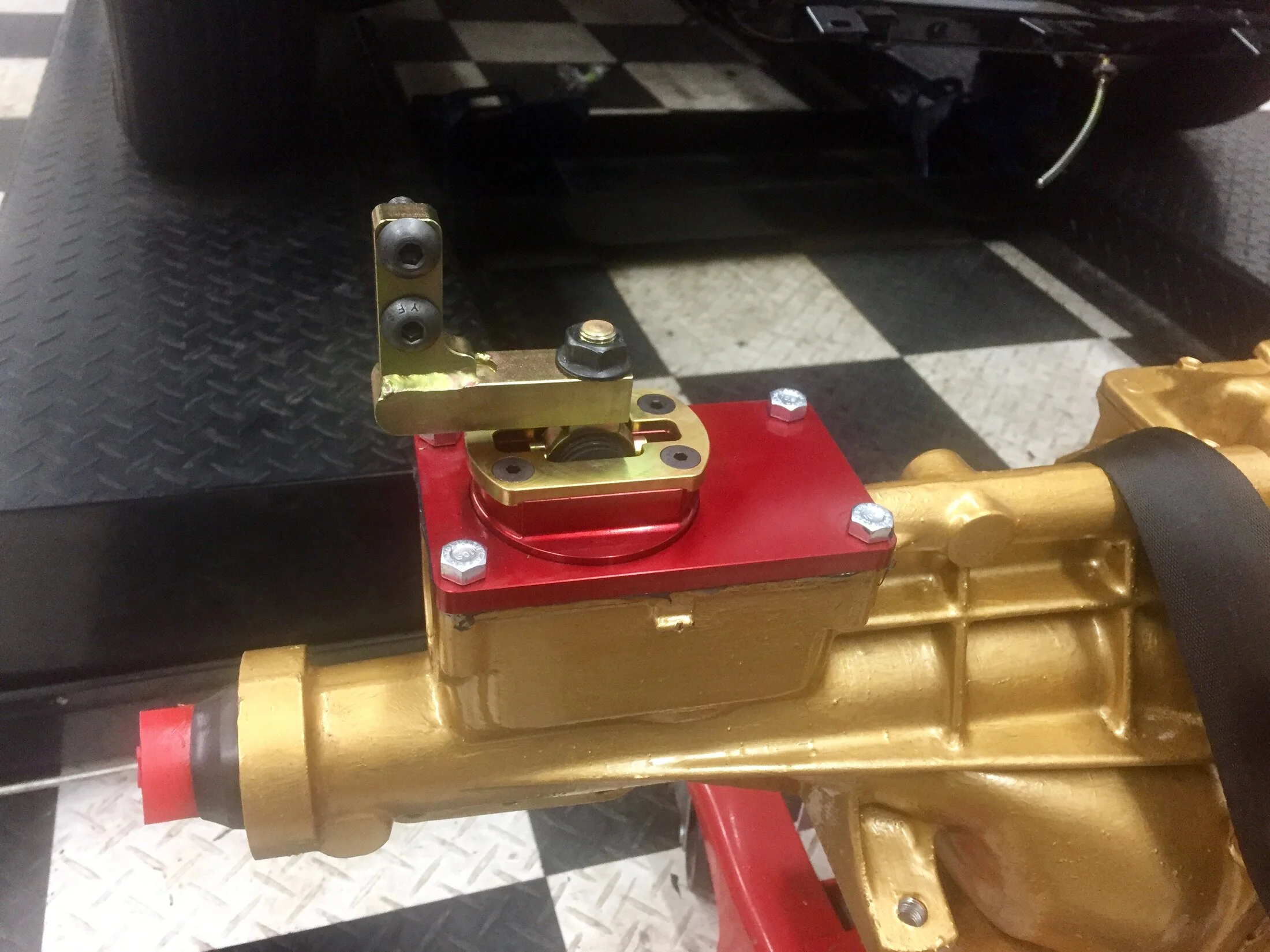

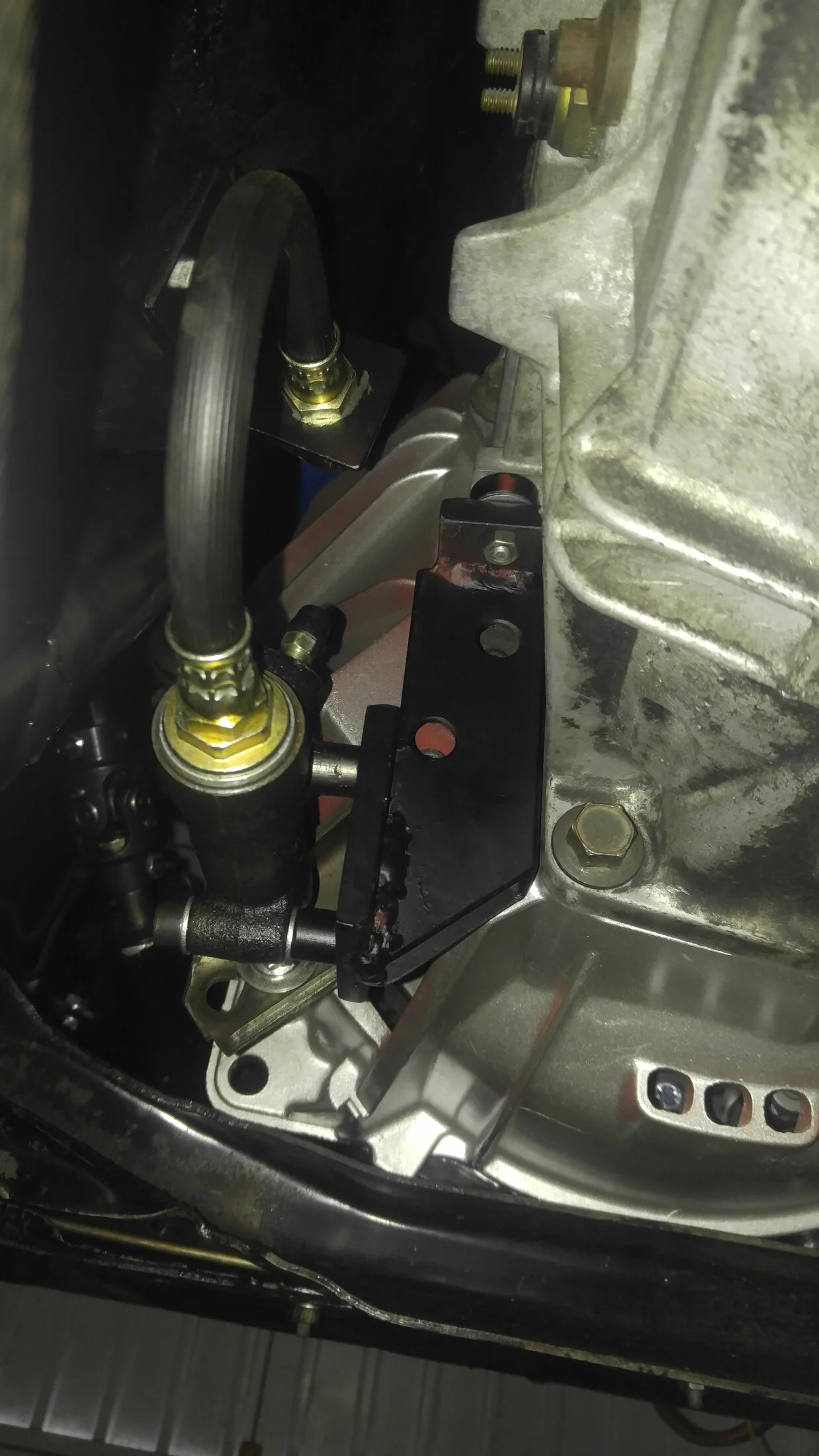

Hey! I do have slave cylinder at the bell but no fork. Mine is mounted on the transmission. I'd have to go check my book to see where I got the parts. If you're interested my install was not cheap. But, it's very nice and reliable. I went away from the fork due to the non stock clutch (spec). Let me know and I'll shovel out the garage to find out the parts and numbers.
I did not get them from MDL but they may have something for it now.

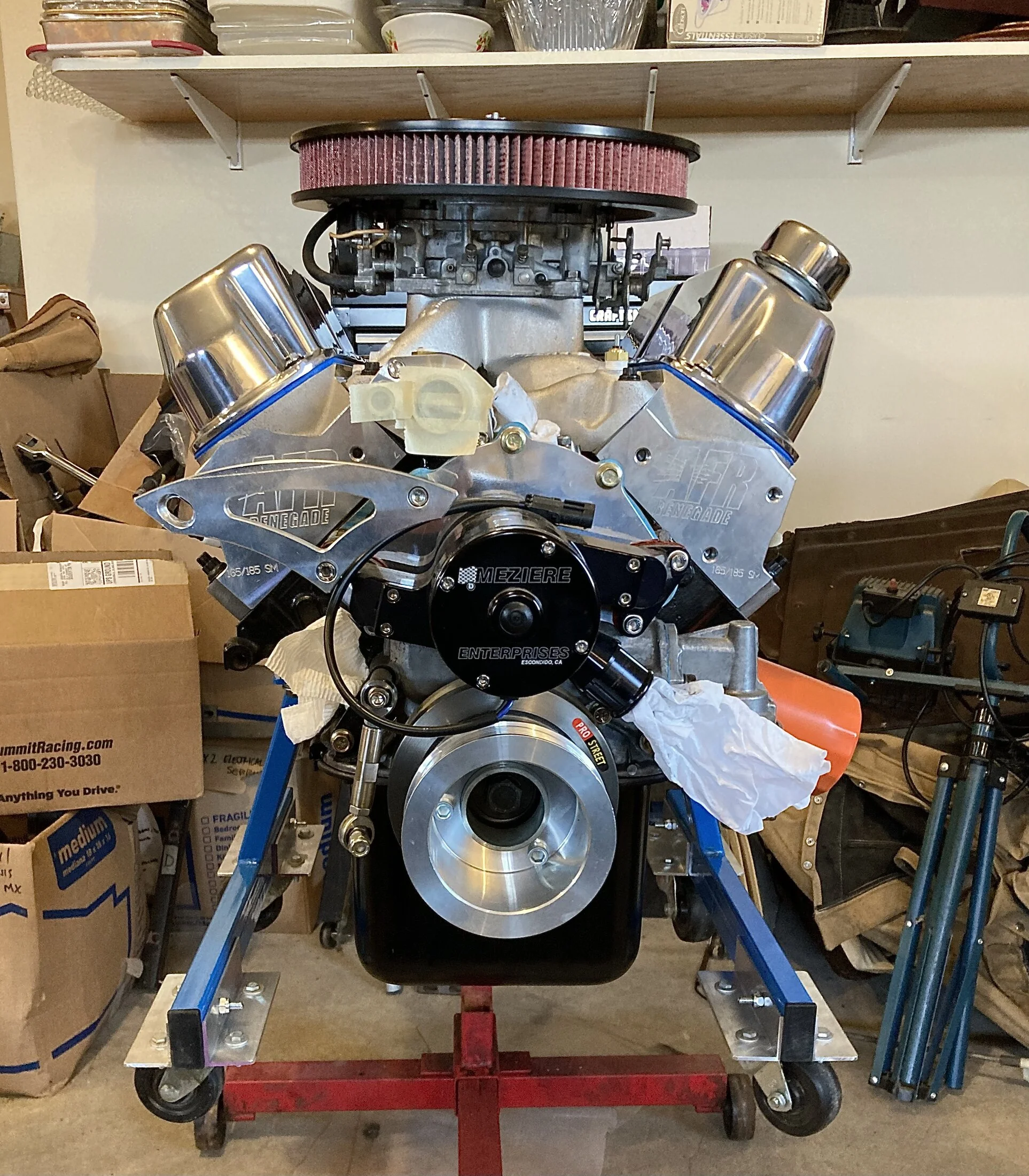

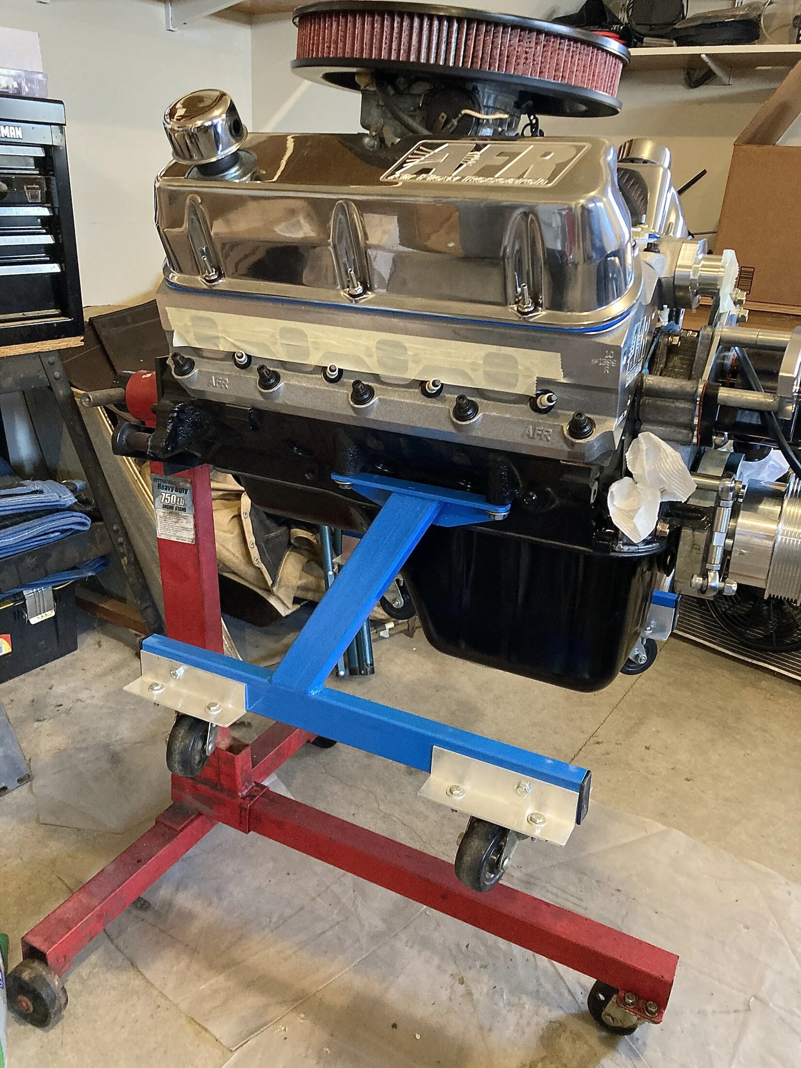

Thanks extra_stout. My engine is a 302 bored 30 over with AFR heads (compression @10.25:1), street cam for max torque between 1,500 and 5,500 rpm. Our guess is high 300s to 400 for both HP and torque. This is going in a Classic Roadsters Sebring MX kit which is a knock off of an old Austin Healey roadster (light car - about 2,400 lbs). Do aftermarket bell housings come drilled to mount slave cylinders? Would it be possible for you to post a few pictures of your pedal set/master cylinder set up? Here are a couple of shots of where we are on the engine. Thanks again!
I think you're underestimating your horsepower by about 50. Car Craft got 400hp out of a stock bore 302 with the stock cam using similar heads to those, given the bore and more aggressive cam, I'm fairly confident you're probably closer to 425-450hp, especially with no parasitic drag from the water pump.

In my opinion a T5 z-spec should handle that torque level with such a light car... it is a question of budget and installation space, i guess. But I'm not familiar with the dimensions of the Tremec TMX.
The question is what bellhousing do you use?
The lada niva clutch set has same diameter on master and slave cylinder. This came all together with the position of the master cylinder relative to the pivot point of the pedal... So this a complete DIY solution.
For slave cylinder there are two mounting styles (which can be done yourself, if you like. its just metal work):
extra_stout
5 Year Member
Aug 27, 2018
831
956
113
Germany
Feb 9, 2023
  • Feb 9, 2023

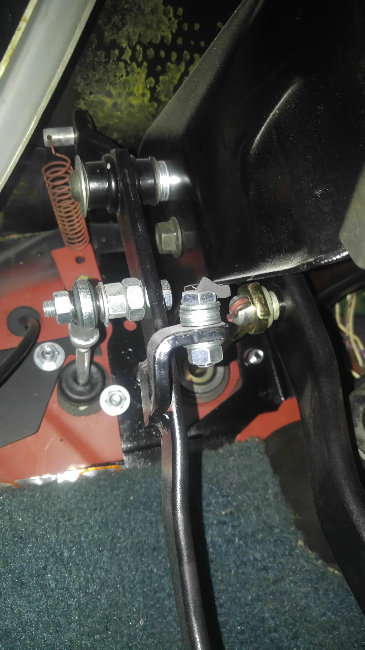

If I remember right the ratio between pivot-to-rubber to pivot-to-master-cylinder is 4.5:1
The clutch fork I used is 94-95 Mustang which is only slightly different to the pre 93 clutch fork... So the fork also has a ratio itself. But that worked out for me.

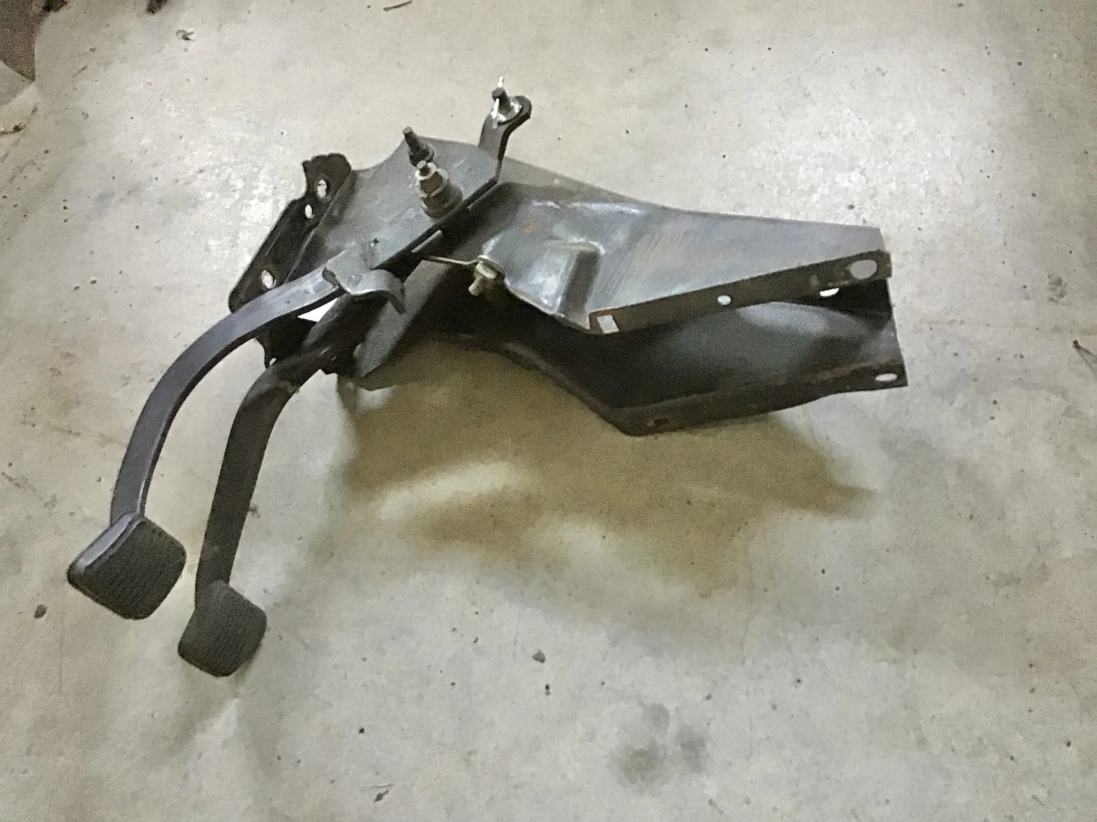

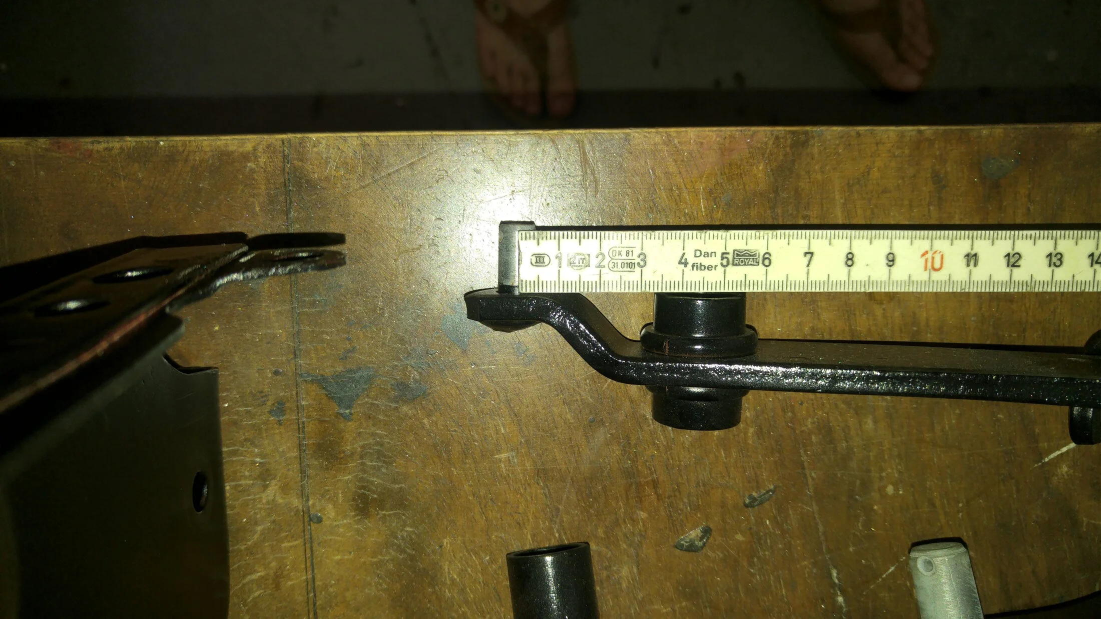

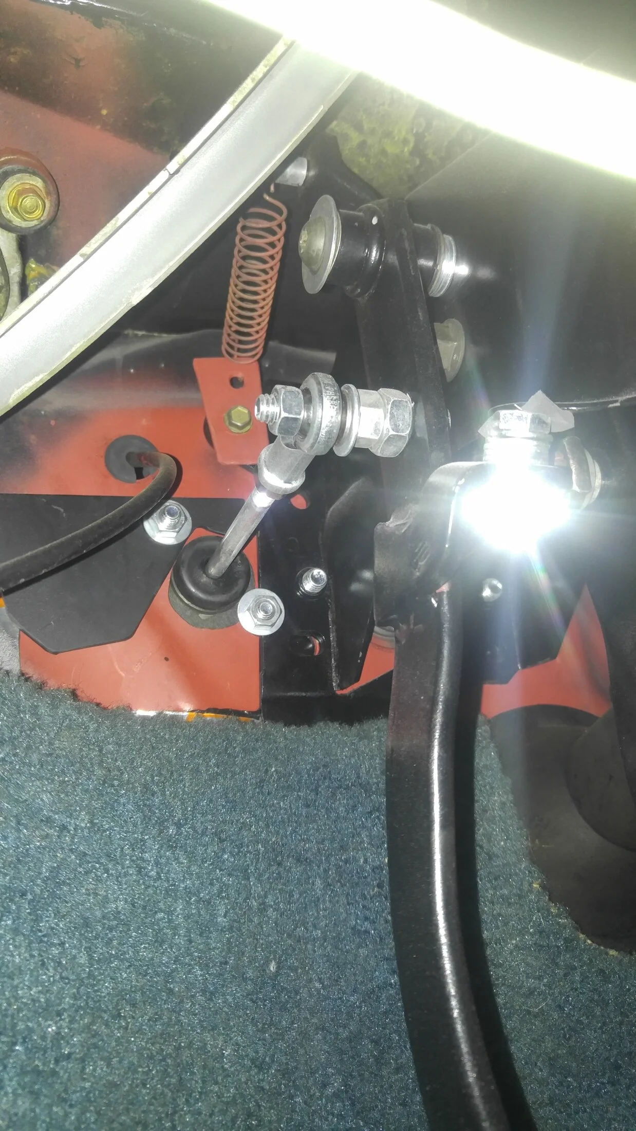

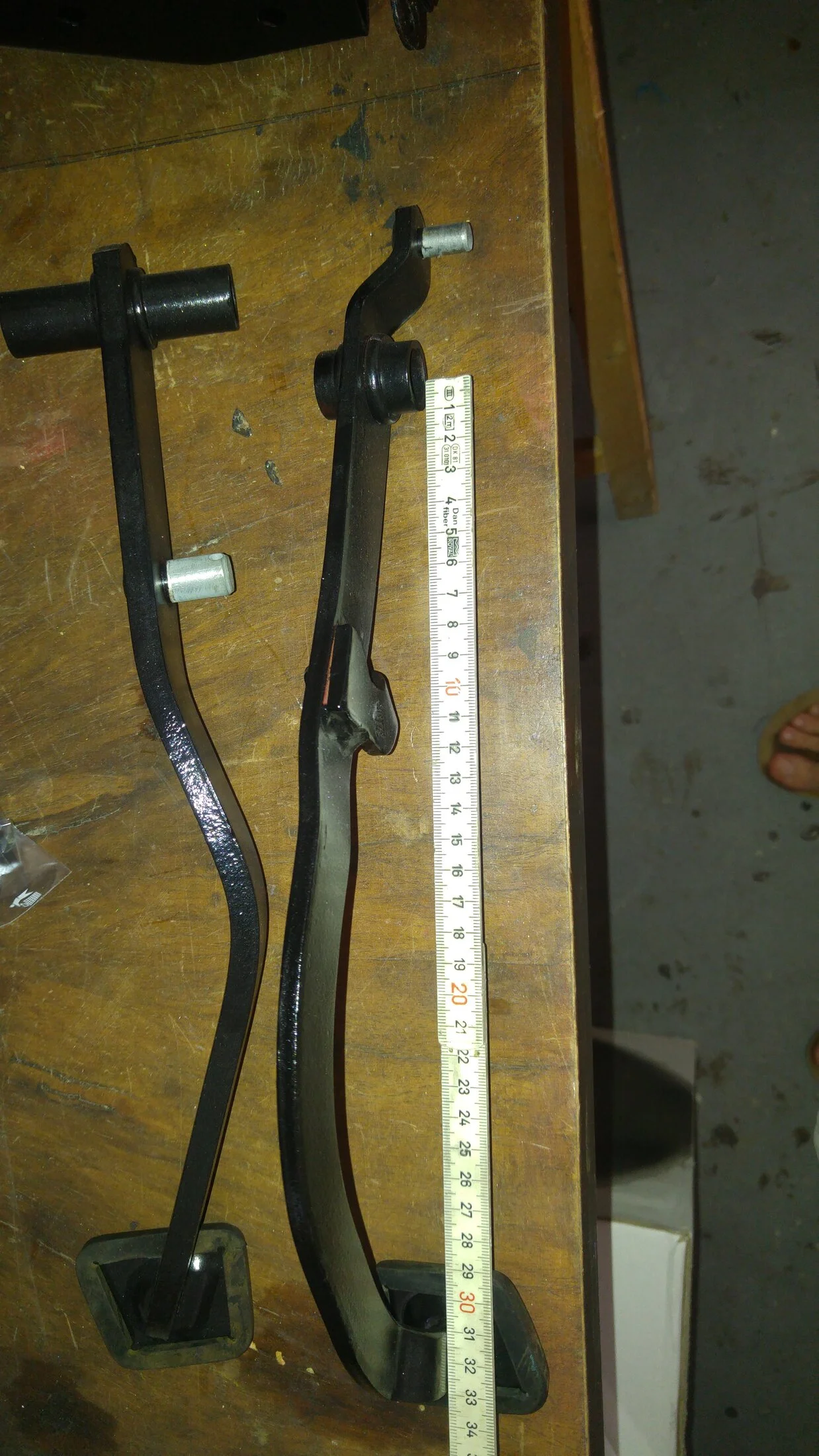

I have found old pictures. I think used the same distance from the pedal pivot point to the clutch cabel for the mounting point of the hydraulic master. Clutch cabel has obviously a ratio of 1:1. So this fits the lada clutch setup, where the diameter of master and slave is the same.
I think back than someone here measured their original Mustang II clutch fork and it was nearly the same as mine (they are all very similar regarding leverage ratio).
My thinking was, that this will than have similar feel and effort than original...

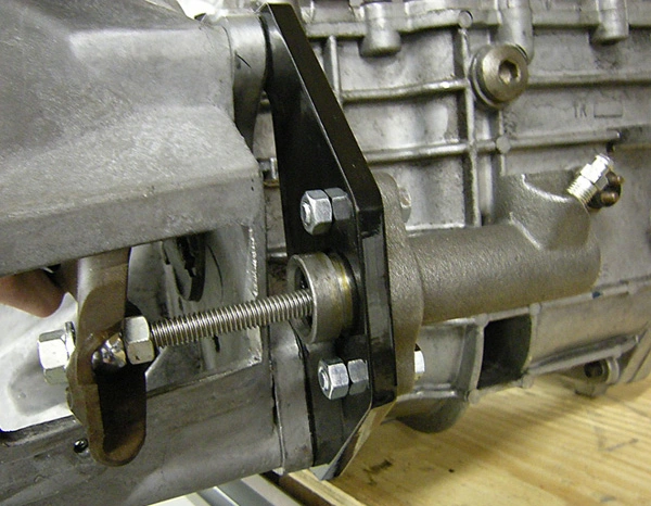

Here are more pictures:

Super helpful. Thanks so much! I may be back to you for more insight if we decide to go this route.

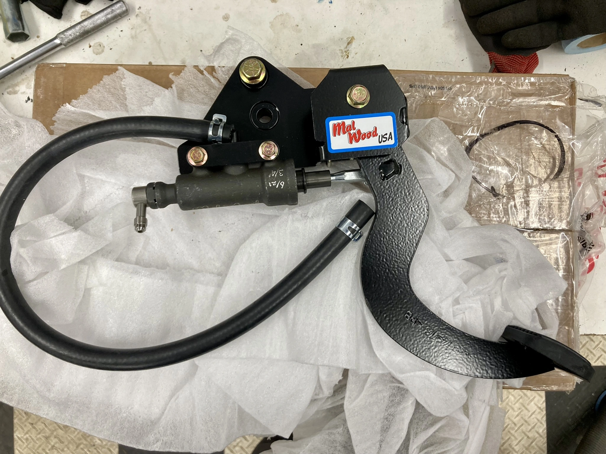

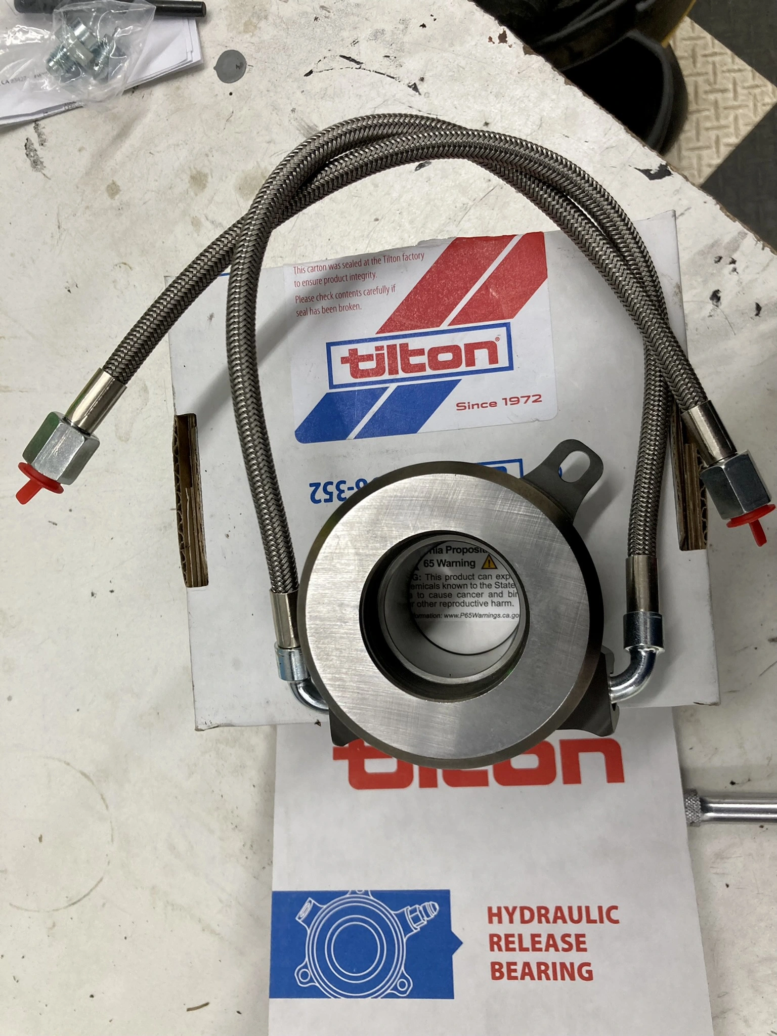

The kit I bought was from MalWood USA. The slave was a Tilton. I think all around it was about $300.00?

I
I installed a clutch pedal kit from Malwood, a Tilton hydraulic release bearing and a shifter from Modern Driveline for a T5 transmission mated to a QuickTime bellhousing.
