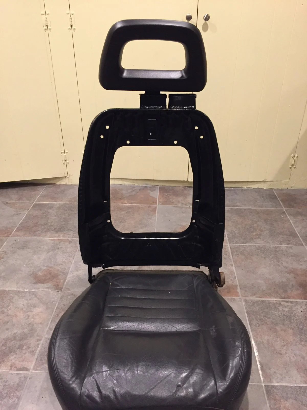

Have seen this asked a few times and always wished there were a few pics available. I had s seat apart so I figure I make a how-to.
First off, you seat with desired headrest to remove

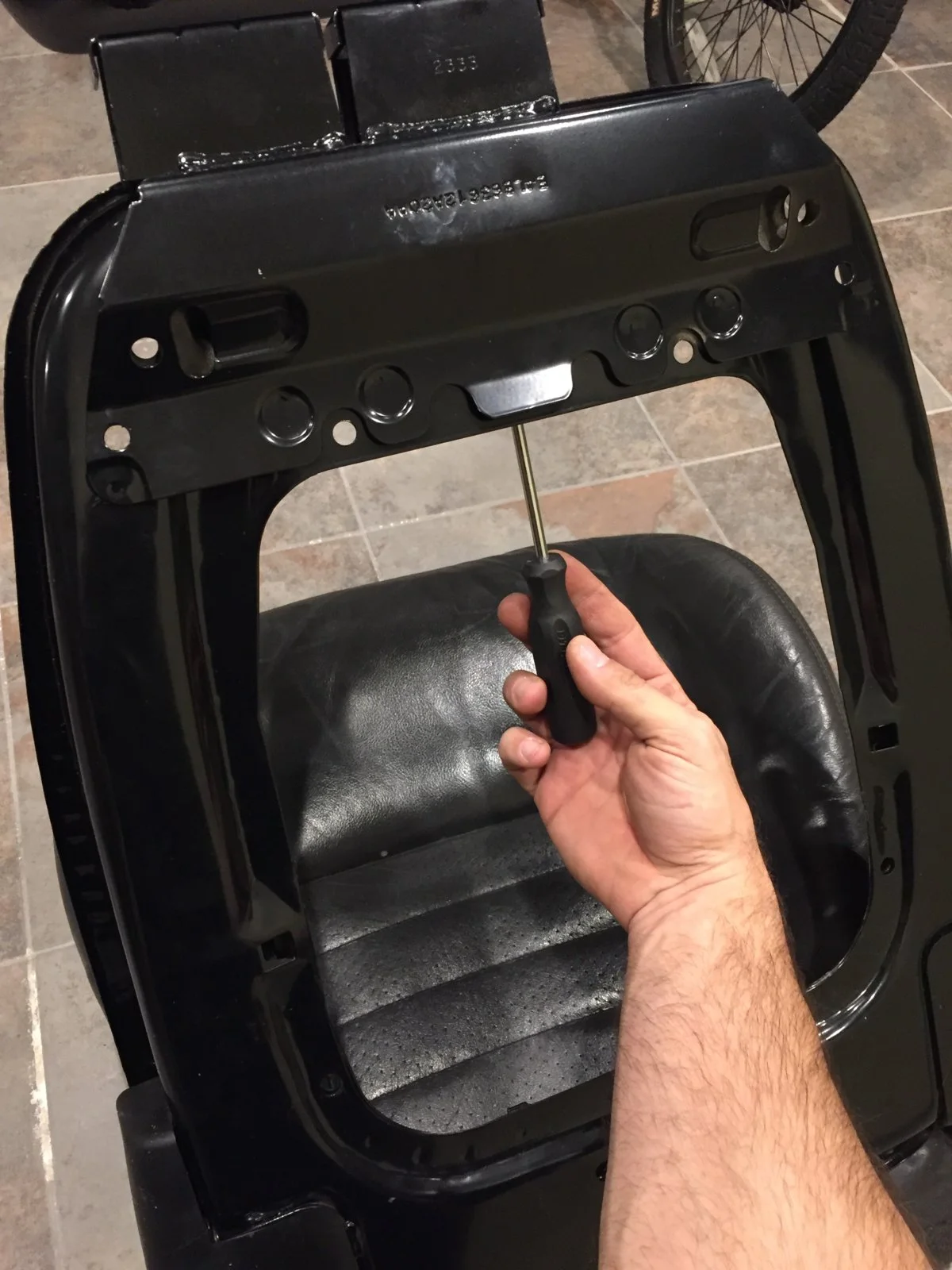

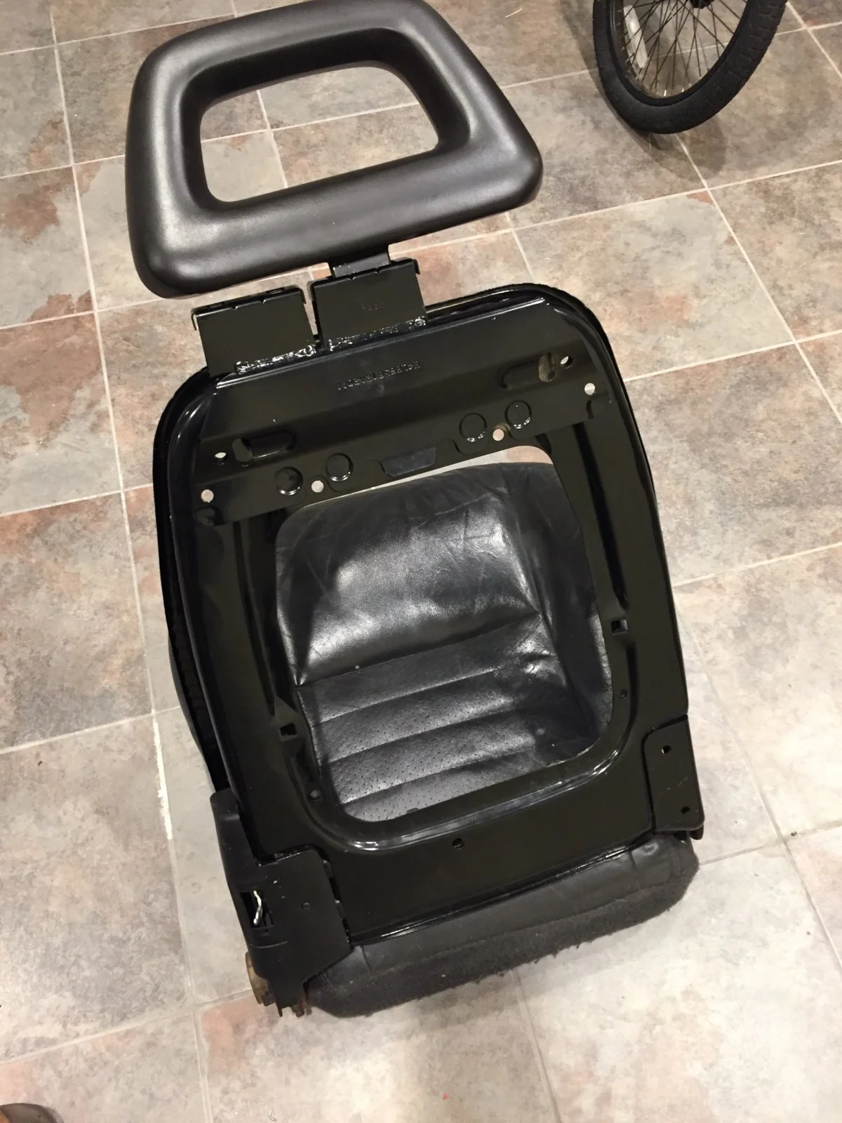

Here's your approach angke. From behind the seat you'll want to slide your hand and a flathead screwdriver up the back feeling for the upper part of the seat frame. You'll notice the center is wide open, that's good because you need to feel for the front of the top of the seat back.

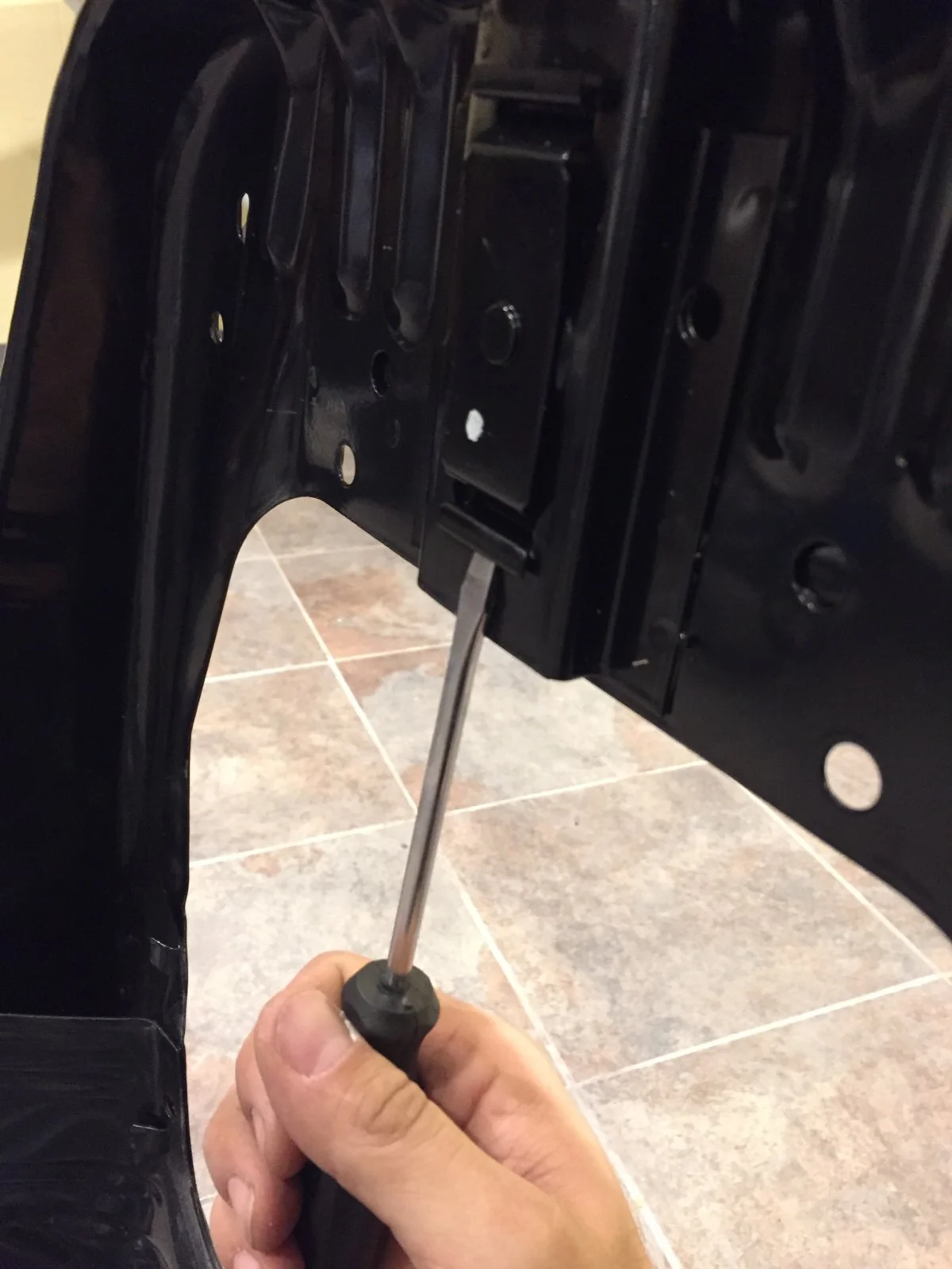

In the front, about 6-8". Down from the headrest is the headrest guide tube. On the front is a small clip. You want to slide the screwdriver under the clip and twist slightly to pry it up. Pull up, or have a helper pull on the headrest. Should come out easy once you've found the clip

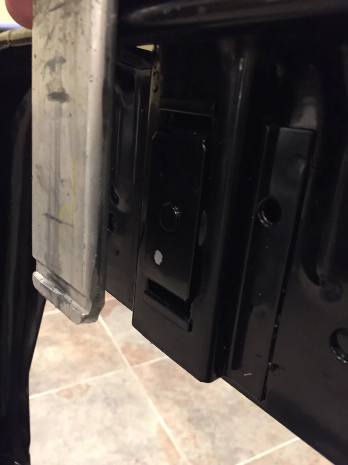

With the headrest out, you can see there is a tab on the headrest shaft that the clip fits into. This is what you are prying up on the clip to release
And that's it. 90+ headrest posts are narrower and use a plastic sleeve. If you want to install an older halo in a 90-04 seat you'll need to remove the sleeve.
