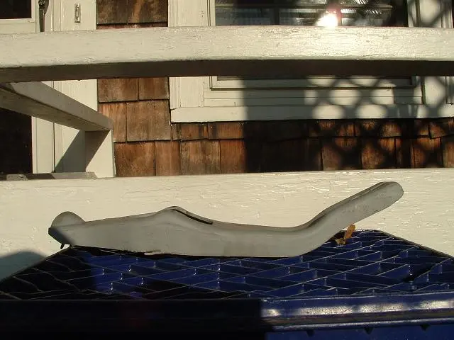

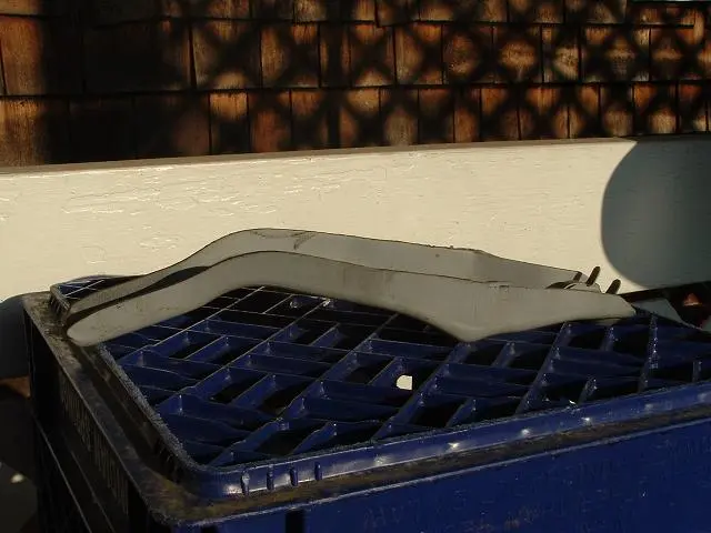

Does anyone have a picture of their clutch fork? I need a pic of the Mustang II one with the rad 4, not any other.
Also, does anyone by any miracle have one that's in good shape? I'm wondering if that's the cause of my clutch tension issues.

best I have, but probably not the rigth angle for you...

its not uncommon with yrs of abuse for the fork to bend forward over time..
i have heard that the clutch your using has a softer feel to it..
this is my clutch fork in good working shape.
