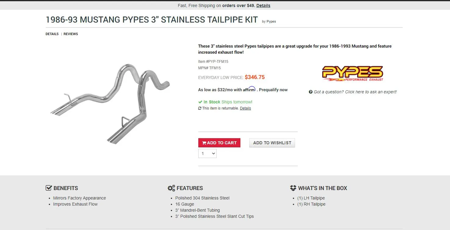

Hi All,
Is any one running a set of 1986-93 MUSTANG PYPES 3" STAINLESS TAILPIPE KIT? I really like the way these thing shine underneath but the issue is that my convert fox engine is all stock.
I was told that the 3" tailpipe kit is not meant for a stock 5.0.
My plan is to pair it up with Super 44 Mufflers -

They are really nice pipes but honestly waaay over kill for even a mild built car plus they are a good bit of weight. If the car is stock and staying stock I would just have a set of aftermarket mufflers of choice installed on it leaving the factory angle cut lx tailpipes and rock it

I run them, for tire clearance and for looks. I didn’t even consider performance but I do have a built motor. They look great but honestly it’s really tight with stock upper control arms.. I haven’t got them to not rattle and I’ve adjusted them numerous times. If I were to do it again I would just run 275’s and 2.5 inch tailpipes I think.

3 inch pipes make zero sense, all they do is cause clearance issues. I've seen guys make 750rwhp with 2.5 exhausts, so i'm not sure what the average guy would do with them.

The car has new front/rear upper and lower control arms w/ Eibach Pro lowing kit and springs. After viewing forums, I guess I will stick with the 2.5 inch cat back. Now I have to select the right exhaust kit for the 1991 convertible. The car does have an H pipe
will be going with the 2.5
