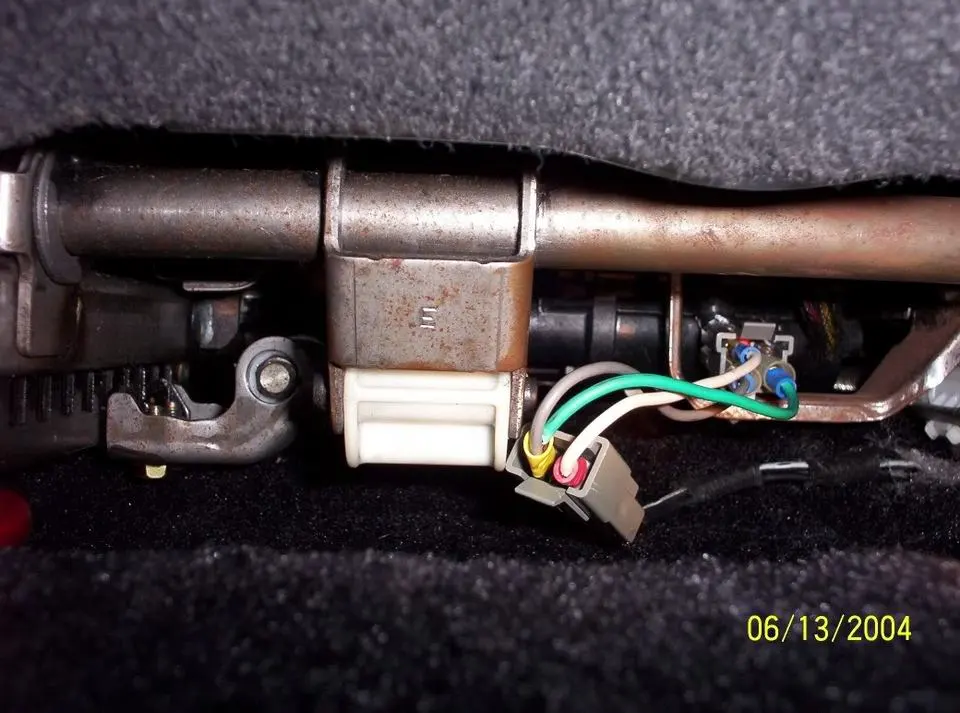

those will work (the whole seat) I own some my self, here is the wiring setup you'll need
The seats in the pic above are 2002 seats in my 87 LX. I put together the jumper wires to connect the power seat track/ lumbar to the existing lumbar plug in the Fox cars. The white wire is ground, the grey and green wires are power for the lumbar and seat motors.
I have a 1988 LX and there is a connector under the driver's seat but the car did not come with a power driver's seat. Did you find power at the connector for your car or did you have to dice and splice?
Actually, my car was a stripper car, no power options at all and did not have the plug, but I pulled the wiring from another car for the 87 GT seats I installed before and spliced it into the lighter circuit.
Probably. The donor car I pulled mine from was a 4 cyl LX and it was all wired into the main console harness. Just grab a test light, multimeter, or wire up one of the interior light bulbs and test it out.

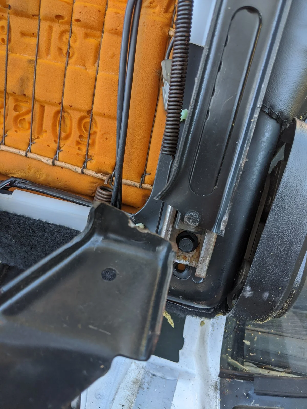

OK, so I had a wonky seat in my '91 LX, and got around to investigating it today. Turns out two things have failed: the outboard seat track is broken (picture attached), and the floor pan is cracked. PO left me with a new floor pan, which I'm not too worried about, because I'm putting in a pair of Steeda subframe connectors with the seat supports, so I think that the crack will be manageable; however, the seat is serviceable, but I'm going to need a new track.
Fox bodies are pretty rare in my neck of the woods at the "u-pick" junkyards, but there are plenty of the next generations.
Will the seat track from a 94-04 donor work with my OEM Fox body seat?
