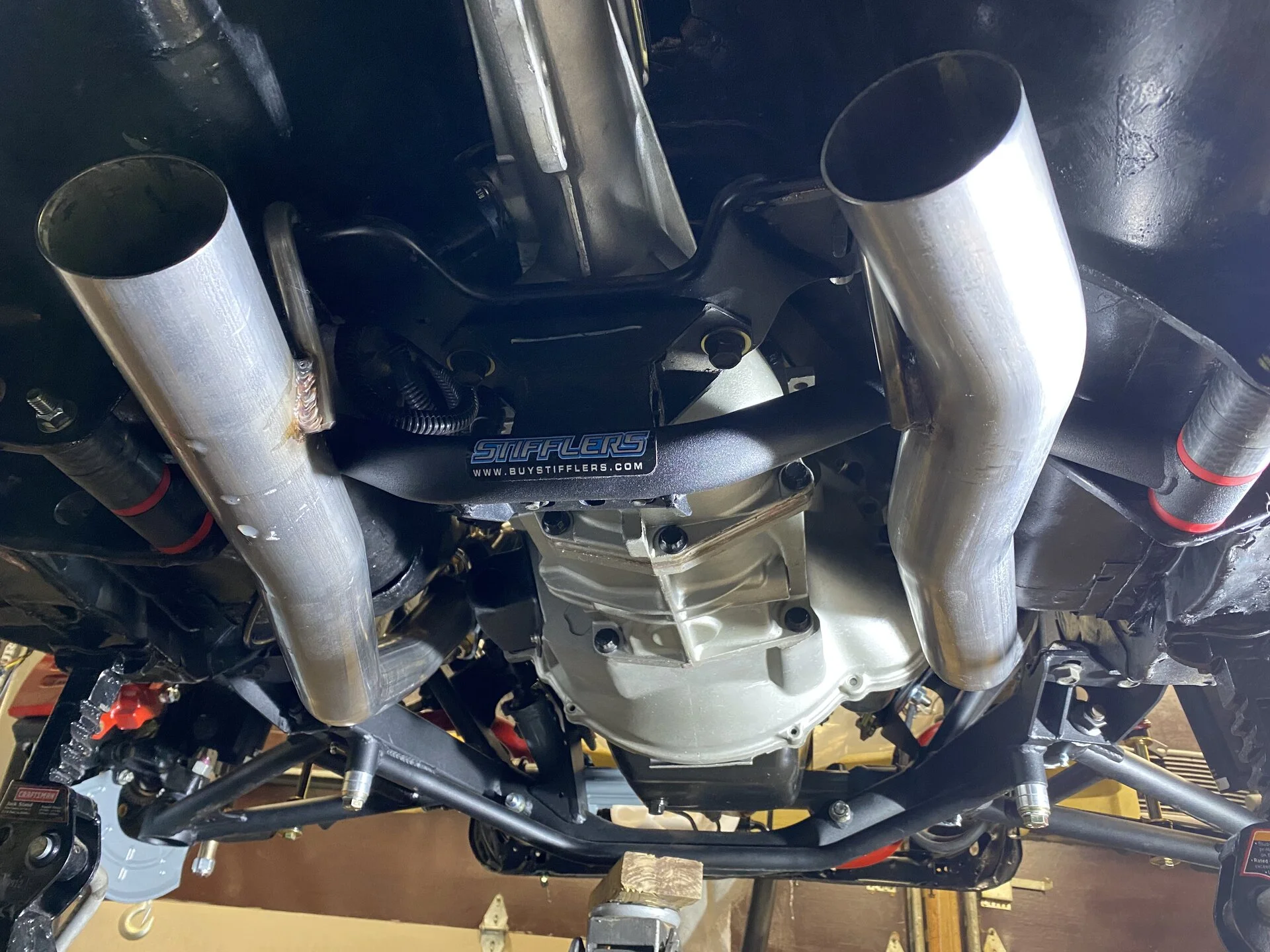

I've had my stifflers trans mount setup with 3 different spacer setups (tko600 requires an addition kit) and none had any vibration.
When I install my torque arm I'll take it more serious, but for now no changes have caused issues.

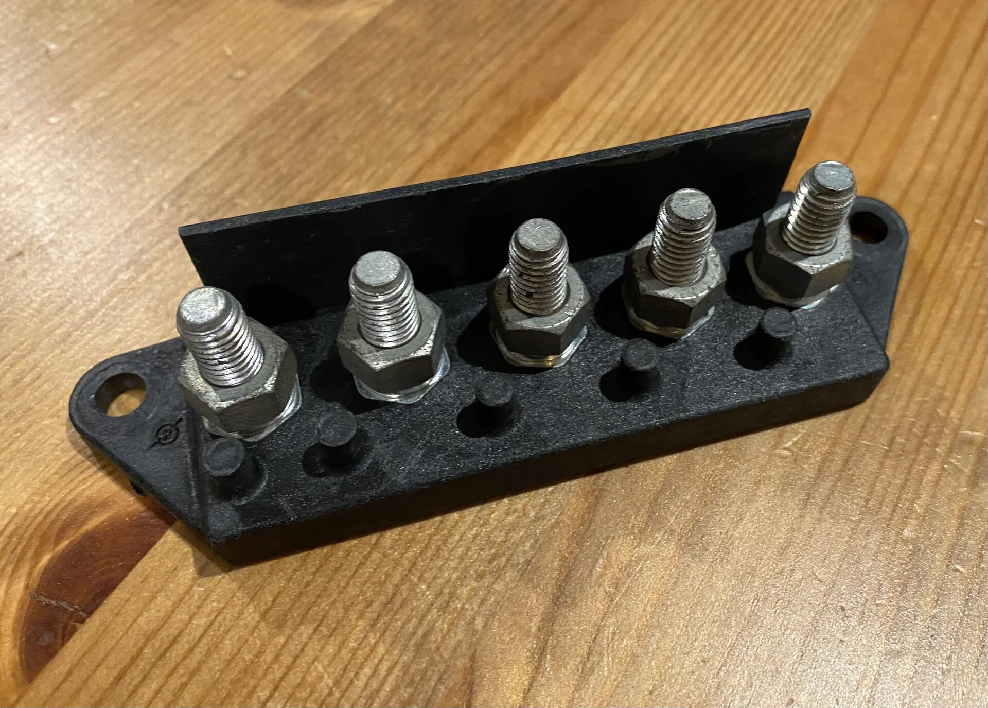

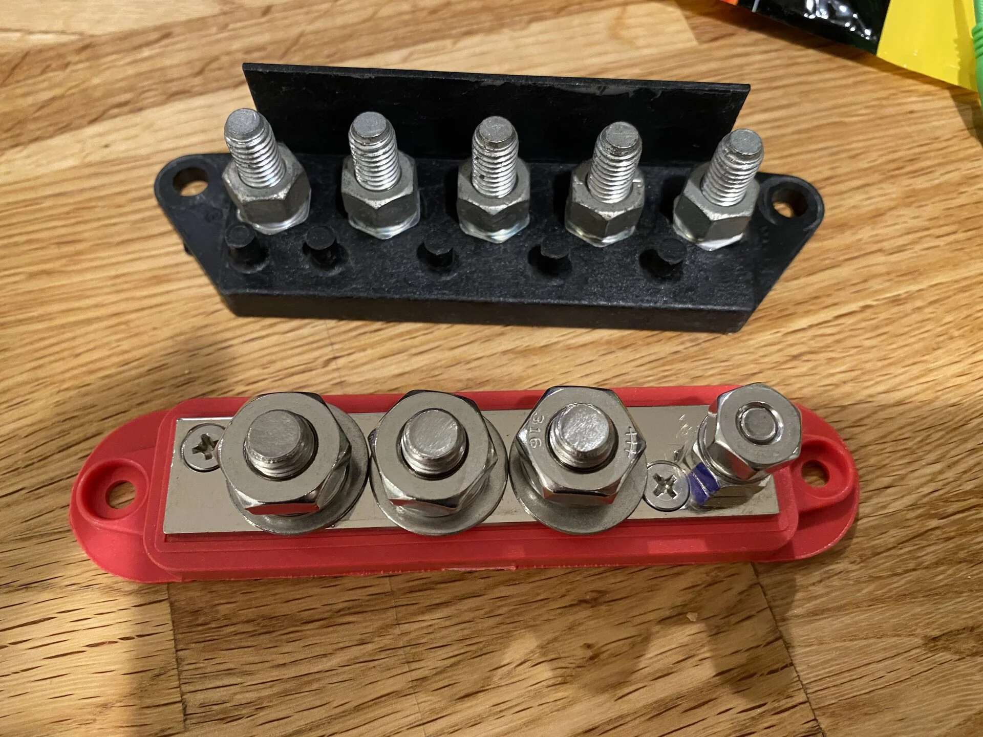

RekeHavoc said:
I picked up a set of these not long ago. They are very solid. Just throwing out another option.
https://warrperformance.com/?product=gm-distribution-b-set-of-5
I ended up buying one. $8 shipped, for an OEM junction block seemed like a good idea. haven’t decided which I’ll use yet.
Compared to the Jegs one, this one seems more robust. The plastic feels more solid. It feels like an OE part should. The plastic on the jegs one feels cheap. I might run the GM block, as it allows more connections independent of each other.

The gm one won't rust and fail. The jegs one looks OK. Can't tell if it's chrome or stainless.

Stainless with stainless hardware. Recipe for potential galling

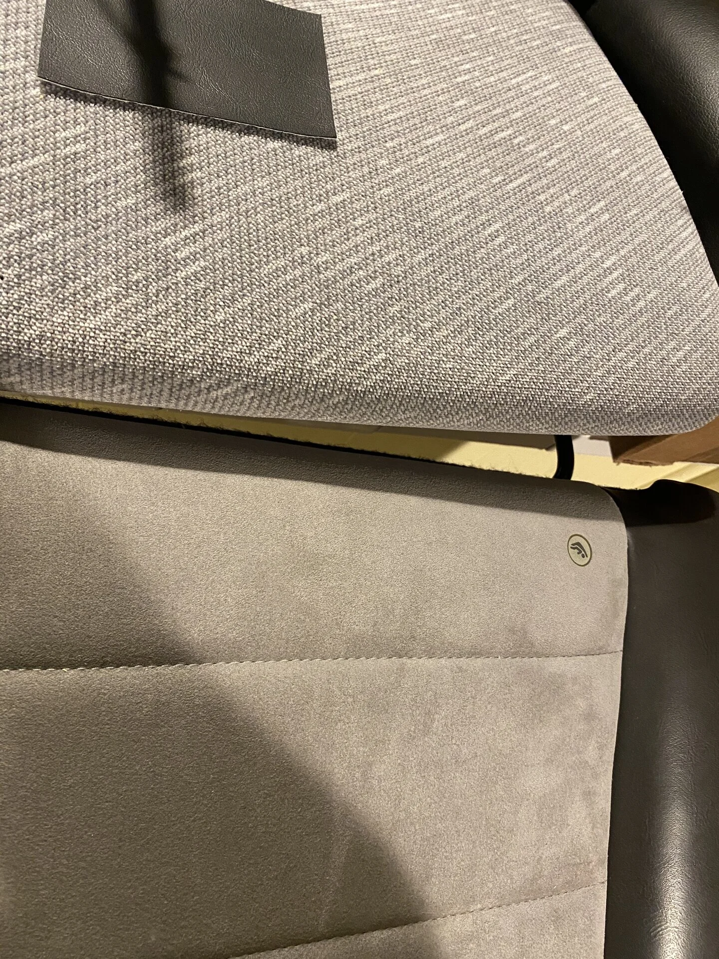

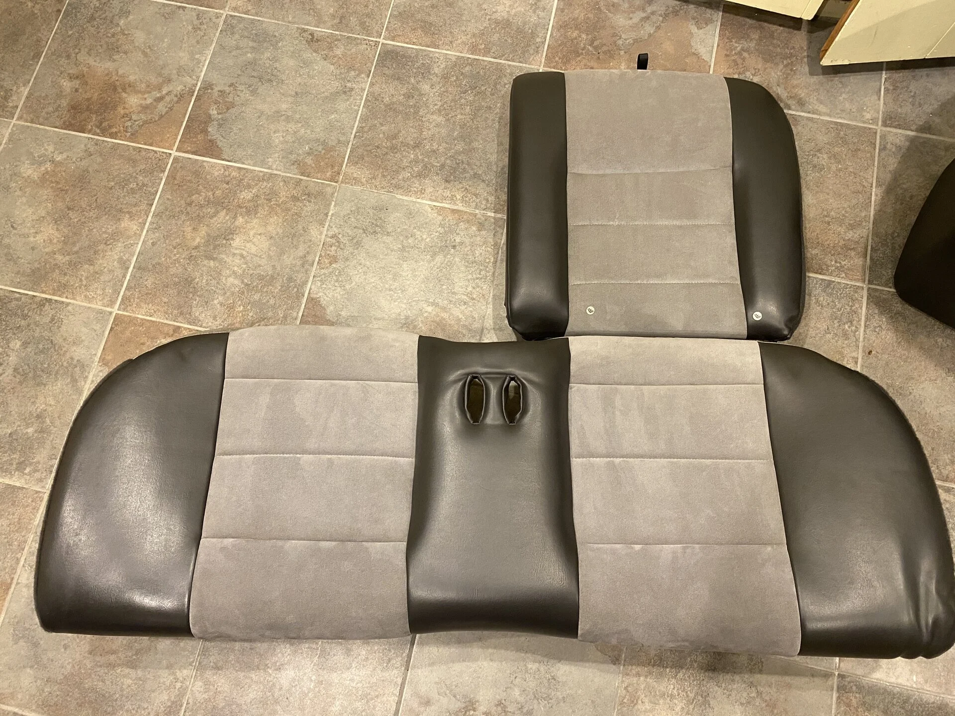

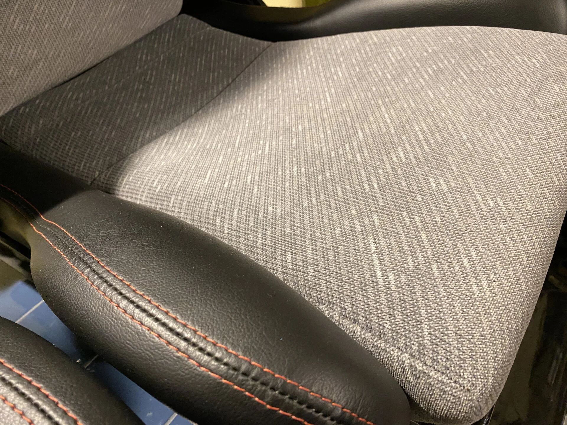

Impulse buy. Had the bottom cushion, and saw the one seat back come up for sale cheap. Into this for under $100 so far.
what will I do with it? Dunno yet

And no, it doesn’t really match the recaros. I have yet to find a suitable material short of seeking out 4 centers from existing Recaros and using that as donor material, which I might do.

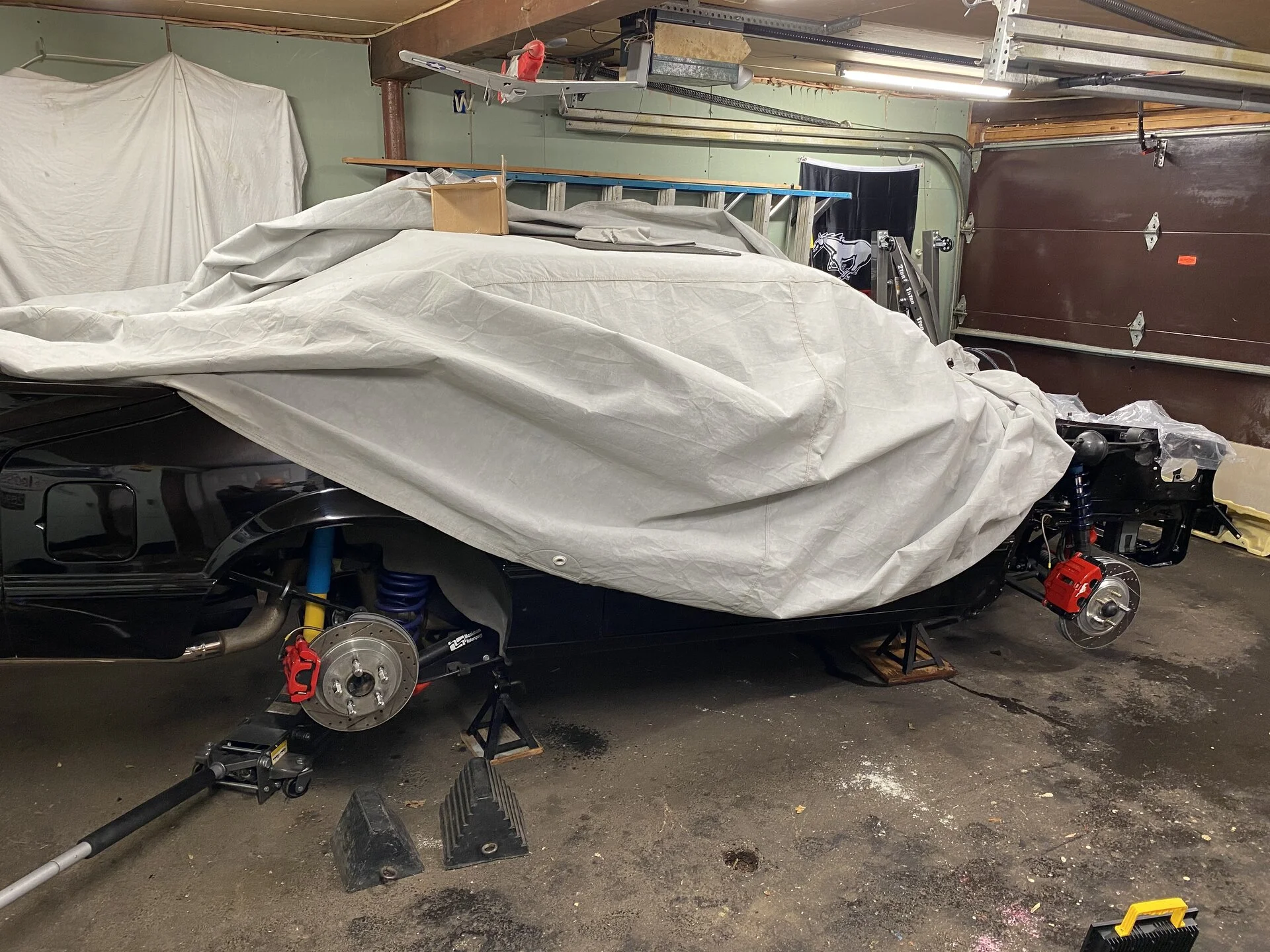

Did some work today. Ran into issues.
finished running the brake line to the rear of the car. Wasn’t bad, but just awkward getting to the line over the axle. But got it done, and started bleeding the brakes.
Did I mention I hate bleeding brakes. Too much work.
I had some leaks. Guess I went too easy tightening the lines. One leak at the rear, one line on the PV leaking and one front line leak. Got it all set and appears to be leak free.
however, I have what appears to be a dead zone in the pedal. Baer supplies a spacer to go between pushrod and MC and seems like mine isn’t large enough. I’ll need to take to Baer on Monday.

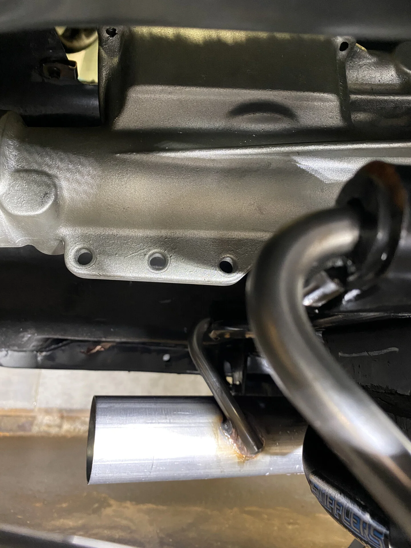

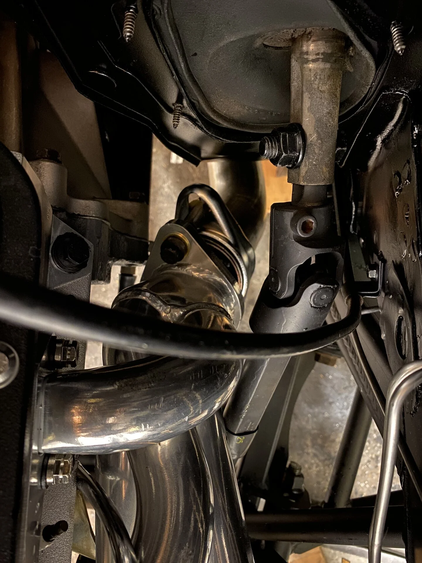

Reinstalled the driveshaft. No problems there.
decided to try and reinstall the exhaust. Started with my Bassani catted x-pipe. Did a test fit of the flow tubes and found I’m just a little short. Doesn’t fully reach the collectors.
The issue is the exhaust hangers. They bottom out on the rubber hanger preventing the tubes from moving forward ebough.
I think what I am going to do is pull the exhaust hanger out, and slot the mounting holes. Then I can scoot the hanger foreard about 3/4” or so and that should give me the clearance.
once exhaust is done, my work under the car is all set. Everything else is engine bay.
