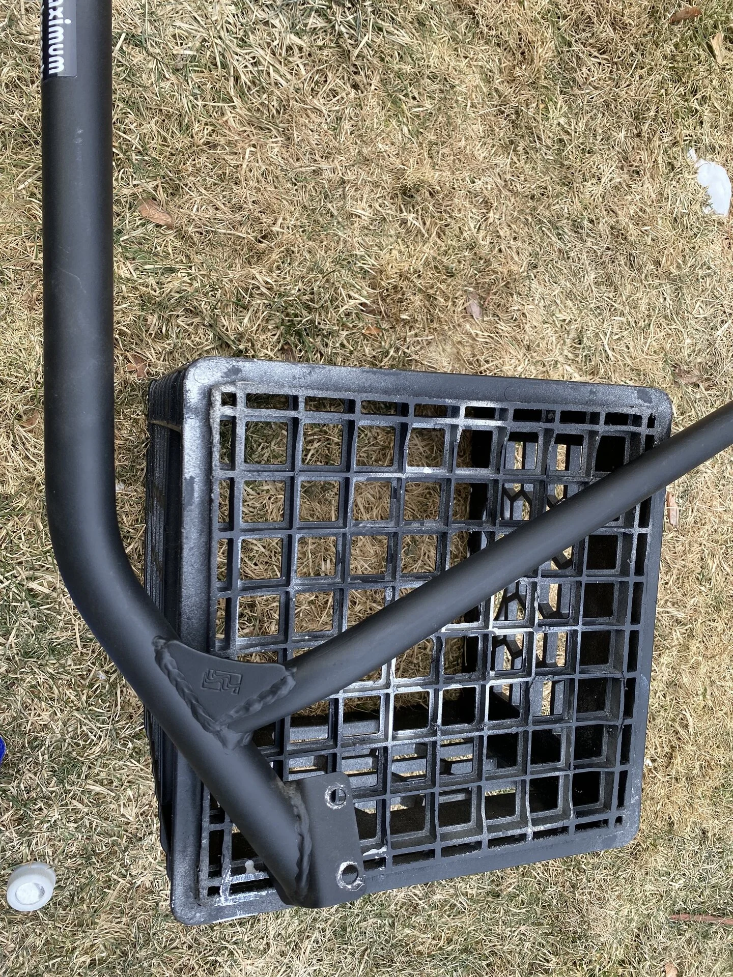

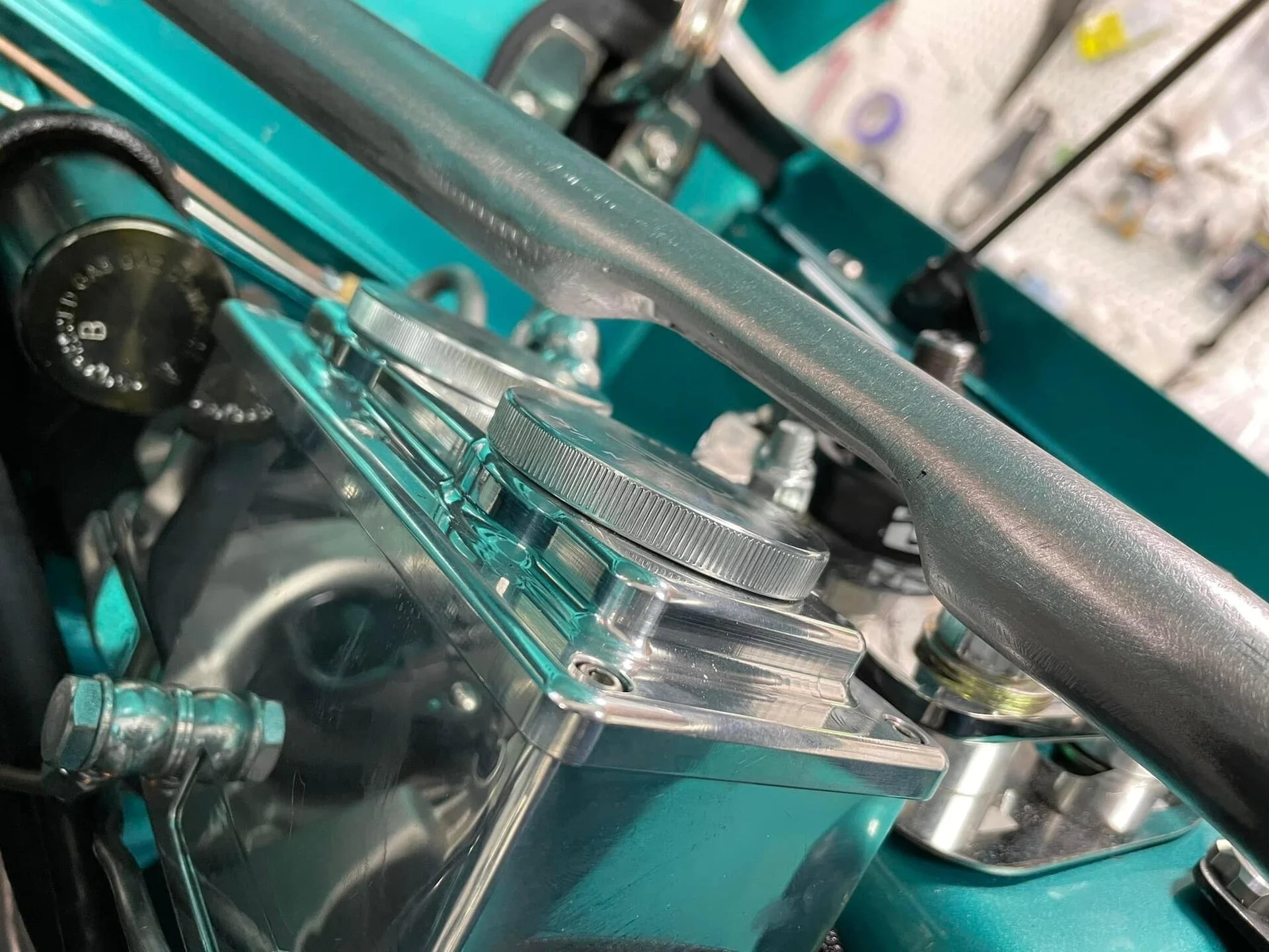

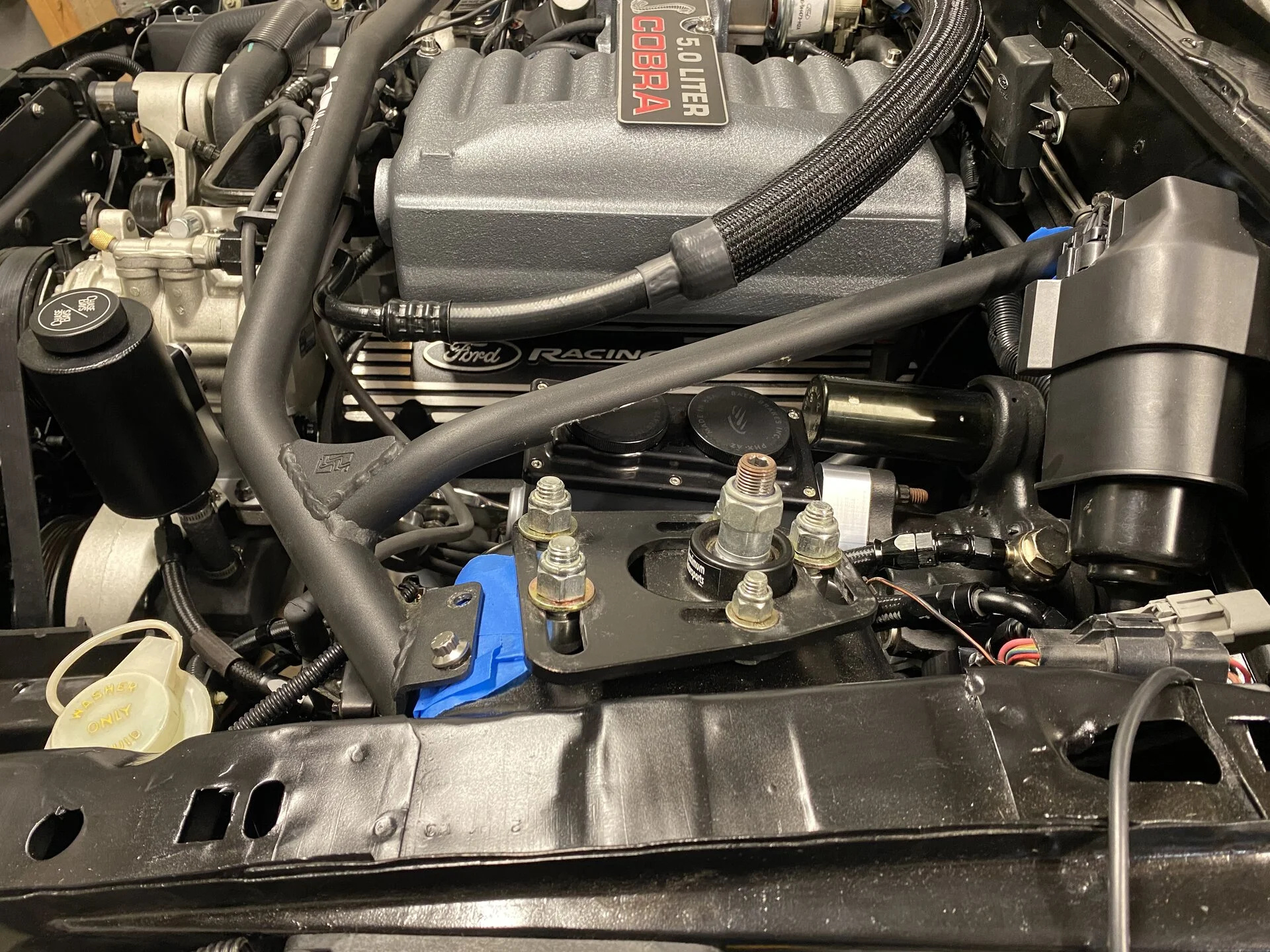

I think you're gonna hate yourself for not moving that bar between the intake and master cylinder for the sake of access to those caps.
Form over function always puzzled me

But grinding out the clearance slot does give me access. If I remove that front cap I can bolt the bar in place.
I can remove the rear cap fine, and there is room to check/add fluid.
It’s the front cap that I need space to remove. This is a situation where I’d rather not overcomplicate the solution. (Not that I haven’t done that before)

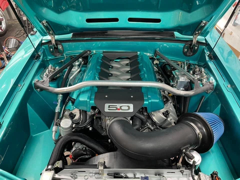

What another gent did for clearance.

Go for it, I think that will work fine, I just wanted to give you a hard time and make more work for ya.

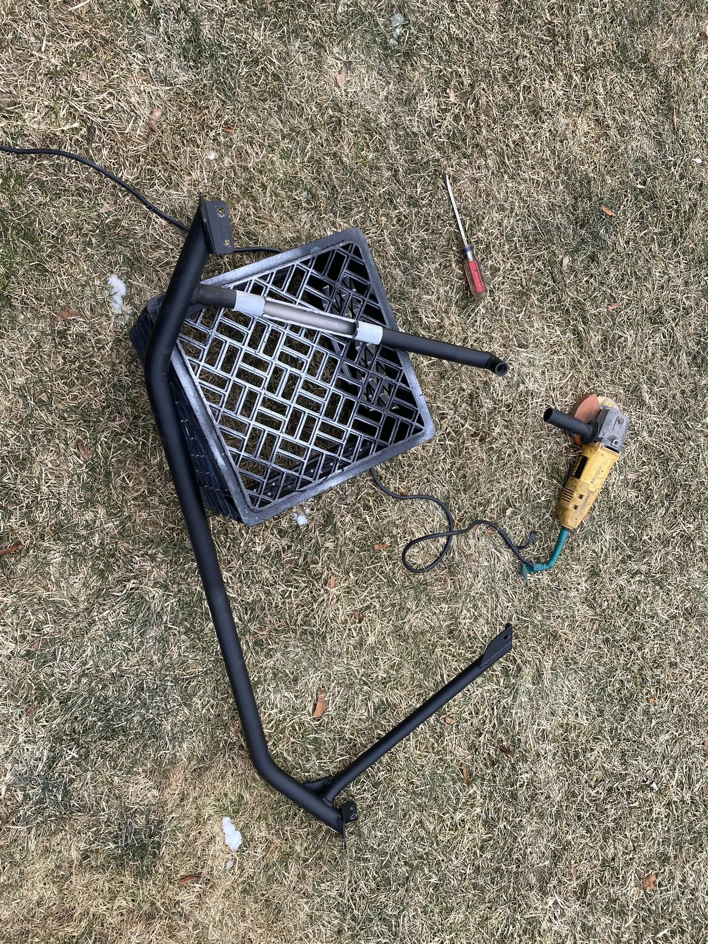

Well right now all I can do is stare at it. Loaned out my grinder/cutoff so I’m just twiddling thumbs Til I get it back.
If I can make a surgical cut here, might not even need to repowdercoat it if I leave the cut open. I’ll need to see how that looks though. If it’s very visible I will weld in a patch and grind it smooth.

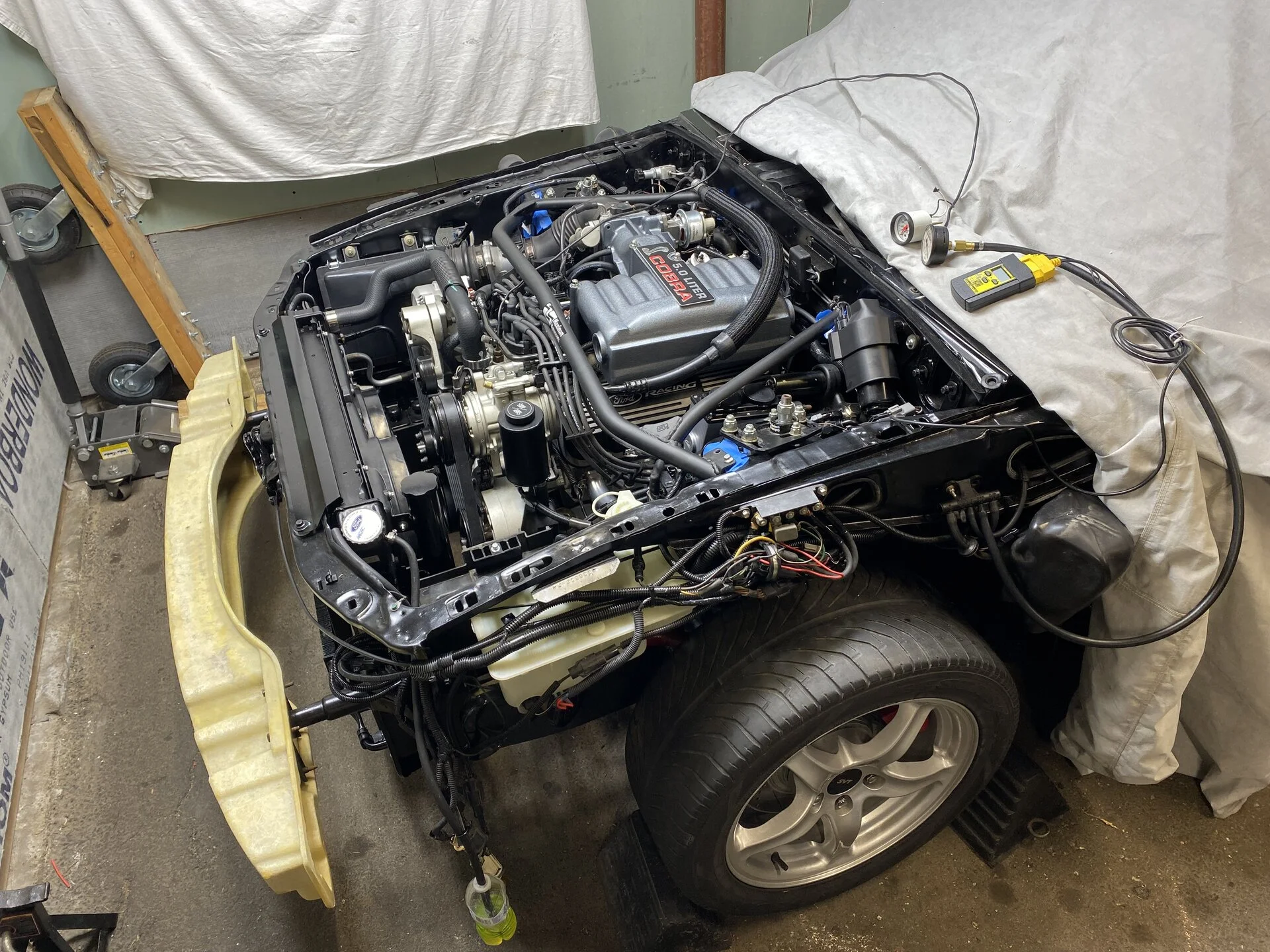

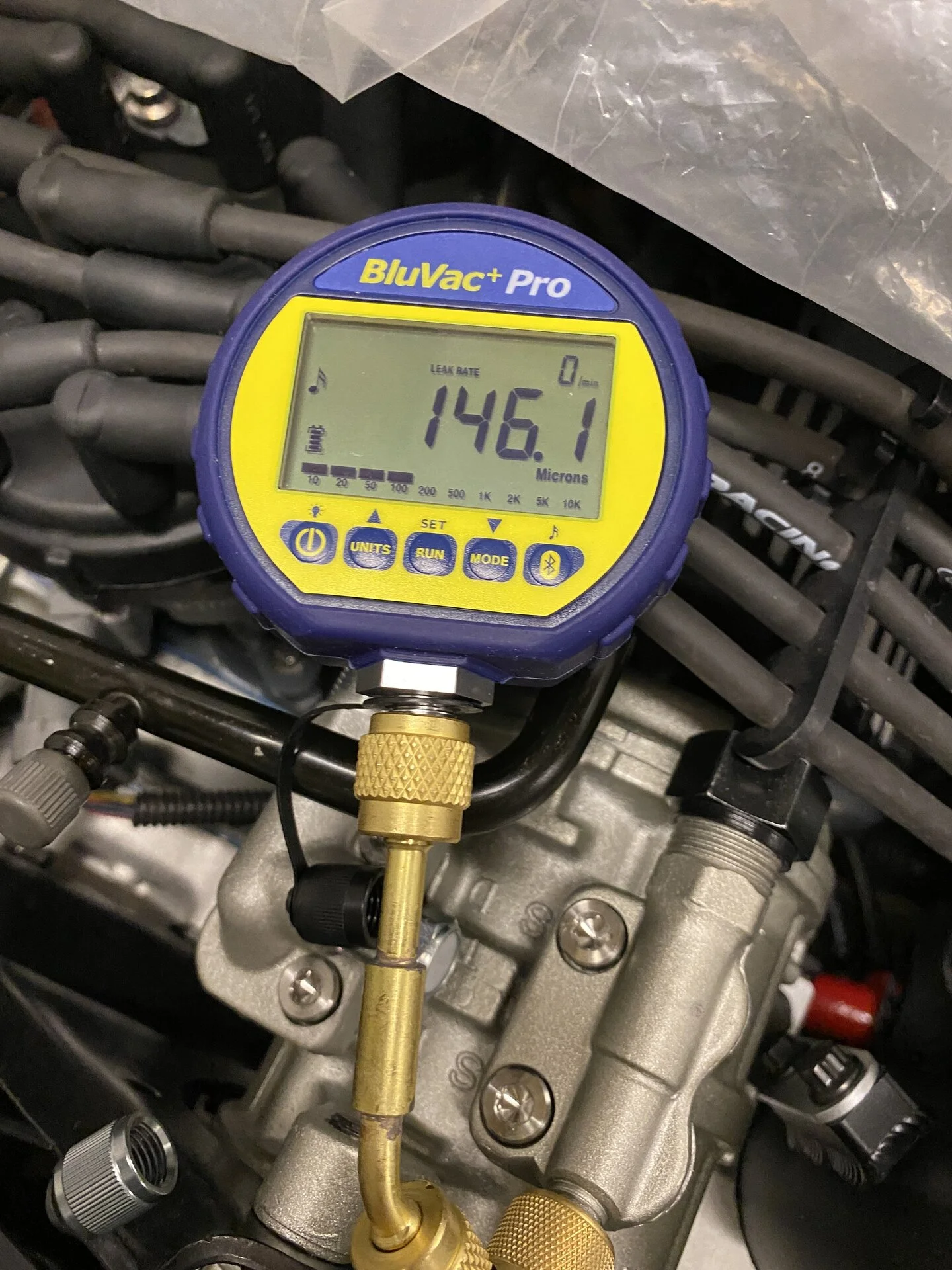

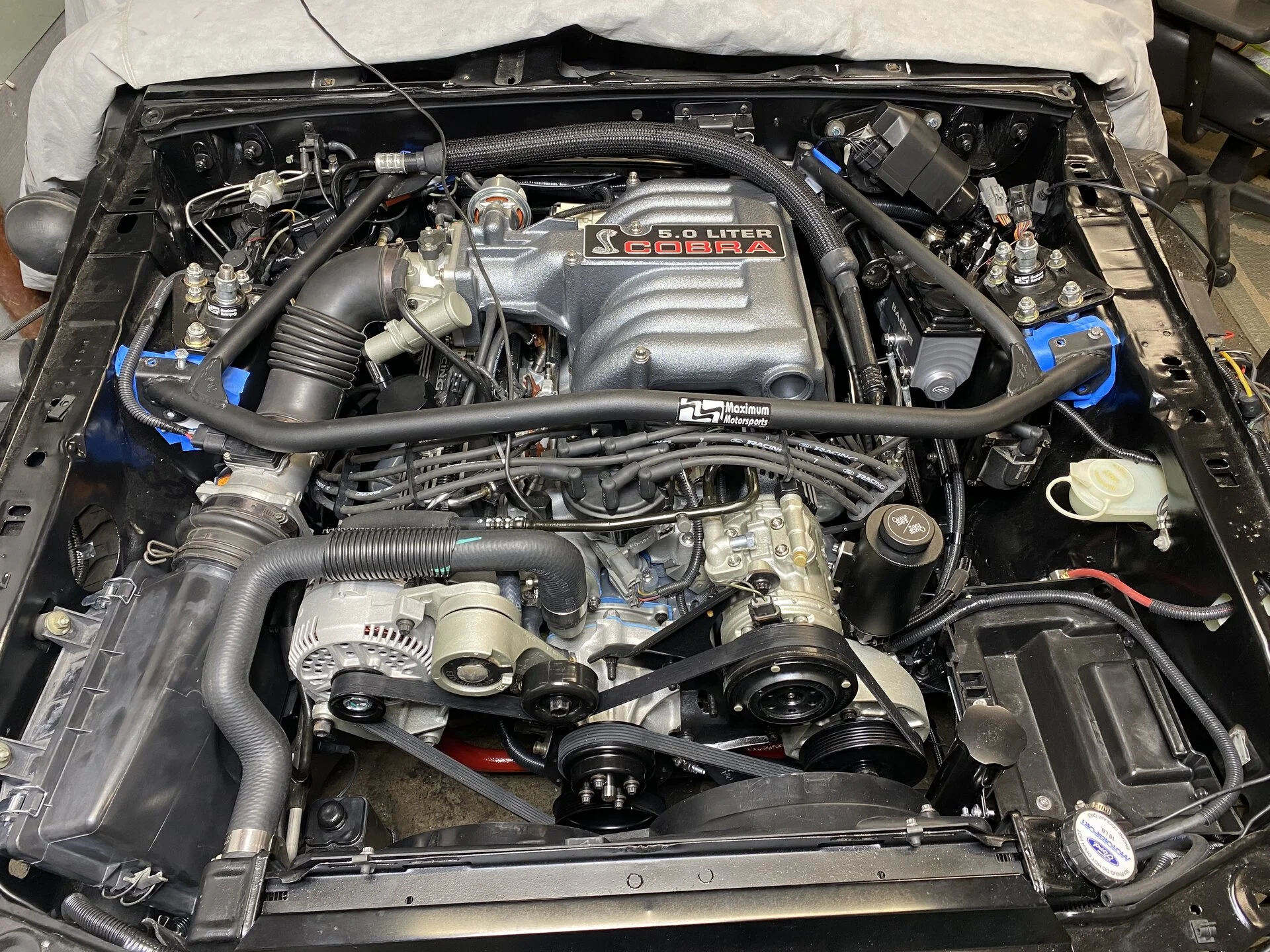

Messed around with the ac again today. Said I was done but I really wanted to get a nice deep vacuum.
I used my nitrogen bottle and did a series of 3 evacs and three refills. Each time, the vacuum got deeper and I was able to get to that level much quicker.
I’d say I’m down where I need to be.
I was advised not to charge it with the ambient temps so low (high 30's in the garage when i'm not running the heat) so I’ll put a little nitrogen back into the system and wait for warmer temps.

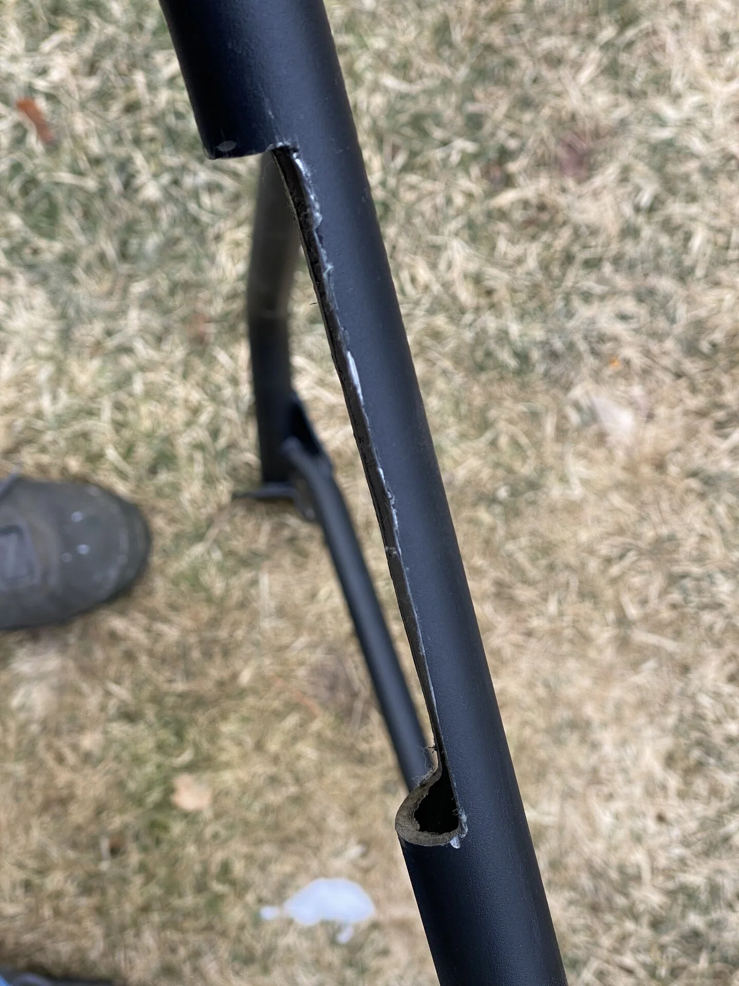

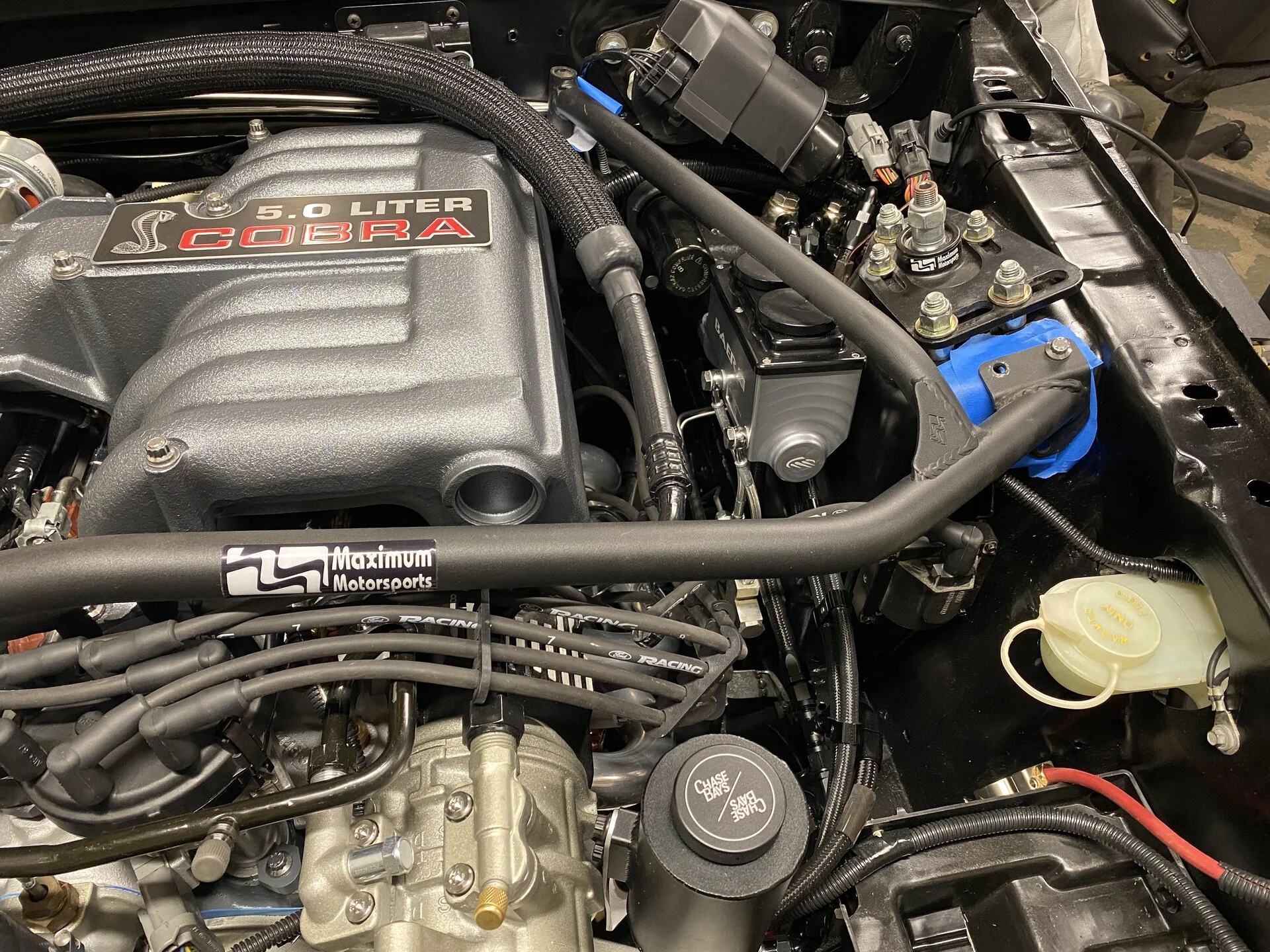

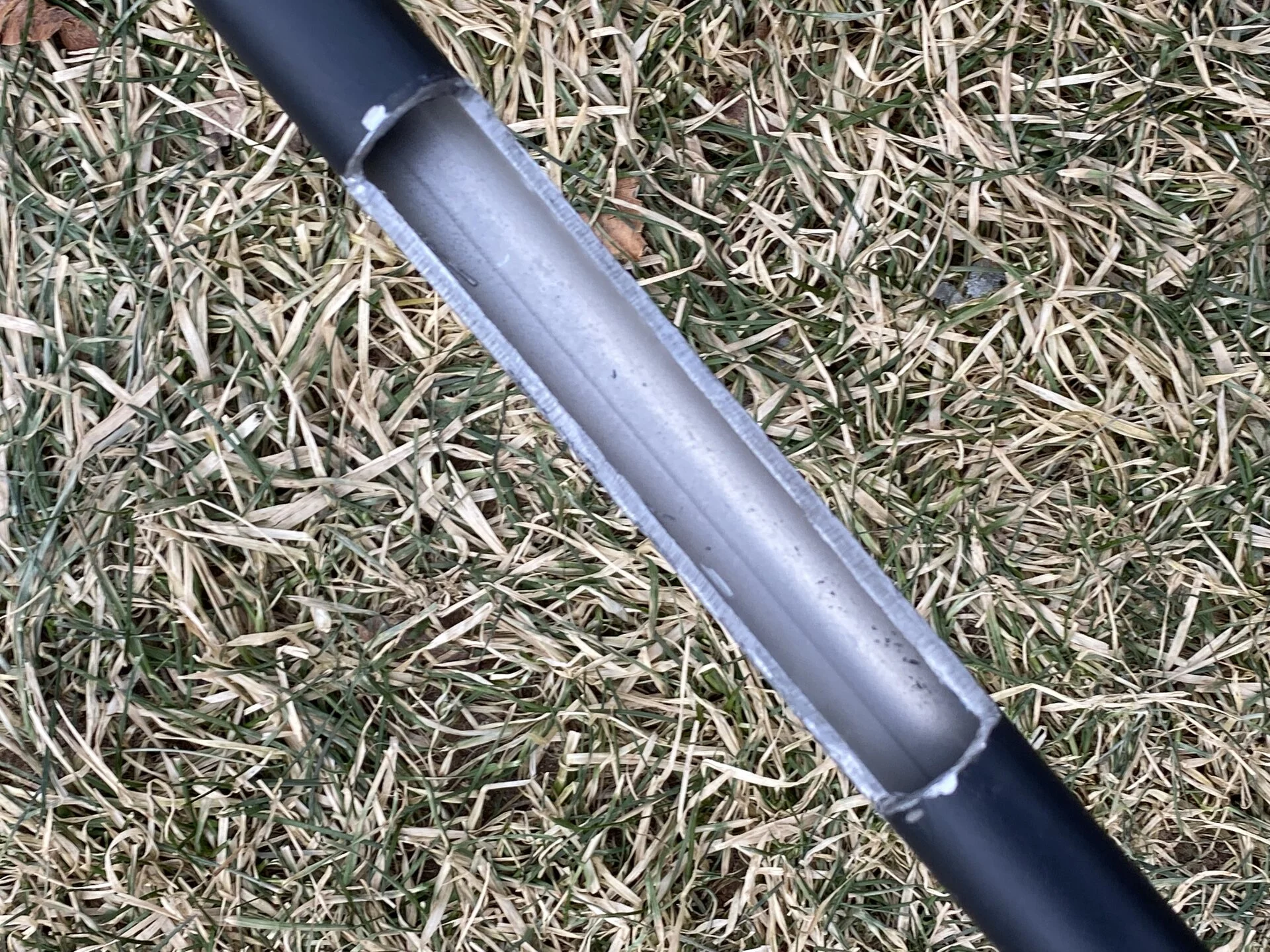

Decided to get outside and cut this out before Snowmaggedon hit. Depending on what forecast you read, anywhere from 18”-35” is coming.
Damn
Anyway, it came out pretty clean. Will try to bolt the brace on and see if it’s enough clearance.

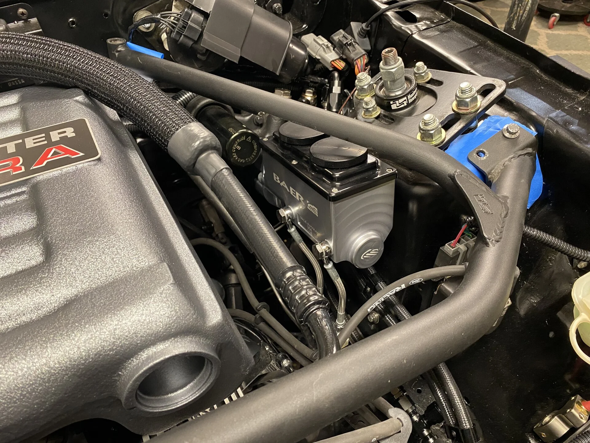

Fits pretty damn well now. I can get off both caps pretty easy to fill.
Now to get some ARP hardware

Couple small things tonight. Working on mounting the STB but need to grab some hardware. I’ll run it like this for now as I want to keep plugging away.
Extended my ac compressor harness and replaced the low pressure switch plug.
Am I done? Holy I think I am.
Time to put some fenders on.

Are you going to weld in a flat plate to fill what you cut out?
I am. I’m debating if I do that now or keep moving forward and revisit it later
True...... can easily be done now or later! The MM brace is pretty high up on my list of next mods!
