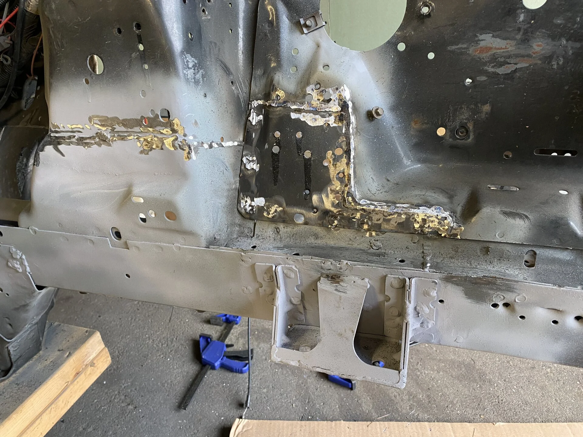

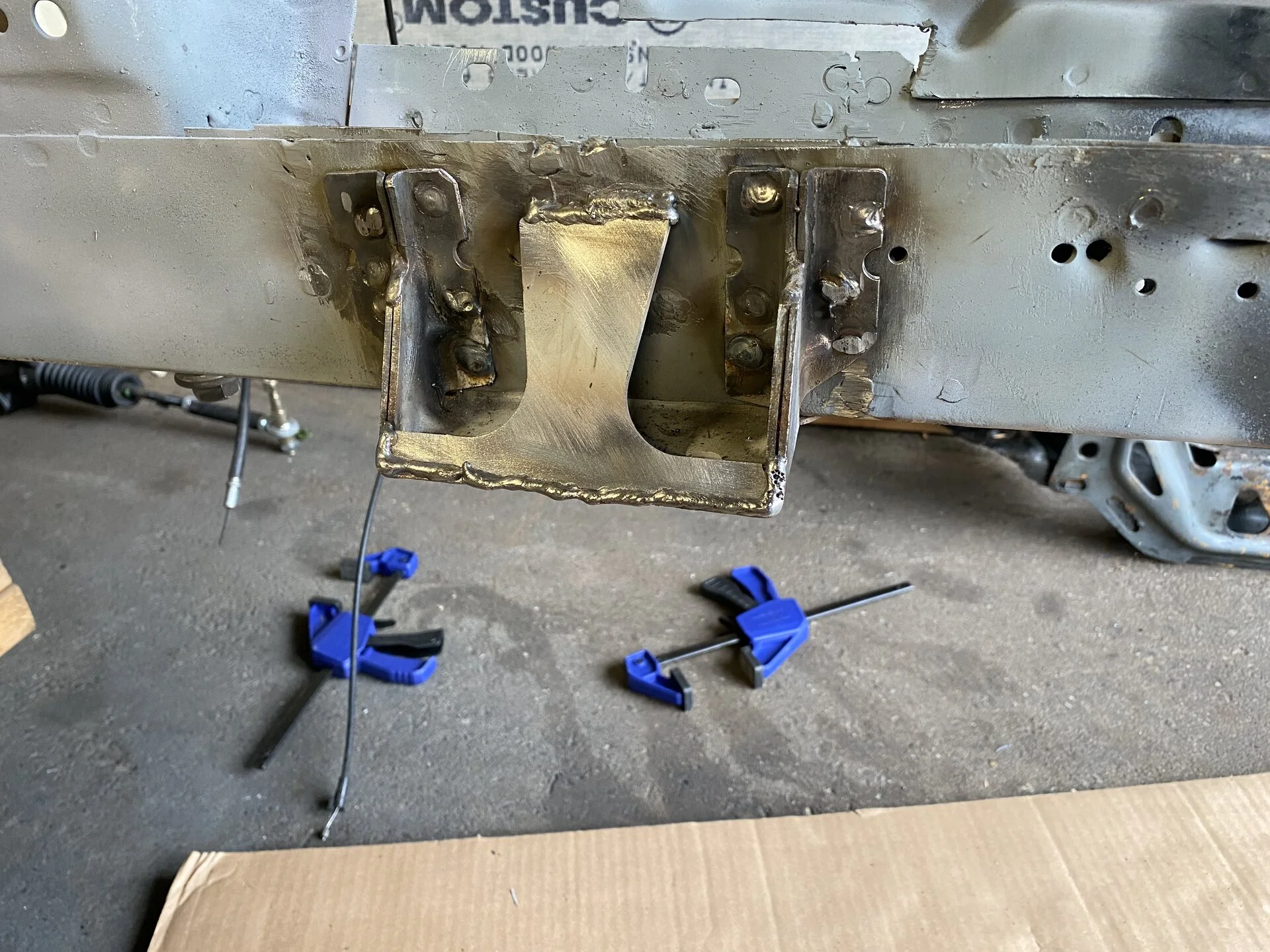

Sway bar bracket and apron back on. Not the prettiest welds but they’ll hold
Rear apron is gonna be a pita. Also need to weld on the frame rail stitch piece at the joint
I need to grind some of my welds down a tad but I’ll do that at the end. I’m just trying to finish up with the welder.

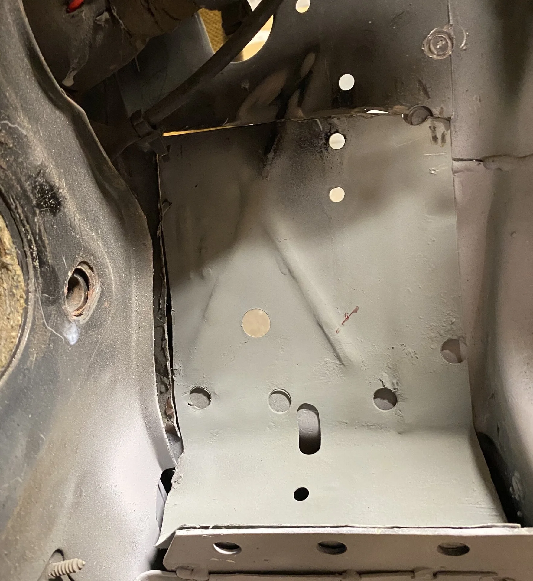

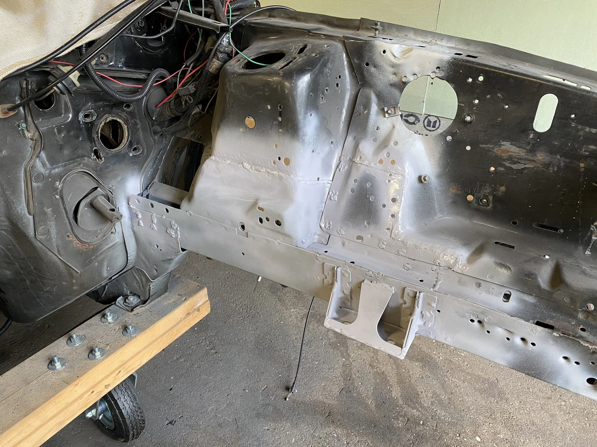

Didn’t weld it in yet, but got the last apron piece shaped up to the SN95 rail, cleaned up and ready to weld in.

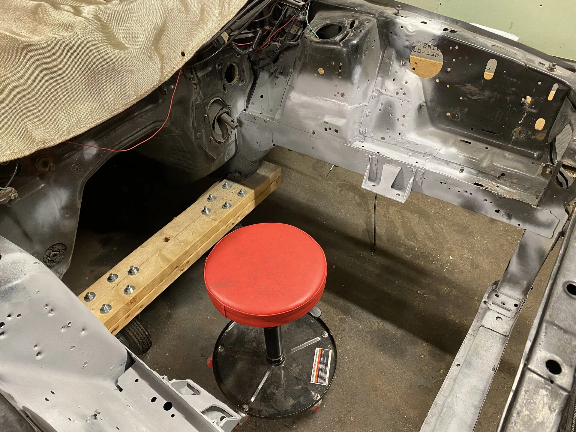

Damn near done now. After this final piece, I’ll start filling and grinding holes in the bay and knocking down some of those high welds. Then I’ll need to hit all the light surface rust areas. Should start moving quickly now.
I’m not filling every hole. I still am running the battery up front, stock airbox and plan on running a coil cover. So don’t expect a extensive hole finished job here.
