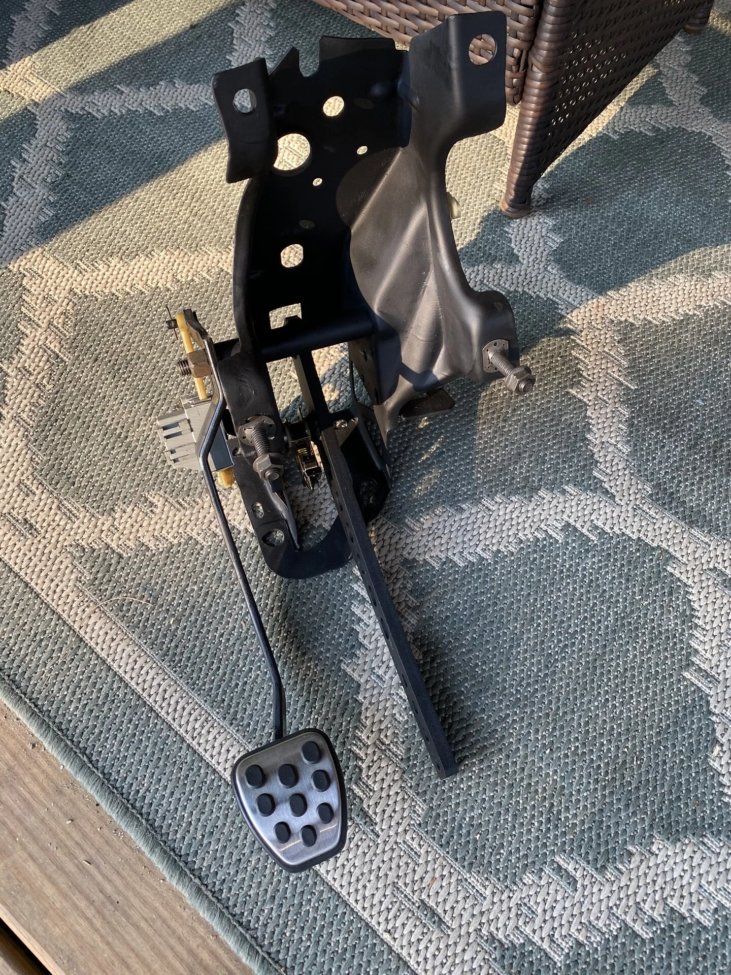

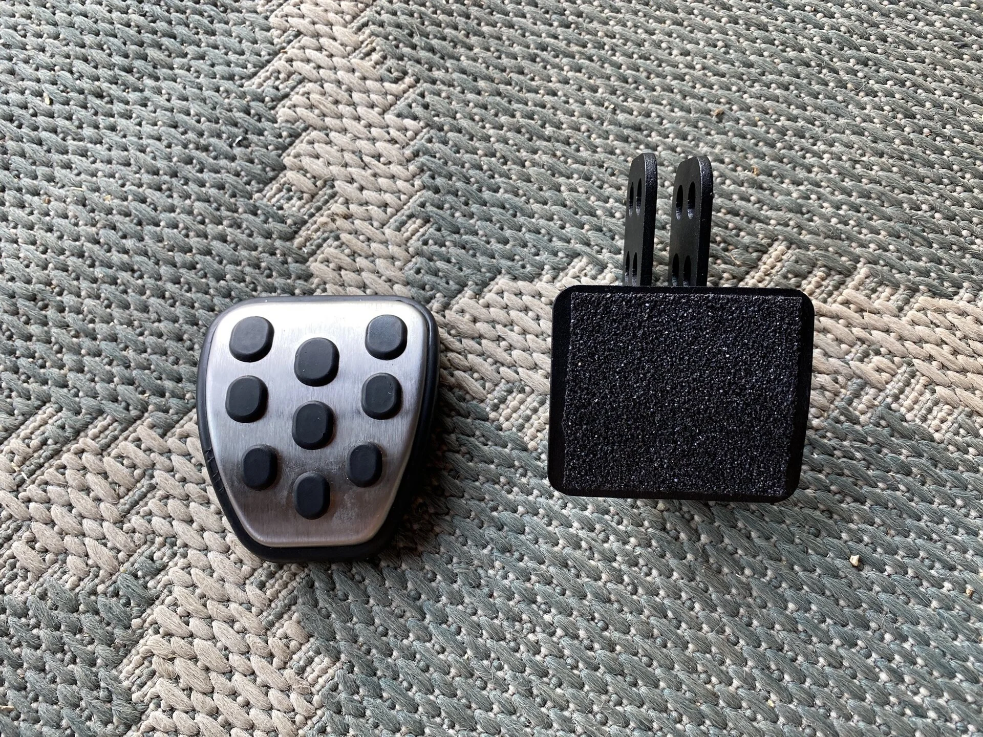

Bushings came. Pedal box done. MM hydroboost pedal installed and modified the clutch pedal for the SN95 bullitt pad.
now need to do the same for the MM pad
Reactions: stanglx2002

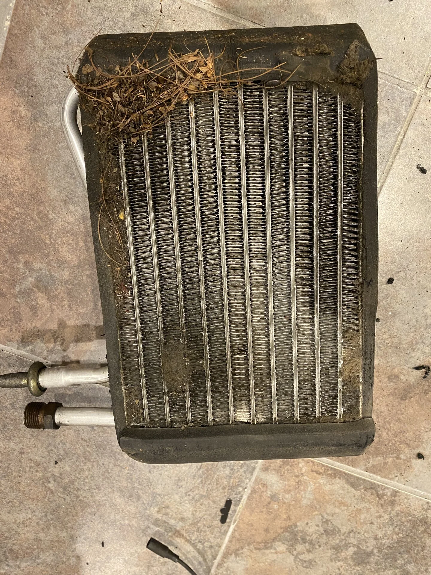

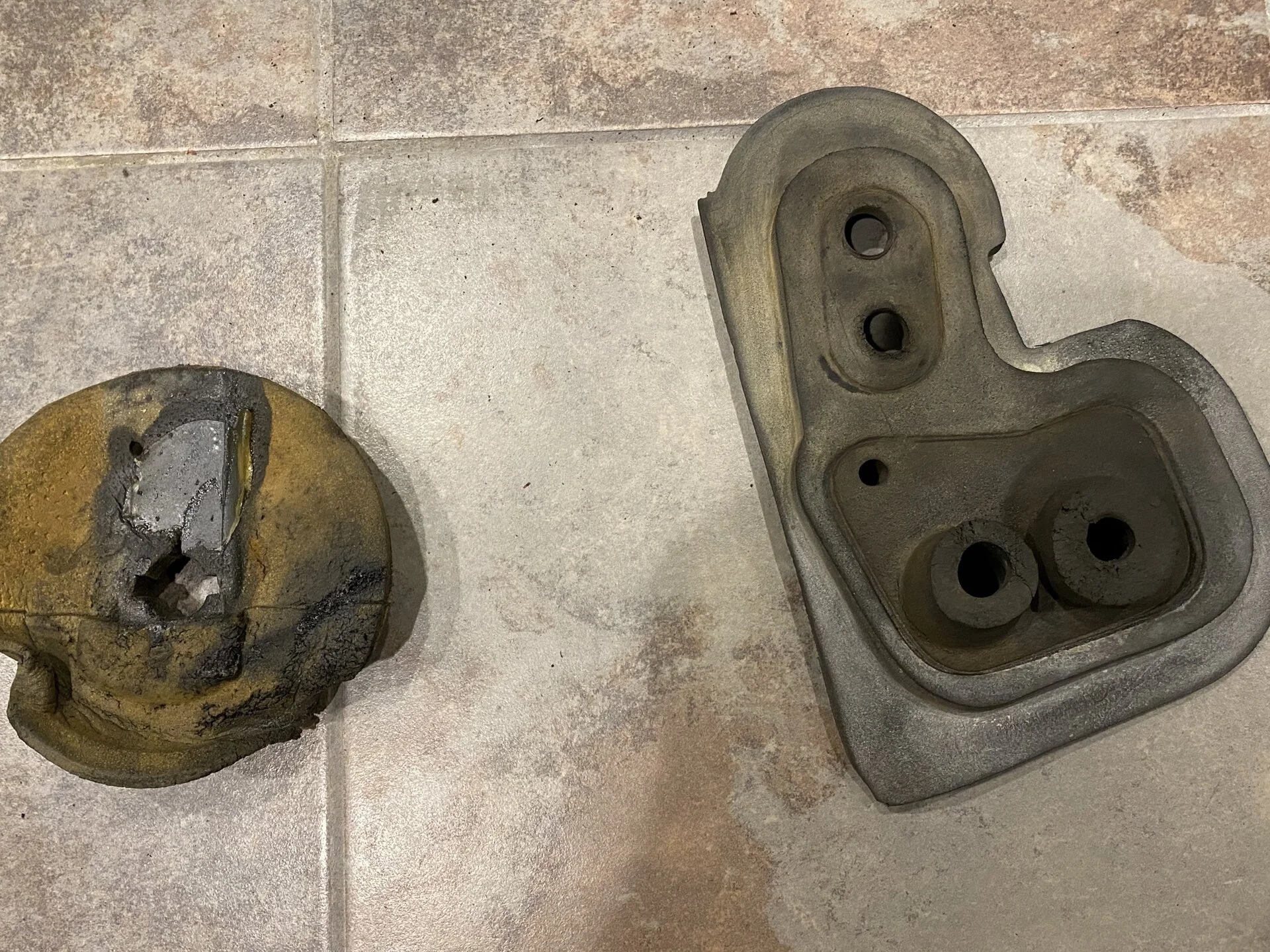

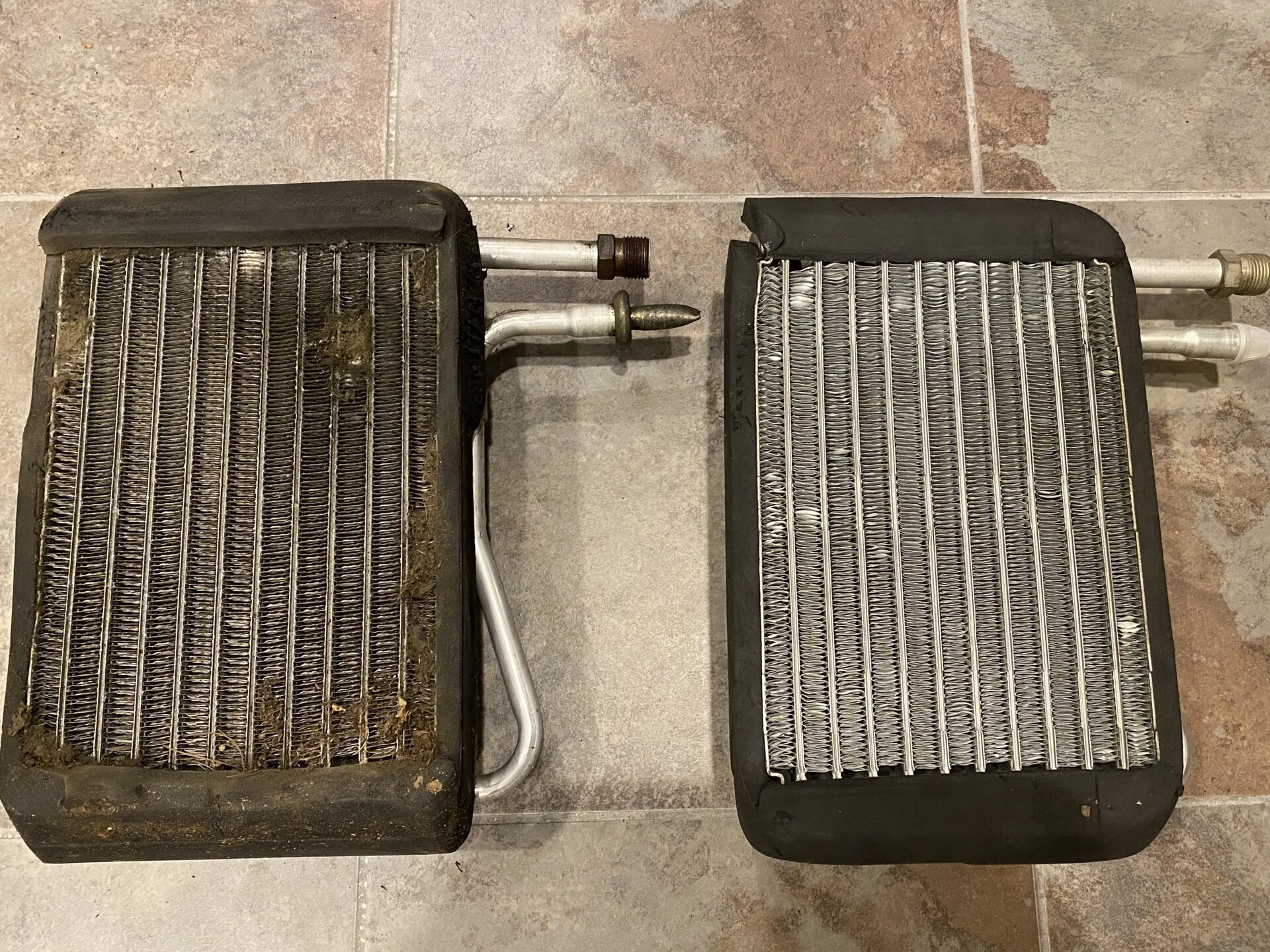

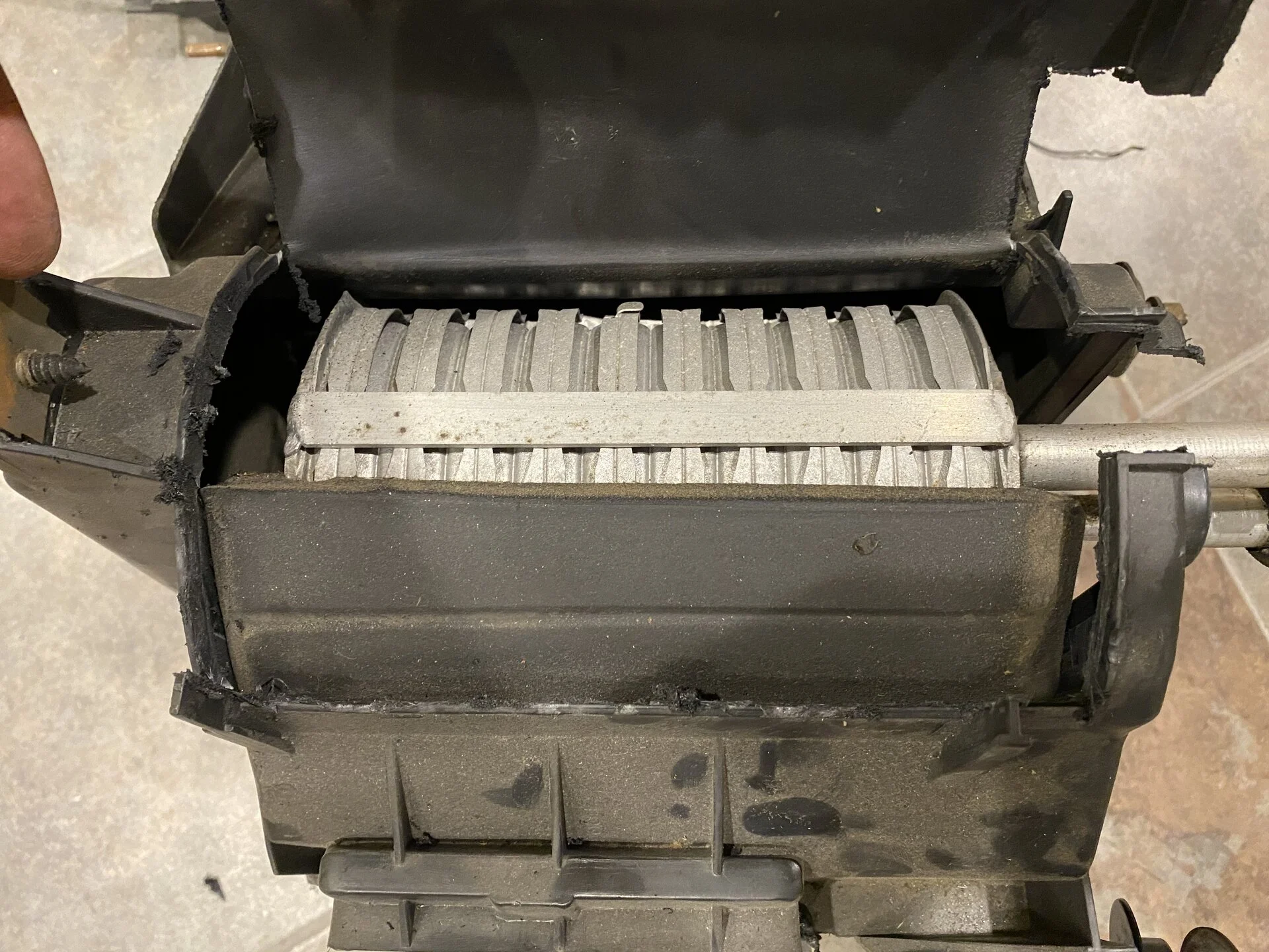

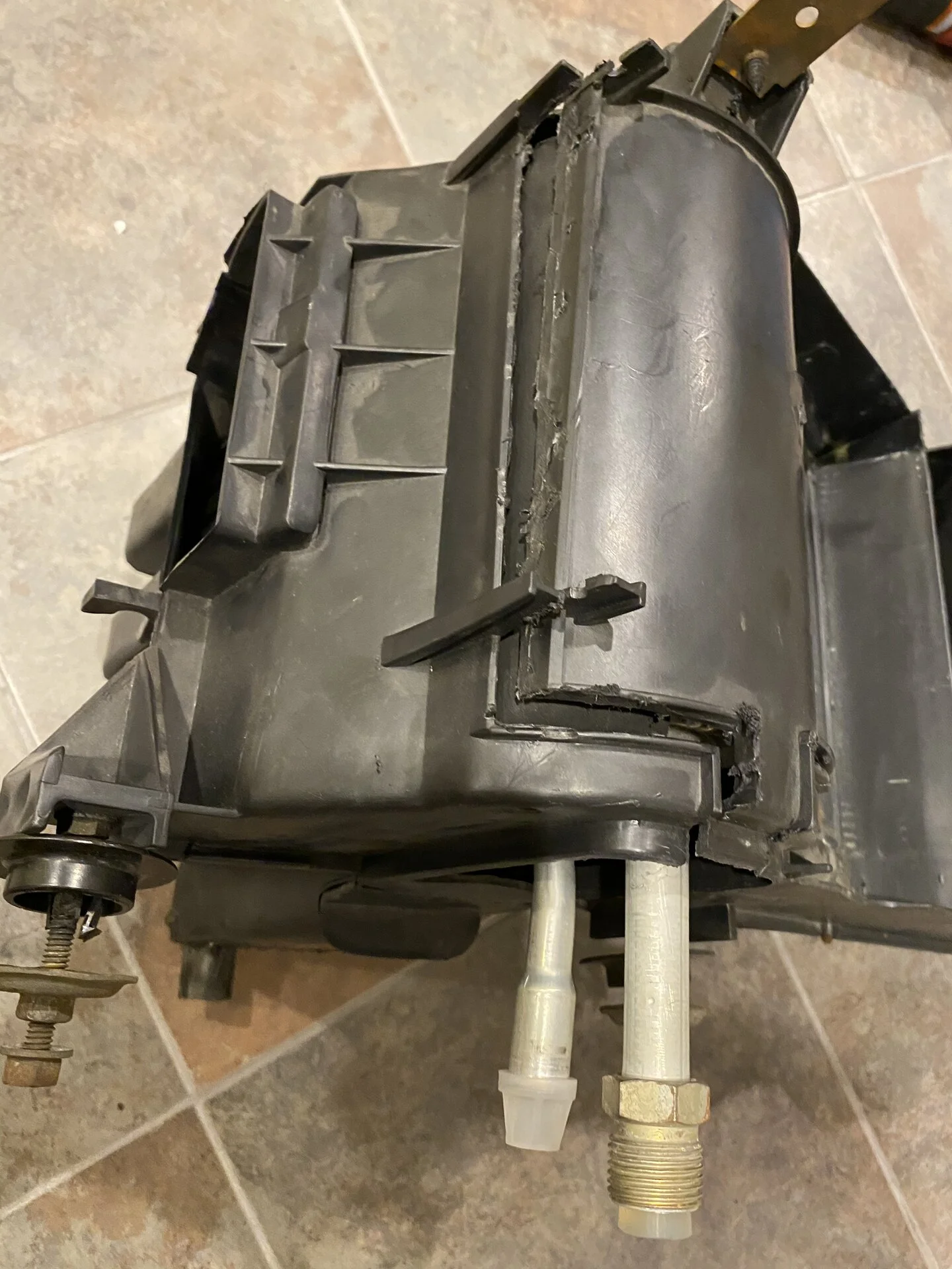

Quick work with a dremel to cut this out
Total nastiness. Glad I opted to replace it.
Compared to the brand new motorcraft unit.
btw, does anyone make these seals? They are in OK shape but I would love fresh ones

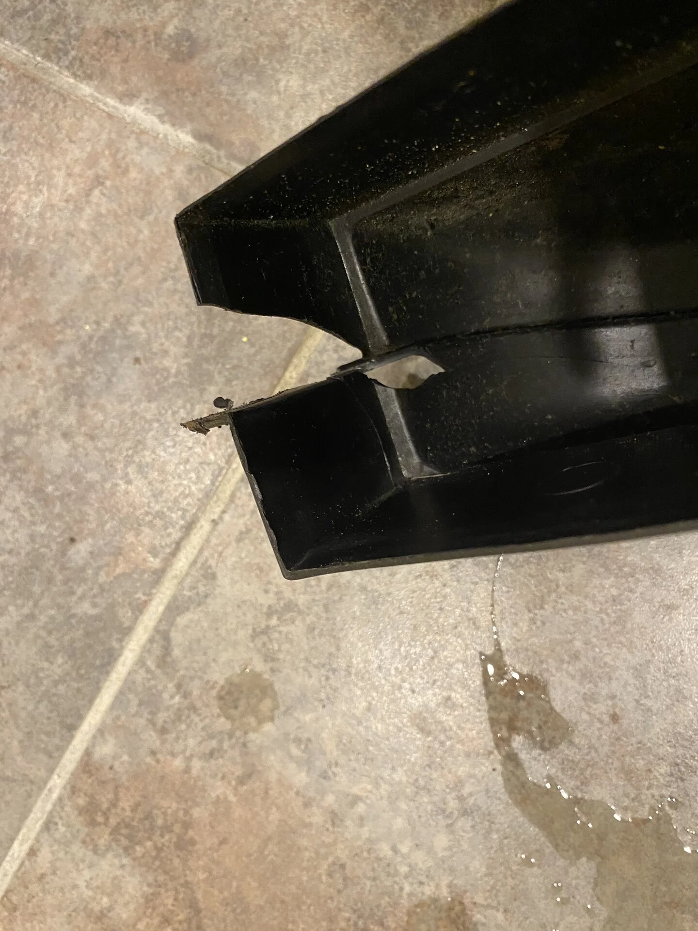

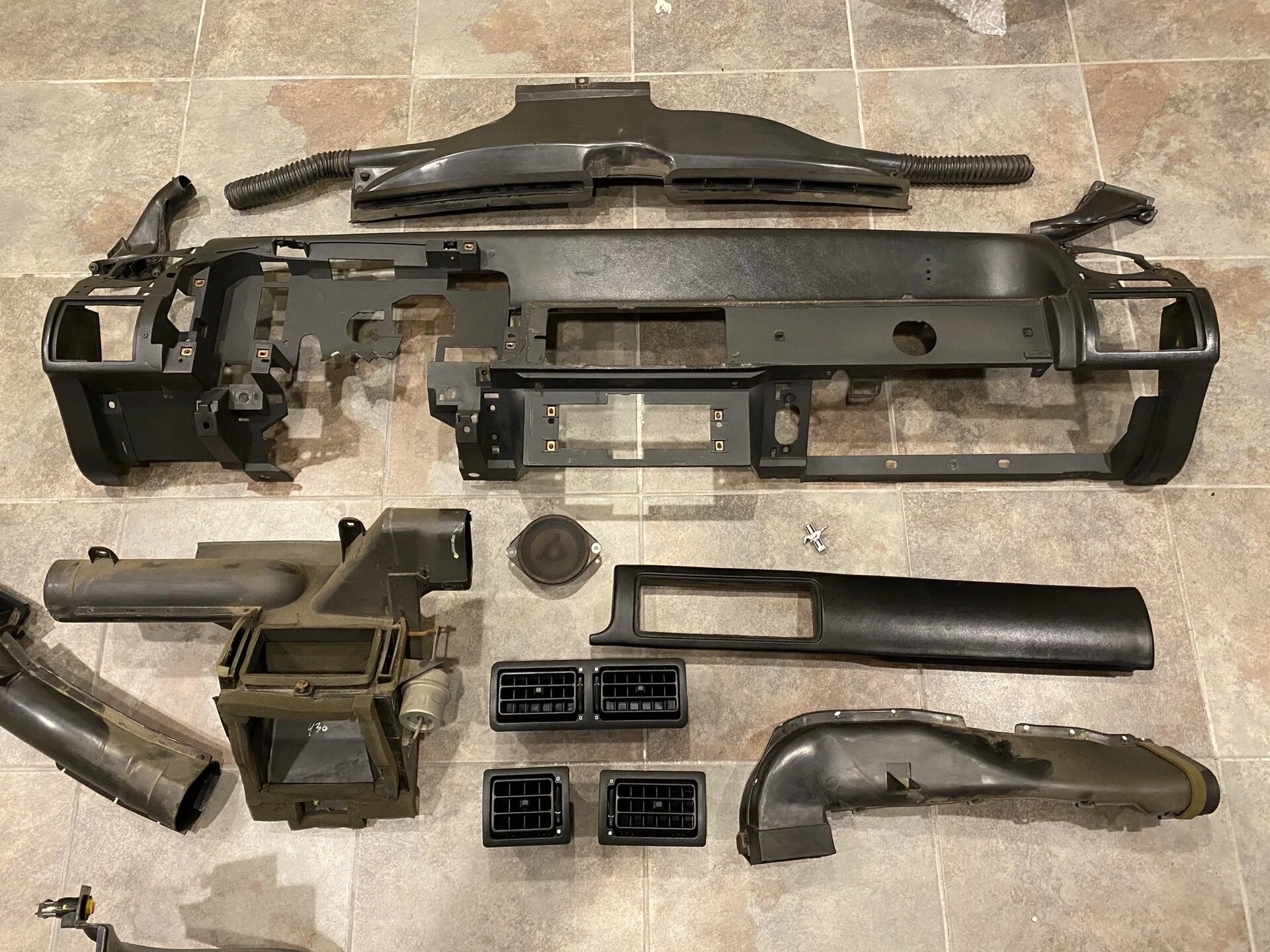

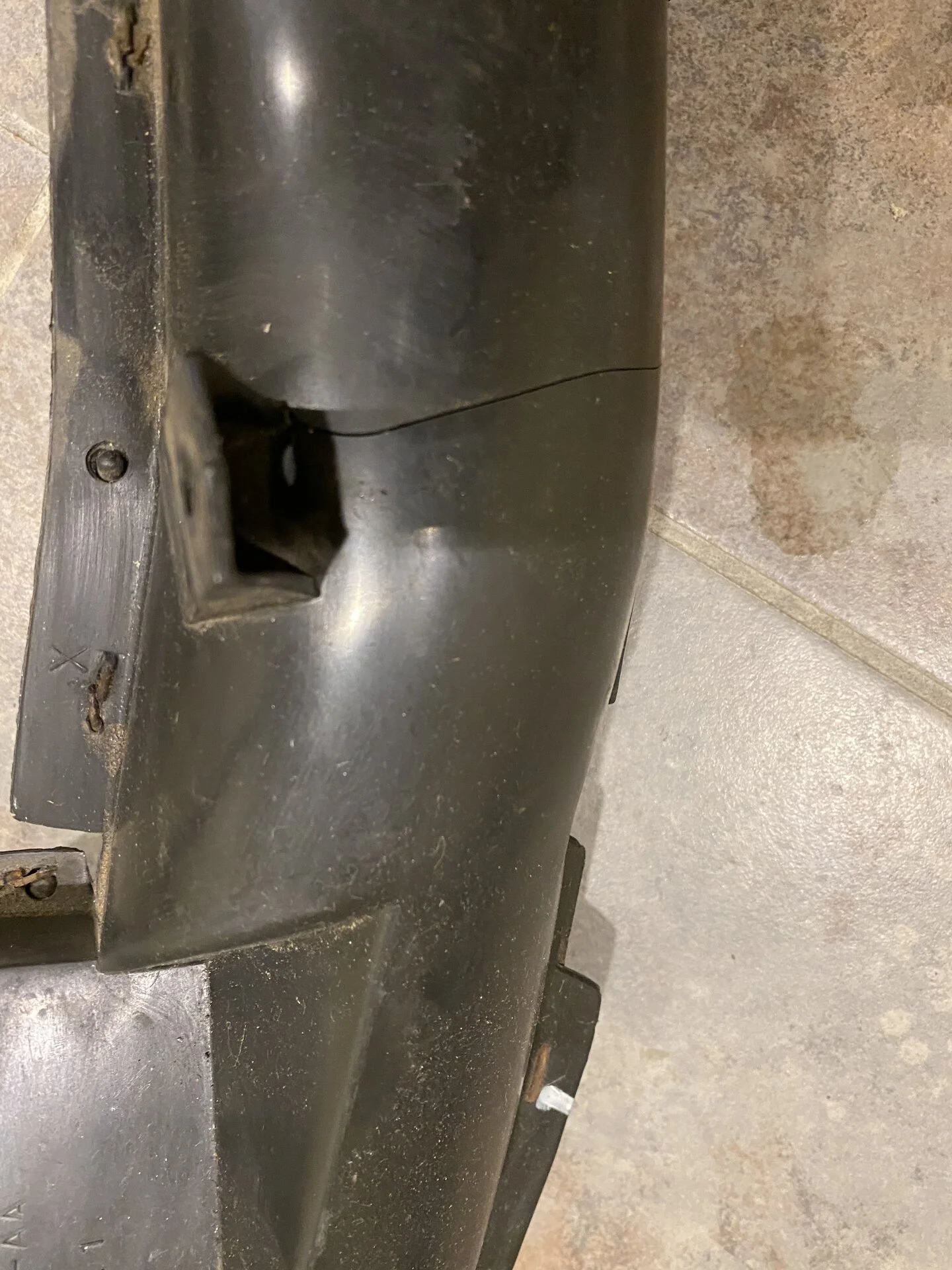

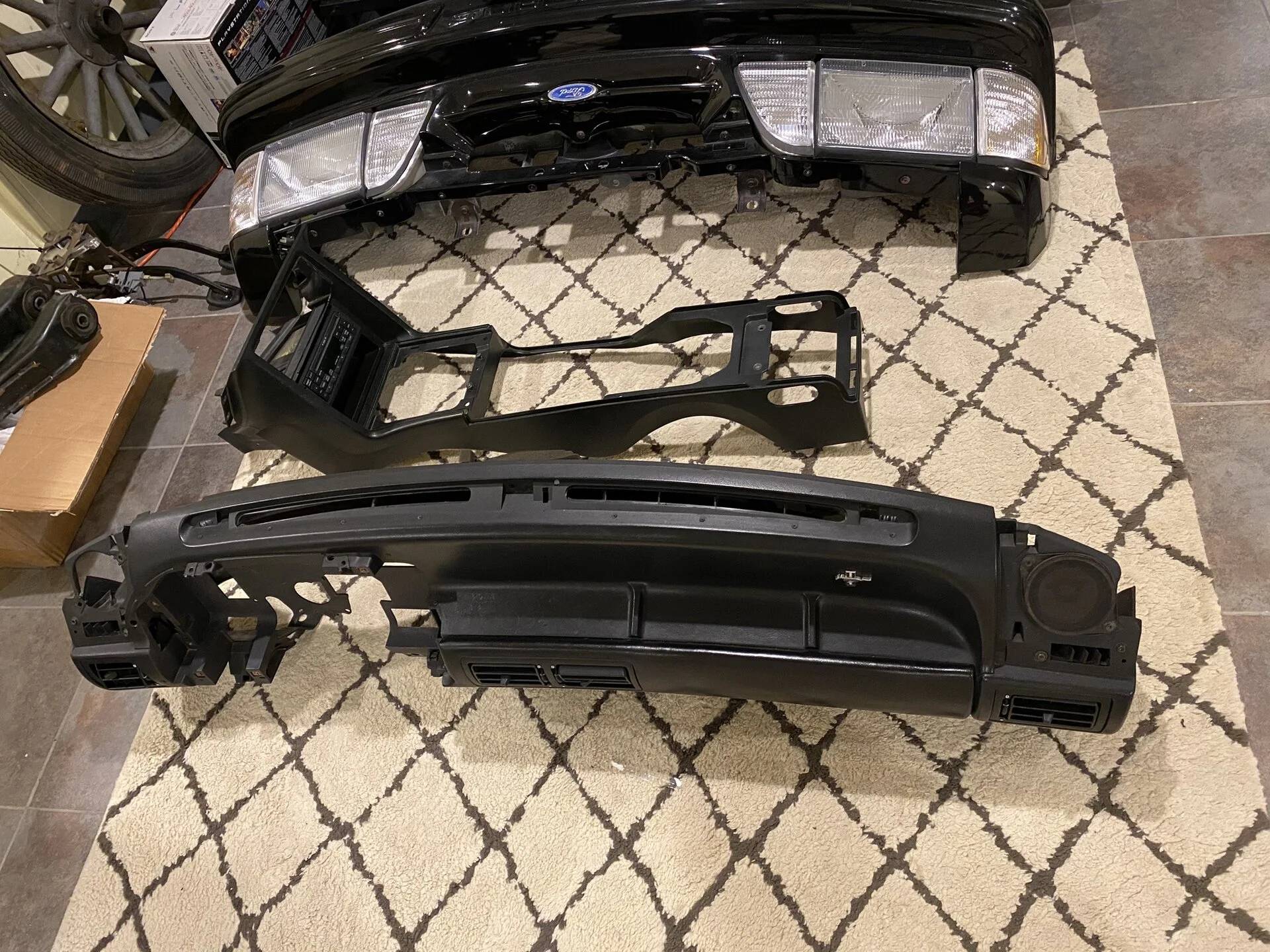

What started as a quick dash wash down ended up with me cutting my hand on glass somewhere in the dash. I took this dash out of a junkyard car so along with the glass I found the remains of spilled coke. Decided to break it down all the way and wash it all.
yeah...I know I’m nuts
Found one of the register ducts was broken. Fortunately I just robbed one off the spare parts black dash in my attic.
Was all sticky under the center register and behind the dash pad.
I don't think so, my friend. Those are DIY.

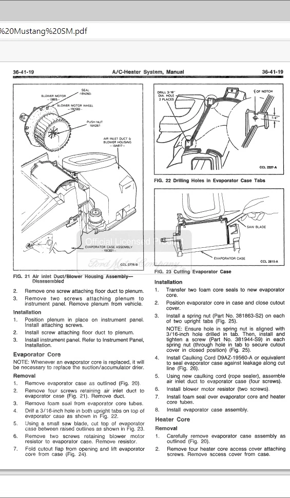

New one in. I’ve got a heater core in the mail. Shame that motorcraft units are not available. I picked up a Spectra so we will see how it does. If it fails...bypass. I need AC...not heat
I ordered the clips referenced in the ford service manual. Now to figure out best way to seal the box up.

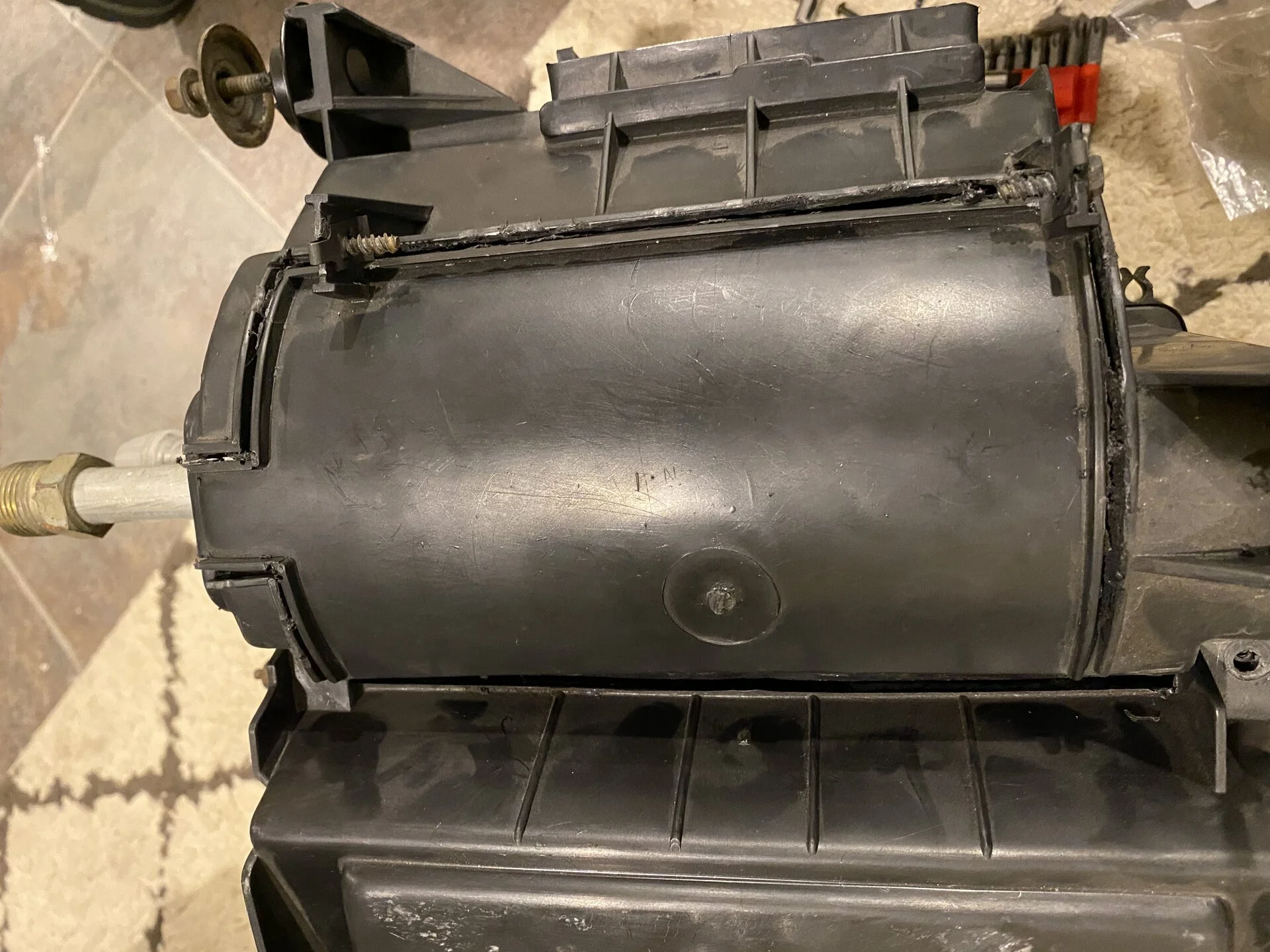

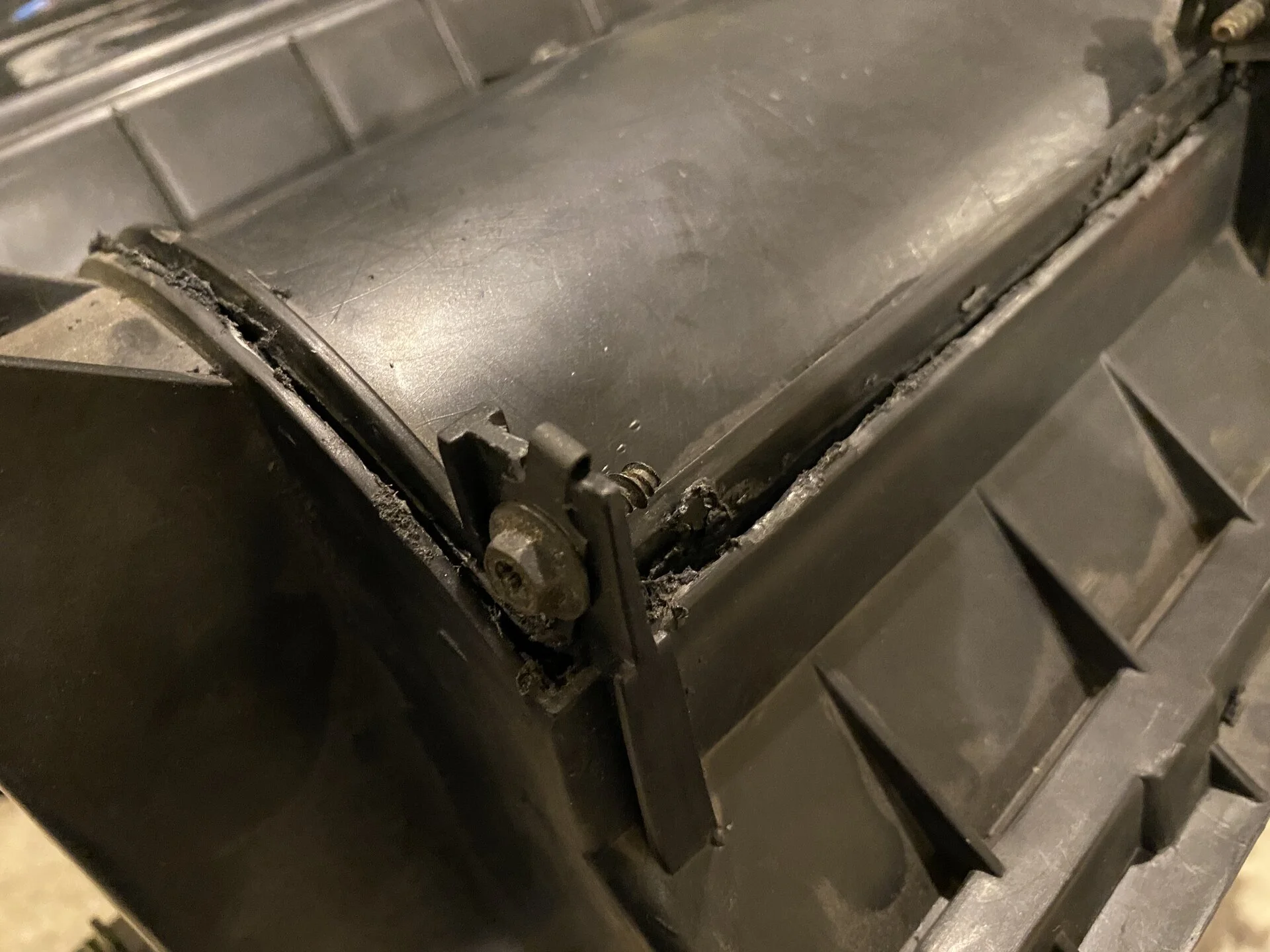

Ok, got some spring clips which do a great job holding the evap flap closed. Now to determine how to seal it up?
RTV? Butyl? Silicone?

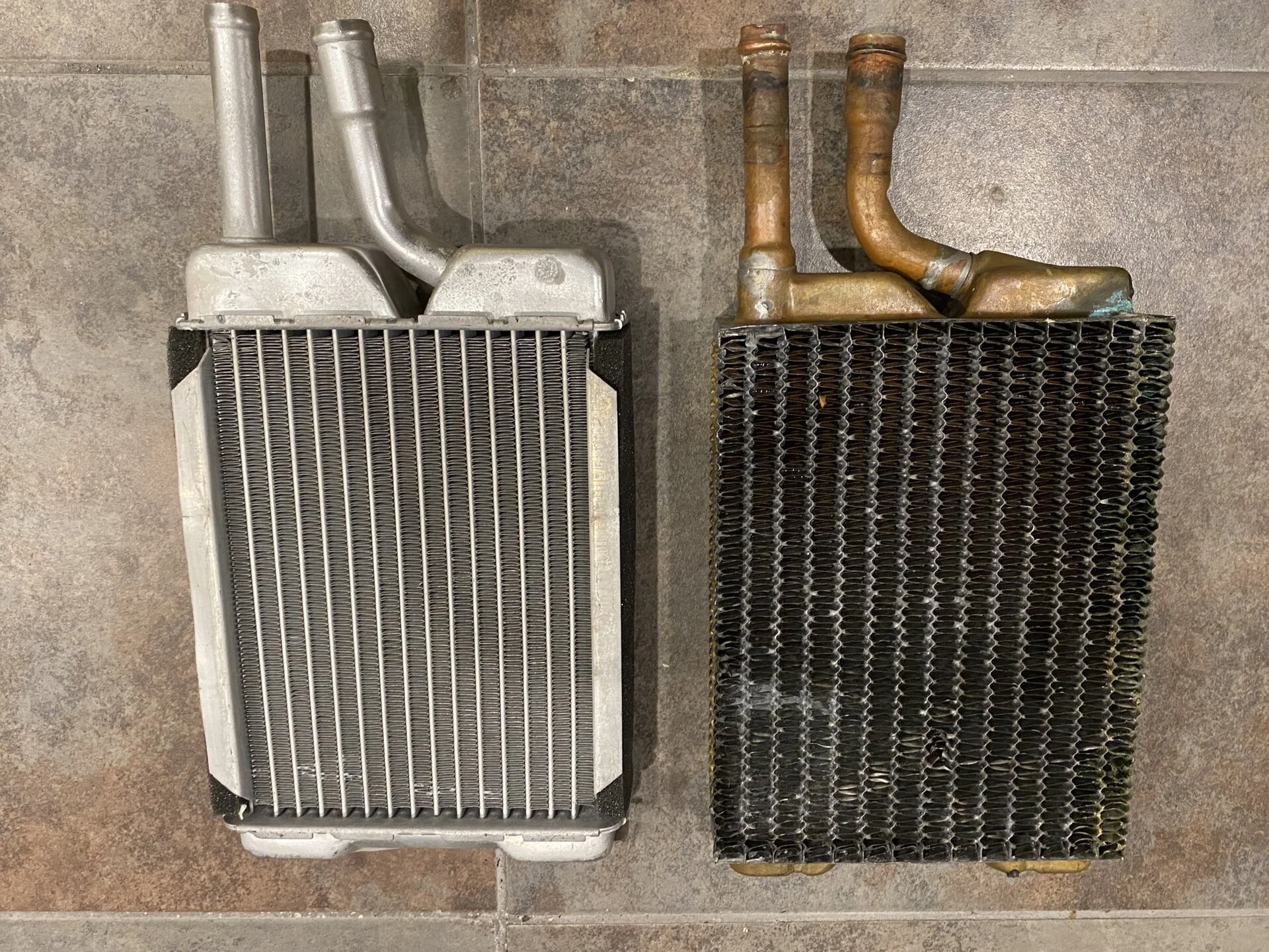

Also, got my heater core.....
eh......
It’s aluminum, and one tube is bent. Seems very...flimsy.
Ican’t find a motorcraft, or copper unit at all. The LMR one looks like one of the bottom barrel cores from rock auto. I don’t want to put any of these in.
I’d pay $100+ for a genuine motorcraft unit...if I could find one

Just in case you haven't checked out NPD:
Replacement Style Heater Core for (79-93) W/ Heater Only or w/ Dealer Installed A/C - #M-18476-1A - National Parts Depot
Buy part #M-18476-1A Replacement Style Heater Core for (79-93) W/ Heater Only or w/ Dealer Installed A/C for your classic 1979-1993 Mustang from National Parts Depot. Free shipping on orders over $300, fast delivery & everyday low pricing! Order now!
www.npdlink.com
It might be worth calling them to see where it's made. The picture looks more like a stock copper unit.
eh......
I used ultra black to seal mine and made a small metal plate or two. I used pop rivets where i could.
I put 3 of the LMR cores in and every one of them leaked. They are in fact the lowest level ones from a parts store. I can now pull a dash out in 30 minutes, unfortunately. Let me look on the Motorcraft core... sorry i forgot.

Wayne Waldrep said:
Check your pm's. I found you ONE. Apparently the only one anywhere.
Thanks. I called. It's expensive.
So I bought it. I can't put this Aluminum POS in my car. Not at this point in what I've been doing to it. I appreciate you finding me perhaps the last one in the country.
