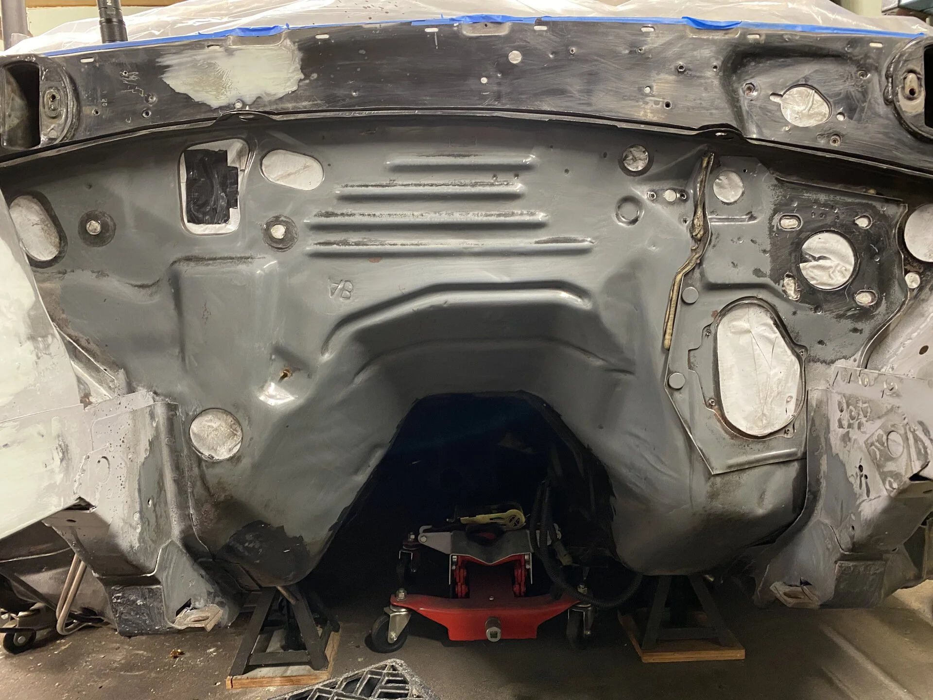

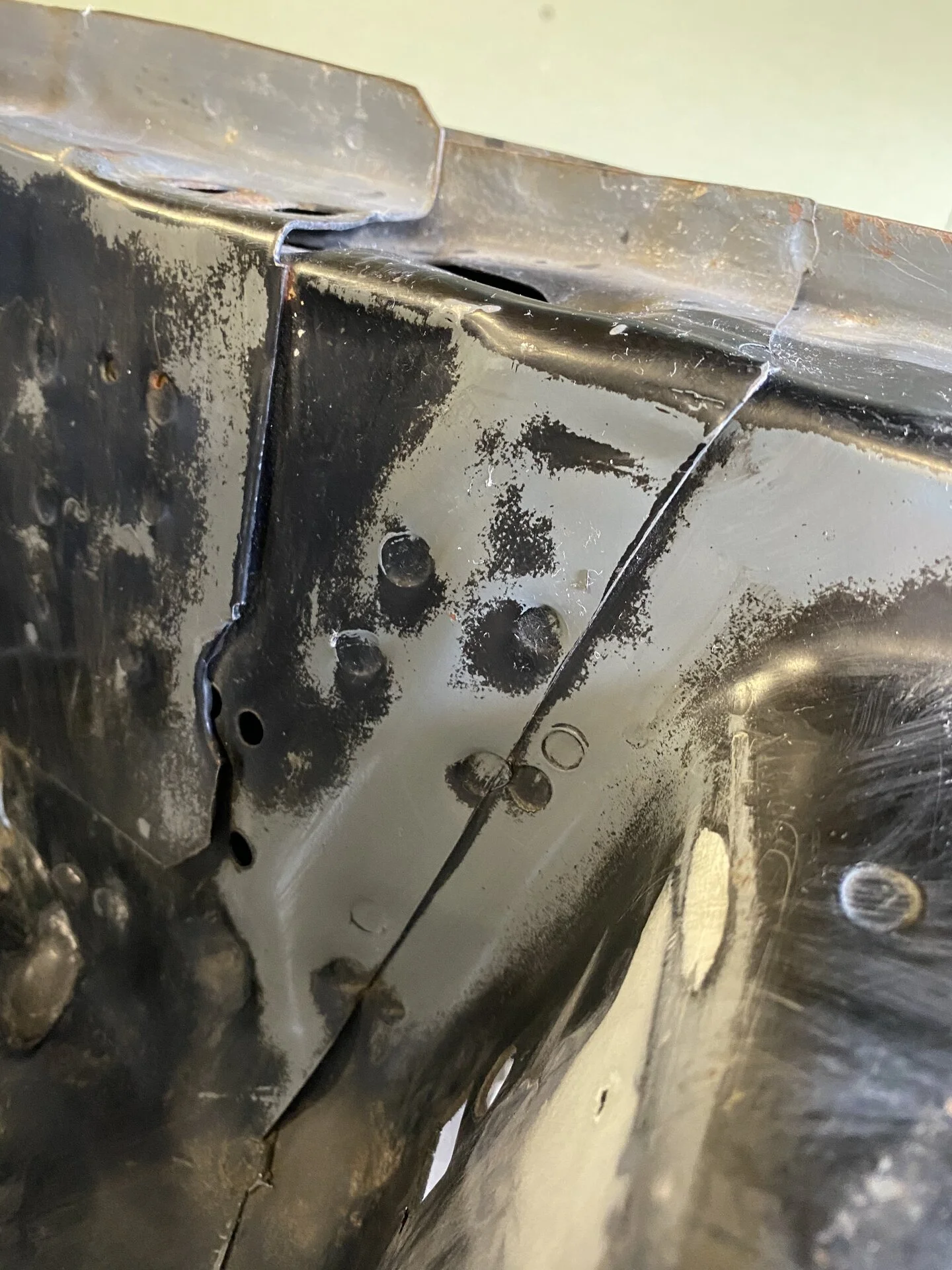

Mustang5L5 said:
So mustamg engine bays are typically fully painted right? They are also painted in a paint that can typically withstand solvents right?
I did an acetone wipe of the firewall and found the black paint easily came off without much effort.
Bottom left, you'll see some black paint that remains, as well as into the trans tunnel. That's the POR I spread about 15 years ago. Glad to see it doesn't come off easiy. I may actyally add some more POR-15 in that lower area while i'm here.
But, it's interesting to see that below the firewall seam, the black paint came off easily and down to the E_coat. Above the seam, it remains. Wasnt the only spot i was able to wipe the black paint off. Rad support and aprons also had paint wipe off, although not as much. I couldn't go crazy though as i obviously needed to stay away from the body filler. I found out the hard way that acetone softens that right up. Oops. ALl fixed now.
On the plus side, i'm pleasantly surprised to see all the other sheet metal is in really good shape. Well..other than the frame rails. But no rust around the cowl and base of windshield as well which was a relief.
With all these fumes and solvents and paints, i ended up buying a supply air respirator. Pump goes outside in the fresh air, and then a 20-25'hose feeds fresh air to my mask. The smells of the filler and acetone give me headaches. When i'm done, i'll sell the respirator off.
Even now Mike, vehicle manufacturers don’t use much material in engine bays and some jambs on vehicles. I can imagine how little they used back then.

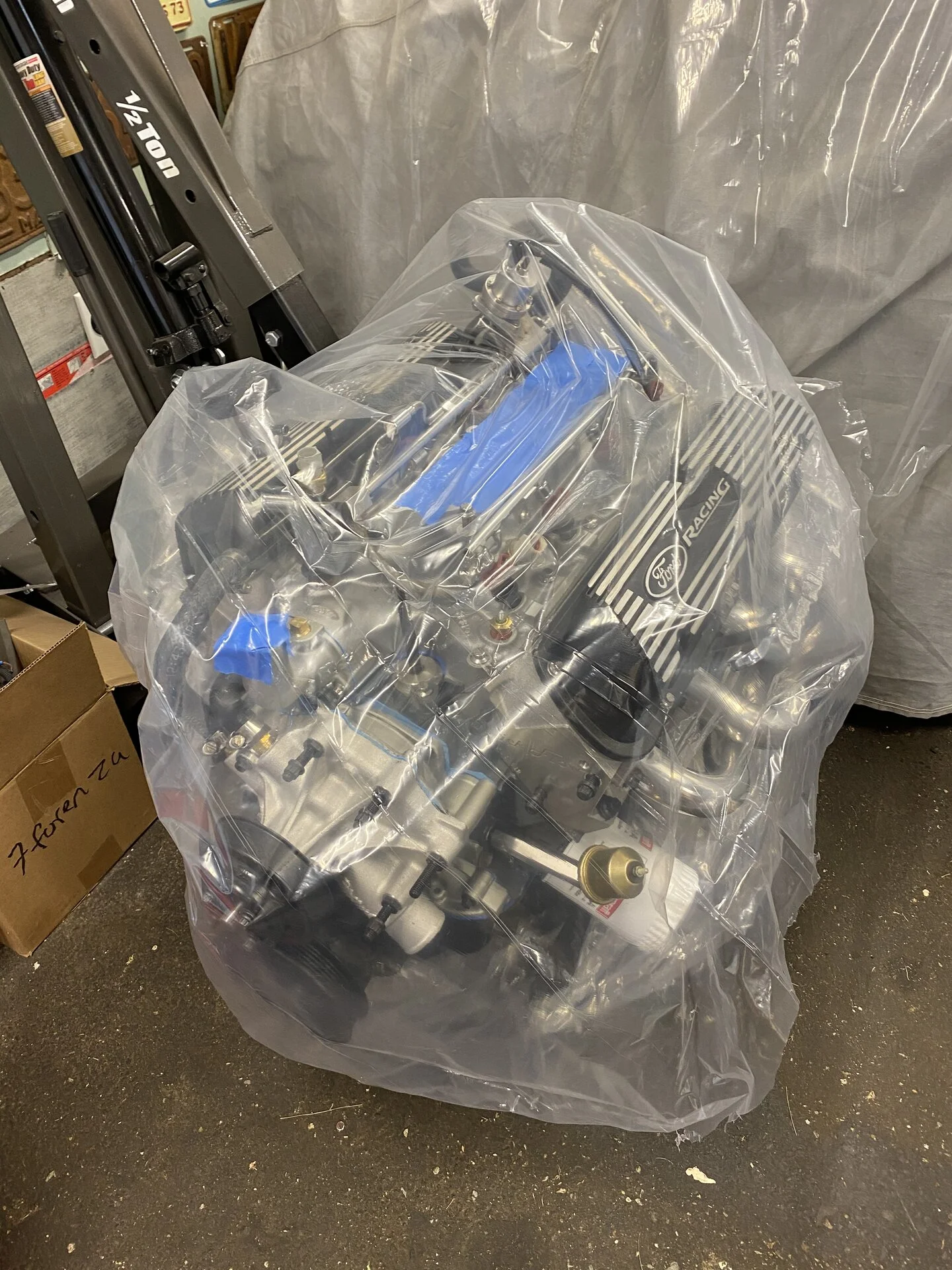

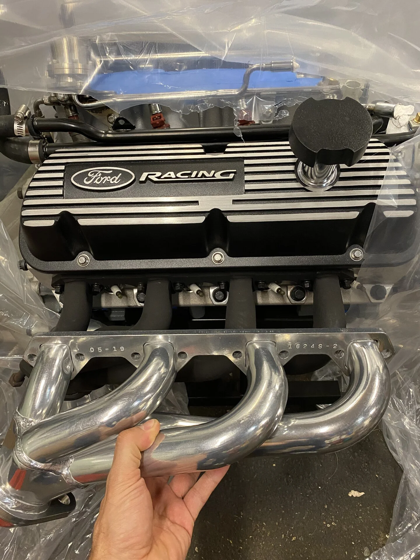

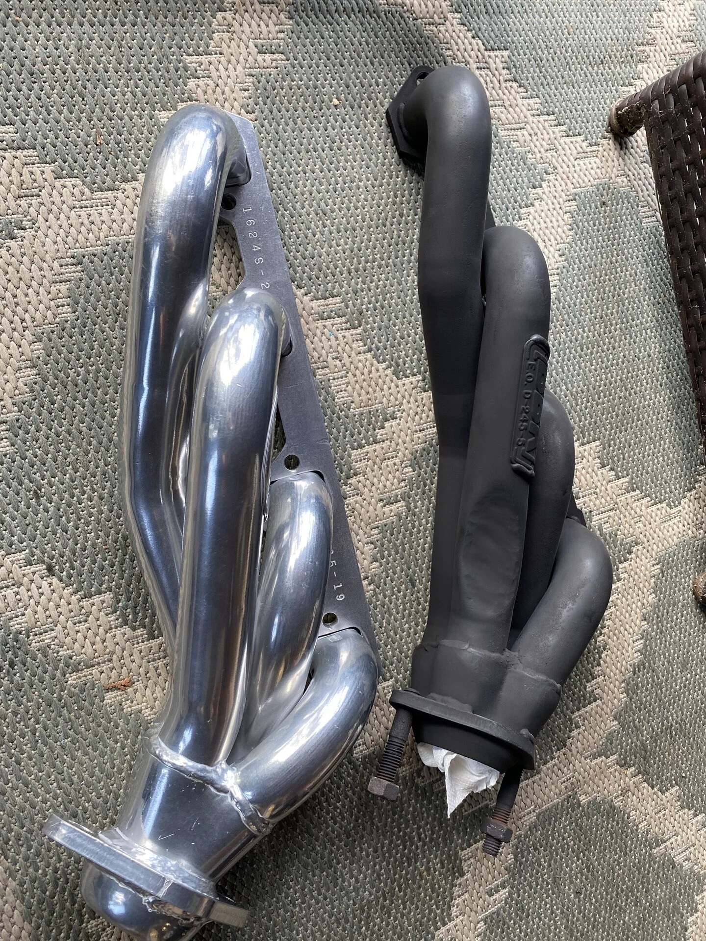

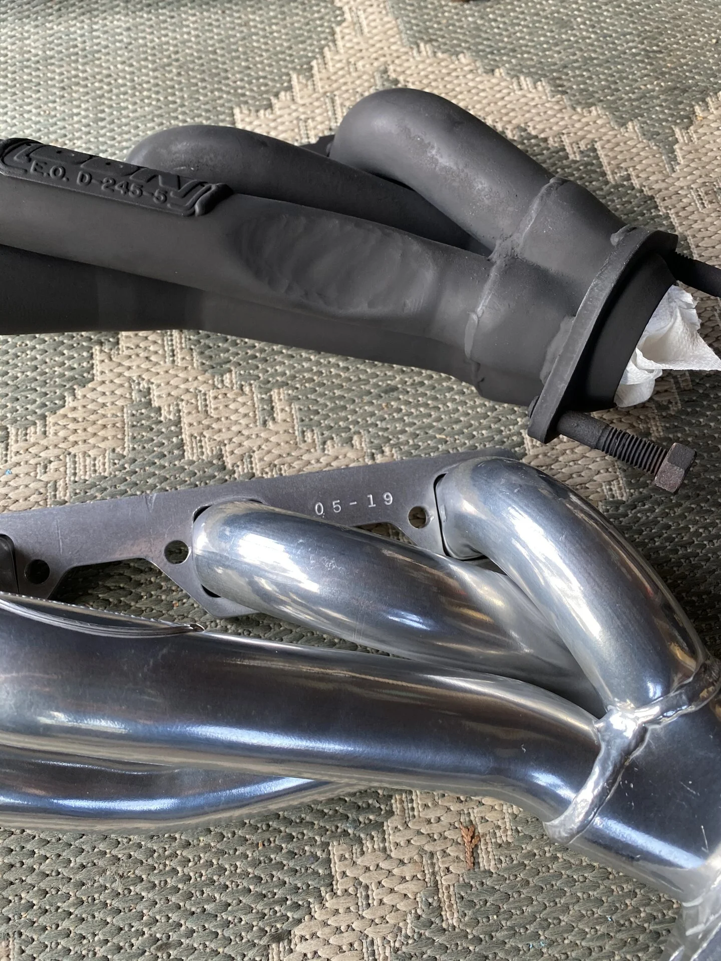

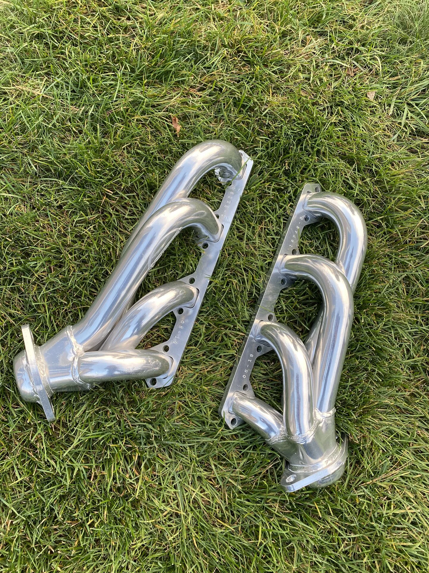

New engine goodies.
the 20 year old BBK headers had to go. These are ceramic coated, so should help with heat. The BBKs were just raw stainless.
Reactions: 7991LXnSHO, Monkeybutt2000, General karthief and 7 others

Mustang5L5 said:
New engine goodies.
You can't post that without also posting a picture of the old for comparison.
JBA is good stuff.
JBA is good stuff.
i will when I put them on the engine. I literally just unboxed them in that pic.
pretty engine pics incoming soon
Reactions: 02 281 GT

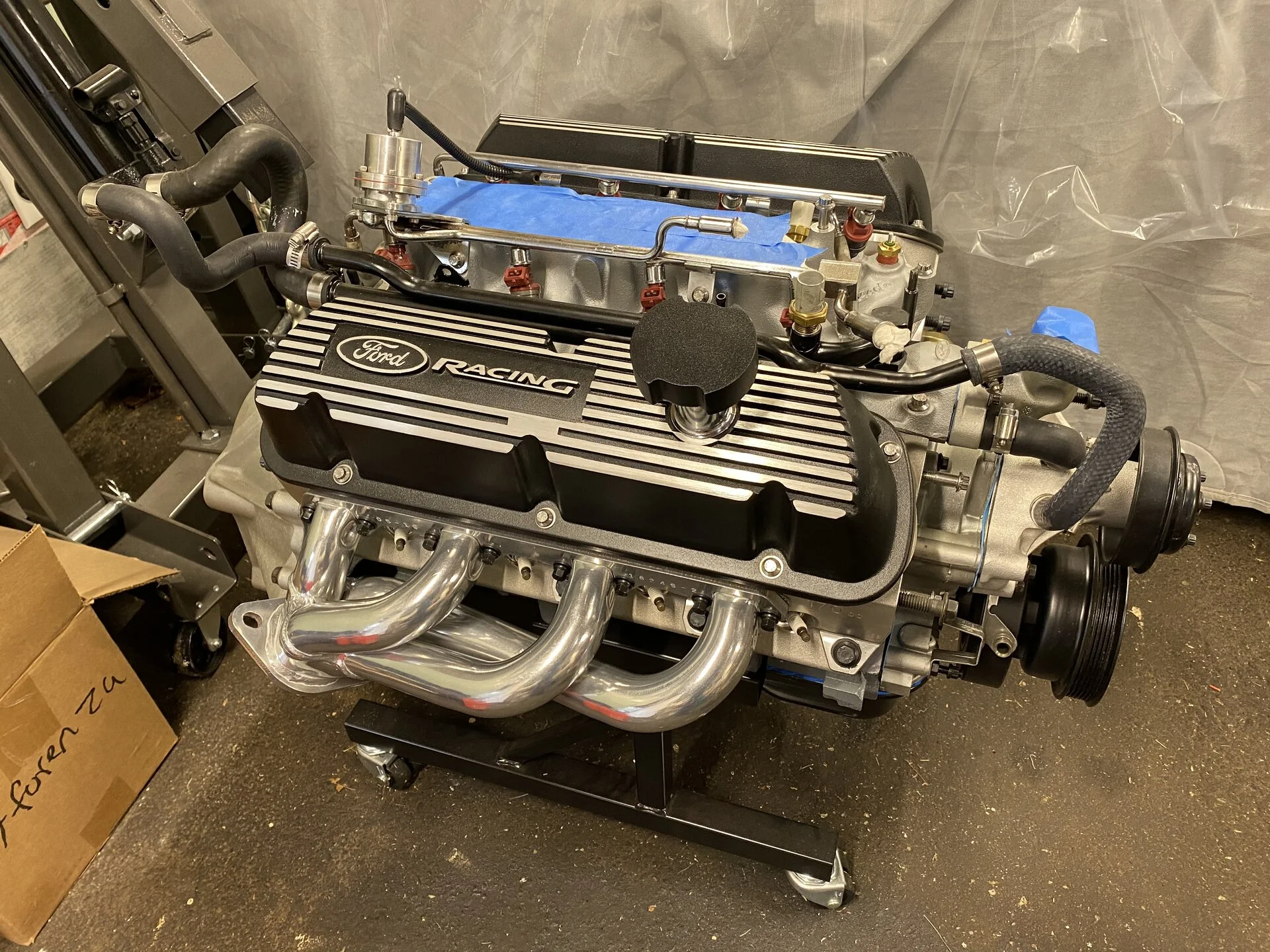

All you get for now

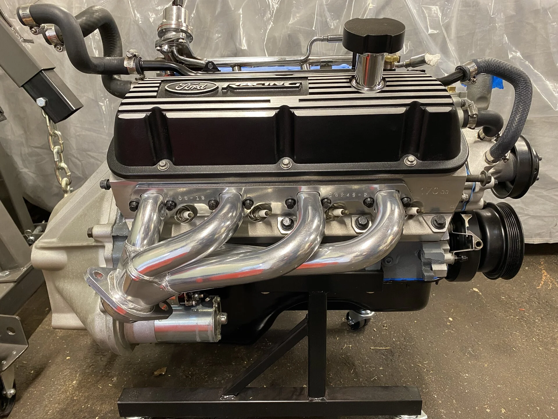

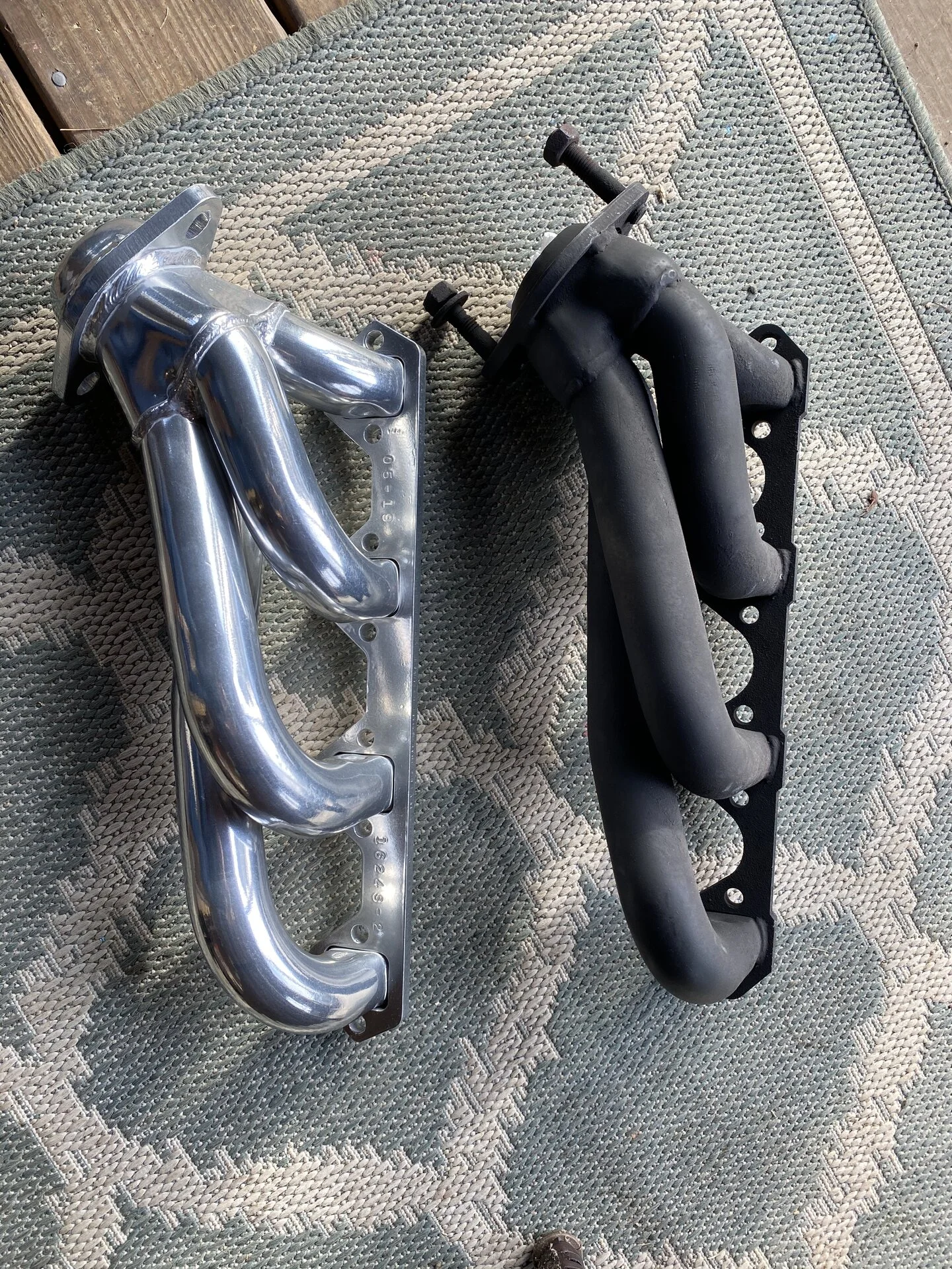

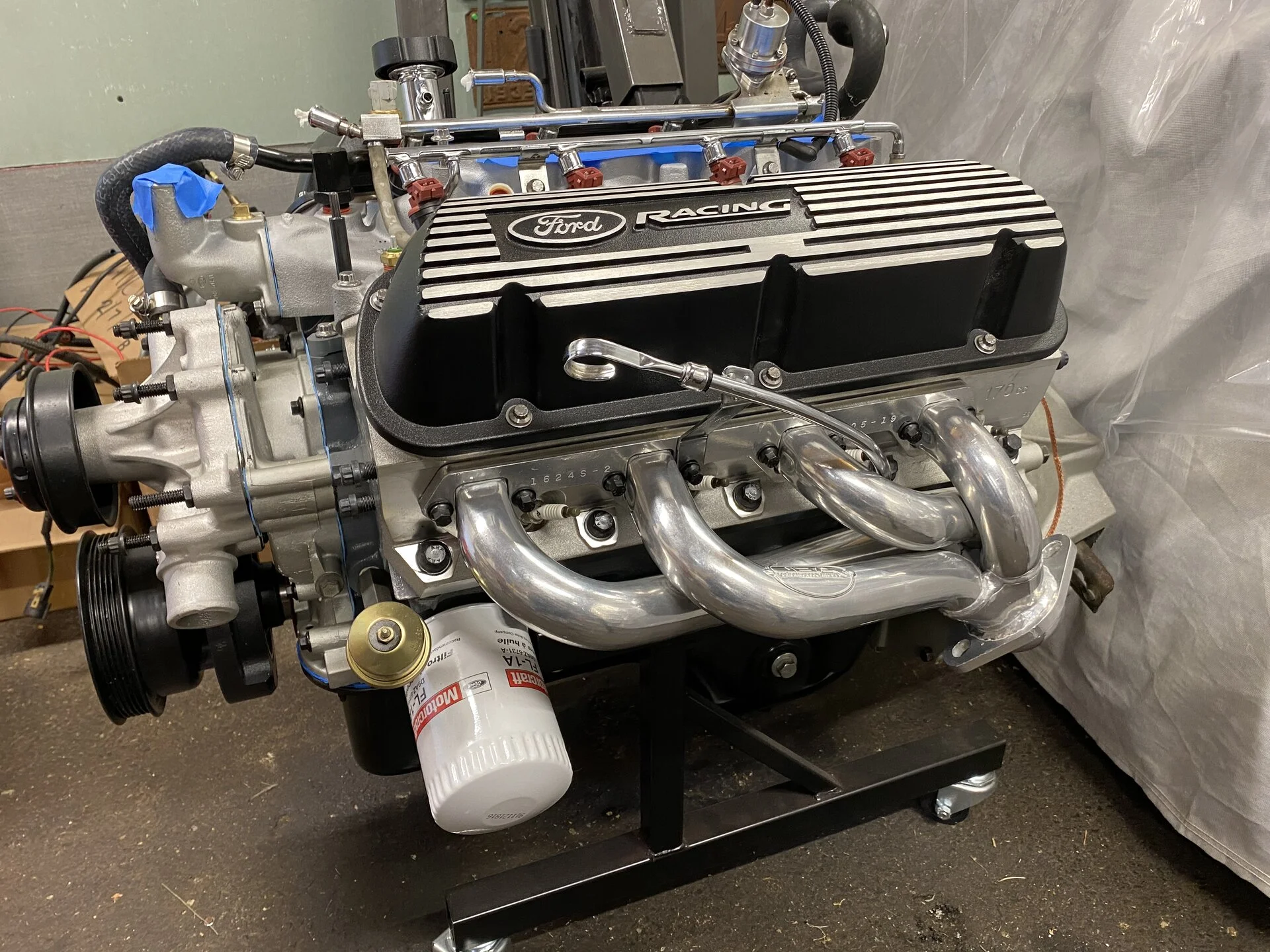

Swapped the headers. I’m gonna get some stage 8 locking bolts, so I didn’t snug these up.
Hopefully I don’t need to dimple these to clear the mm steering shaft like I did the bbk

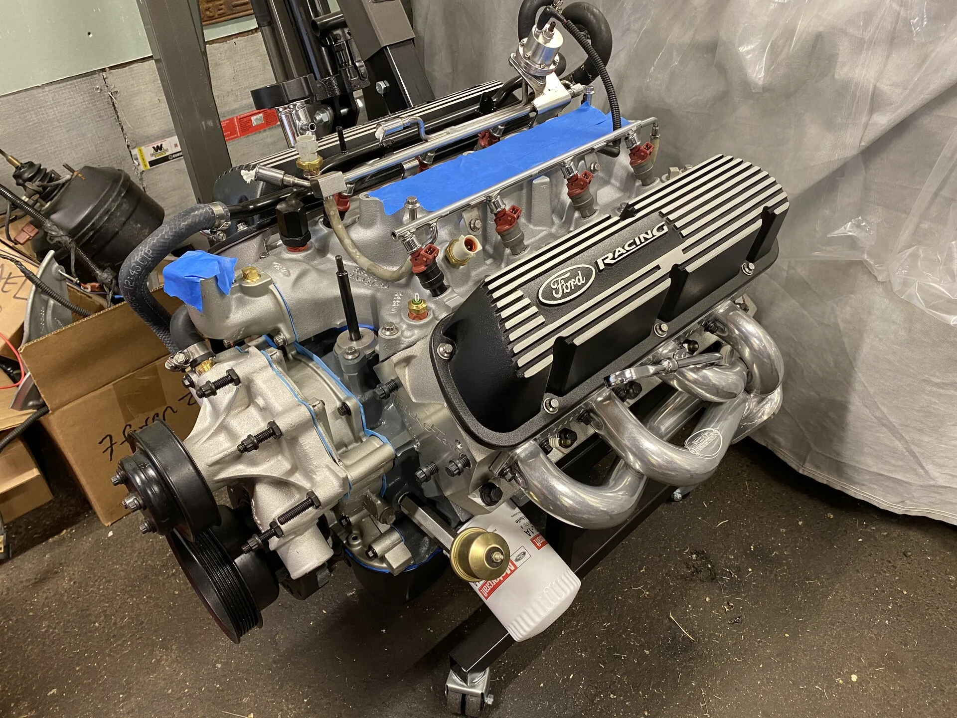

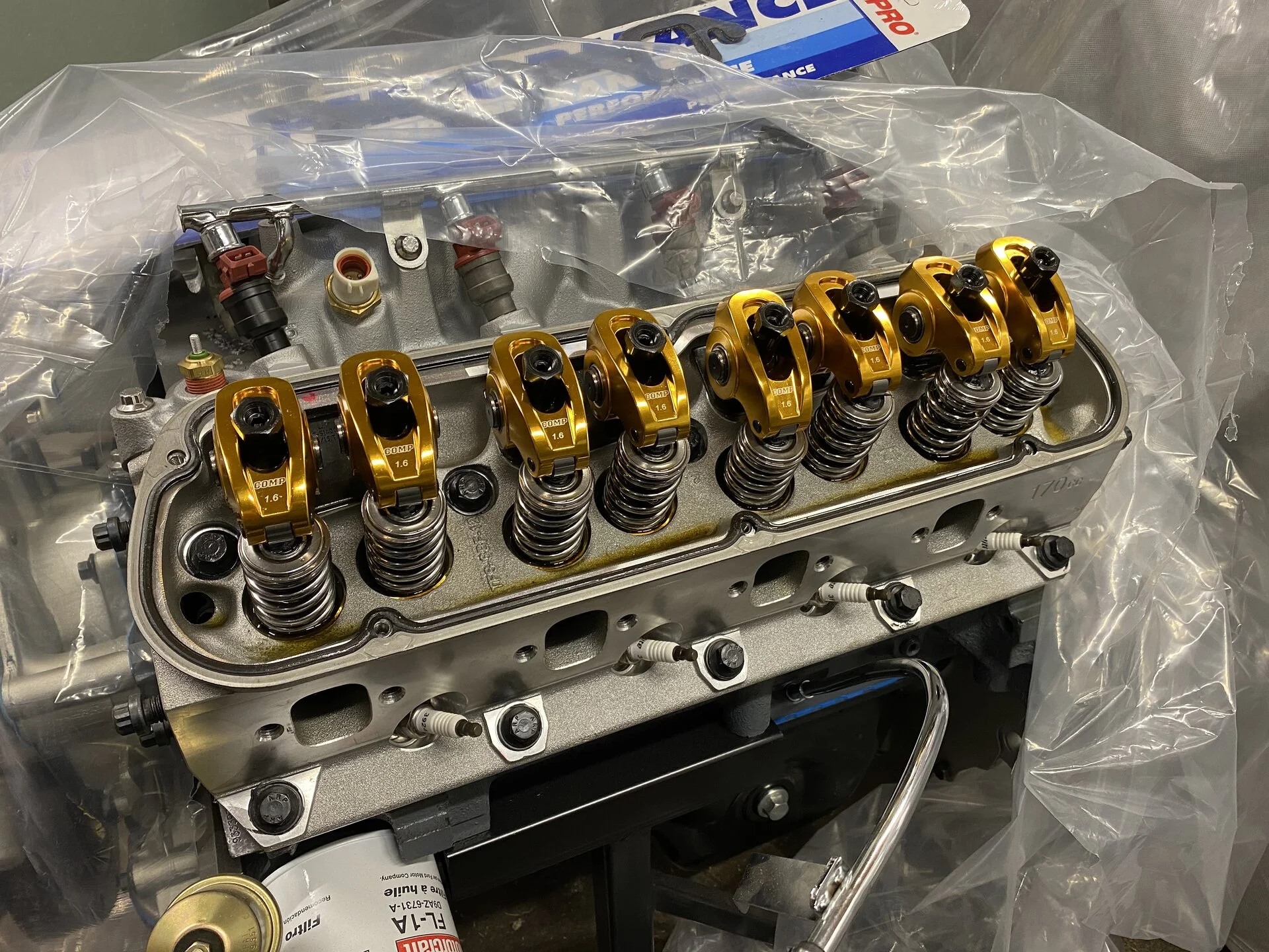

Hopefully this bag-o-engine isn’t sitting in the corner for much longer
Reactions: Wayne Waldrep, Habu135, Flatfoot and 11 others

That is a good looking engine. The headers feel at home.
Reactions: Mustang5L5

Yep, thats one good looking engine. That'll be right at home in a black car Mike.
I replaced the original Ford exhaust manifolds on my ‘86 with Bassani equal-length ceramic-coated shorties. Every tube of the old Ford exhaust manifolds had holes in them.

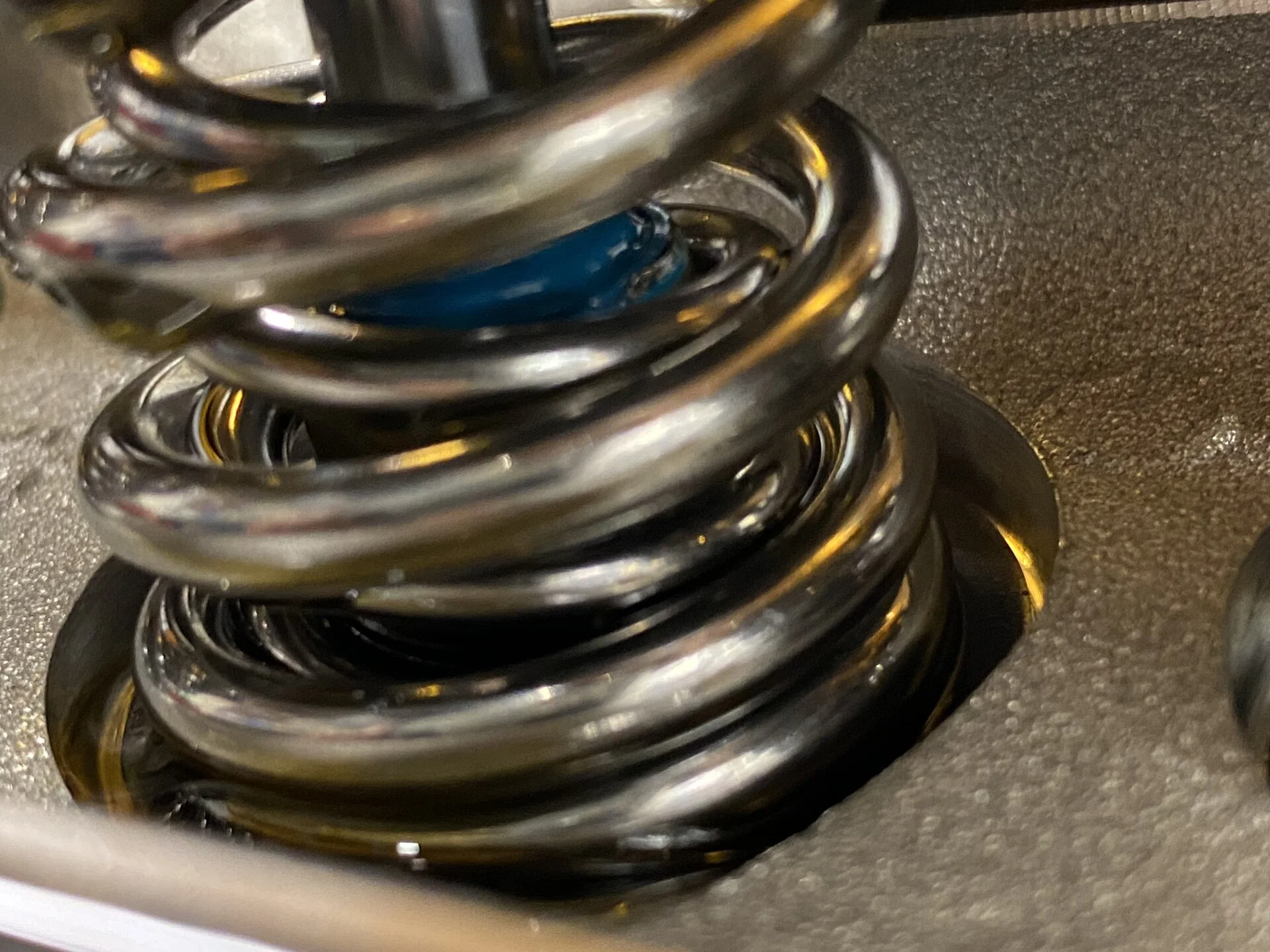

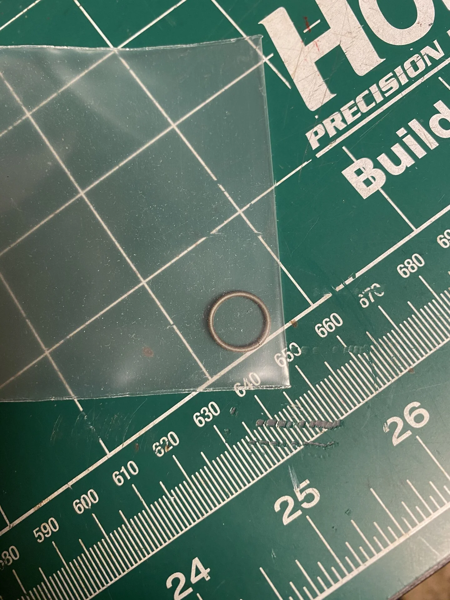

Cleaned the garage a bit. Found this guy. Hmmm.....
pop a valve cover
Dammit

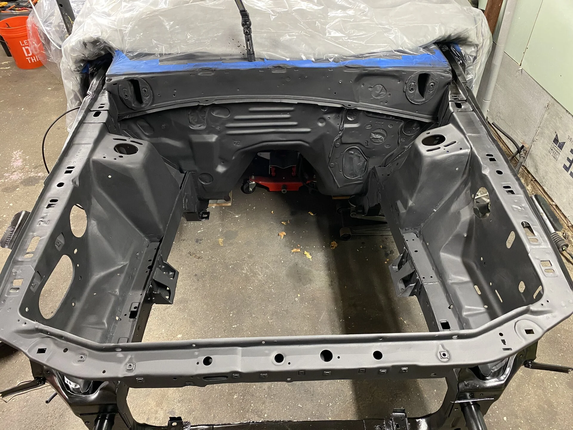

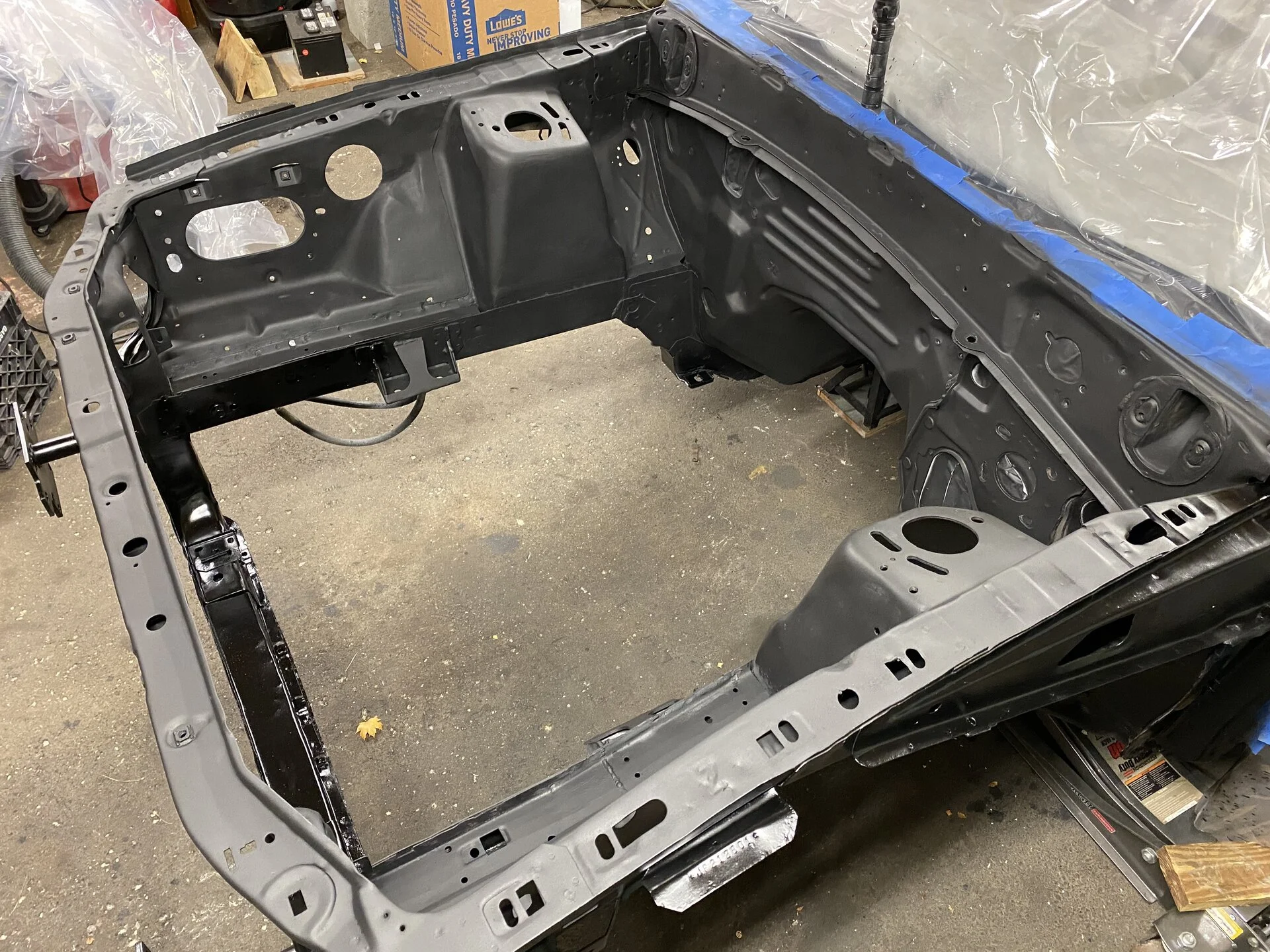

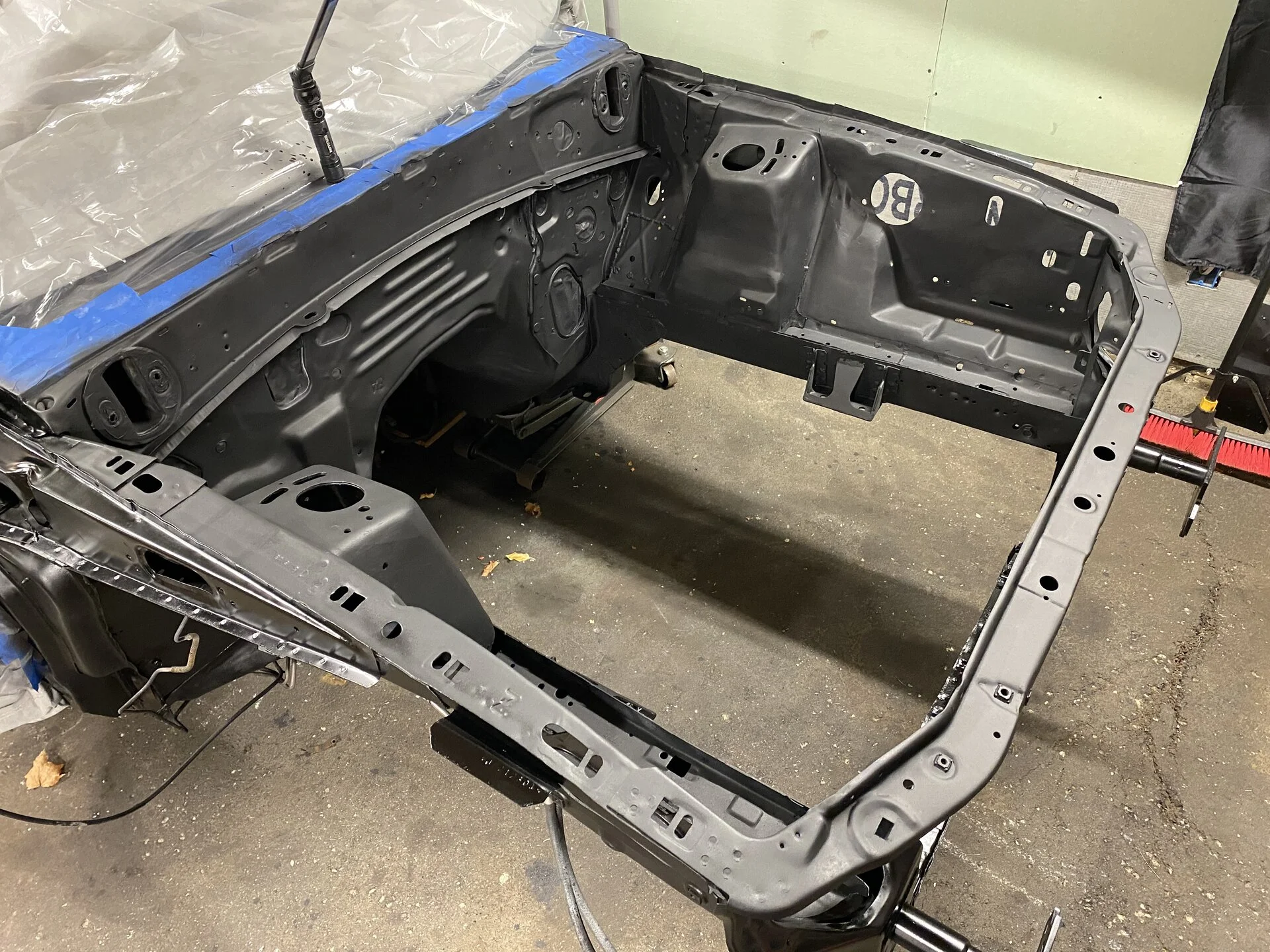

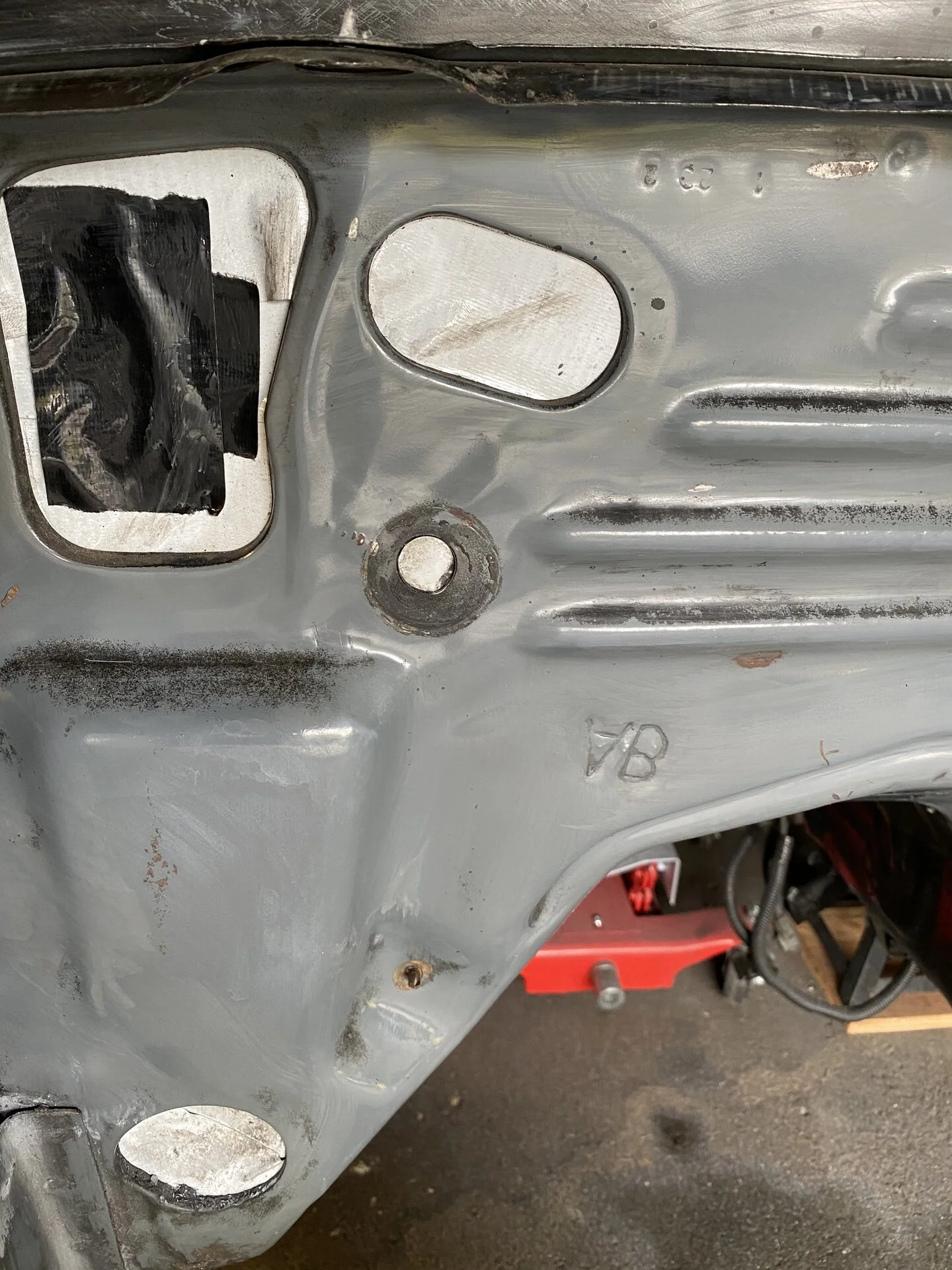

Ok, I by no means no what I’m doing when it comes to painting. Never did much of it, but I’m willing to try things out. This is probably the most prep and attention to detail I’ve ever spent painting anything.
needless to say, after hours of prep, buying Supplies and odds and ends, hours of research, and sanding and sanding filler, I found myself against the clock in terms of weather. Last weekend of 70s really. About to get cold.
so I said screw it. I may not have done every step properly, but dammit I did it the best that I could manage with what I had available. Not a show car by any means, but so far so good.
sitting in primer tonight, and the partial engine bay hole filling didn’t turn out too bad. Not perfect, but the engine and related hardware should hide most of what isn’t completely smooth. I’m happy so far.
Reactions: Willybill32, Boostedpimp, Gearbanger67 and 7 others
