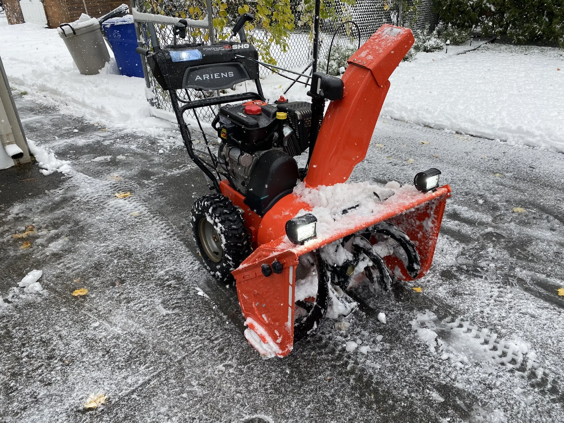

Do I let it melt, or bust out the big beast Snowblower?

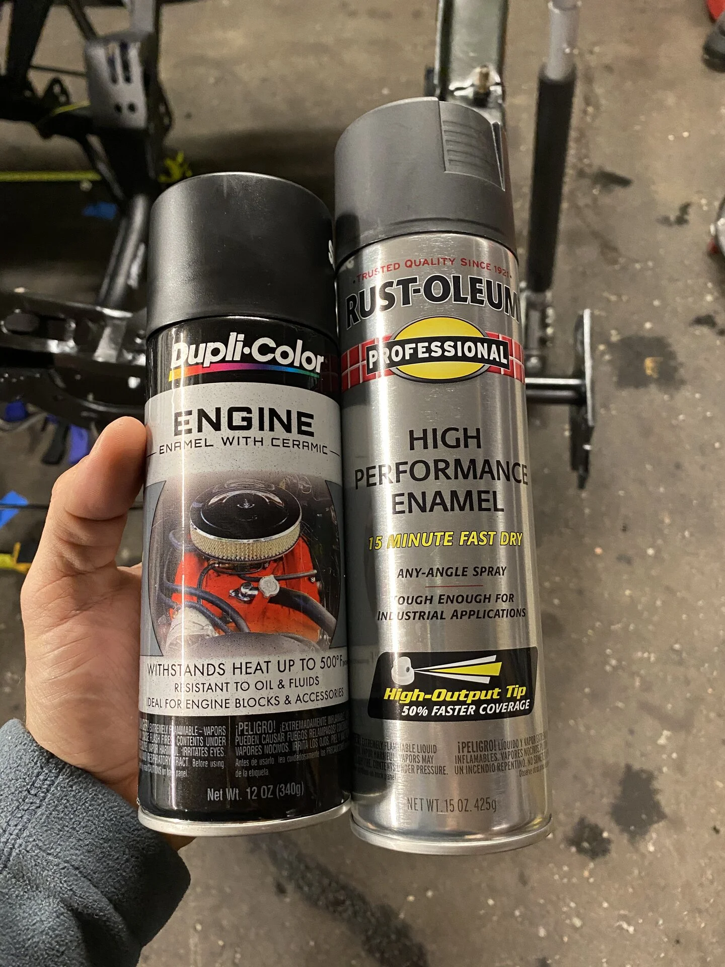

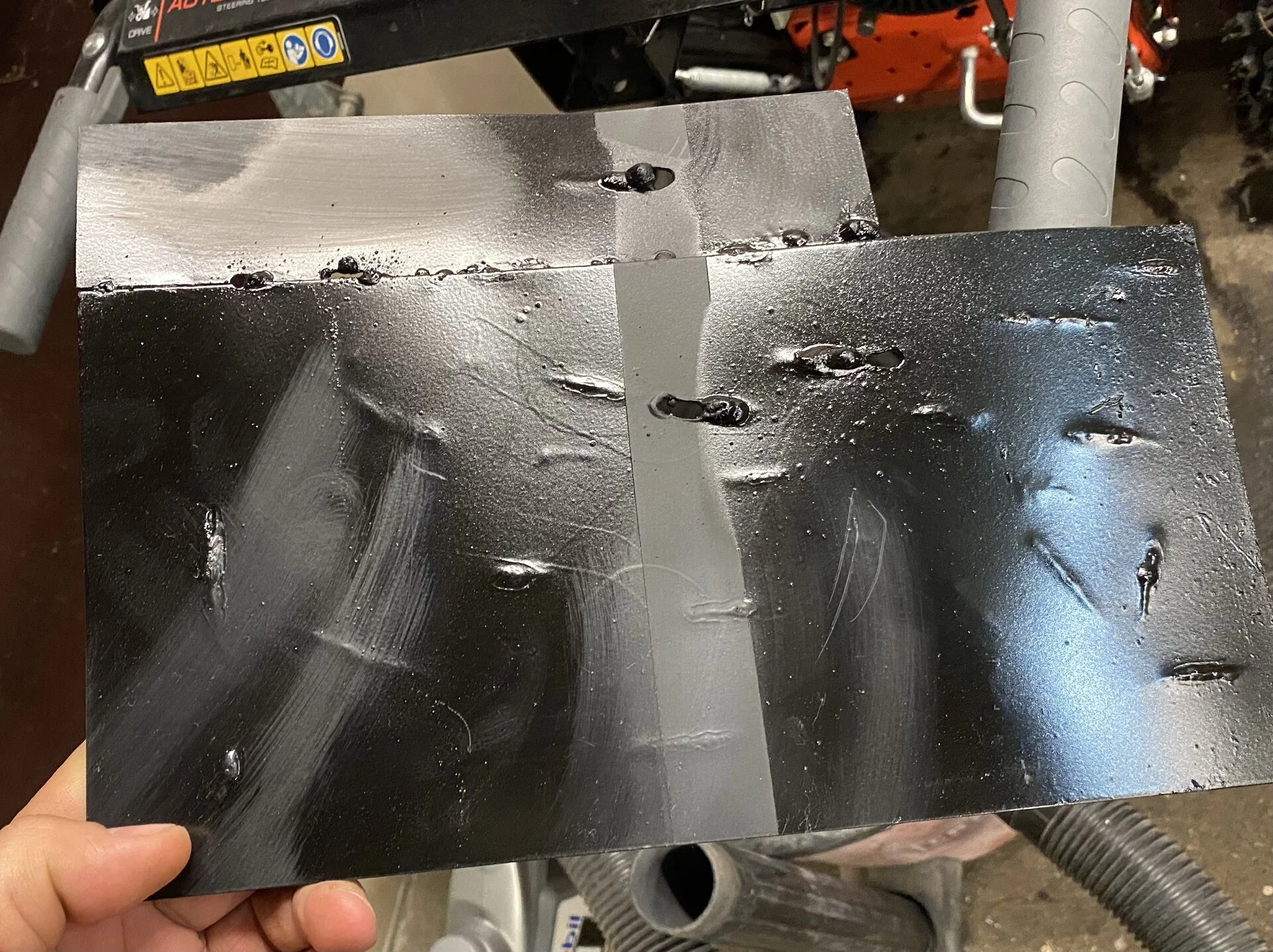

What kind of paint do you use for small parts....I use Rustoleum and it separates all the time.

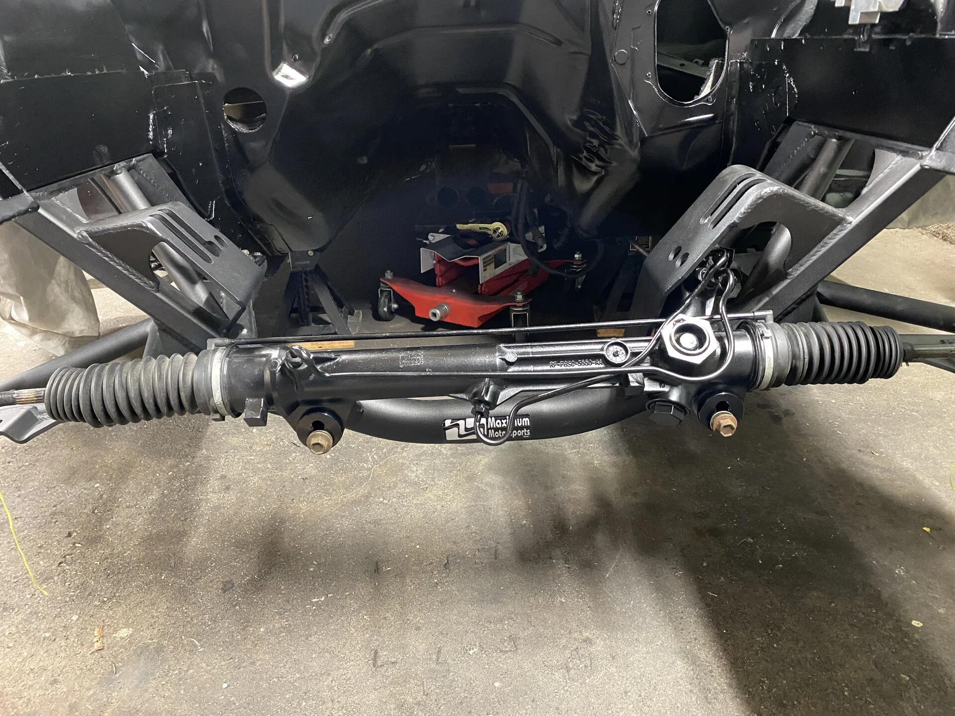

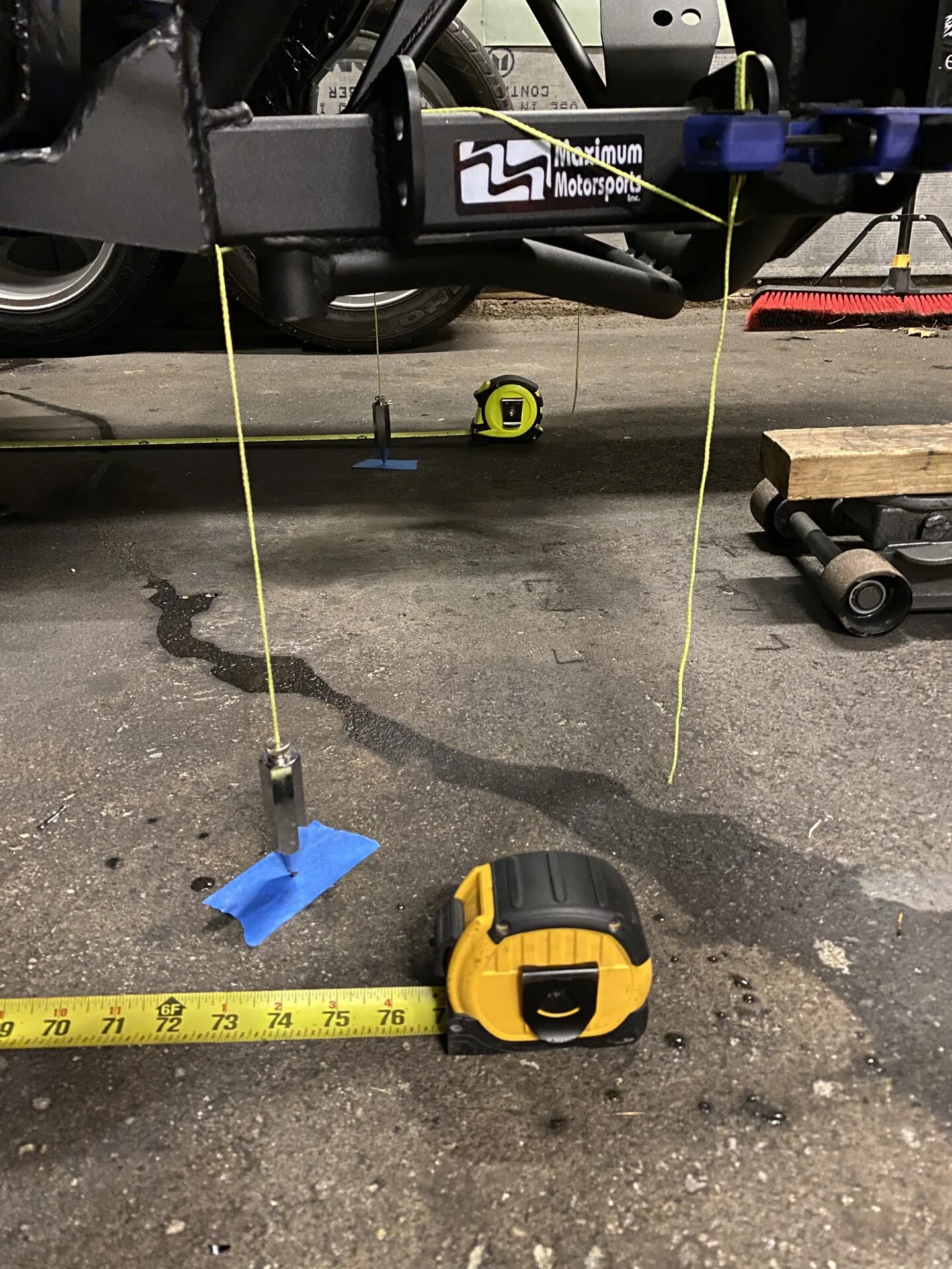

You'll need to position the jack stands on the frame rails 10-12'' behind the core support,this will give you all the room you need to work.If you don't have tall enough jack stands you'll have to block them up higher to reach the rails.I believe MM shows this in their install instructions.

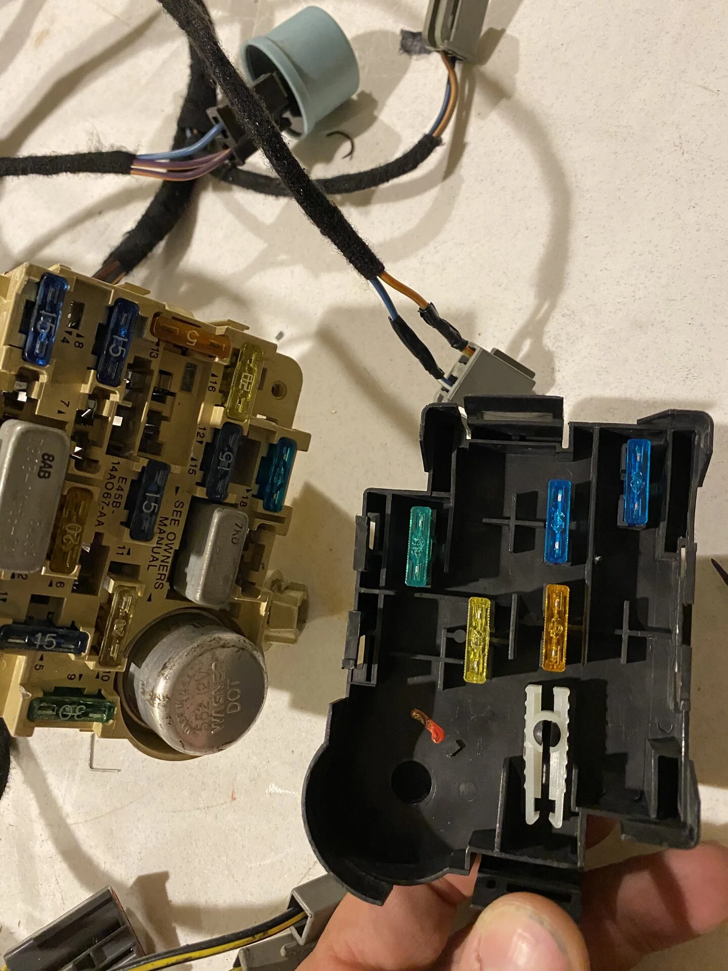

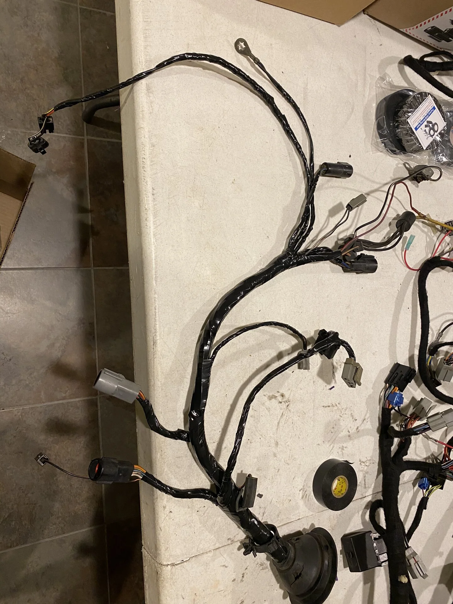

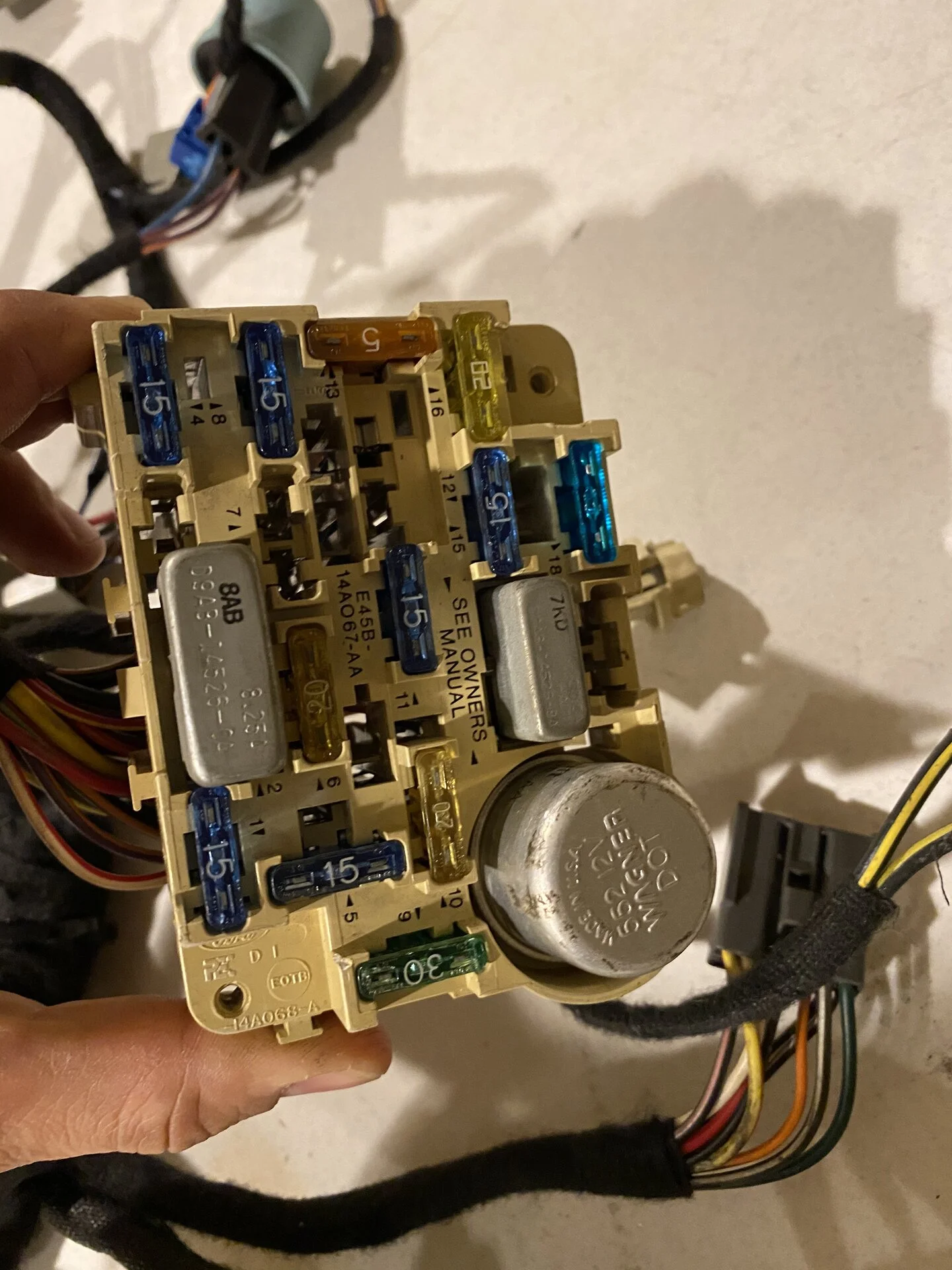

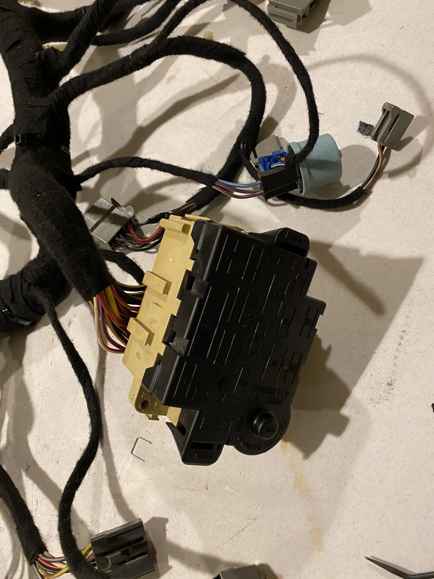

Wait! You can put spare fuses there? My life just improved by 20%.Harness all wrapped up.

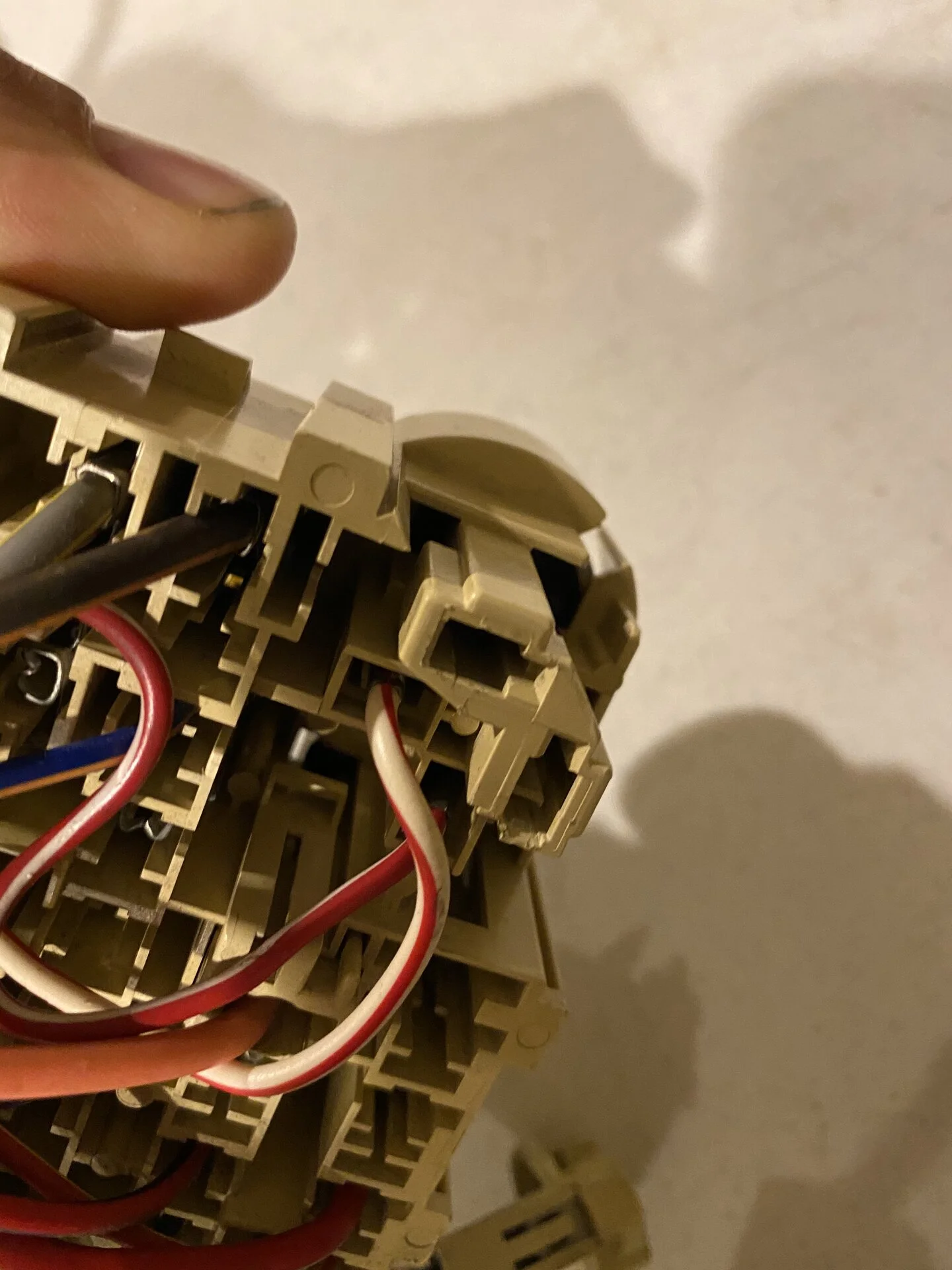

Ford stuck the hazard flasher on the backside of the fuse block in the 87-89 cars. Since I swapped to a 90 dash, been meaning to mount the fuse block correctly. So I bought the 90-93 mounting frame on eBay. I reversed the pins on the hazard rekay to flip it around to the correct side
also picked up a 91-93 fuse box cover. Fits right in with spare fuses too.![]()
