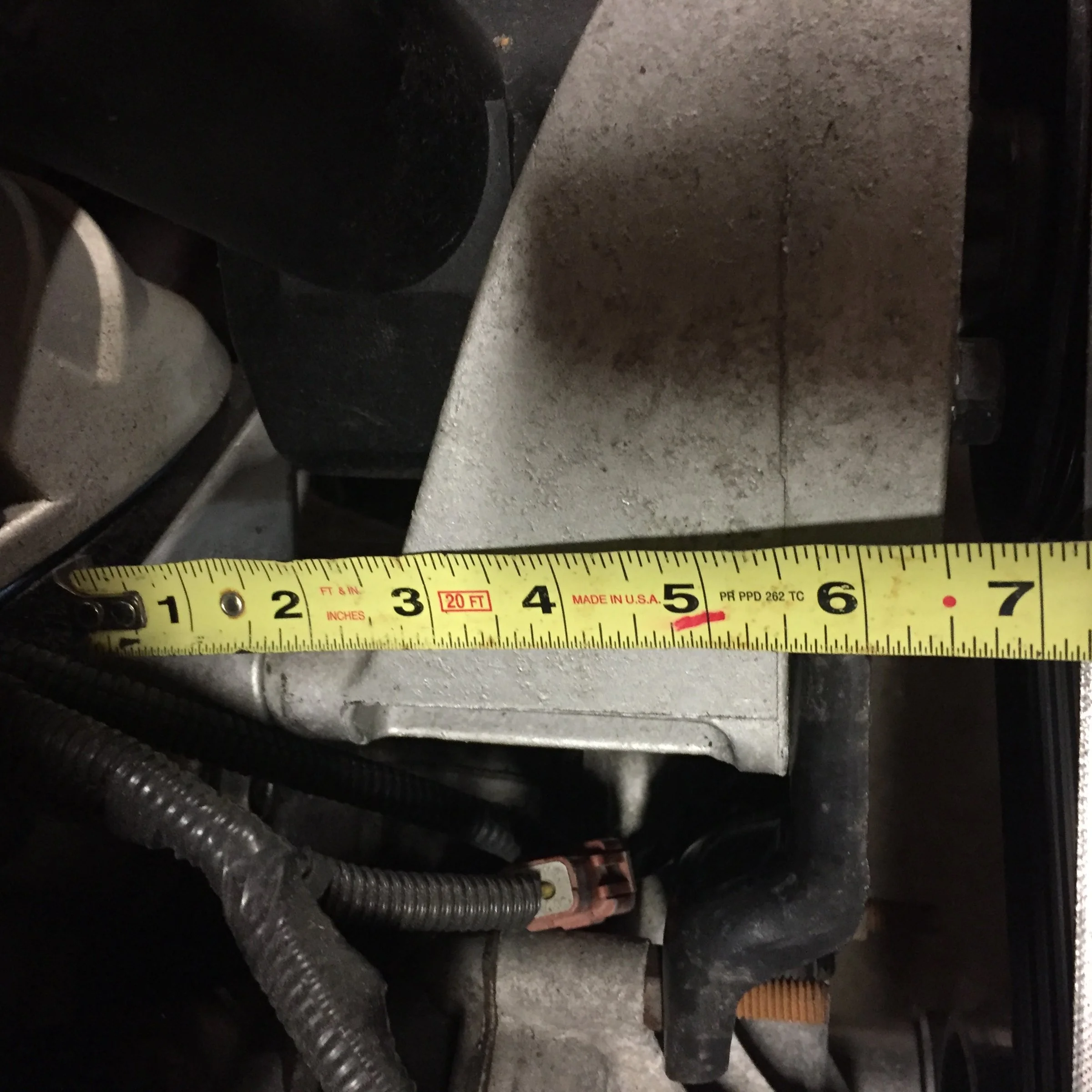

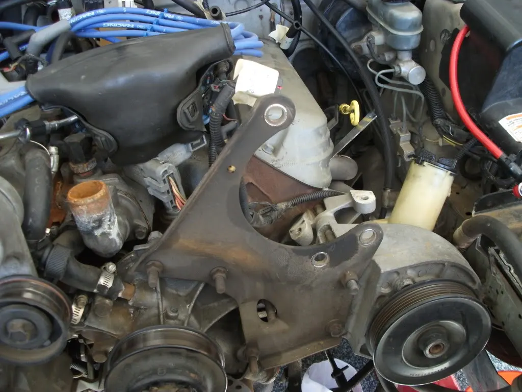

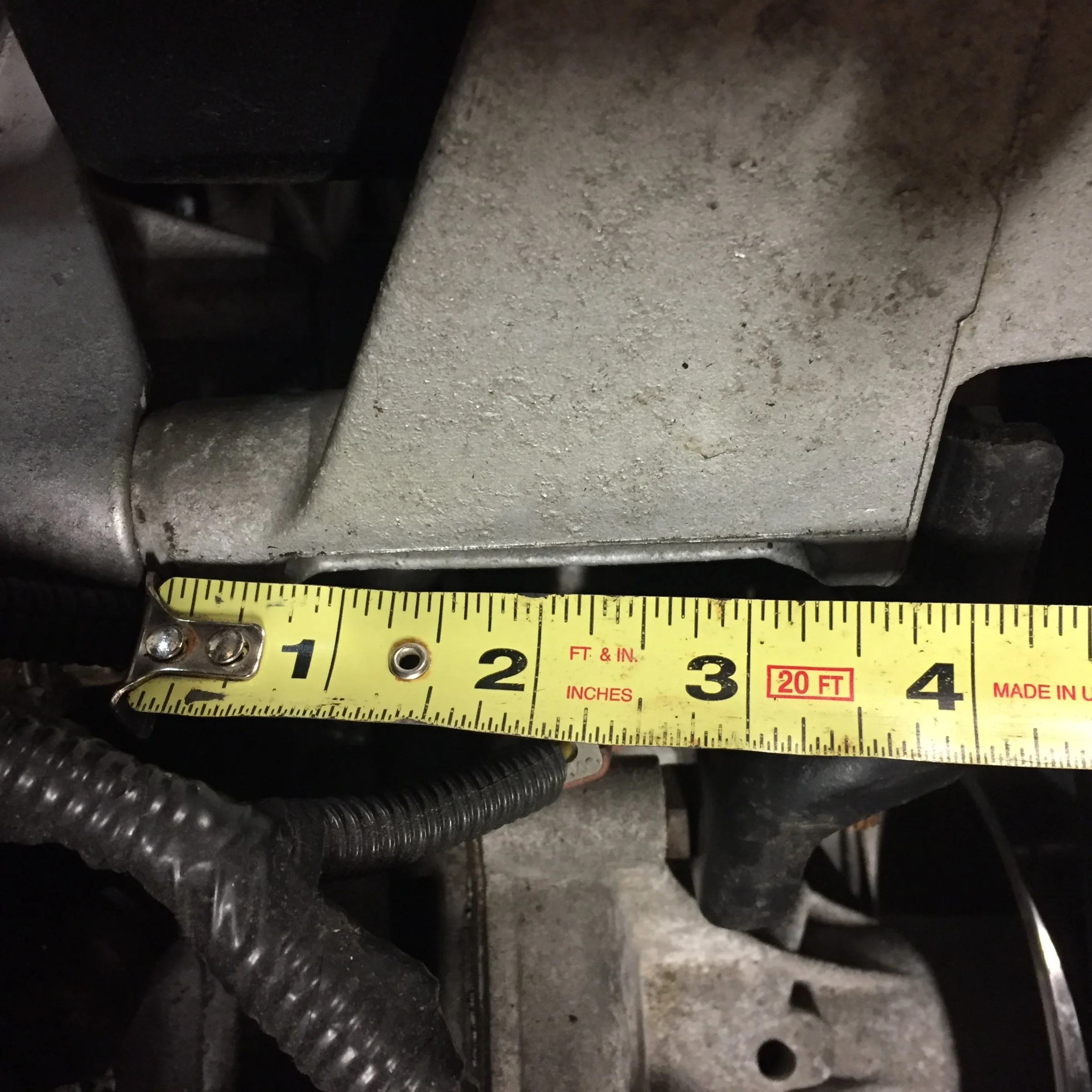

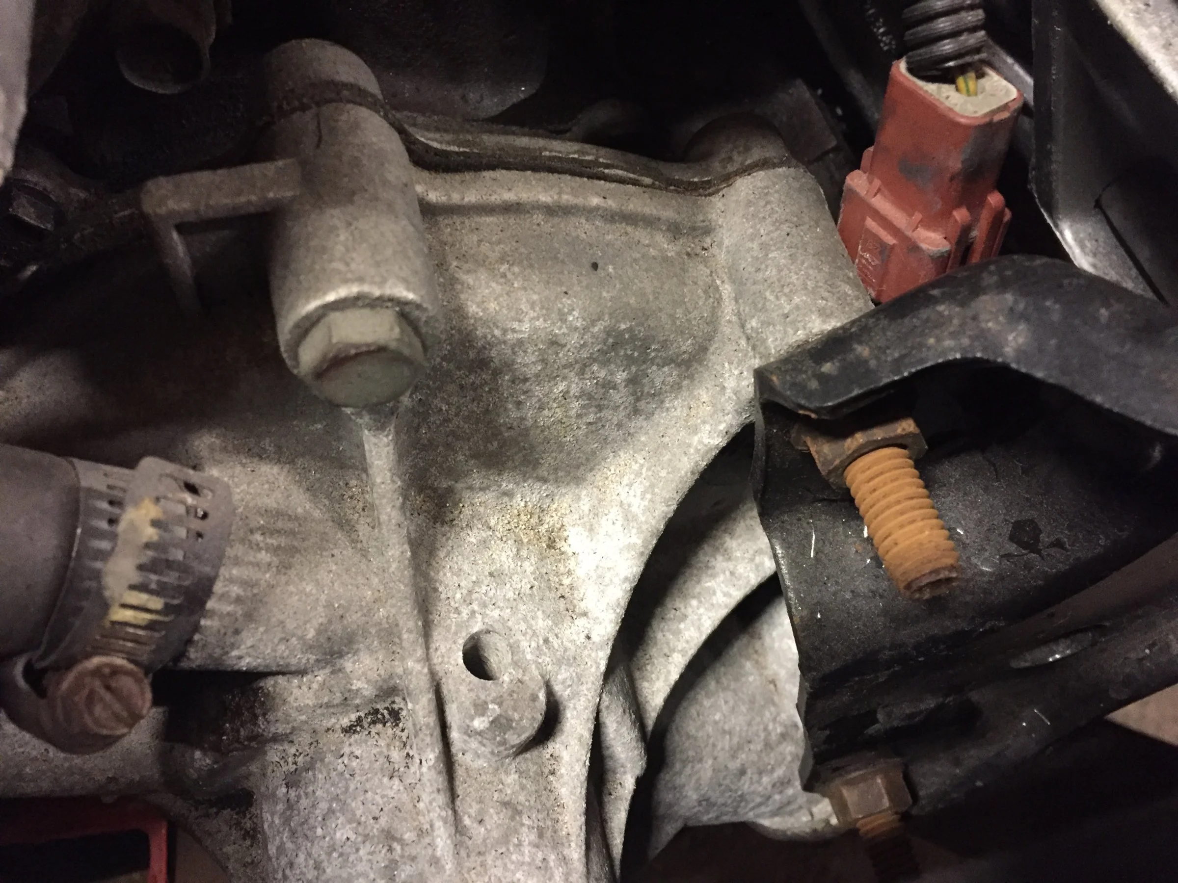

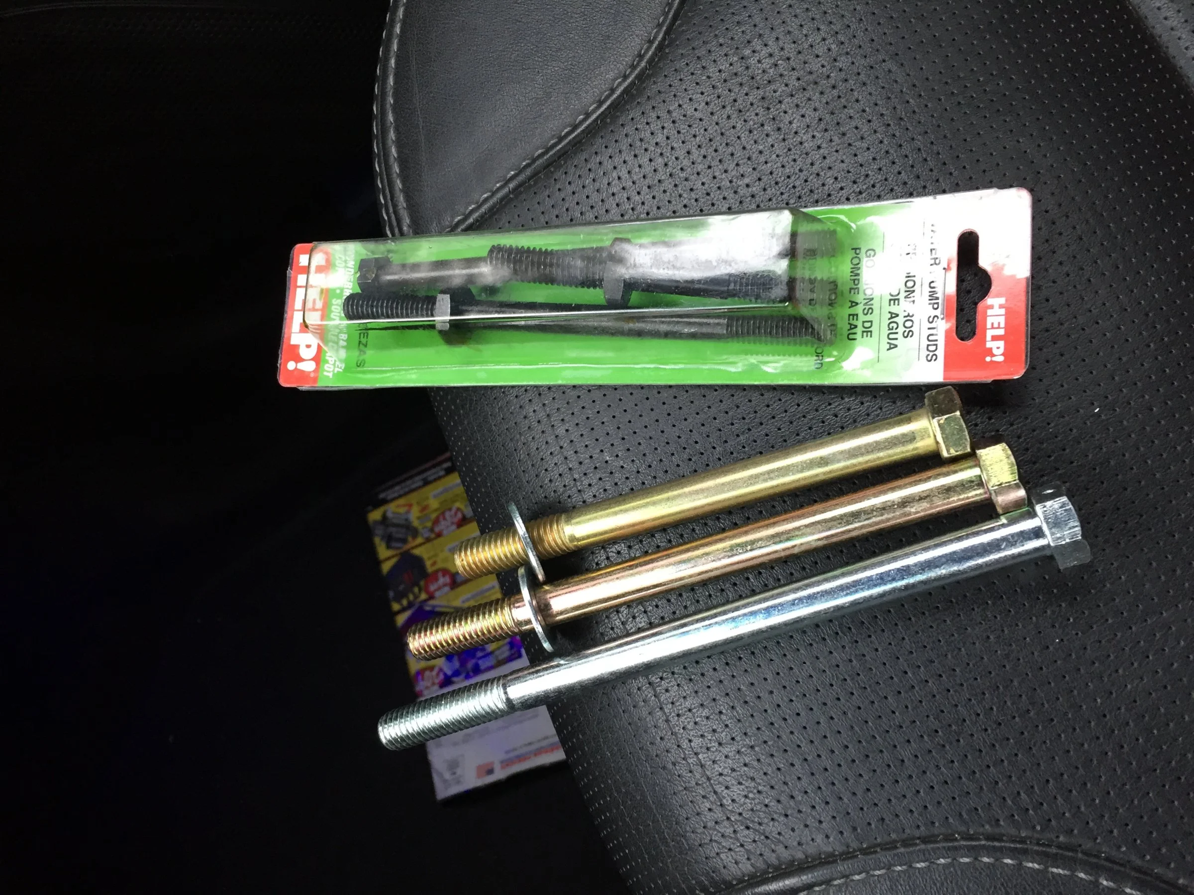

Ok. Did some measuring. I think a 6.25-6.5" bolt with 7/16" thread will replace the stud. Looks about 5.5" from bolt head to the face of the cylinder head. Add a 1/4" for the front stamped bracket, and 1/2" into the head
Pretty sure I can reuse the bottom bolt, but since I want to eBay the delete kit, I'll pick another bolt up.
Looks like top of pS bracket is 4" and bottom 3.5".
So 5" bolt prob ok here since I can thread through the inner ac bracket. I can prob pick these up, in grade 8, at local hardware store.
However, just realized I replaced one WP bolt with a normal bolt. The compressor bracket does bolt to this bolt. Should I let this go? Or find the correct bolt?
This is how it will bolt up with ac

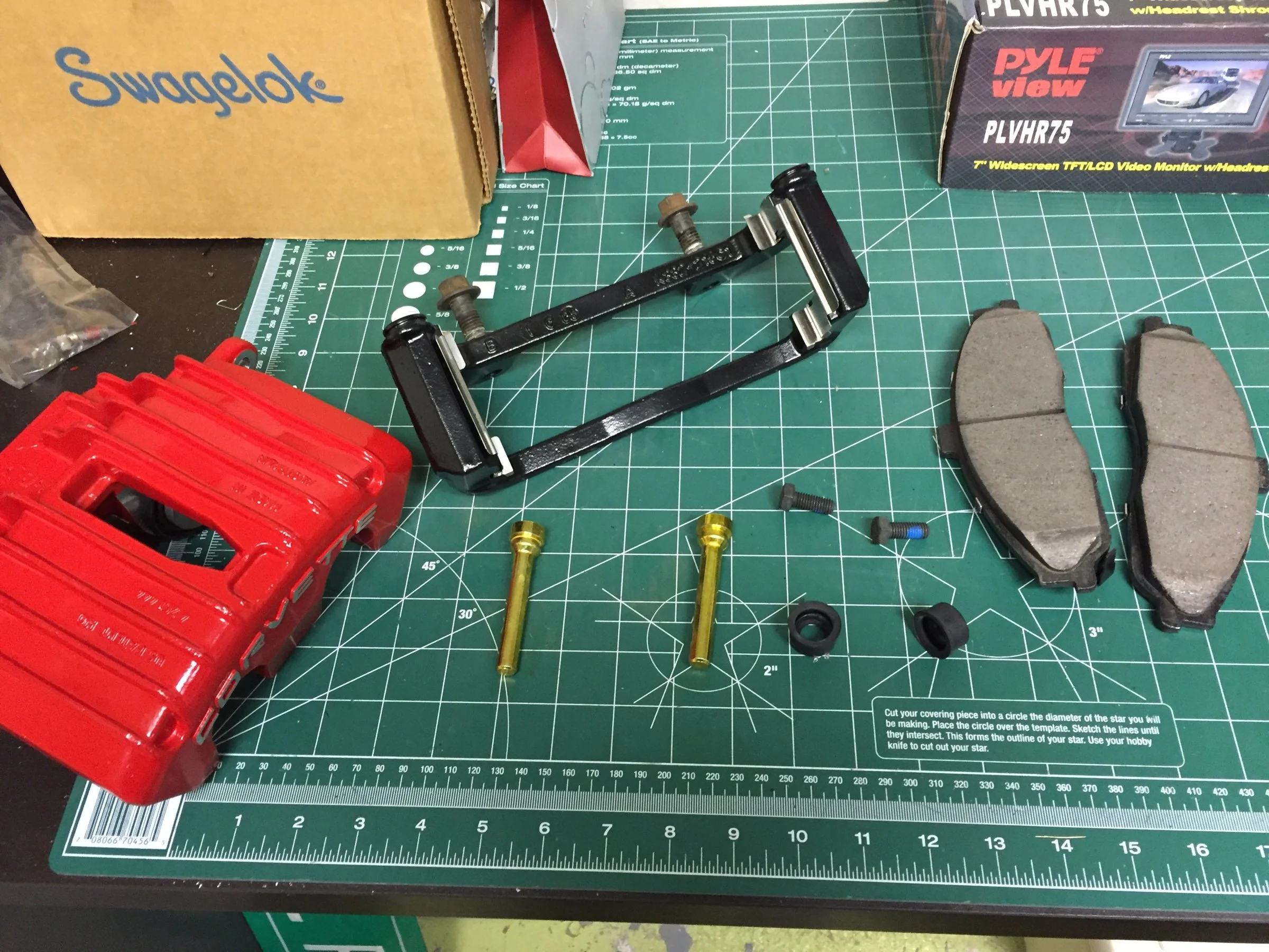

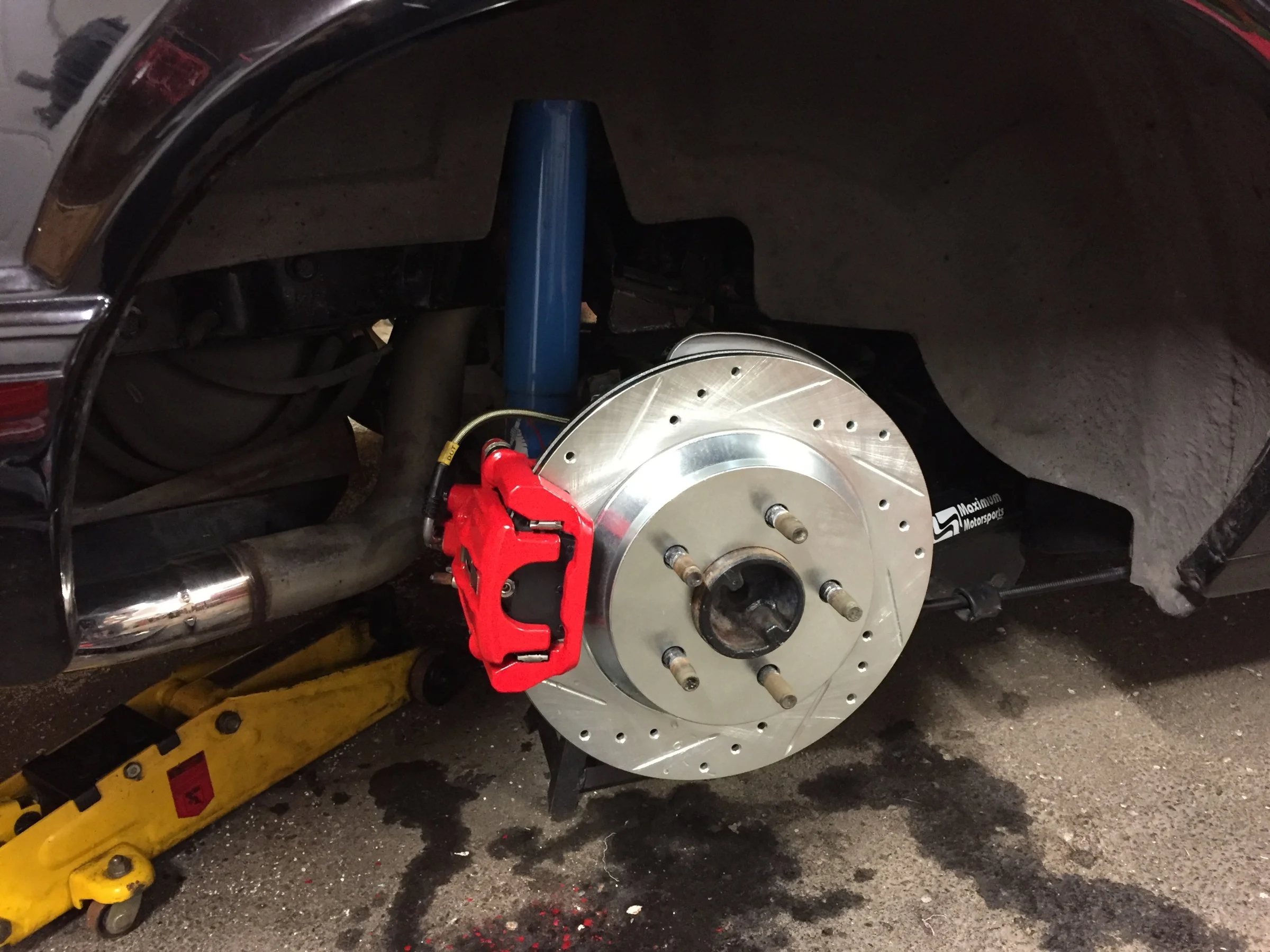

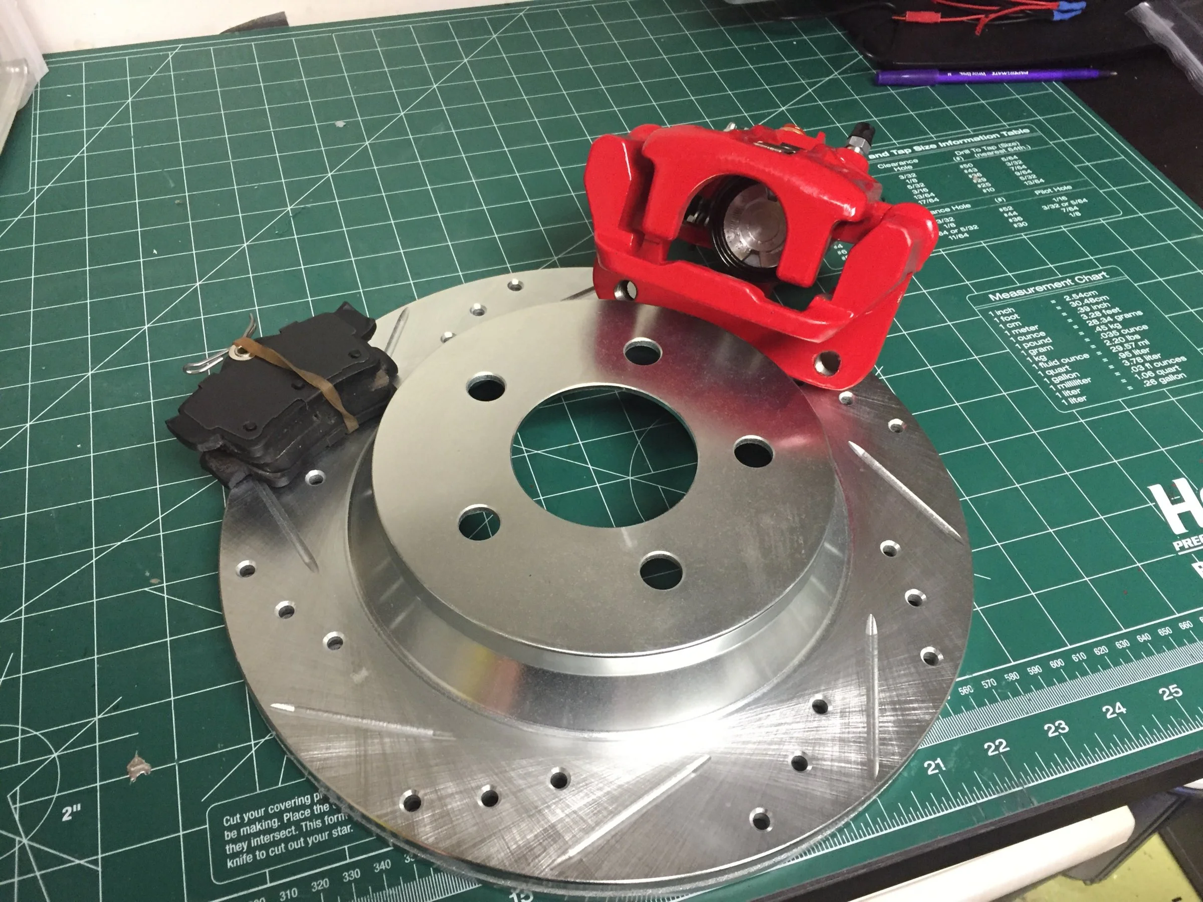

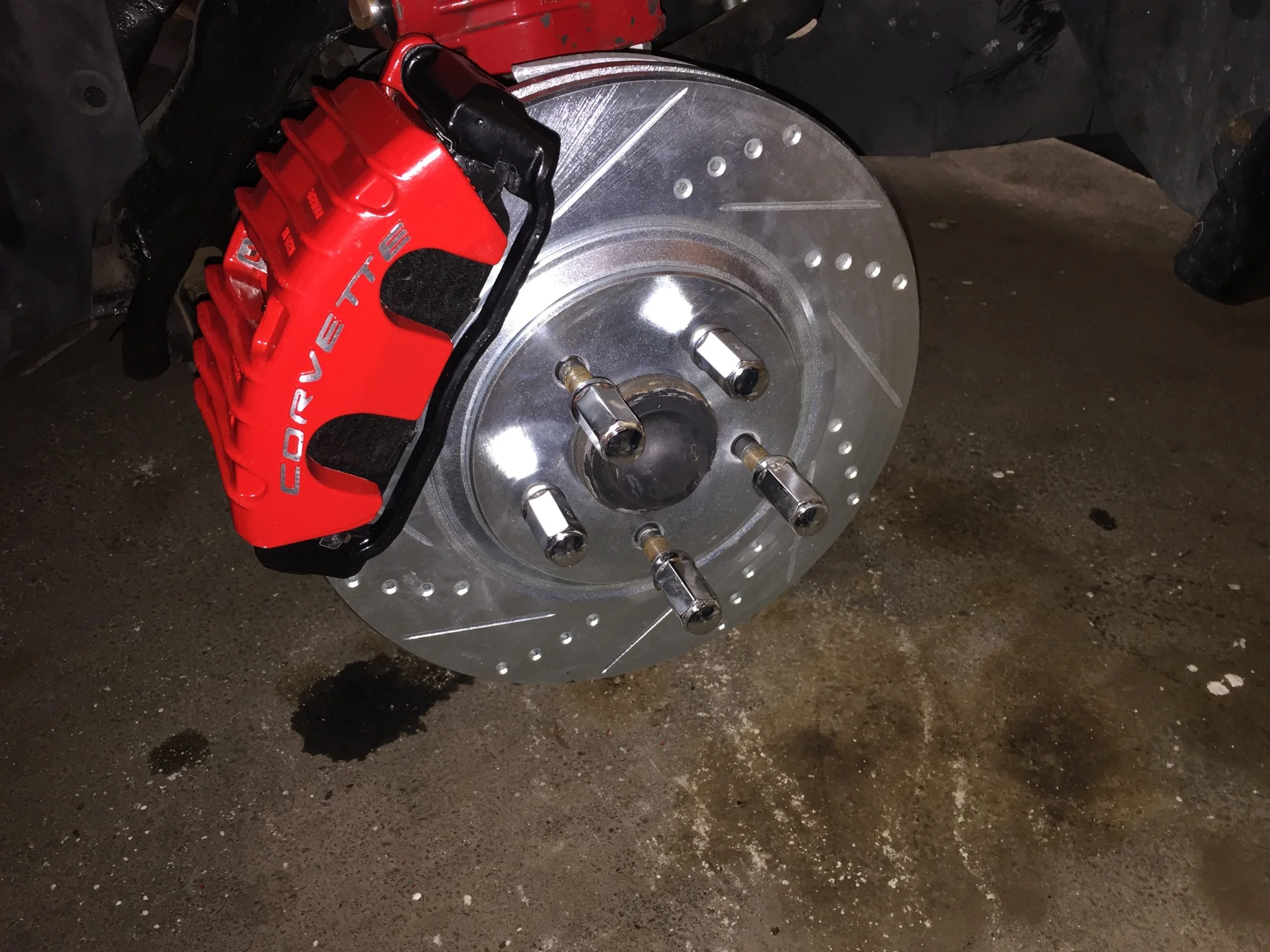

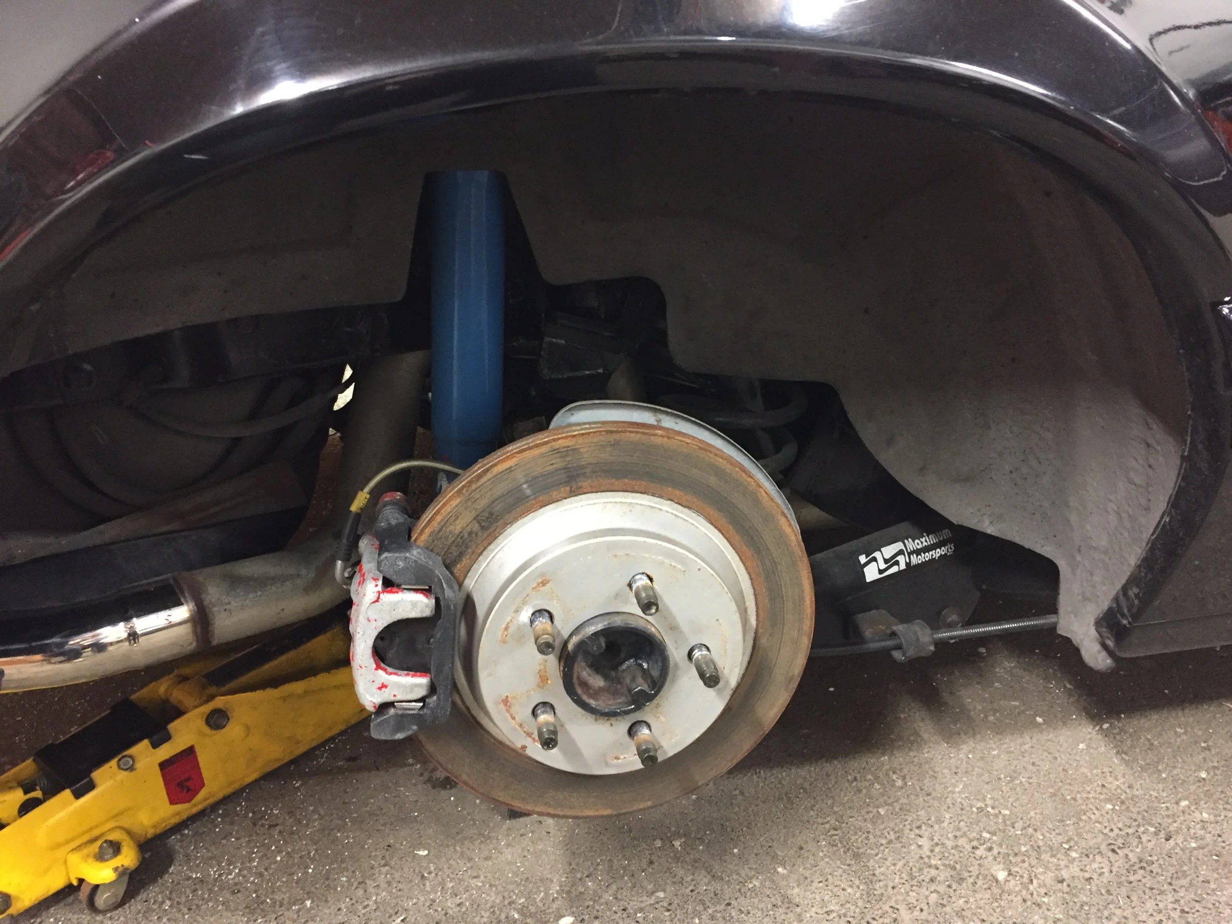

Got the rest of my caliper parts.
20 min later
Terrible pic, but you get the idea
One more corner to do... but I think I'm gonna try to get the ac compressor back on first.

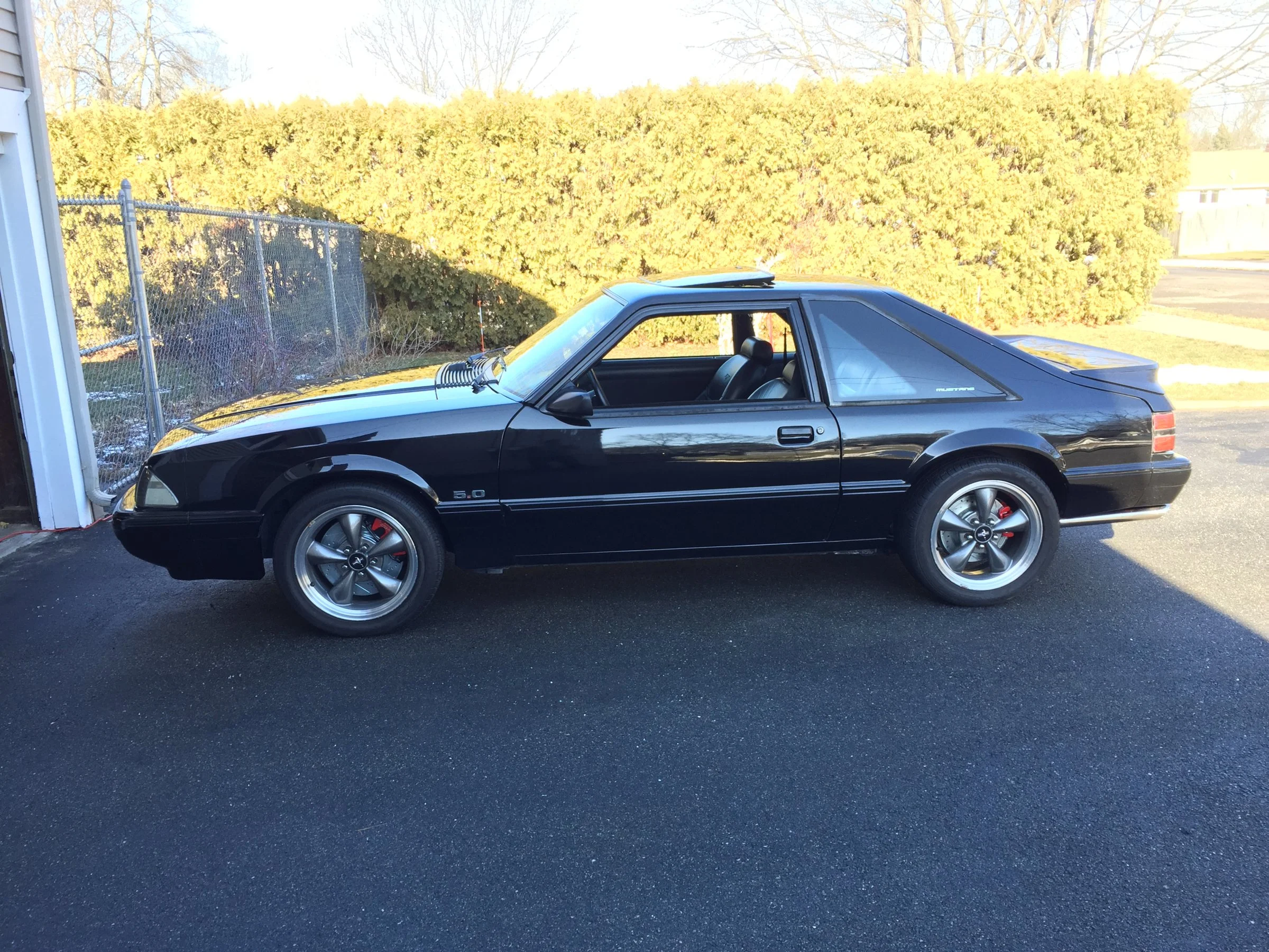

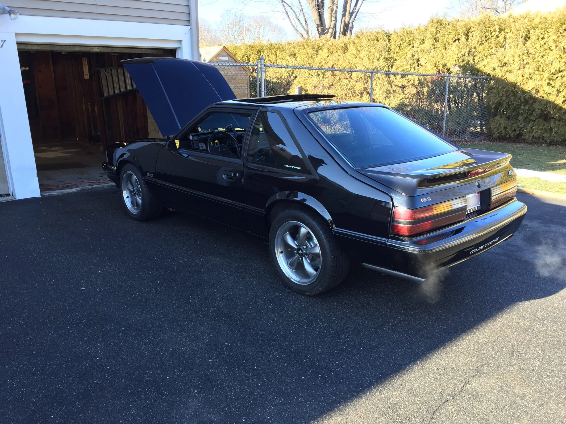

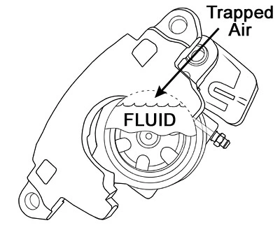

Took advantage of nice Dec day to back car out and clean it up a tad. First thing I notice is I have no brake pedal. Looks like trapped air. Oh well, got a few months to address that.
Daily driver needs a bath. But no point roads are salty

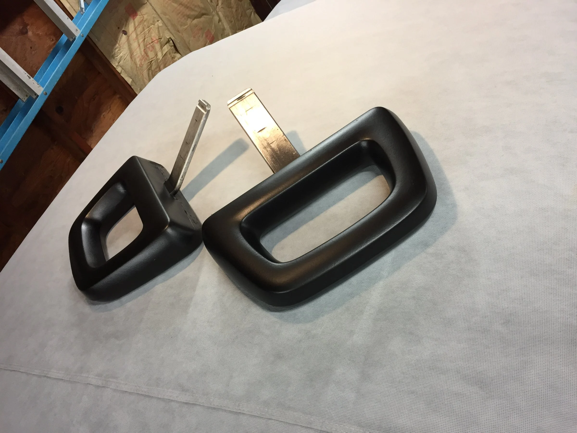

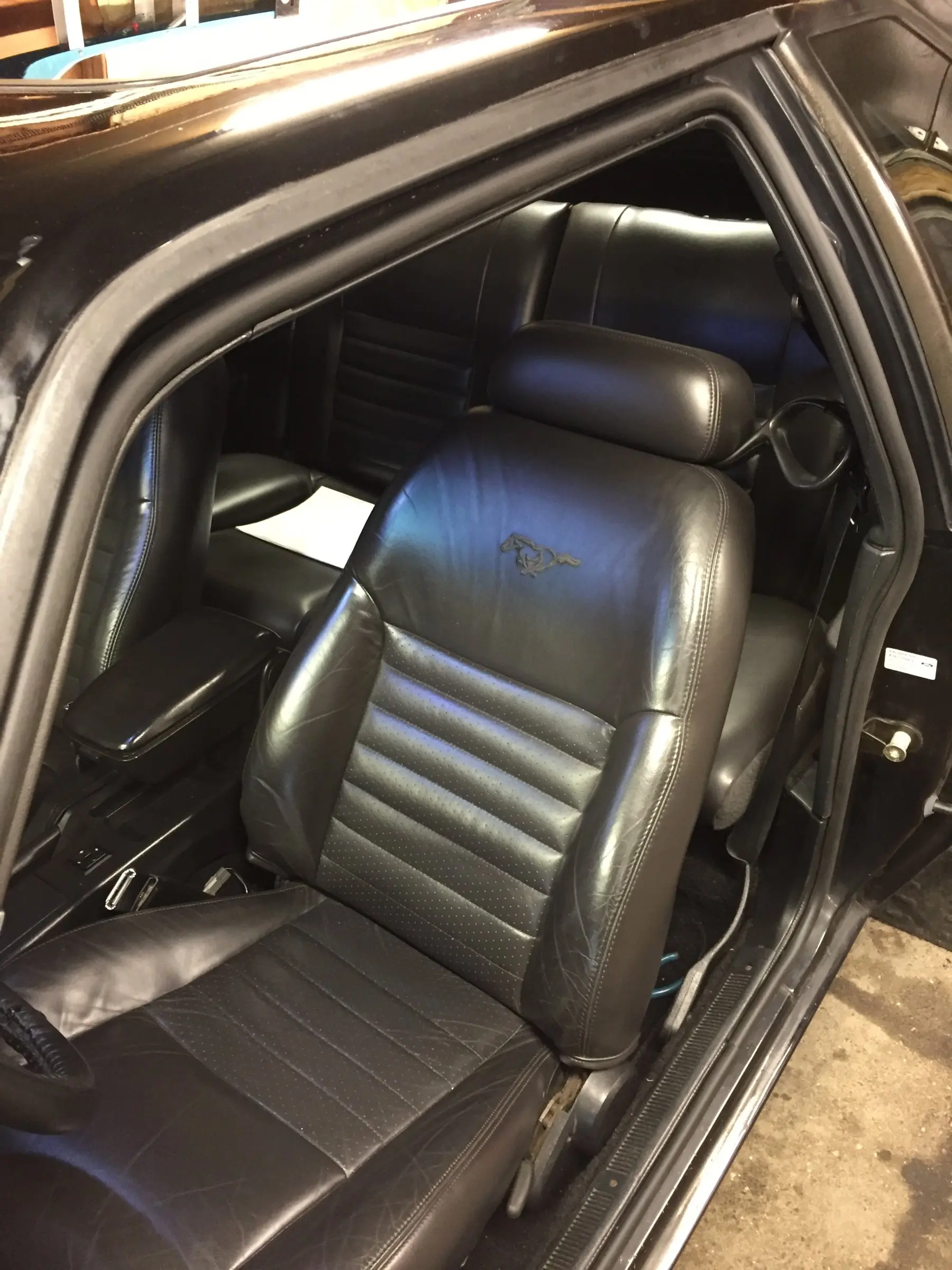

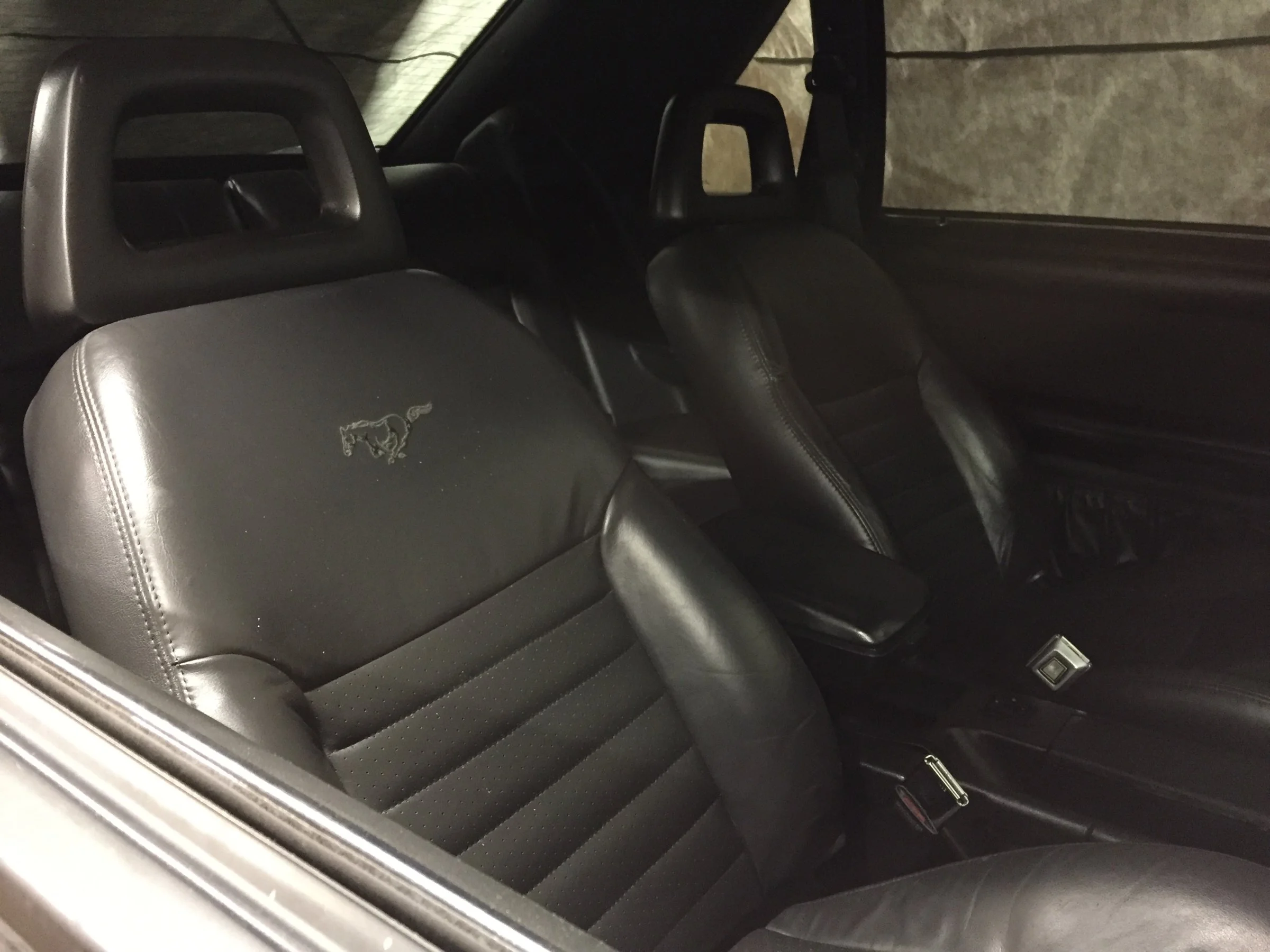

taking the week after Xmas off. Installing these is on the agenda. Just finished dying them

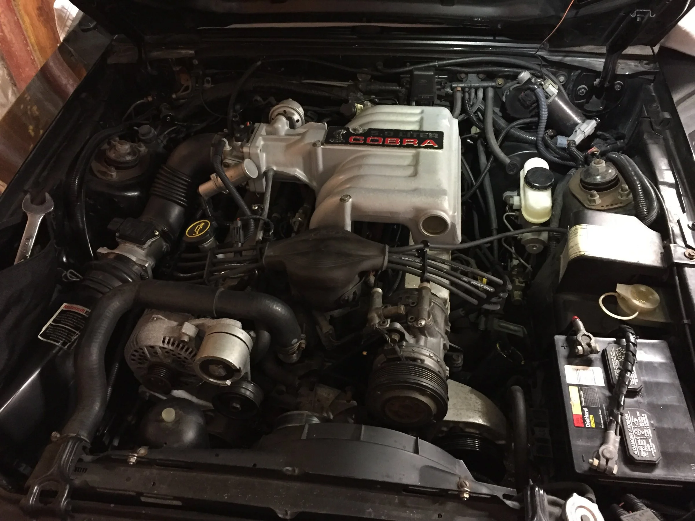

After a crazy holiday I got some time to head to the garage. Bolts I got weren't exactly right, but a few washers later it all went together. Need to test the wiring later to make sure compressor still goes on, but ac compressor is mounted. I'll use it as a core when the times comes because from this point it will take only a few mins to swap.
Wife's out of town next few days. Need to get an 85" belt, and then reposition car to get at that last brake I need to freshen up.

Ok. 3 trips to Autozone and got the correct 86" belt. Little tip: don't use a string that has some elastic qualities when measuring belt lenght.
Anyway, fired it up and found smog pump to be a bit noisy. Noisy enough I don't trust driving on it. So got a new (used) one on the way.
Jumped out the AC low pressure switch and turned on the AC. Compressor clicked on. It also sounded like hell, but I figured it would considering it's been sitting, open, for more than 10 years. But like I said, I'll use it as a core when the time comes.. for now it's fine as an idle pulley
Also, since I had a working smog pump again, decided to run codes. Got two code 11s and a code 44. Will troubleshoot that code 44 later.

If anyone, this is what I used on the headrests. Matched the dark charcoal leather seats perfectly.

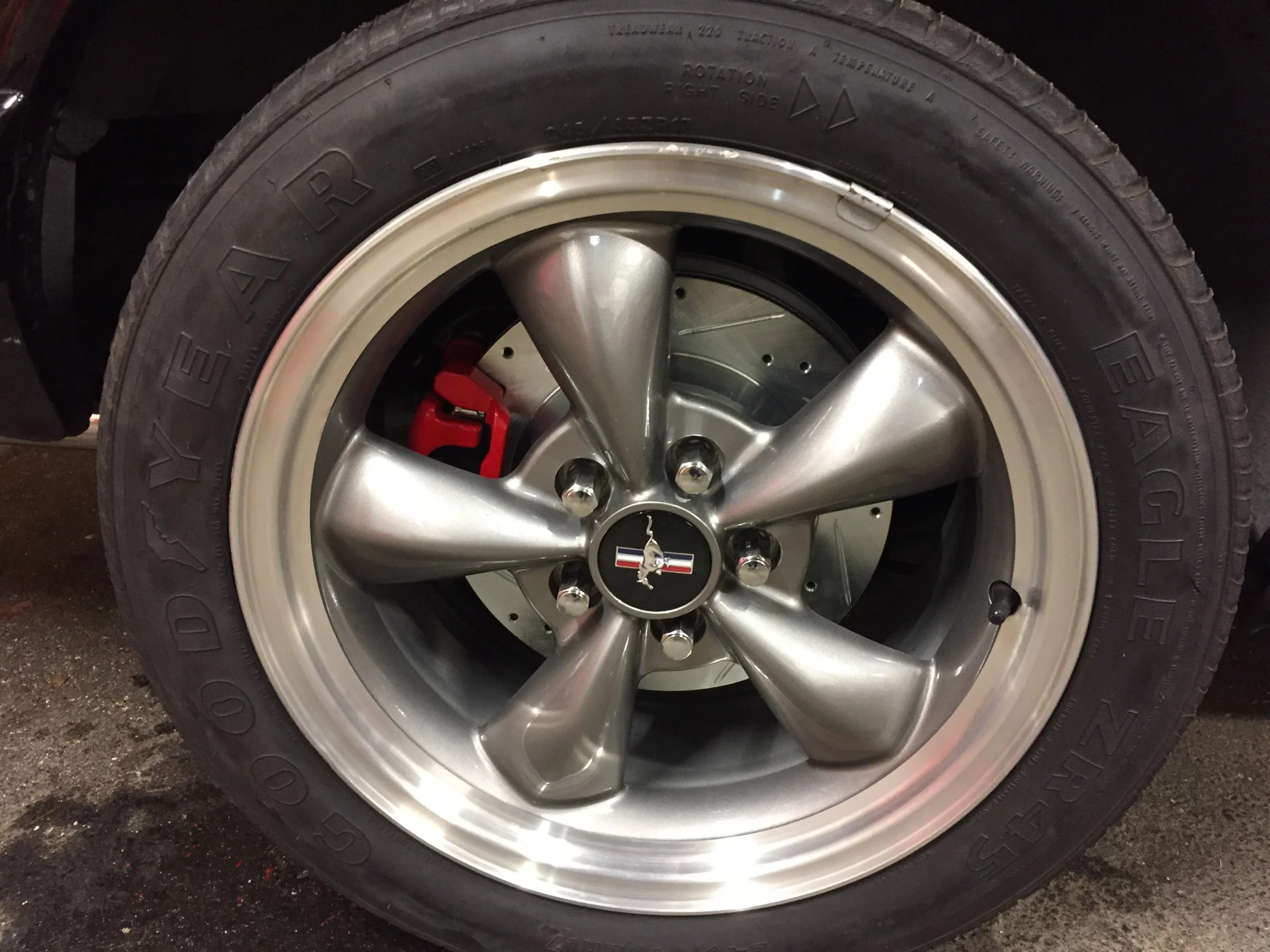

Last brake done. Now to bleed the hell out of all 4 and get a firm pedal
Before
And after
Reactions: Bossed, A5literMan, Jersey Joe and 3 others

Car on ground. Other head rest installed.

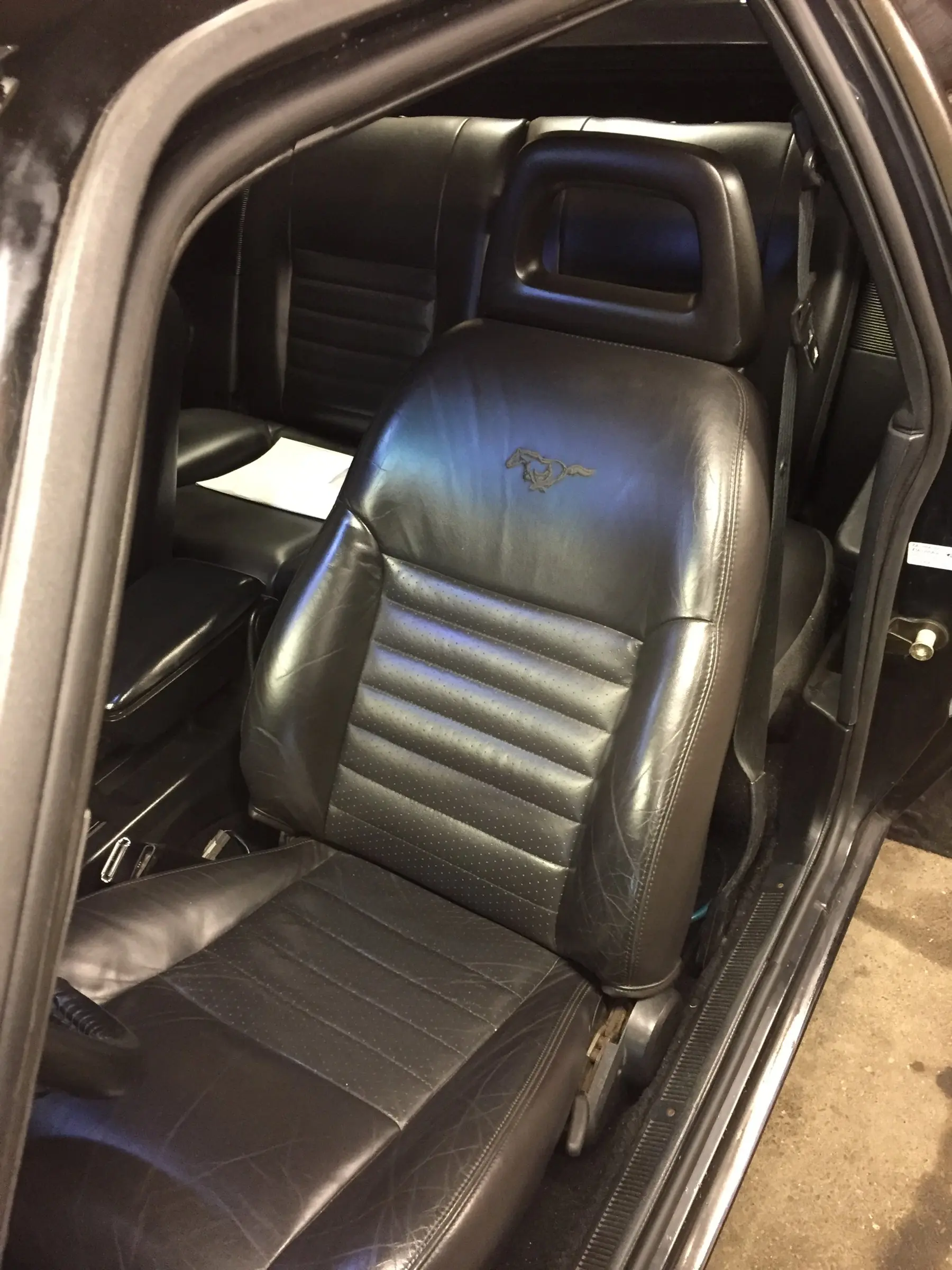

Headrests look darker in pic, but in normal light they look pretty darn close

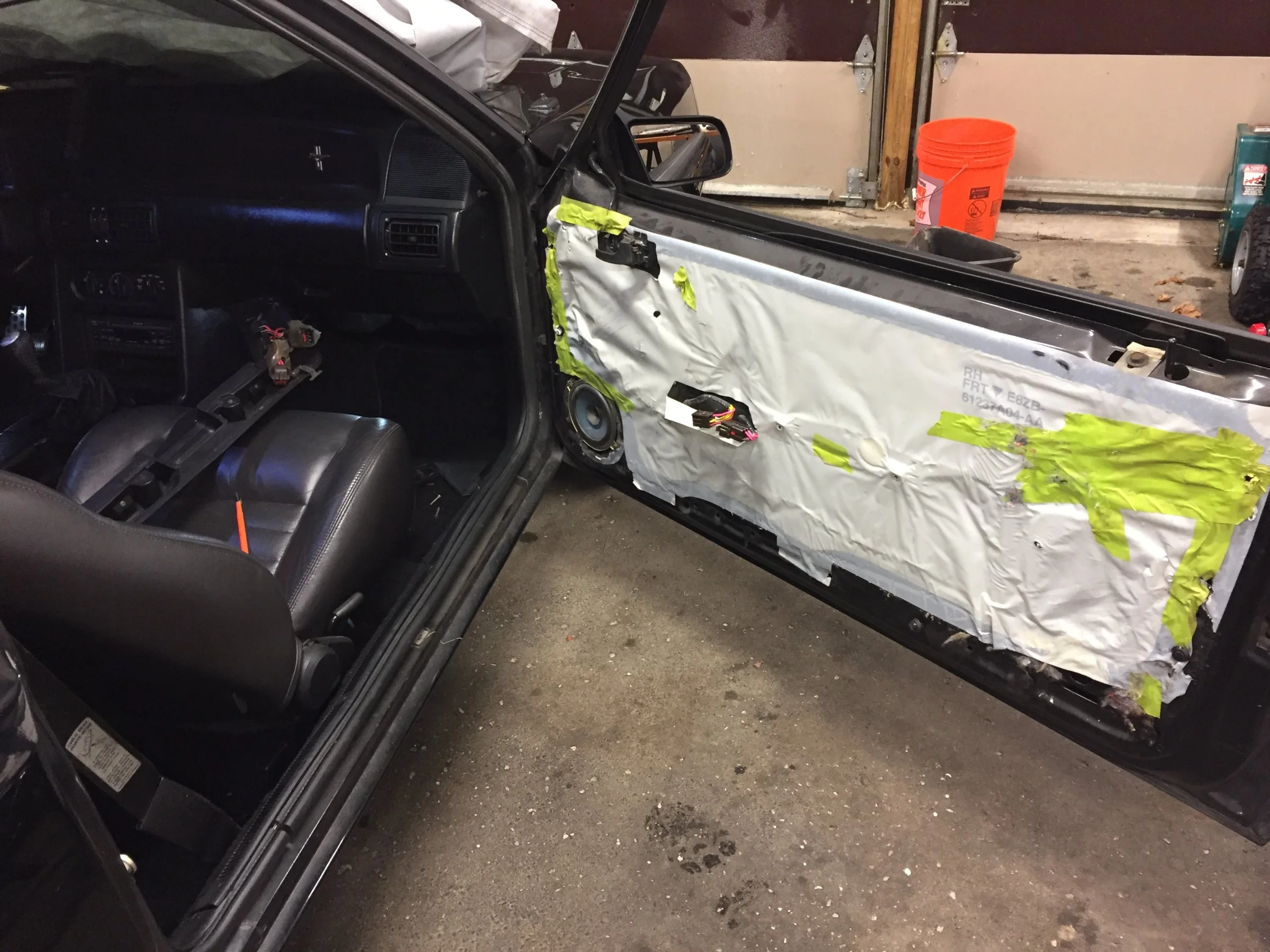

Changing gears. Working on pass door panel

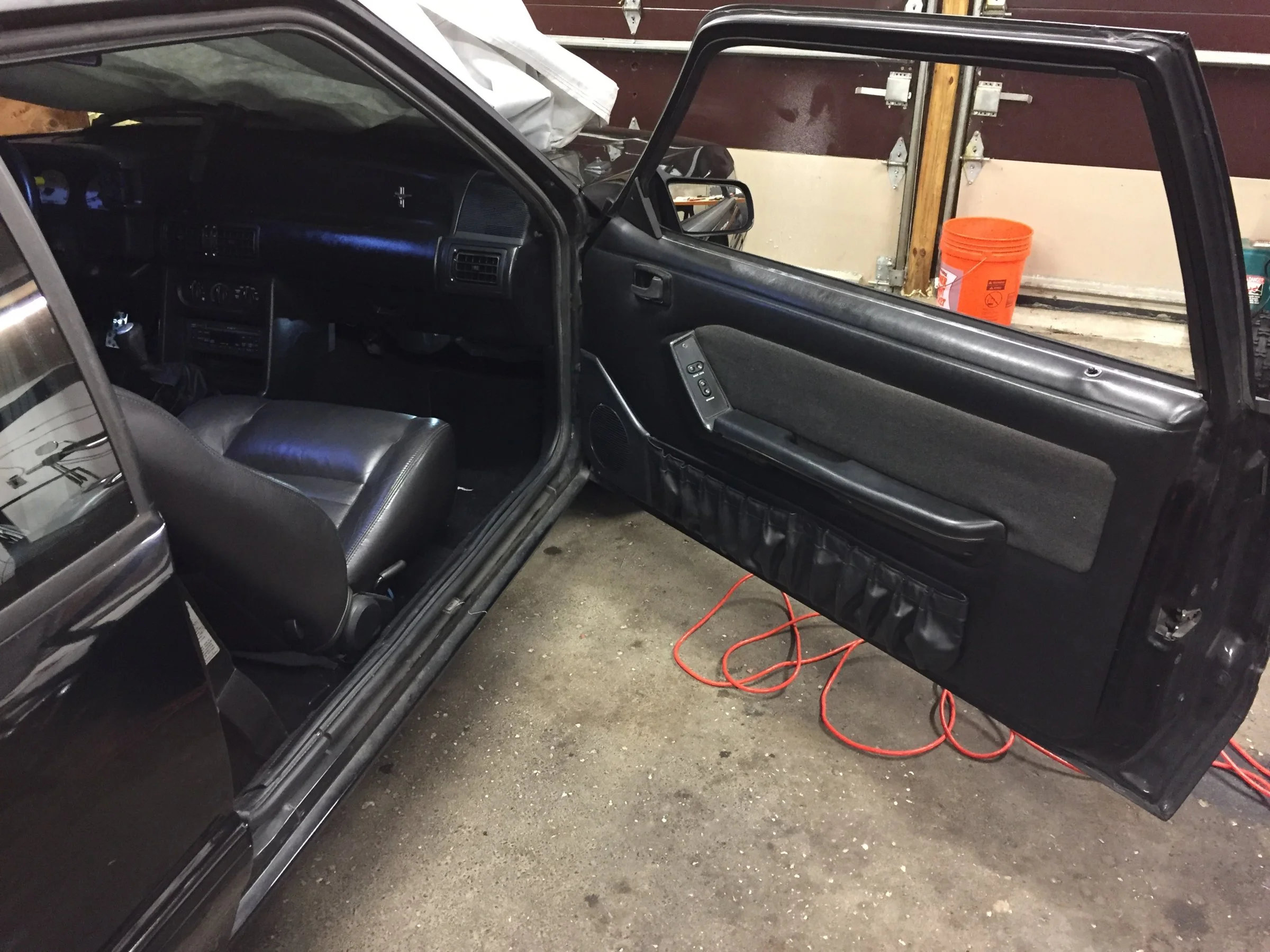

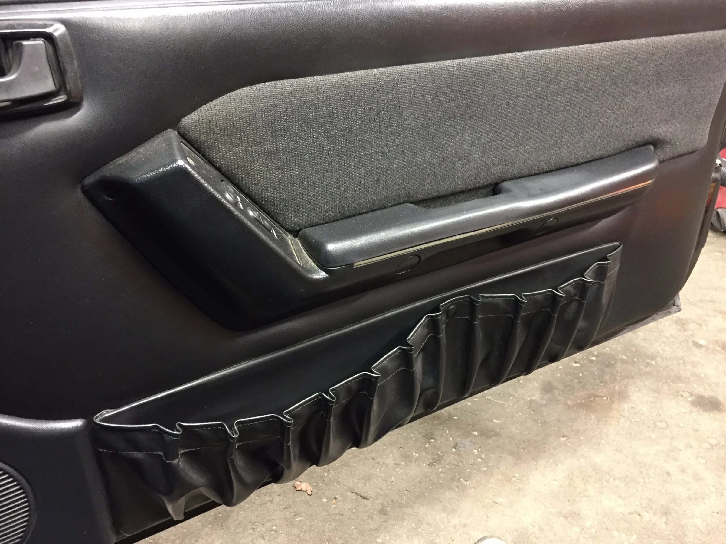

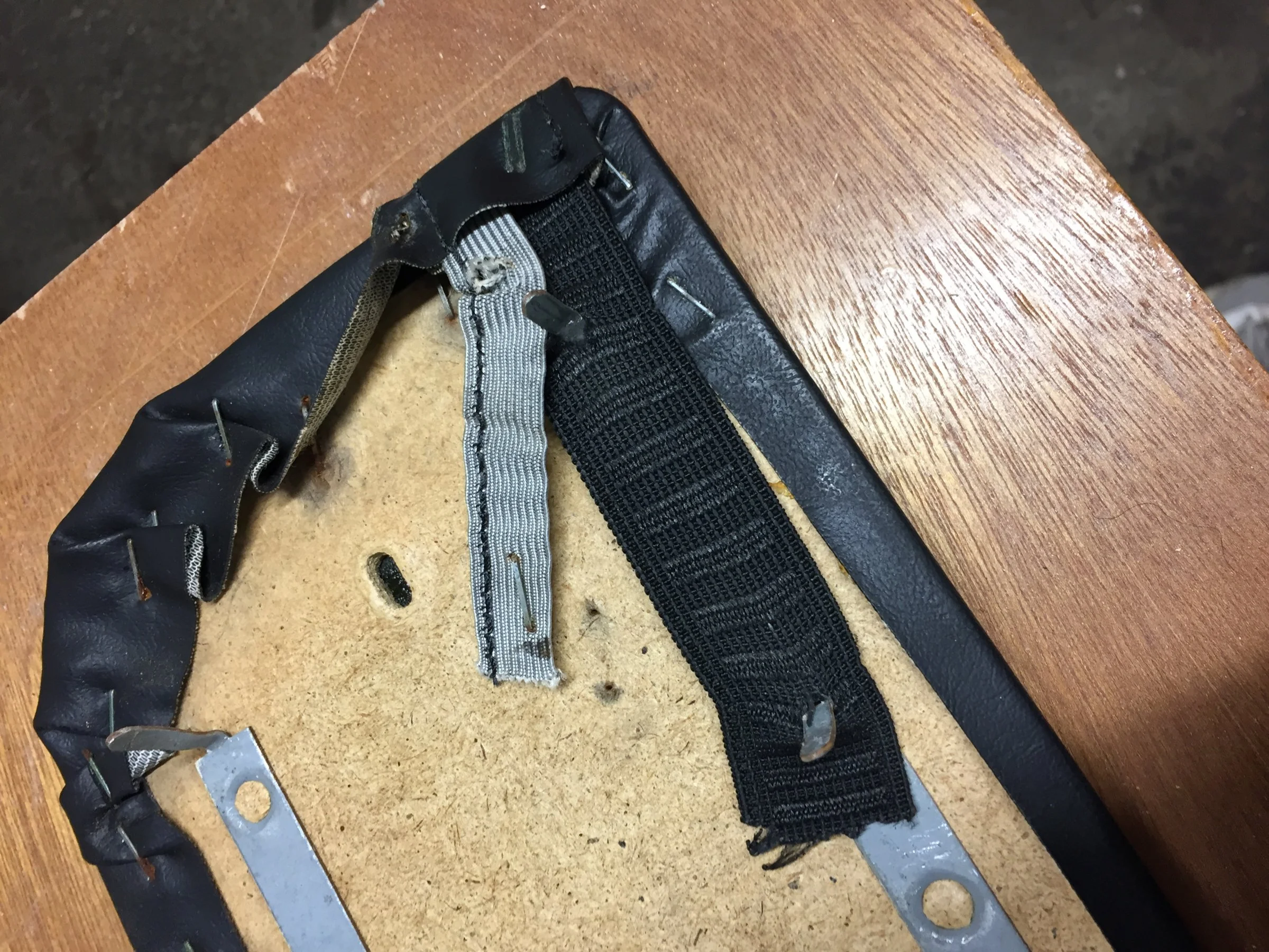

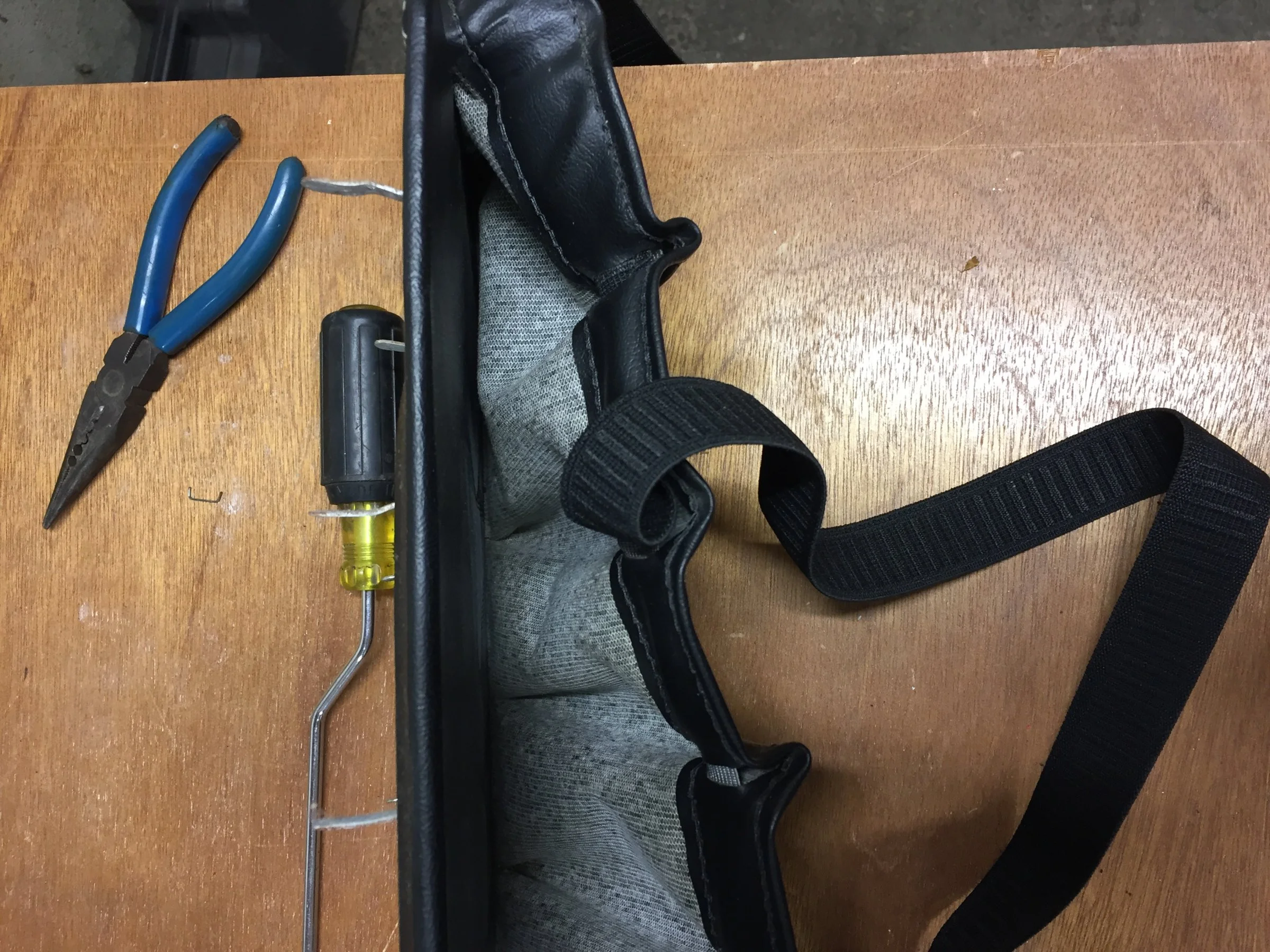

Pretty easy to fix these. Bought some 1" elastic off Amazon. In hindsight, 3/4" would be better. Take the pockets off and feed it through
Reactions: Nutty 5.o
Mustang5L5

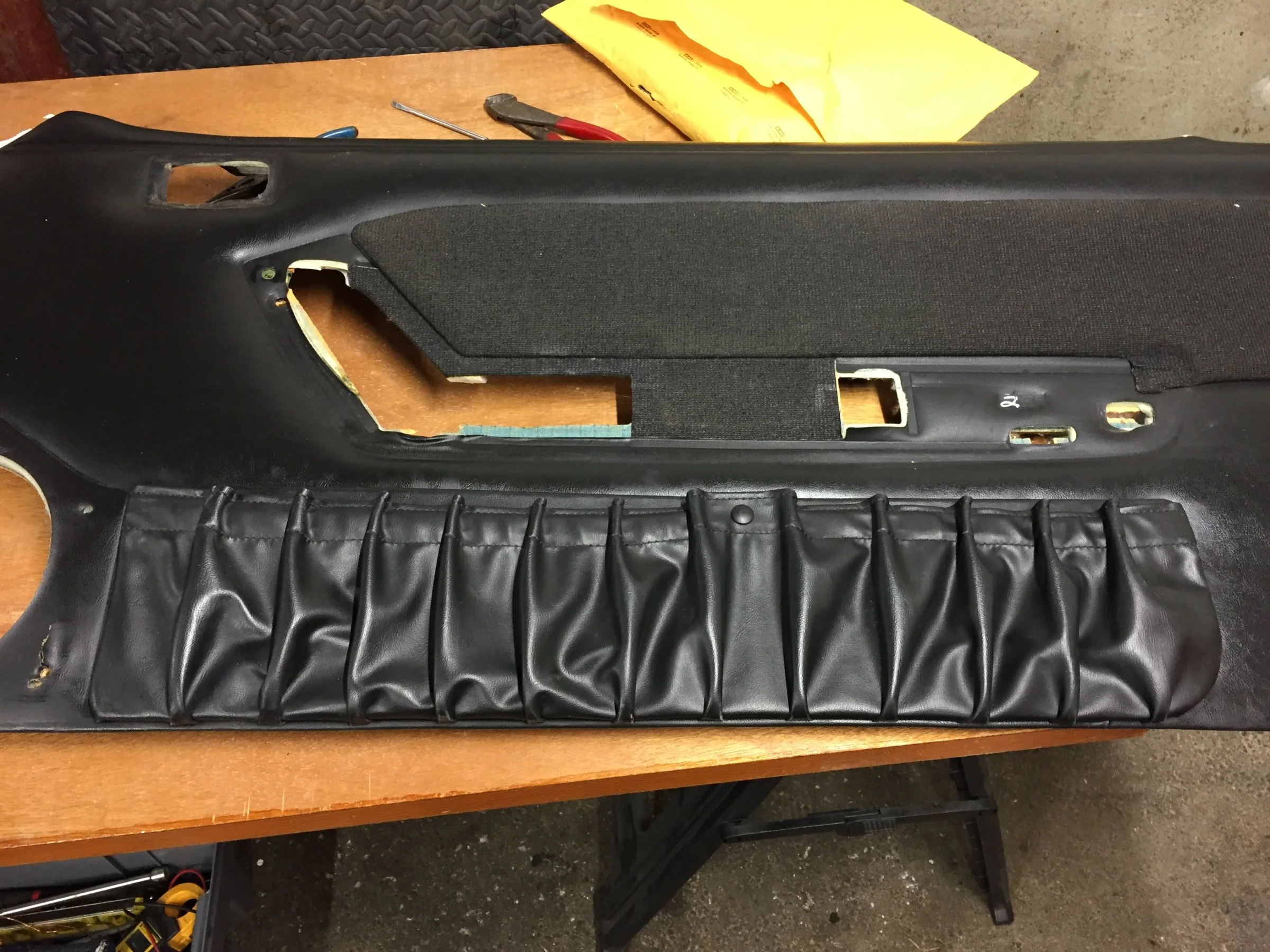

#497
  • Dec 28, 2016
  • #497
Then just pull tight and clip over two of the pins that secure to the panel
No more sag
Reactions: 90sickfox, RaggedGT, Davedacarpainter and 2 others

And done. Even did a new speaker grill. (Reproduction) Now to change out the door weather stripping. I will needvto go back into this door at some point. The pins that hold the panel on were all busted. Need to get enough for both doors and make it tight

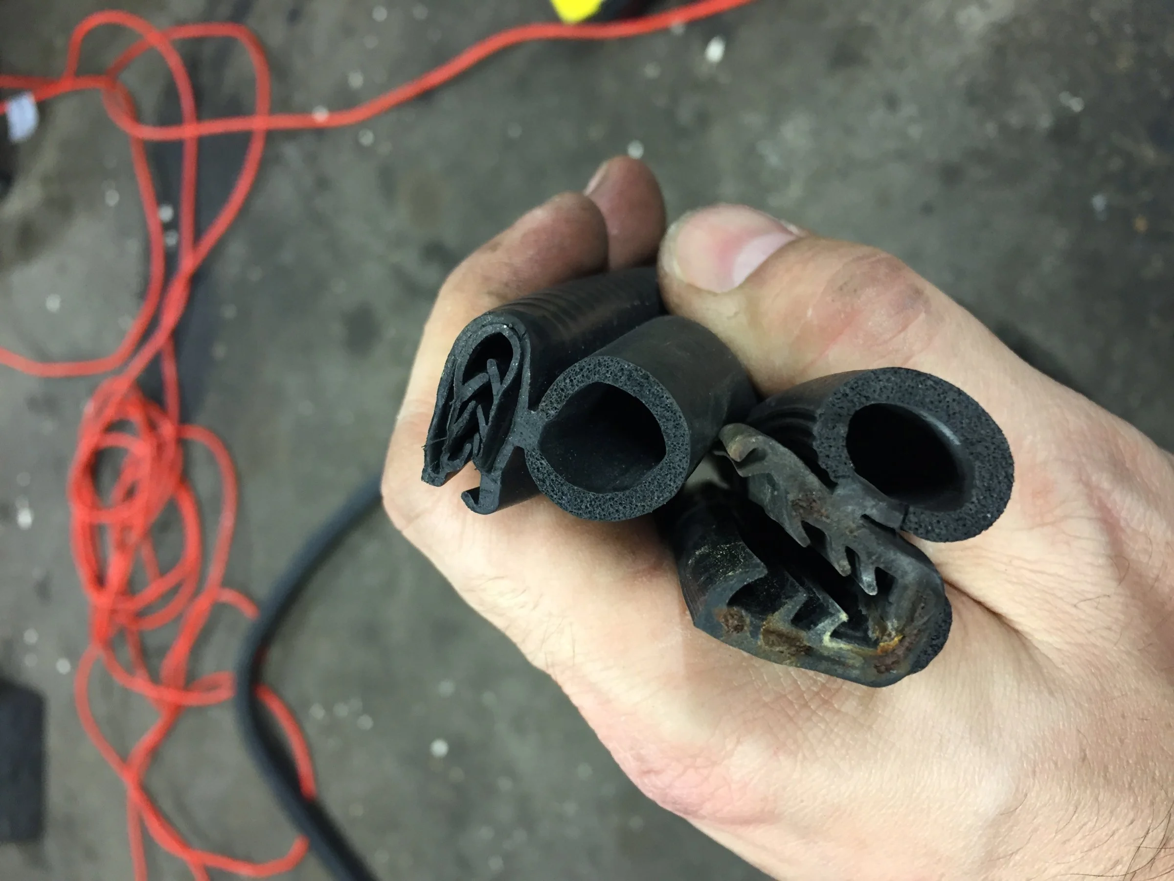

And door weatherstrip done. These strips have come a long way and fit great and cheap. My pass door wasn't too bad, but nice to have all new seals at all three doors now.

Picked up some brake fluid, and ordered a pressure bleeder (motive). I need to bleed the brakes on my Taurus and I do brake bleeds often enough I should invest in proper tools. So waiting for that.
I suspect this is my issue with front calipers. Need to machine up a block of wood to fit inside them before I can pivot them up and bleed.
