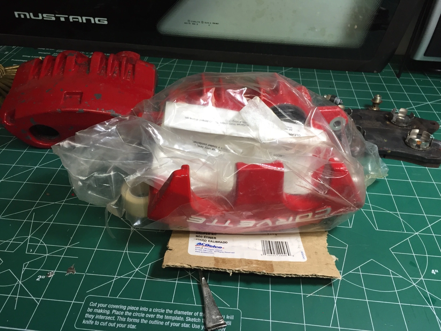

I would have ground it off, but get where you are coming from. So you only purchased one side so far?
Only need one caliper (the red part). I have the abutment brackets and pads and rotors and hardware.
I wanted to make sure it was actually going to work before I went crazy buying parts. I paid $50 shipped for that red caliper because there were a few scratches and chips. It was brand new.
Just waiting for another one to pop up on eBay. I have time so trying to find a similar deal until I'm really in need of one. In the meantime I can pull the cobra stuff off replace the hub and get the new rotor and bracket on, and paint the sn95 cobra rear calipers. So basically I have enough to keep me busy while I search

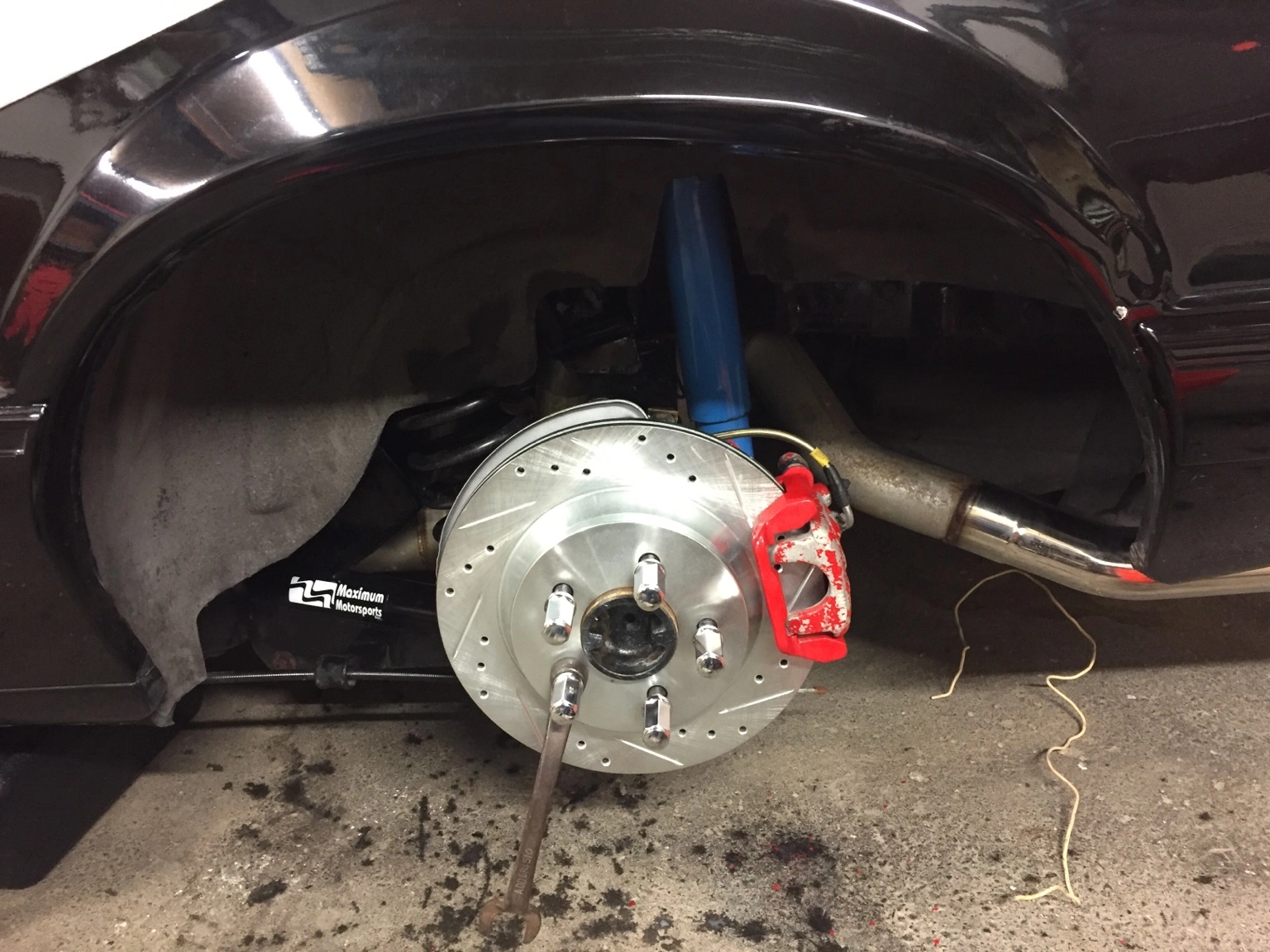

Ok minor updates simply because I can't get much done when I only get an hour and there to sneak off.

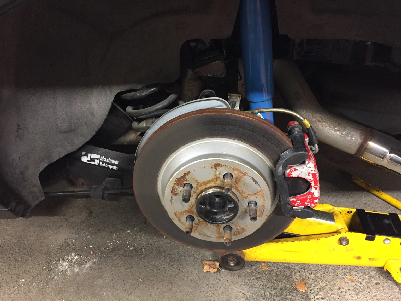

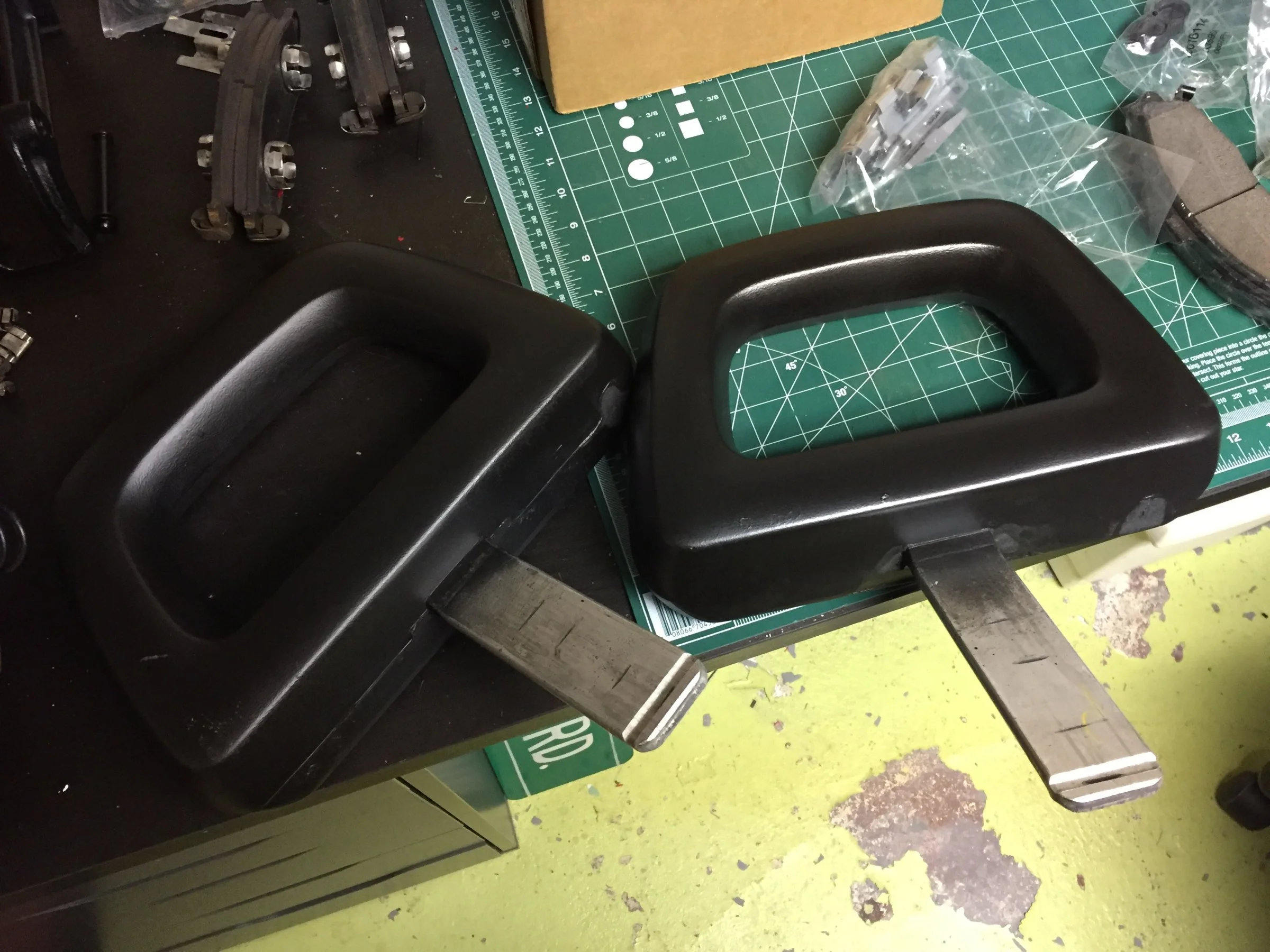

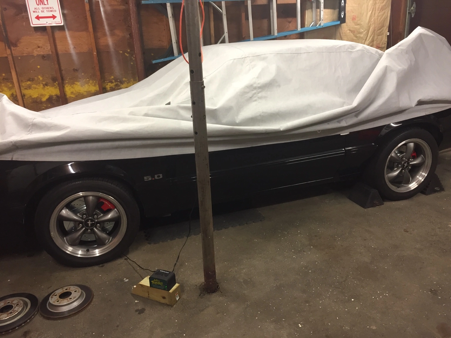

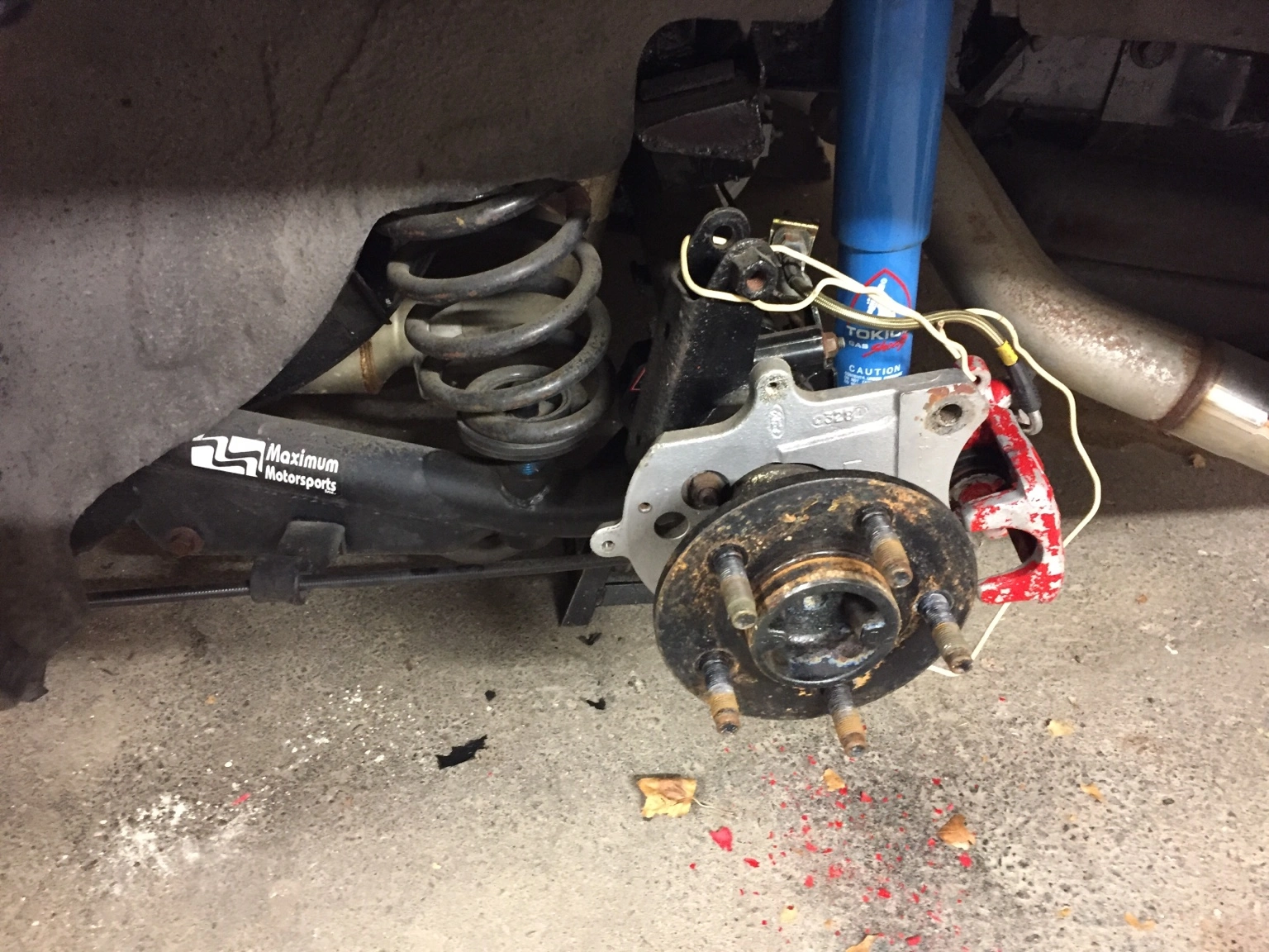

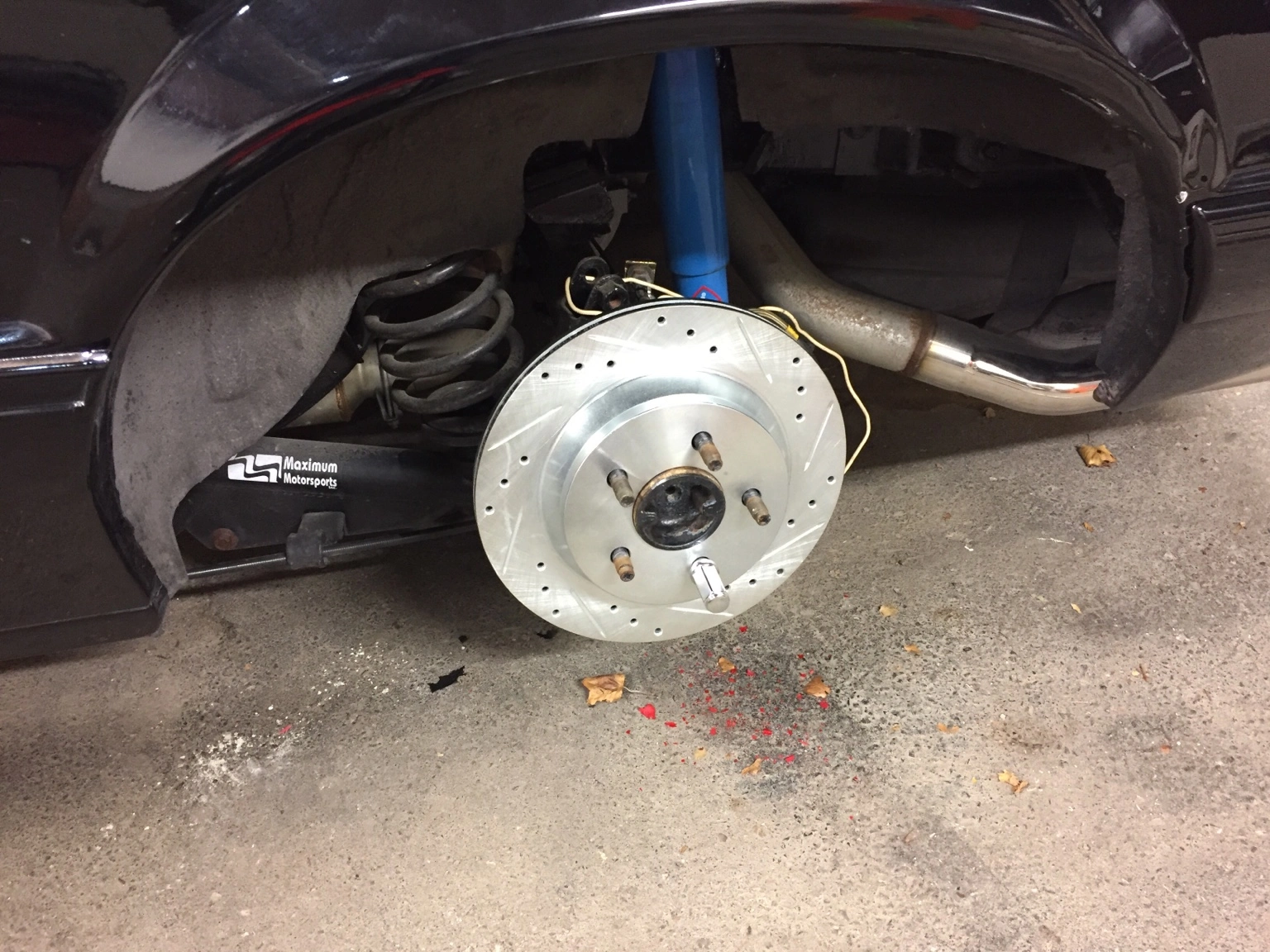

But next project. Would you believe I have less than 200 miles on these rotors? Sitting for 4 years takes its toll. Surface is pitted badly. Prob be ok if I turned them though so I'll save them. I have a few goodies already installed back here
Brakes stripped down. Time for some elbow grease cleaning this up.
I need to remove caliper to paint. Thinking of temp installing the front Mach caliper just to keep line from bleeding down while open.

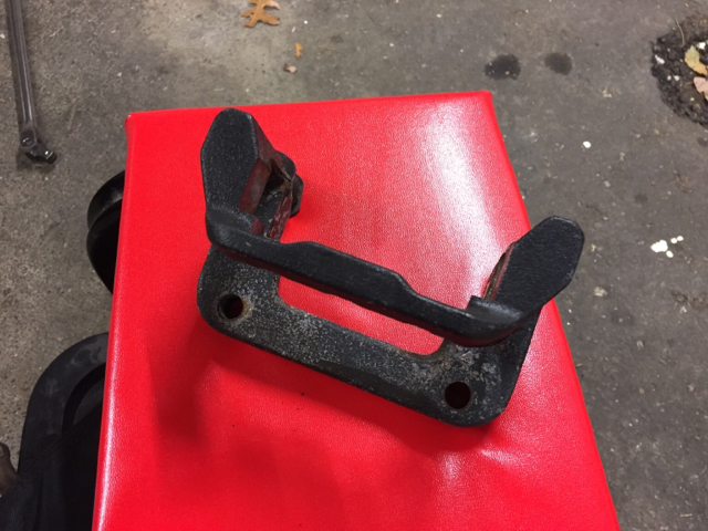

Question. Painting calipers red to match front. Paint abutments black, or red like the 10th anniversary cobra calipers?

That's awesome. Brake swaps seem to be full of questions on which master cylinder. Have you done any investigating there?
For the Corvette PBR's? They use 40mm pistons, same as the Mach 1 calipers I ran before. No MC changes needed. I'm running a 1" 1993 Cobra MC and SN95 booster with adjustable PV. Brake performance has always been great...even excessive at times for street use on such a light car. I barely touch the pedal to stop during normal cruising around.

I agree with all red on the back calipers/brackets. Those new rotors look slick, btw.
Red it is then. Time to start a cleanup of the area with some hot water and rag, maybe some paint and then reassemble. I really need a set of quad shocks too. I do get wheel hop even with all aftermarket suspension back there.
Rotors are the Eline rotors from R1 concepts. Made in china unfortunately, but what isn't. I know I should just resurface my OEM rotors, but I wanted some bling bling and nearest place to me to resurface them is a 40 min ride and $30/rotor. Car is mostly a cruiser, so hopefully I never crack them. Just going for the "look at me" approach for now

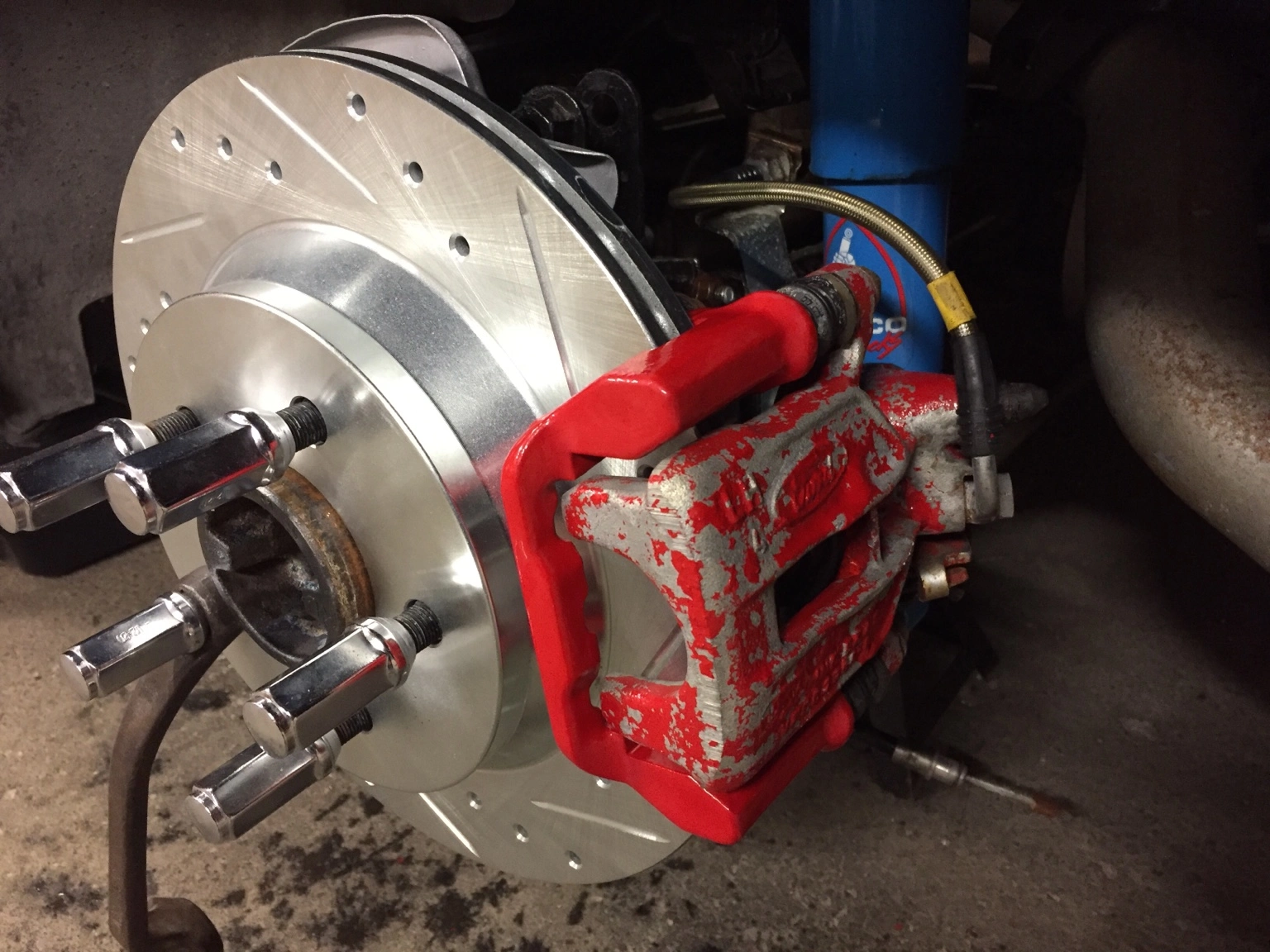

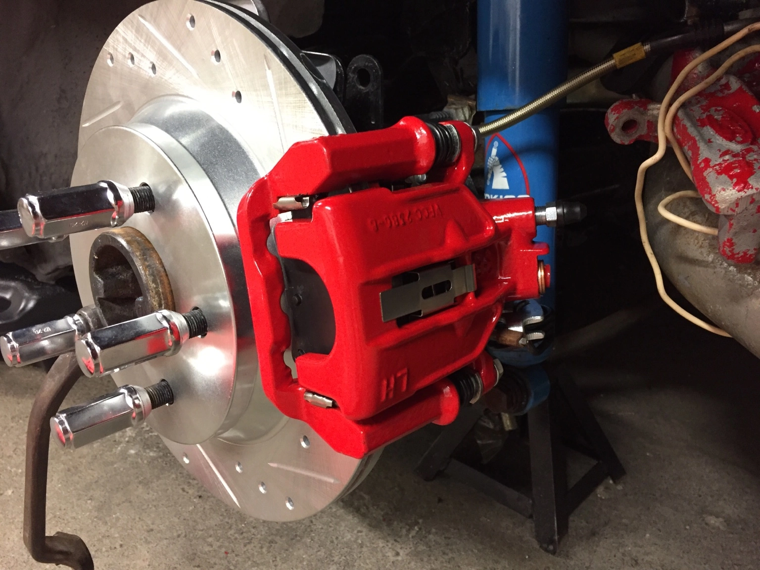

Slow weekend. Figure toss a few pics up.

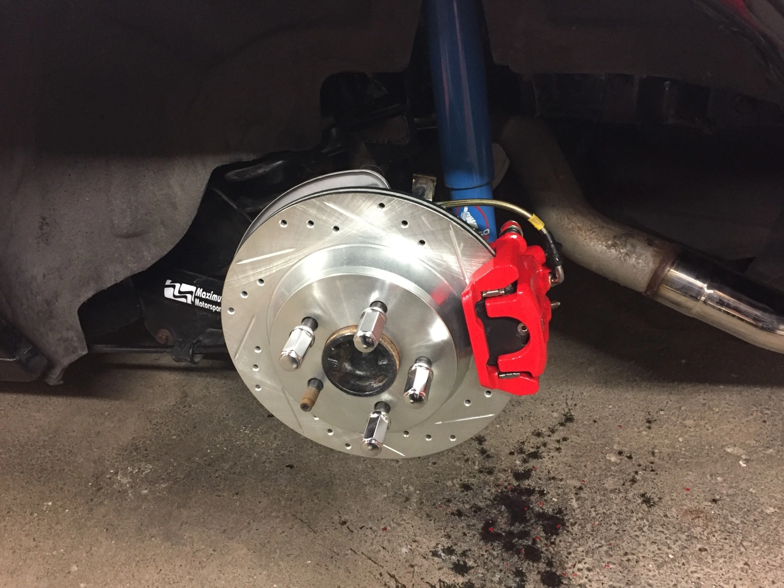

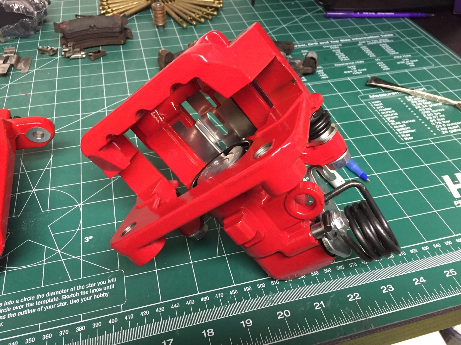

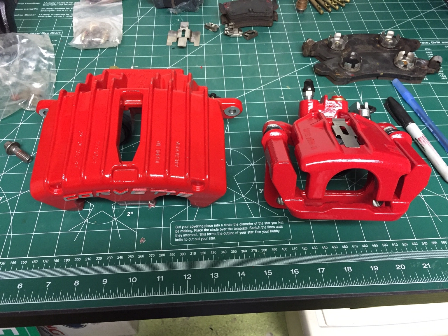

Hot water and soap cleaning. Began painting the calipers but total pita. The duplicator brush paint was too thick and gobbed up. The spray paint was fragile and chunks came off just putting the pads in.
Sooooo
Rockauto.com has powdercoated red Cobra calipers for $44 each plus $22 core.
I figure my time and sanity was worth at least that considering the effort and $$ I've spent so far.
Oh, and I will not be shipping back perfectly good cobra calipers for $44 minus shipping (prob $10). For the $30 or so I'll keep em.
Anyway. Delivery is Thursday. So we wait....again.

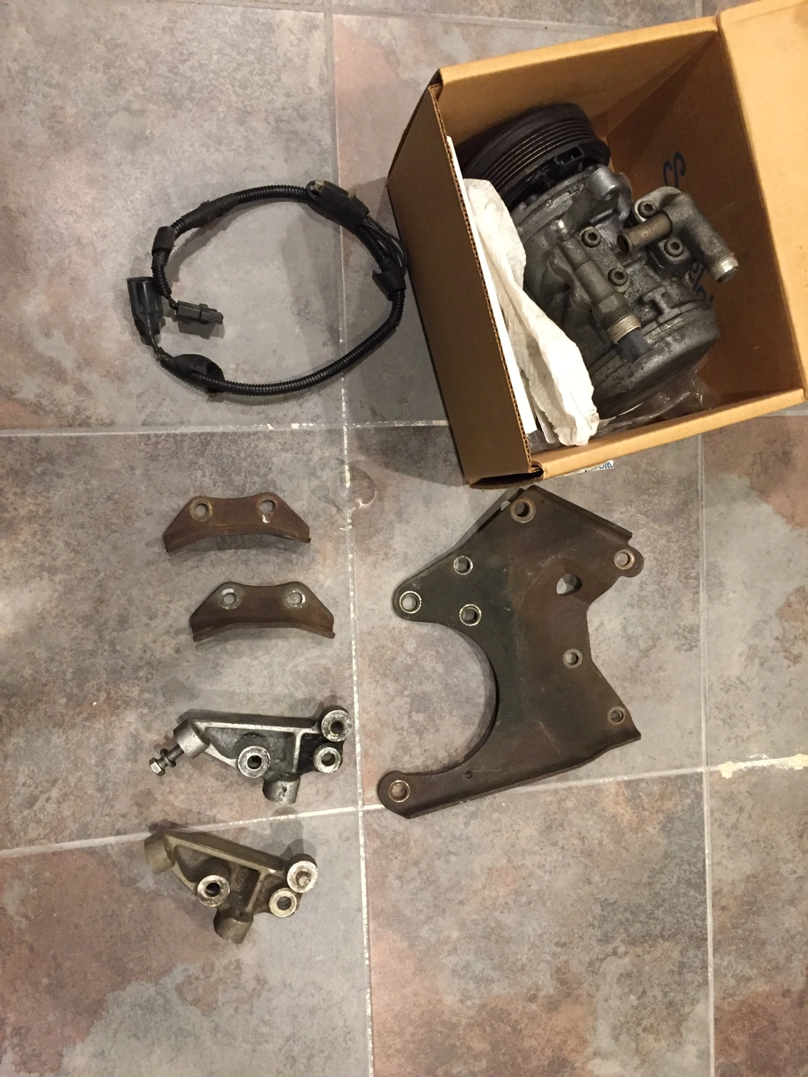

Gonna get a Reman compressor, this one been sitting open for years. It will be my core but until then it will be temp installed
Sent from my iPhone using Tapatalk

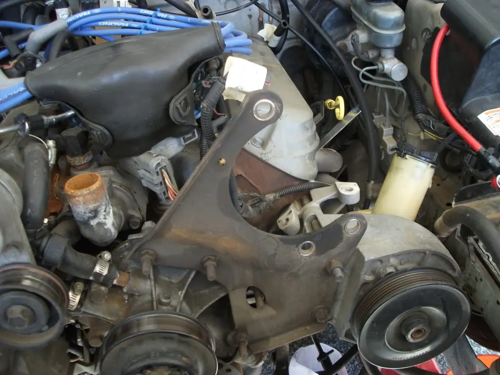

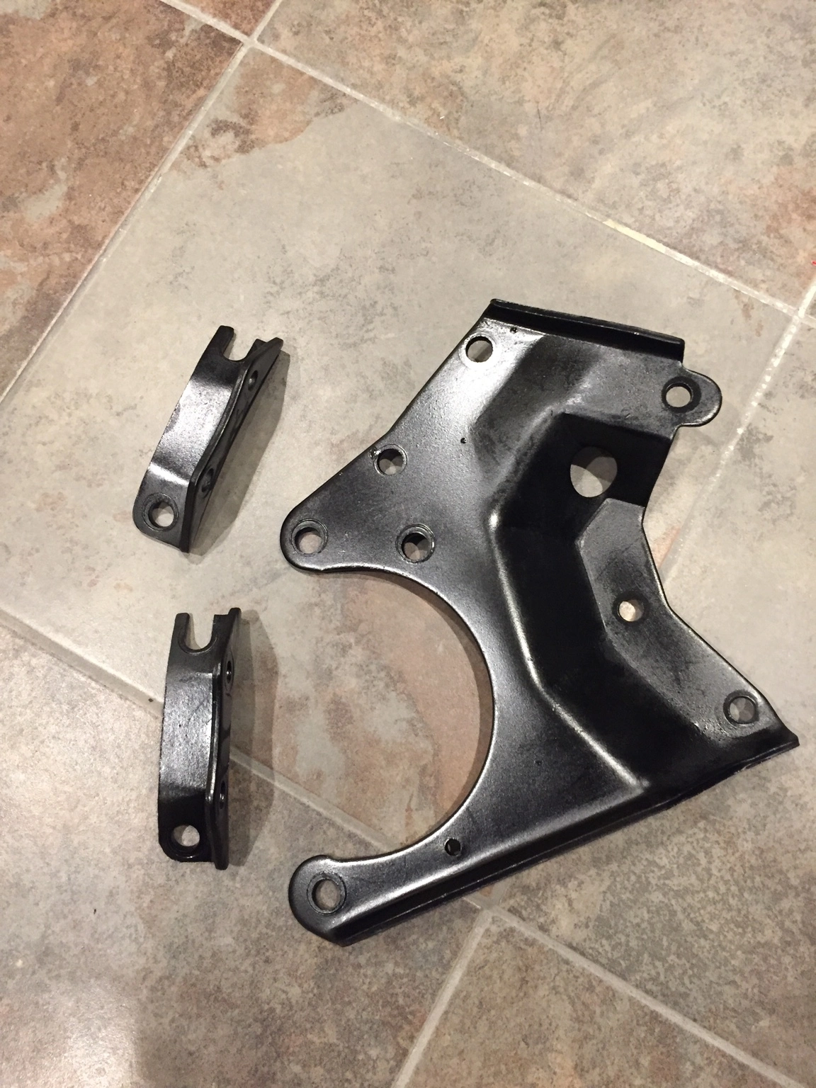

Ok, fail on the compressor reinstall. I thought I had all the parts I needed but I guess not. Lacking the two main power steering studs, and one bolt for the small AL bracket into the head.
Found this out AFTER taking it all apart. Had to put it back together as I need to move the car around to do the other two brakes. I'm not pushing it.
On the hunt for hardware. If anyone has this stuff, let me know.

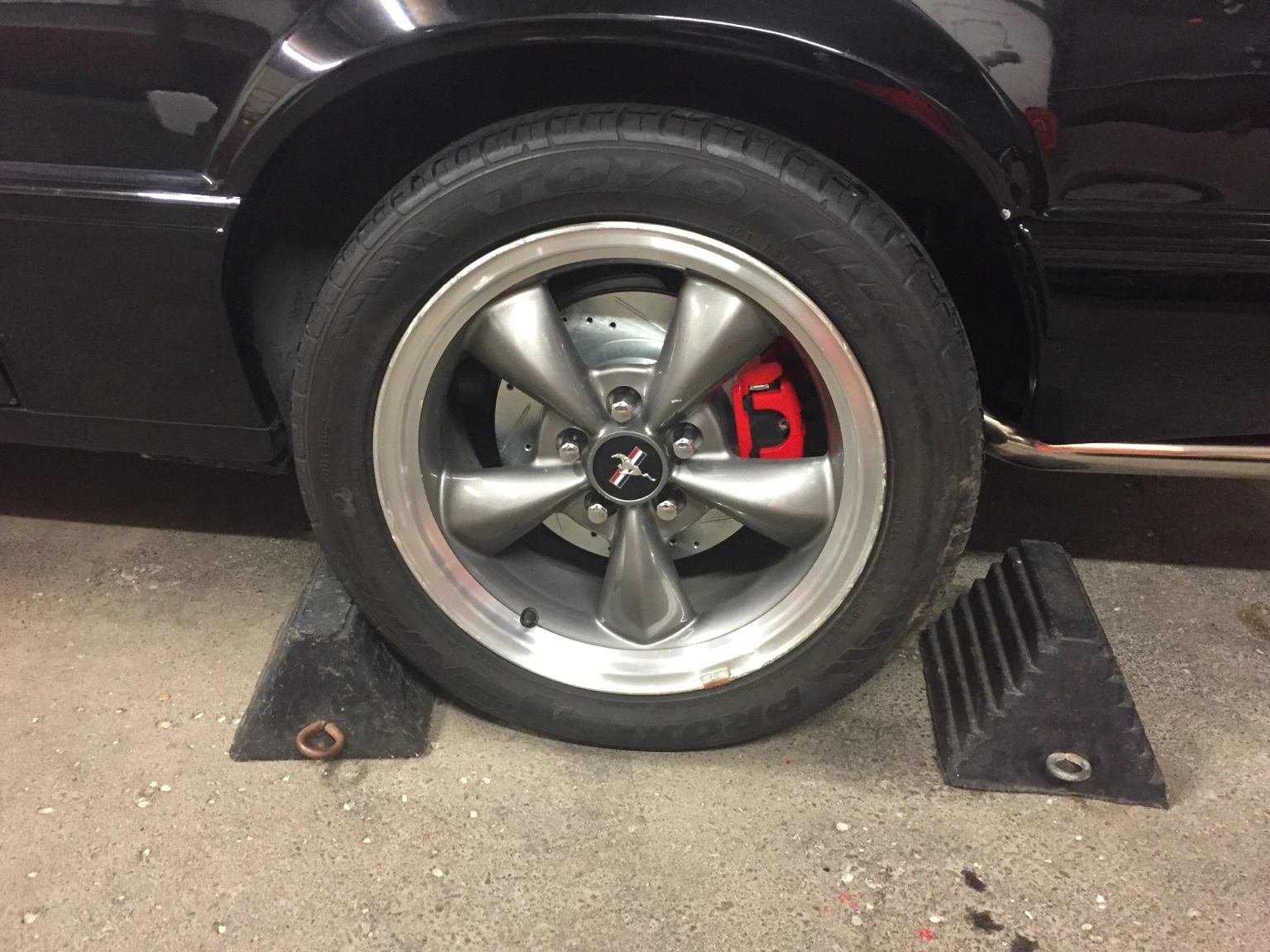

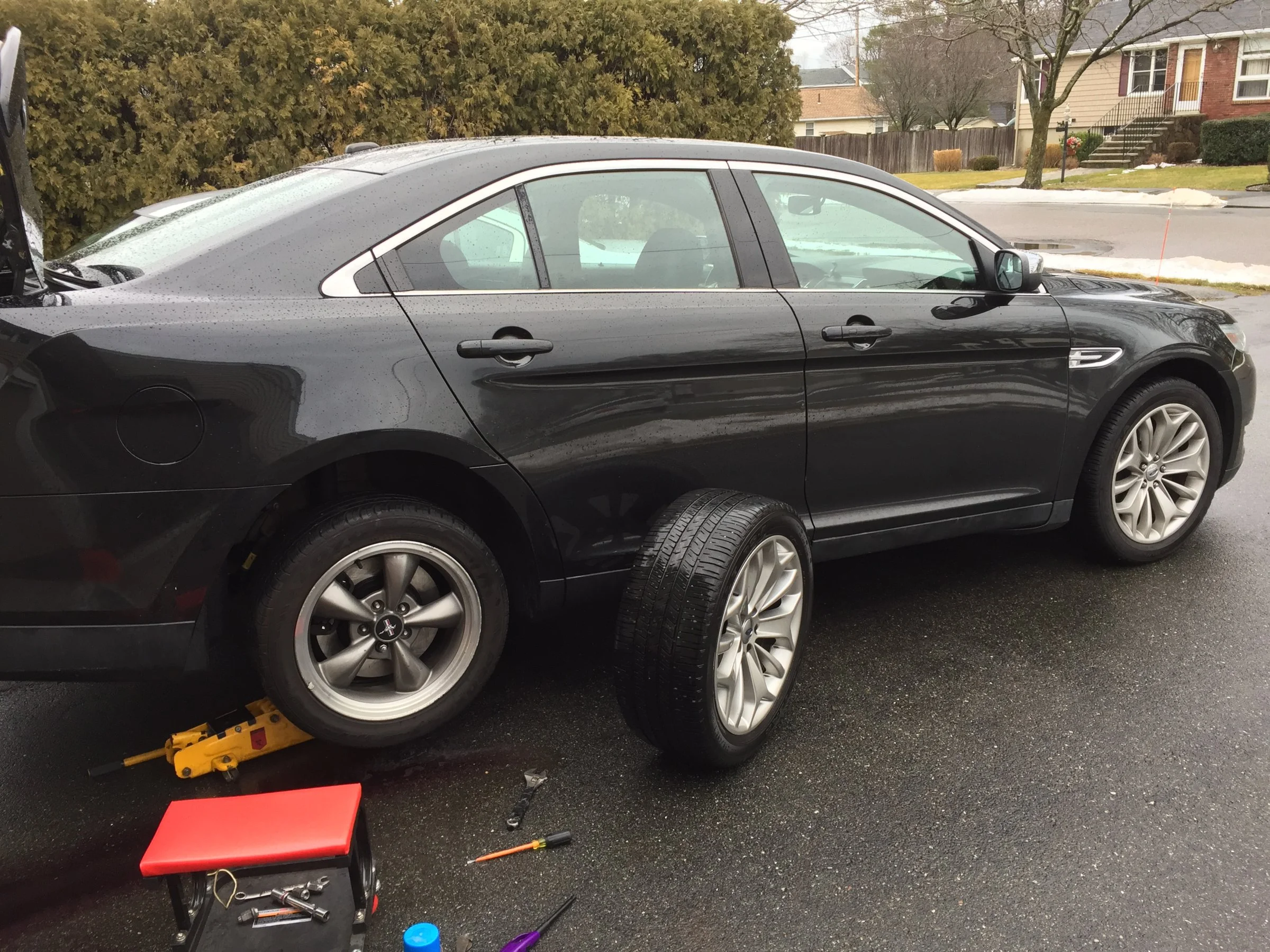

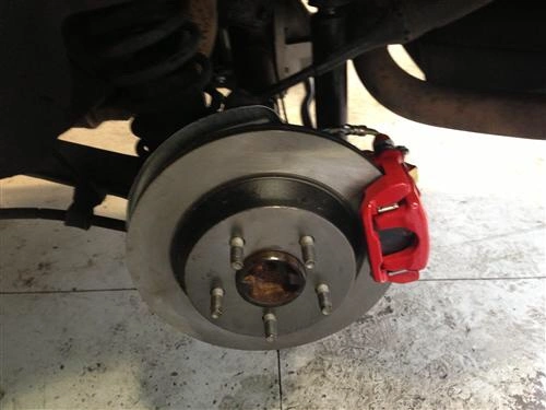

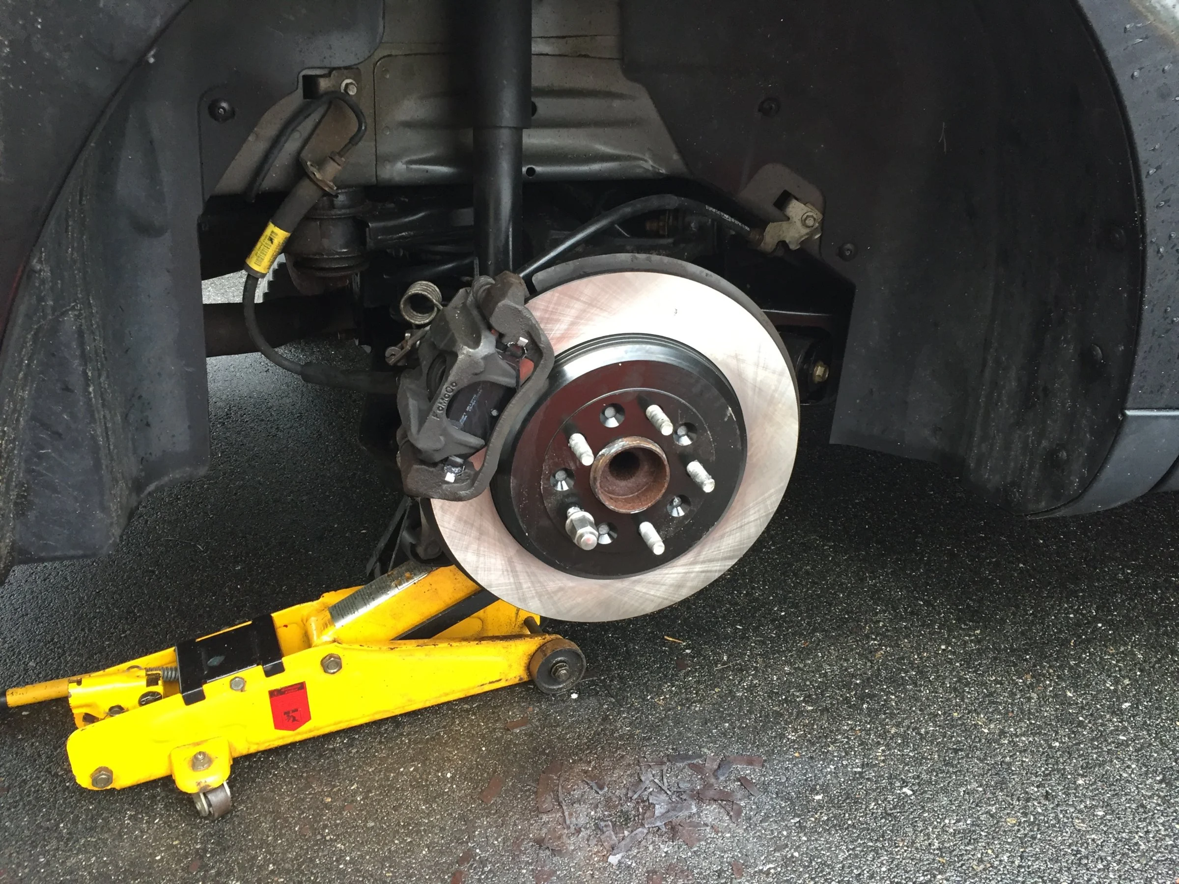

Since it was warm out (50s is warm to me) I tackled brakes of the DD.
13" rear disks. Amazing what they put on normal cars these days
Stuck a 17" Bullitt wheel on just to see
17's are too small for this car
I thought so too, but the bolts with the ford delete kit are too short. On the delete, the two bolts thread into the bracket that bolts to the head.
On the ac setup, the stud and bolt thread directly into the head as pass through the bracket. So they are longer.
Quick check on eBay. People asking $40......each!
Pick for reverence.. I need the two bolts on the far right. You can see how top stud passes through the rear bracket and into the head.
