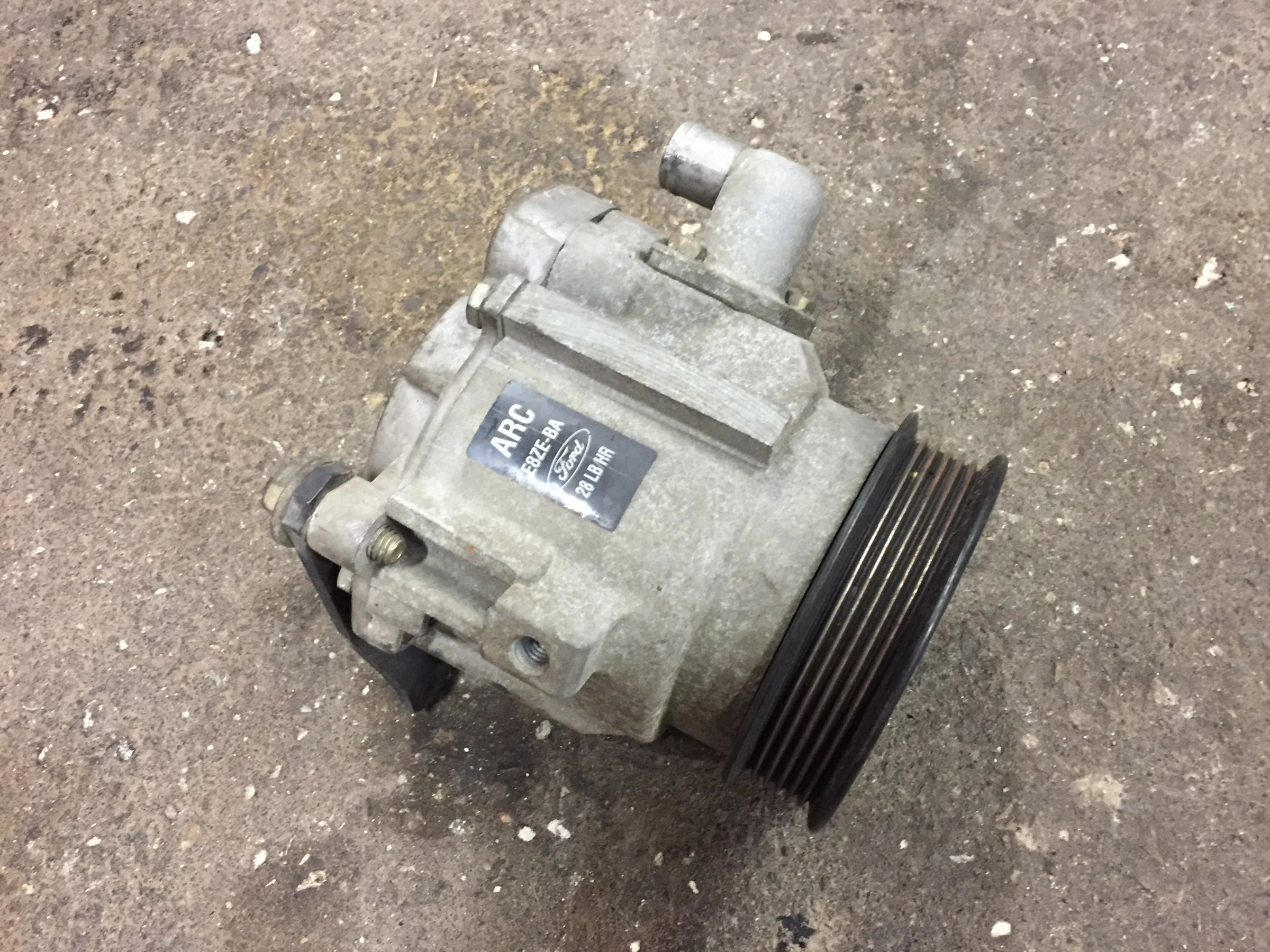

Smog pump. Ohhhhhh. Ahhhhhh.
Just waiting on parts. Discovered you can't change thread title on mobile app. Or maybe you can, but I can't figure out how.
Waiting for pressure bleeder in mail. Hosting some parties here this weekend, so no work on Mustang til Monday. I want to get the smog pump on and then find a block of wood to fit the front caliper to bleed it up.

New pump installed. No more noise. Runs great. Only a single code 44 remains but despite that engine is running quite well. Code 44 is prob a clogged port on the tube behind the heads. Eh.
That's all I got. Waiting on parts to pressure bleed the brakes before I move onto the steering rack. Happy new year

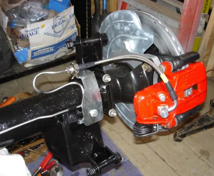

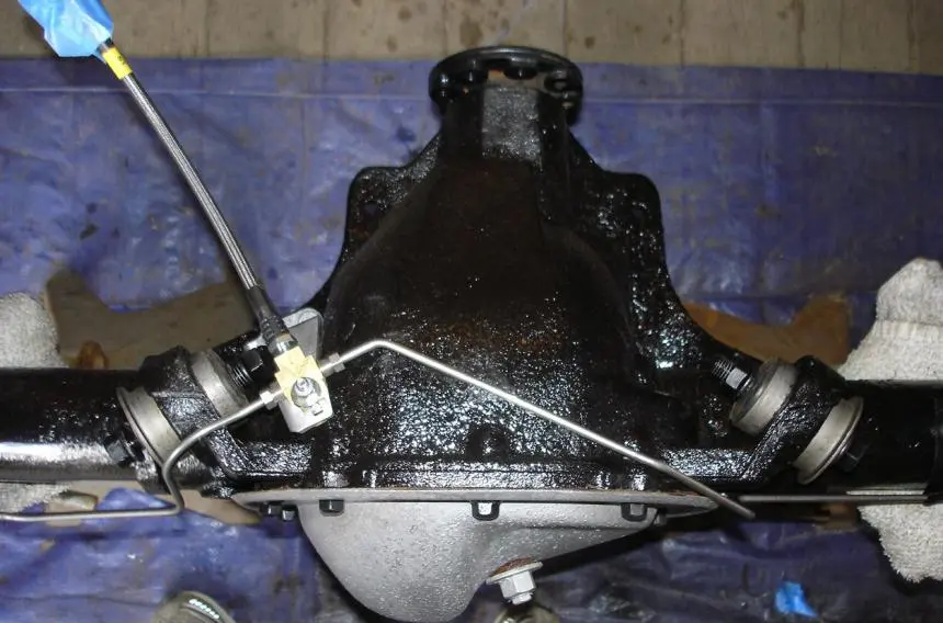

liljoe07 said:
Those the MM stainless hoses? What bracket did you use for the hardline/flex line connection?
Yup. It's the MM 3-peice kit out back. The brackets are supplied by MM, and bolt up like the 94-95 Mustangs. Center line requires you to cut off the factory hose and reuse the bracket

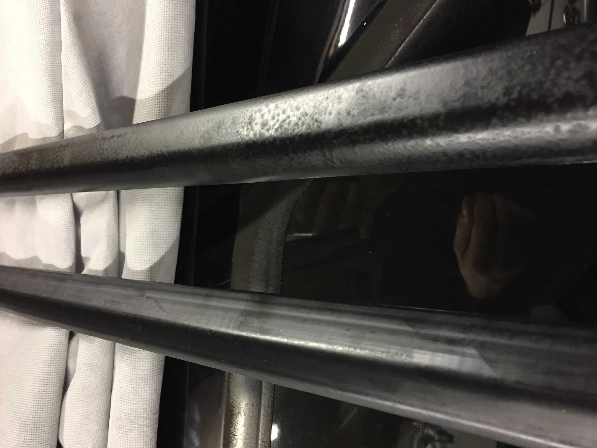

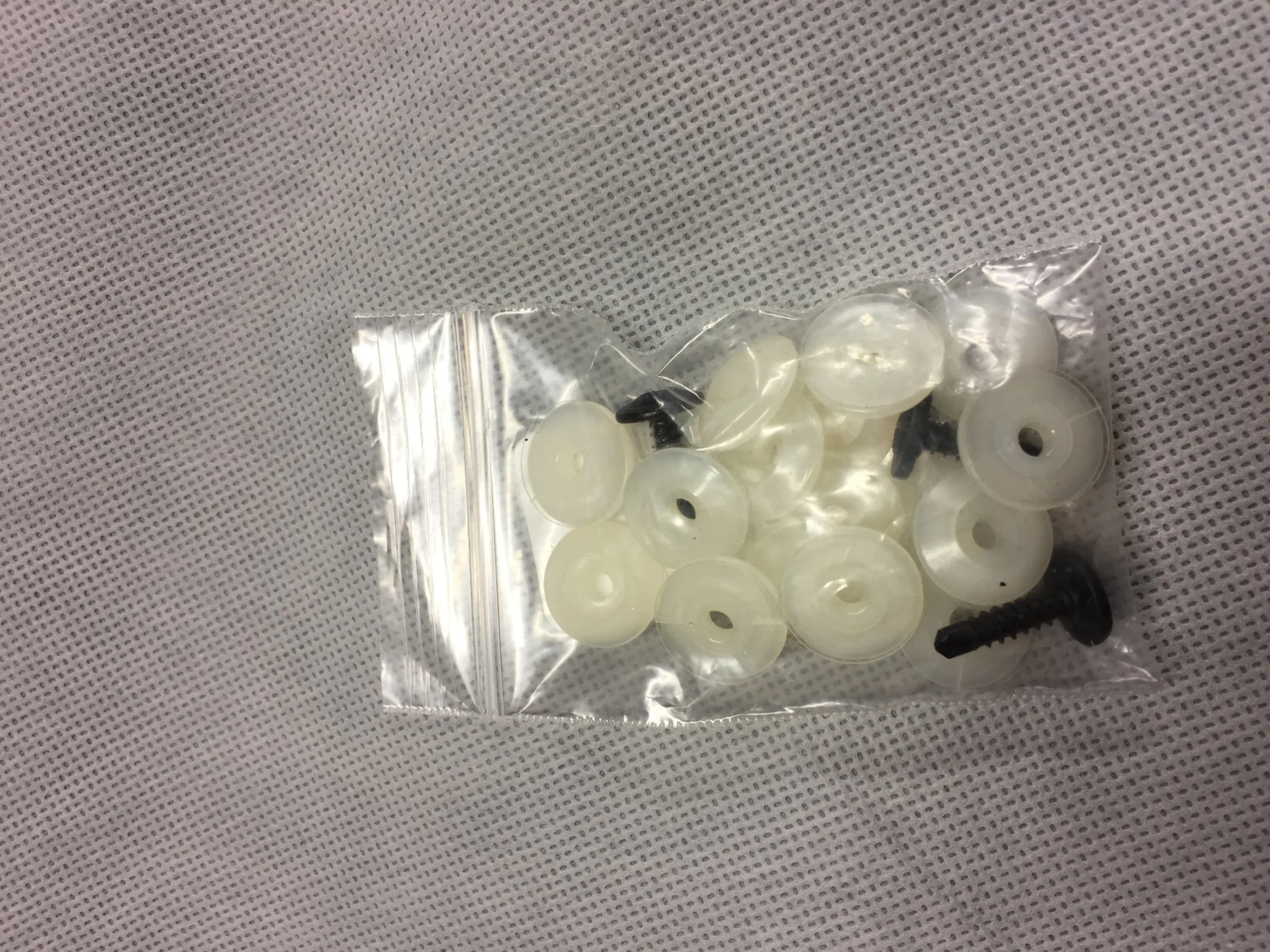

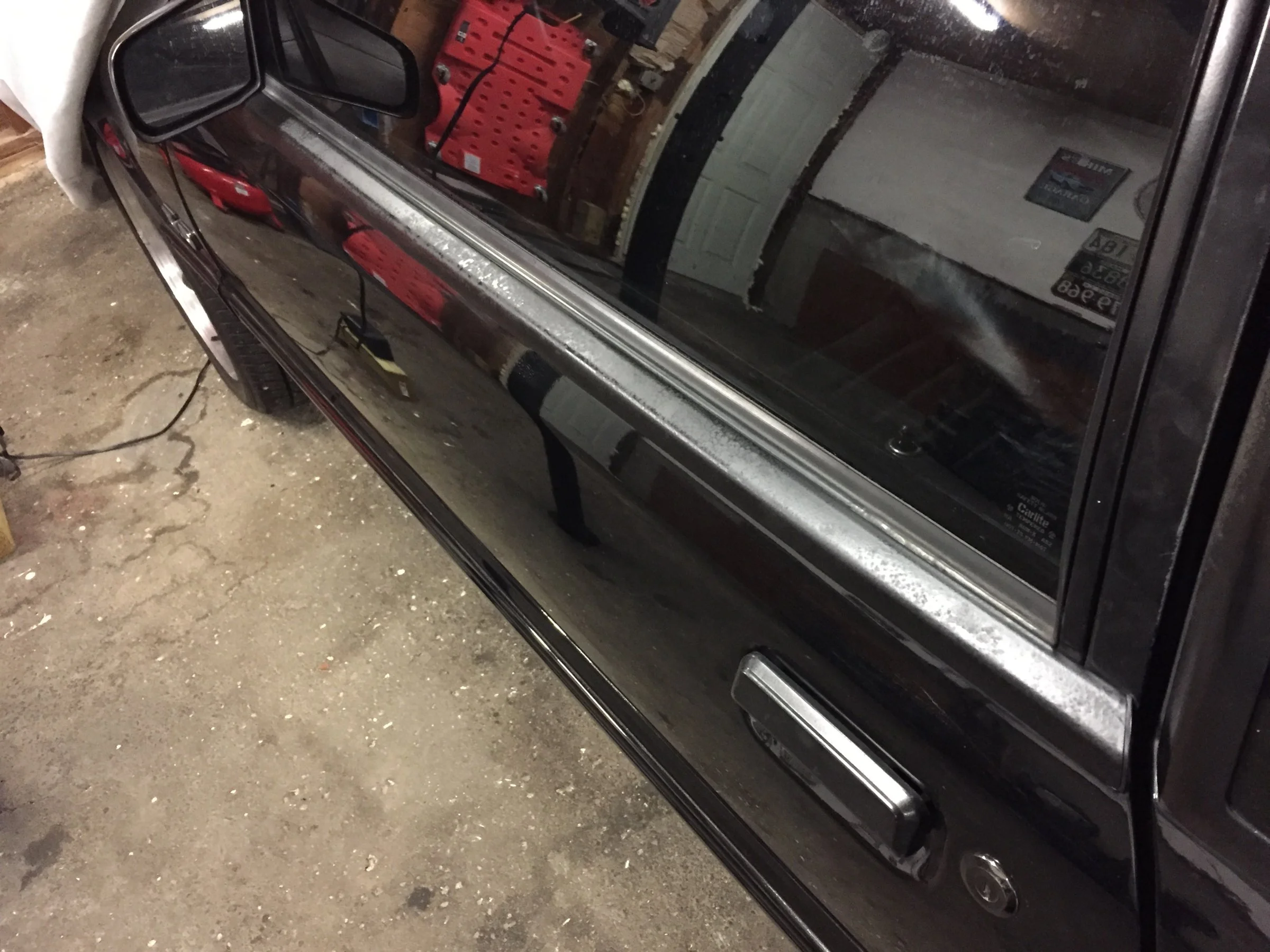

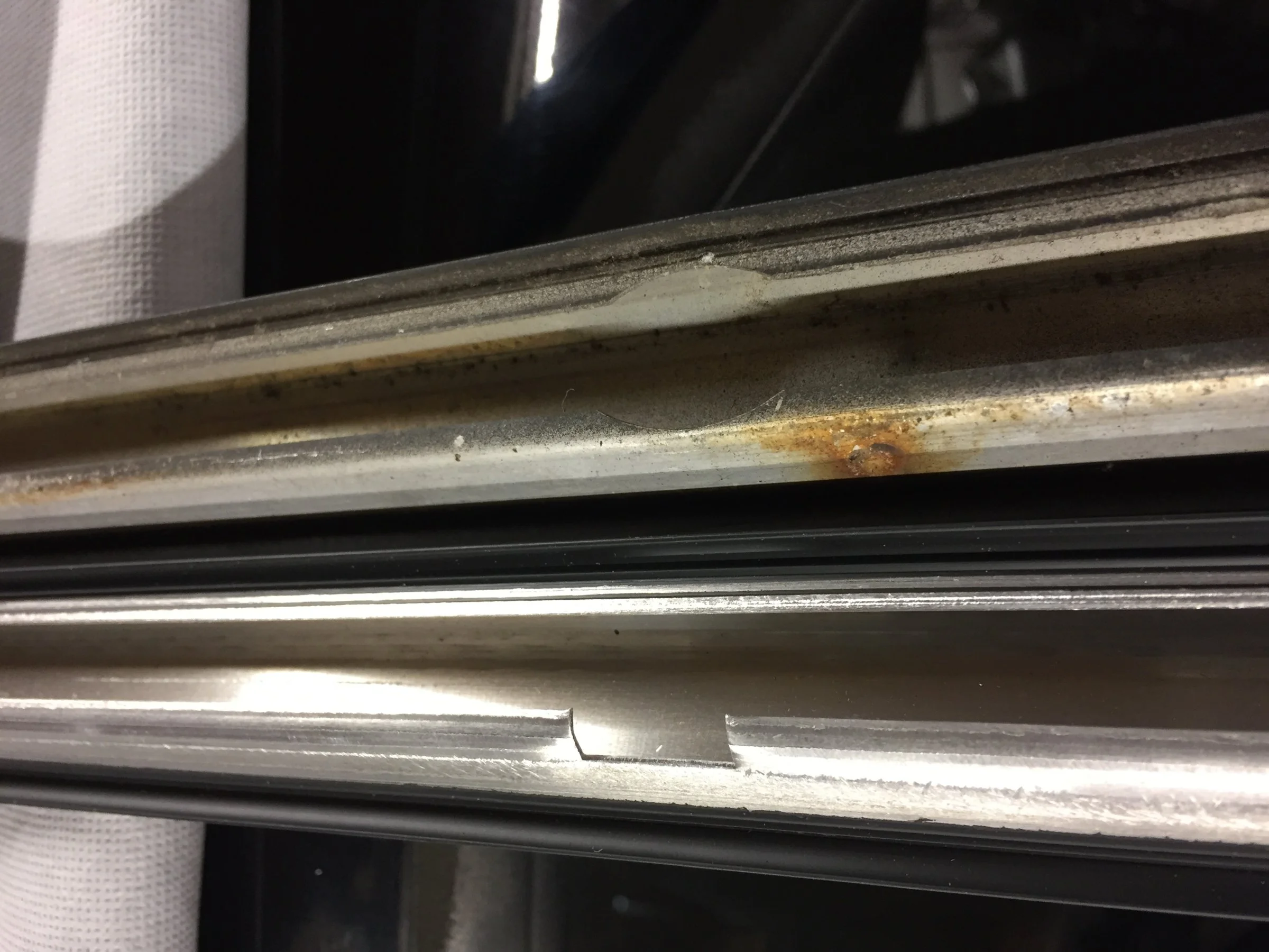

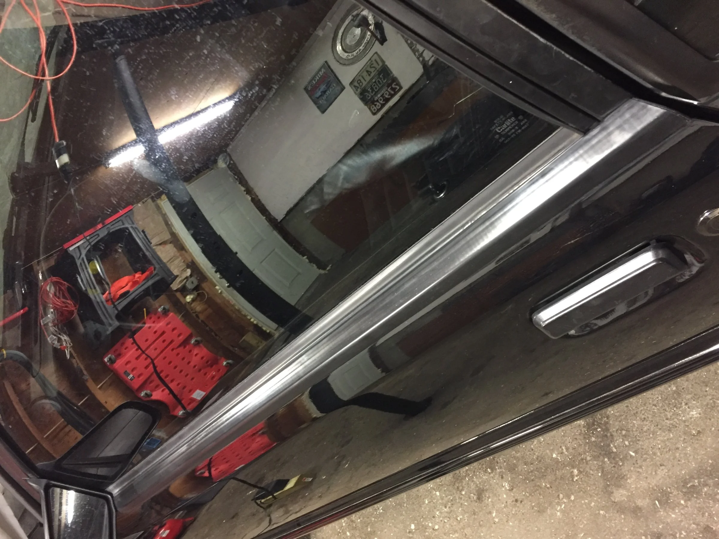

New belt moldings from American muscle. I tried to paint the originals using SEM trim black paint, but failed. It spotted badly
Comparing side by side, not a bad finish
Mounting setup slightly different, but still works fine
Bolted up, same as oem. Pretty good fit
They supply you with plenty of rivet clips, although I bought another batch of them a few months ago as I needed 1. Oh well

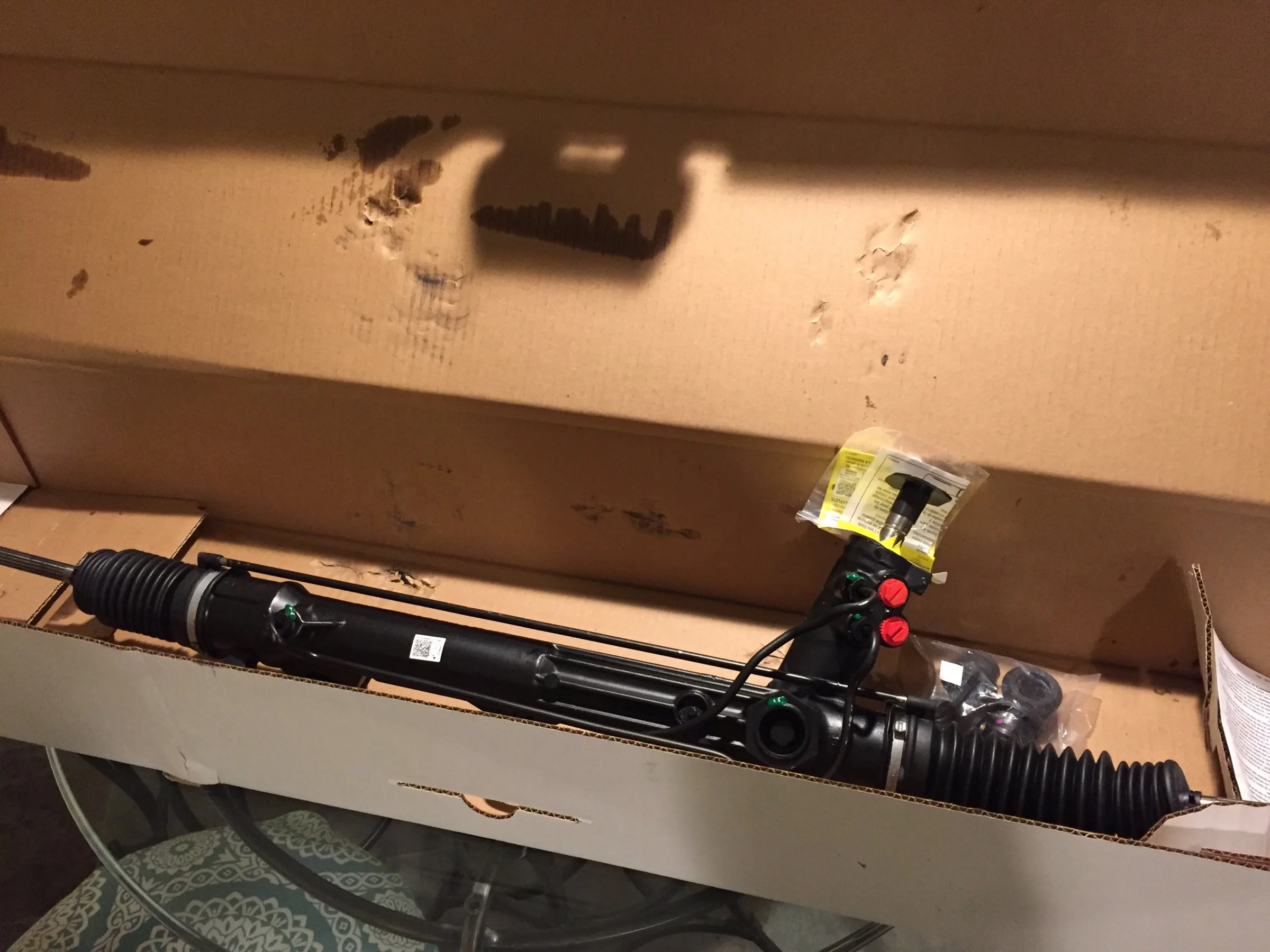

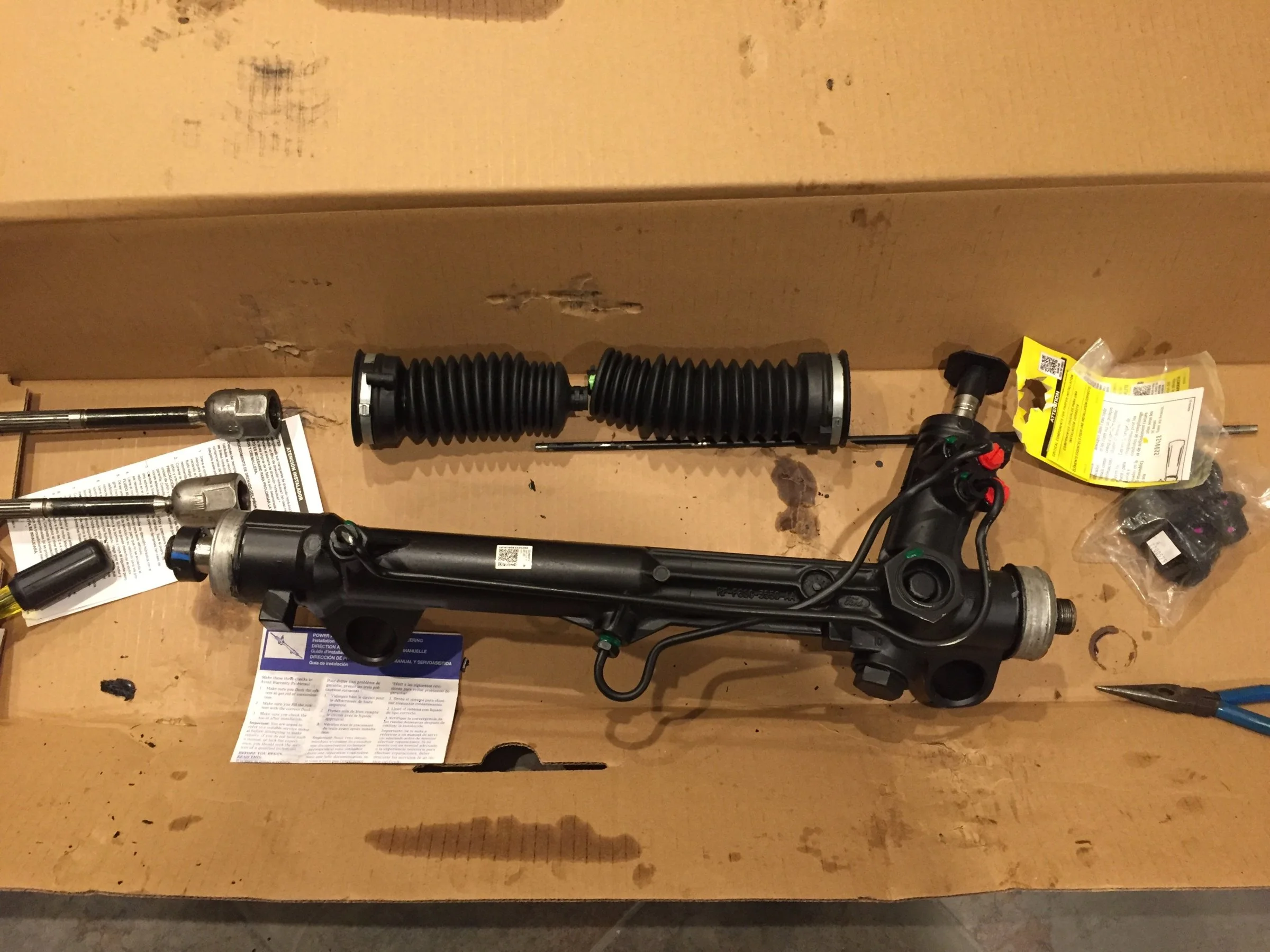

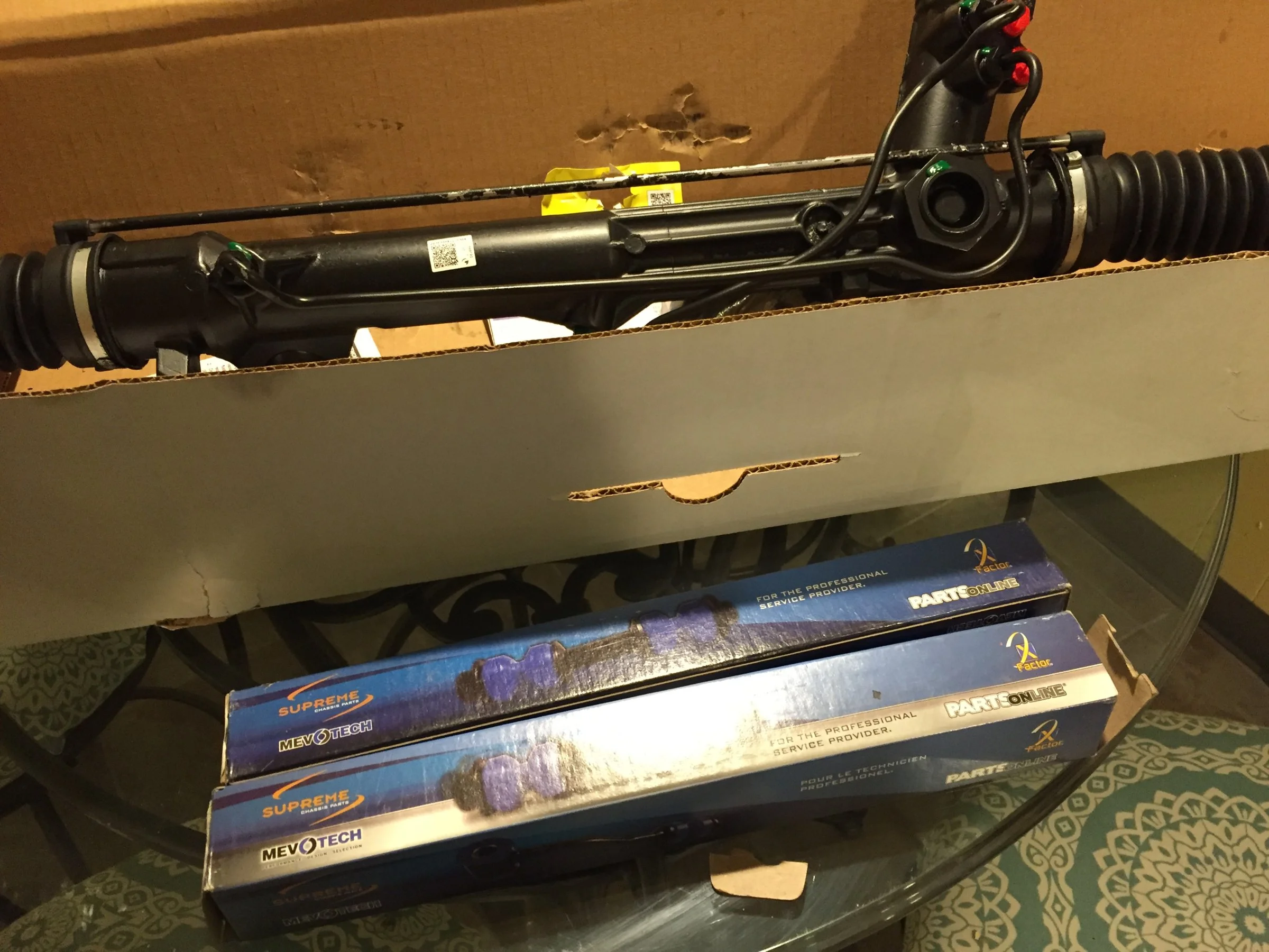

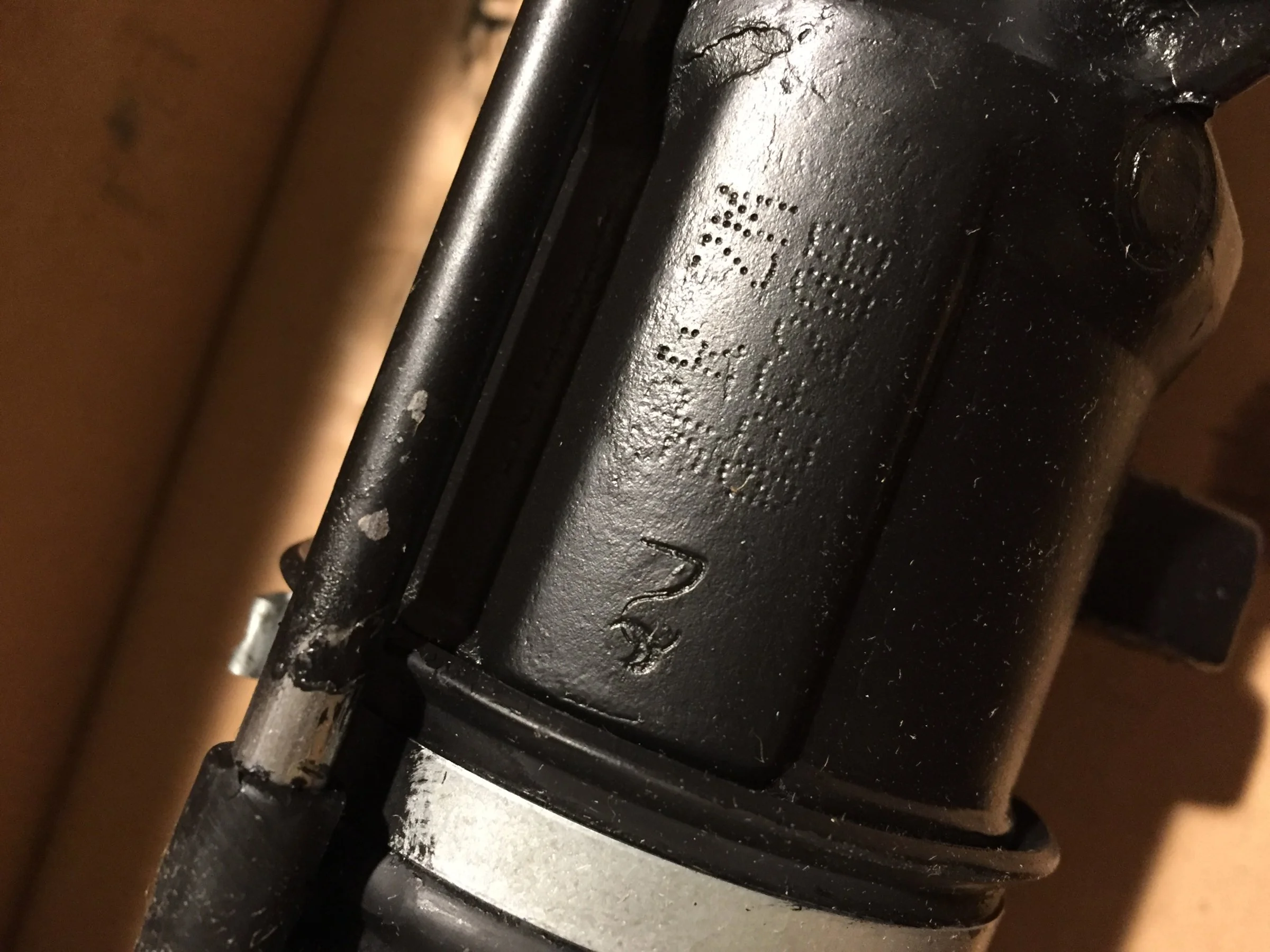

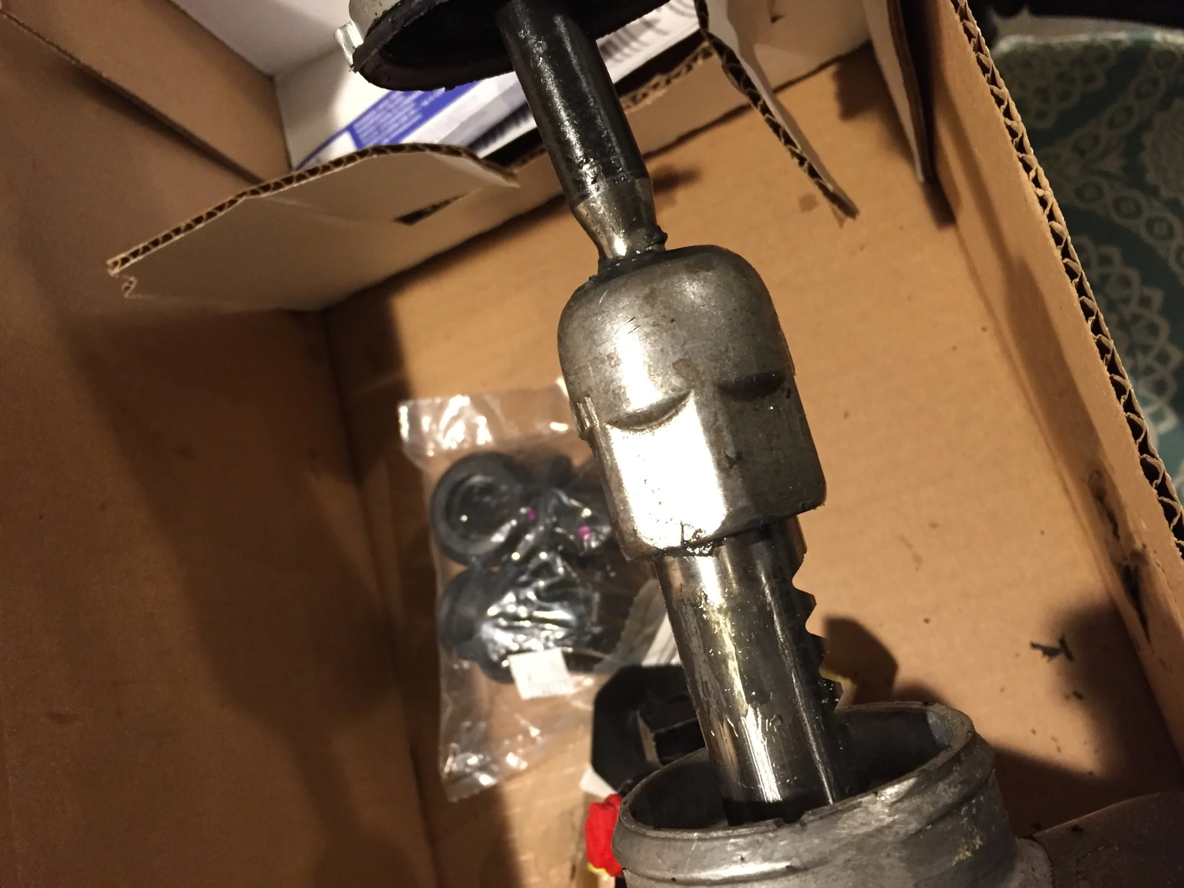

Got my rack in. Confirmed it's a SPR ZM rack.
I ordered a new set of inner tie rods. I'll swap them on the bench. MM steering rack adapter to be ordered shortly.

The fox outlets are SAE thread, while SN95 inners are metric. So you have a mixup.
Sn95 outers are longer, and don't work well with the shorter fox a arms

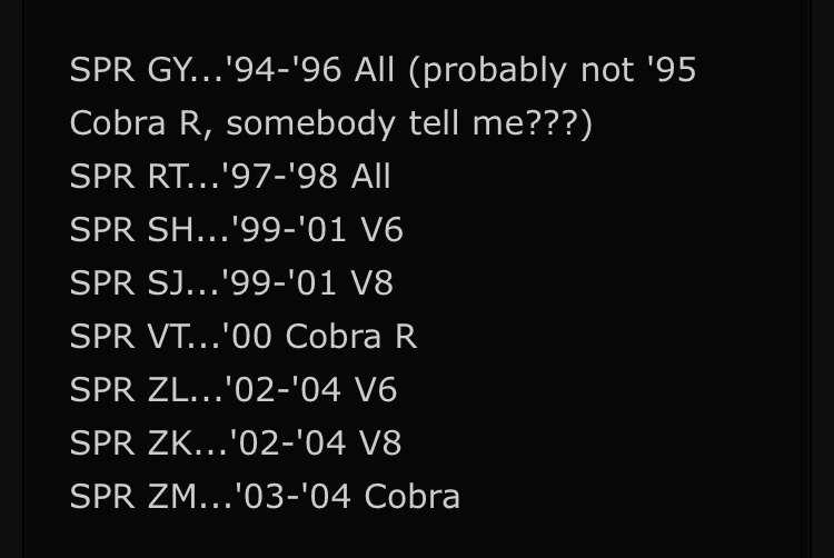

95BlueStallion said:
Forgive me for not Googling this and forming my own opinion, but what makes this particular rack better than say an SN GT version?
Stiffer torsion bar and spool valving. That means more of a manual steering feel/input before the power assist begins.
2000 R rack is supposedly the "best", with 03-04 cobra next and 02-04 GT/Mach after that.
Here's an unofficial sn95 rack breakdown.
The torsion bar diameter in the ZM rack is 0.230" in diameter. The bar diameter in a ZK rack is .212" in diameter
Also, the ZM rack comes with rack limiters due to the 275's they put on the cobra. I believe the only Sn95 rack with rack limited other than the ZM rack is the 2000 R rack since it had 265's on it.

jrichker said:
IRC, the inner tie rods are secured with an aluminum pop rivet to keep them from coming loose. The 2003-2004 Cobra may not have that feature, but the Fox body OEM original probably does.
Position the rack so that once it is extended as far as it will go and see if there is a pop rivet. Use a 1/8" drill bit to drill out the pop rivet if it is present. Do the other side the same way...
No pop rivets here.
However they sure are on tight! Trying to get both sides off now. Prob would be easier to do on car, but I want to do on bench to get the tie rod end lenght matched up well
Also, you'll notice the 03-04 cobra rack limiters I talked about are not present. I'll prob pick up a set and install.

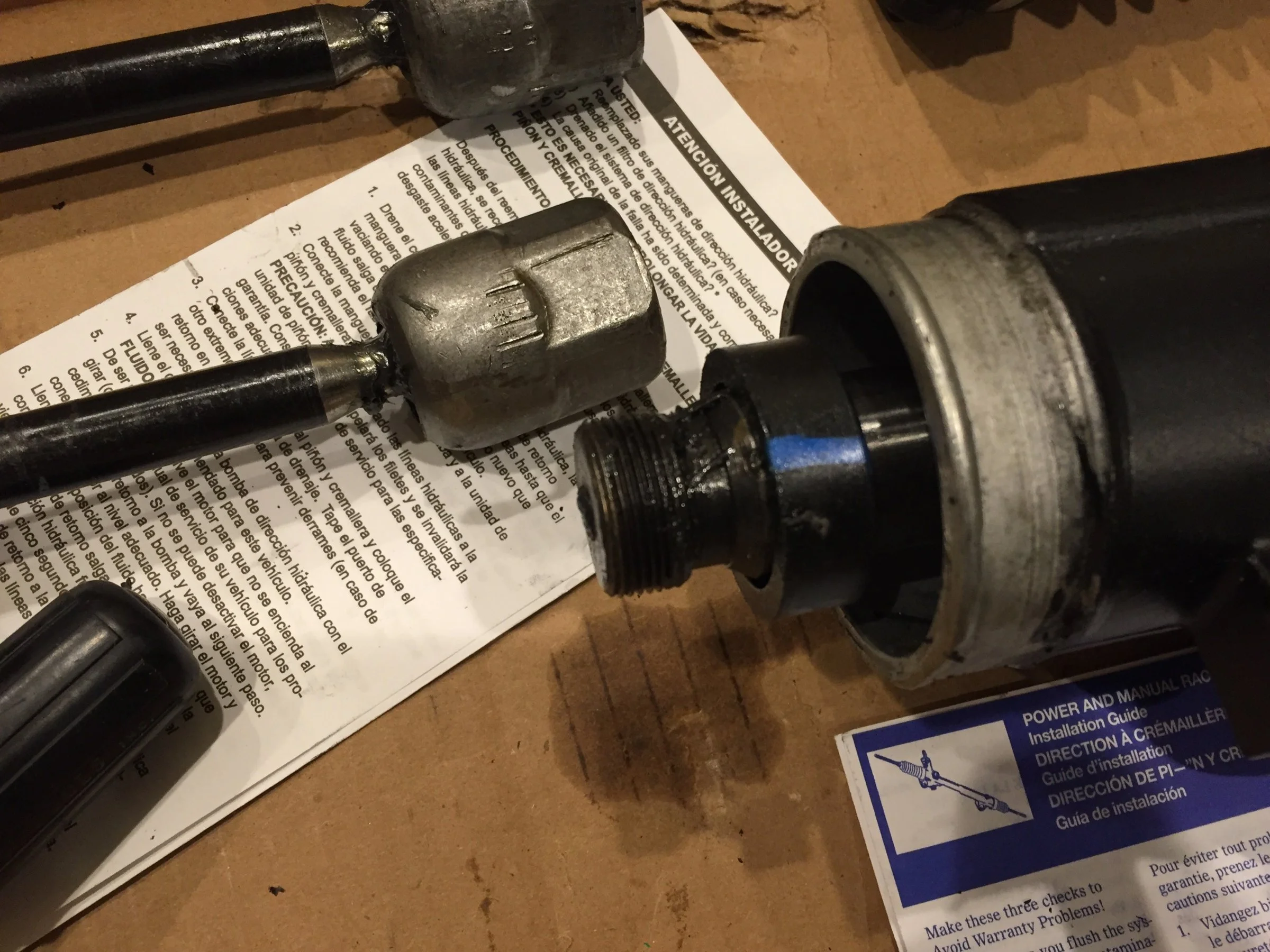

Scratch that. One rack limiter was present. Gives me hope they did rebuild it to 03/04 cobra specs. The bellows are ford marked as well.
The shaft does have the recess for the fox body roll pin

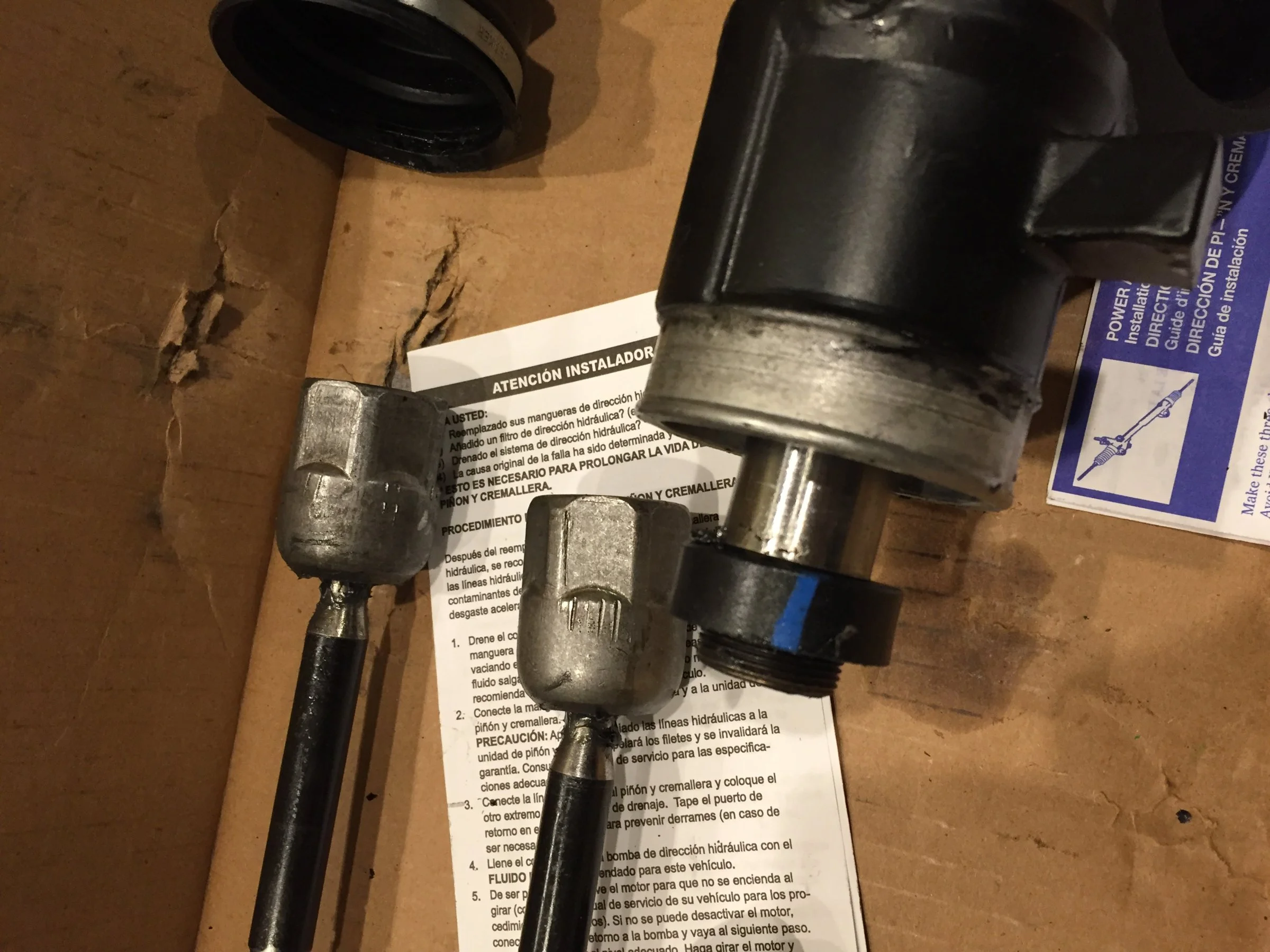

Inners off. Awaiting the fox inners in the mail.
I haven't purchased new outers yet. Was going to reuse mine, but at this point I'll just buy new ones.

Tie rod end arrived. They do have the roll pin. Will get these installed shortly. Also, end links, and power steering hoses on the way.

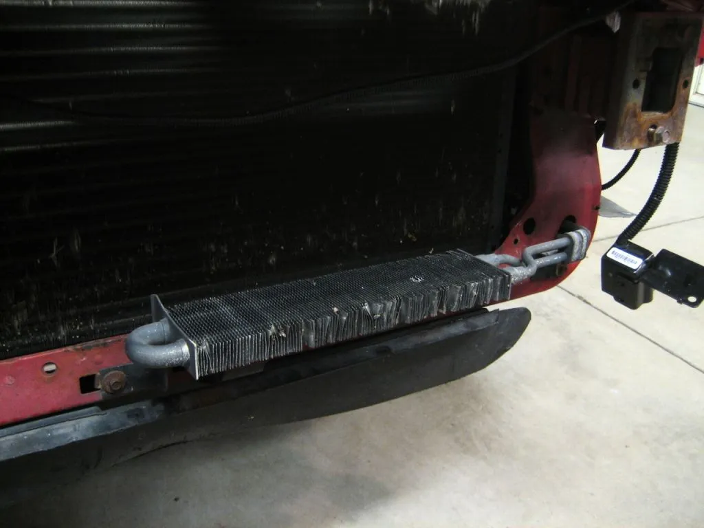

So, since all the PS lines are cheap, I ordered up all gates replacement lines. A reman pump is $35, so why not. Considering I am replacing my entire system, I thought I'd ditch the stock tube cooler and put a real cooler in.
I know I could get a $25 cooler and call it a day, but not happy with how most have to mount.
Since I'm all about factory style mods, I decided to see if ford did a real cooler in the SN95 and they did in the 94-95 cobra and all 96+ v8s.

Welp, reason for the addition of the cooler on the 96+ cars was because of the hydroboost also running off the same system.
Still going to add it the PS cooler. Tons of guys complain about boiling over their PS fluid during AutoXing. While I'm not currently autoXing the car at this time, I'd like to build it to be capable of competing in an event, so that's why I'd like to add the cooler on a car currently only street driven.

I took a step back on the cooler. Might select a different model, but my concern is routing the lines in a clean spot. Might revisit searching for a SN95 cooler

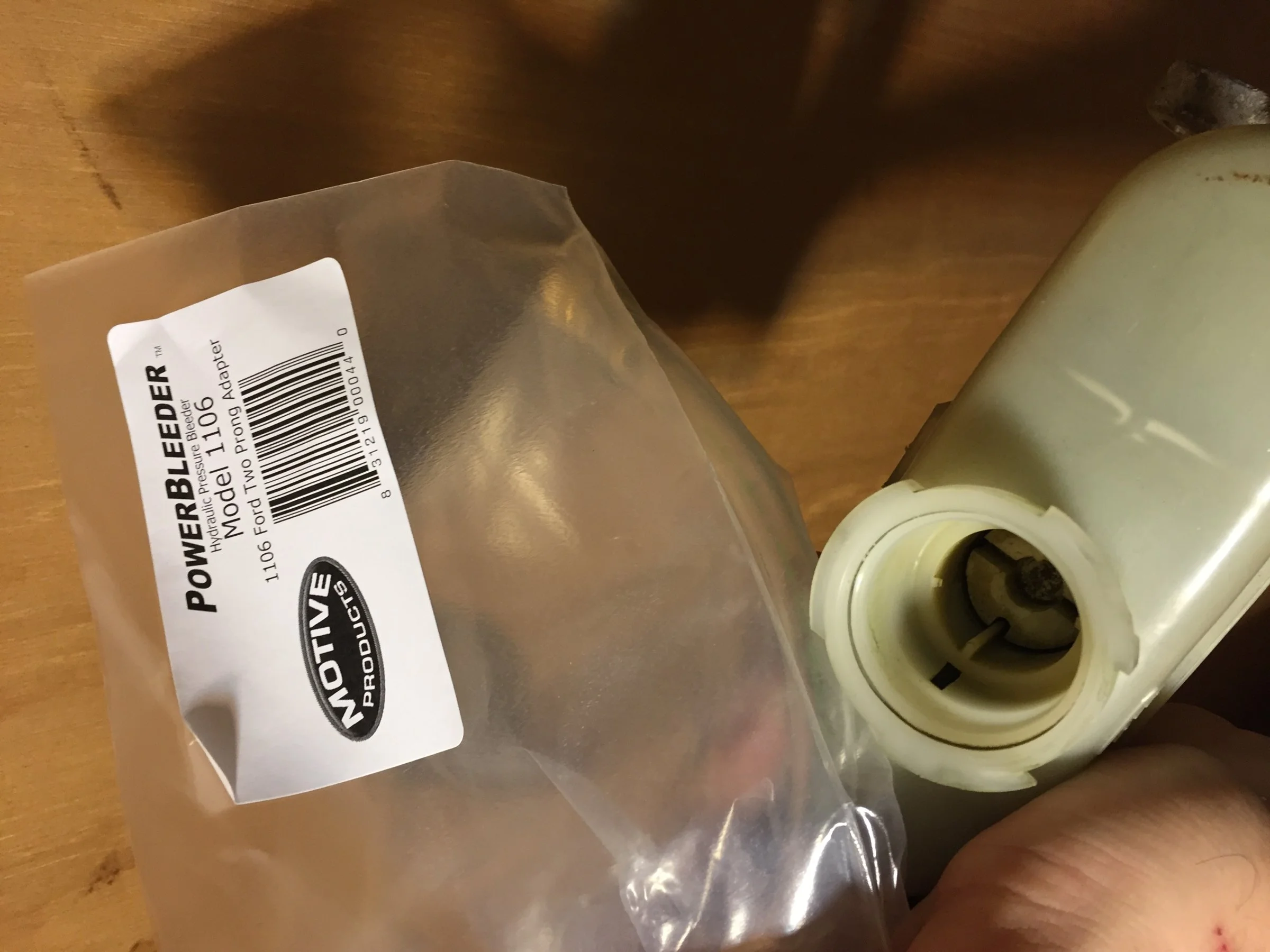

went to wrap up my brake bleeding. Decided to test fit the bleeder to a spare MC first.
Hmm. What's wrong here

Ummm, nothing in the bag to bleed with?

Ah, now I see it. Two prong.
