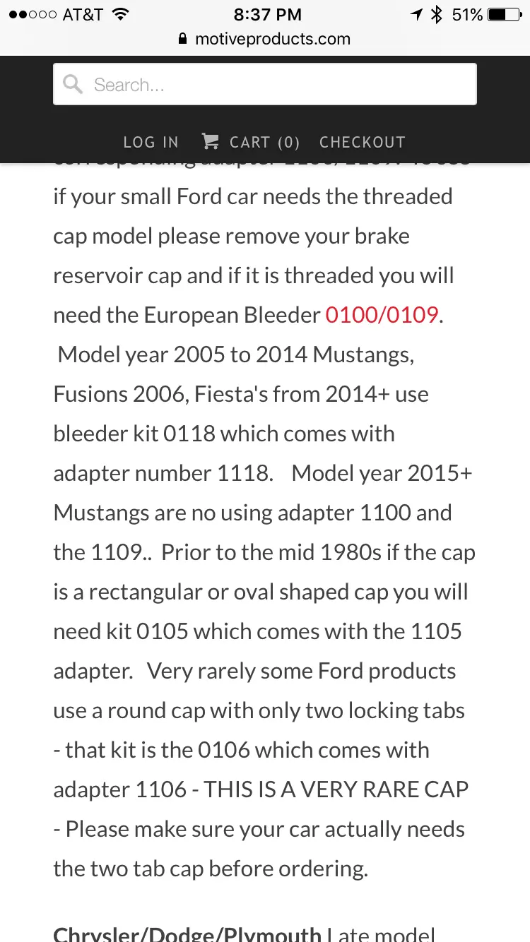

95BlueStallion said:
Ah, now I see it. Two prong.
I needed 1107, not 1106.
Figures, there goes my chance of selling it off to recoup my costs.

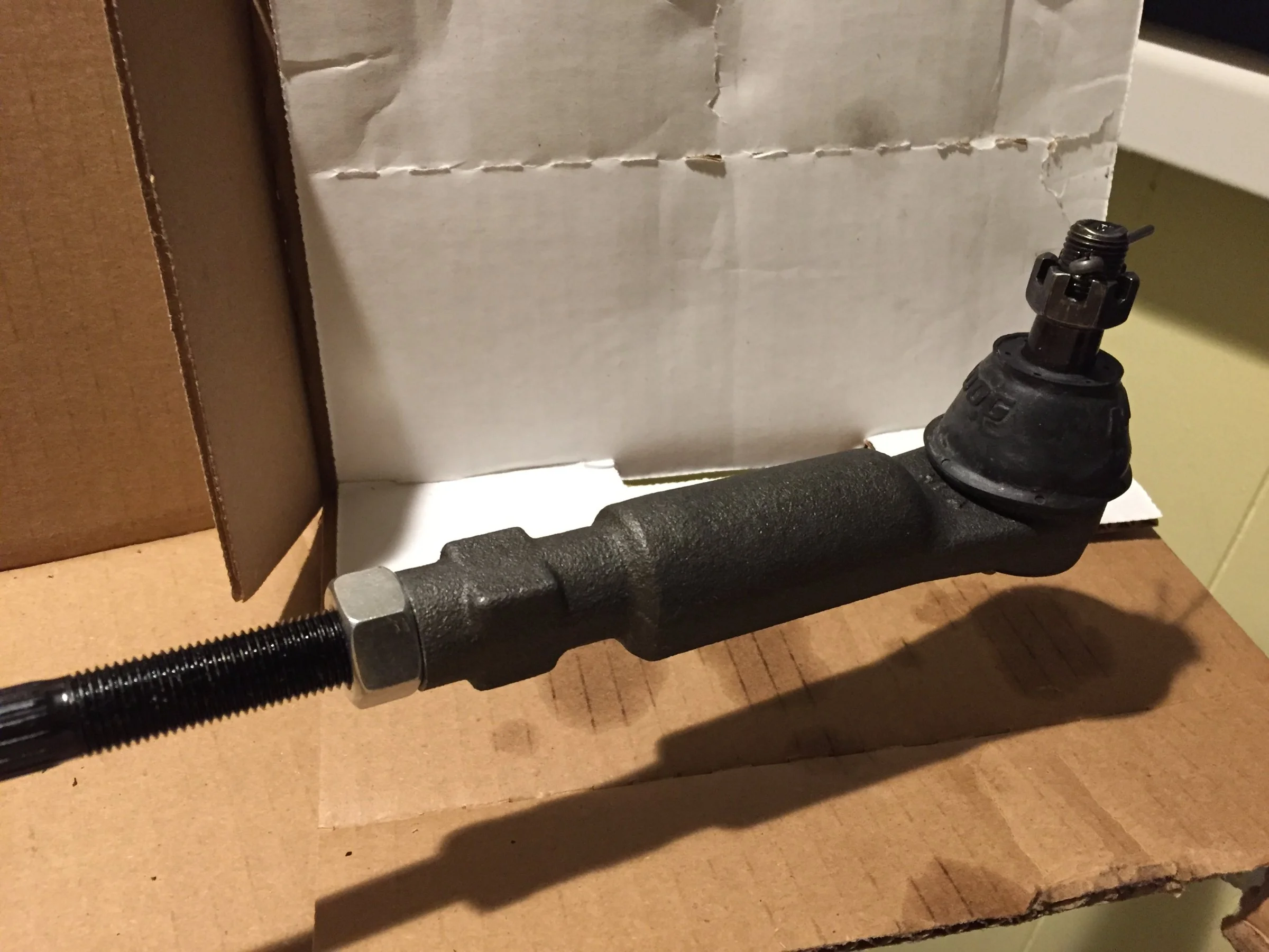

Got the new inners installed. Simple job. I ordered a set of rack limiters while I'm here to deal with the wider tires.
Outers should be here tomorrow, I'll get those on. Should be ordering the max motorsports adapter shortly.
Next step is to remove the old rack. Should be fun. I need to rebleed the brakes first as I hate leaving things incomplete. Adapter should be here next week. Once I'm satisfied with pedal feel, I'll pull the old rack off.
Old sn95 inners

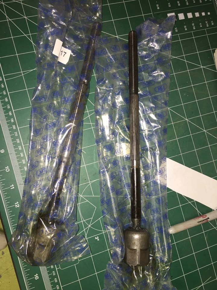

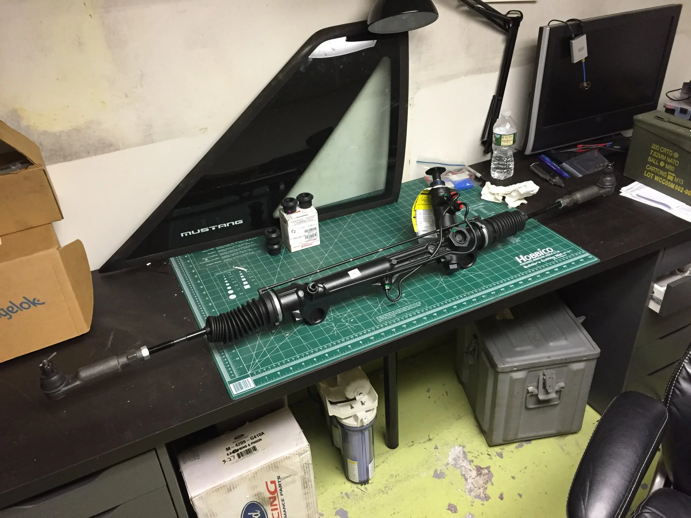

End links arrived. The moog pieces are quite nice. Some good heft to them, and grease fittings. The grease looks to be good quality too.
Forgot to add, the inners were from Mevotech. I've used them for suspension parts on my Infiniti and they were decent quality. They were much better than the endlinks cardone stuck on there. Machining was better. Better finish, better quality grease.

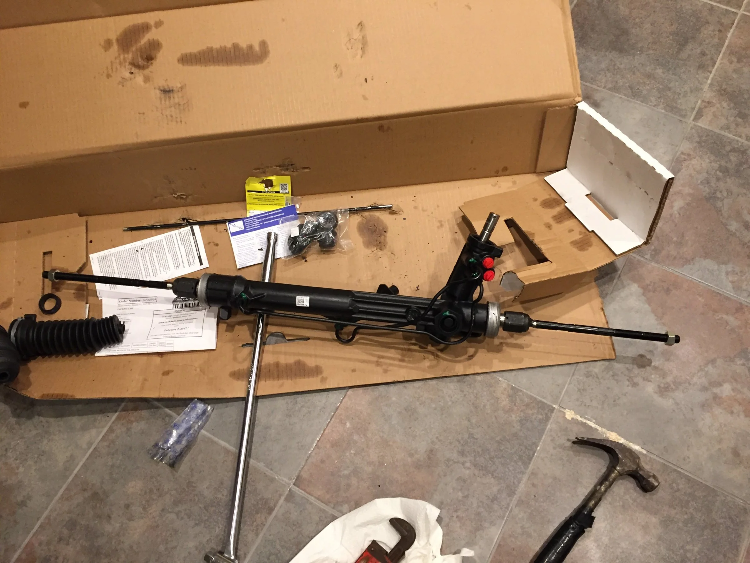

Rack is assembled. My rack limiters will be here Friday. At that point time to remove the old rack and try and match end link lenght.

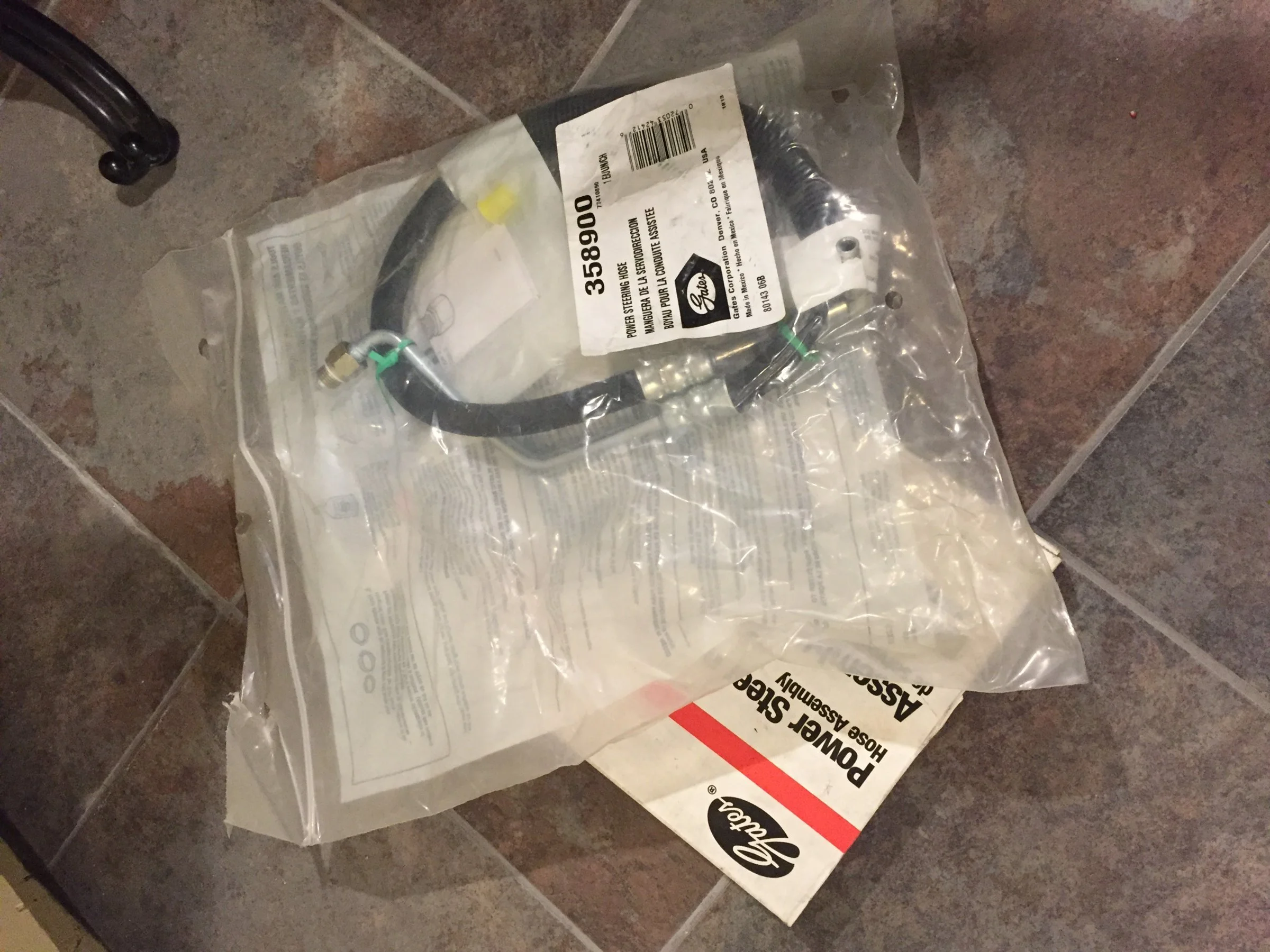

Also, new PS hoses. Using new hoses along with a cooler. TBH not impressed with the high pressure line. Doesn't look oem and has a different "look". also doesn't feature the band that the factory clamp secures to to hold the hose in place.

When I did my Cobra Rack I had the same idea to buy new hoses and they sent me those same Gates ones, after getting the rack installed I went in the house for the night and when I went back to the garage the next day only to find the pressure line leaking from the nut, the Ford service manual said if it leaks from the nut the hose is bad, so I dug my original out of the trash and installed it, I was pissed cause I had to undo everything to slide the rack forward to remove that damn hose, I also recall a handful of other people on the forums having that same hose leak from the nut on them too. I also went with Proforged Inner and Outer Tie Rods, everything I shopped for looked cheap and had a 1 year warranty, the Proforged is beefy and had a helluva good warranty.

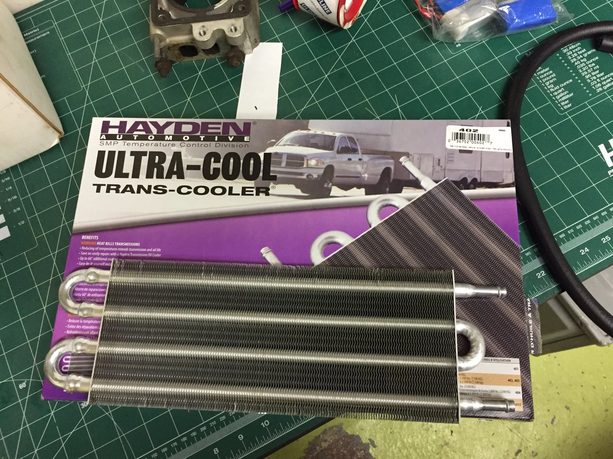

Amazon fails again.
The PS cooler I thought i ordered was not what they sent me.
Anyone need a trans cooler rated for an F350?

Nevermind. Opened the box and saw it's not as big as I thought. Should work nicely.

As for the PS hoses, I'll make a decision when the time comes.

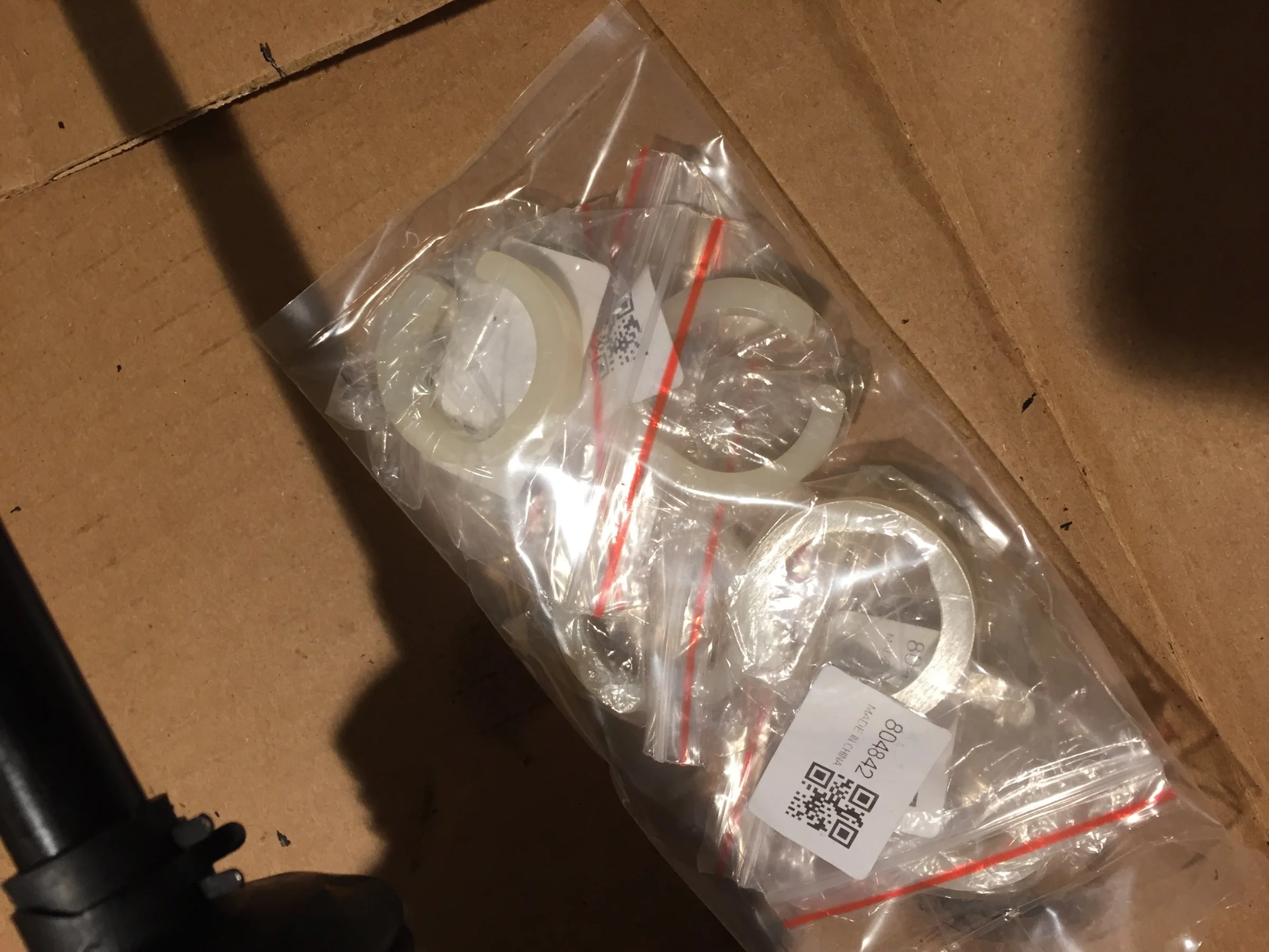

Decided I should prob order aftermarket steering rack bushings while I'm here. Makes sense.

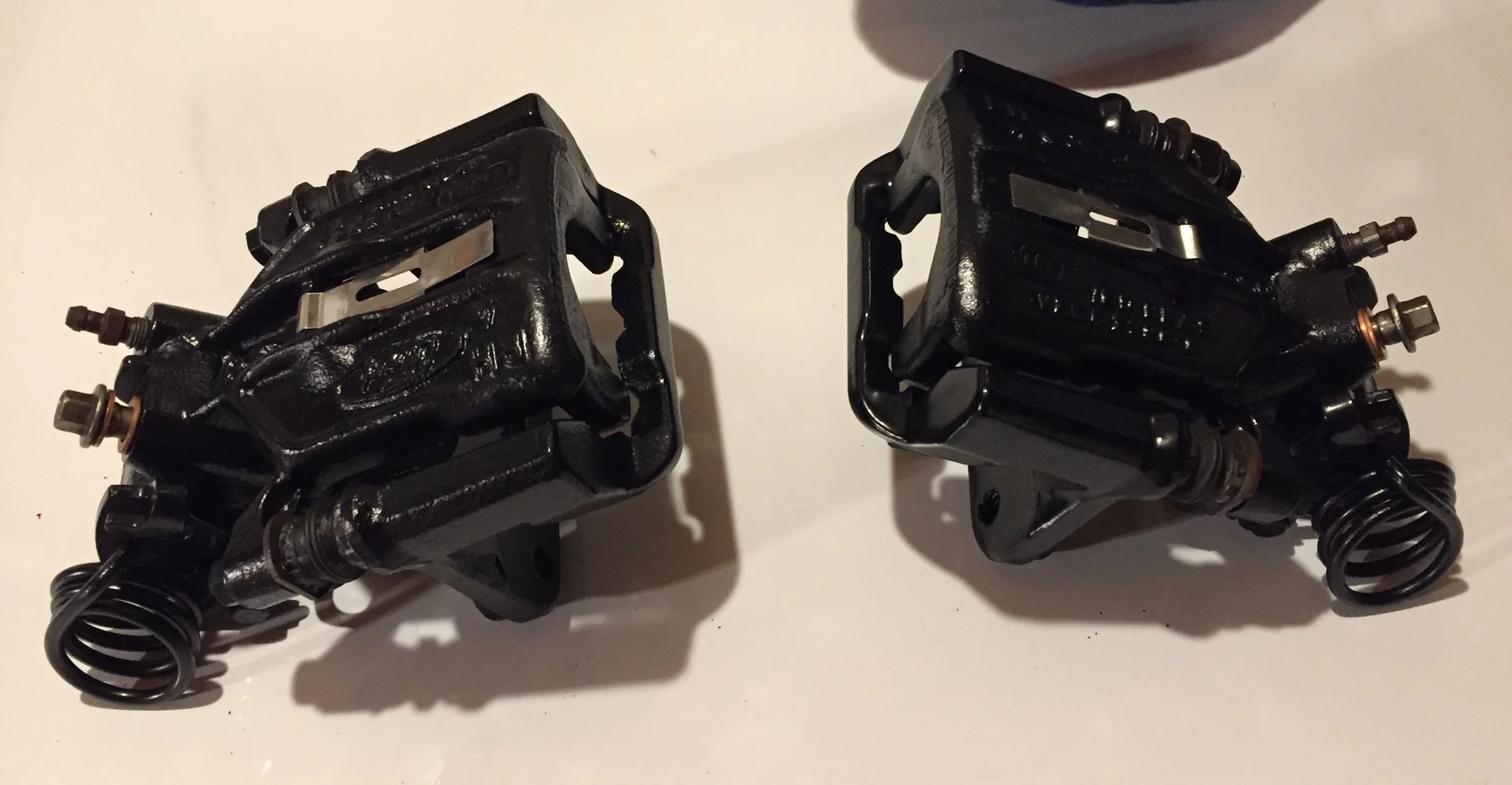

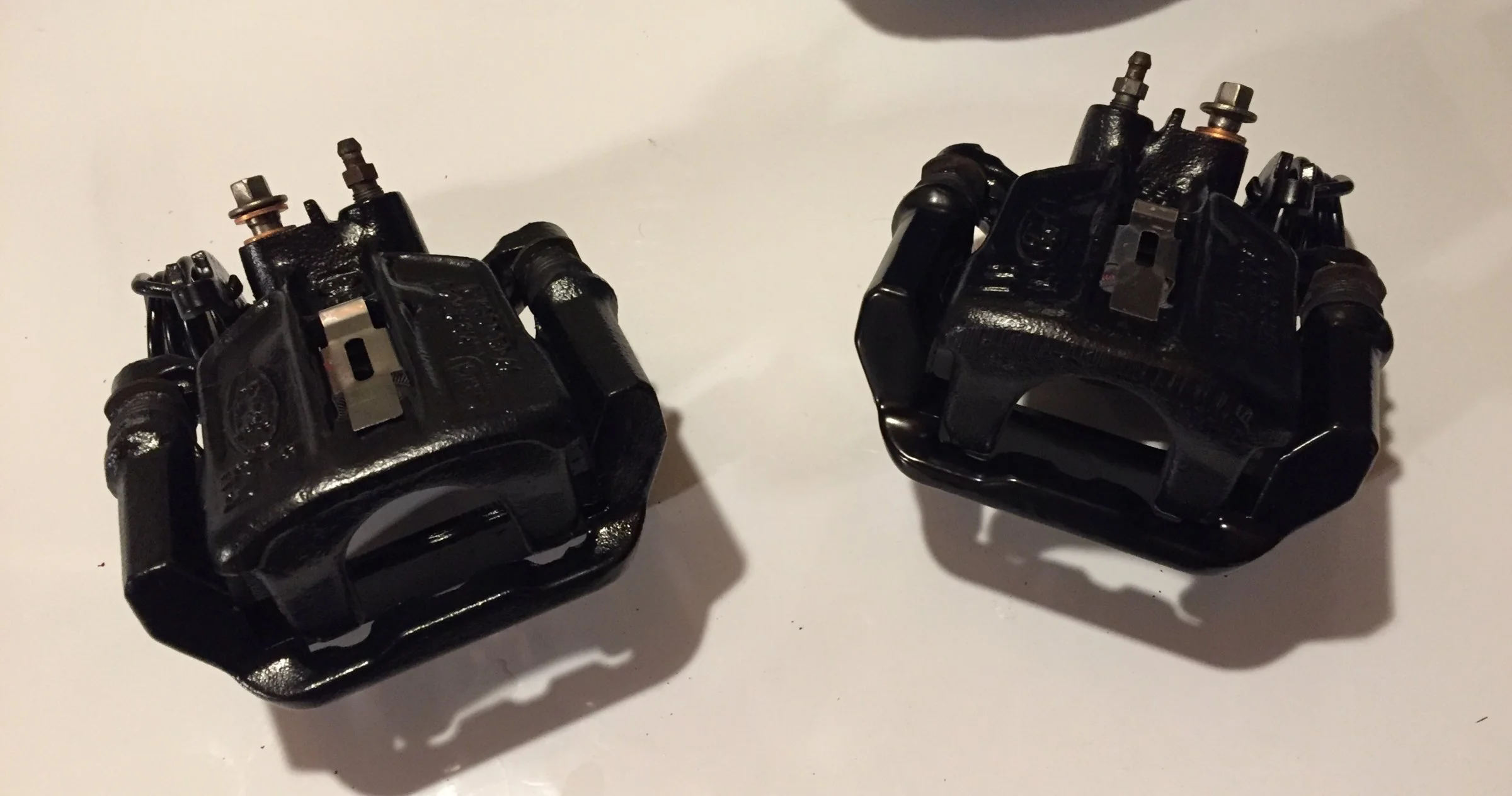

These cleaned up pretty well. Removed all the old paint, degreaser, and some fresh black paint.
Time to work on the old Mach 1 fronts now. Just gonna paint them black like original
Reactions: a91what, 90sickfox, A5literMan and 2 others

Front ones didn't come out so well. Not even gonna bother posting pics of them. Gonna list them all on the bay and see what I get.

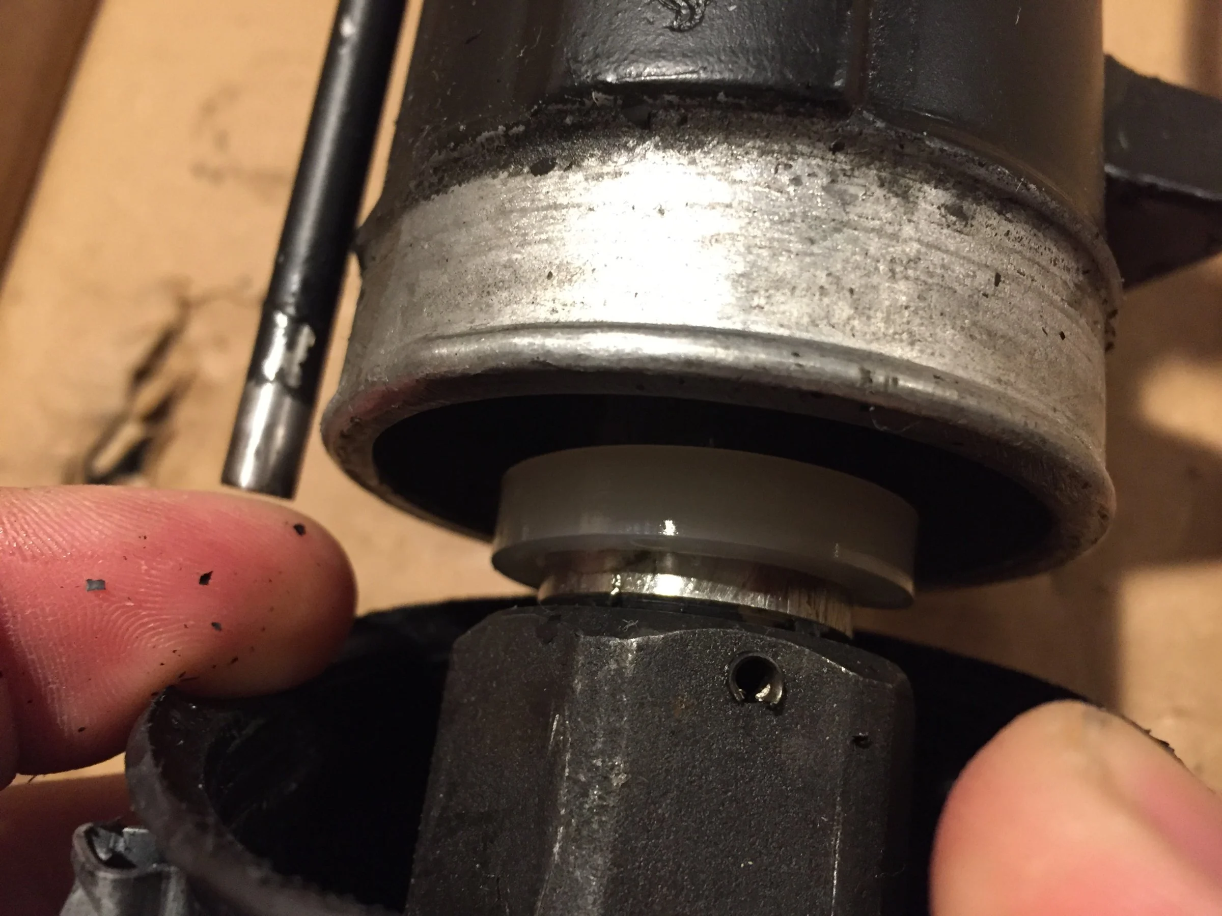

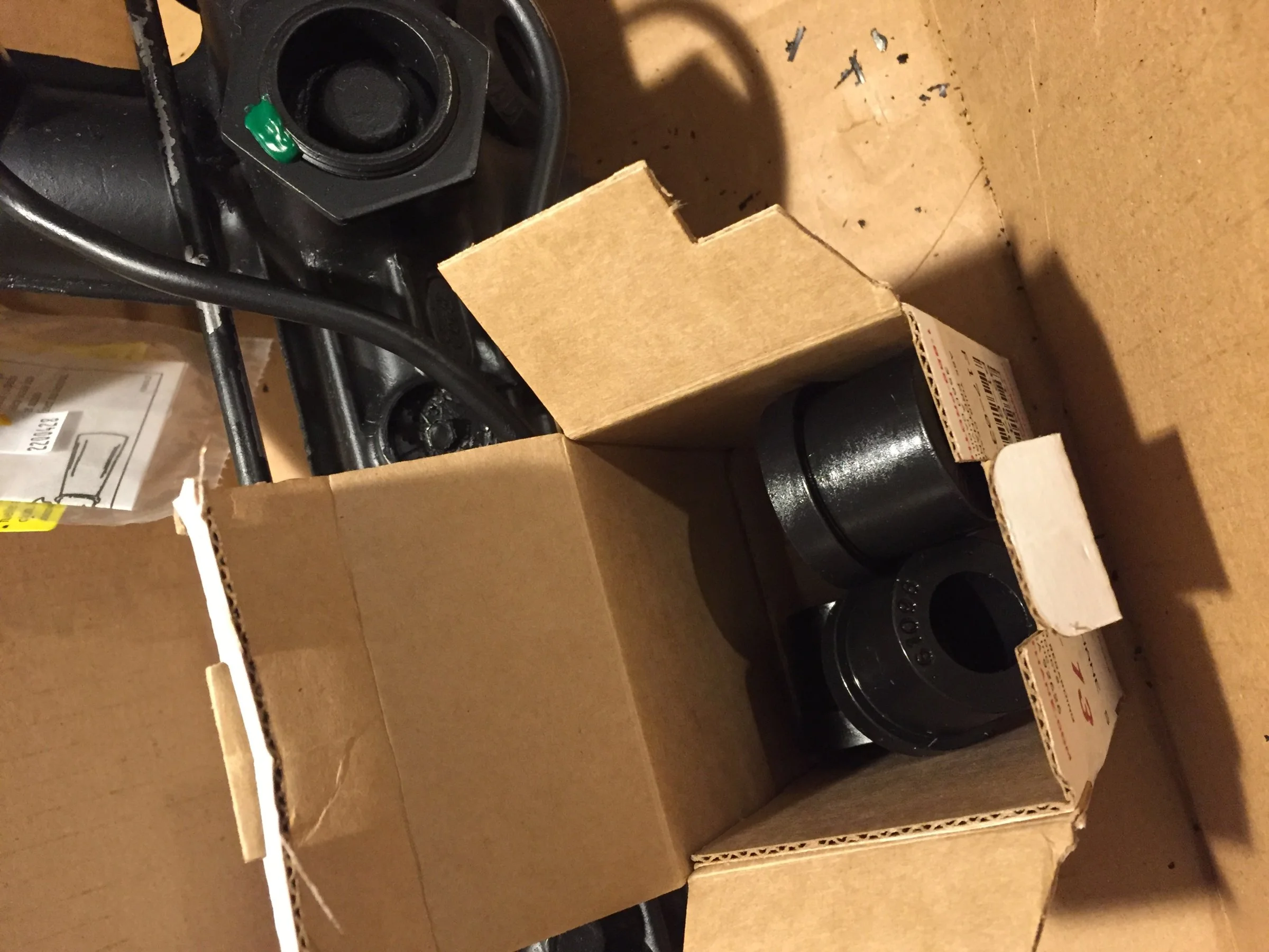

Back to the rack. Bushings came in. Very firm compared to what came with rack

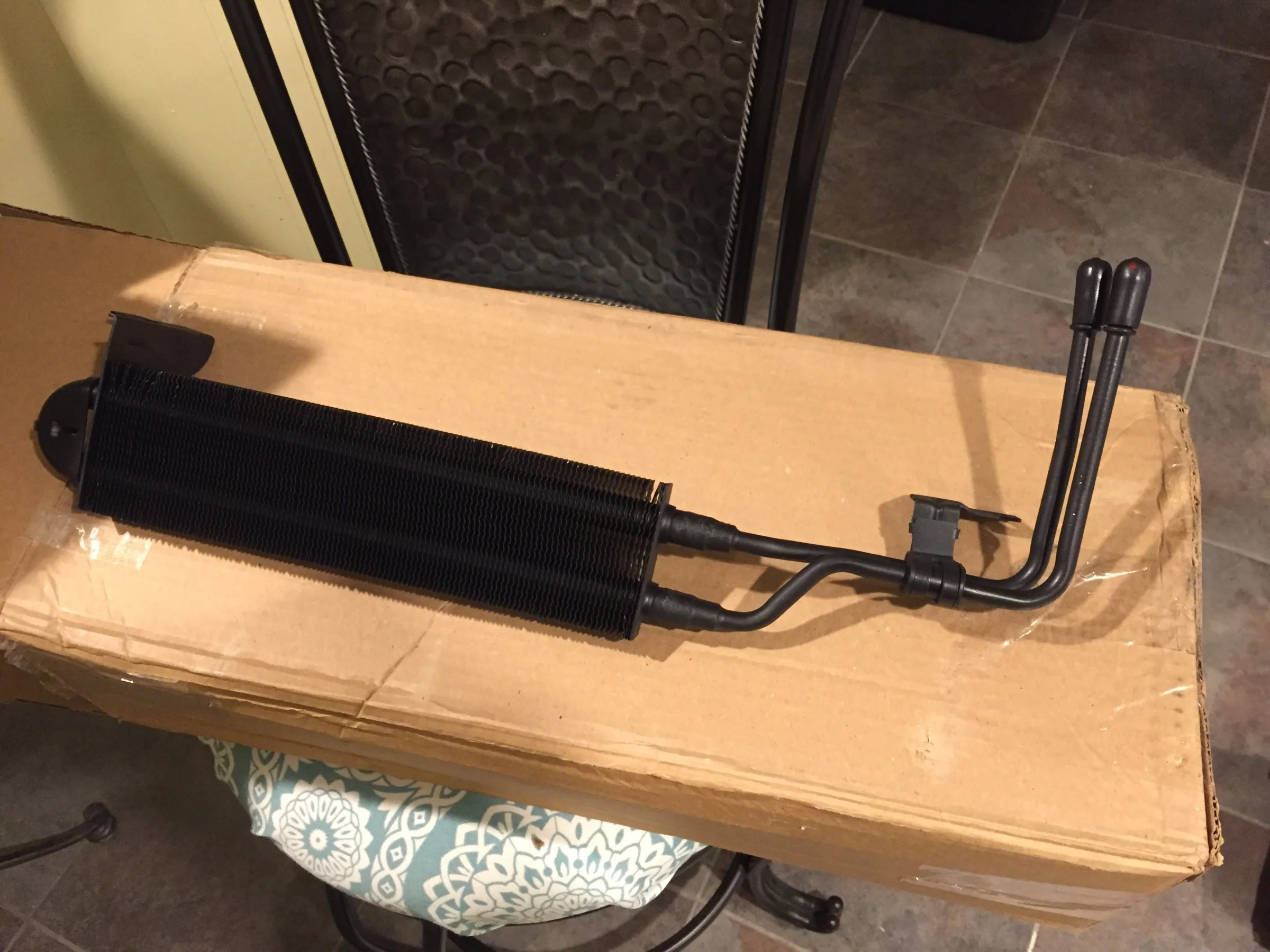

I know I said I wouldn't do this, but i bought an OEM cooler and returned the one I got from Amazon.
I just prefer oem style installation, and even though this was $100, in my mind it's "done right" so to speak.
Just waiting on MM rack adapter. It's ordered, paid for, just not shipped yet. Last component I need before I start this install
Total cost so far? $590

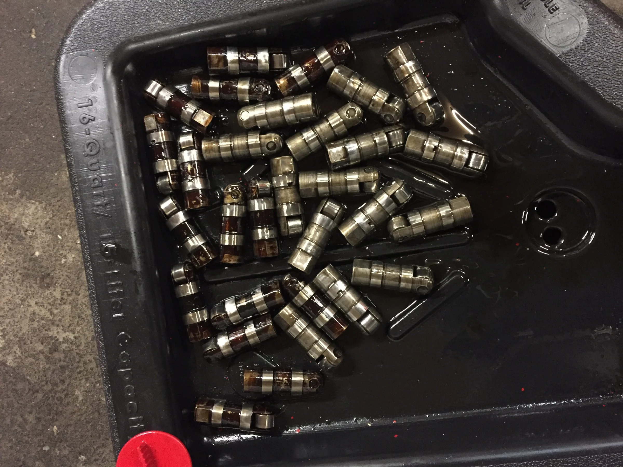

Listed a bunch of stuff on eBay and going through my hoards of mustang parts. Any reason to keep these? Two sets of 15. No idea where the singles went.
Sitting in oil for 10 years. Any reason to save them? I certainly have no desire to install used lifters.
