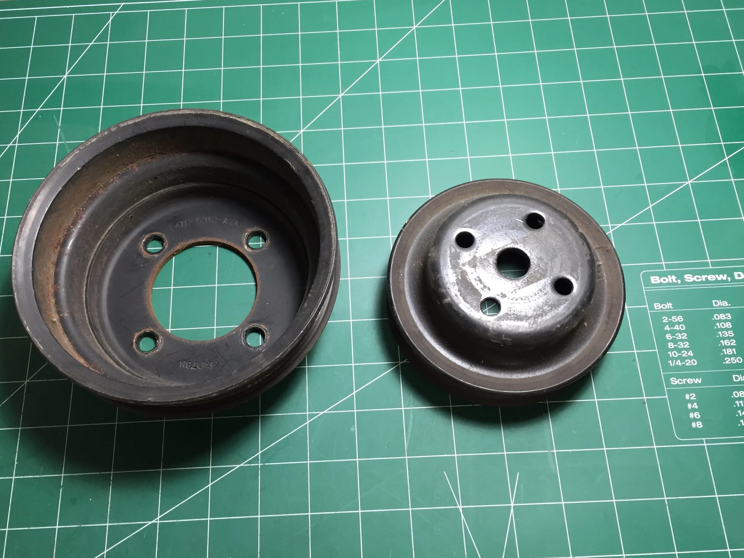

Also an eBay snag. Found a set of stock pullies for cheap for once. $30 shipped on eBay. Sadly I think I sold my stock pullies years ago for $5. Amazing how much stock stuff is worth these days.
I'll toss these on in the future. I just put a new belt on and not wanting to play musical belts any time soon again
Unsure if I need hardware or can just use the ones with my underdrives

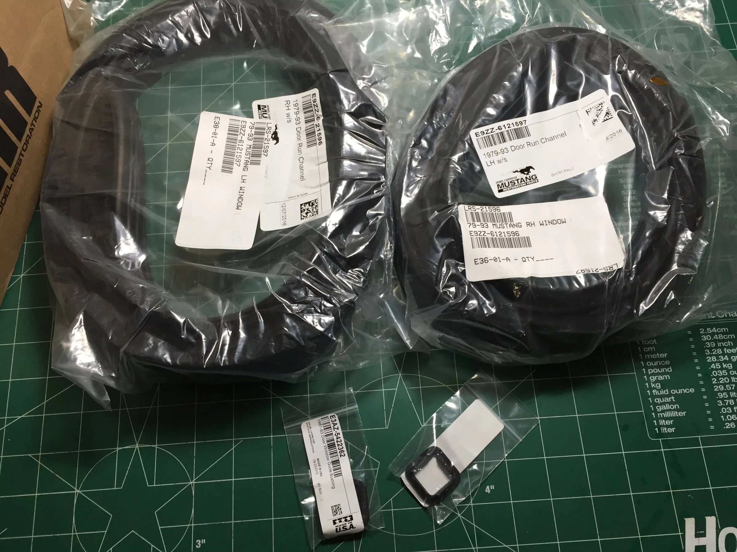

Also, resto parts. New window guide bushings for one door, and run channel molding for both sides. Decided I had lived with my drivers window bouncing on the way down long enough.

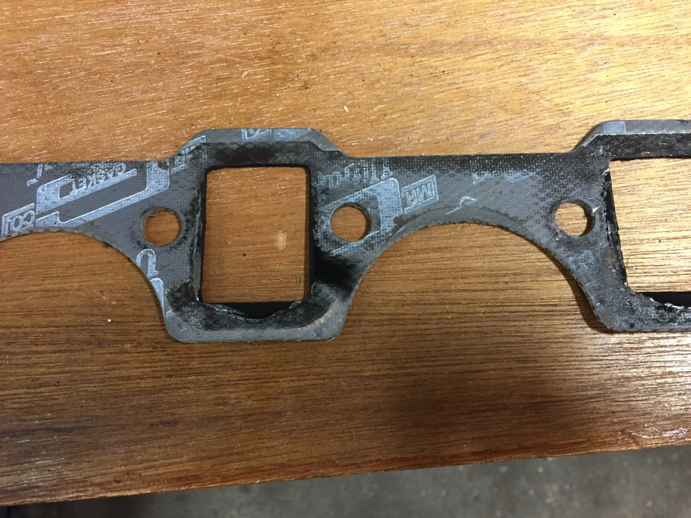

Ordered fel pro header gaskets and picked up high temp paint for headers. Figure if I'm gonna dimple the header, I take it out and do it neatly. Unsure if I'll do this right this second or wrap up the lines and fluid on the PS rack first and give it a test.
I found this video interesting when wondering how much dimpling is too much
Hate the fel pros . I've had awesome luck with the mr gasket ultra seals. Autozone carries them on the shelf in there "high performance " section

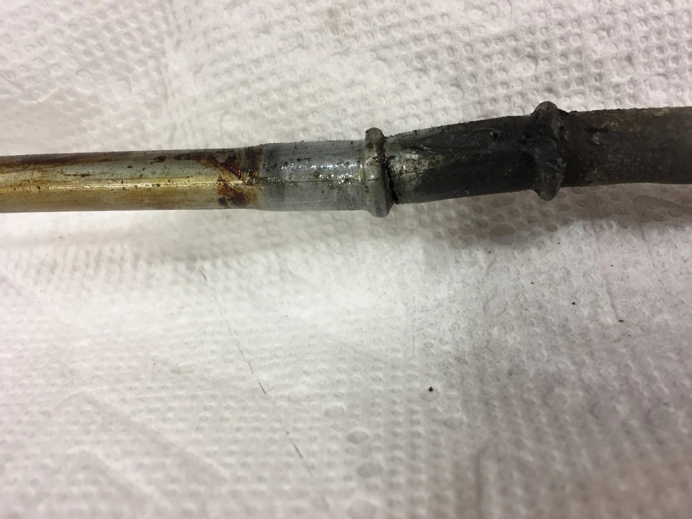

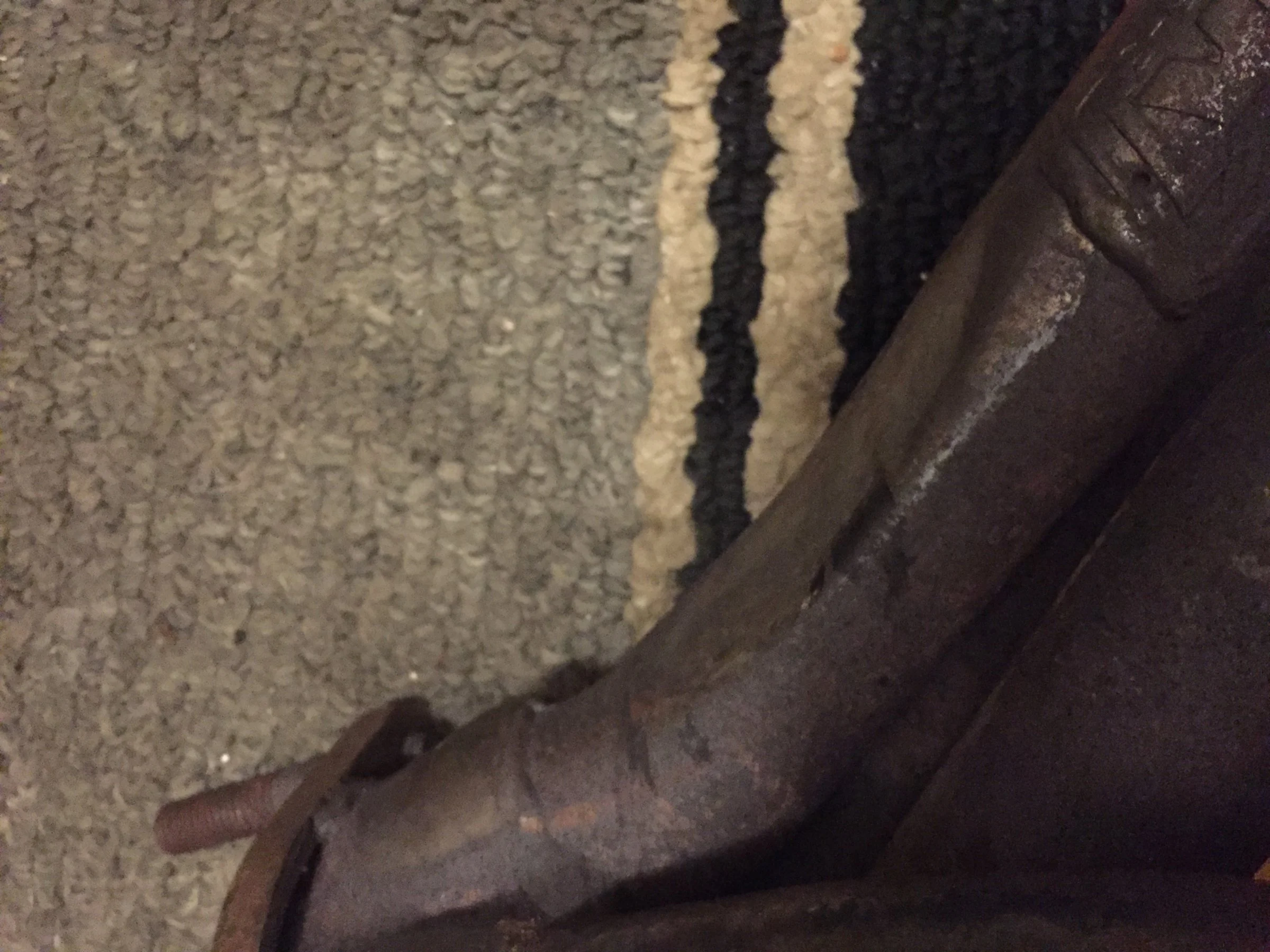

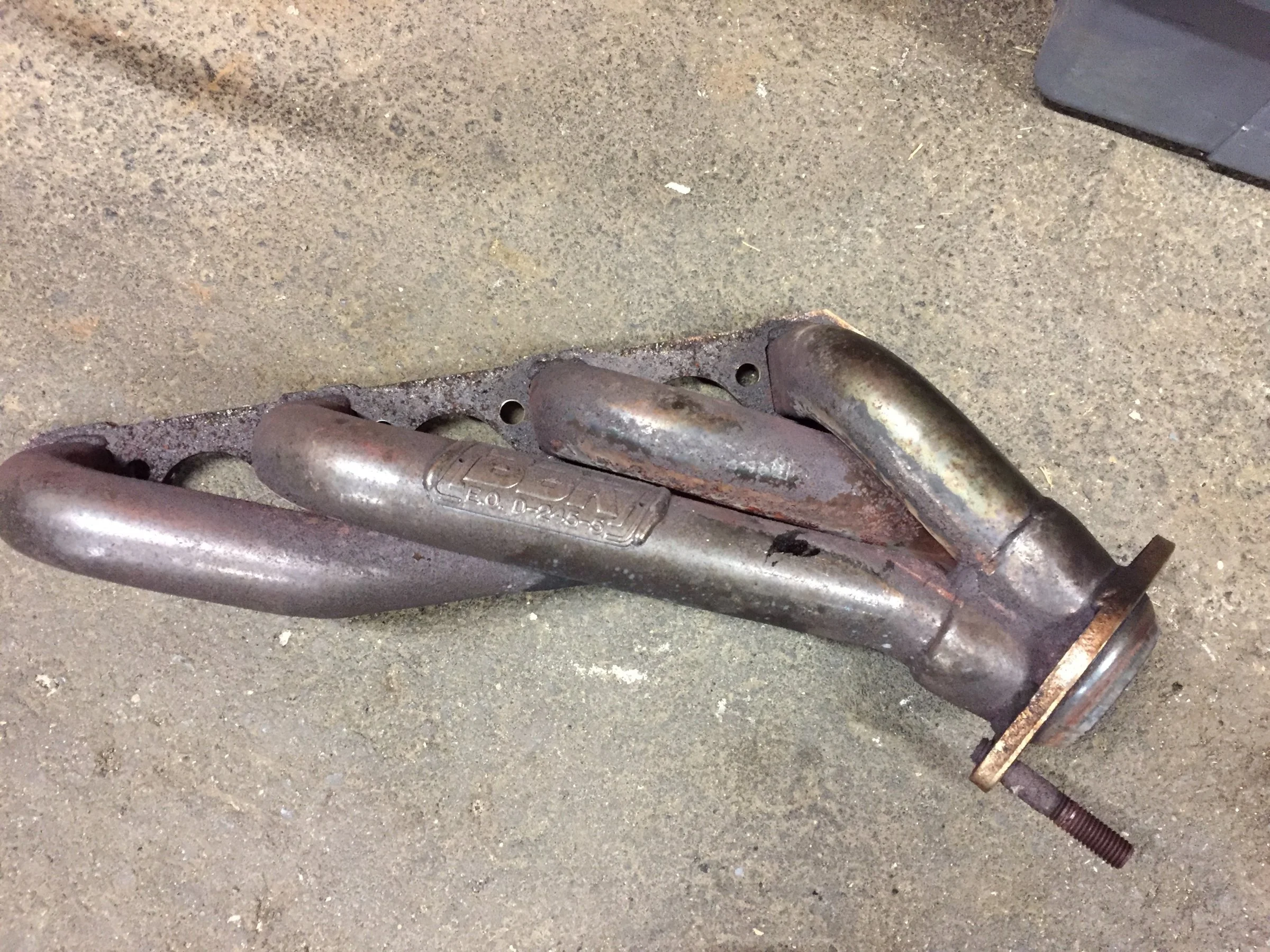

Ok. Had a few mins. Have I mention having a good collection of air tools and sockets has dramatically cut down time spent? I think I had this header off in 10 mins.
It is in fact solid, albeit light surface rust. Black mark is where I need to clearance for the shaft. Gonna work on that and test fit and then pull the other one to give to my buddy to blast.
Discovered I only had 7 header bolts. One was MIA. Also discovered I had used the Mr gasket gaskets long ago. Of course leak at the missing bolt
At that point, I started looking around. Engine has never been out of car and it shows. The original engine mount looks like trash. Oil leaks, rust, dirt, grease. Ugh!
Broken dipstick as well
At that point my OCD kicked in. I'll clean up what I can, and get car driveable again. Do the mass air swap, get my inspection sticker and enjoy a few months of driving...
Then engine coming out. I need to bring the engine and bay up to my standards.

Great day to bash stuff with a hammer!
Clearanced the header and test fit. Gave me 1/2"+ of clearance which should be fine. Now to have my buddy blast it for me before I reinstall.

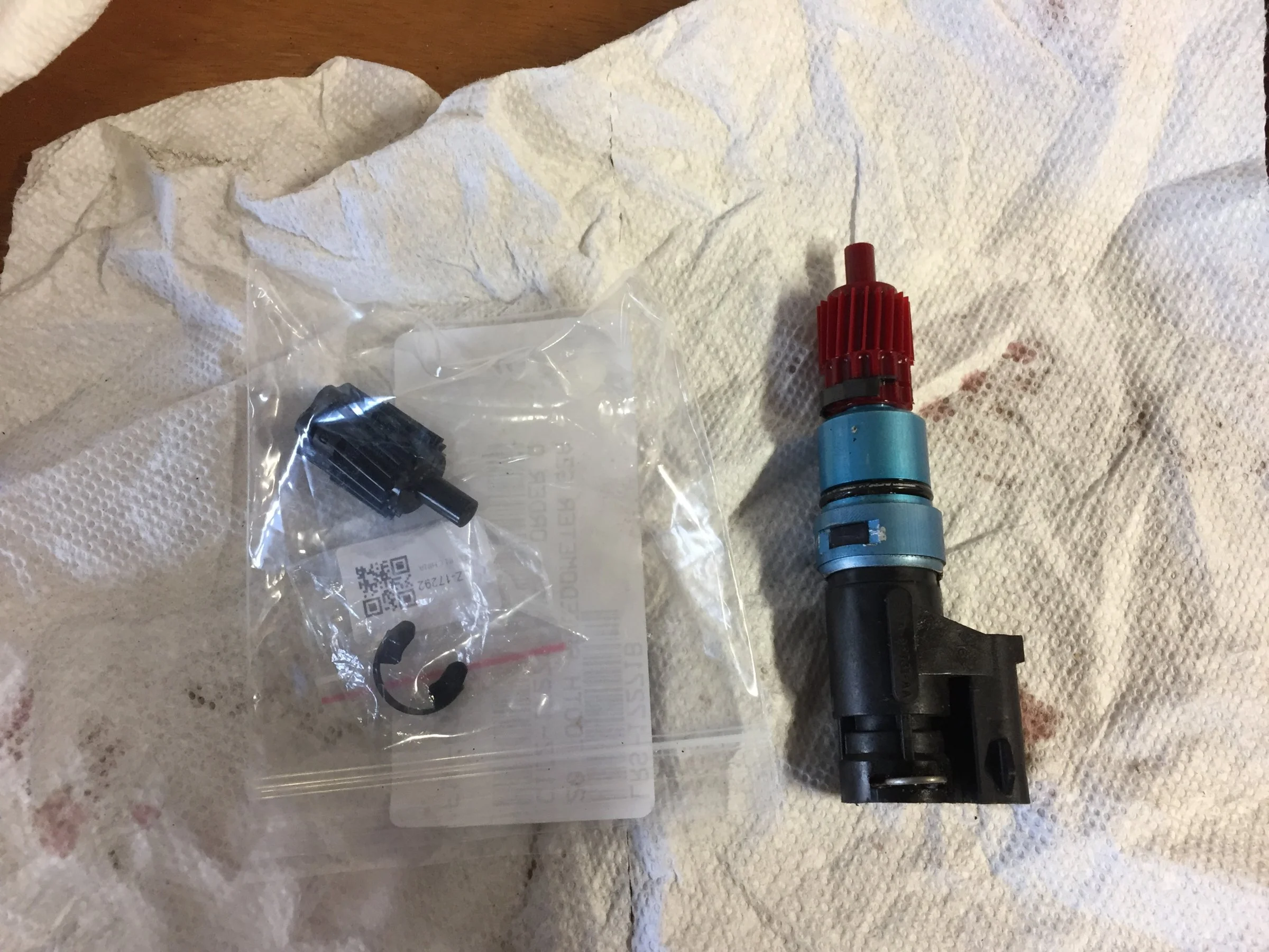

I was gonna change out my speedo gear and work on my window guide bushings and window seals...but I didn't. Oh well

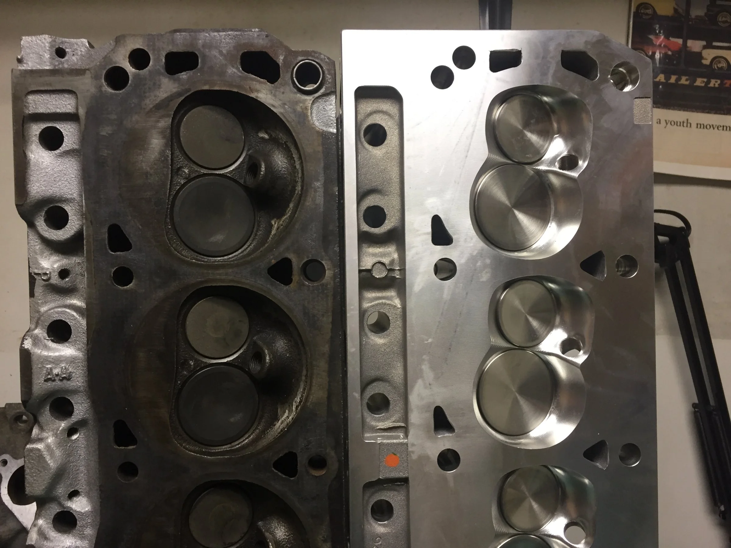

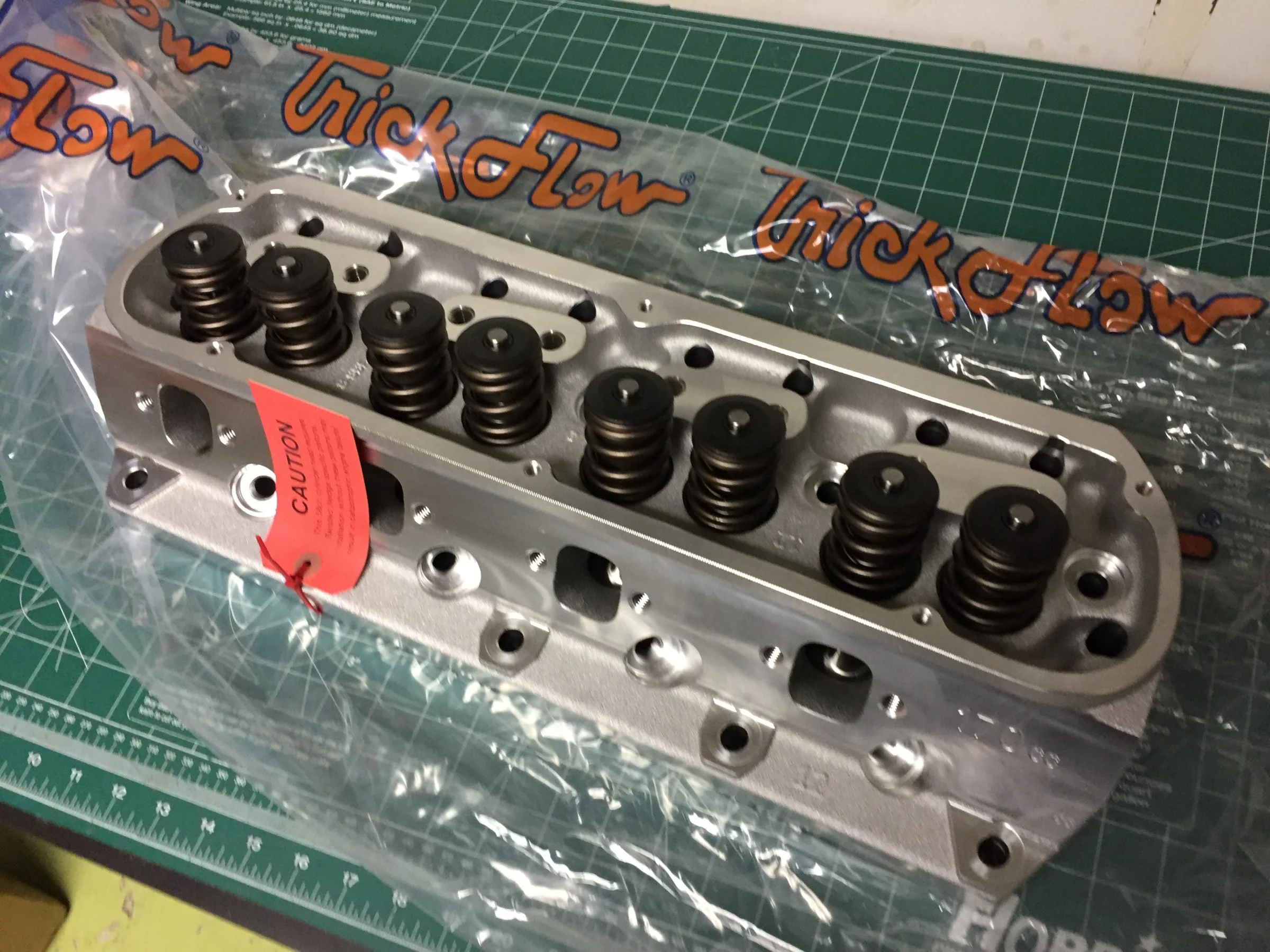

These came today. 58cc versions. It has a buddy still in the box.
Now to start dialing in rest of combo. Just gonna focus on a weekend cruiser setup. Will never see the track. Down the road I would like to build a quality lower end for these heads. But for now..

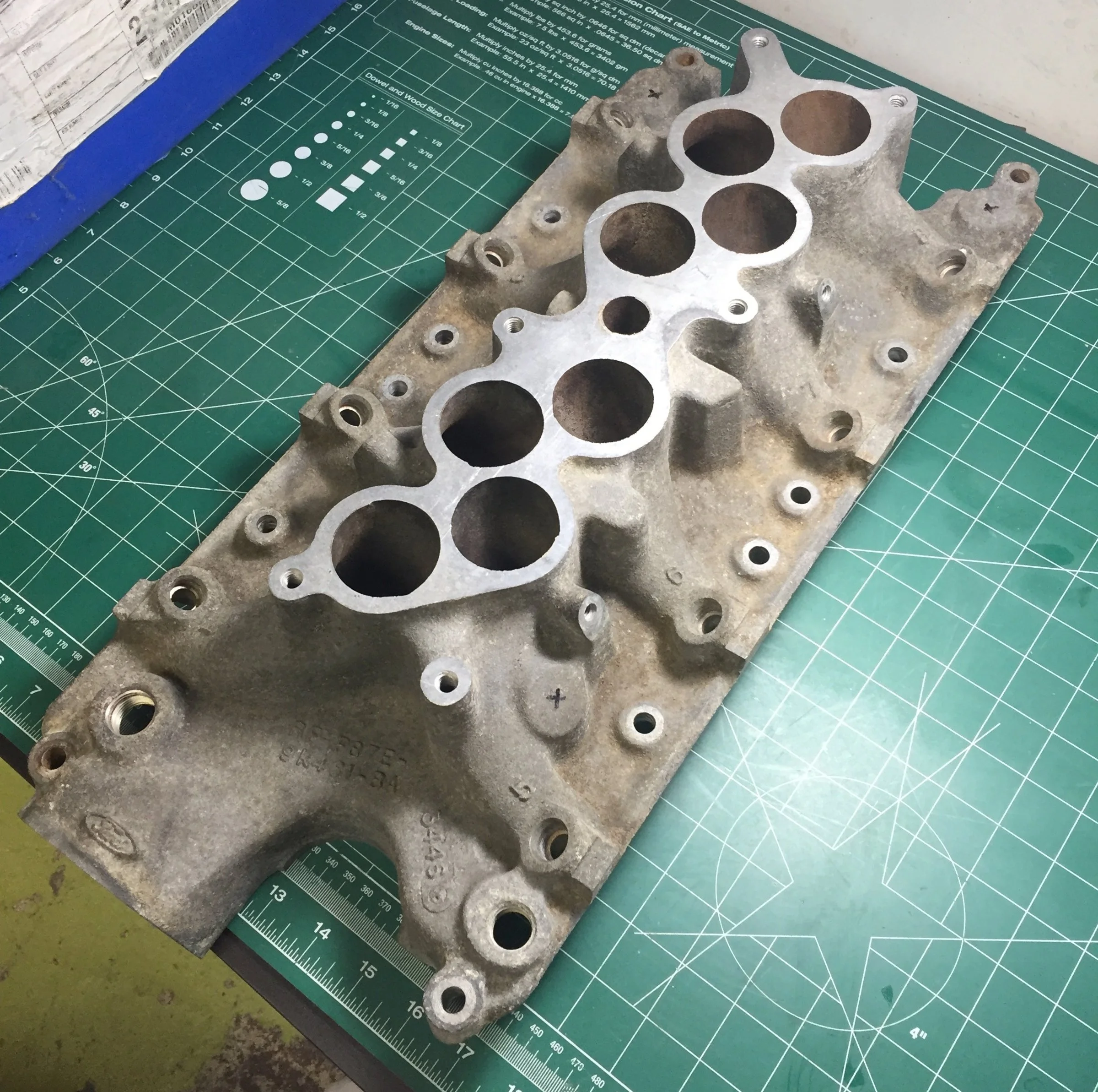

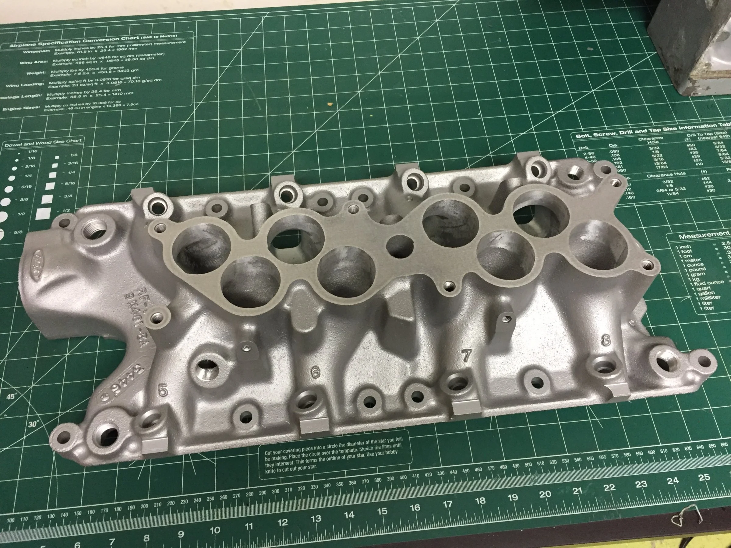

Next up, have Tmoss port a spare gt40 lower intake I have. I'd like to stick with the 1993 Cobra upper for sentimental reasons....unless someone can talk me out of it. Should I be looking for a 70mm TB, or 65mm fine?

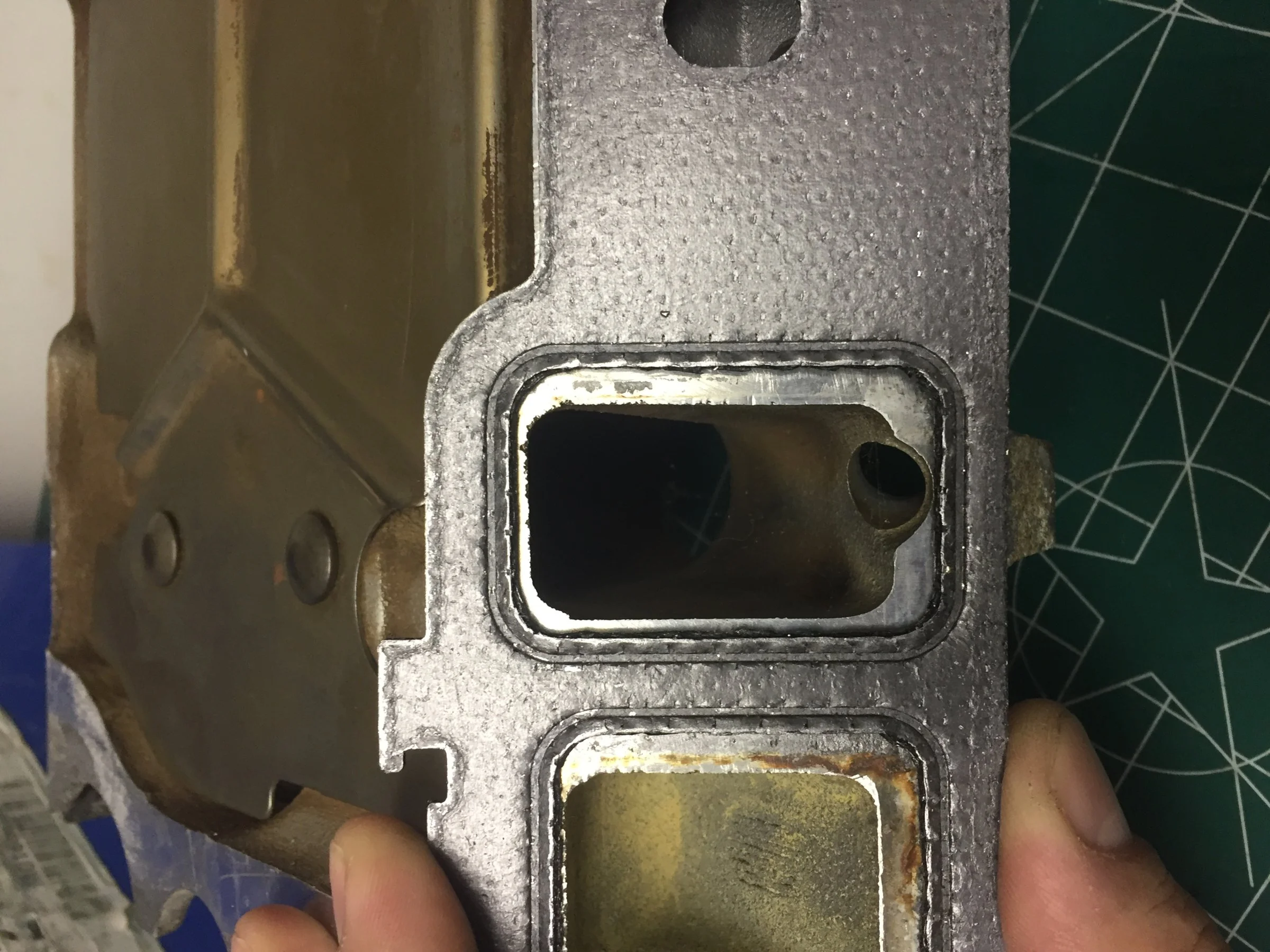

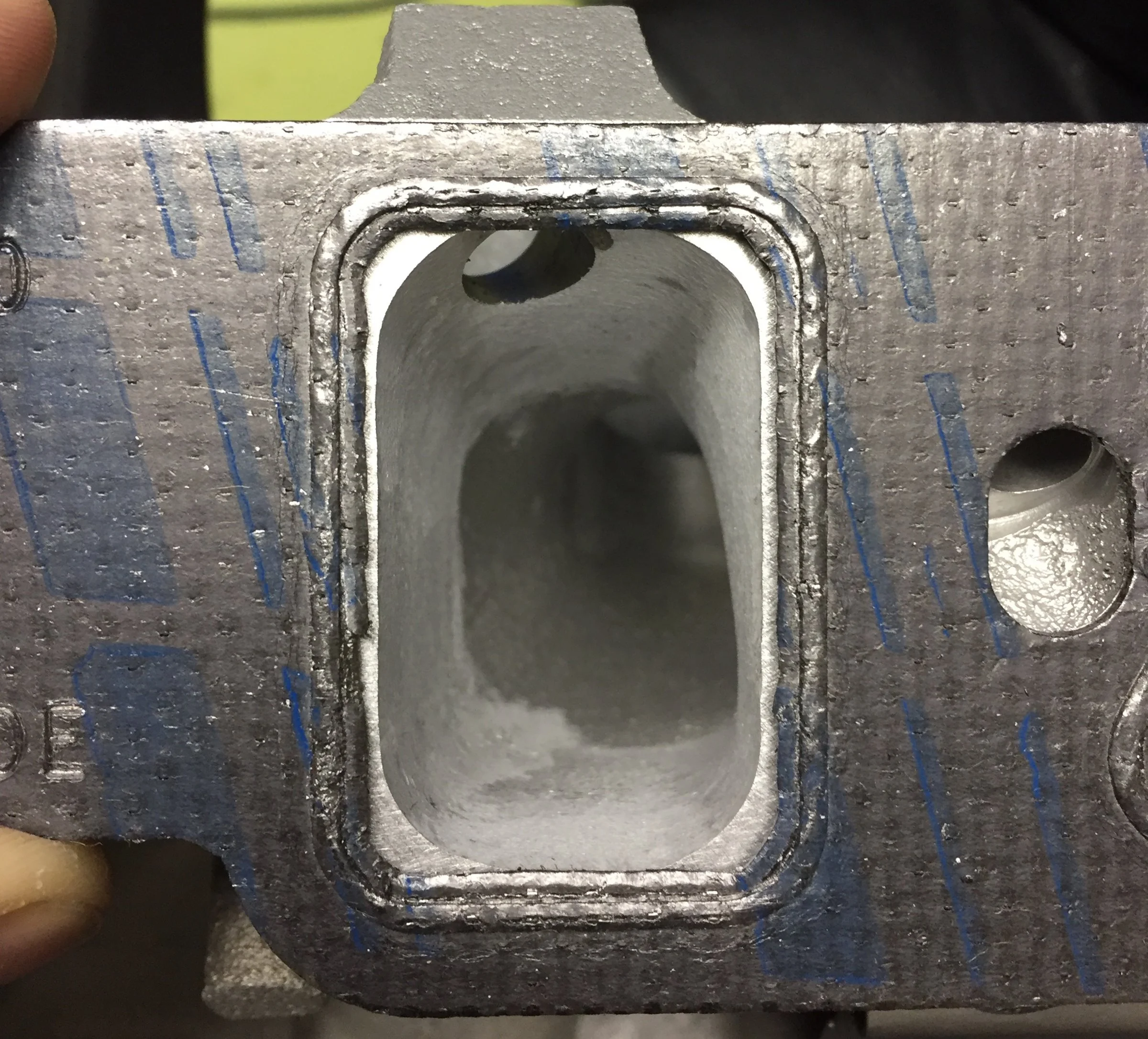

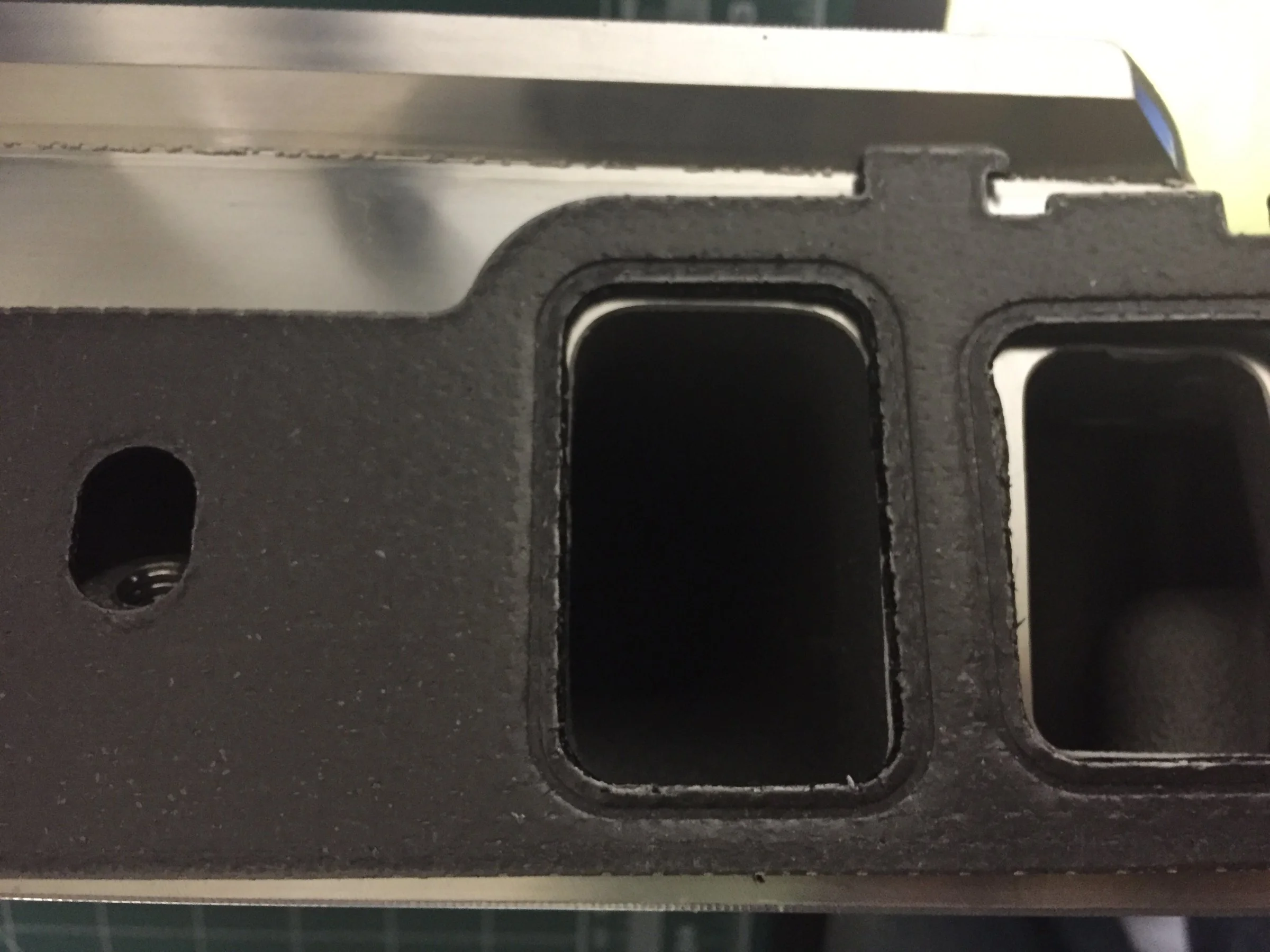

Just some more pics before I put them back in box. Figure I could look back on these years from now.
The TFS vs the GT40Ps I acquired years ago.
Checking my Fel Pro MS 95952's against the intake ports.
Perfect fit on the TFS.
But as you can see...need some improvement on the Cobra lower
I know someone out there is screaming at me not to use this intake on the heads. But like I said before. I really want to stick with this 1993 cobra intake for now. An intake swap down the road is easy.
Time to find a box for this and get it ported

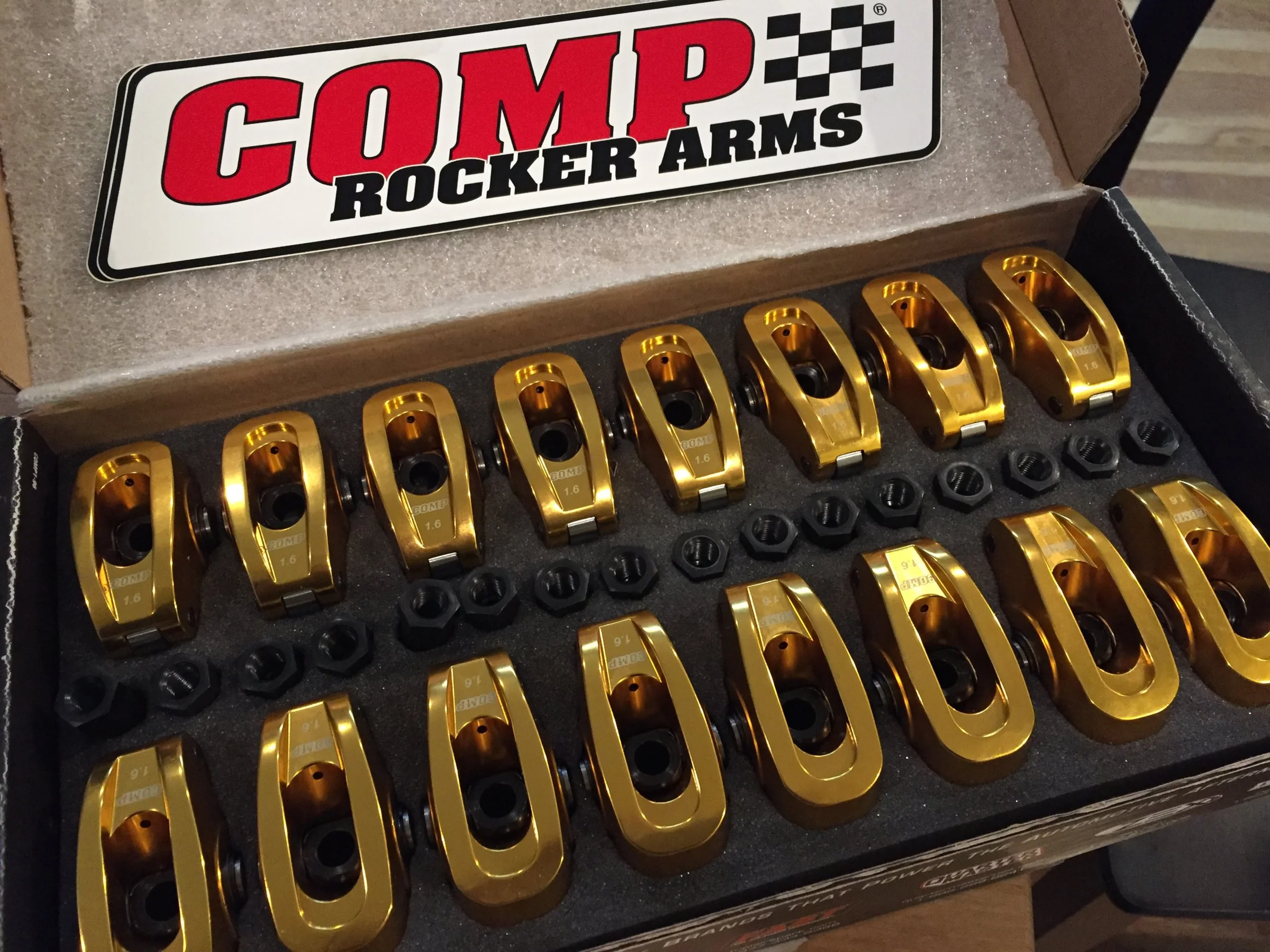

I think you guys recommended Comp Gold rockers? So I got some via Chuckman

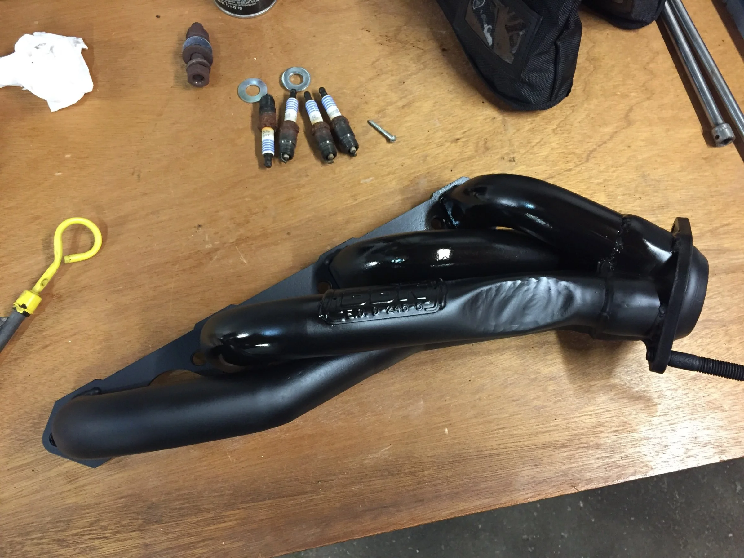

Got blasted header back. Prepped and painted. You can really see how much I dimpled it in this pic
Will install as soon as I wrap up some house projects. Painting the kitchen and some recessed lighting today

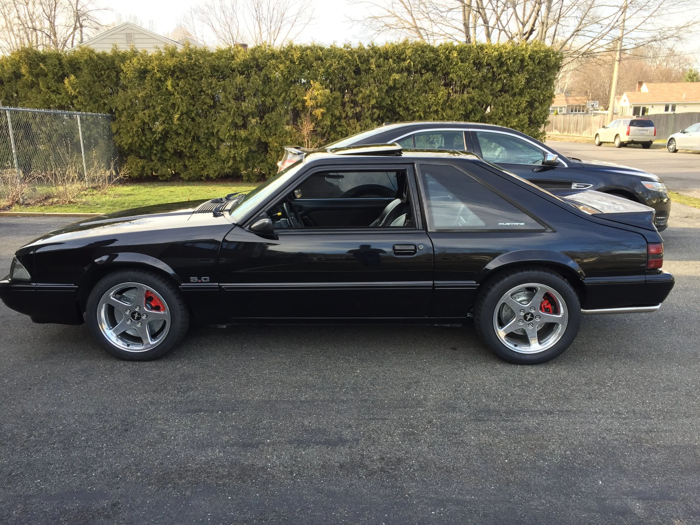

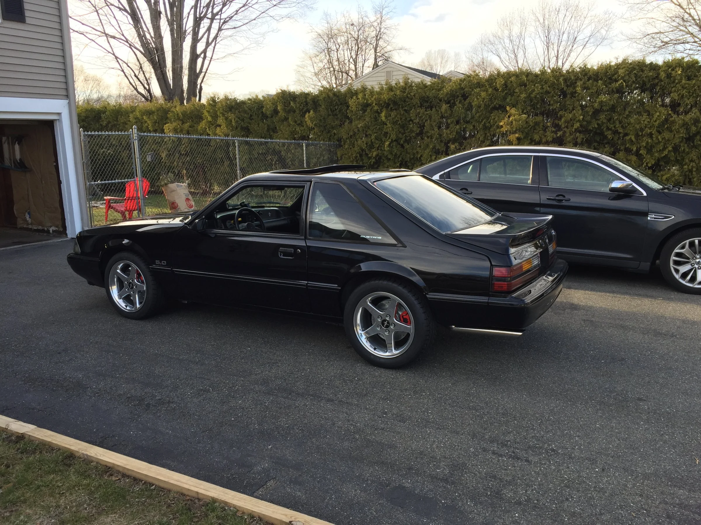

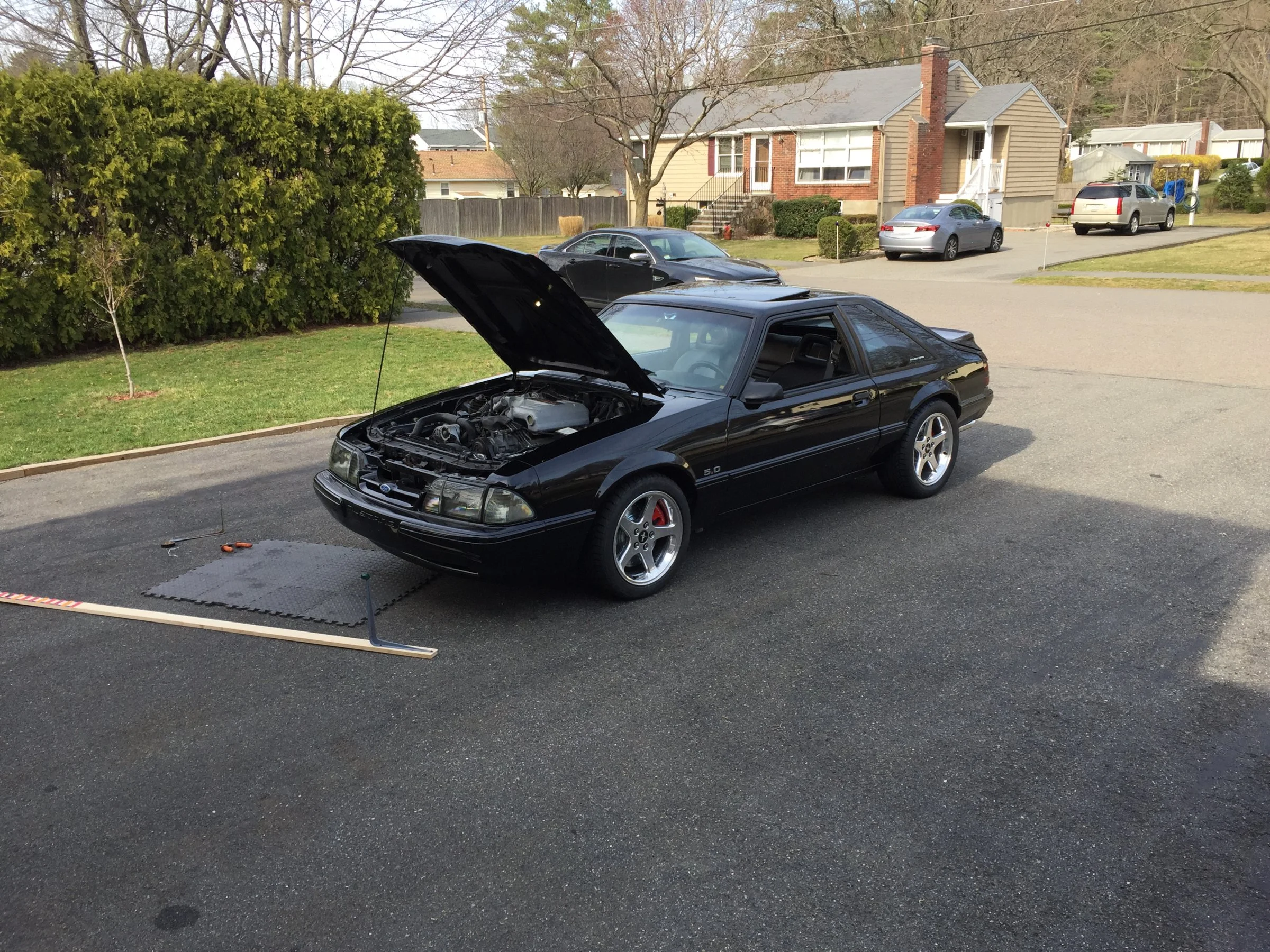

Ok. So header on and leak free. Actually surprised about that. Plenty of clearance to the steering shaft. Started the motor, purged the PS lines and got smooth operation.
Before I dropped the car down, changed out the speedo gear to correct for the larger tires out back.
Got the car down, and decided to go around the block. Steering is definitely firmer, but I never got the car over 15mph so no feedback yet. Needed alignment, and I think it was toed out so it drove poorly.
The brakes...they are soft. I can stop the car fine, but 15mph isn't really a good test. I'm sure all the air is out, so I may need to change to a larger MC.
Anyway, first outside pic with the wheels on. Pics don't show it but rear is higher since putting the taller tires. I'll adjust the adjustable LCAs down a tad
Next up...alignment
PS pump sounds as noisy as before. Haven't tried the vacuum pump trick just yet. I will soon

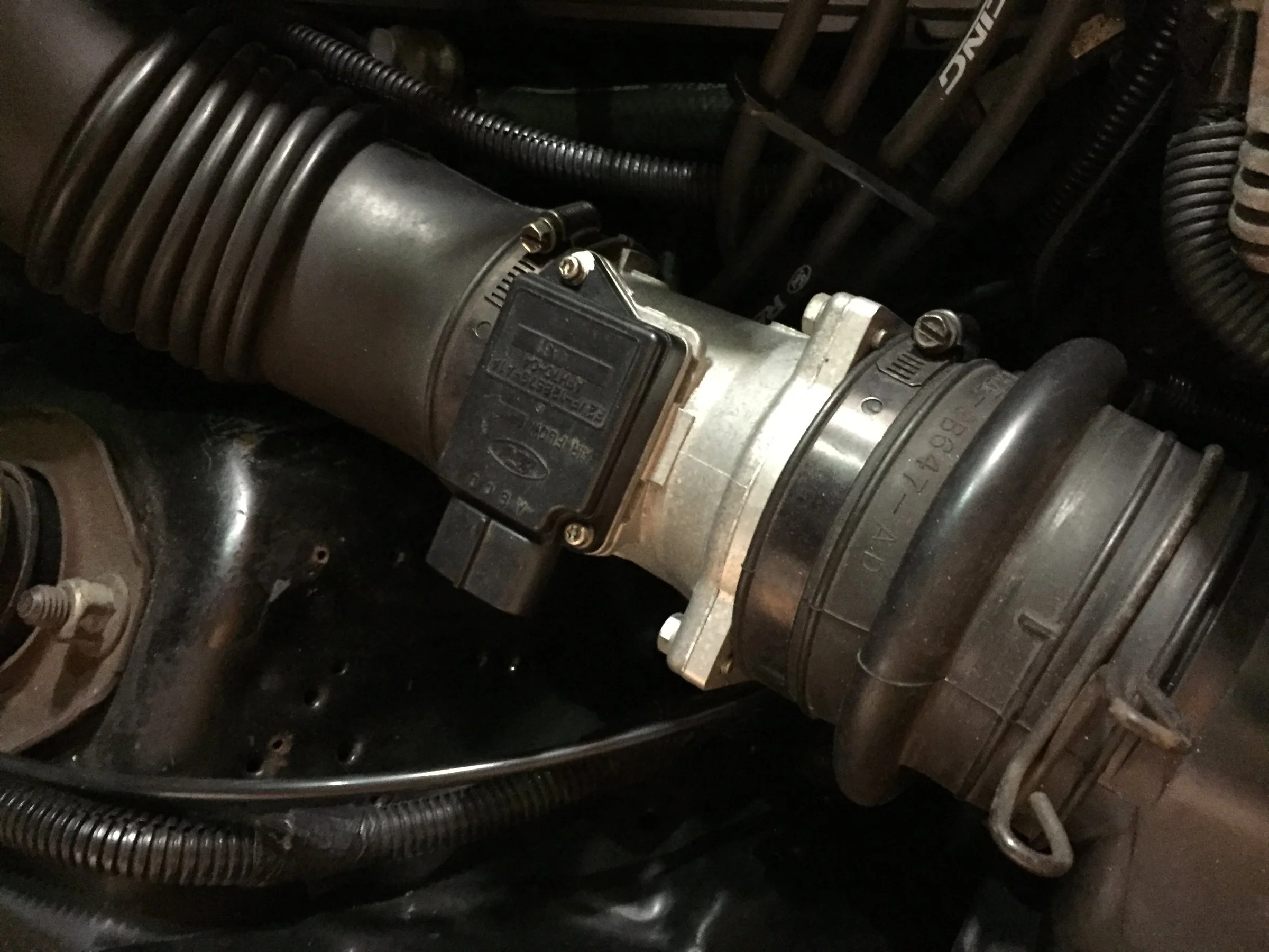

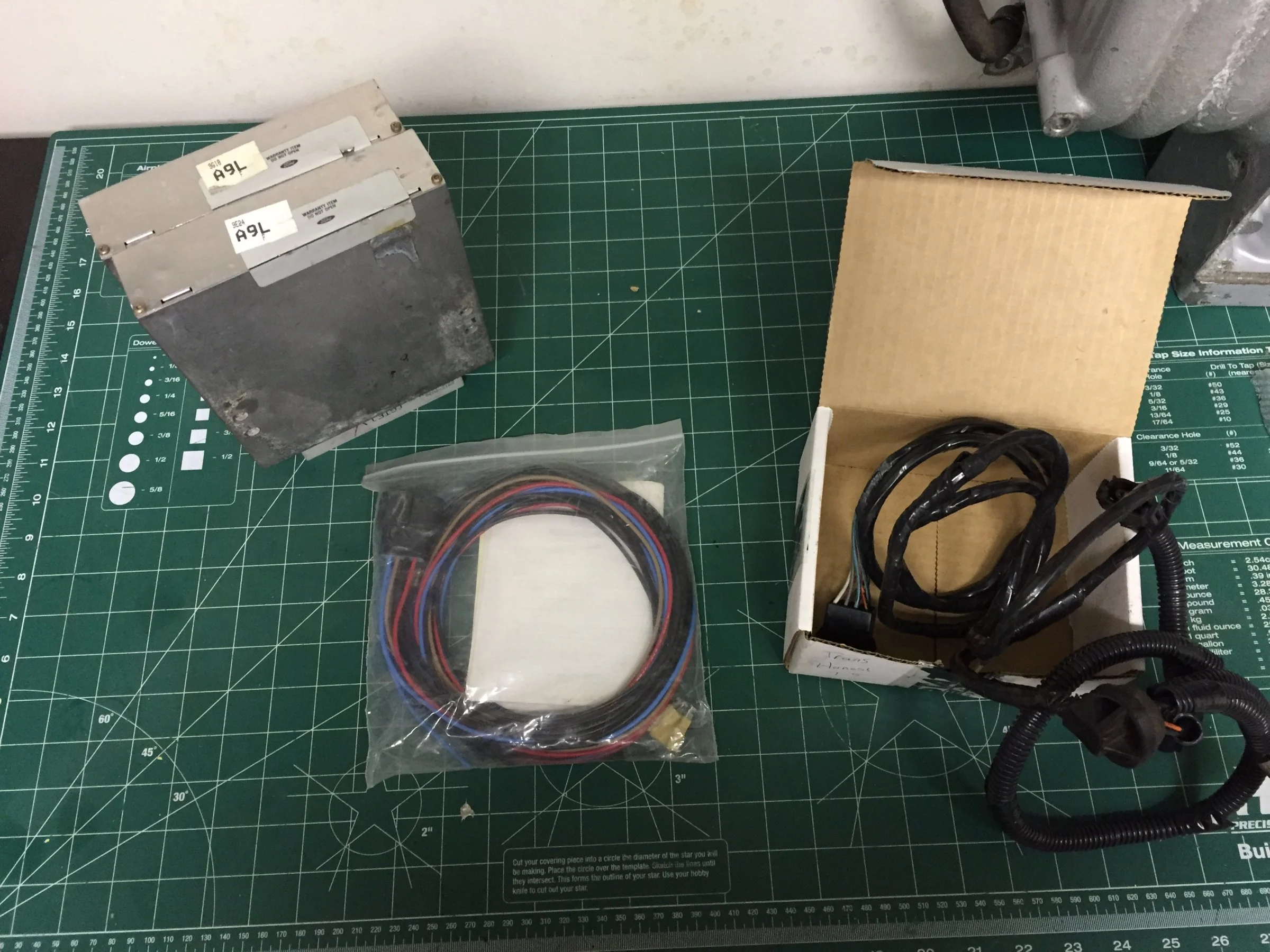

Next up...mass air swap. Yes, as perhaps the only fox owner to actually save motor work for last, I finally have a reason to go to mass air.
Since I'm gonna convert to an A9L, I need to address some of the wiring as well. Specifically the trans harness, and the o2 sensor harness.
Using this SN95 70mm MAF with adapter. Been on the car for 10+ years...never hooked up
And here's my new trans harness. AOD cars do not have the plug for the NSS, so I'll be swapping this one in.
Also shown is the IST mass air conversion harness, and a pair of A9Ls. Both were cheap junkyard finds I scored years ago. Given the cost of ECUs these days, I certainly don't mind a spare

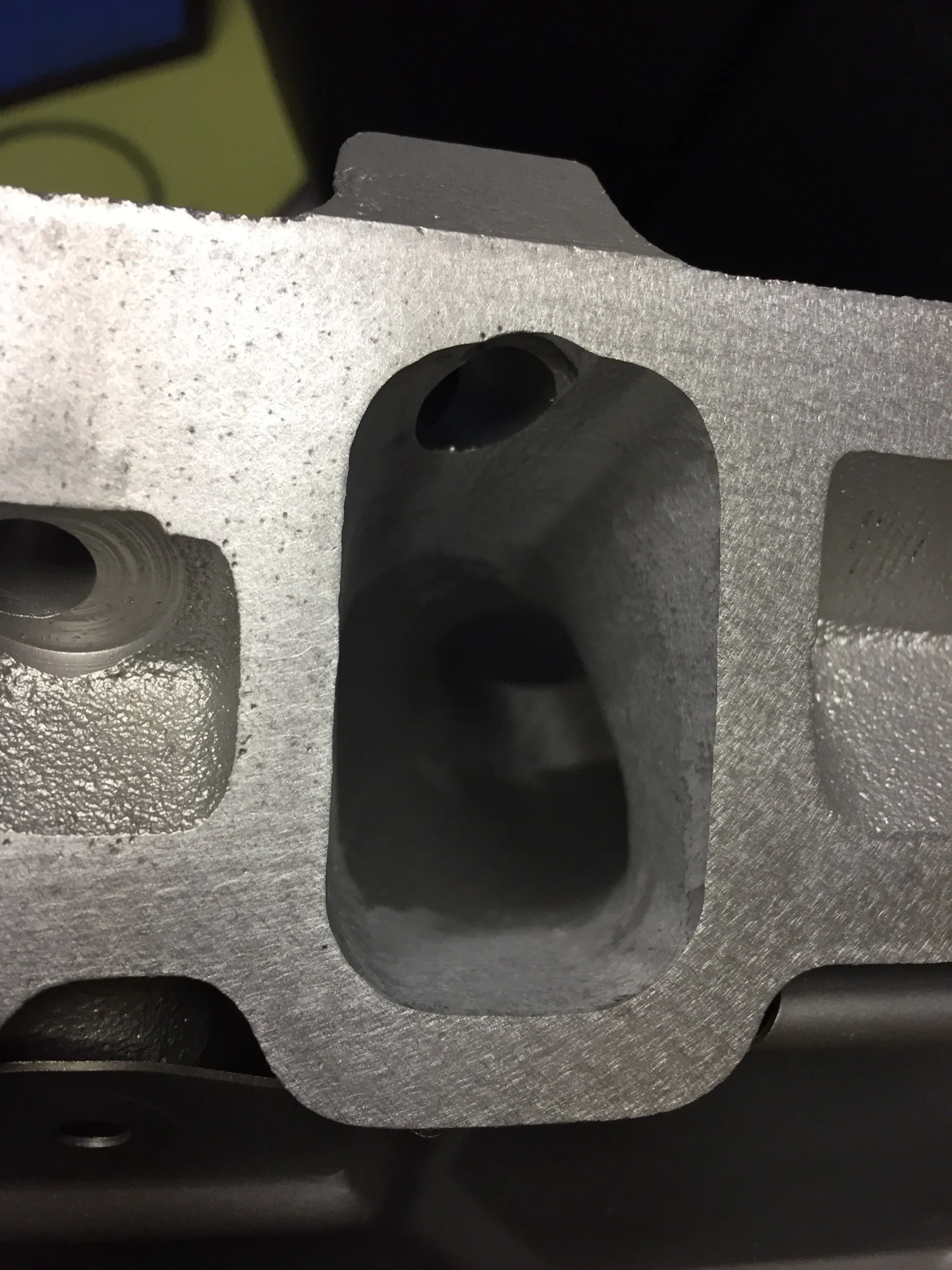

Got my tmoss lower back. His son Matt actually does the porting these days.
Went for a port for my tfs170s, drill/tap the act and coolant bosses, and tank and paint. This lower actually started out as an early -BA explorer lower, with the larger baffle underneath
Before
And after

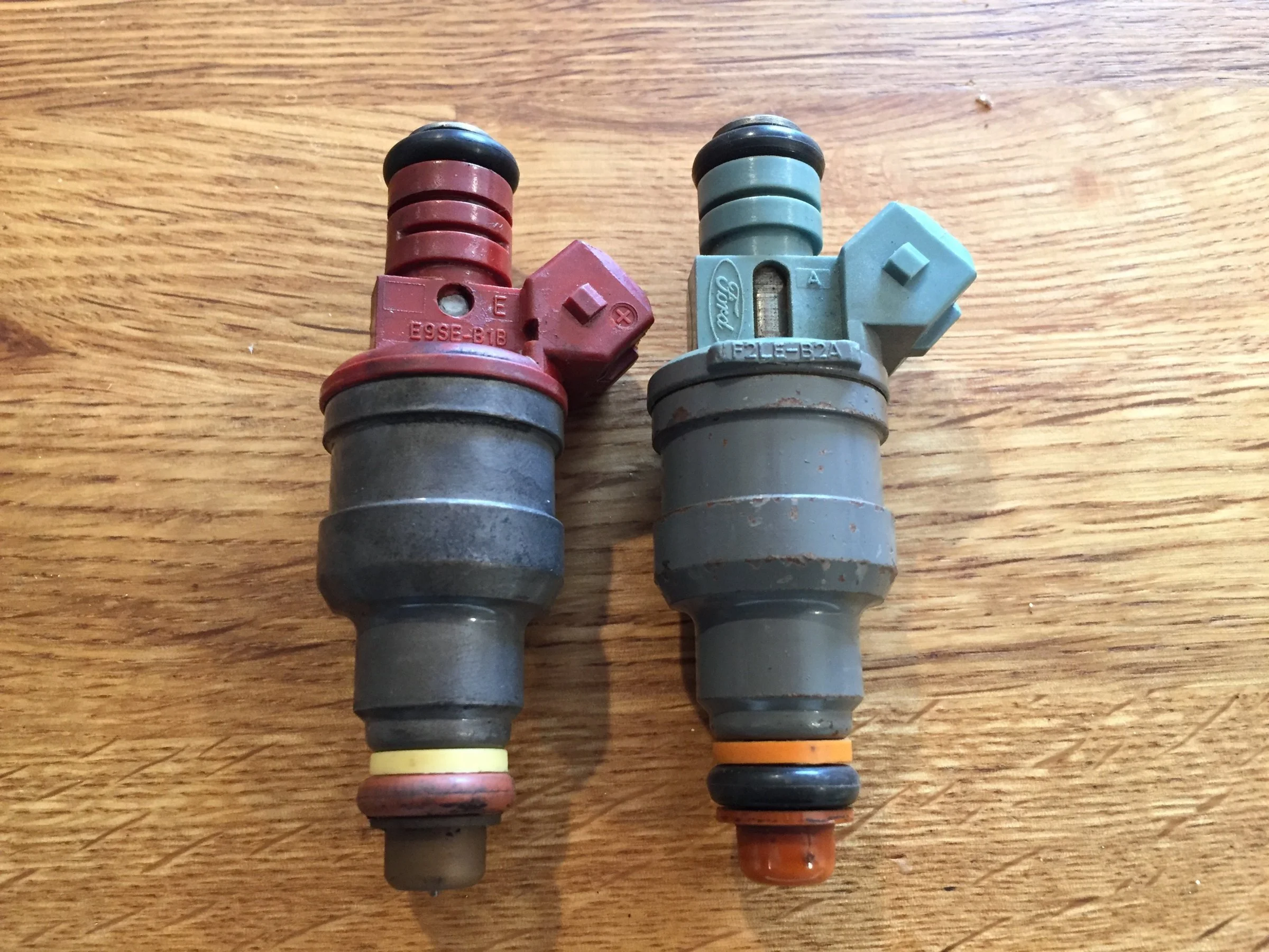

Also scored some 30# injectors. Already had 24s. Anyone recommend a MAF for these?
