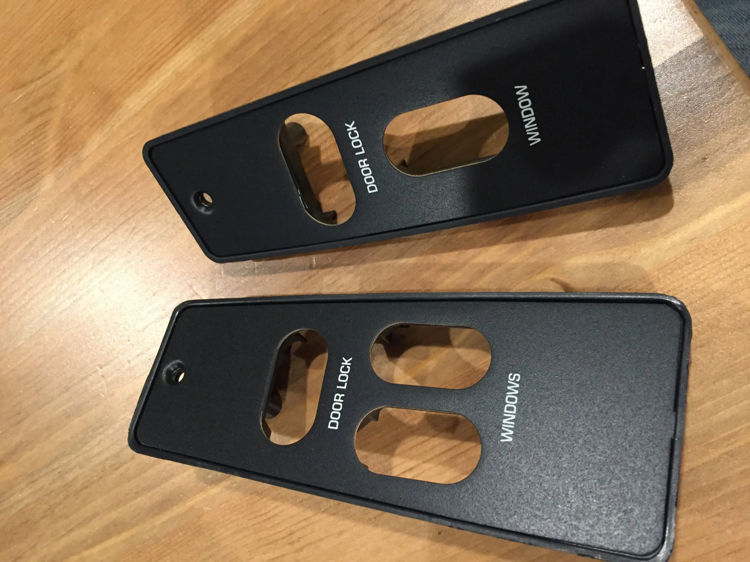

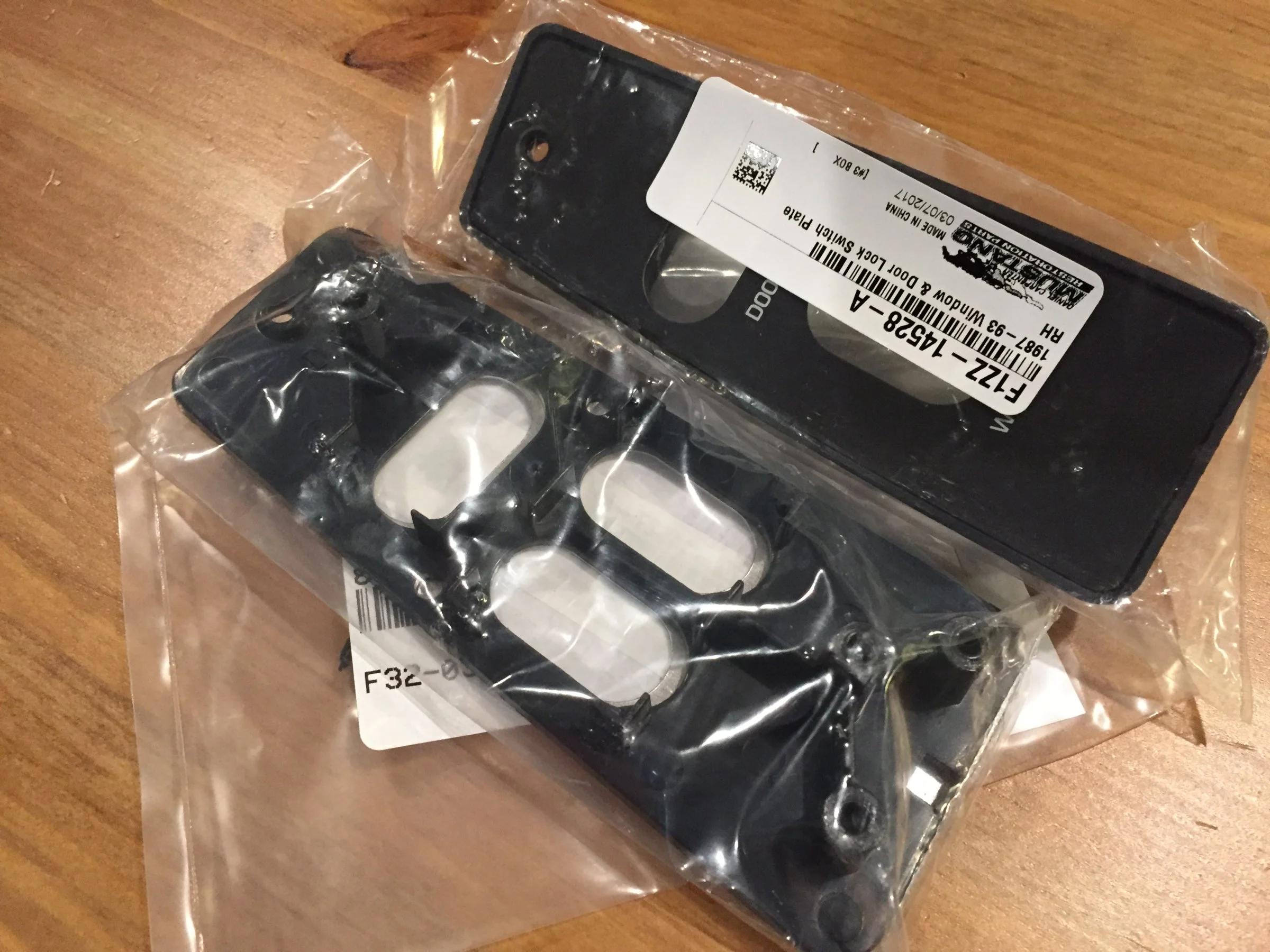

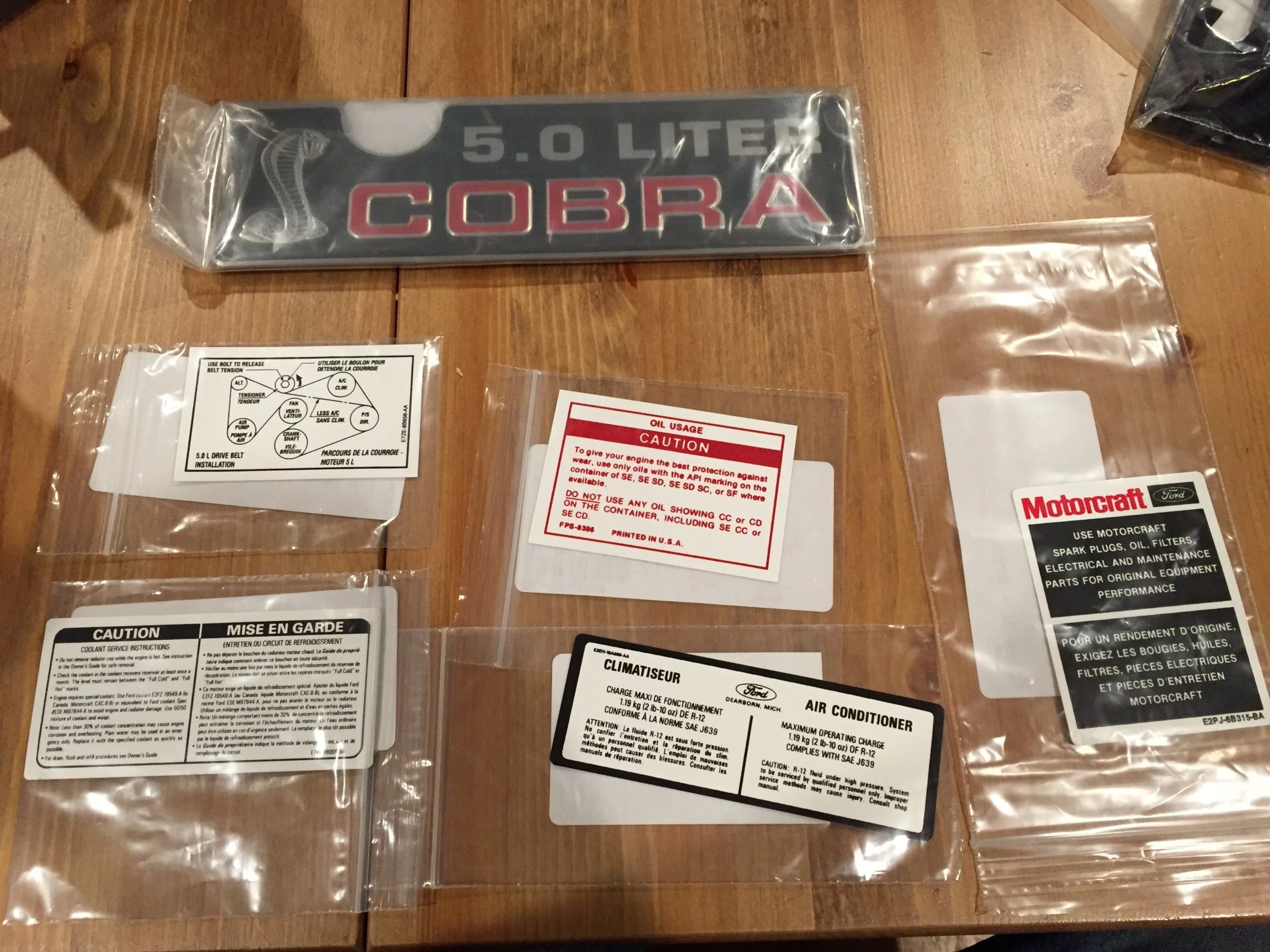

Well, haven't bought anything in a few days so I took advantage of a LRS code and did a impulse purchase.
New window switch bezels, underhood decals, and intake plaque for Cobra intake
These are pretty good quality. My original Driver side one is cracked around the edges and the writing is fading a tad. Figured I'd get both so they match. I'm debating replacing the switches as well since the arrows have faded.

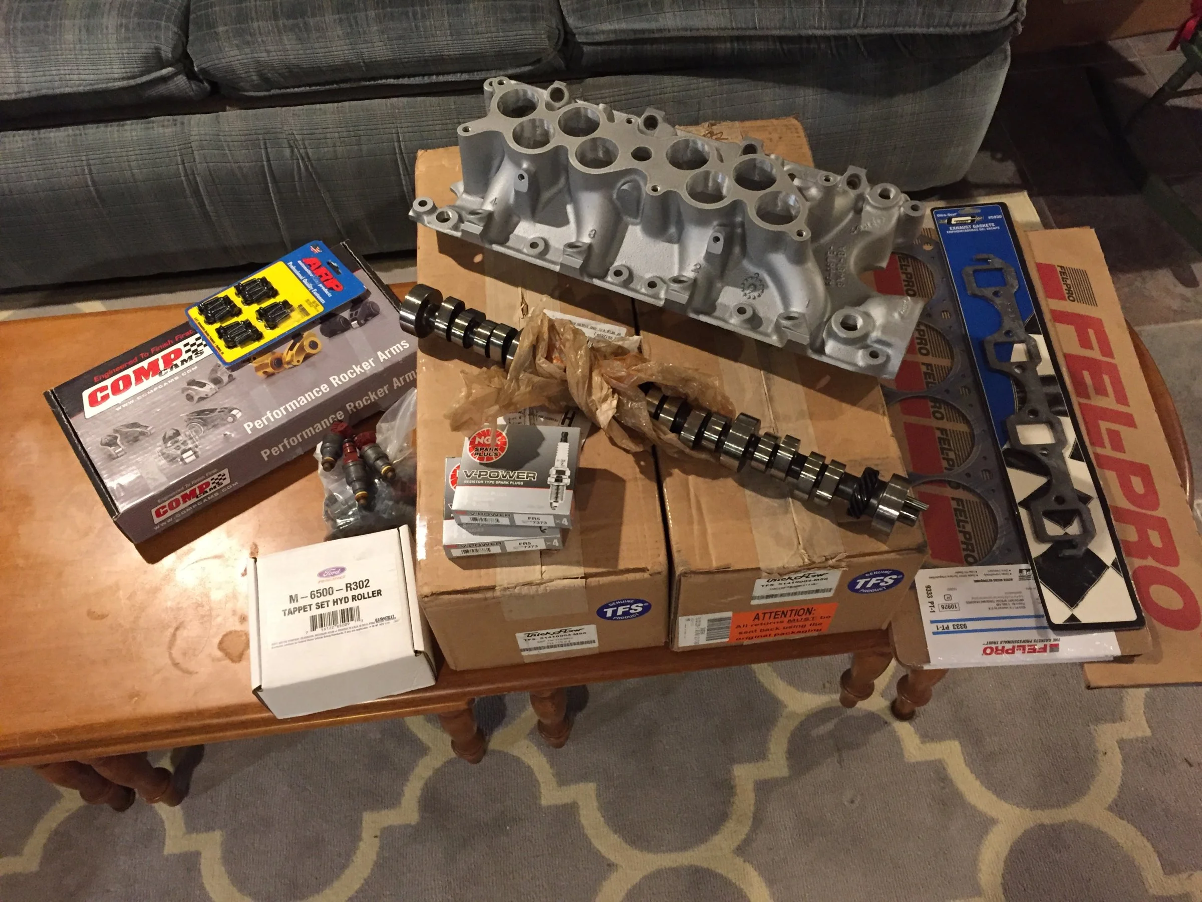

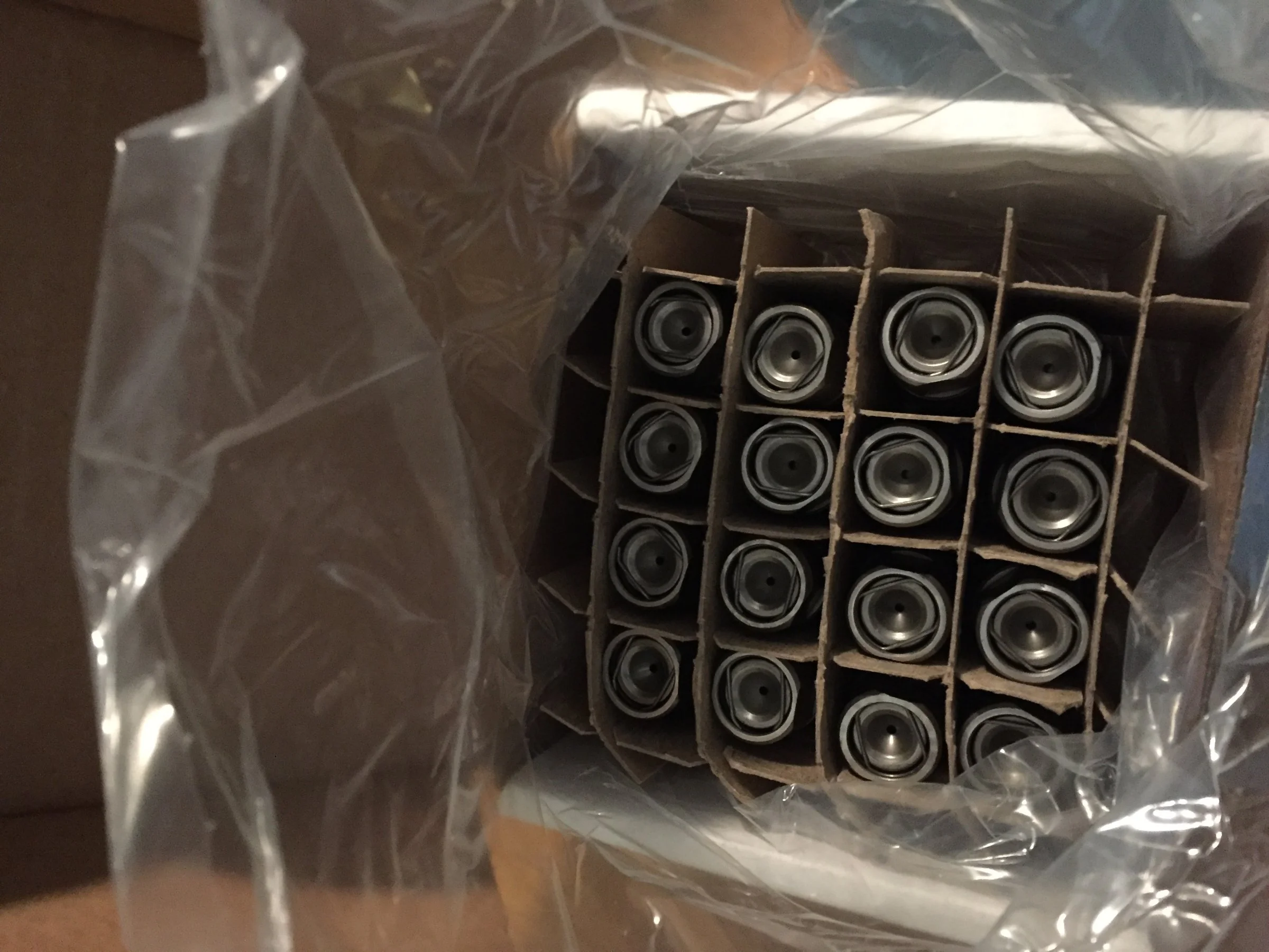

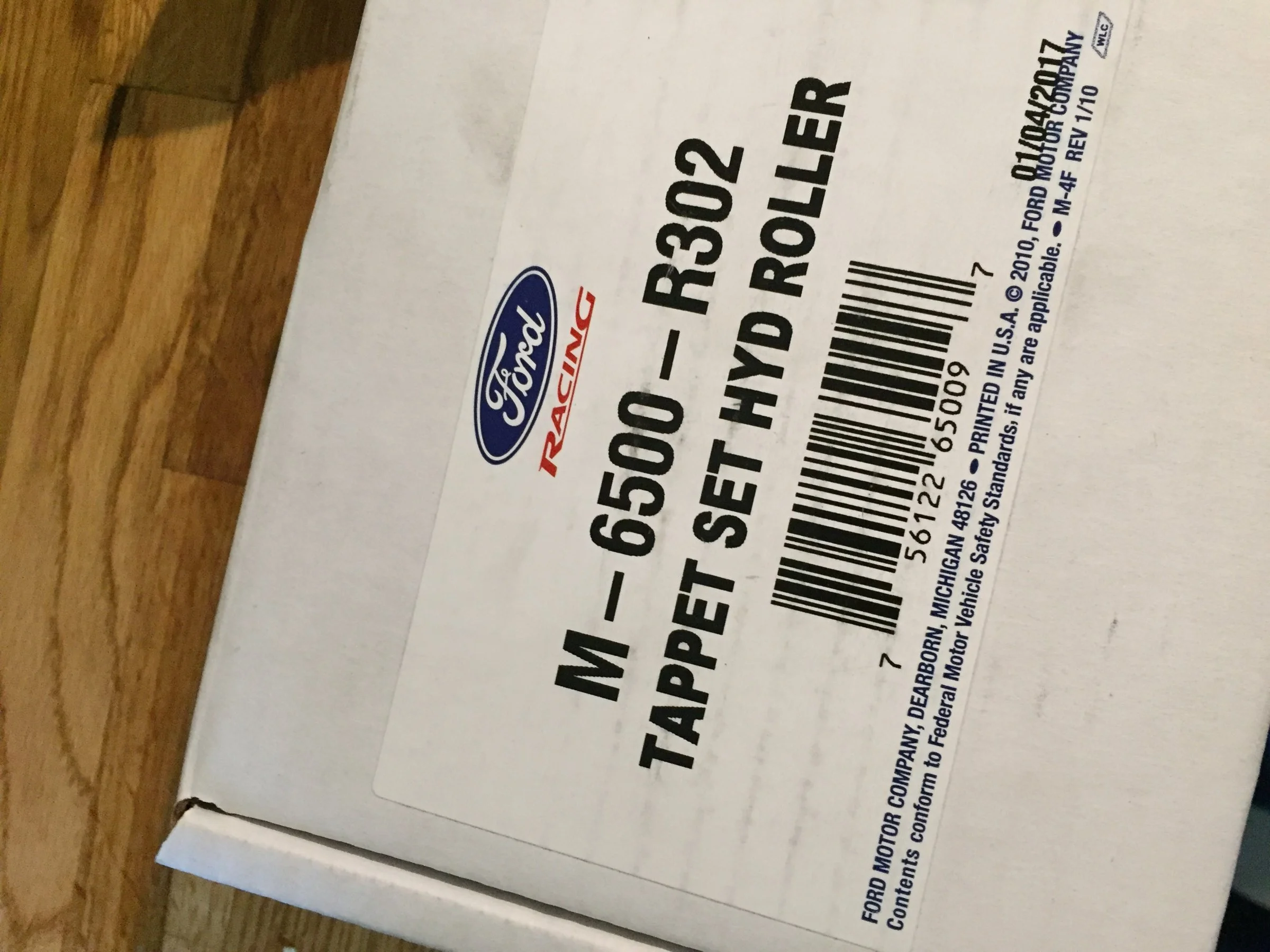

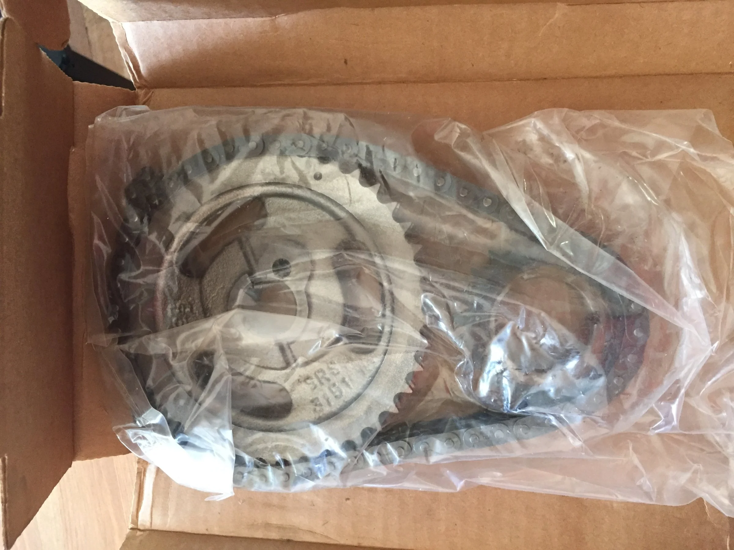

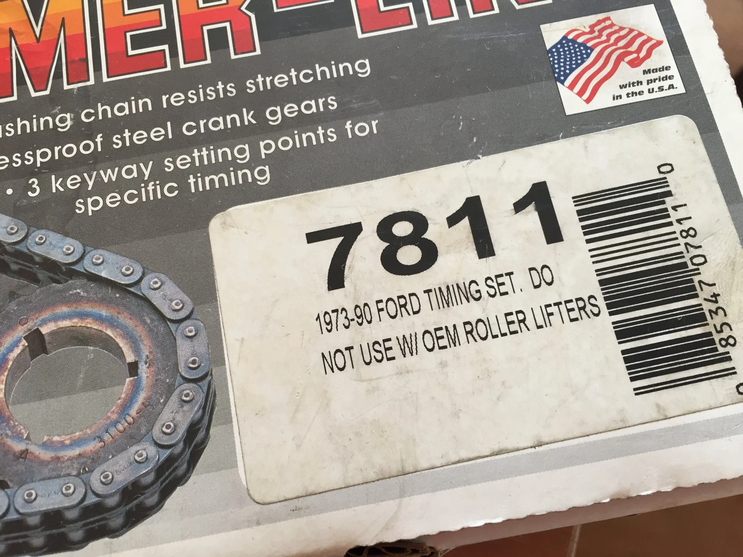

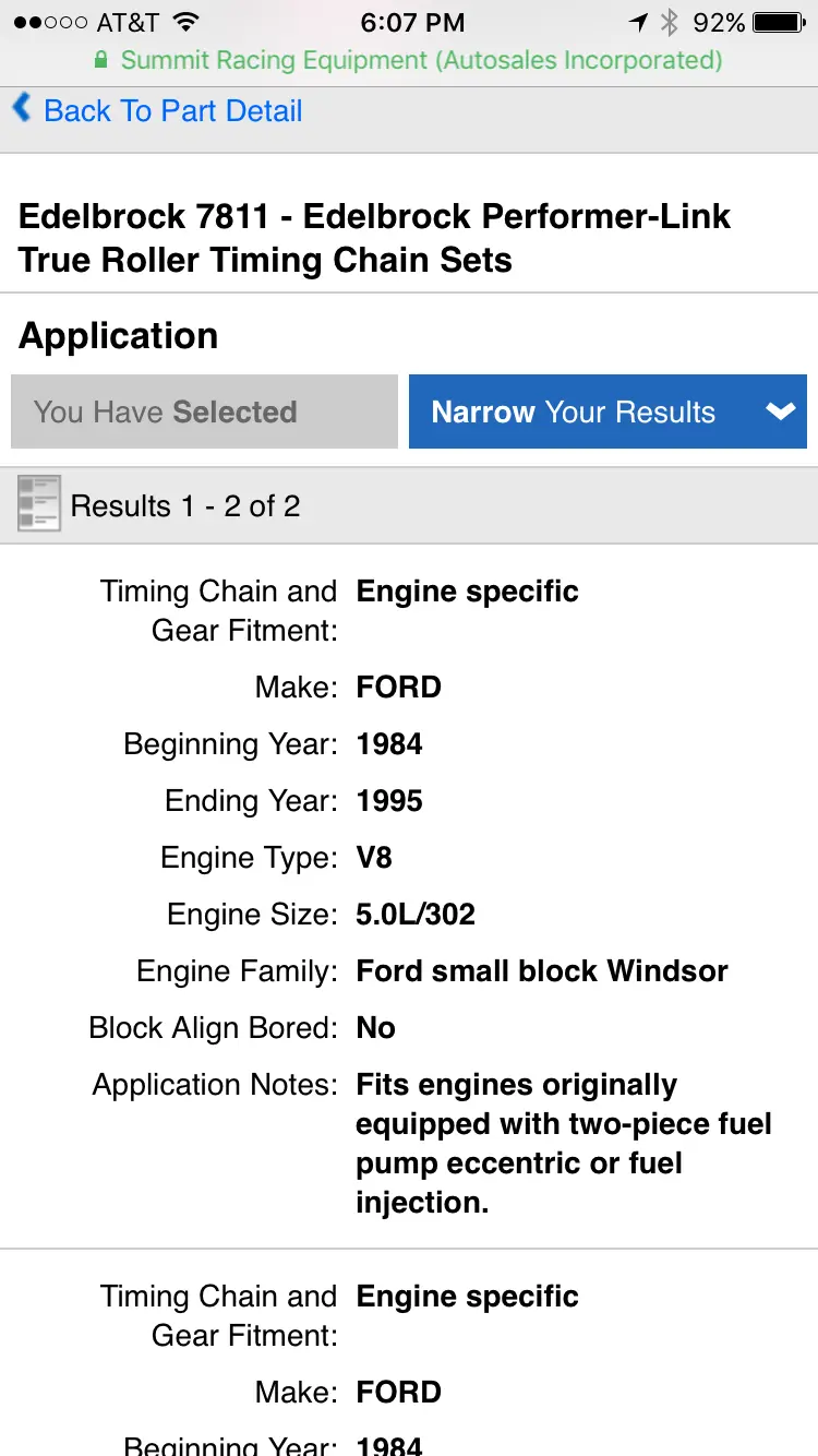

So I scored a timing chain cheap. Edelbrock 7811.
Problem is I bought without research. I figured a timing chain was a timing chain.
Can't use OEM lifters? What's up with this?

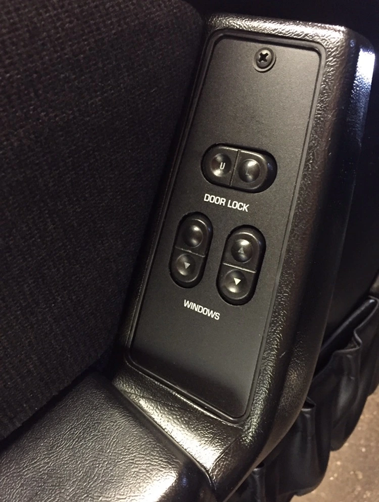

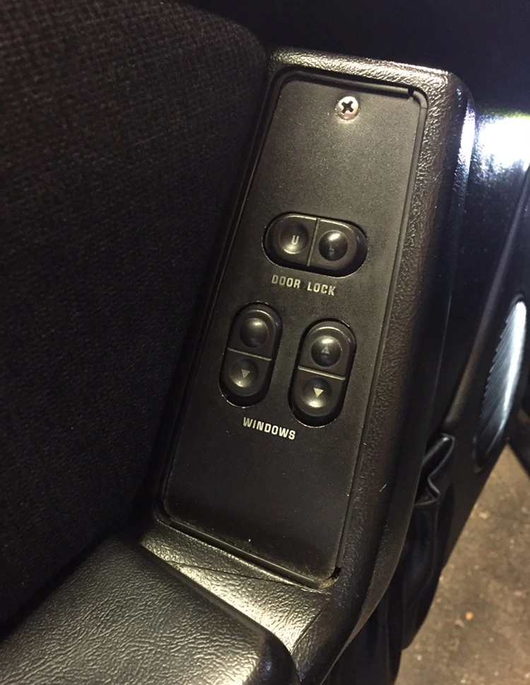

So I managed to change out the drivers side switch panel. Easy job, took about 20 mins and that was with cleaning up the armrest a tad. Anyway, really debating getting new switches, but the repros don't have the white triangles. Might have to scour the eBay to find some clean ones. It's gonna bother me now if I don't do it.
Anyway, Before...
And after
