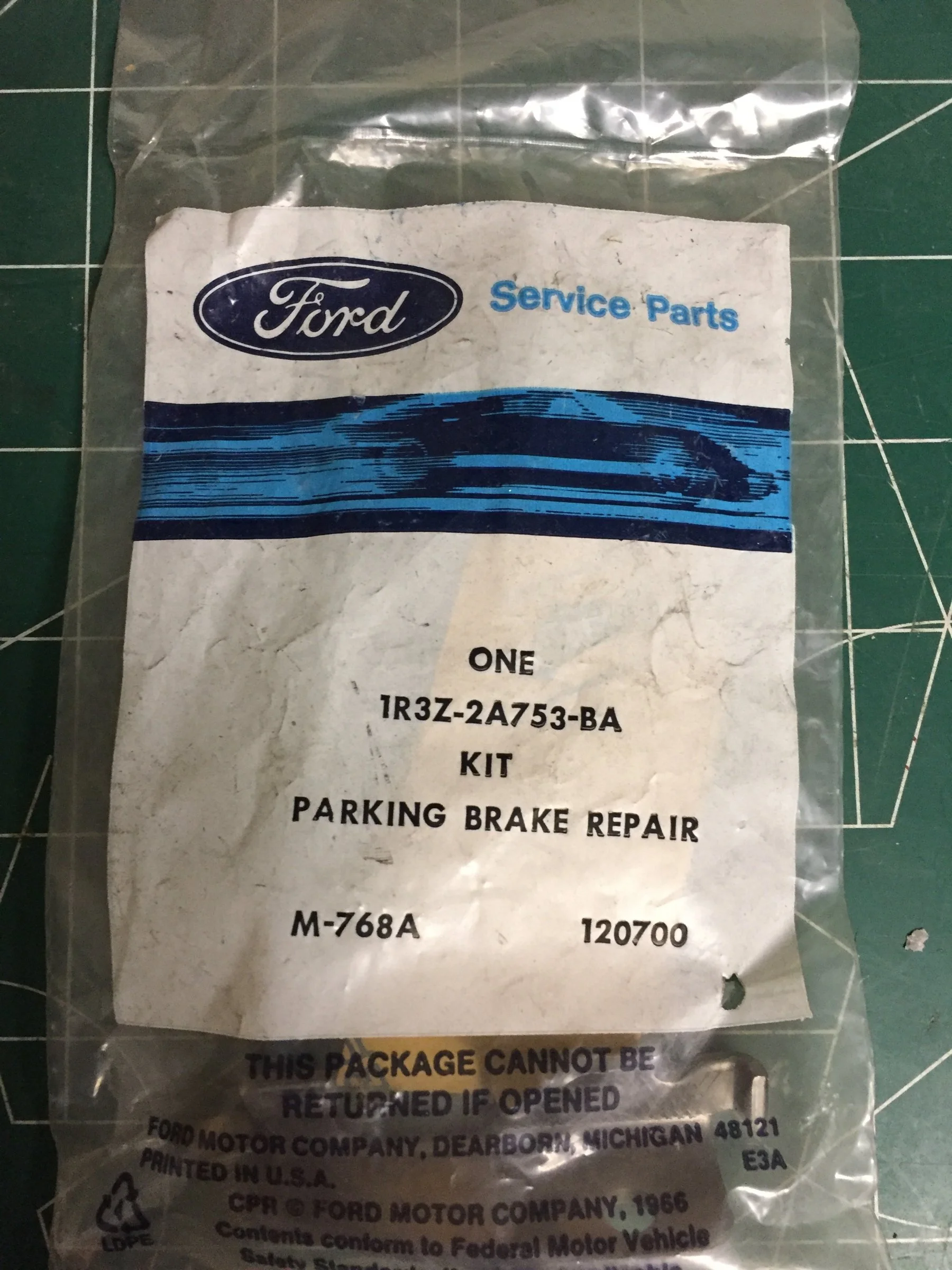

I'm interested in seeing what this part looks like. I've got a 98 e brake handle in my car. It works great...for now.
Basically it just bolts to the top of the handle. And locks the adjuster so it can't move. It's no different than welding the pawl. I'll post pics when I get it on the install.
Was $5 shipped on eBay. Prob might be cheap if you walk into Ford.
Part number
1R3Z-2A753-BA

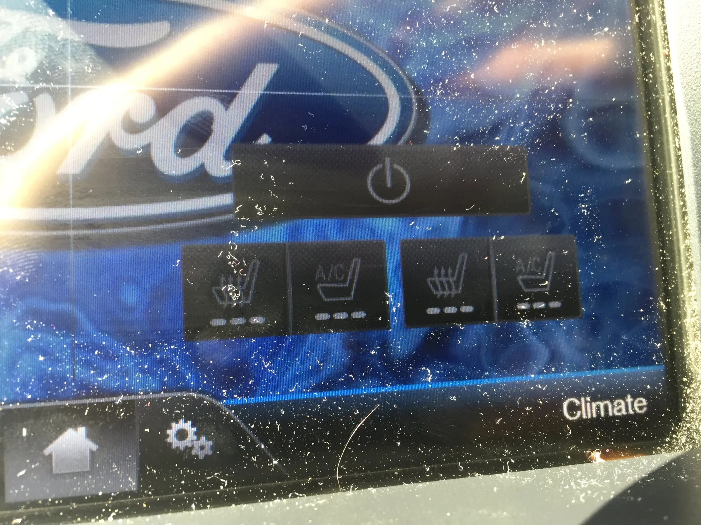

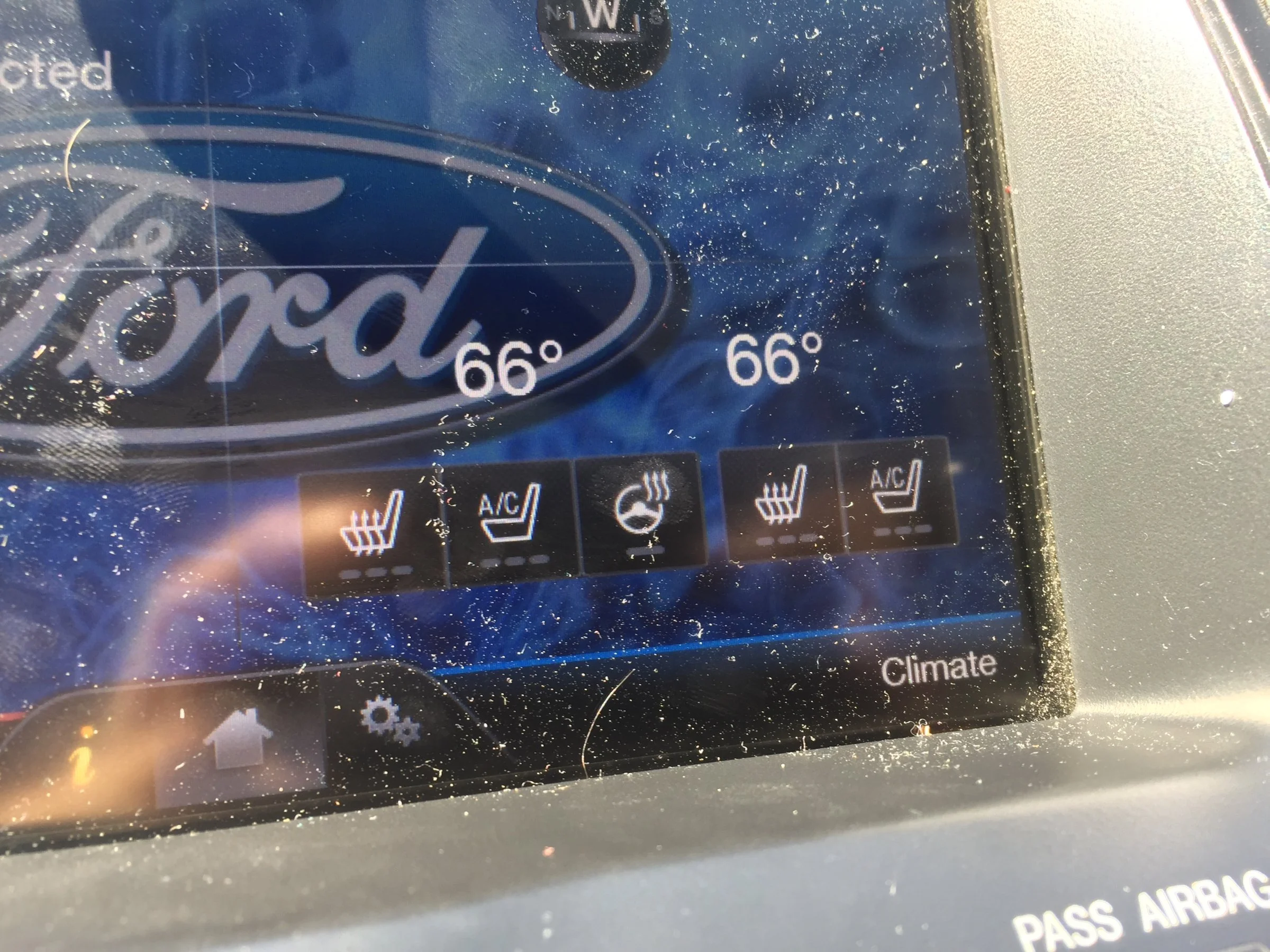

Bored, and been playing with the daily more than the Mustang.
Plugged in my laptop, and went from this...
To this
Obviously it doesn't work...yet. Found myself a heated wheel module on eBay. Going to see if I can plug it in and get a response. If I do...well I'll just need to find myself a steering wheel then!
Too bad the SHO alcantara wheel is $800+ in the heated version

Your screen is dirty
Guess I know what I'm doing Sat AM.
Found an SHO steering wheel on Ebay for $60. Scrap yard misidentified it. Heated wheel, paddle shifters, better leather. Really need to see if the wiring is present to do this mod. Already have the module to control it.
Reactions: 95BlueStallion and a91what

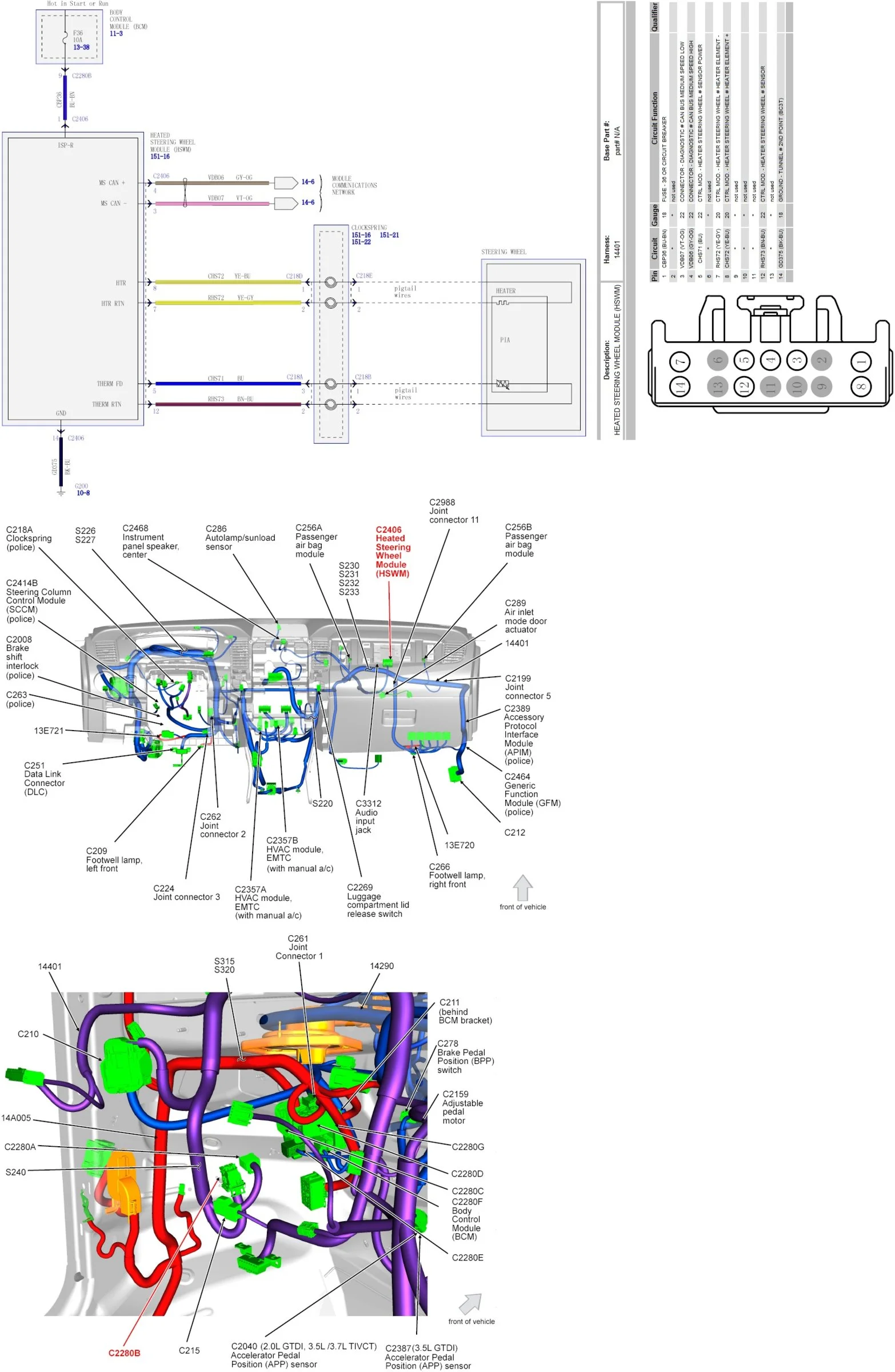

RaggedGT said:
Would it be a plug and play type harness?
Don't think so.
Going to go take one more look and see if it's tucked WAAAY back in my dash. I can pull the glovebox down and make it wide open

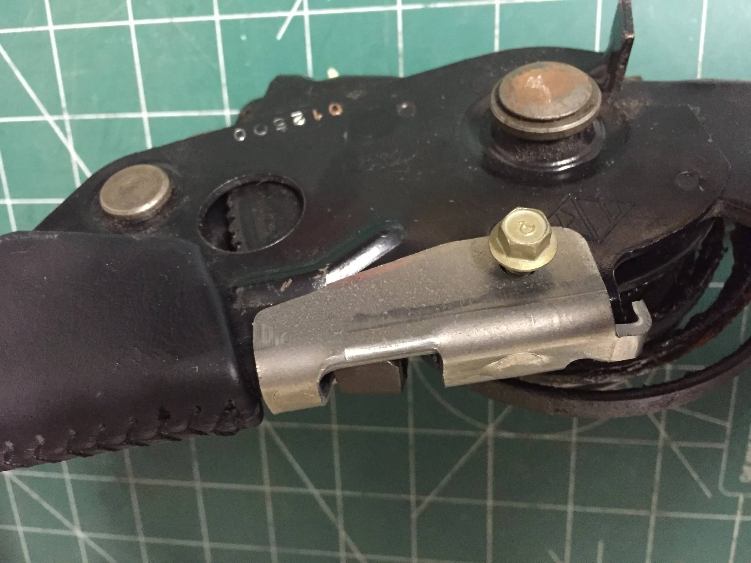

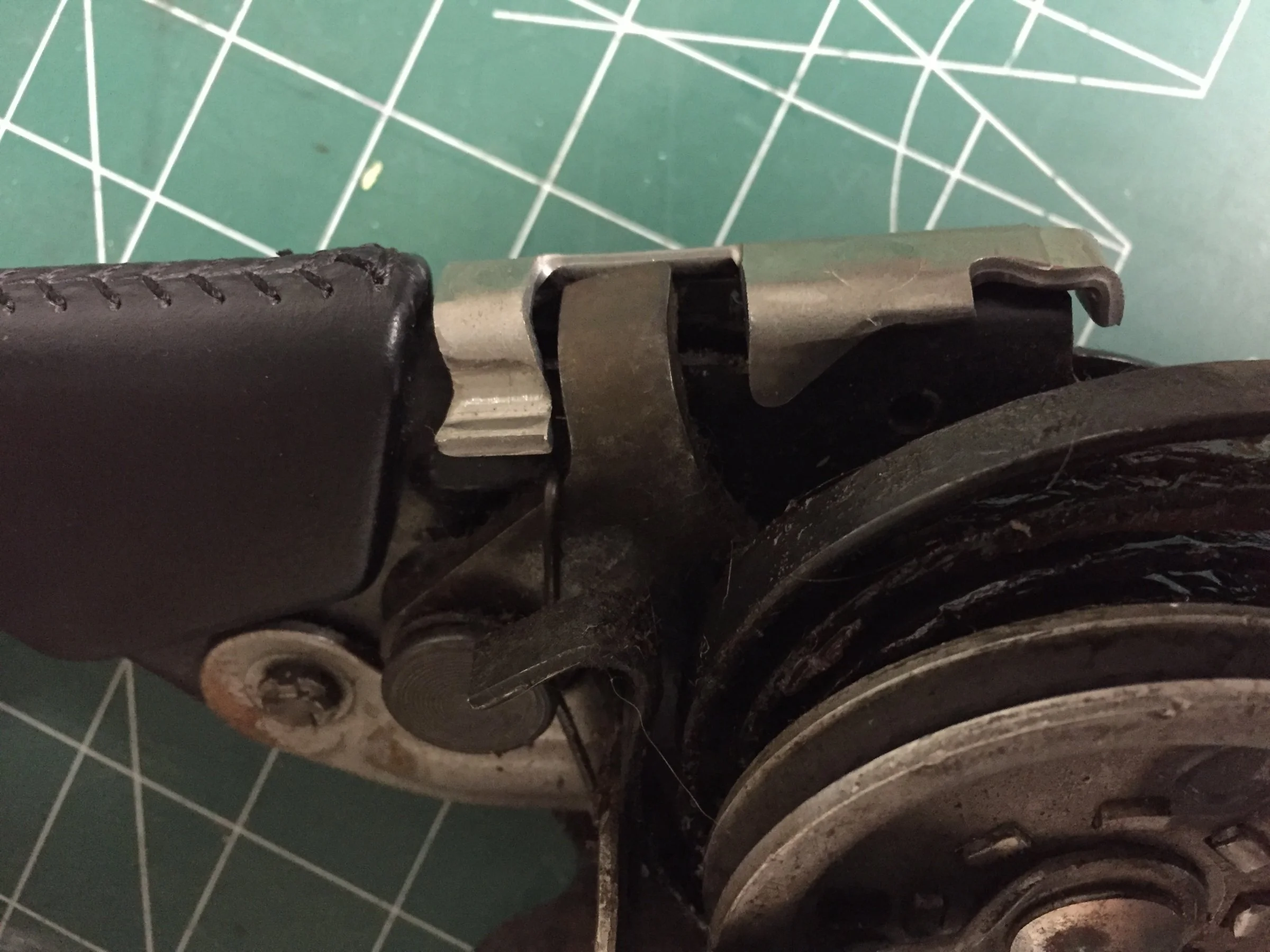

Part number
1R3Z-2A753-BA
So here's the piece.
Here's how it installs
The hole the bolt is in is not tapped, so I may run a tap through it first. But basically this locks the self adjuster mechanism similar to how us fox guys weld the handle. Unsure if this part will work on the fox handle, but I assume it is the same.
It can be installed without pulling the handle...and you can always unbolt it and adjust the handle from inside since it's not welded.
