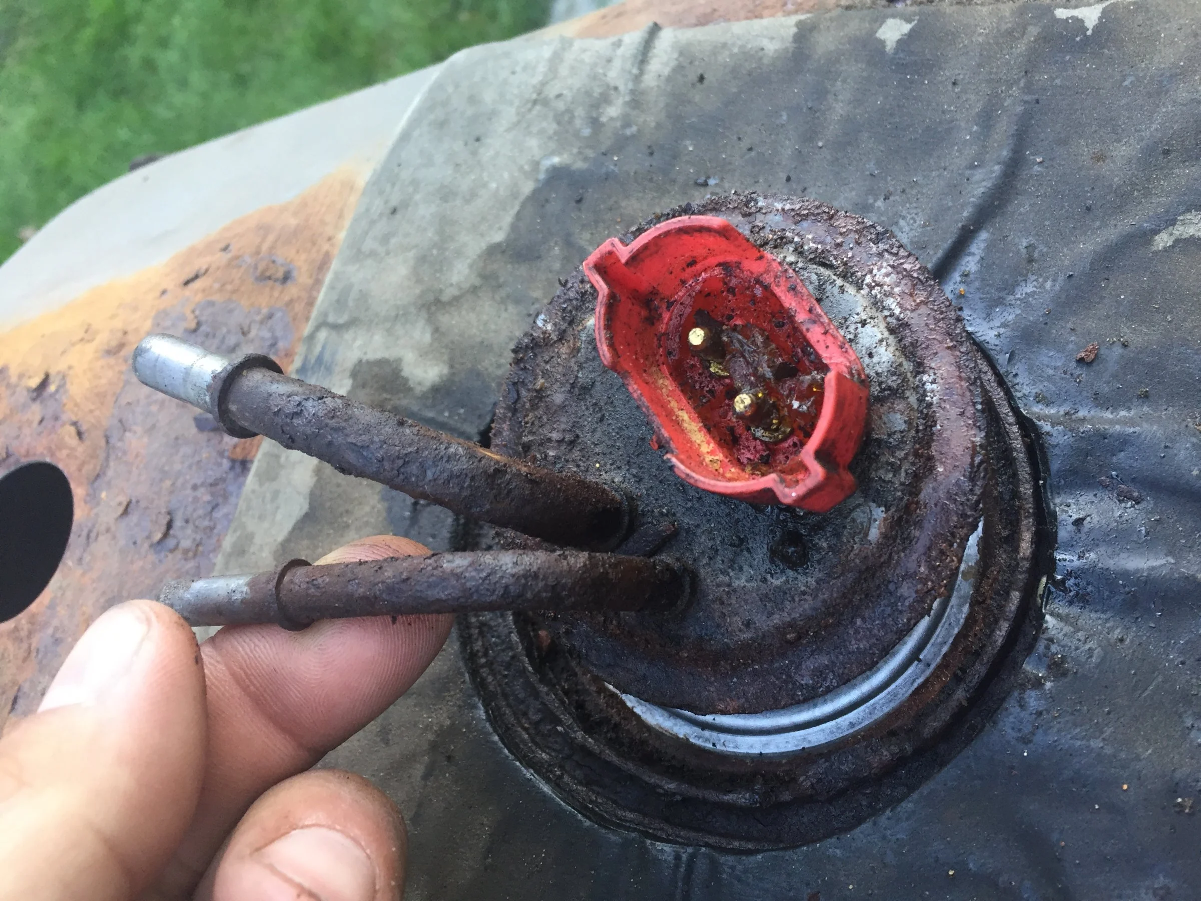

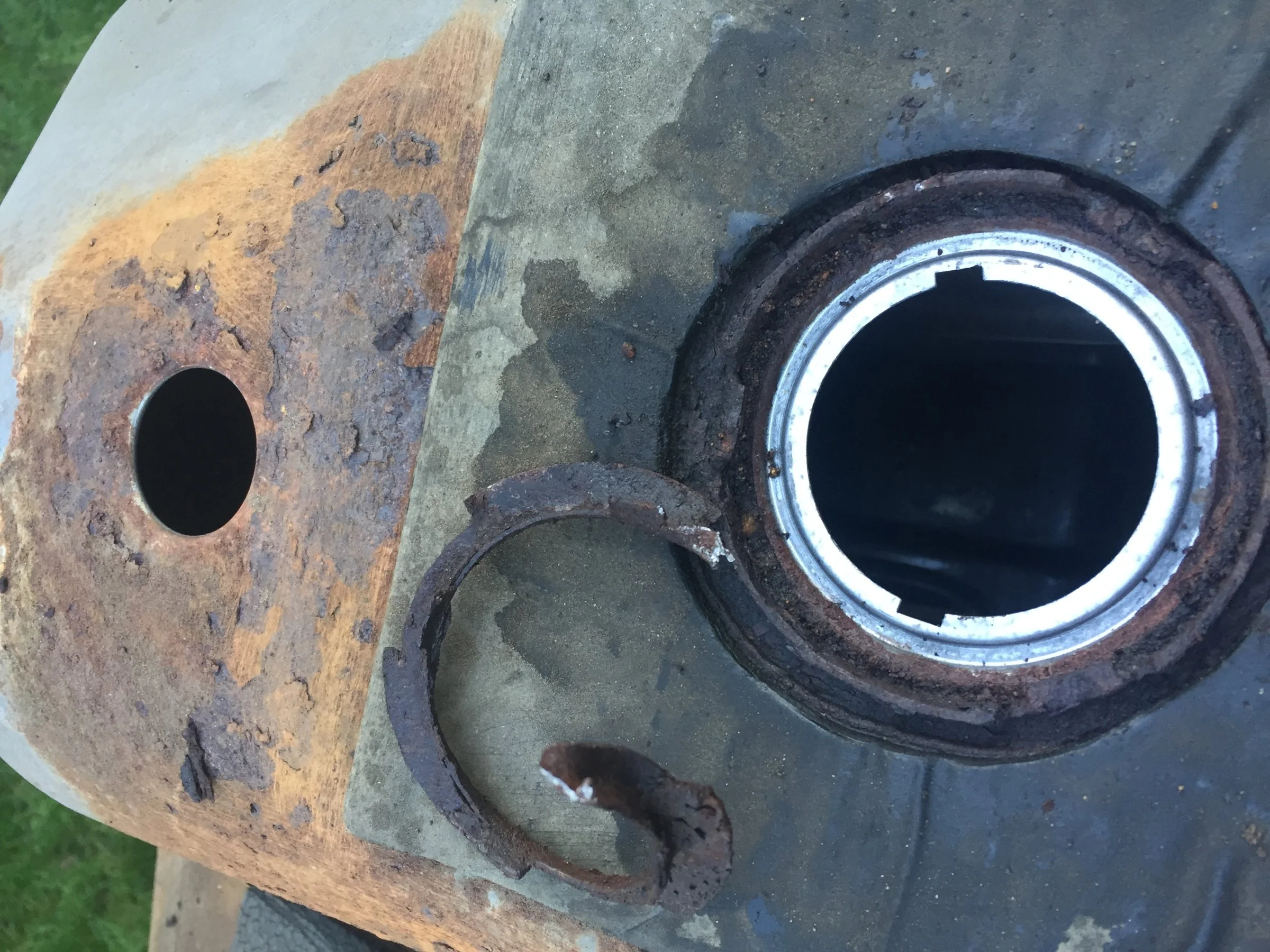

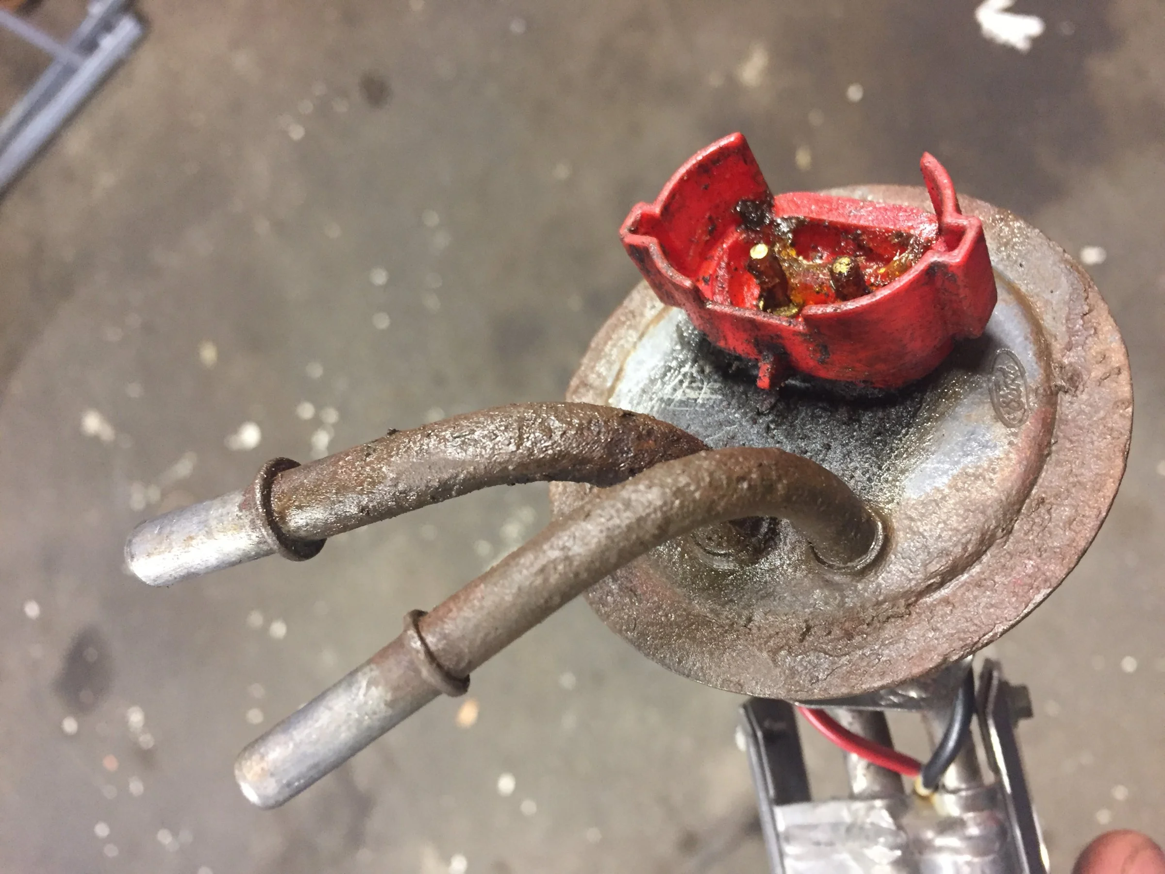

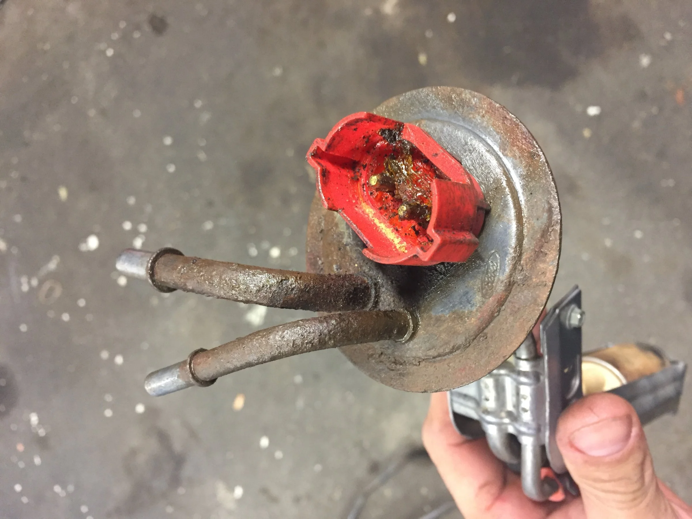

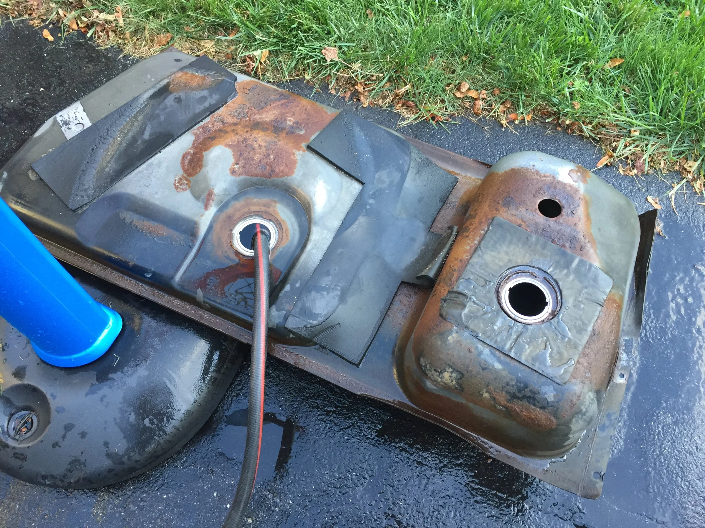

Got home and pulled the pump out. Was able to left a corner and snip the ring and get it all out.

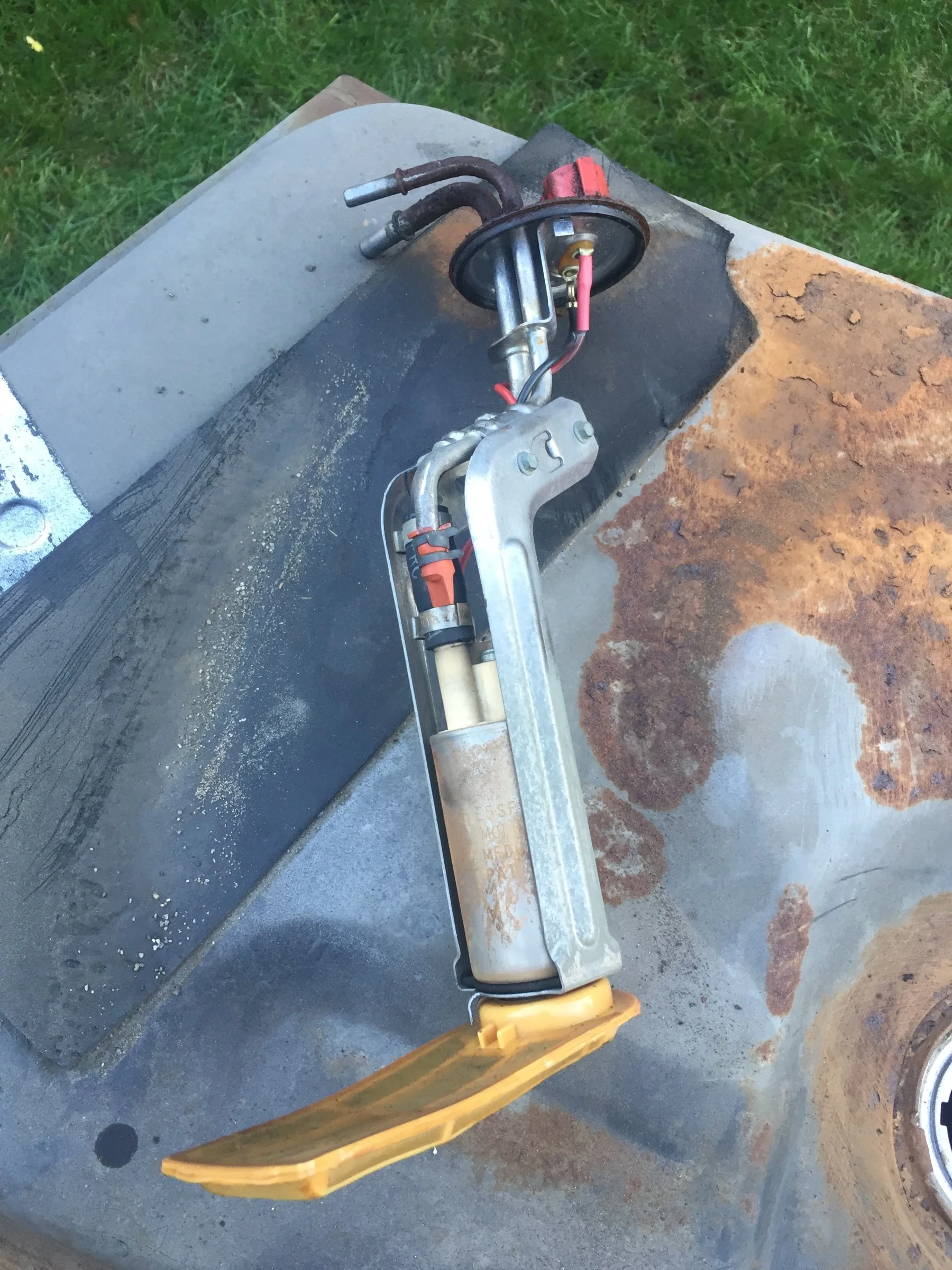

Original fuel pump with mfg date of Feb-1987. Amazingly if the baffle is the cause of my fuel starvation issues, then this pump is still good to go. Obviously I'm swapping it out but it did go 30 years, 5 months.
Pretty clean inside the seal

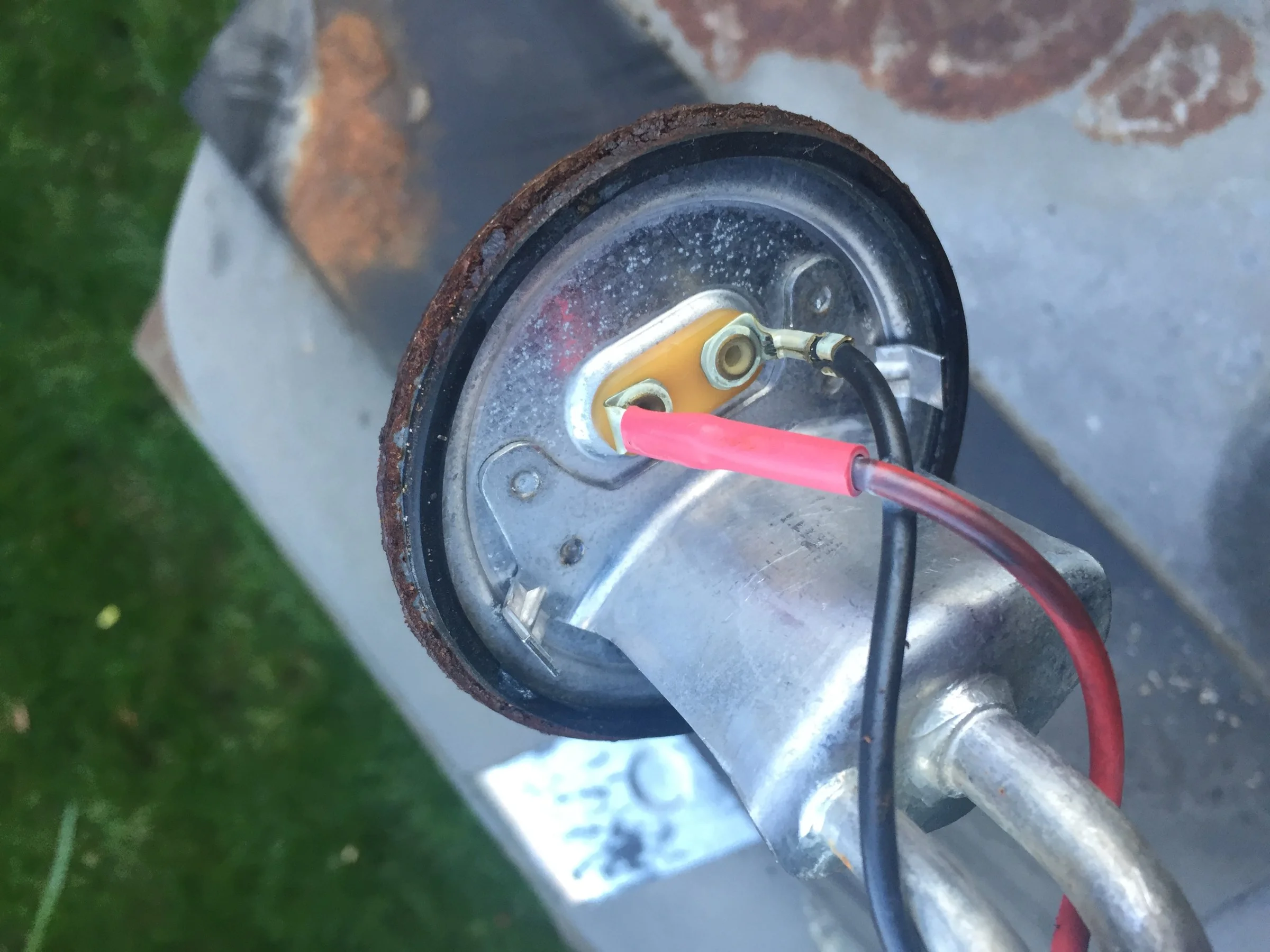

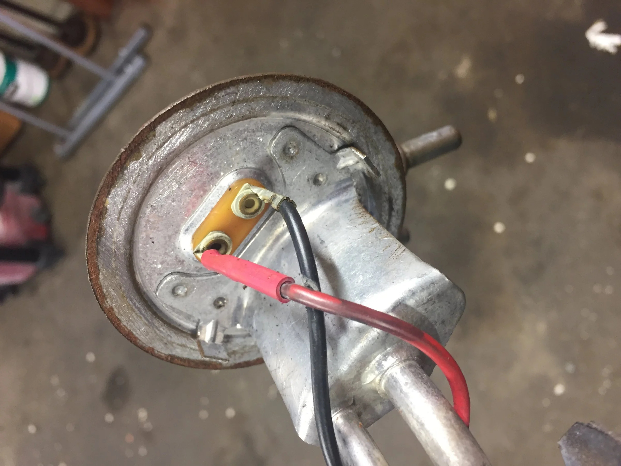

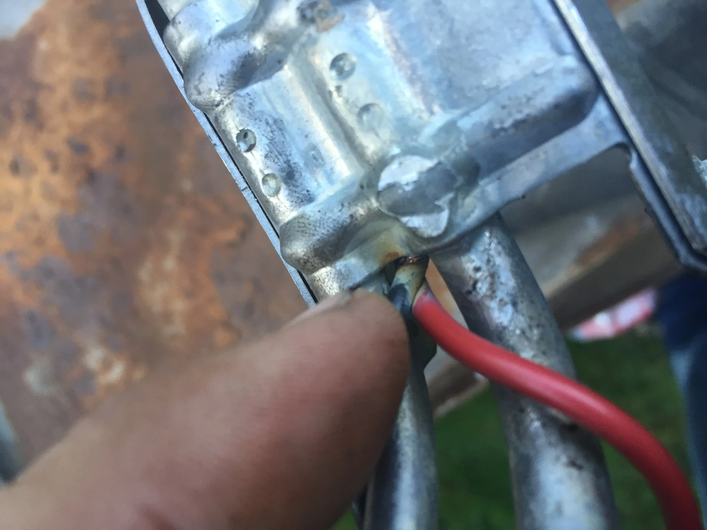

Looks like my ground wire shorted to the pickup

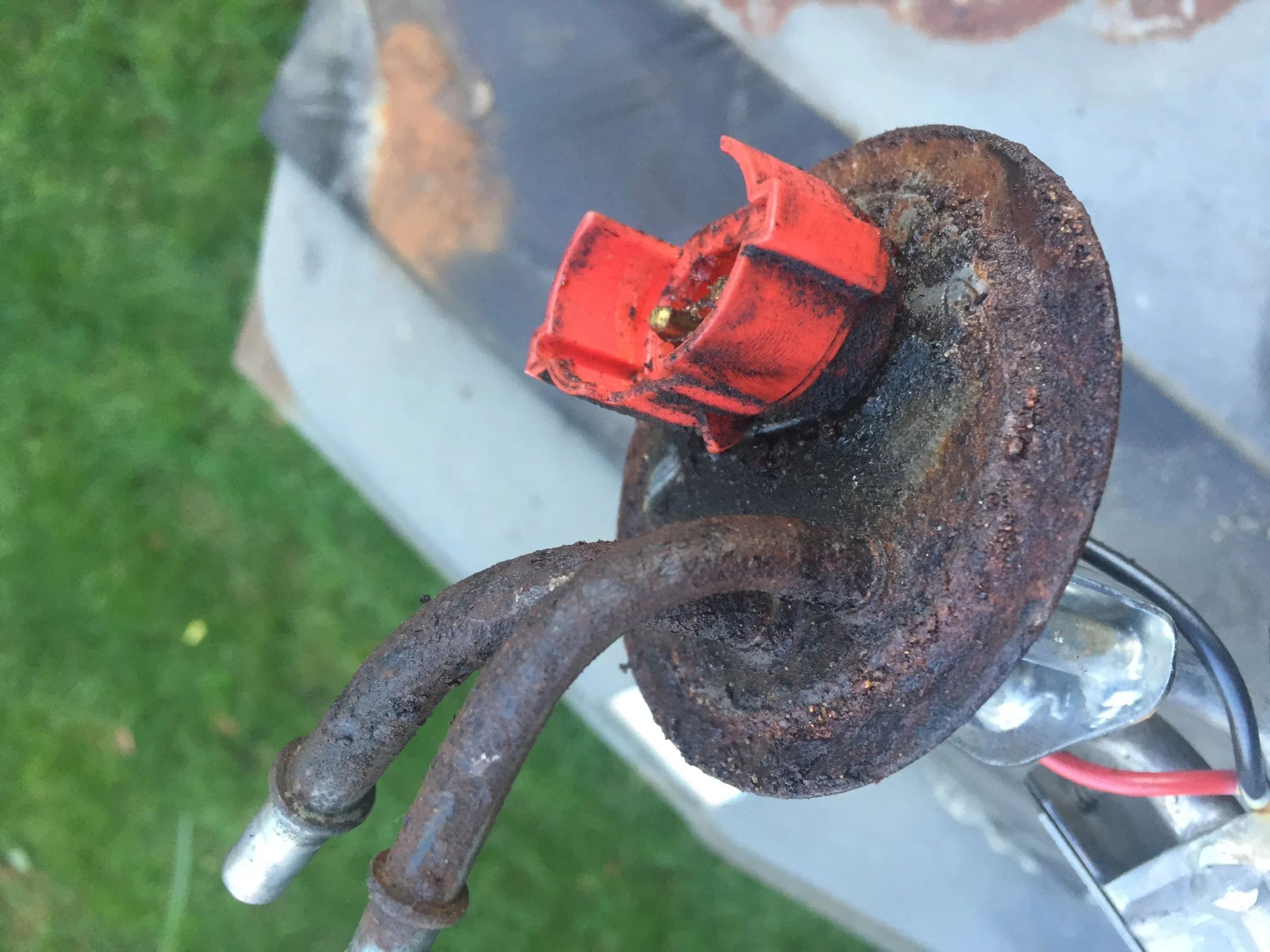

Working the pickup a tad. Making progress cleaning it up. What do you think? Put a little more elbow grease into it and then make a decision?
As for the sender,
Found from a few sources that spec is ~22ohms full, and ~145ohms empty.
So I tested mine.
Full range up = 16 ohms
Full range down= 170 ohms.
So explains why my Guage reads empty when I still have a little gas left.
