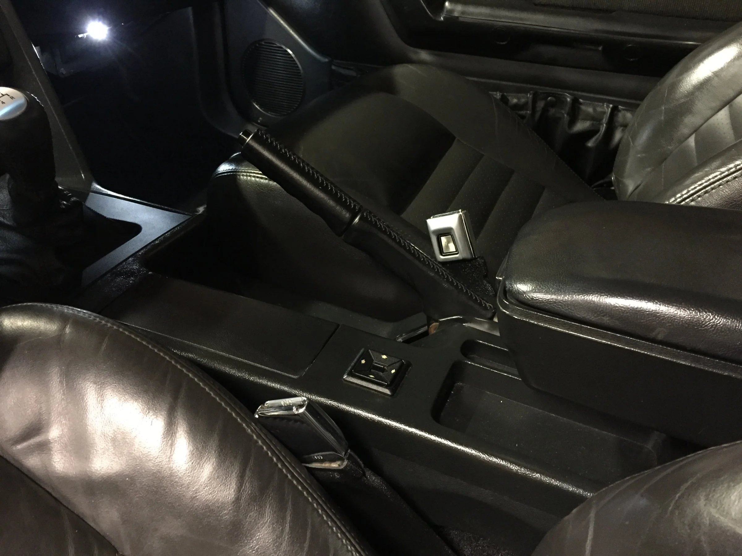

1998 Cobra parking brake handle installed

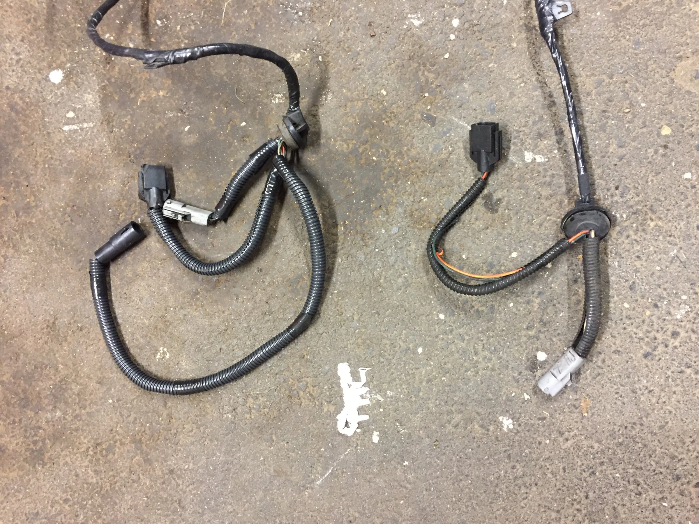

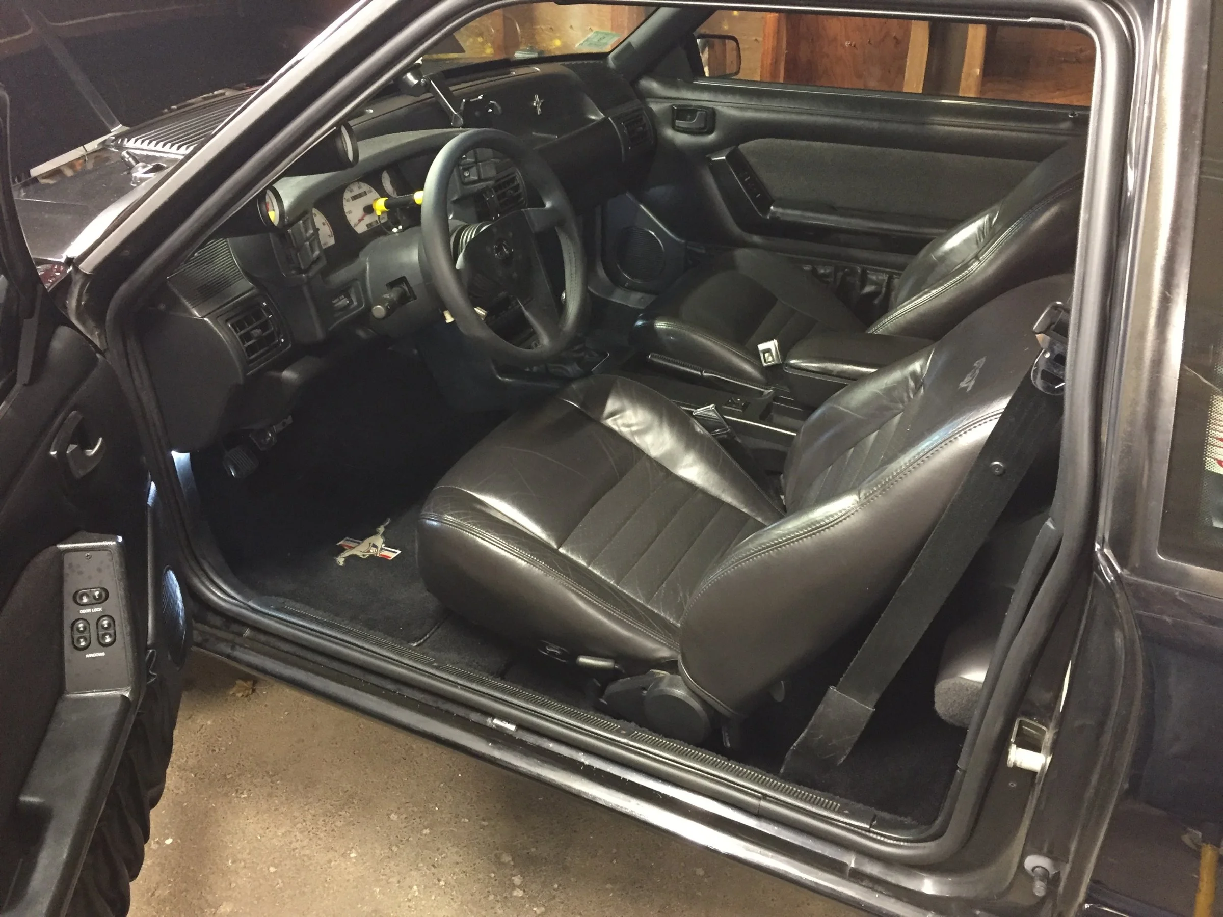

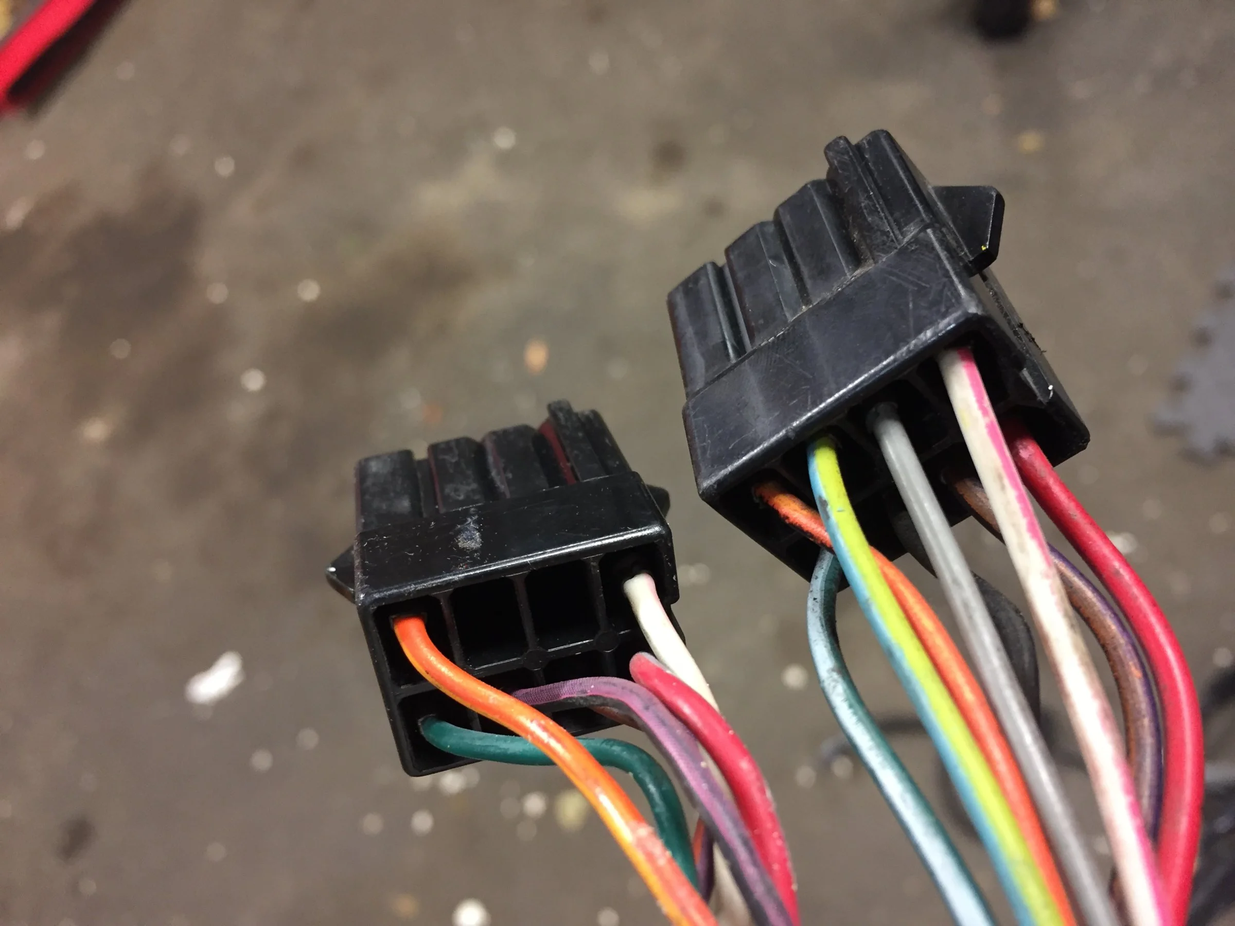

Also swapped out the trans harness. The AOD harness doesn't have the provision for the NGS on top of the t5. Since I'm going A9L mass air swap, I don't want a code 67 from not hooking it back up.
You can see the harness differences.
And interior back together and cleaned. Next up...drop fuel tank

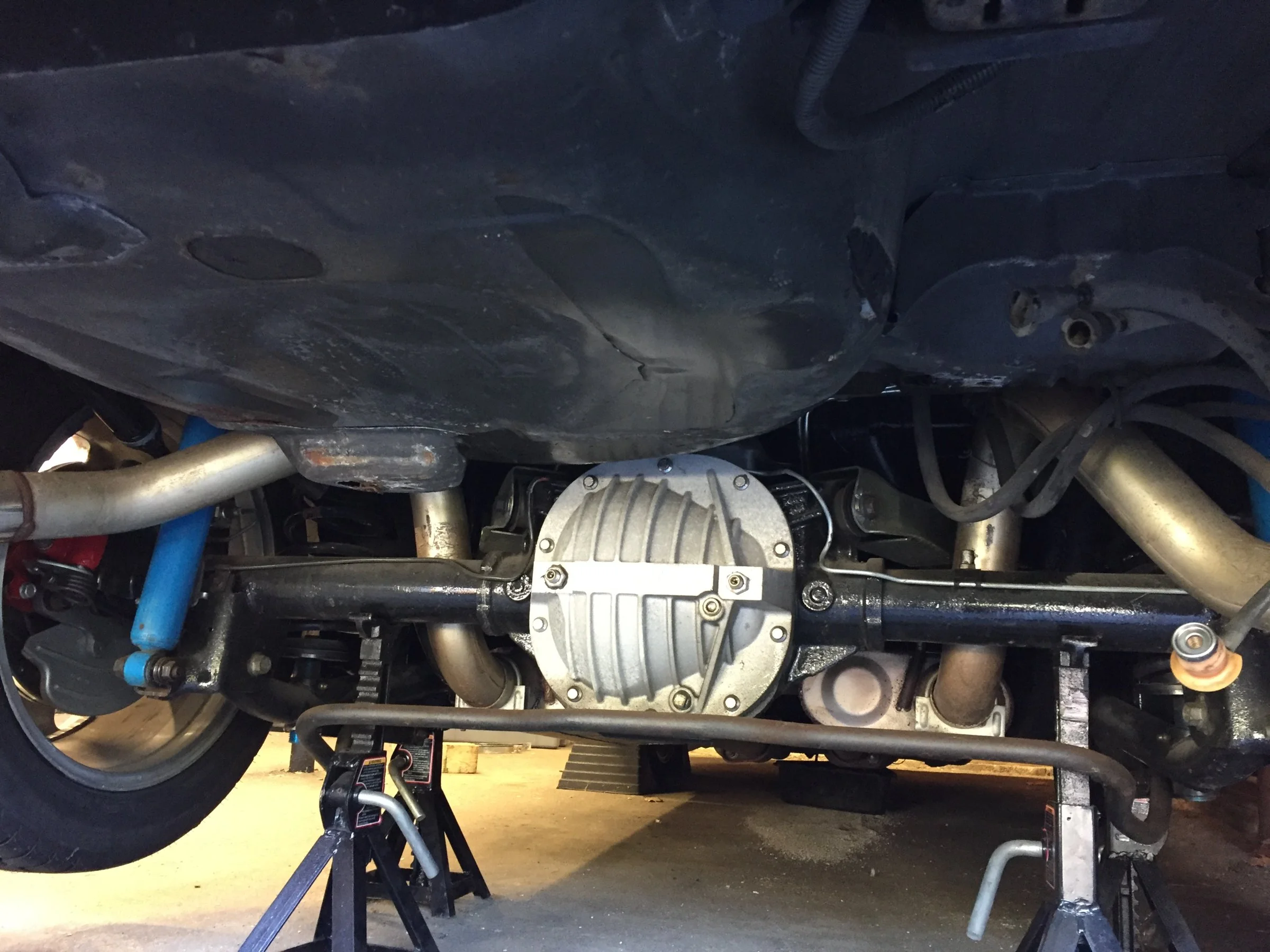

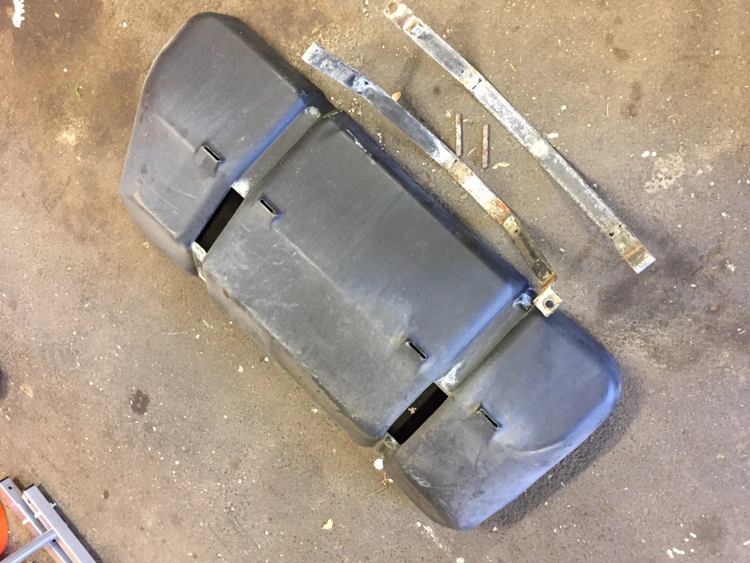

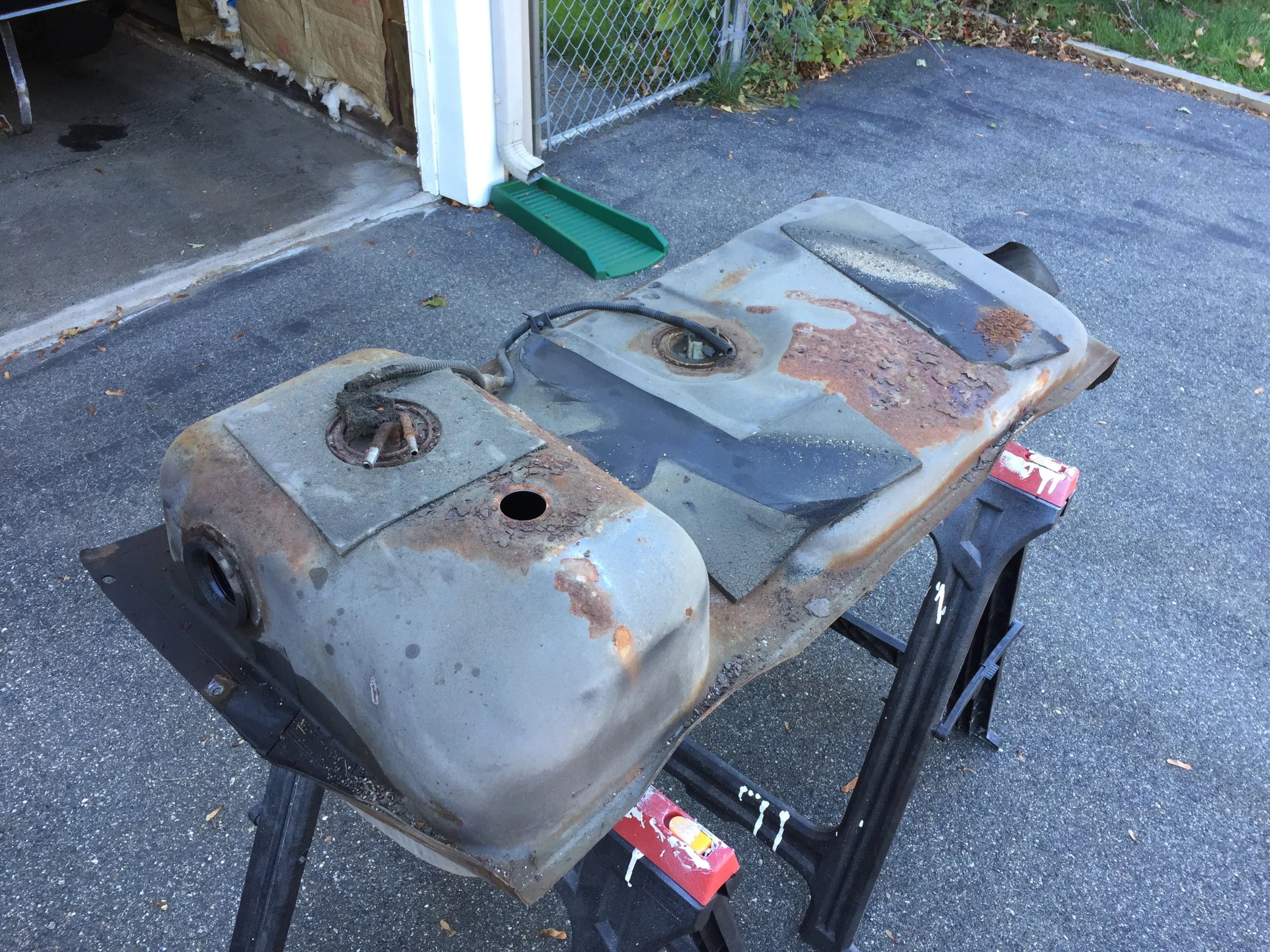

Well tank is down. Glad to see inside was clean and shiny...like new. Fuel filter was clean too.
Outside? Not so much
Underside of car pretty clean
Some things to paint.

So, oddly enough the sender is way off. Fill the tank and it points to F. Drain it to E, and well I pulled 4 gallons out of it after that.
Tank is siphoned as much as I can and outside venting off what remains. Inside is shiny and clean, so I don't want to replace the tank. Outside will need wire brush and paint.

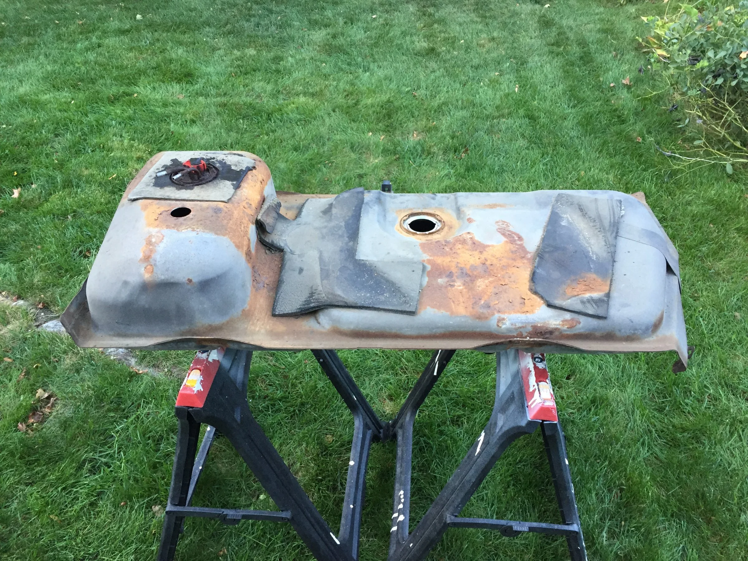

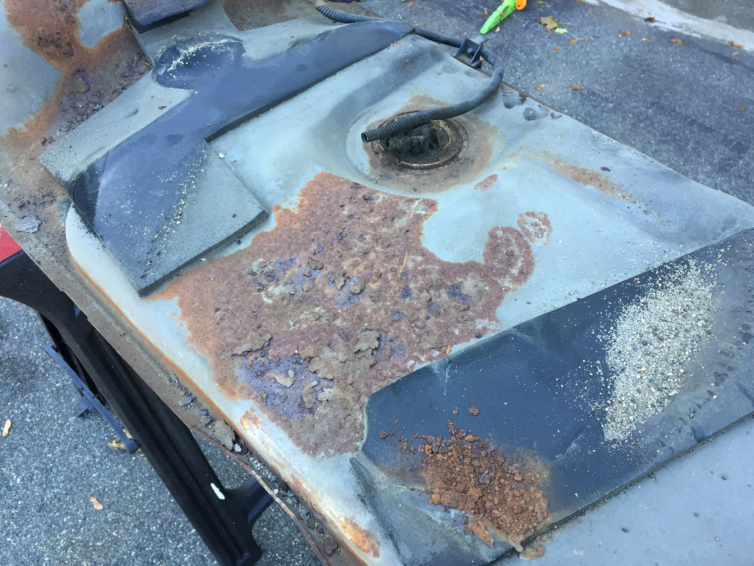

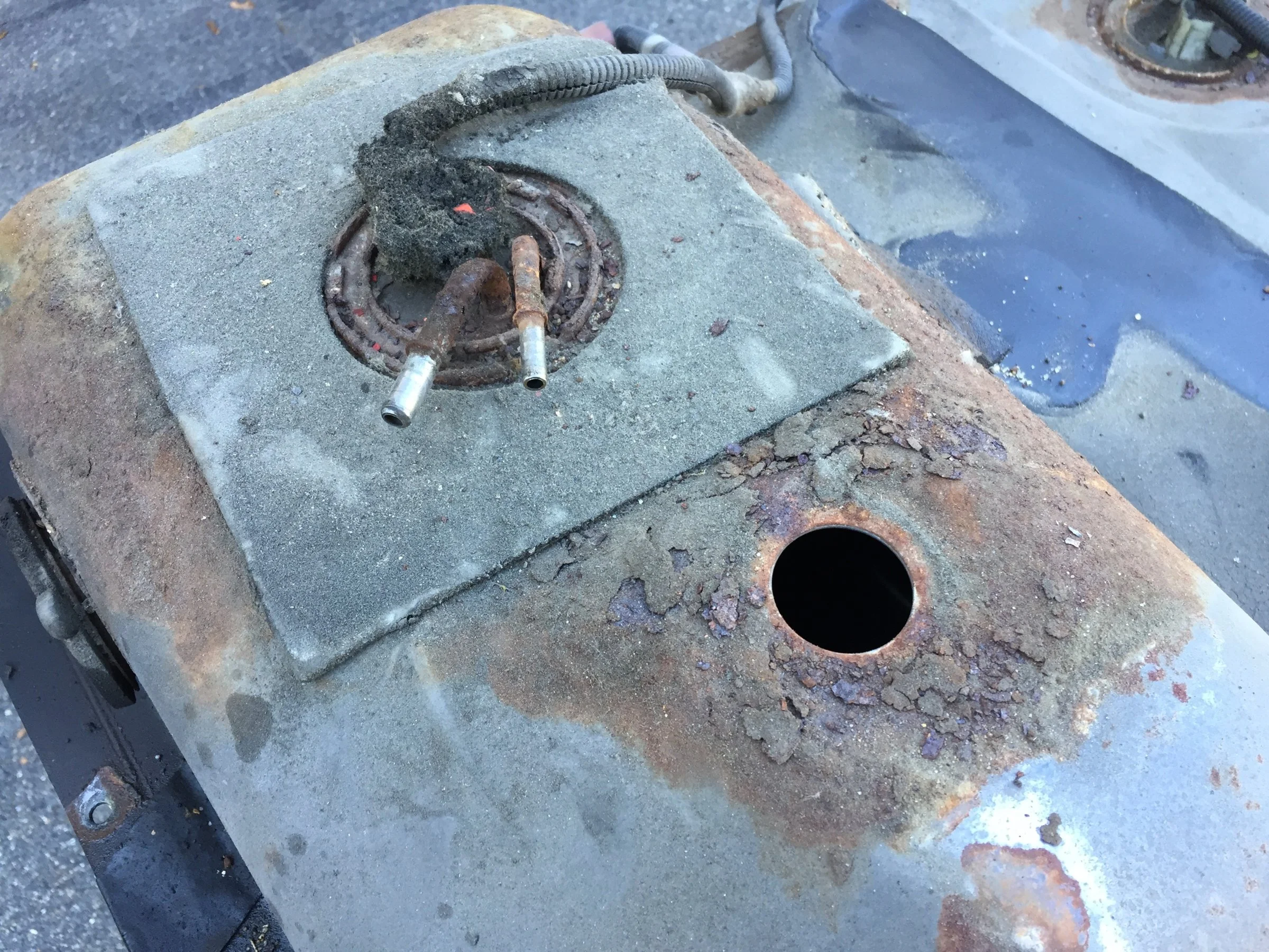

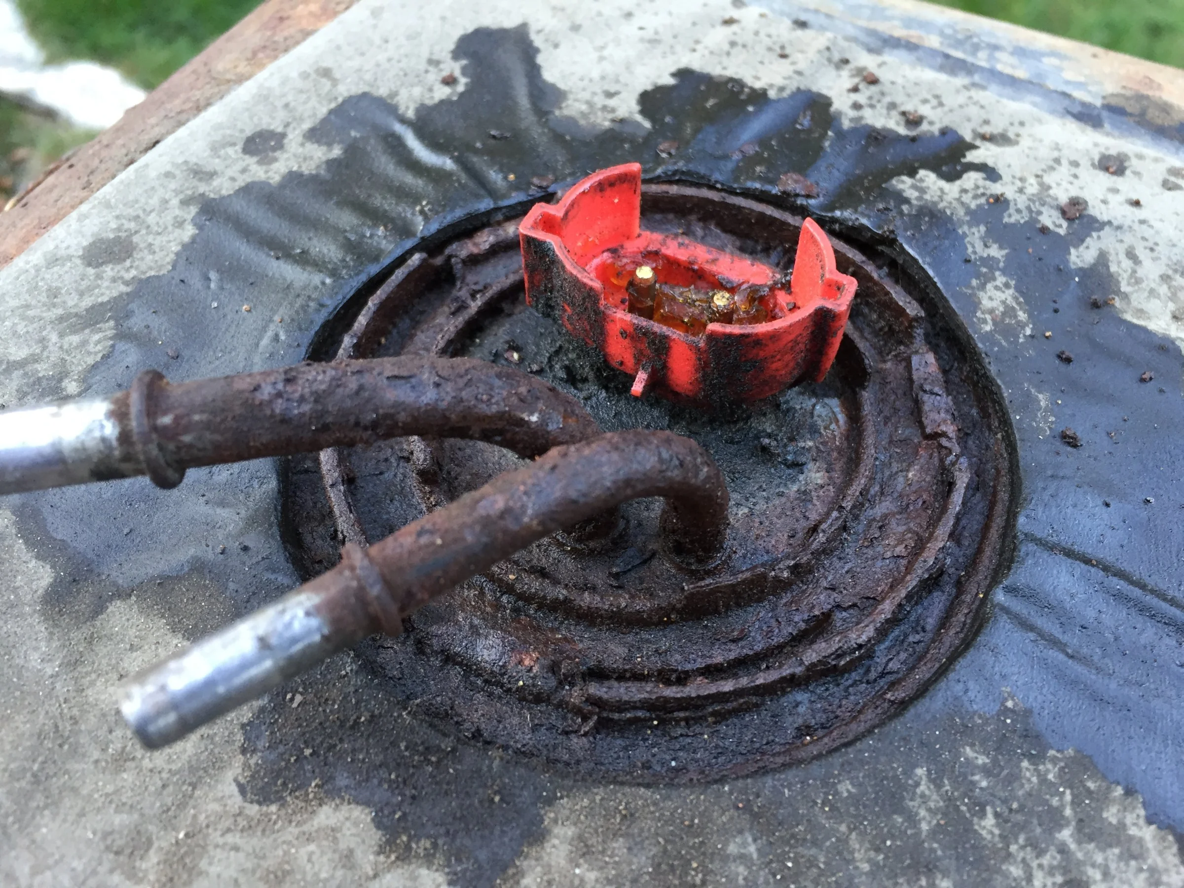

Pulled the sender and started cleaning tank. Some external surface rust but not too bad. TAnk completely empty and venting off in the yard.
I'm thinking por-15 here
Here is the problem. I can't get the lock ring for the pump off. It's soaking in on blaster now, but any attempt to spin in just ruins it. I'll Have to get a bit aggressive after I let the tank vent off for a day or two

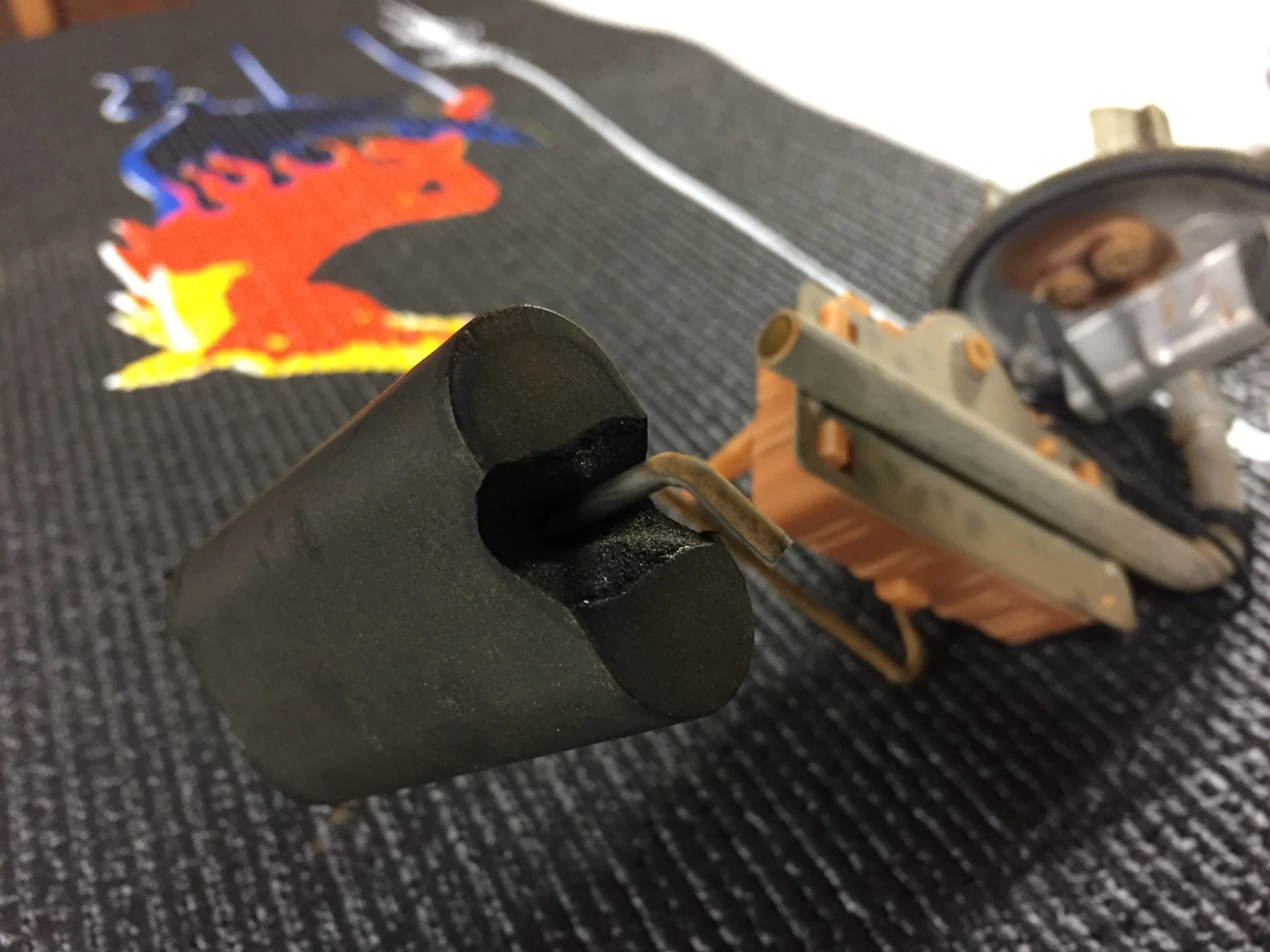

Sender looks ok, other than some damage to the float. I may replace it, but to be honest not sure I have a problem. Tank, when F points to full, and when on E, I still have 4 gallons left. Good enough for me
@jrichker would you happen to have a table of resistance values to check my sender against?

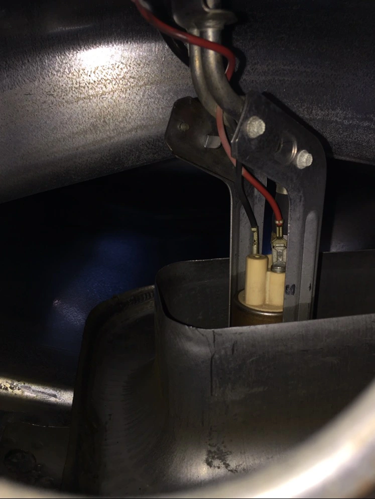

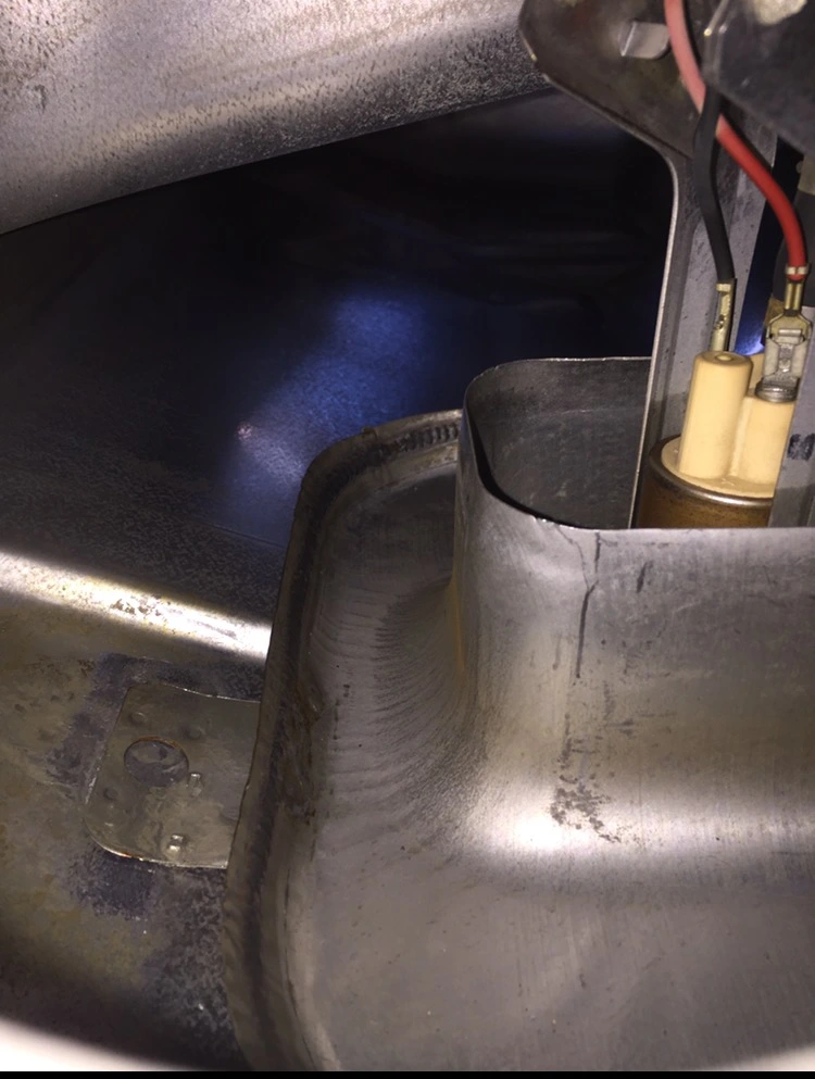

Inside of the tank looks great, why I'd hate to scrap it.
Btw, is the baffle around the fuel pump supposed to be loose? This one can move around .

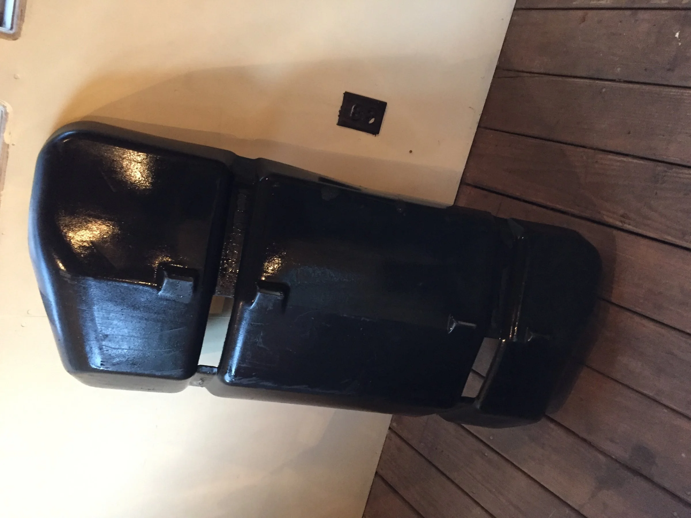

And starting the clean/paint phase
No jb weld it

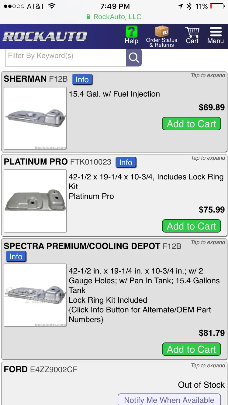

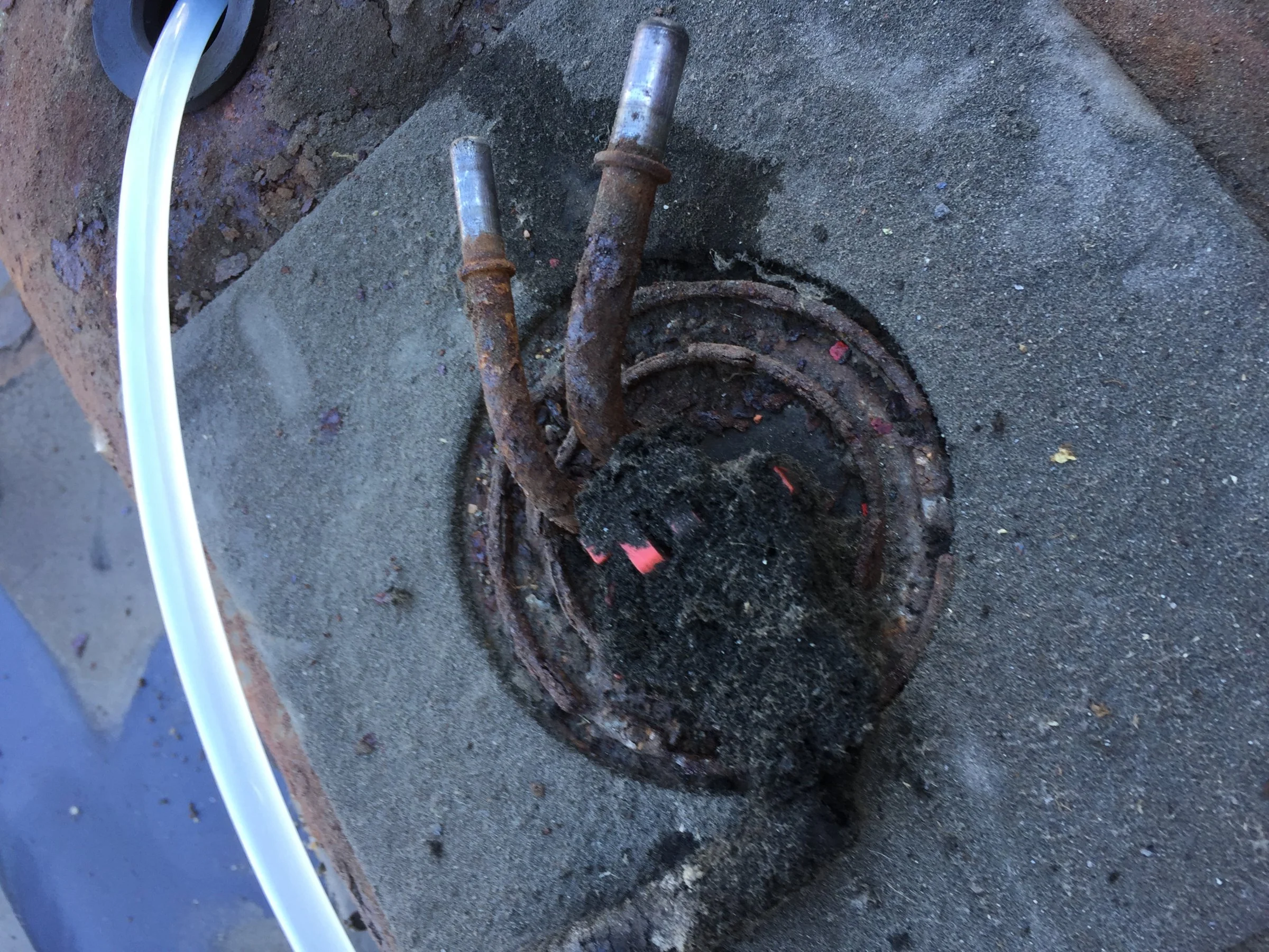

Googled and found people do use jb weld to fix these. How the hell do you get it on there? Not much access.
Well this might explain why my fuel pressure drops under acceleration.
This turned out interesting. Might just order up a new tank

First you thoroughly clean the tabs and mating surface with acetone. Then you put a dab of mixed JB Weld on each of the tabs . Let it set overnight. A couple of large super magnets can be used the hold the baffle in place until the JB Weld sets.
