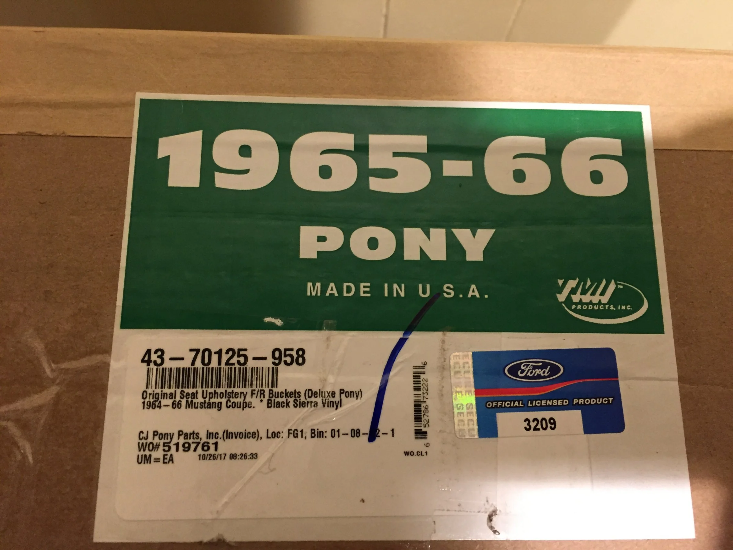

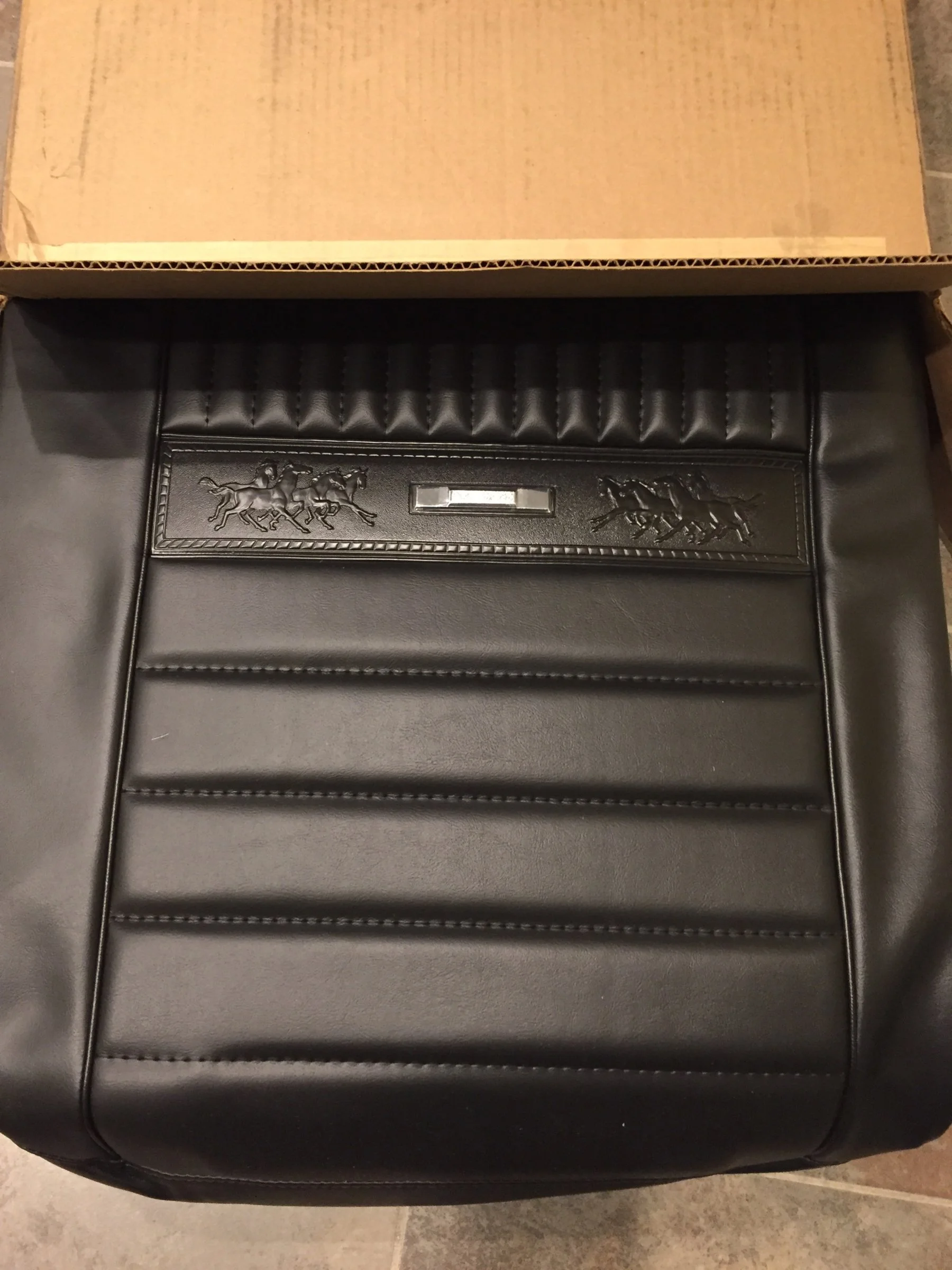

Anyway. Ups delivered my package. I leave work early and rush home...
Wait??
What's this BS??
Apparently they have their internal bin sticker for the 85-86 kit on a 65-66 kit. So now I gotta ship this back and wait for the next one

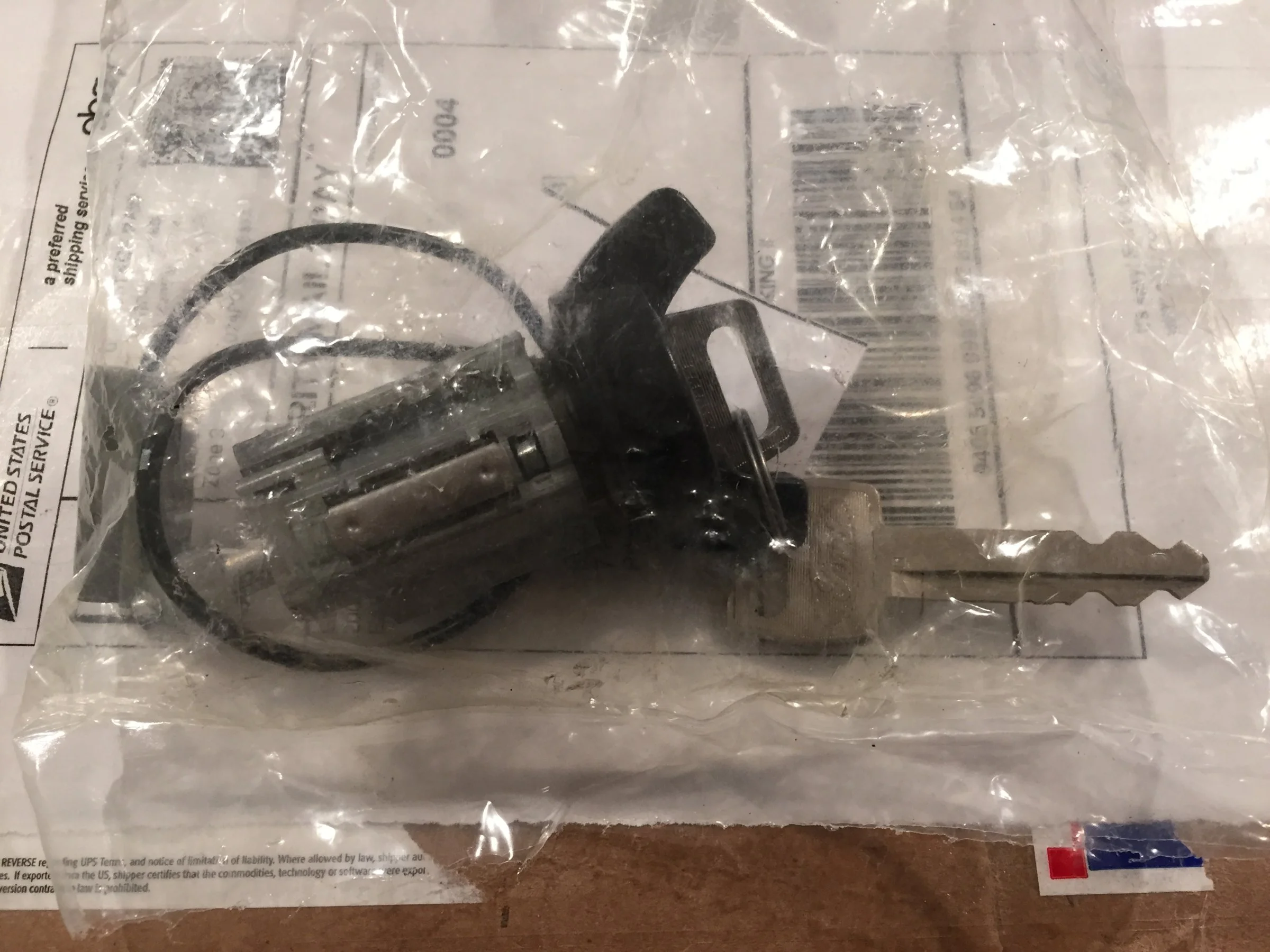

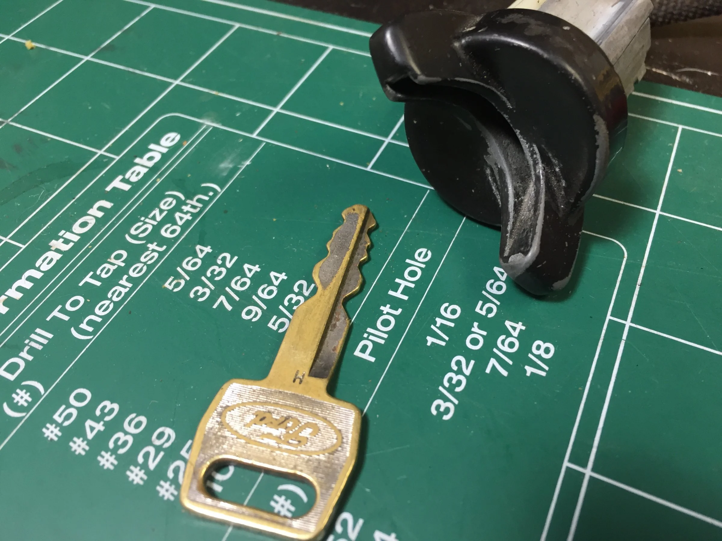

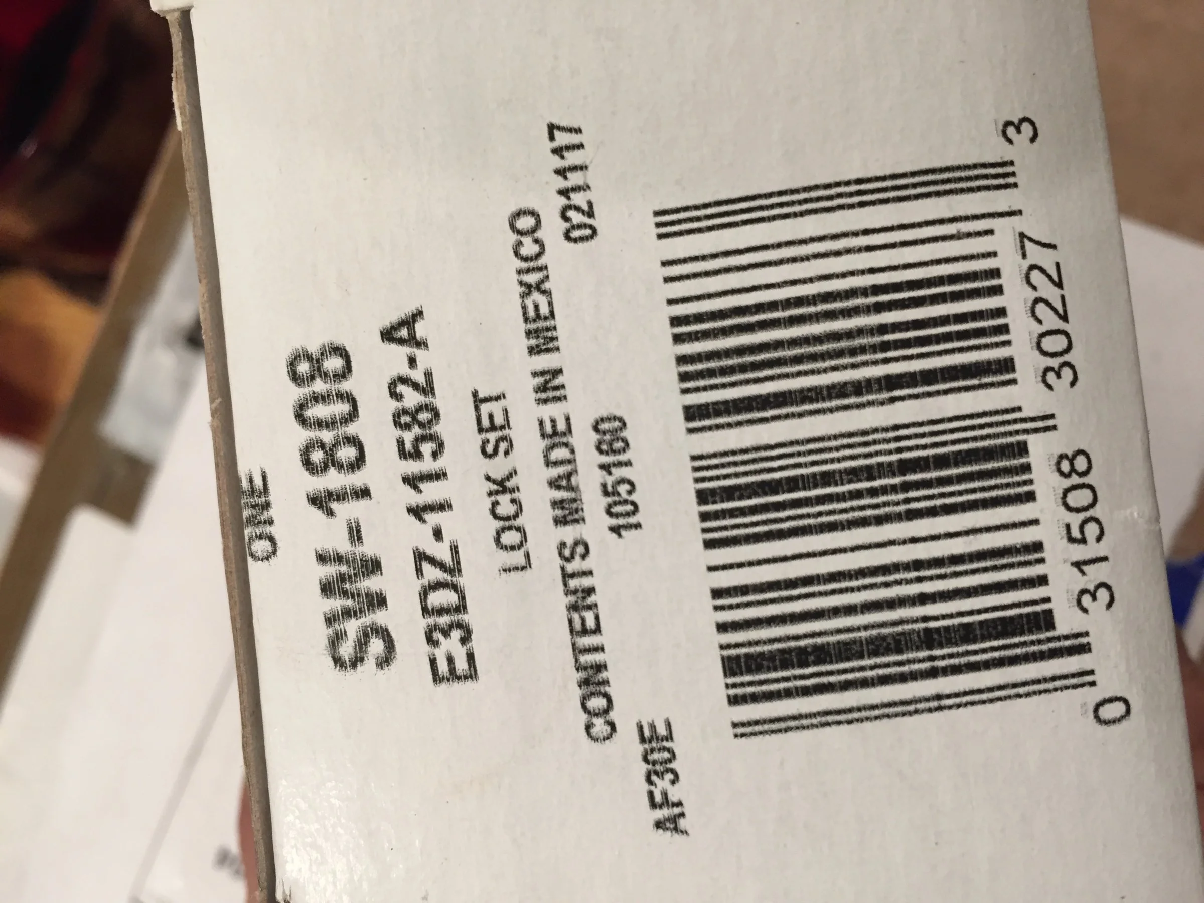

Got myself a new ignition and set of keys. Killed two birds with one stone. Wanted a new ignition key, and my cylinder was all scratched up and needed refinishing.
Was going to buy a LRS repro, but this oem Ford unit was same price. Google SW-1808

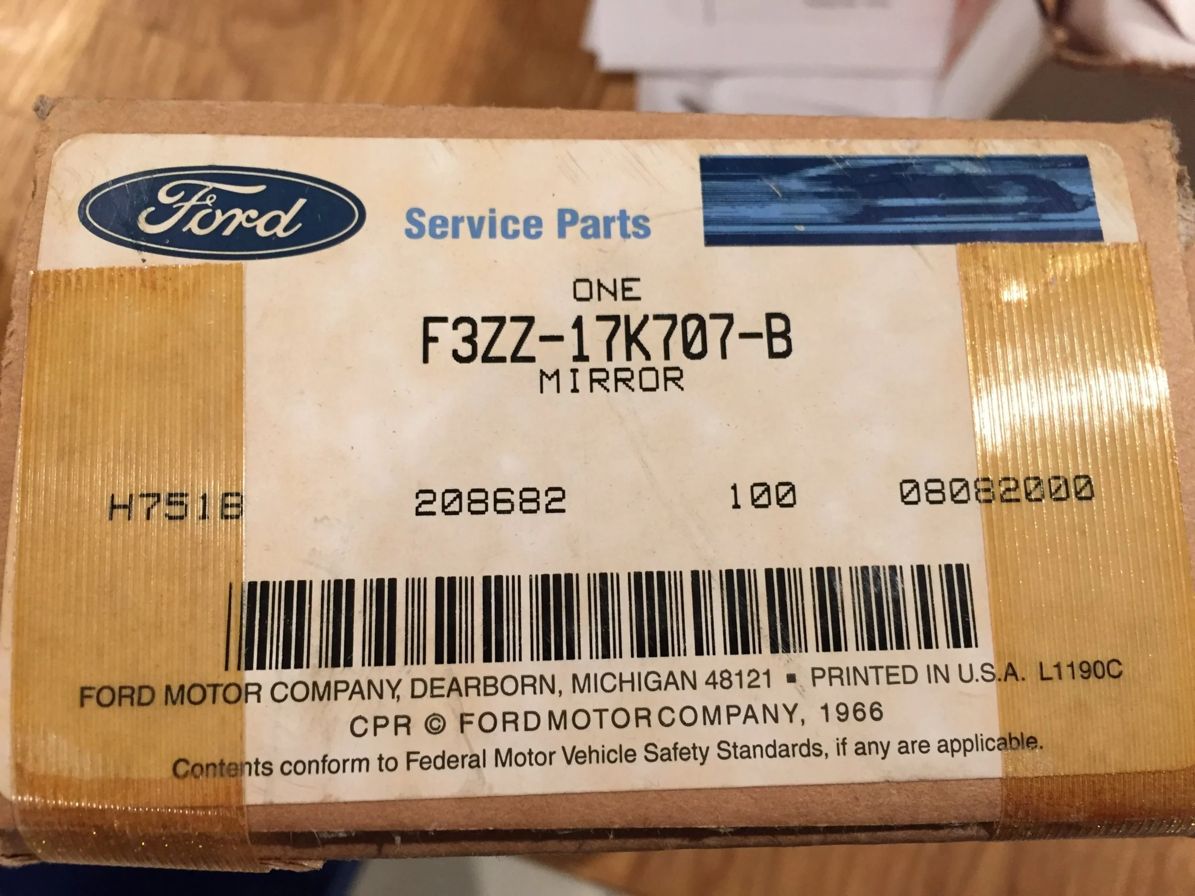

Also, sniped an NOS drivers mirror to add to the hoard pile. Still sealed

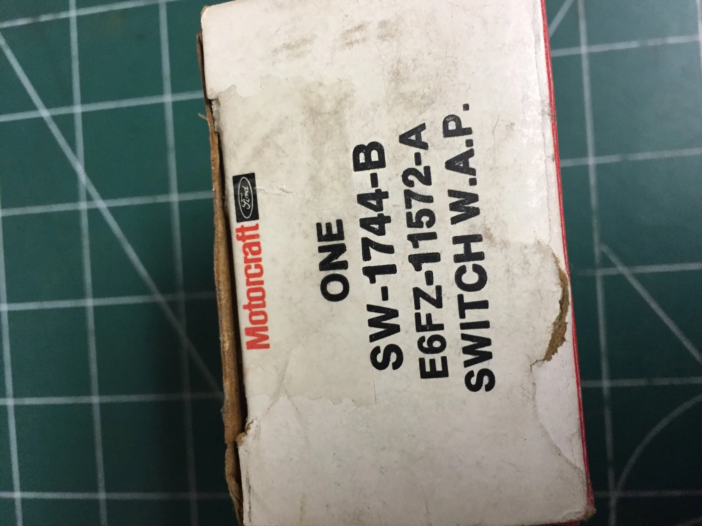

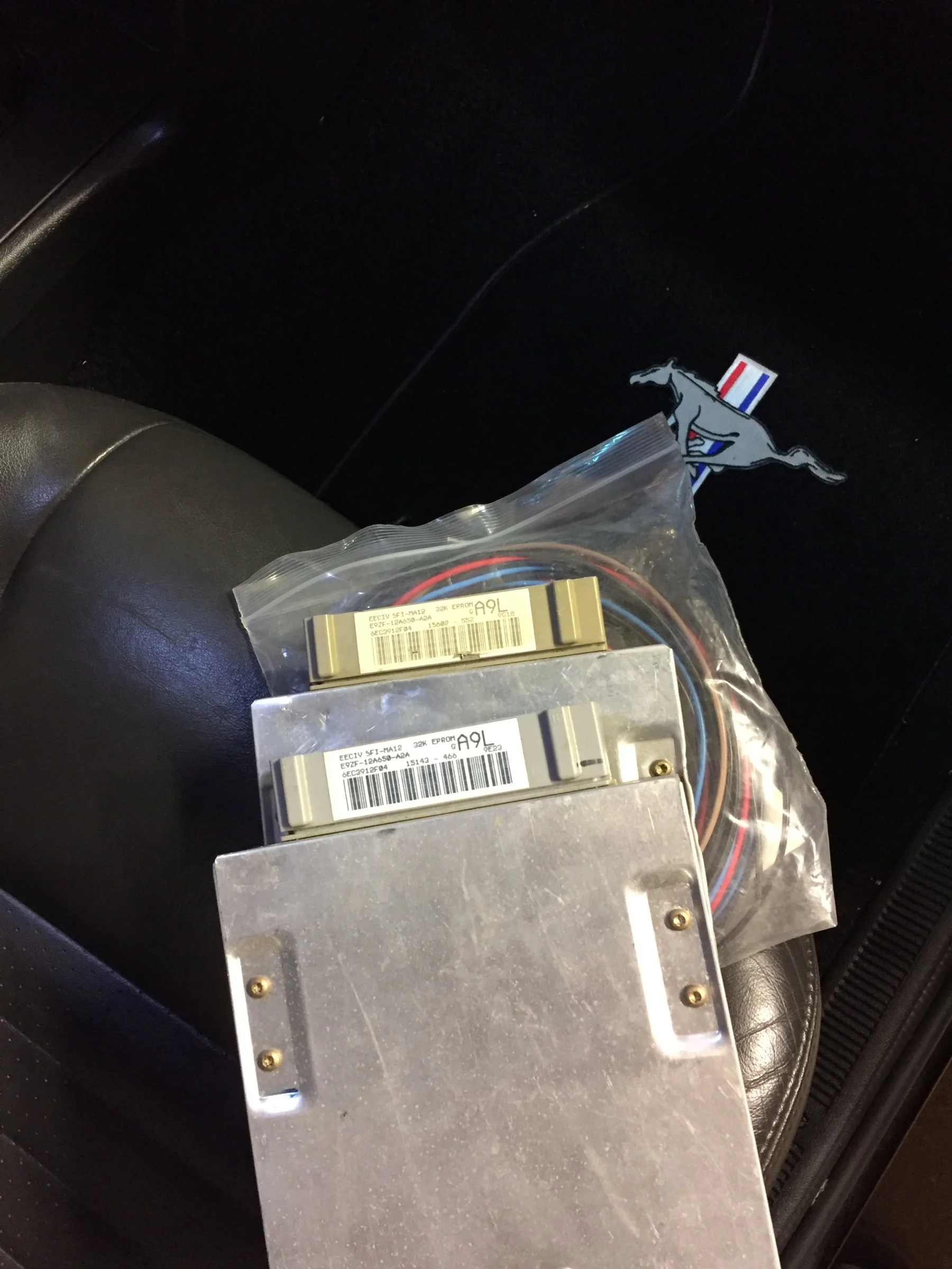

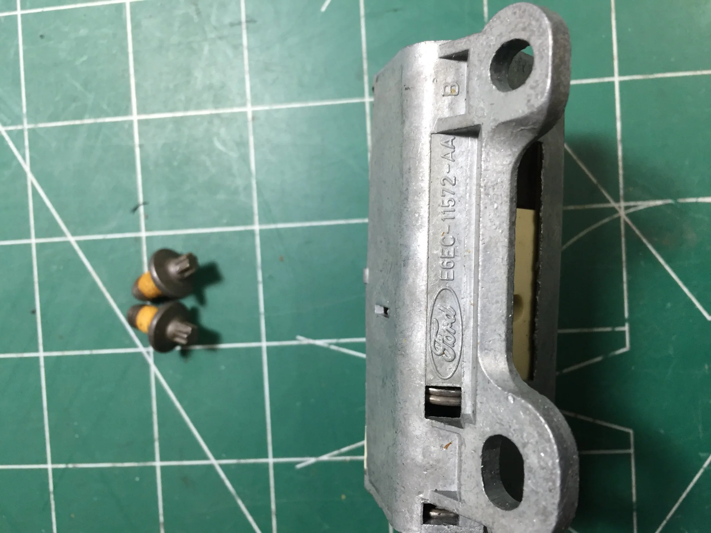

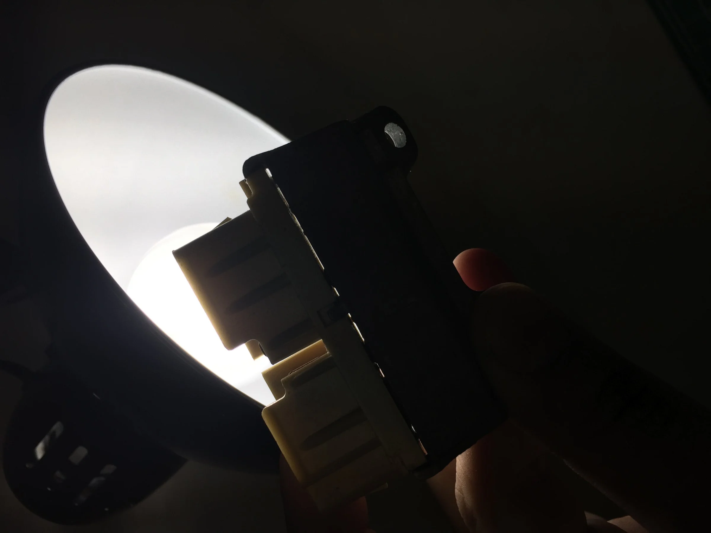

Lesson learned. If you are going to order an ignition switch module off eBay, make sure it's the correct revised module (SW-2474) and not one of the ones removed from service due to the recall.
Look at that gap right out of the box
Reactions: 02 281 GT
Yeah, that eBay seller is probably not too happy I am returning it.
I checked mine tonight while installing my new ignition cylinder. It's actually one of the new F2 ones that was the replacement during the recall. Mine looks brand new, so going to leave it.
Oh and 30 years almost to the day my car was built...the original key gets retired. Those teeth were pretty worn out.
New key cylinder nice and tight and shiny black. One more new item

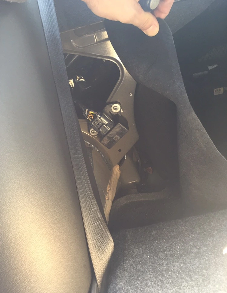

Heading to work and remote start the Taurus to warm it up. I hear it start. I get ready, walk out to car and it's off. Hmm. I get in and try to start and it cranks and cranks. Hmm.
Fortunately, I knew what it was. The fuel pump control modules on these are junk. ONLY the ecoboost models have a recall. The n/a engines don't apply to the recall.
Didn't even bother testing anything, I was that confident. I bum a ride to the local Ford dealer, pay $70 for a new module, and I'm back in business.
Module is located behind the rear seat back. I found one on eBay for $35 new and bought it as a spare....ironically from someone else who bought it as a spare until getting rid of the car.
