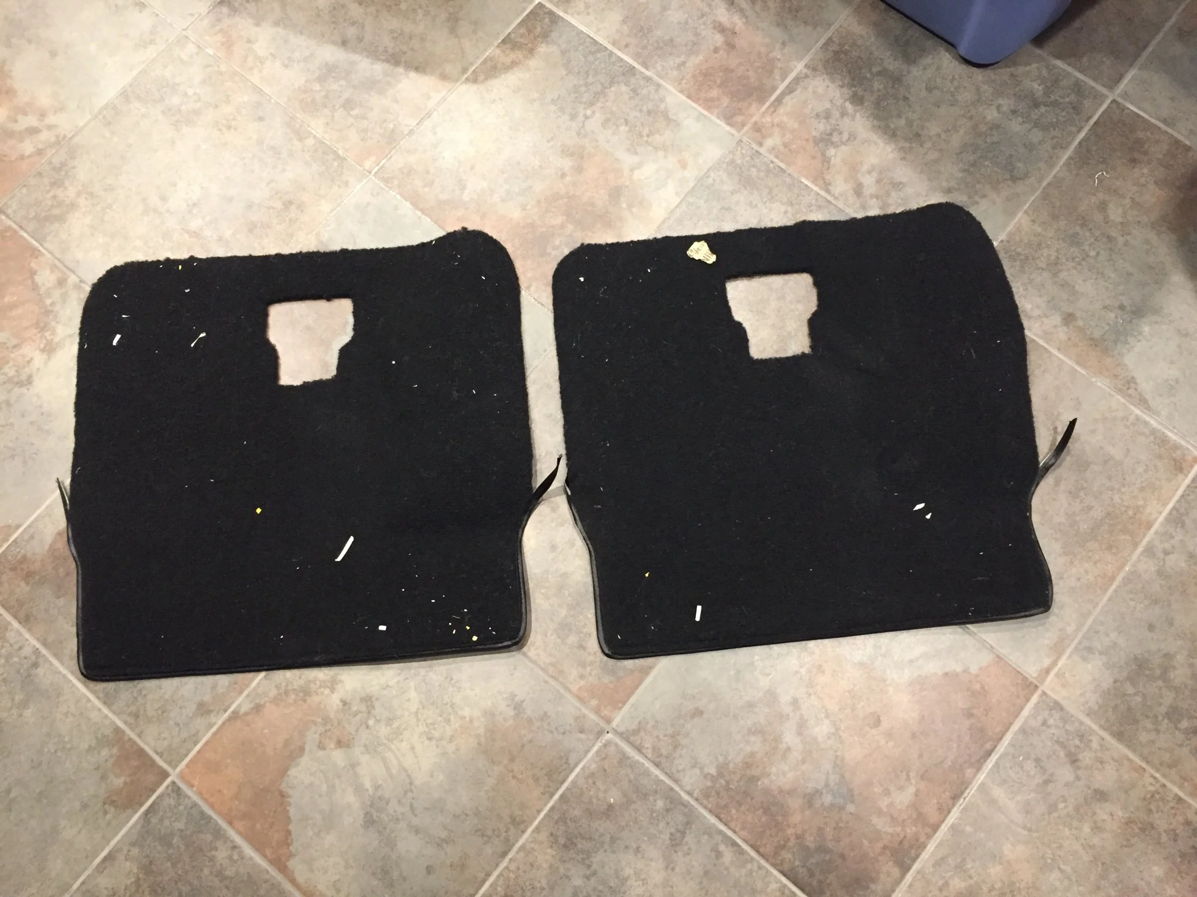

Got my seat carpets from someone on a FB group. Guess bookface came in handy for once

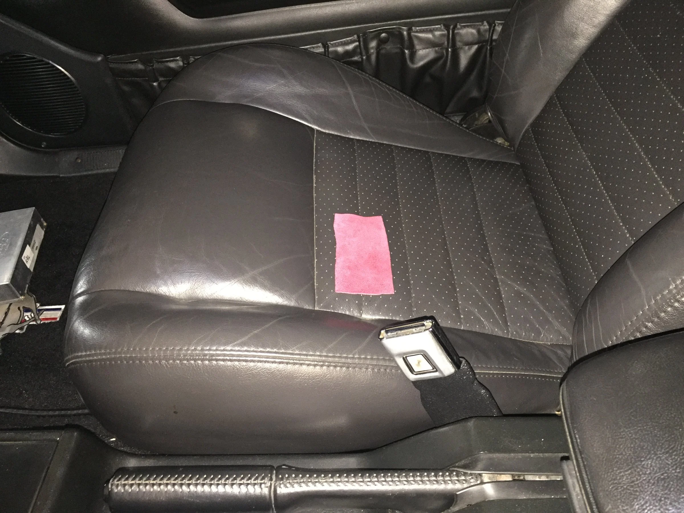

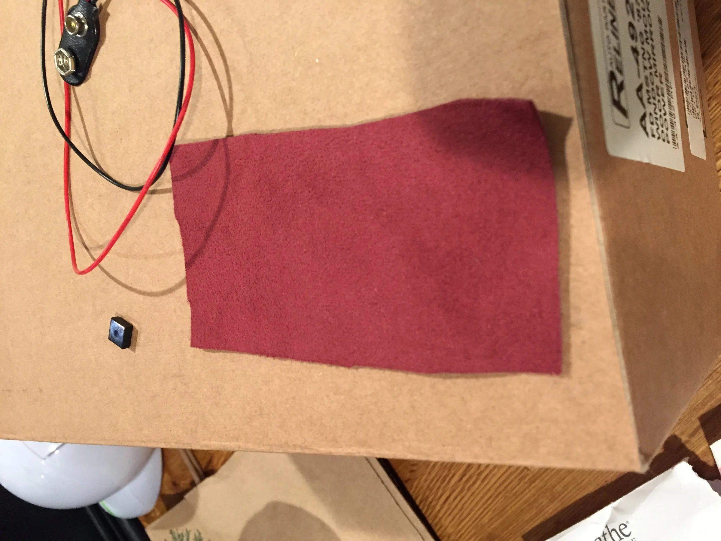

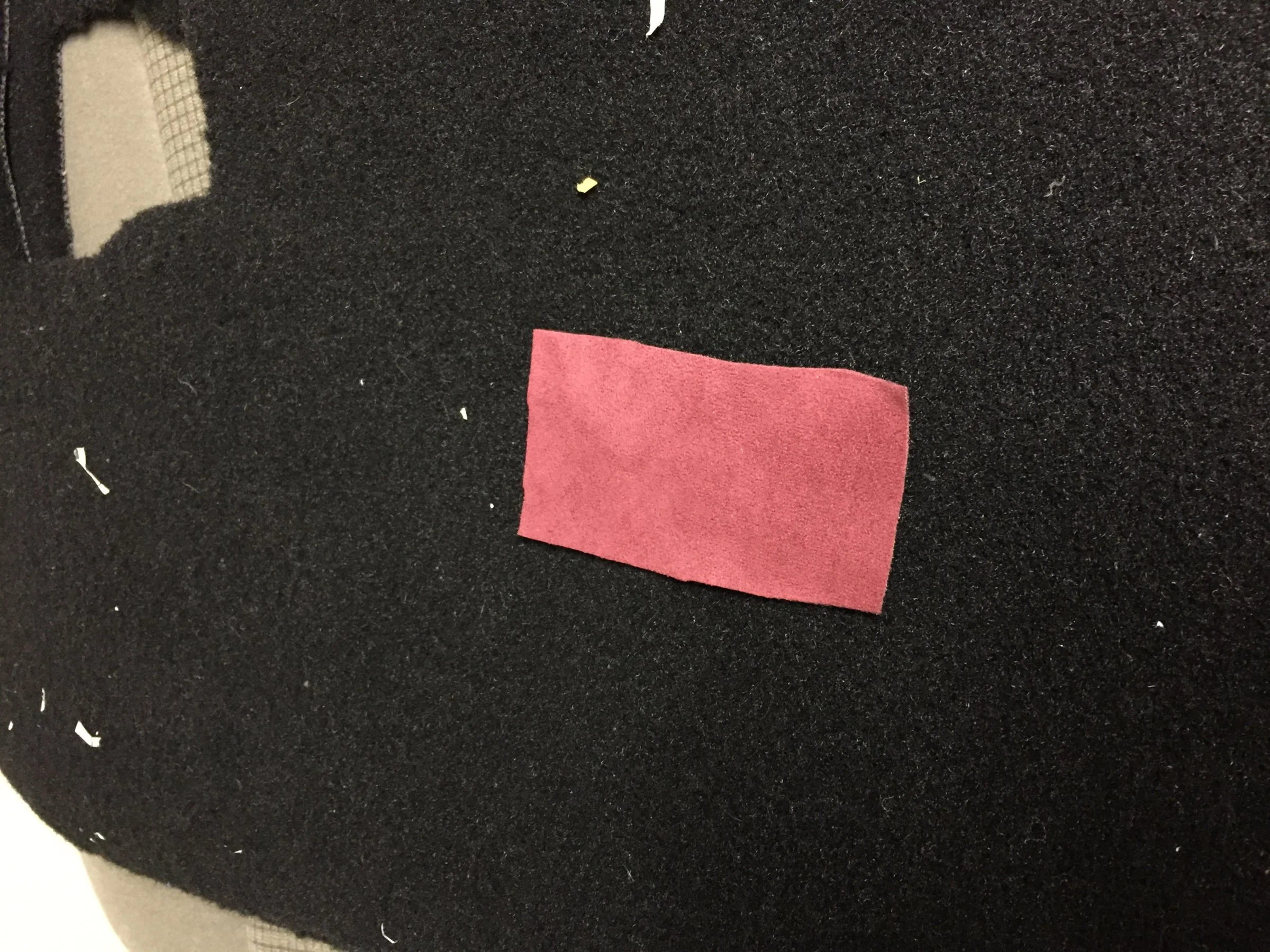

So here's the point I second guess my decision.

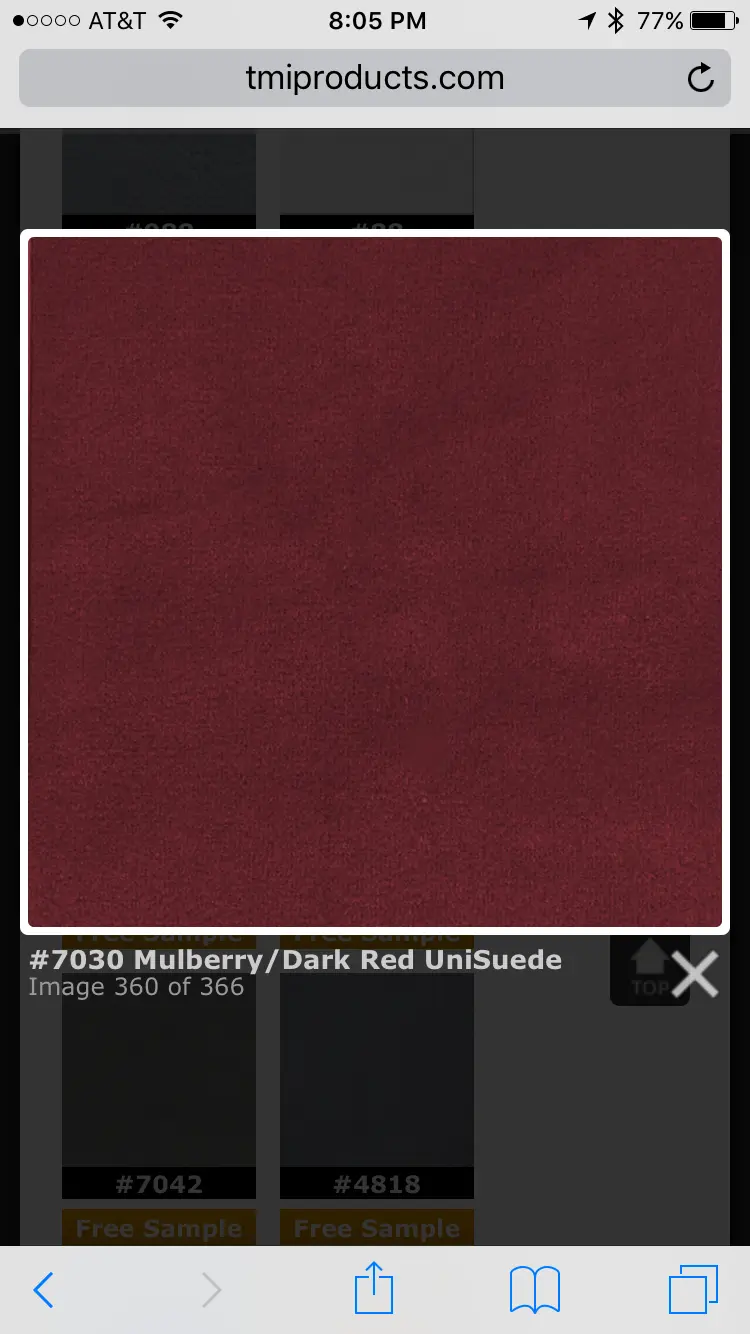

I requested a color swatch of what I think is the same dark red suede the seat inserts have. I wanted to see how much of s match it was to various things.
So I pull out the swatch in my kitchen and I like the color

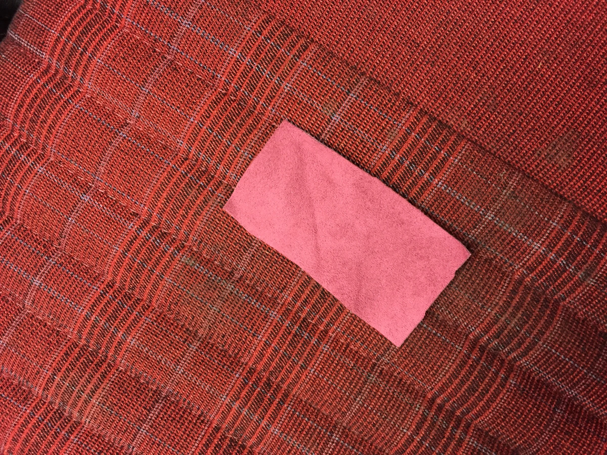

But then I take it to my work shop and under the fluorescent light laid out on the carpet it looks pink!
Those don't even look like the same color in these two pics.
And for final comparison...against red tweed.
Need to check it out in direct sunlight tomorrow

You've gotta think at some point that guy realized his mistake. I would imagine LRS would have gone back to the vendor and raise hell because they sold have shipped incorrect parts that cost them money. I know at my company, it's a big deal. So even if he never admitted it, I'd have to imagine he figured out the truth eventually.
My replacement order shipped today. Let's see what I get. I think o did my original order back on Nov 30.
Meanwhile this swatch is pissing me off because it looks pink! I'm just hoping the color that they actually used is different. I had to have requested the wrong swatch.
Vs

RaggedGT said:
Not to be the guy who adds more doubt- but in that pic you just posted-looks like two different colors..
I agree.
I'll throw this swatch aside and wait for the actual kit to come in....hopefully this weekend. I have some free time Sun so I could start on the backseat and maybe get it in the car.

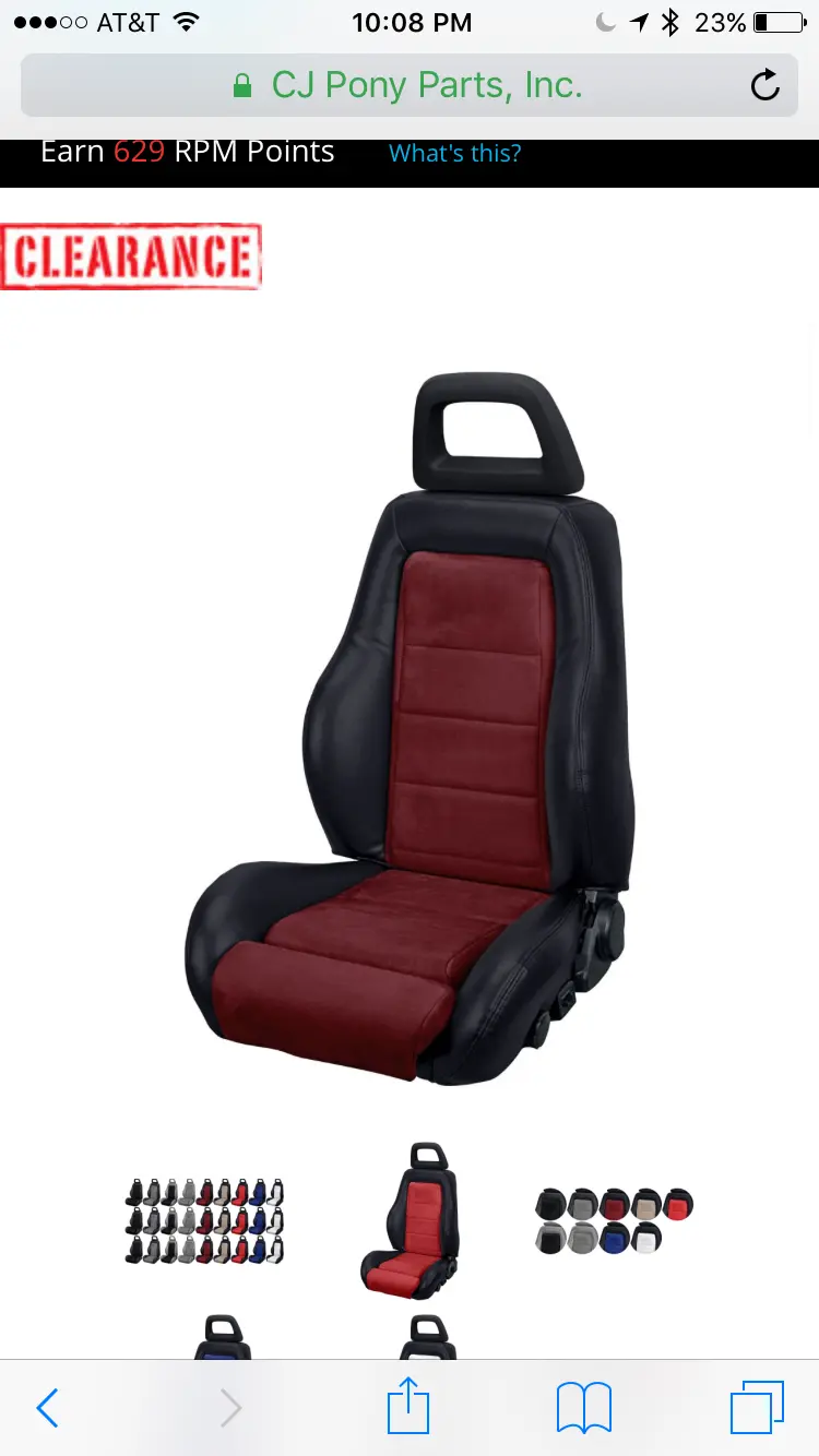

This is what I requested from their site. I'm only assuming it's the same because a it's listed as a Ford suede. I could be wrong
But that pic does kinda look like the seat photo...no?
Vs kitchen counter pic

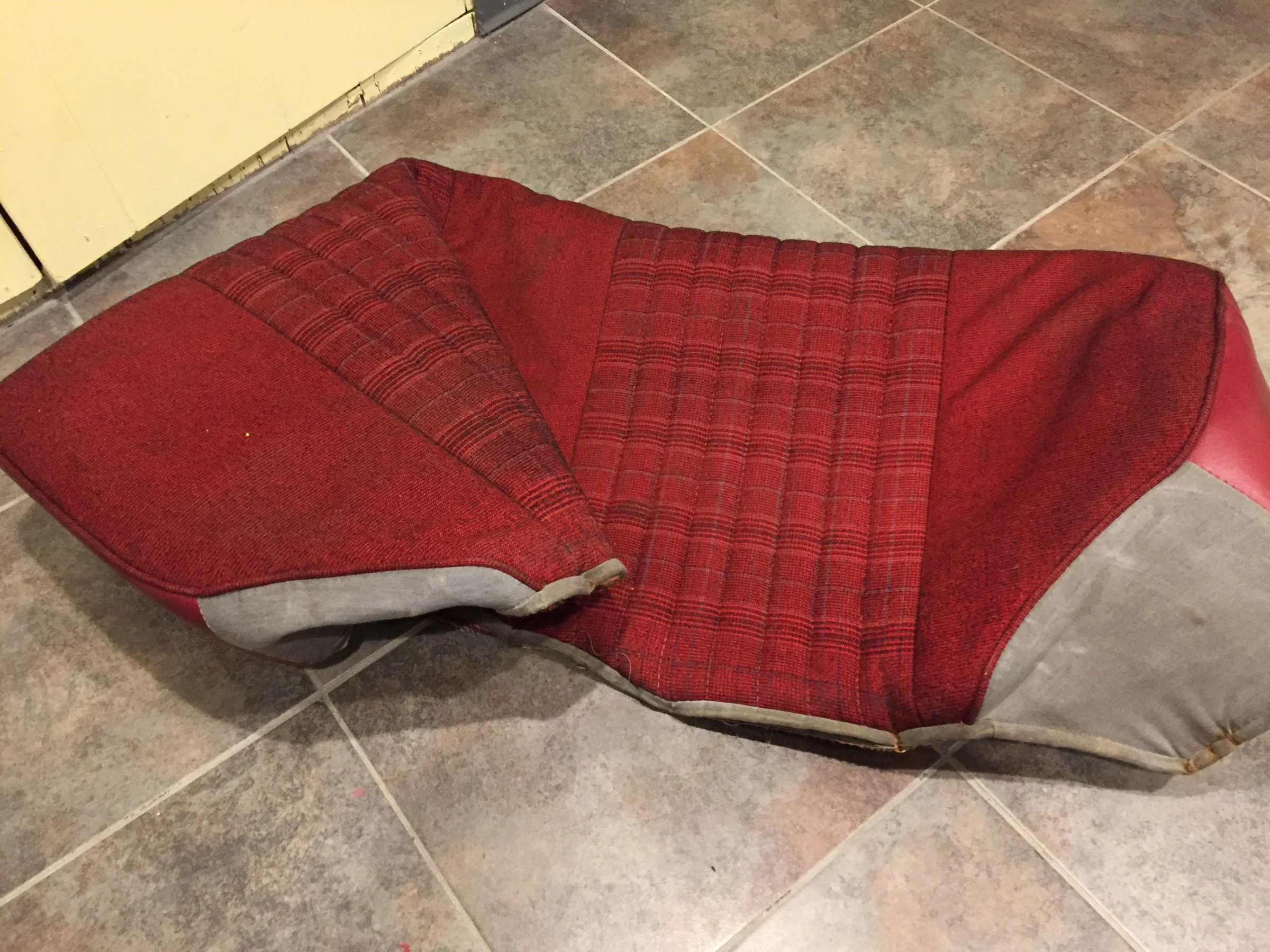

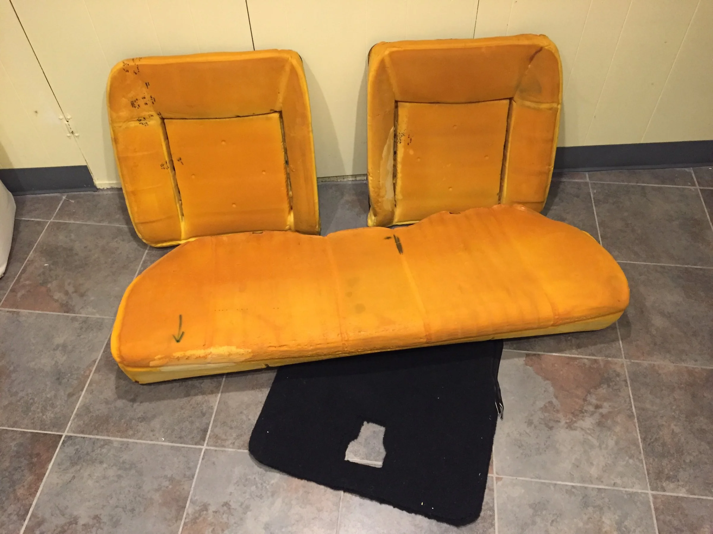

In the meantime, stripped down the donor rear seat

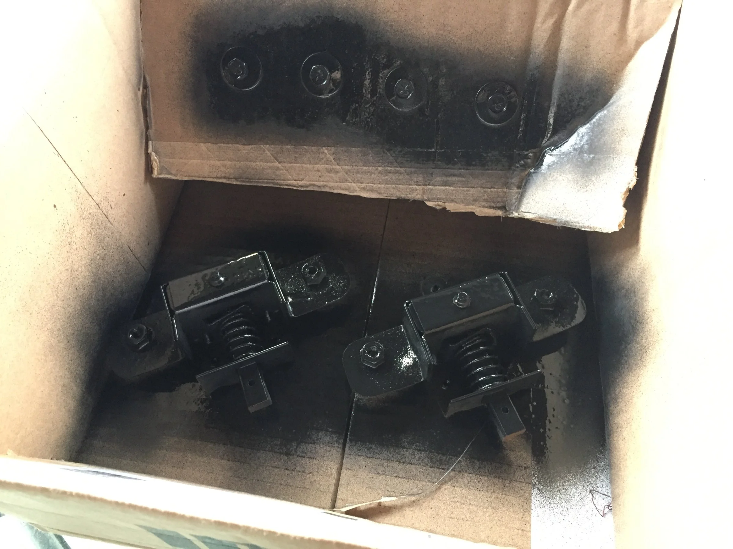

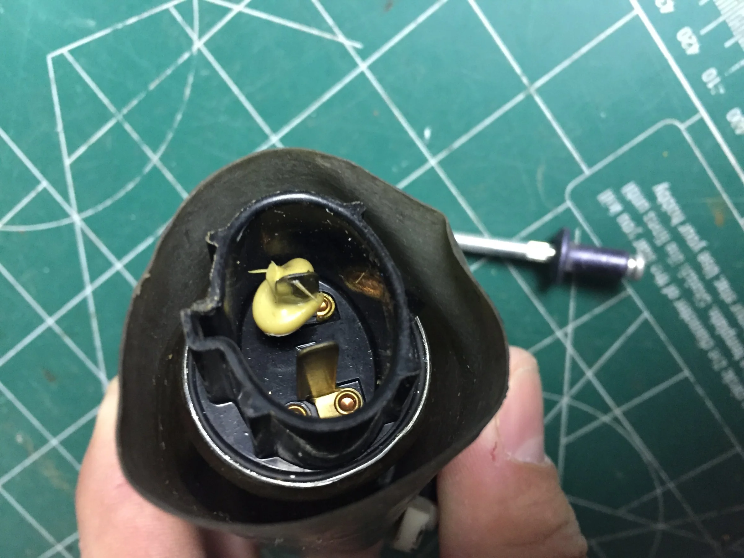

Also, since I am a sucker for details...painted the rear hatch latch hardware
Anyone need a red tweed cover? Going on eBay for a limited period of time before I trash it. Other that one cig burn it cleaned up nice

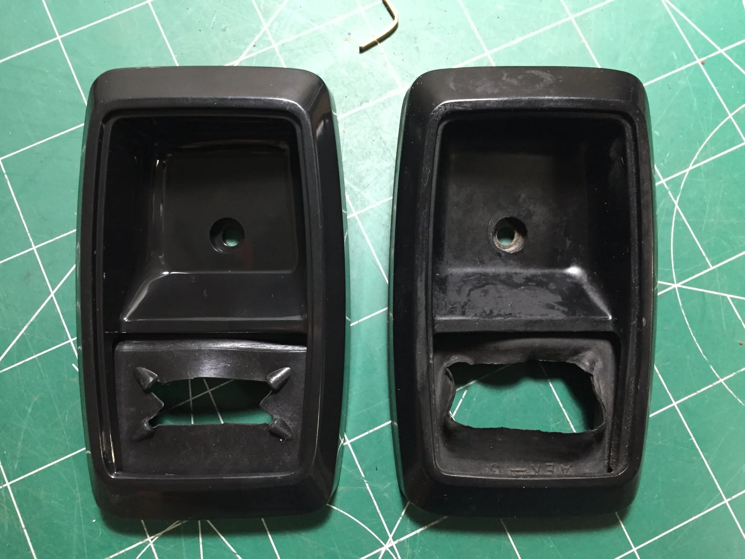

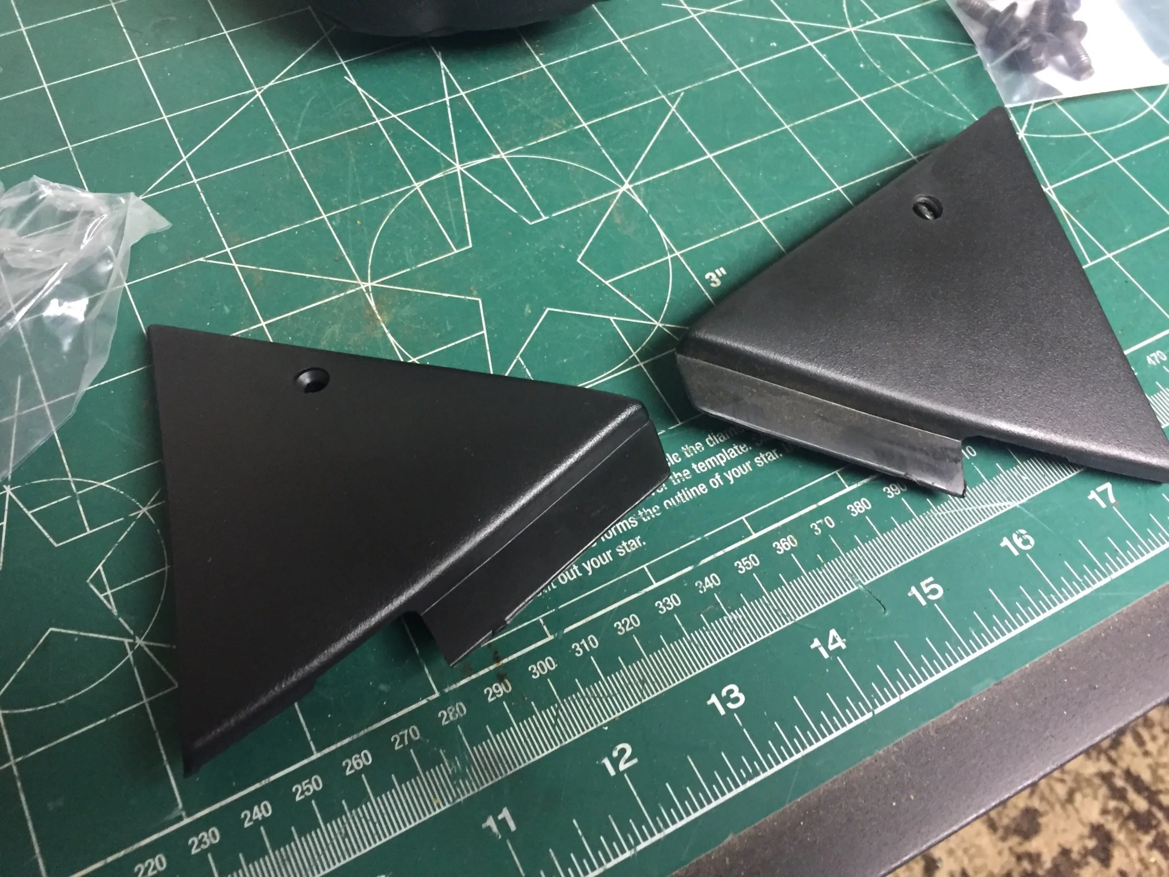

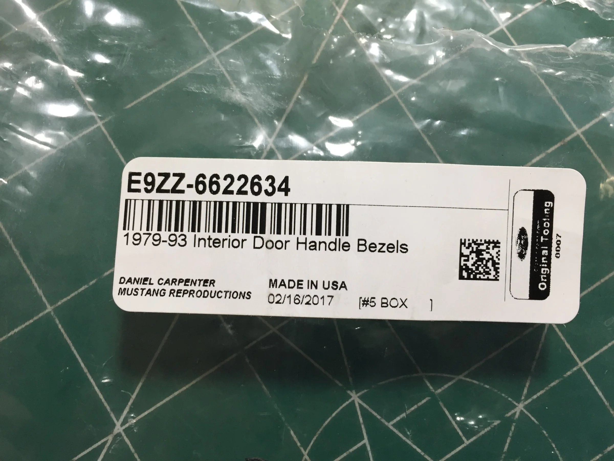

So I busted one of the power mirror covers while r&r my door panels and mirrors.
On eBay, a used one was $15, and a pair of repros was cheaper.
This is the first repop I feel is equal to the OEM part
Daniel Carpenter Reproductions
Left is new. Texture is spot on and has the foam back. Color looks different in pic but it is the same

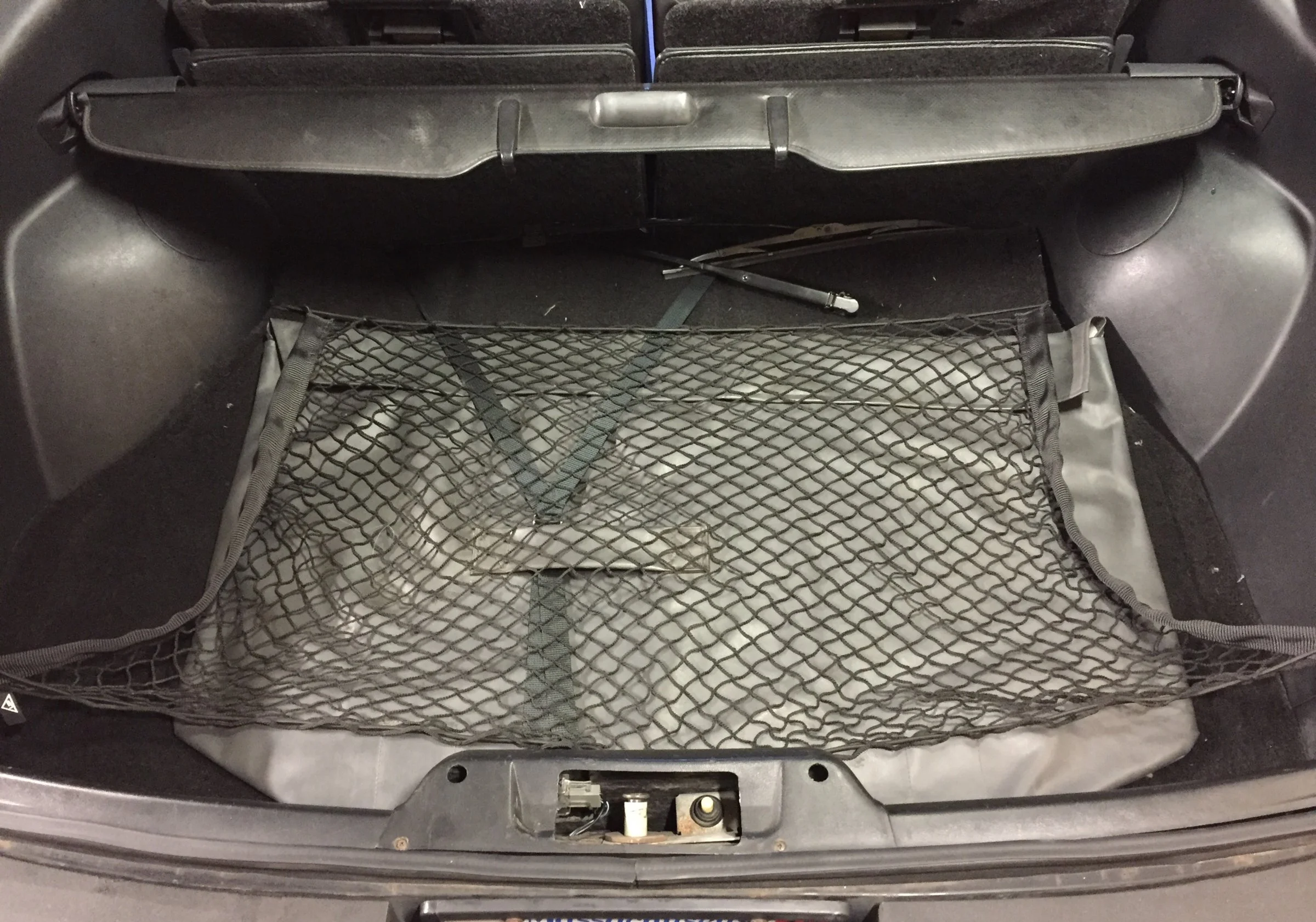

Finally scored myself a cargo net

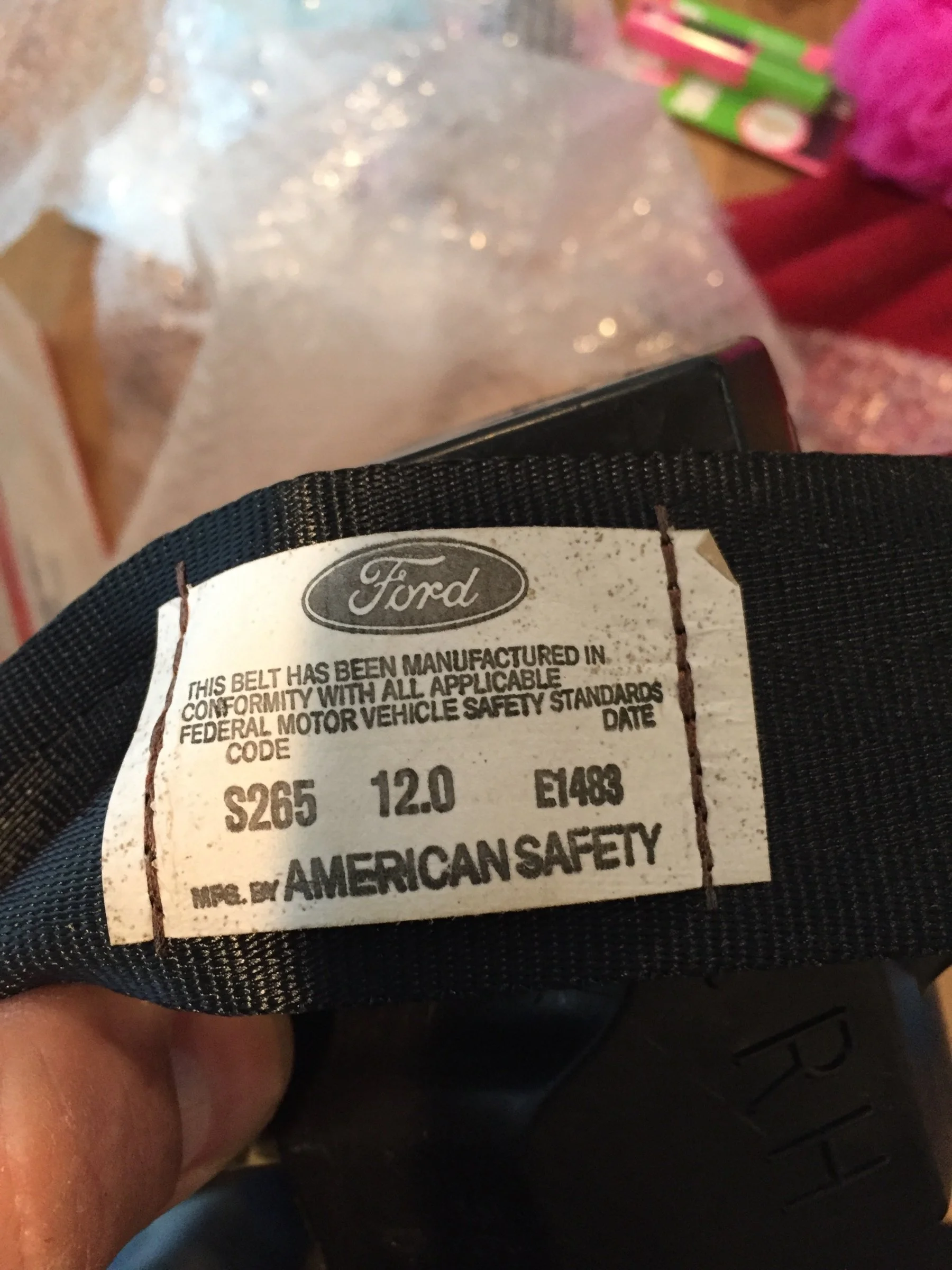

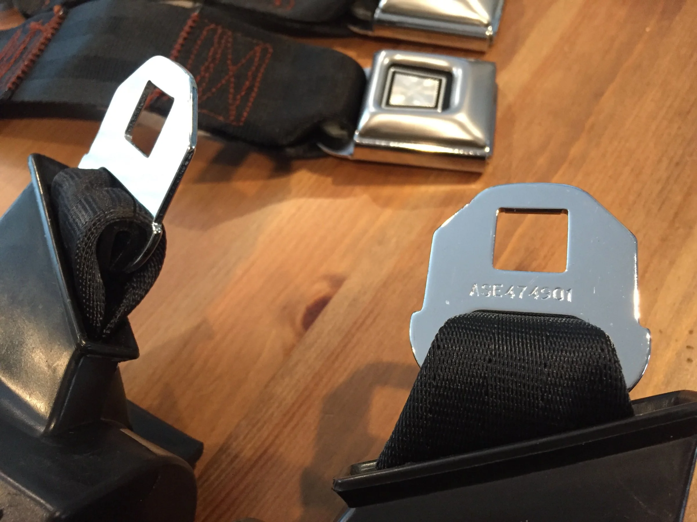

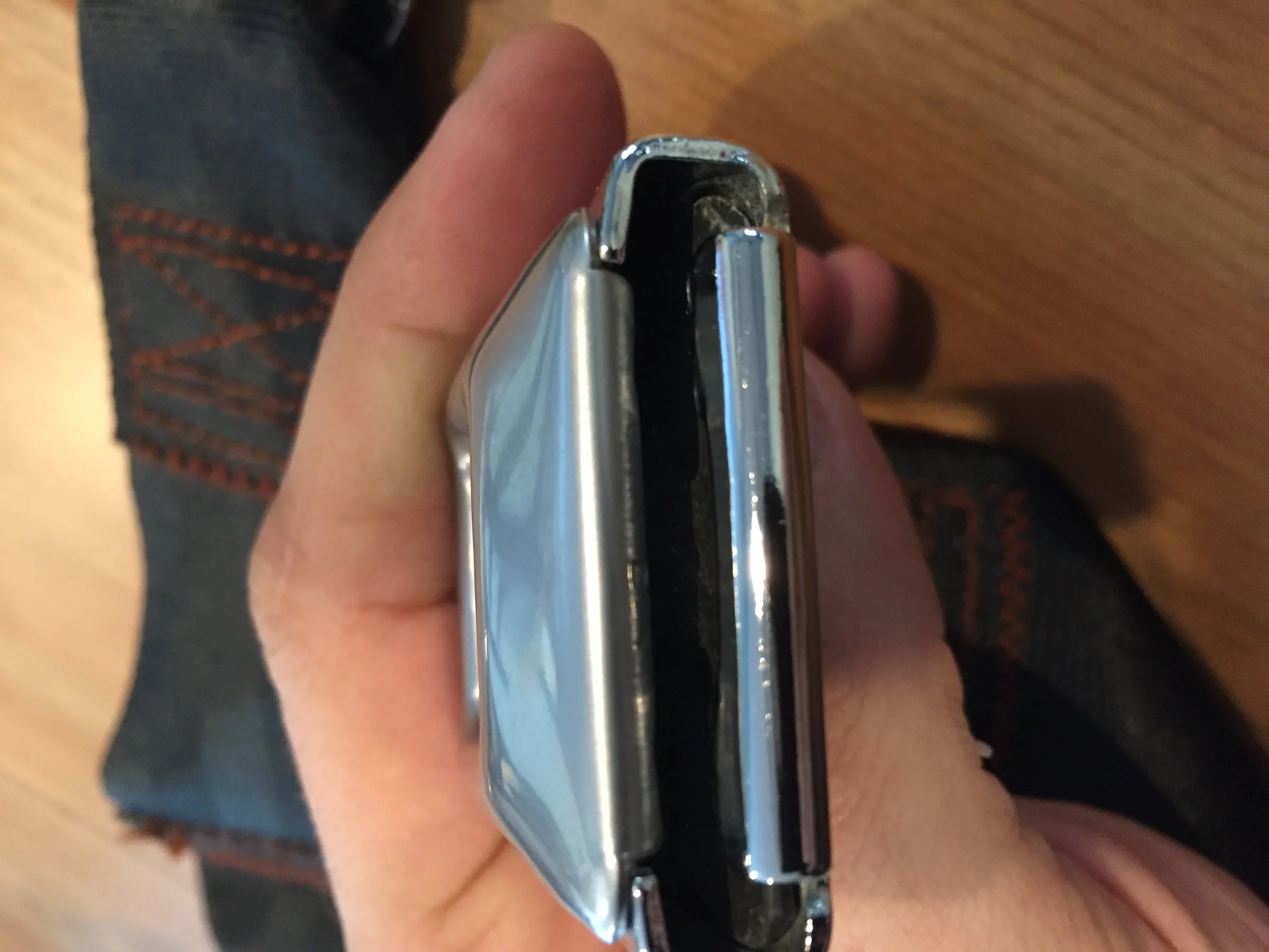

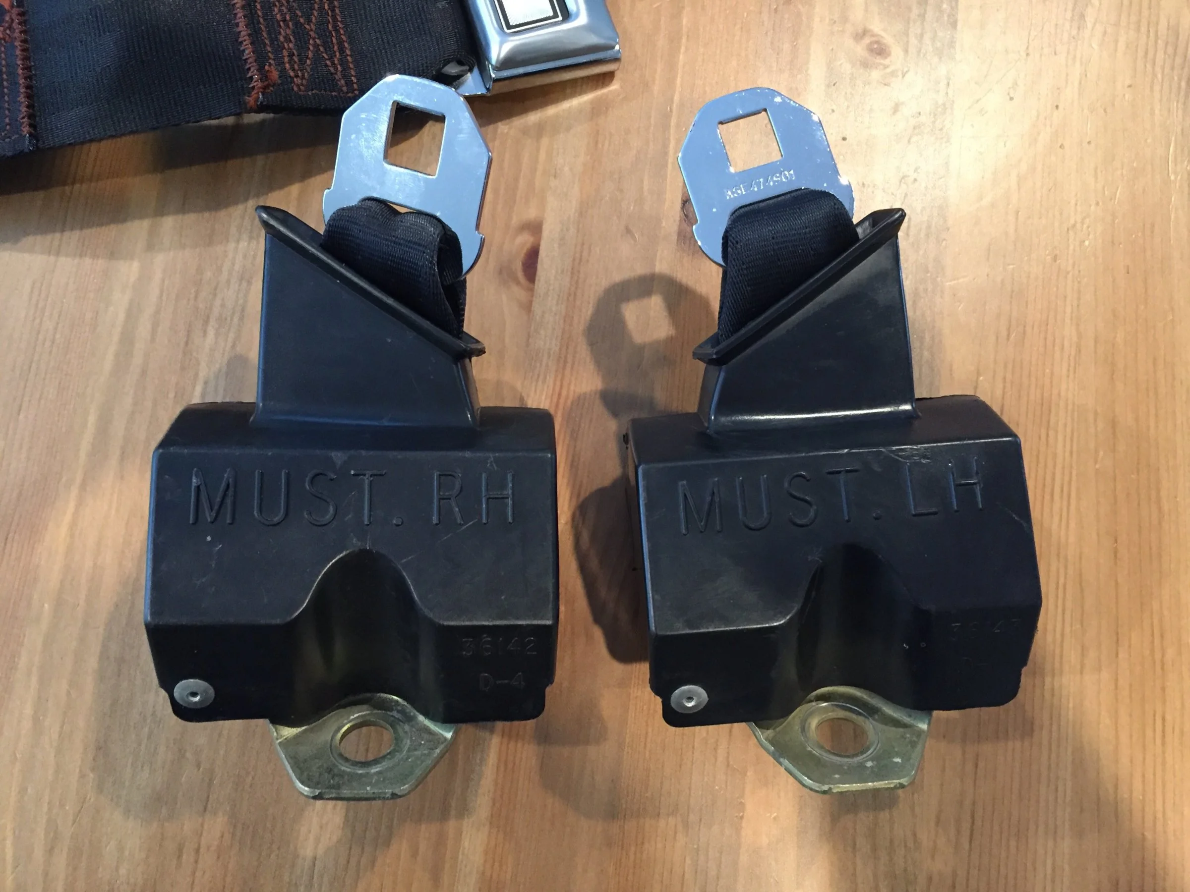

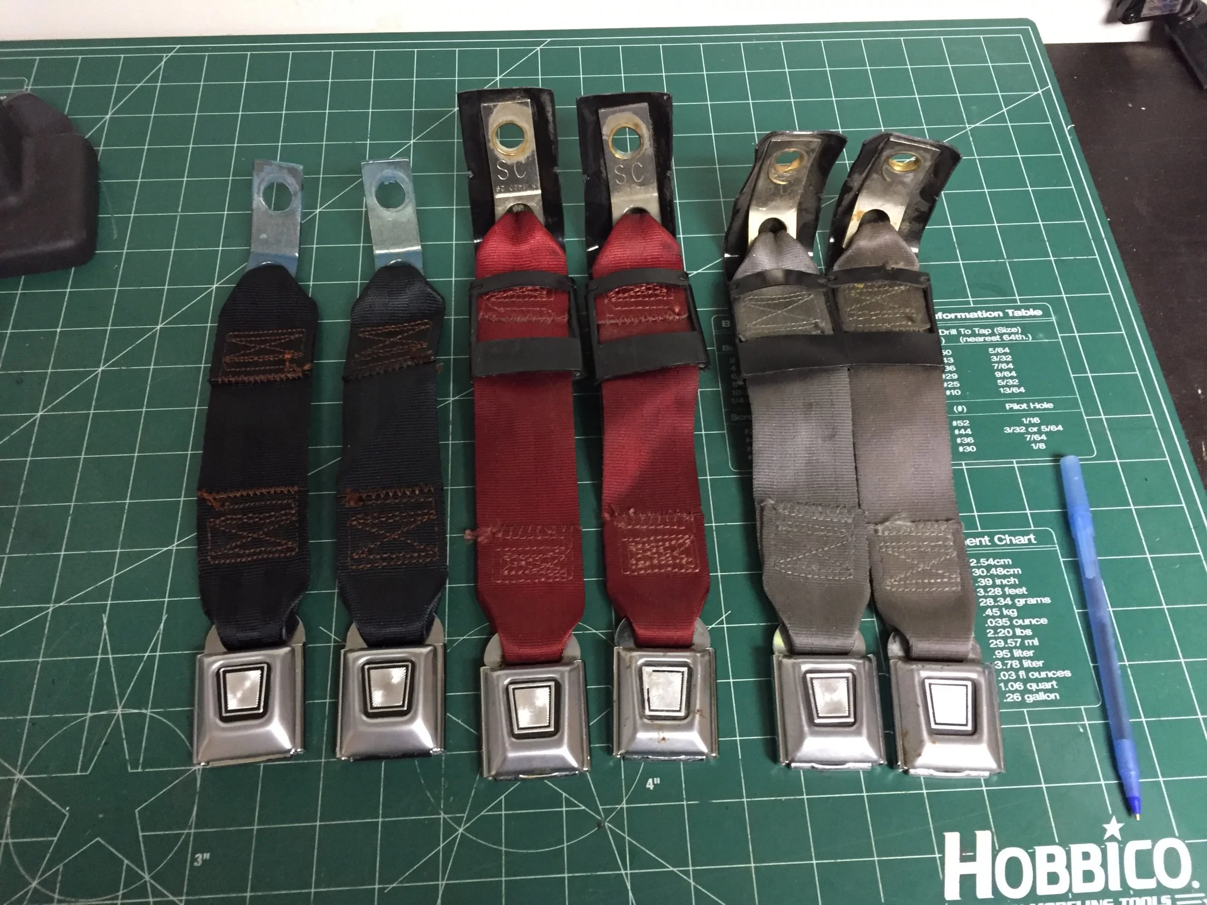

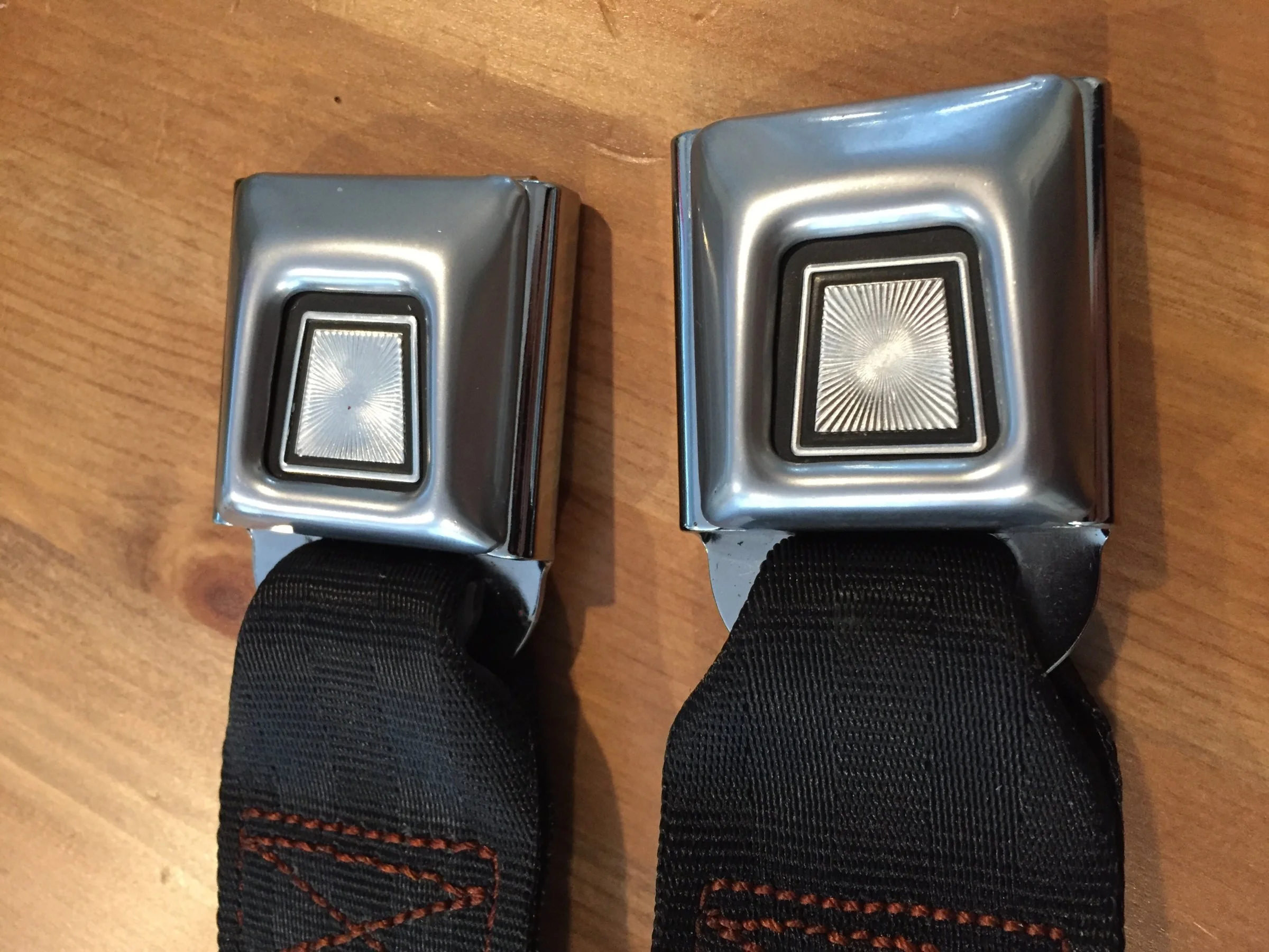

So I scored a set of black 1979-1984 belts. Supposedly they were removed from a 1983 years ago and stored.
Got them today. Damn, they look as if they have never been buckled....literally
Compared to the 87-89 belts, a tiny bit shorter and no sleeve.
Not a fan of the red stitching, but not the end of the world.
Problem? They are too nice. I feel guilty installing these. These really are pristine, new belts pretty much.

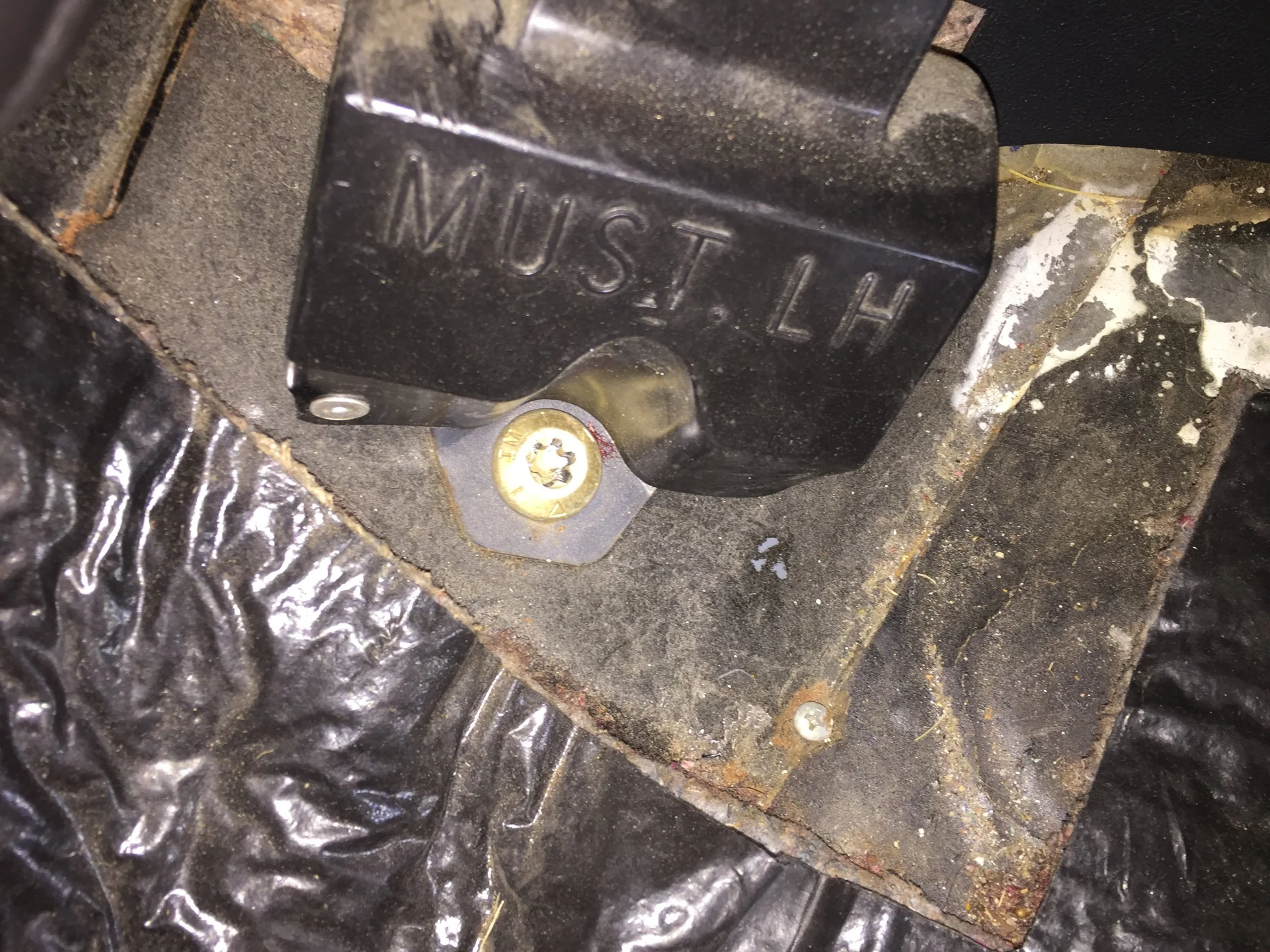

Anyway here's the second problem. My original red retractors are still in place. I can't get these bolts out. I've tried breaker bars and now two different impact guns and no luck. I've busted 3-4 of my T50 bits so far. I've tried heat and pen fluid. Now I'm slowly rounding out the inside of the bolt head with better quality t50 torx drivers
So, the black belts stay in the box until I get these out. I don't want to drill yet in case I mess it up. At least now they are functional

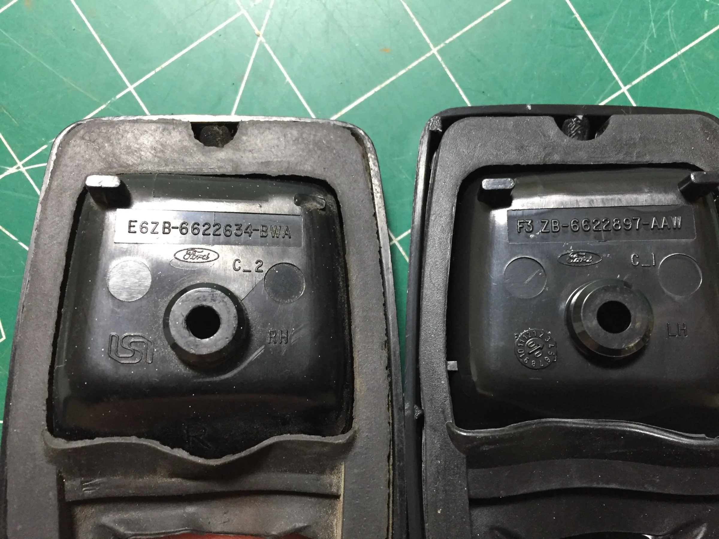

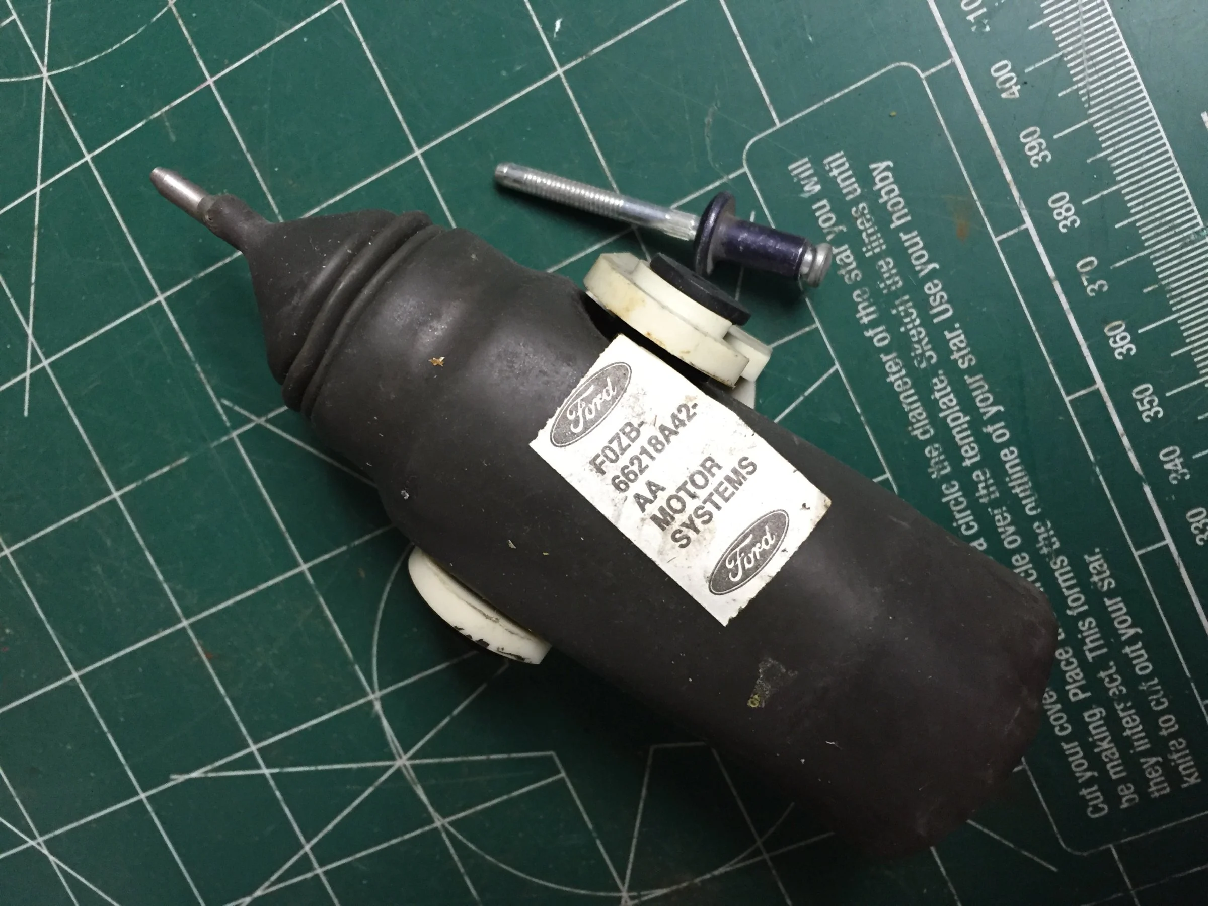

Some more stuff. Busted one of my door cups during my door refurb, so ordered some Ford tooling made repops. I'm happy with these
Compared to originsl
F3 part number...also molded in 2000. Unsure of that's the actual date they were made, or the last date on the molds used before Ford shut down production.

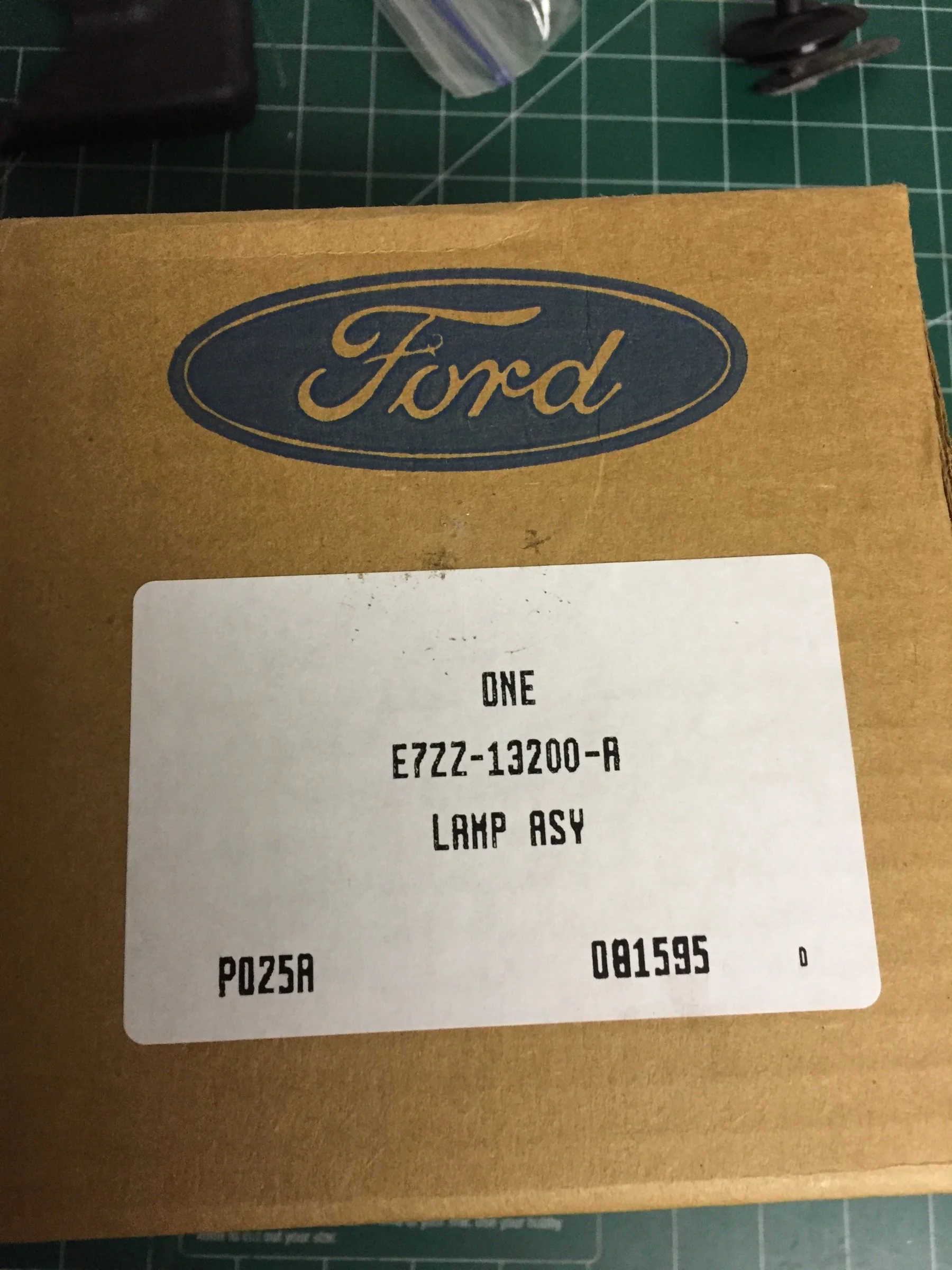

Also, another NOS grab. Got a passenger inner parking light. Currently one lamp away from a full set of 6. Just need a passenger headlight. E9ZZ-13007-A
Right now, the LRS repros are holding down the fort. Given the car is garaged and not driven in the rain/night, I'll leave them even after conpleteing the set.
Don't this we are quite at the point for this yet however

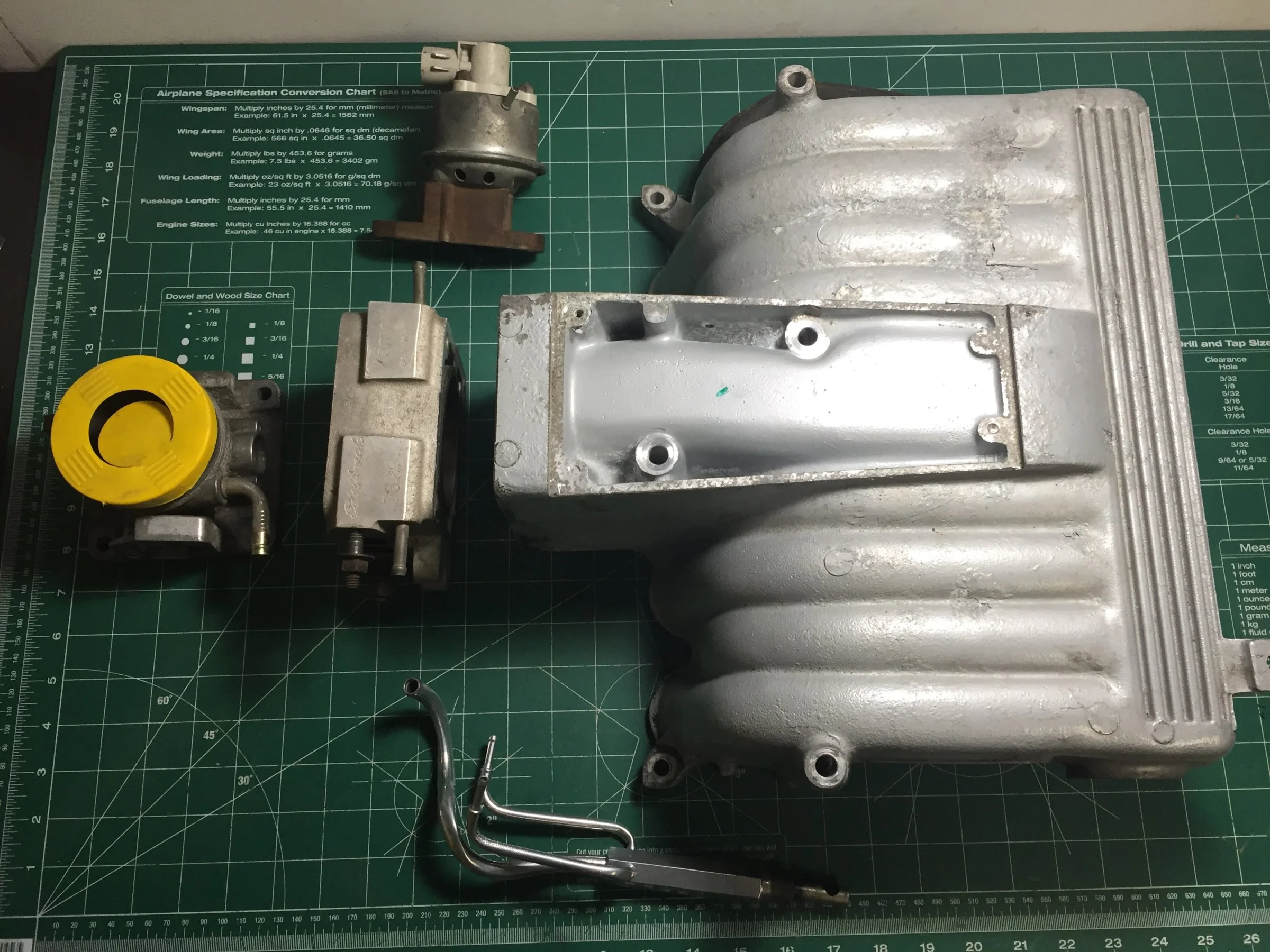

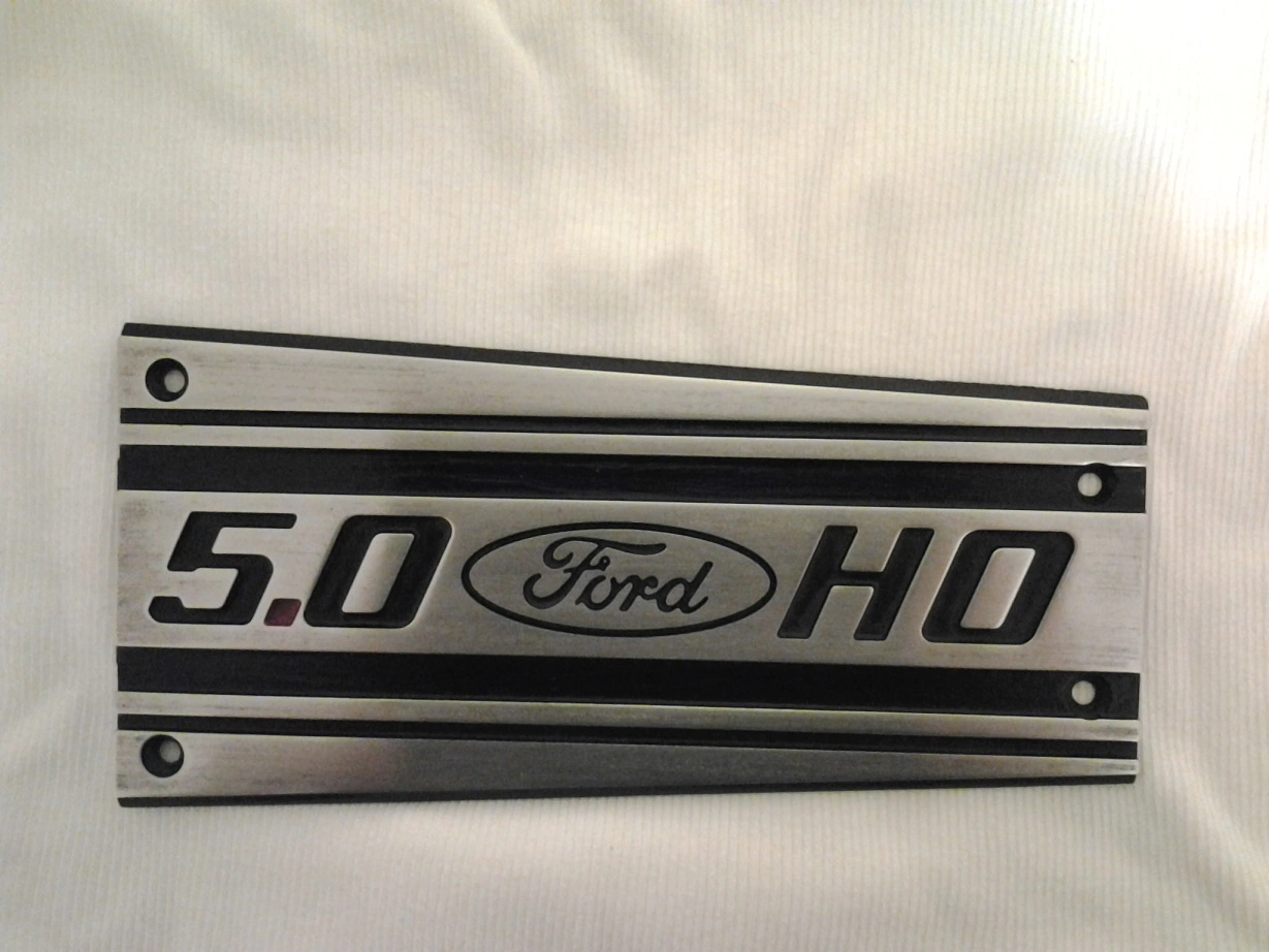

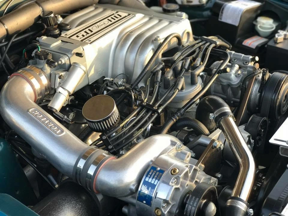

Kinda been mulling this over. Think I'll try something different.
Explorer upper plenum, 70mm egr and 65mm TB with a stock HO engine plate on top. Very OEM look after I repaint it. This will be on top of its original lower which I had tmoss port for me.
The opening on the explorer is 65mm, which leaves a pretty big step with the 70mm egr spacer, so I'll blend that transition. A 70mm TB is on the "keep an eye out" list.
I really like the look of a detailed explorer upper
My '93 cobra intake needs refinishing after 20 years on the car. I'll stick it on the shelf for now.
I know a TFS intake would better match my combo, but for now I want to stay with the GT40 family. Maybe down the road...

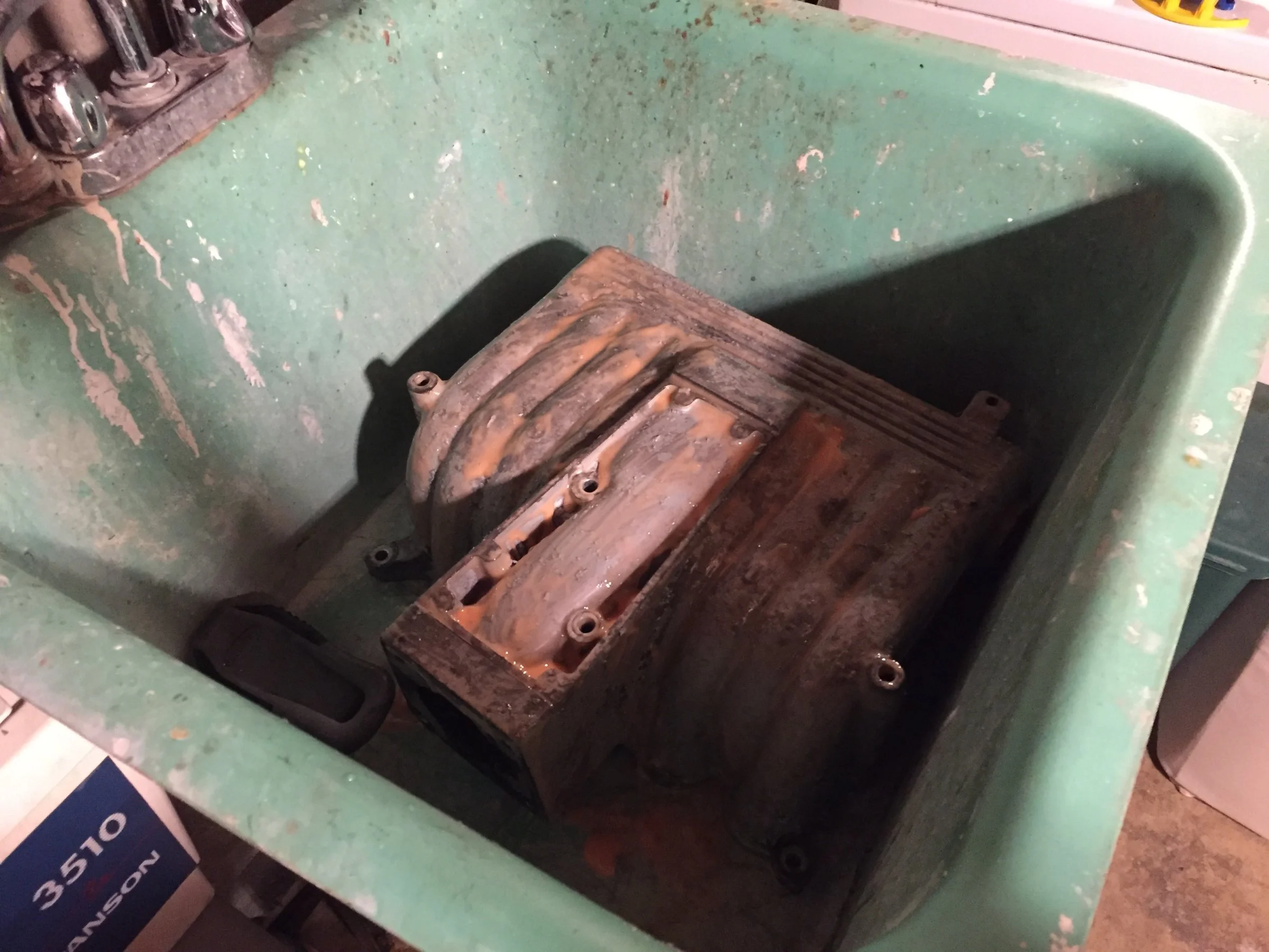

Started stripping the upper. Round 1 was with the nasty aircraft stripper, and rd two is a good overnight soaking in Citristrip.
I have two paint schemes in mind
One is to mimic the stock HO manifold with argent paint and repainting the HO intake plate like OEM. Basically go back to OEM...but with a ported explorer intake.
Second it to match it to a set of Ford valve covers, black with the machined ribs. I'd paint the entire upper black but sand and polish the fins and then clear it all. Black EGR spacer and black TB.
basically match these
https://cfc7329ad537523a5de1-b21544...7de3d.ssl.cf1.rackcdn.com/m6000j302r_3634.jpg

Haven't painted it yet. Still soaking in Citristrip to strip the paint off. Currently researching what paint works best and I think I'm just going to use VHT high temp Al paint, with a high temp clearcoat on top.
I'm duplicating this for the intake plate. I have one sandblasted, so my plan is to sand the top a bit now, and then clean it up, spray it black, and then resand the top to give it this final appearance
I also intend to cut off the boss on the side of the plenum, and clean up all the vac line tubes that were explorer specific and drill/tap for the OEM vacuum tree tube.
I checked this AM and the Citristrip is working quite well. It's slow, but that's fine as it's non-toxic and doesn't have the strong vapors like the aircraft stripper. I can work in my slop sink in the basement. Tonight, i'll scrub and remove all the loose paint, and then reapply another coat on certain areas and repeat.
Chuckman said:
This right here? Yeah, do that. More elbow grease on the iac and tb though.....
Egr, TB and IAC will all be painted to match.
Also, after talking with Tmoss in another forum, there's some cleaning up of the upper transition where it bolts to the lower that I intend to do. I also need to blend the explorer's 70mm intake opening to match my 75mm EGR spacer.
A little elbow grease here, but end result should be nice.
As for my 93 cobra intake. No idea what i'll do with it. Keeping it for now.
