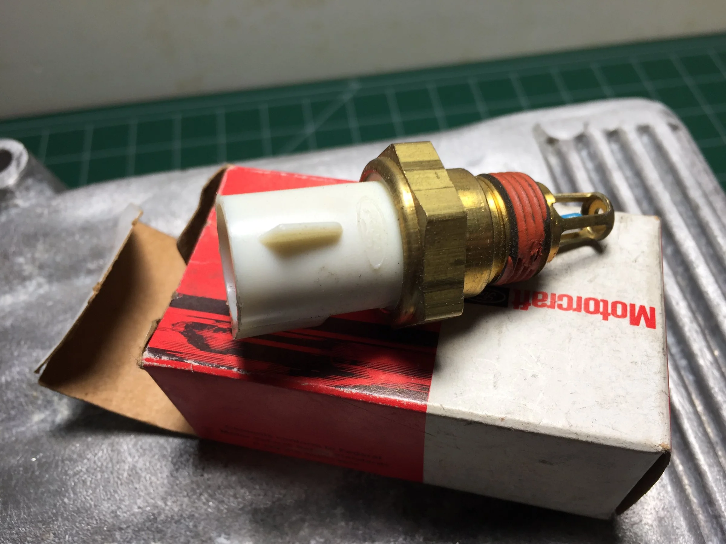

So moving on, I finished this up today.
And you know me...I'm the type of guy that would track down a NOS act sensor

95BlueStallion said:
Damn it, I was trying to find that ACT sensor! Ended up buying a repop.
Motorcraft DY304 is the p/n if you want to search. Got mine on the eBay for $25 shipped

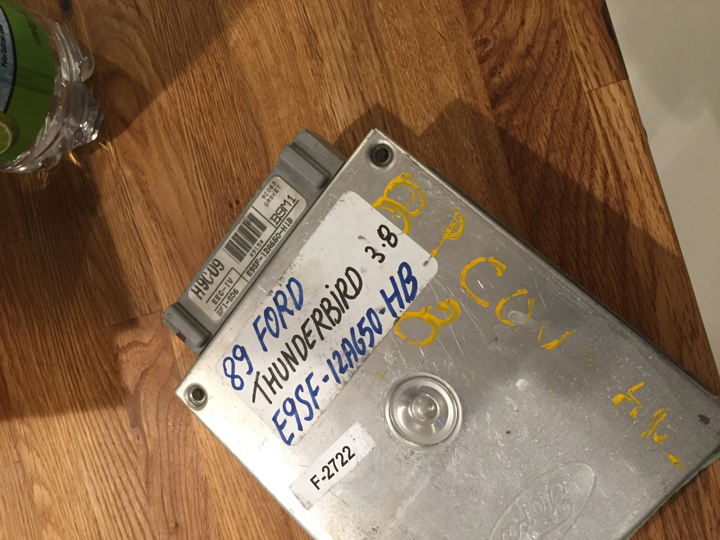

Got my hands on a donor ECU for the 60 pin for $9 shipped

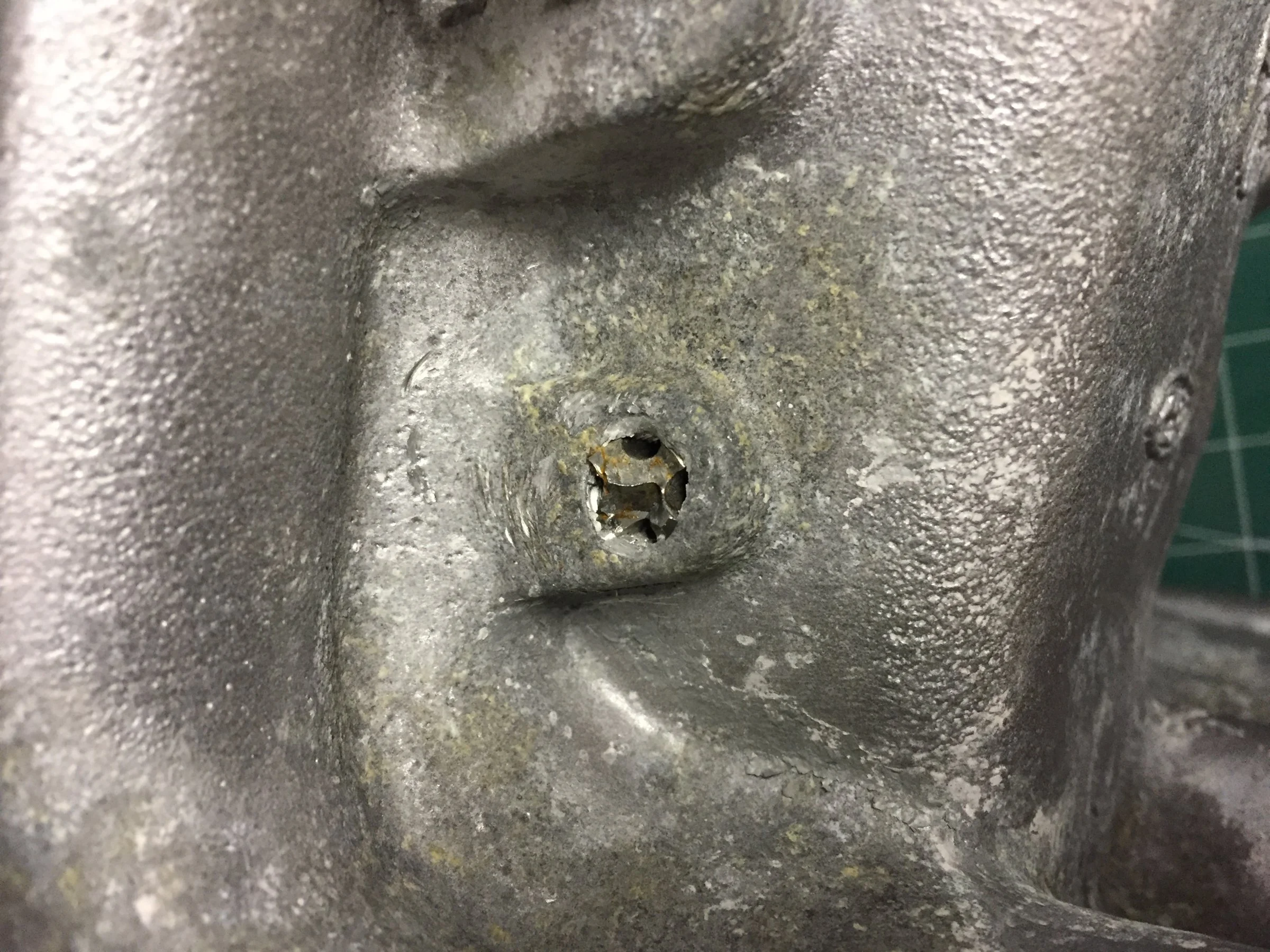

So, set out to do my final cleaning up of the explorer intake before paint, and also to tap a few holes.
Aw fudge
Gotta see if I have any nitric acid at work, or maybe try another method. Hmm. I just need to get it out and I'll drill/tap for next size up. This is the vac line for charcoal canister...which might not now be needed with the MS3 setup.

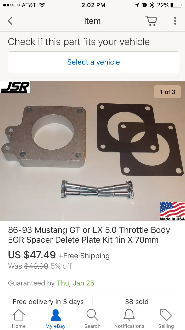

Anyway, since MS doesn't control EGR, I'm going to delete it. I'll block off at lower to upper intake gasket in case my state ever brings back emmissions testing so I don't need to pull lower intake to unblock.
Since I no longer need my working EGR spacer, anyone used these before? I hate buying eBay mods...but it's just a piece of machined Aluminum.
Just need to decide if 1" or 1/2" thick will help clearance the best with the taller VCs

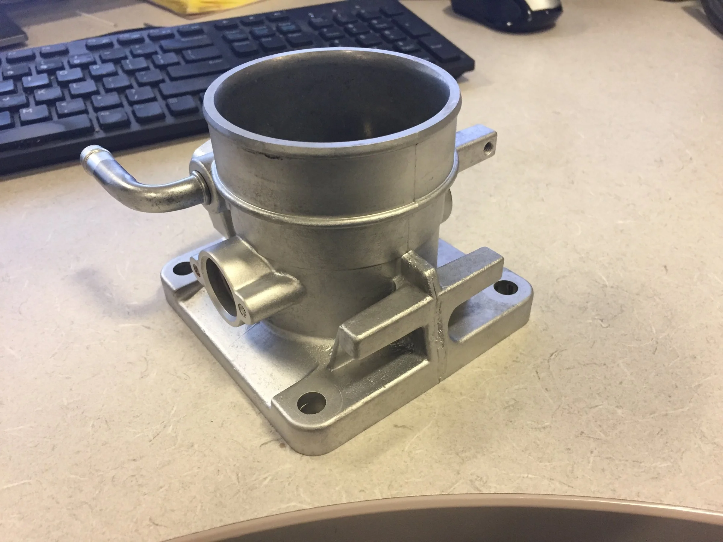

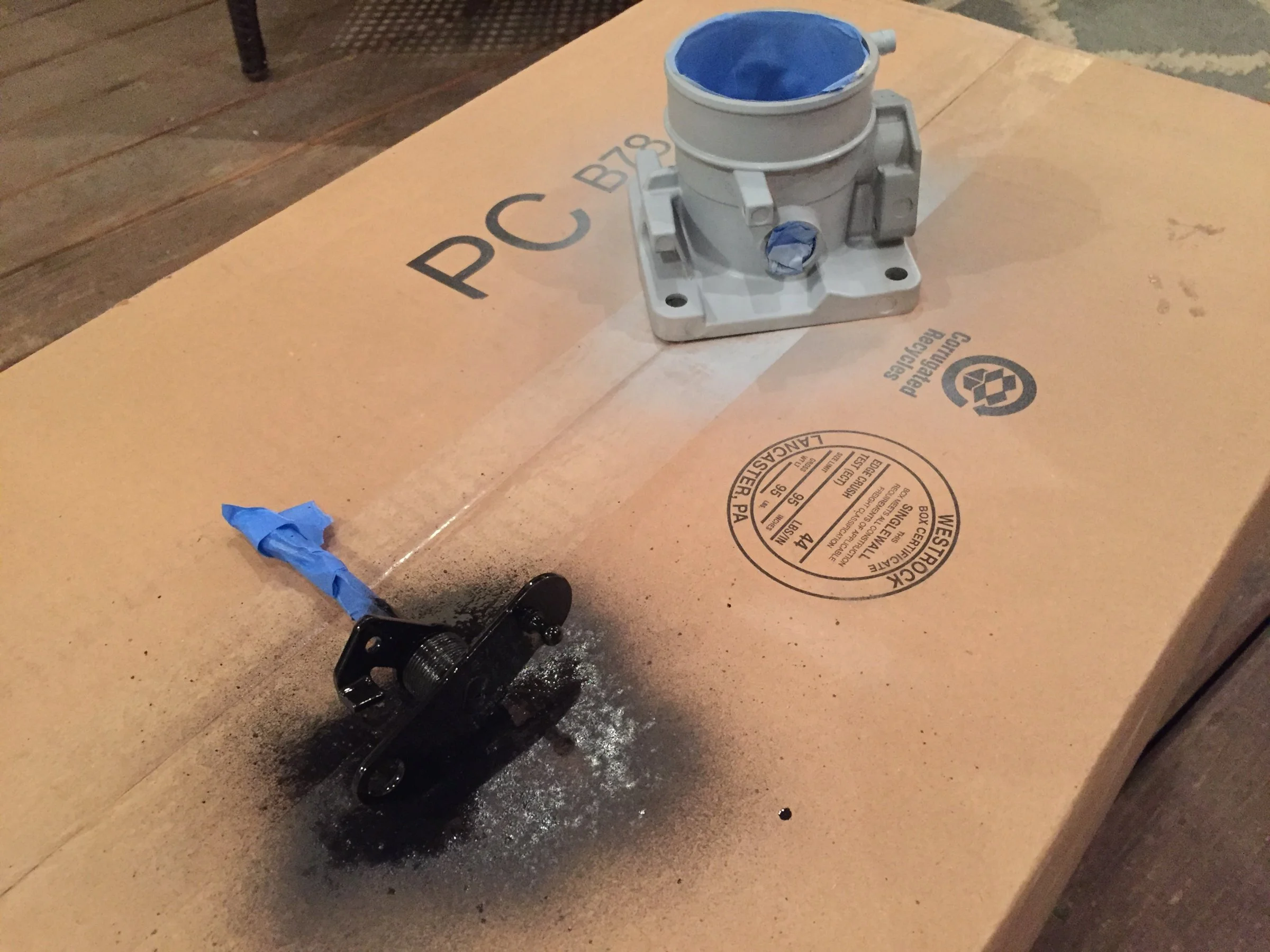

I also bead blasted the outside of my 65mm TB. Time for paint

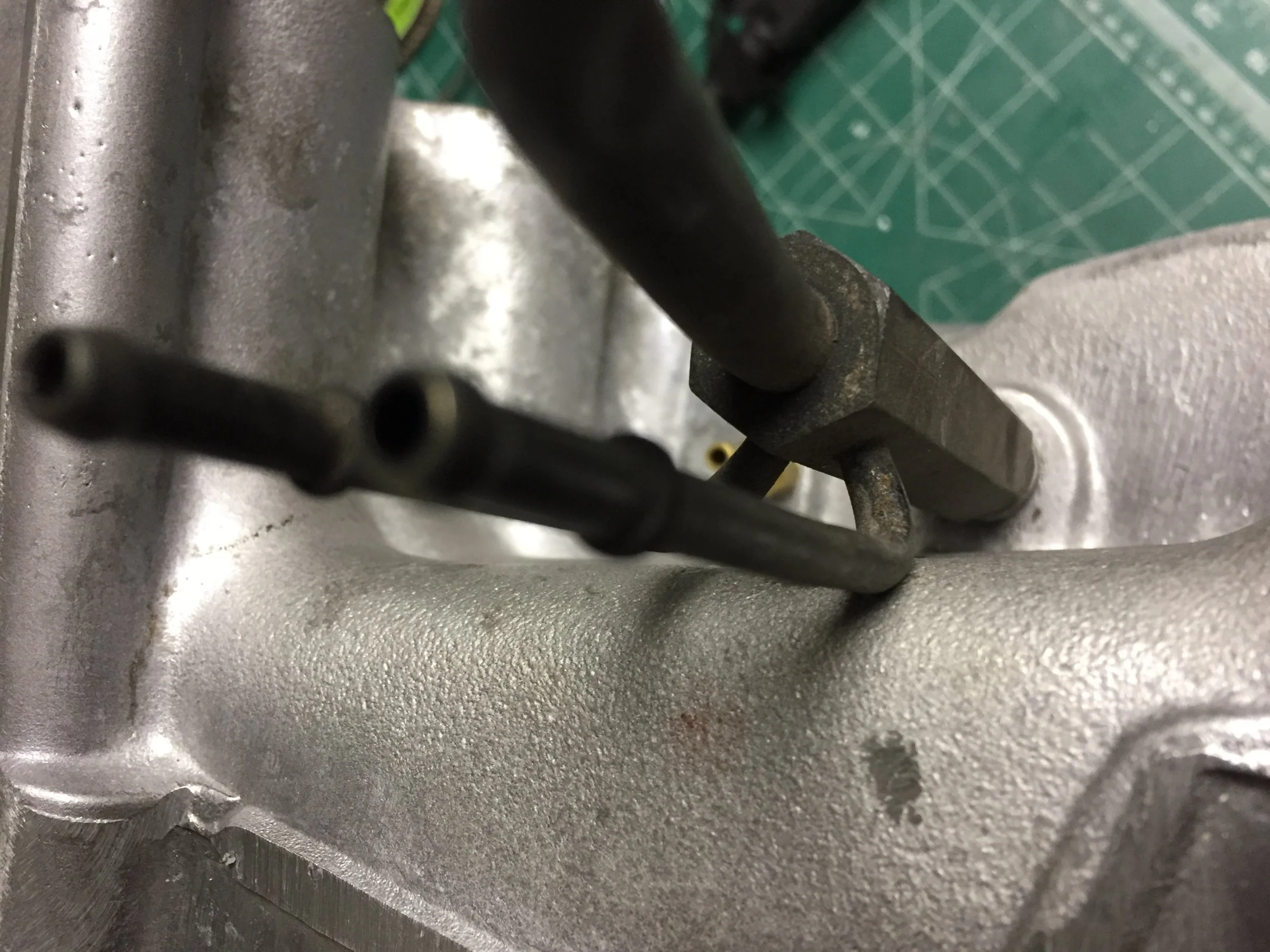

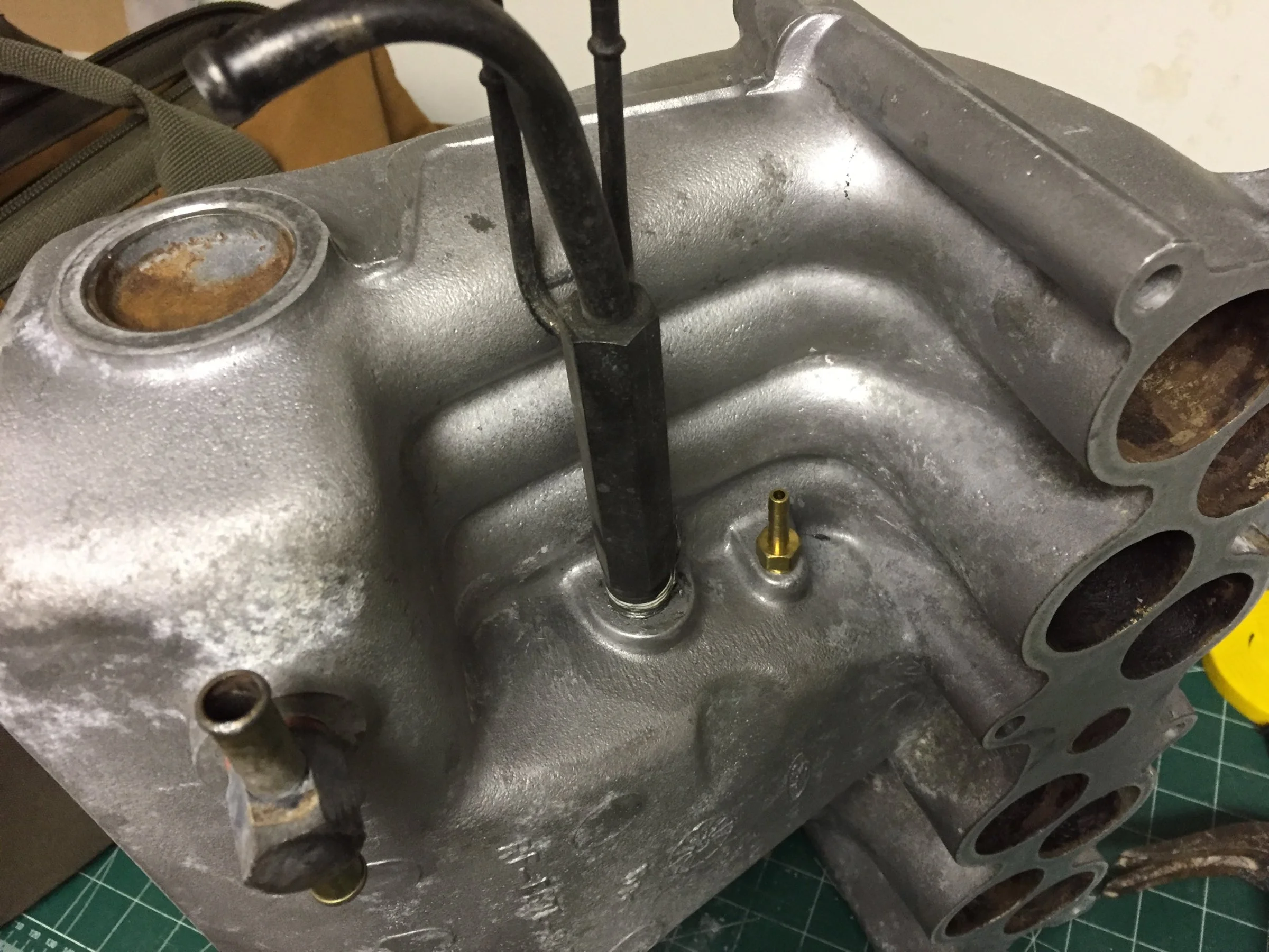

Drilled and tapped some holes on the opposite side of intake.
The brass port is for MAP and the other is standard source and EGR/FP
I goofed on this though, or the factory pipe just sits way too close to the runners. I should have drilled at more of and angle to get more clearance. I'll make it work though. I think I can slightly bend these to get it to clear. If not I can fab up a manifold. Nobody will ever see it here anyway.
Just need to remove the broken tap, retap that hole and then I'm ready for paint. I want to replace the freeze plugs as well...post painting. Waaaaay too much work for an explorer intake lol.
Started to prime the TB

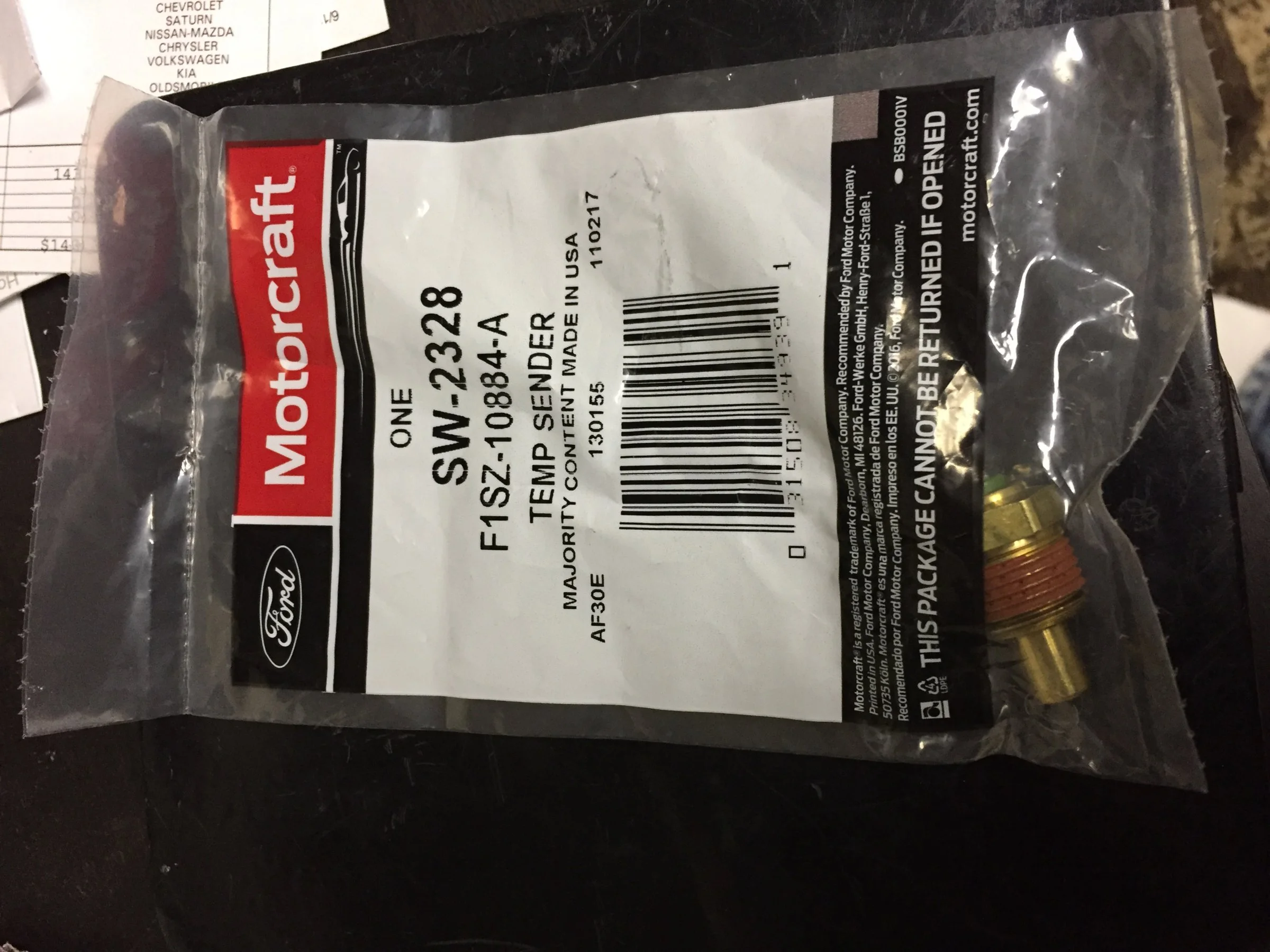

And my new oem temp sender came in. Mine is fine...just oxidized. I want fresh sensors.

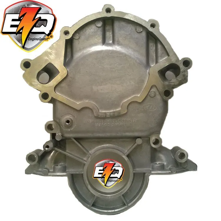

hoopty5.0 said:
As far as alignment, it depends. Steve told me the pickup needs to be 5 teeth (50 degrees) ahead of the gap when the motor is on TDC. I don't know what the offset is for A9x cars.
I believe it's the same regardless. I'm not going to set it up until I go MS3 though, just wanted to plan for the wheel to be in place.
I guess I just need to figure out balancer orientation with regard to TDC and then I can orient the wheel properly on the balancer. I believe 5 teeth puts it approximately where it would be on the explorer.
Aparently LRS used to sell a F150 timing cover as a Mustang cover years ago that had the holes for mounting a crank sensor. As far as I know they swapped to the Mustang cover now. I think the issue is the orientation of the water passage holes, but I don't think it matters given that the holes on the back of a Mustang water pump are in fact circles. those sloped ramps shouldn't matter..no?
SO really the question is do I swap to this style timing cover and mount a factory style non adjustable sensor and really have to pay attention to where I mount the 36-1 wheel, or come up with a custom adjustable mount that I can bolt to the standard timing cover bolts and then adjust the sensor.
I'll be doing the latter. Makes the most sense... For my situation at least.
