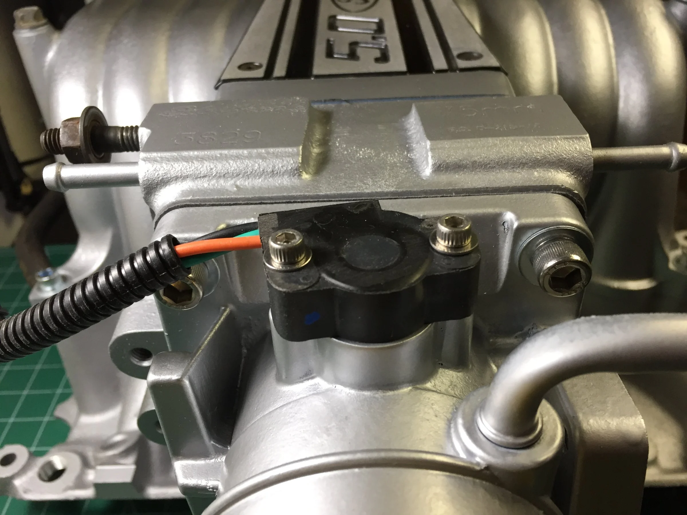

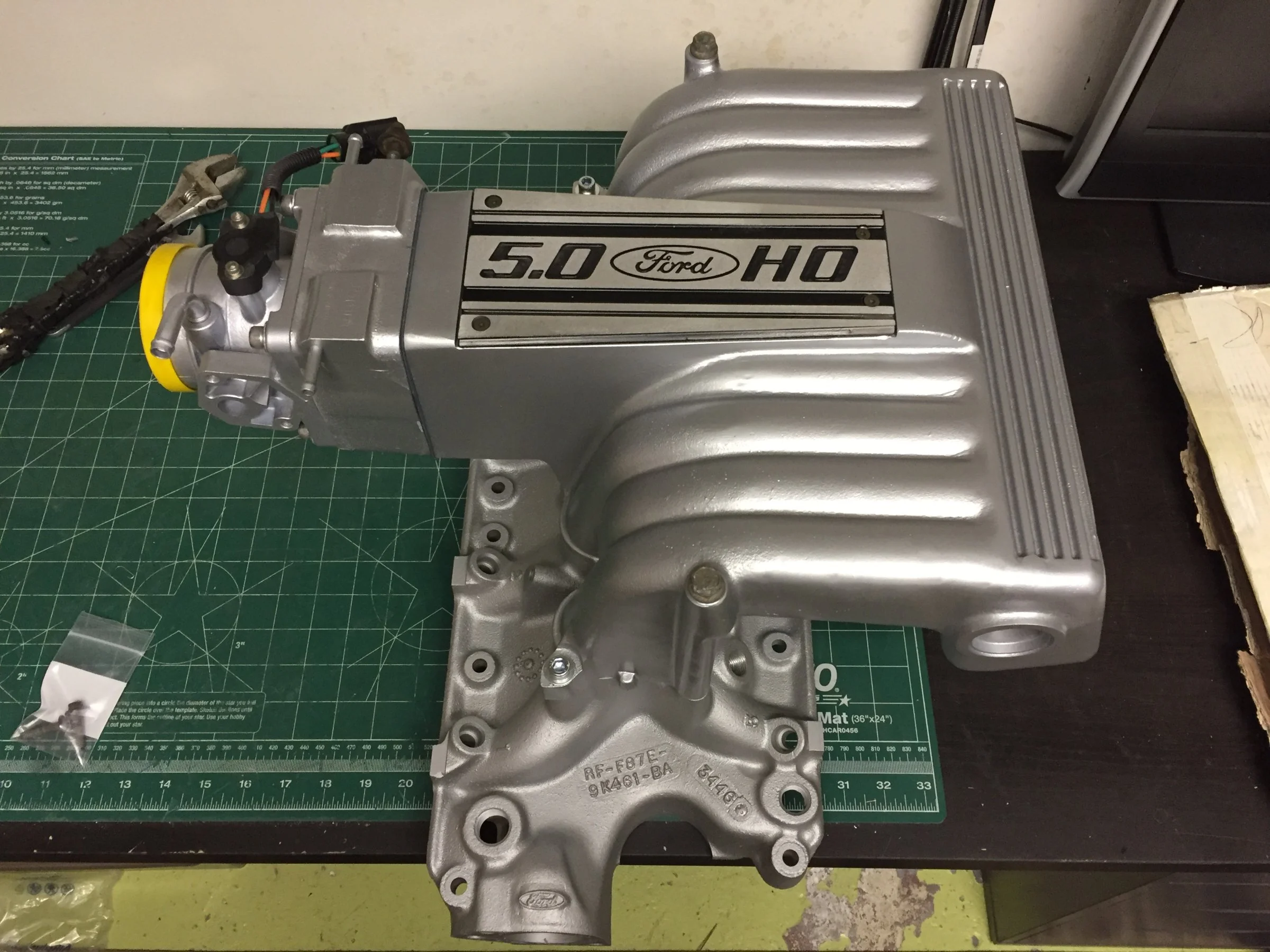

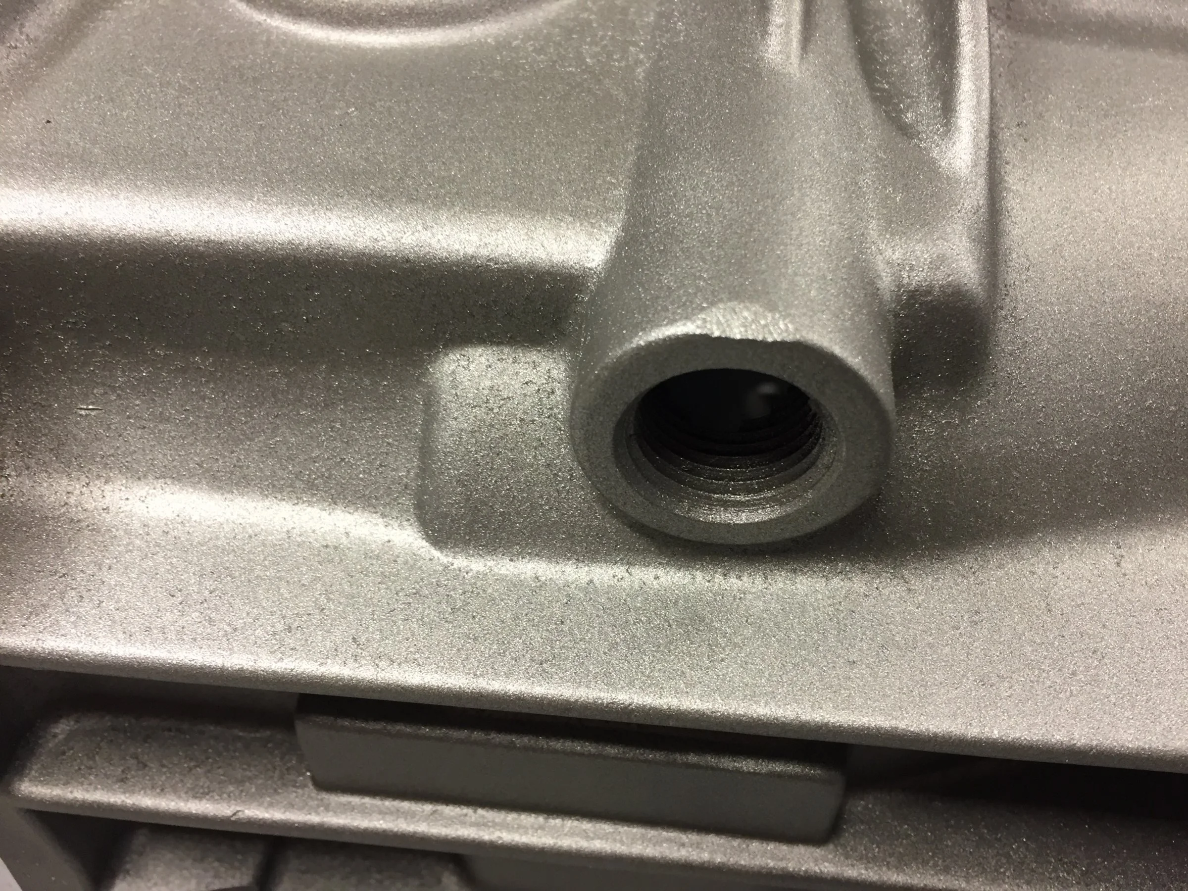

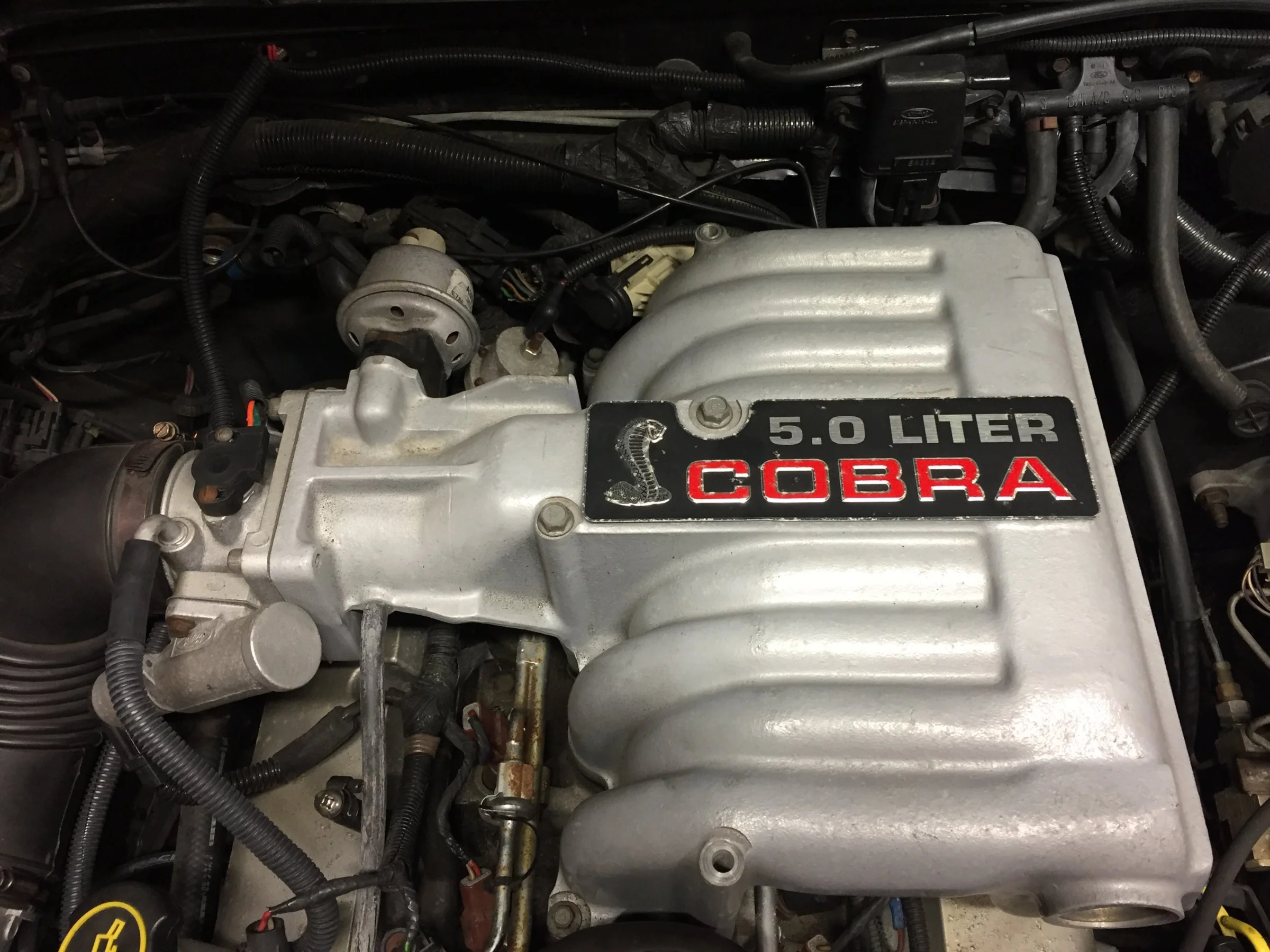

So I picked up some hardware. Need two more of the long bolts. My particular store doesn't have them so I'll prob have to order online.

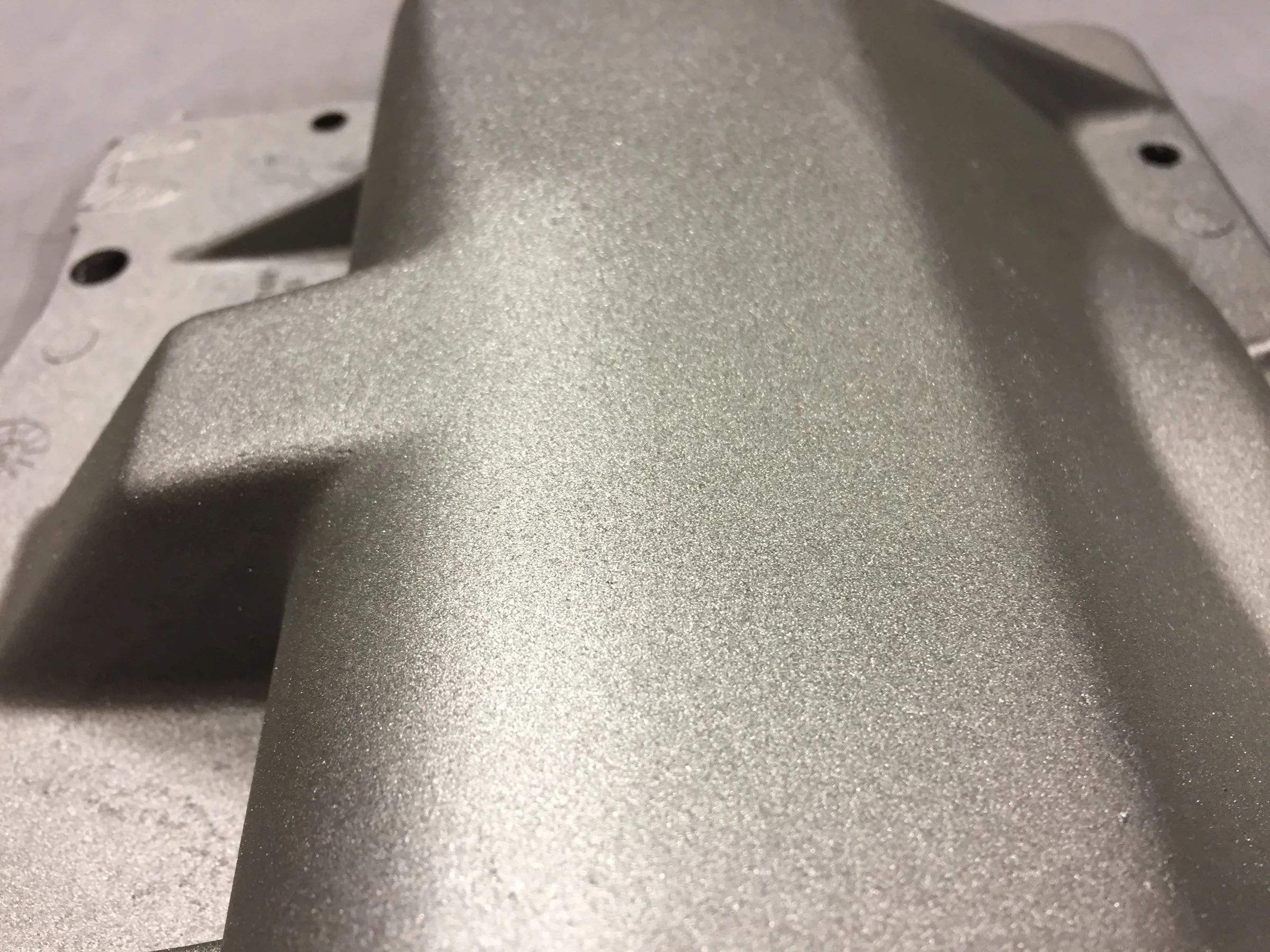

Just realized I never did a final interior rinse if the intake to flush any loose particles out. So need to take apart and do that now
Need to pick up some IAC bolts, wash the intake and then grab the long bolts for the upper.
Lower intake won't get installed right now. No point with E7s

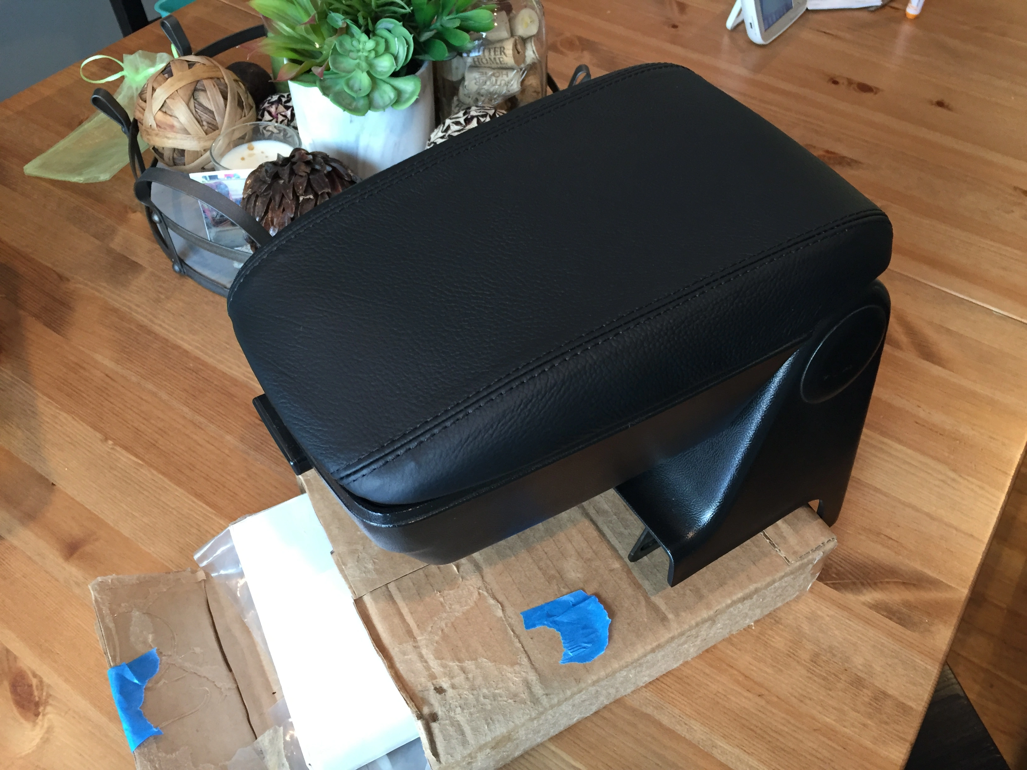

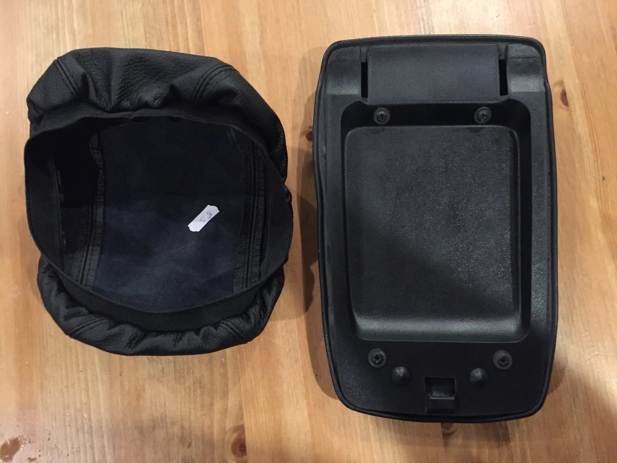

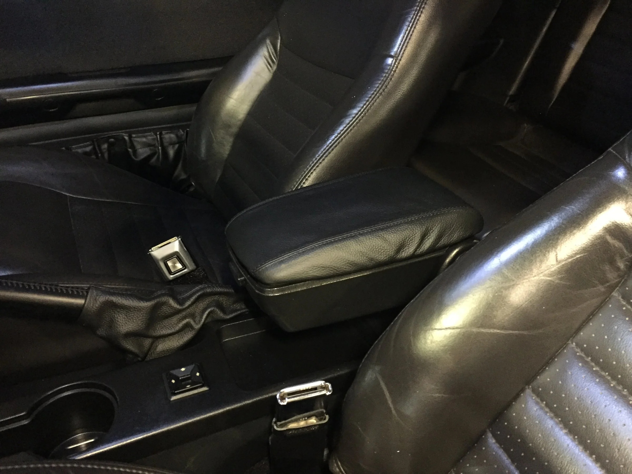

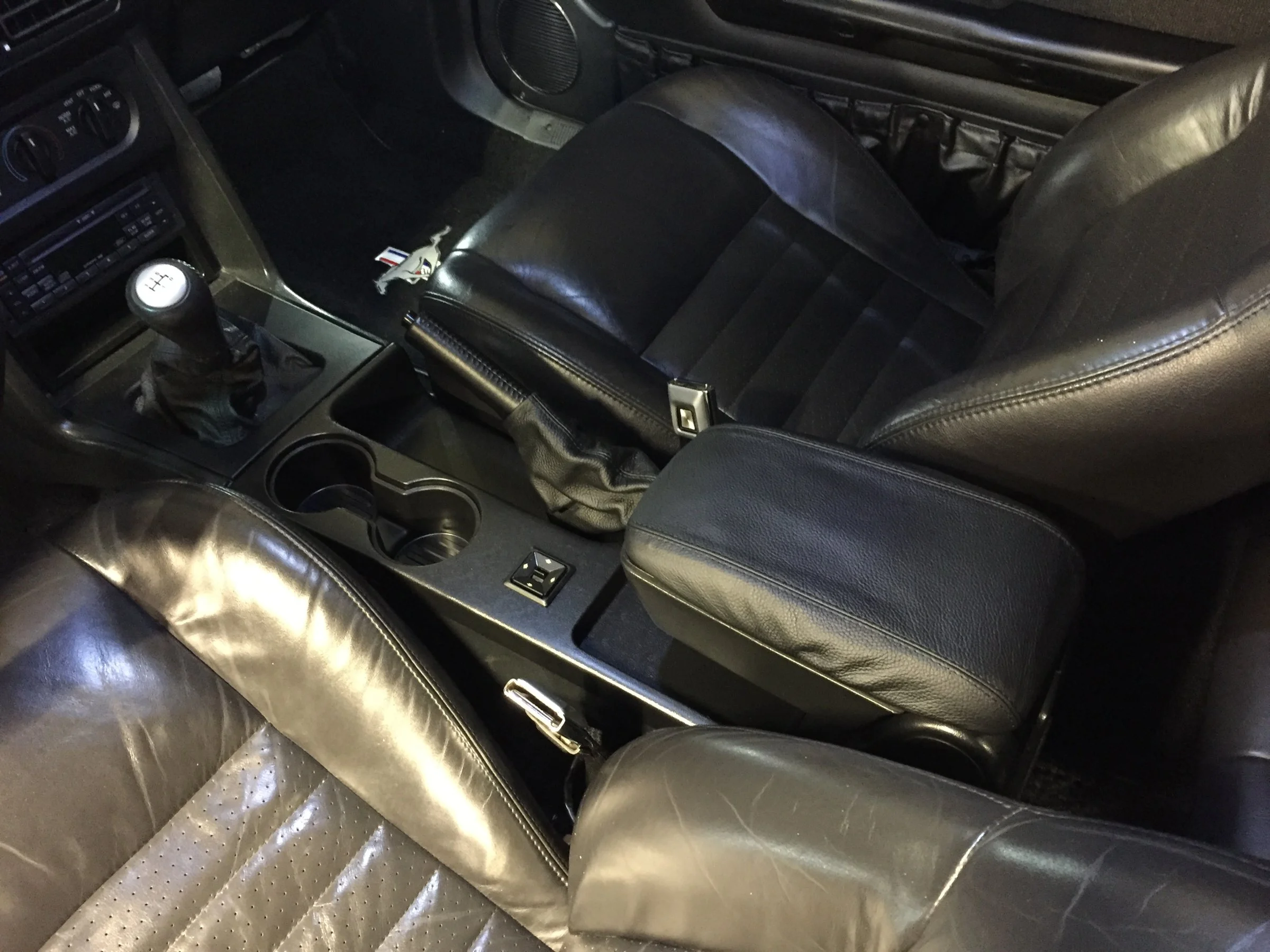

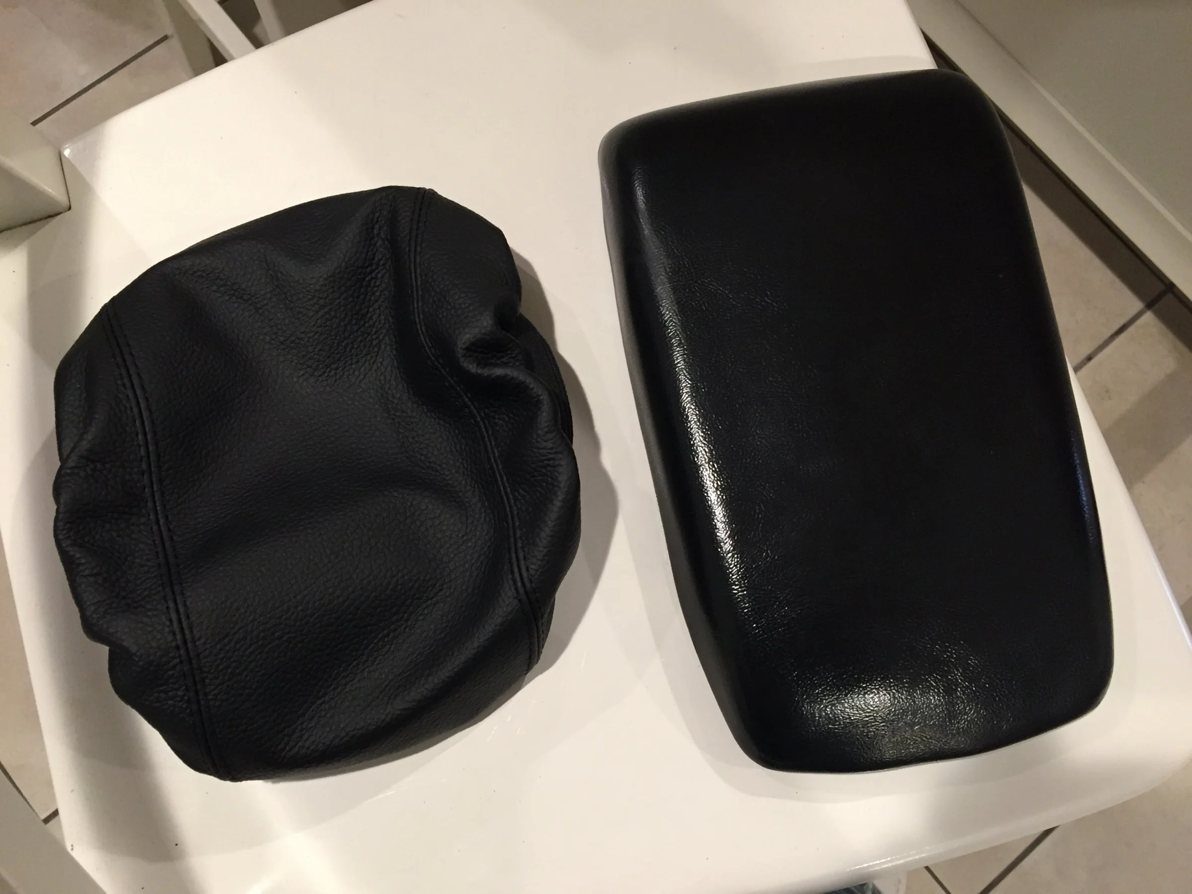

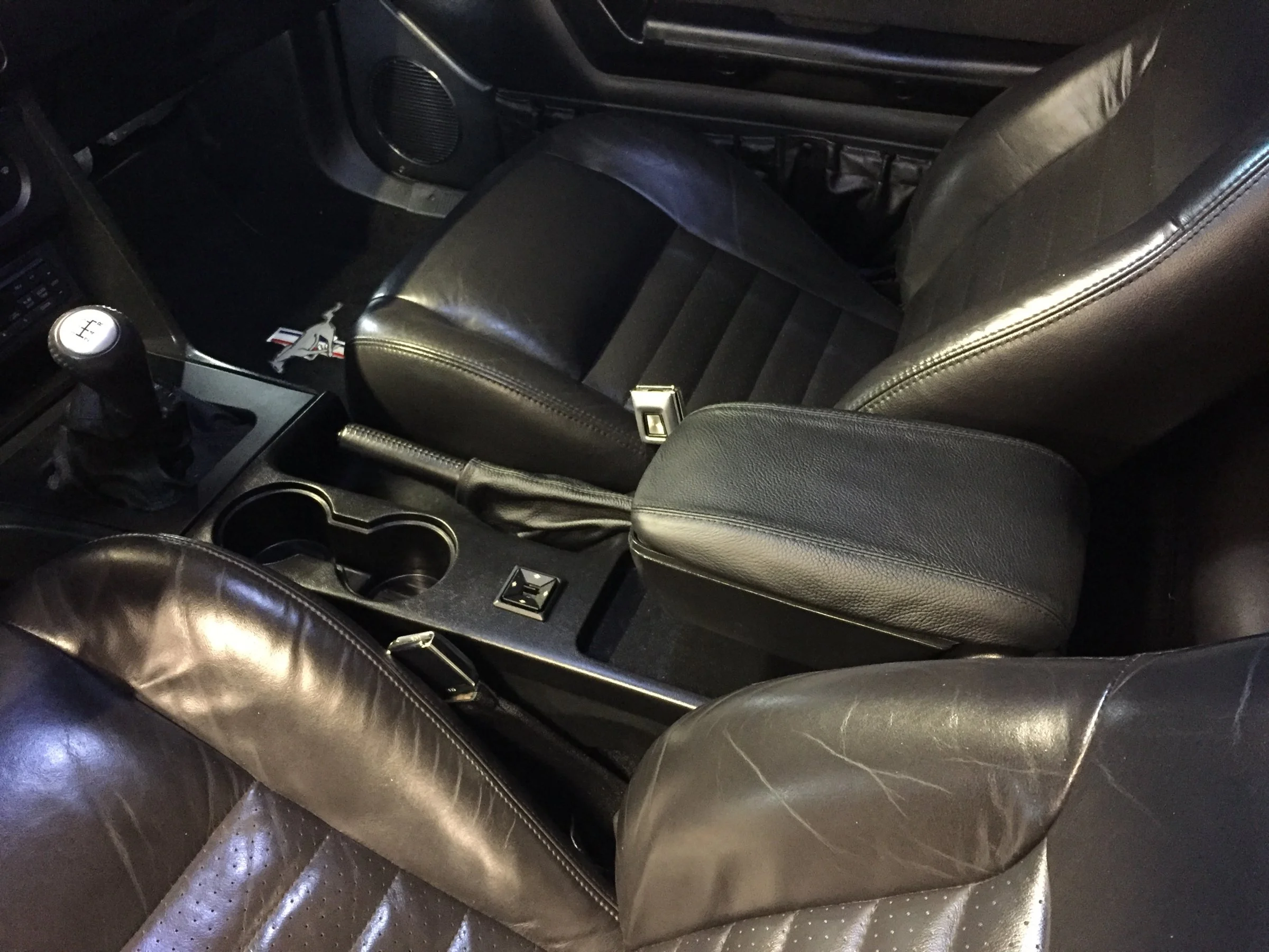

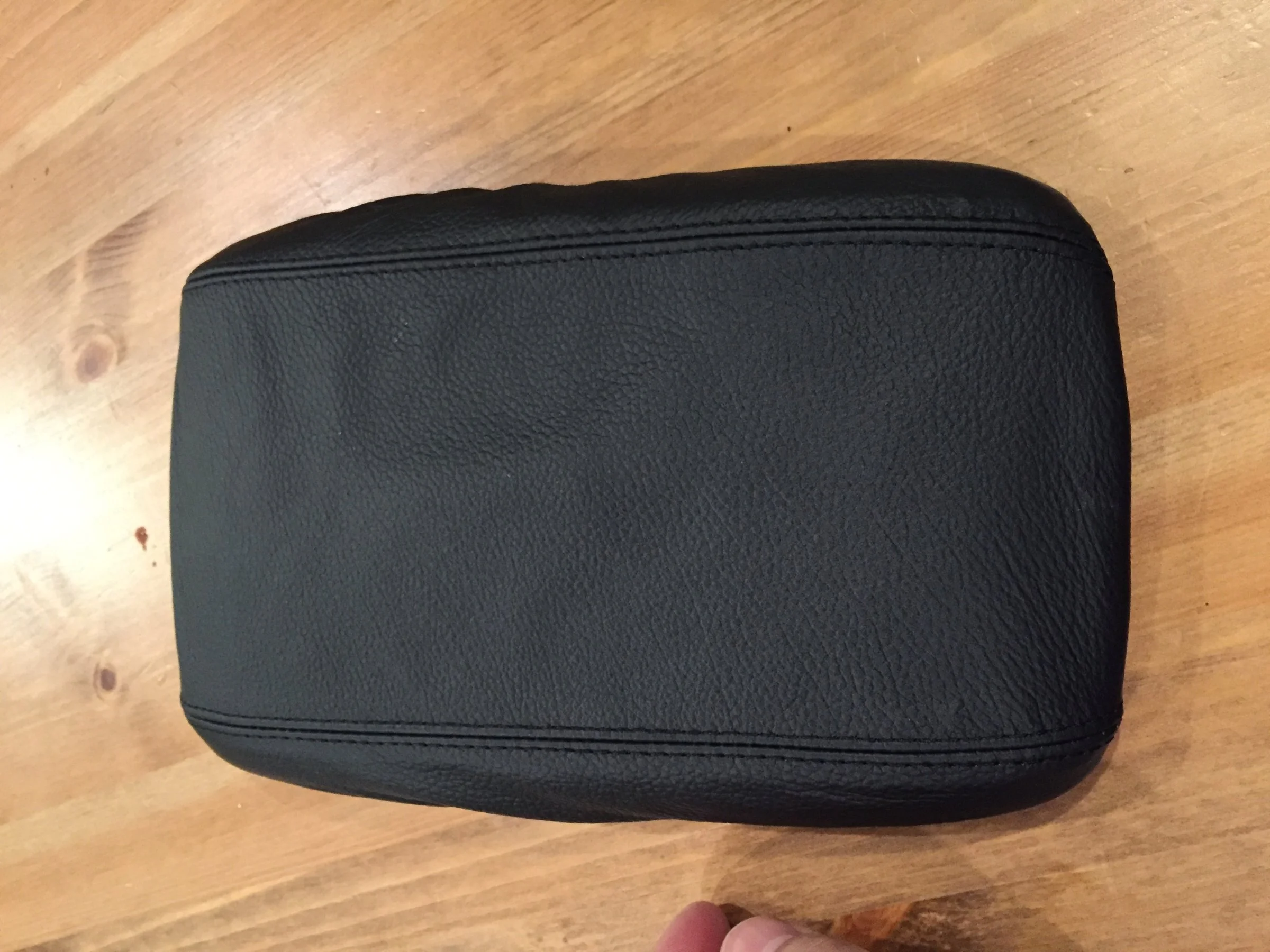

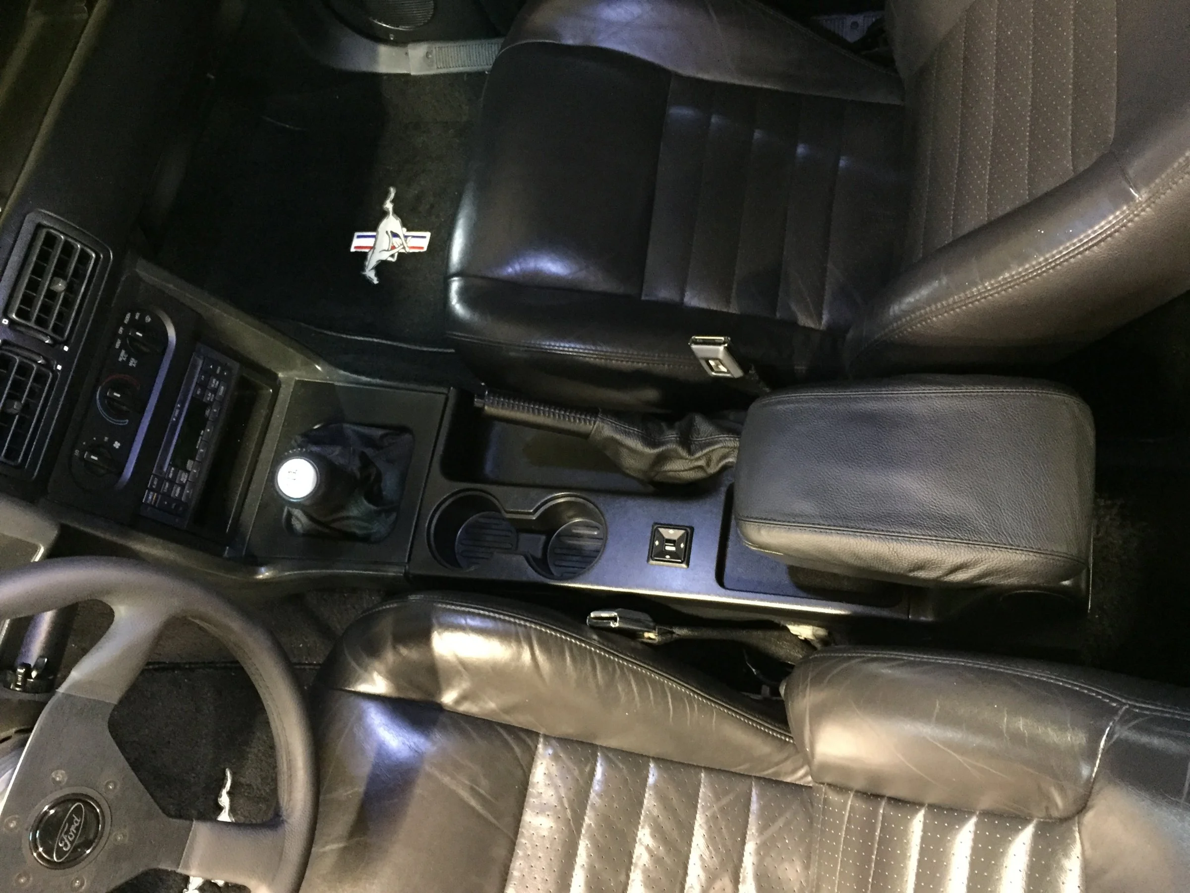

Got the redlinegoods.com armrest cover today. Fits well except i stripped one of the mounting screws. I'll need to repair that. But here are pics. I'll probably work at tightening up the sides a bit when I repair the stripped out screw hole.
I'm thinking of getting the leather dash pad cover next . I' really liking their stuff. I might even door the door armrest tops.

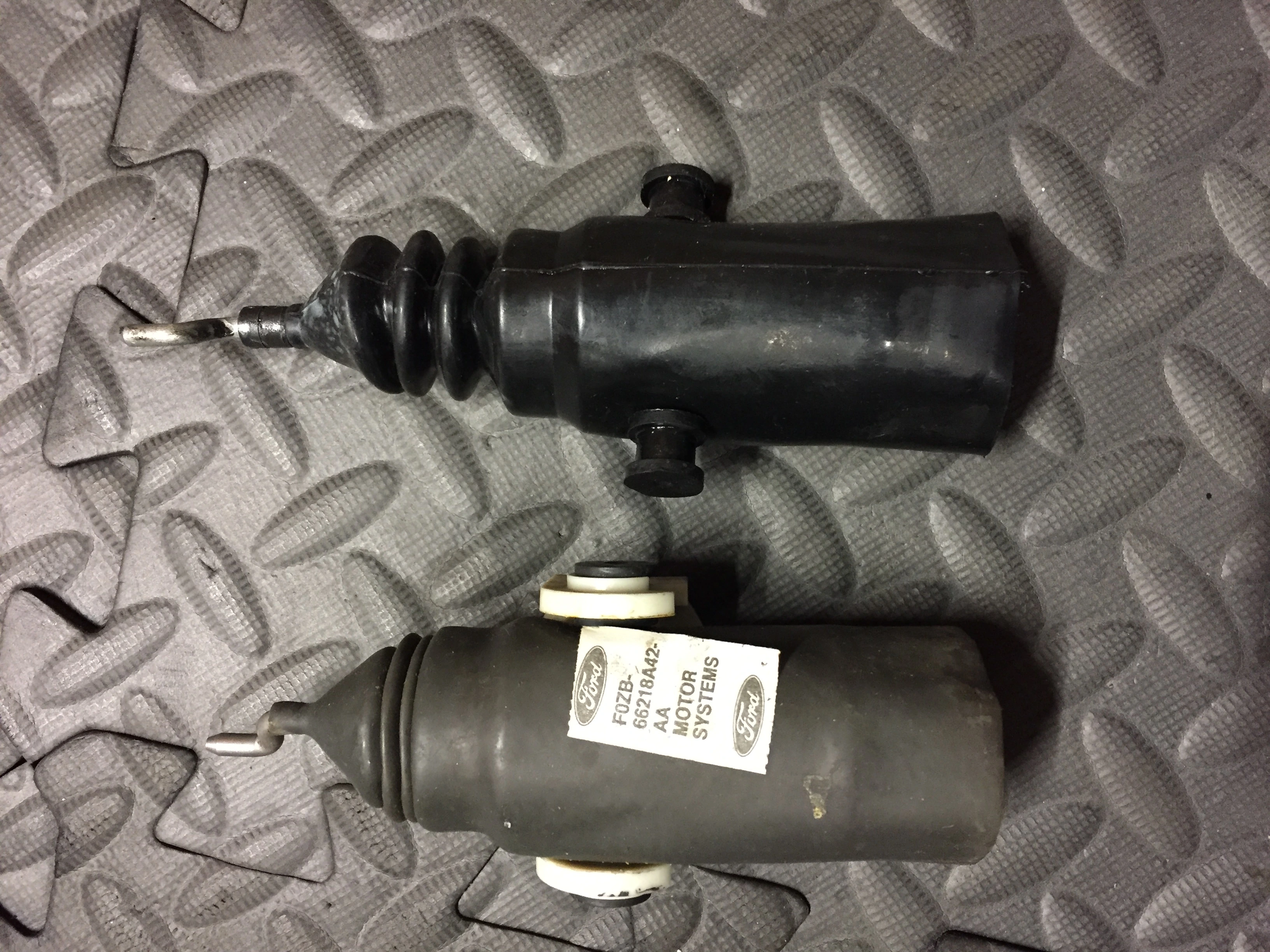

Gone is the reproduction door lock actuator, and in its place a new NOS actuator! Now both door locks thump with authority when I lock/unlock the doors

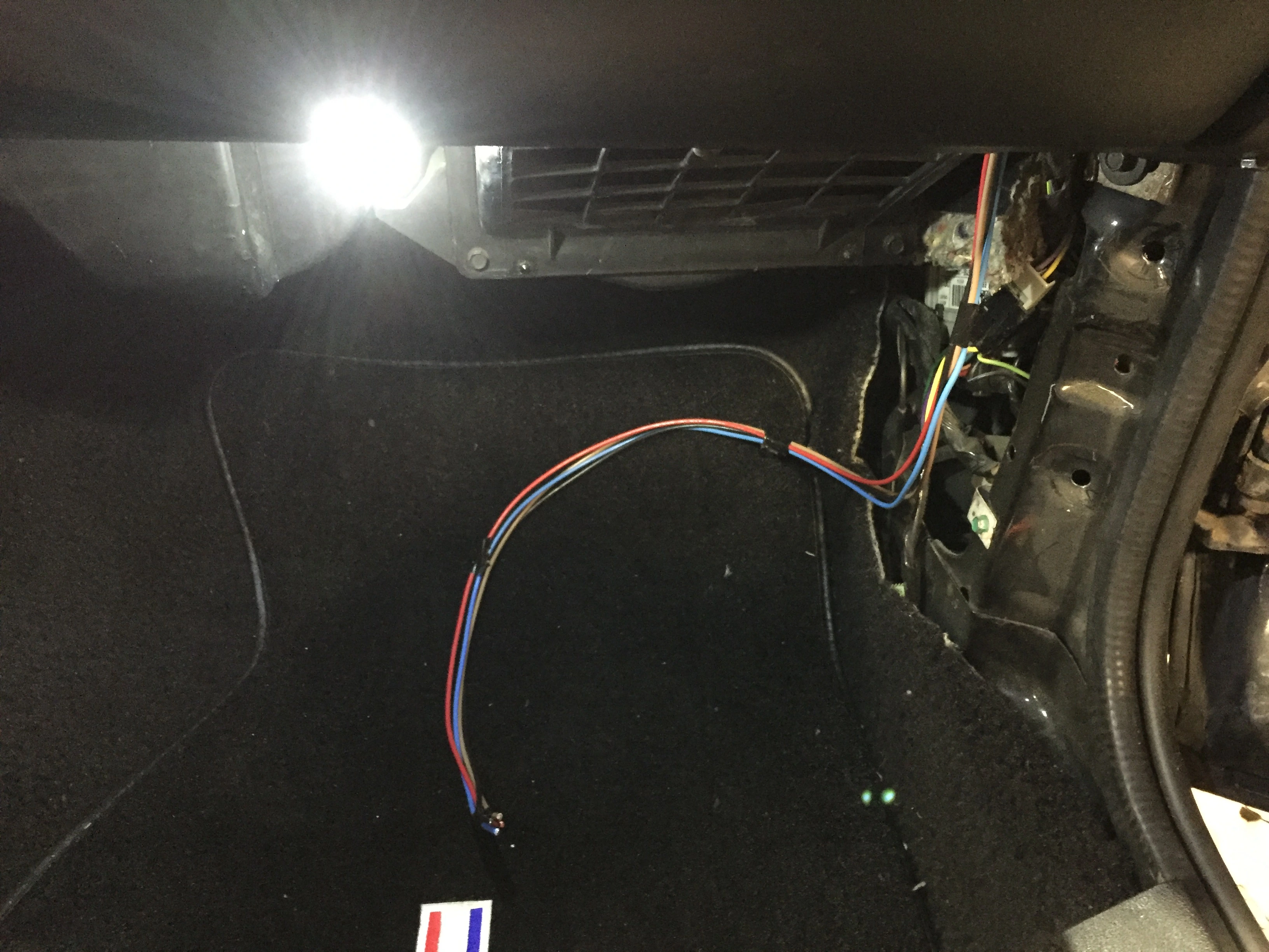

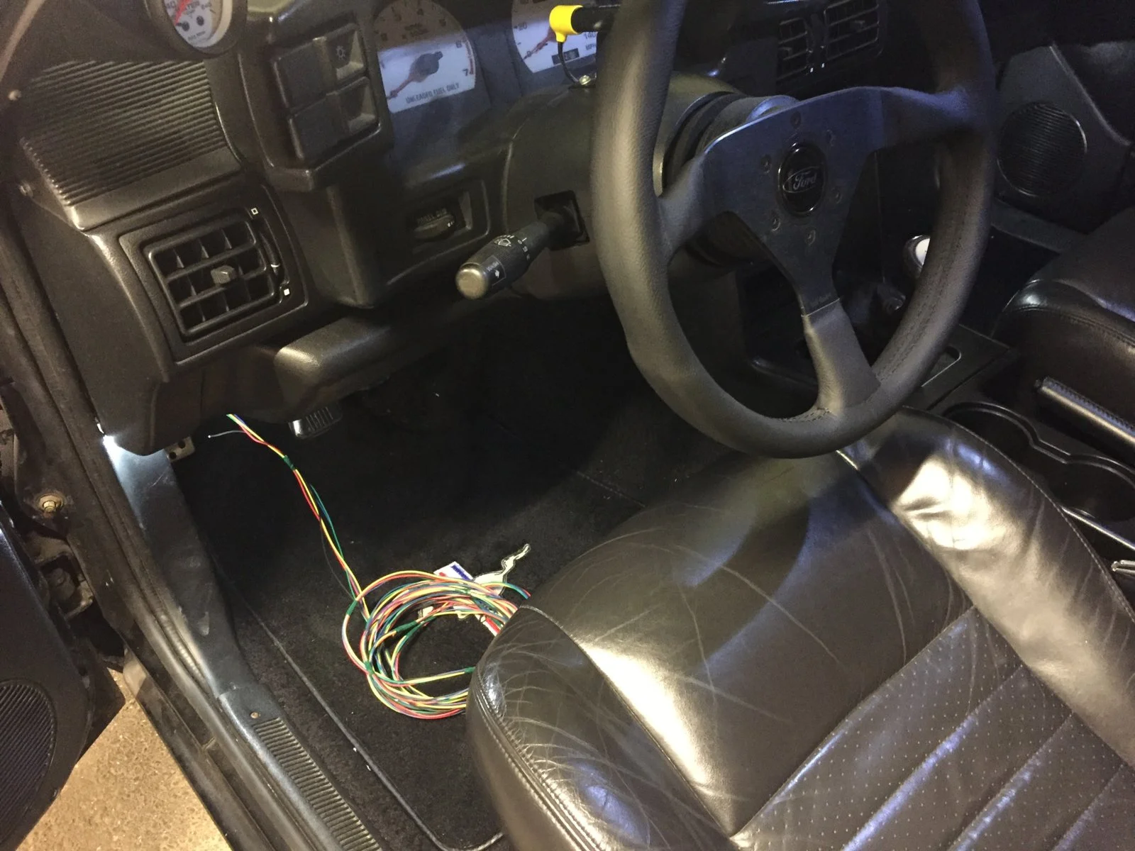

Also, holy hell fishing these were tough. Got really lucky feeding these through and finding a clear path. But, mass air conversion wires have been run. That's the hard part
Next chance I get, need to run the two VSS wires and the fuel pump monitor. Then repin the o2 harness and finally do the actual swap at the ECU

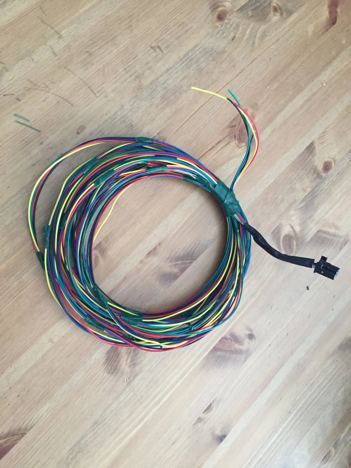

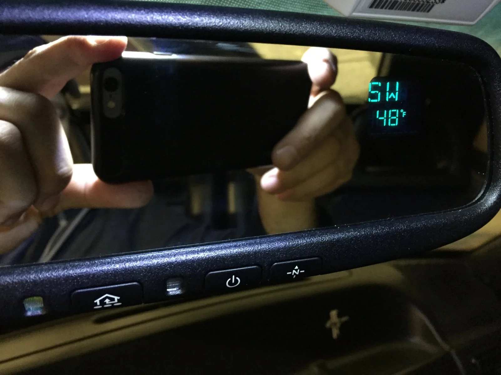

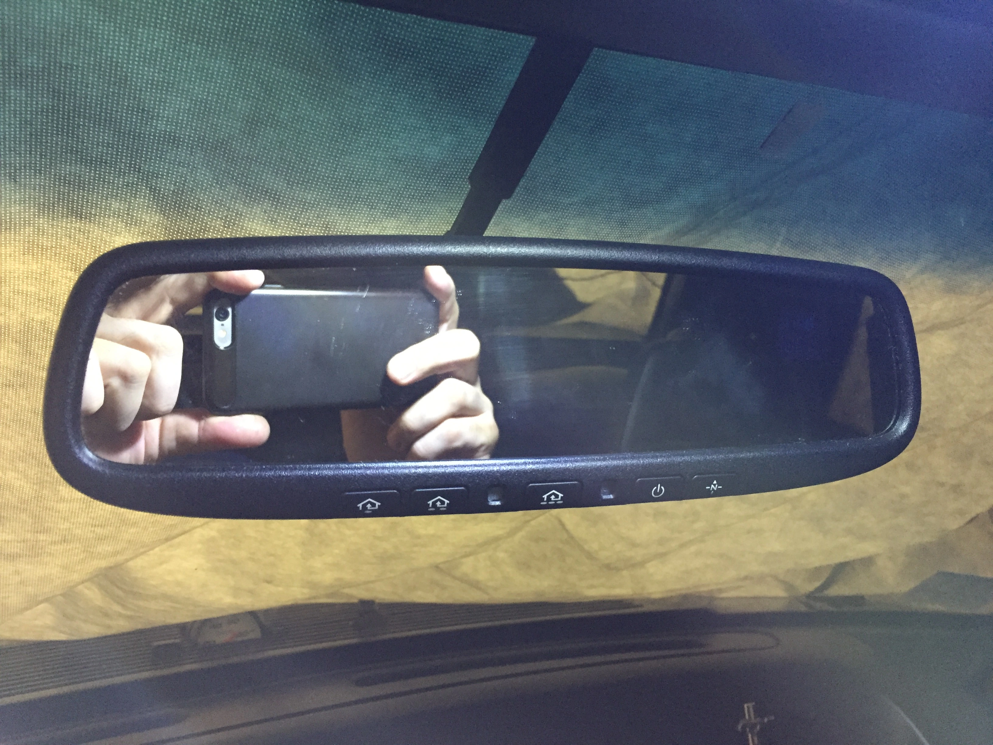

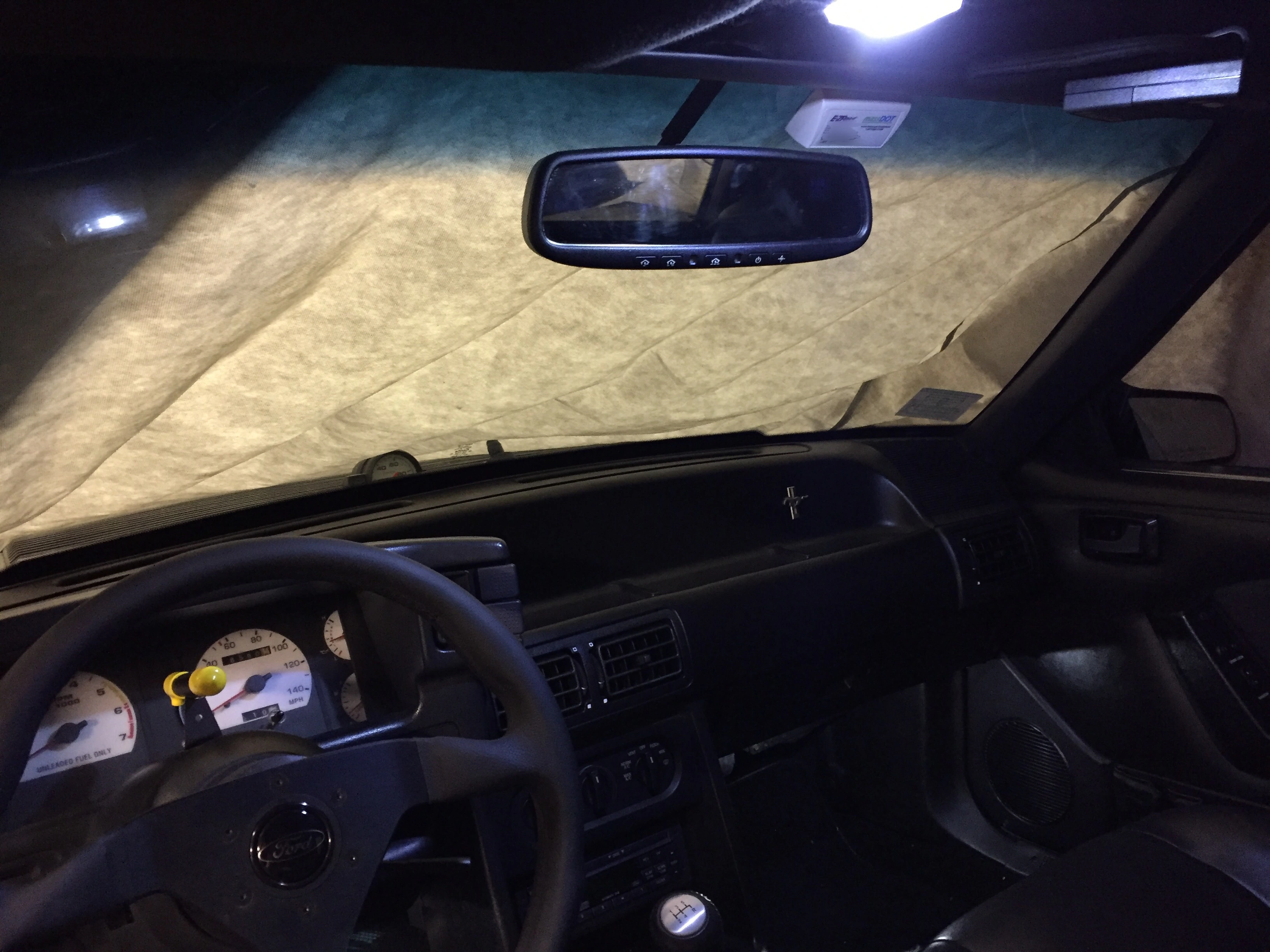

I am keeping my eye on this install... My mirror is de-laminating as well, and are in need of a new one. If I can get rid of the garage door opener on the sunvisor that would a huge benefit.
Mostly why I did it. Delaminating and wanting to ditch the opener. You can see it on the passenger visor in the first pic. If I nail the throttle hard enough it will fly off into the backseat somewhere. Getting annoying.
Wiring should be easy. It's 5 wires.
-Ignition on hot
-Constant power hot
-ground
-temp wire
-temp wire.
I'll ground it on the dome light ground wire, and then run the two power wires down to the fuse box area and find appropriate wires. Really hardest part is running the two wires to the front grill area to mount the temp sensor. As soon as I get my wire in and make a harness i'll get this done

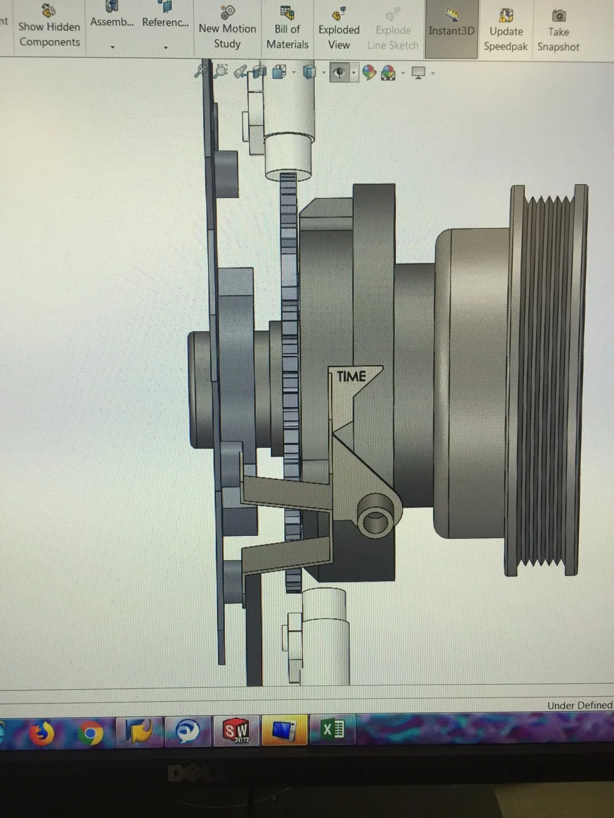

I had remembered you posting this after doing some searching online about covers and the offset of the explorer engine dress vs the fox.. did you come up with a conclusion as to whether this cover will work or not [line up with the tone ring]
So I opened up my model to see if the timing cover with the boss for the vr sensor would work if the tone ring was attached to the backside of the stock balancer, and it does appear that it would line up. The stock timing pointed straddles that boss, so the ring does appear to line up with the center. Of course no idea if this is 100% accurate as I'd need to check a few things first dimensionally.
I think I am going to try to machine that unmachined portion of the balancer and then cut a 36 tooth wheel and press it on here. I'll cut 1 tooth off when I determine where i'll put the sensor.
I saw that too. I think LRS sold this for a while as a timing cover for a Mustang as searching through old posts, you'll find reference to the LRS timing cover having the provision for the explorer sensor. However, the new ones don't have this. I saw a pic of one and I'm pretty sure it's the econoline cover that uses a standard pump.
I don't think it matters if your water pump has the circular holes on the rear
Yeah im not going to worry much about that part, i am mostly concerned with ridding myself of the vibration of the sensor. my current setup works but i dont like how far out the sensor and tone ring sit from the engine. The single largest hurdle is the tone ring, why ford didnt add it to the SN balancer is beyond me.. it would have made this whole affair plug-and-play

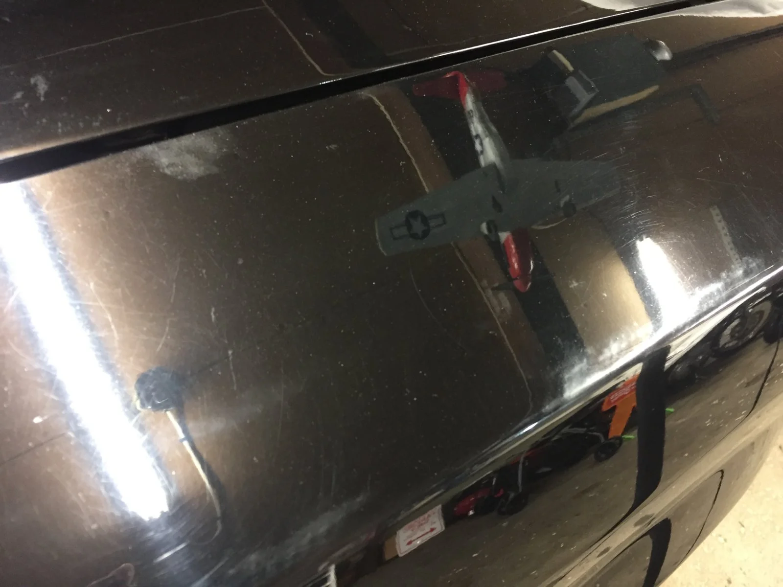

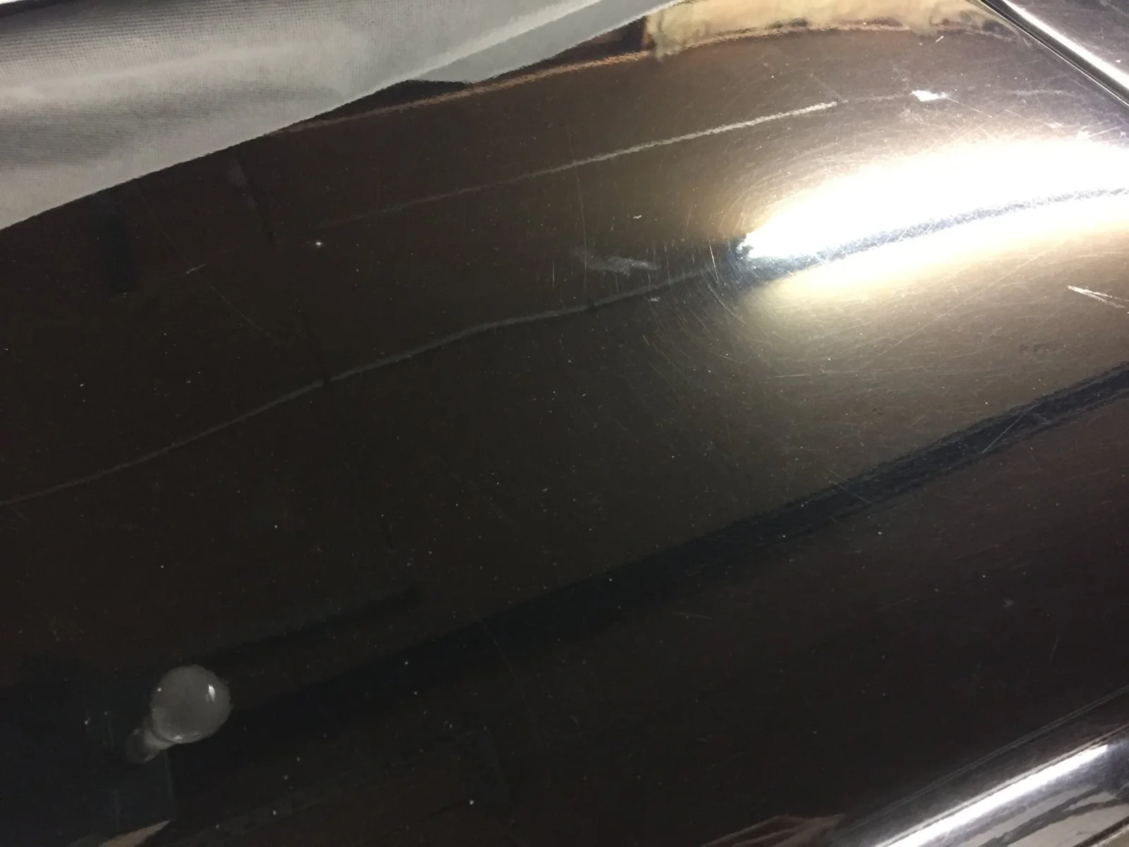

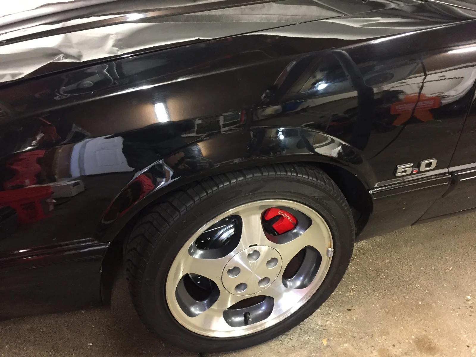

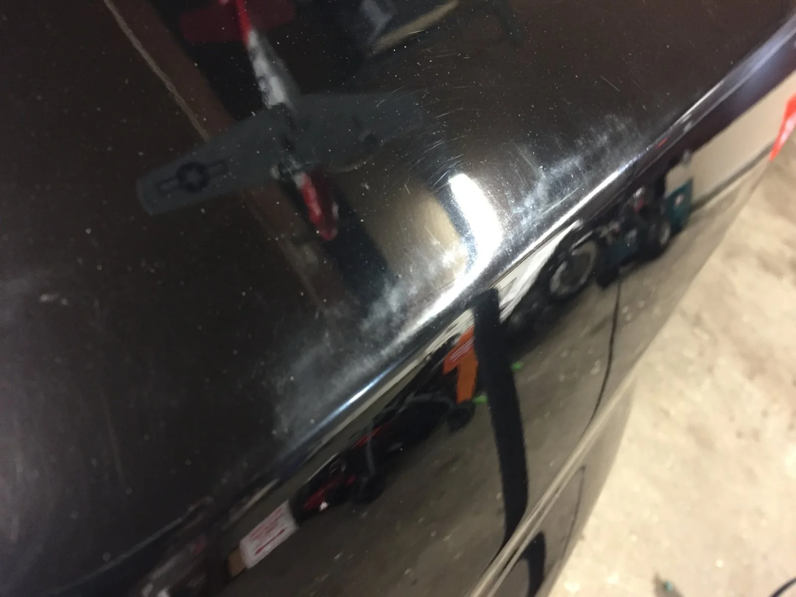

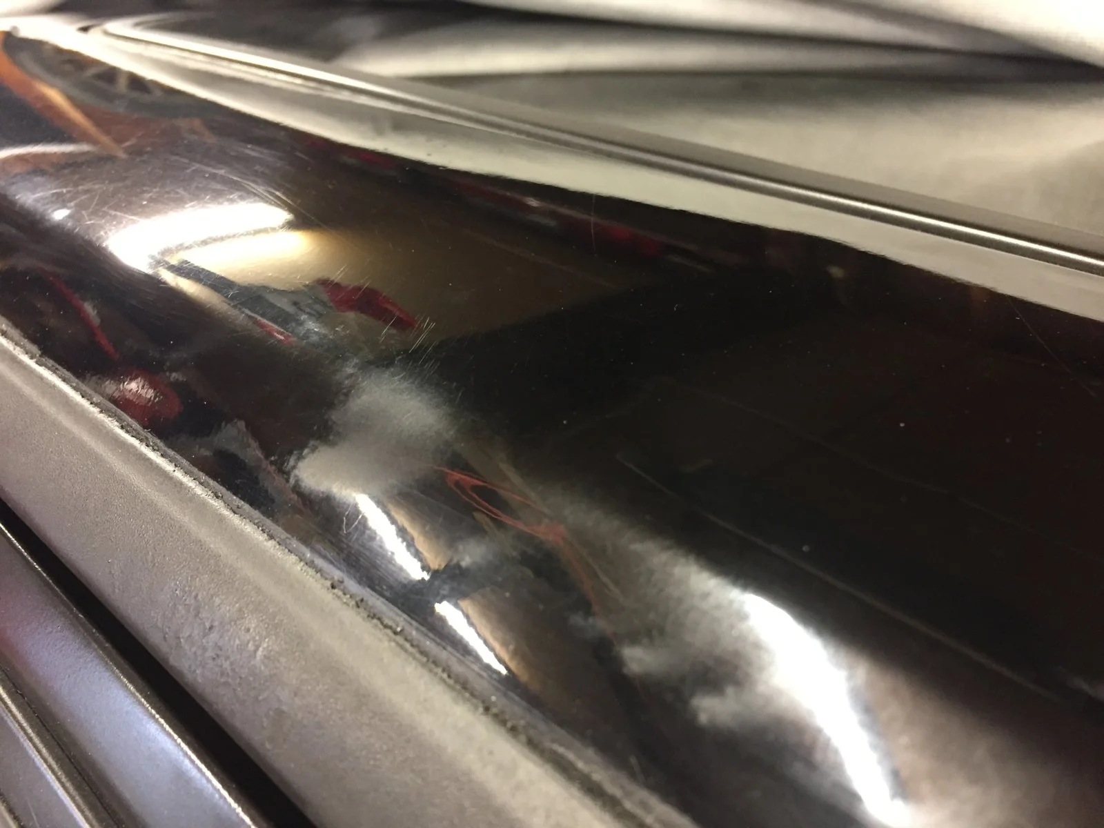

Decided I needed to spend some money on the paint. Car was repainted in 2000, but I've neglected it.
The paint isn't too damaged, just has swirls and haze from almost 10 years under a car cover. I need to fix that finally.
Got a DA buffer in the mail. Prob pick up a few more different compound cuts and polish to try out.
So here's what I got to work with with paint. It's not terrible, but it lacks the depth of nice shiny black paint, especially in sun.
From 4-5 feet away, plenty of shine under gararge lighting.
But up close, you can see the haze spots and fine scratches from years of being under a cover.
Furthermore, lack of depth in the color. Worse in direct sun.
My paint will be nice again with a little work
