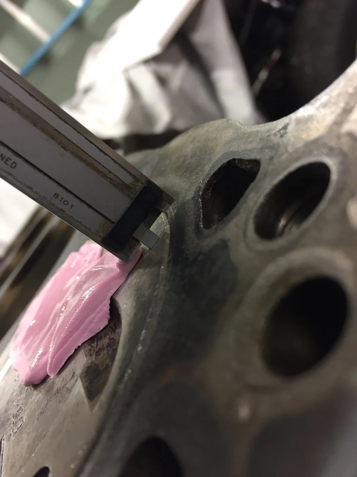

Did a practice run just to see. I think 6.750” might be the number. This was 0.065” wide. Spec is 0.080” according to the TFS instructions. I just need to read up on how to factor in lifter preload

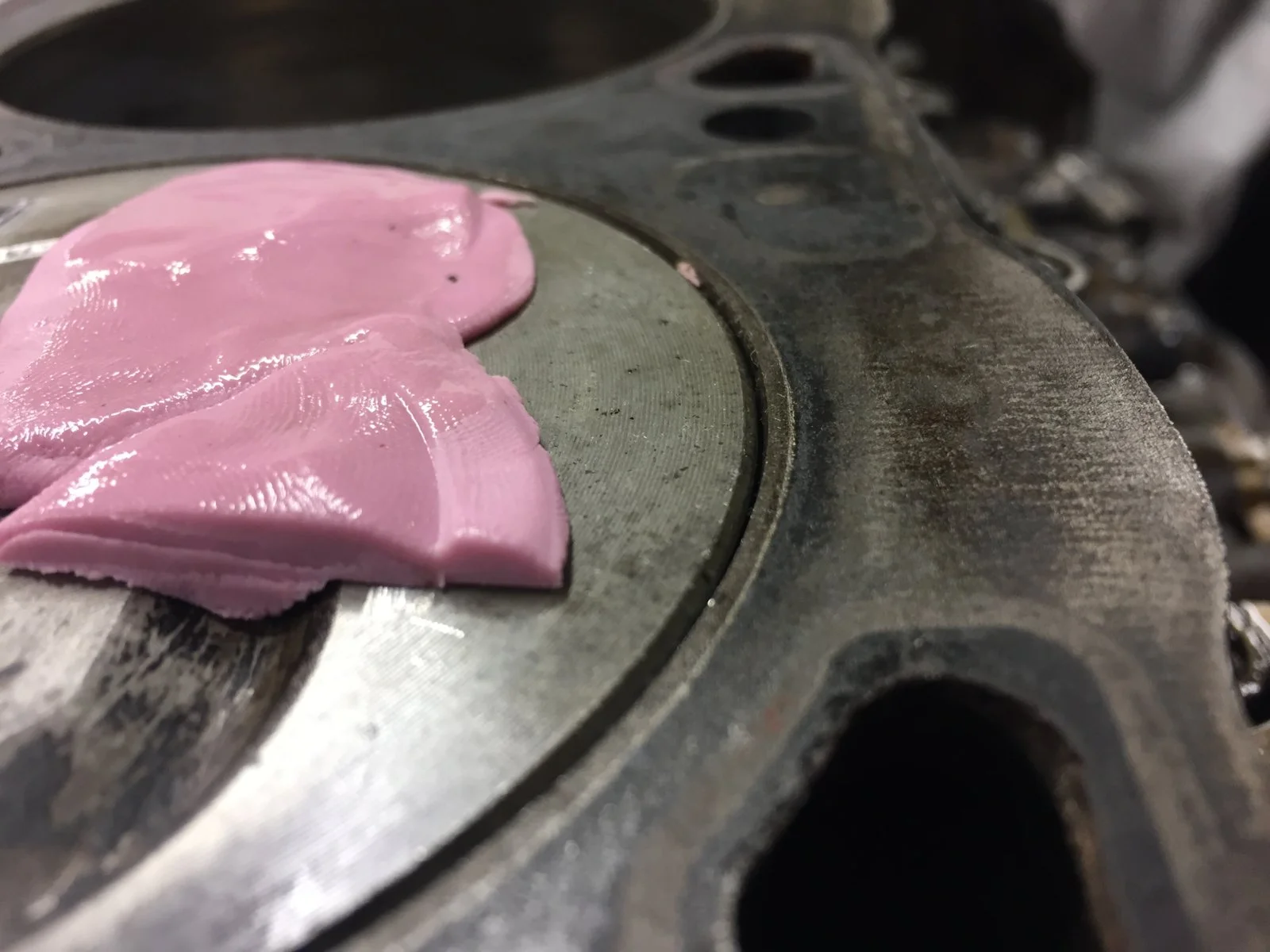

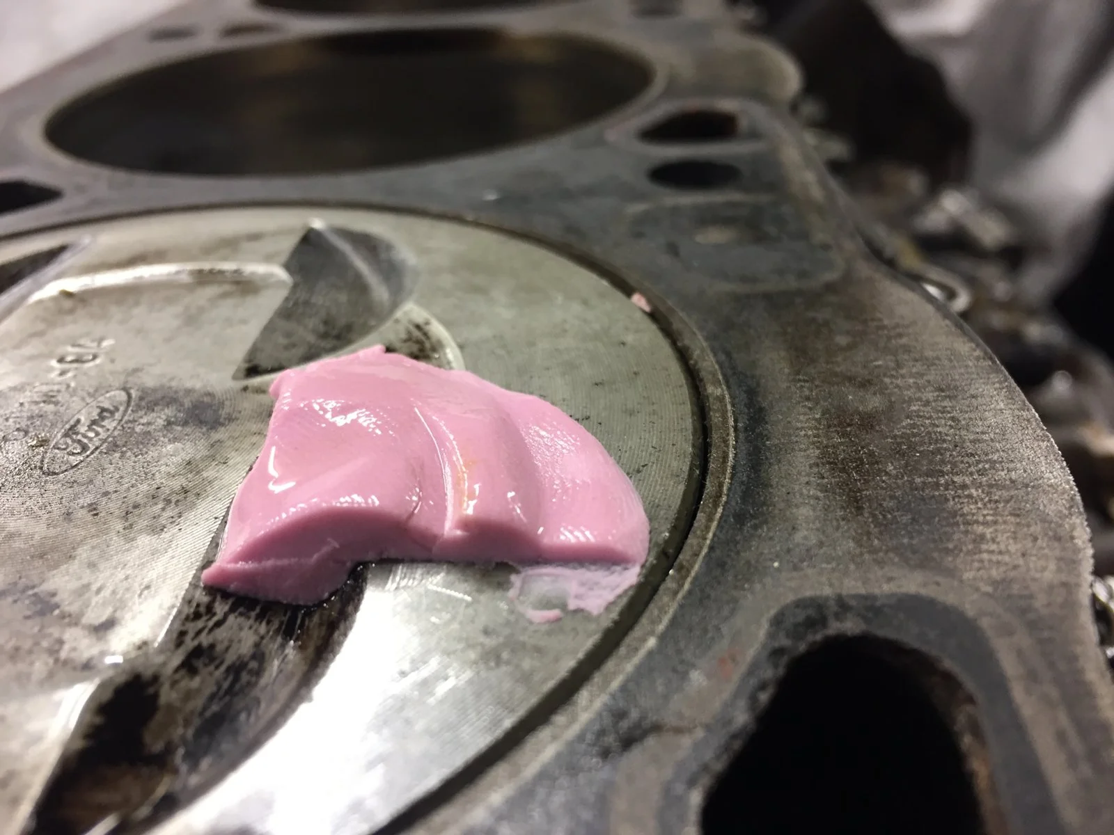

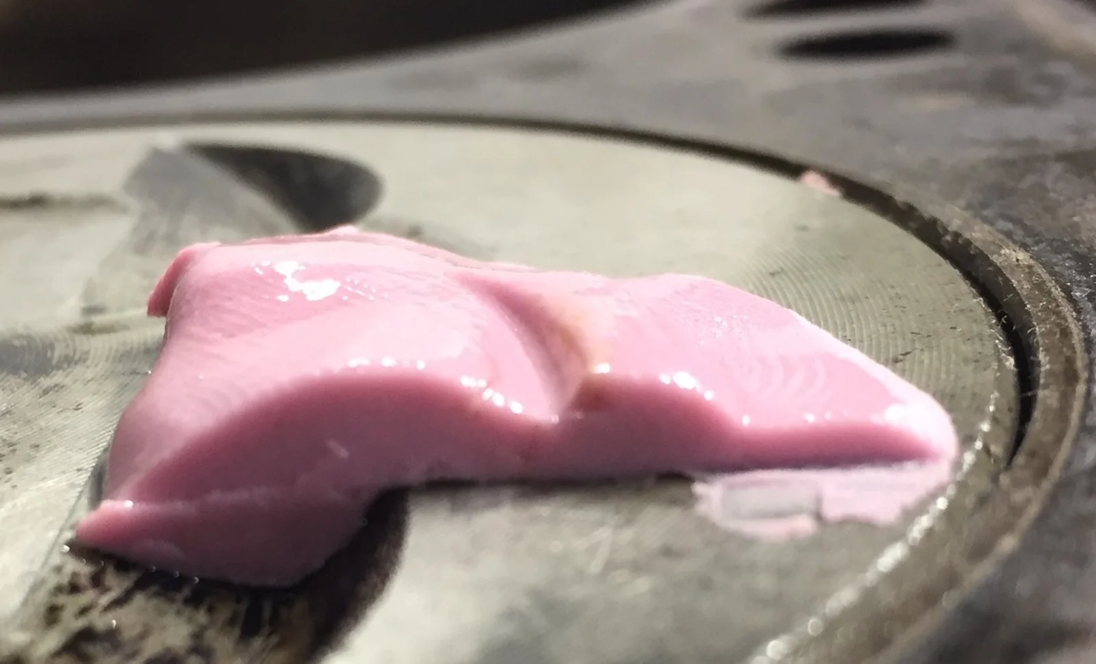

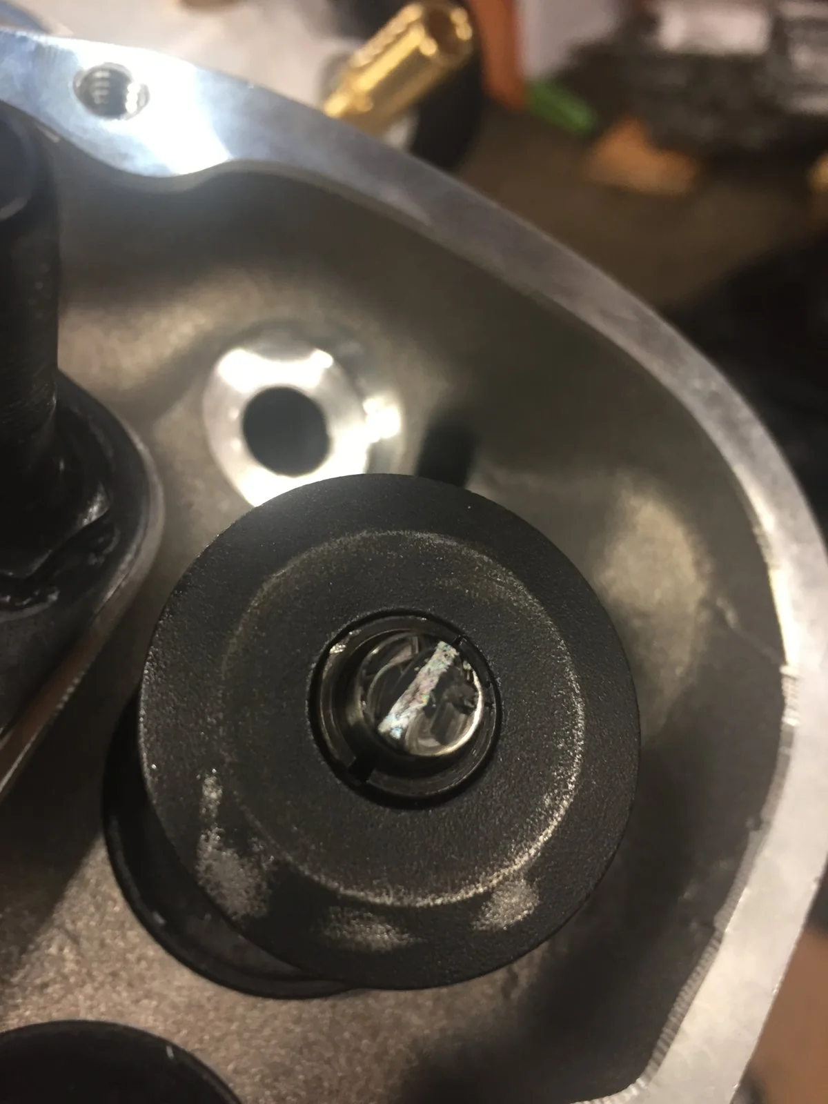

Exhaust valve never really gets close. Here’s the intake valve. On my Caliper it measures pretty damn close to 0.080”
Mustang5L5
Mod Dude
Feb 18, 2001
43,333
18,059
224
Massachusetts
Nov 16, 2019
#1,454
  • Nov 16, 2019
  • #1,454
Repeated it. Exhaust way away so I’ll disregard measuring it from here out. Intake close to face.
Gonna degree the cam again just to be sure. I’ll need to rig something to mount my wheel off the balancer since my front dress is installed (jumped the gun there)

Looks good to me. Run it. Lol.

I’d contact Ed. It’s a custom cam for your combo. He’s probably done 100’s if not 1000’s of 5.0 cams. He’ll know if something is amiss.

If that measurement turns out to be correct I'd be comfortable running .080" intake side on a steel rodded street car.
