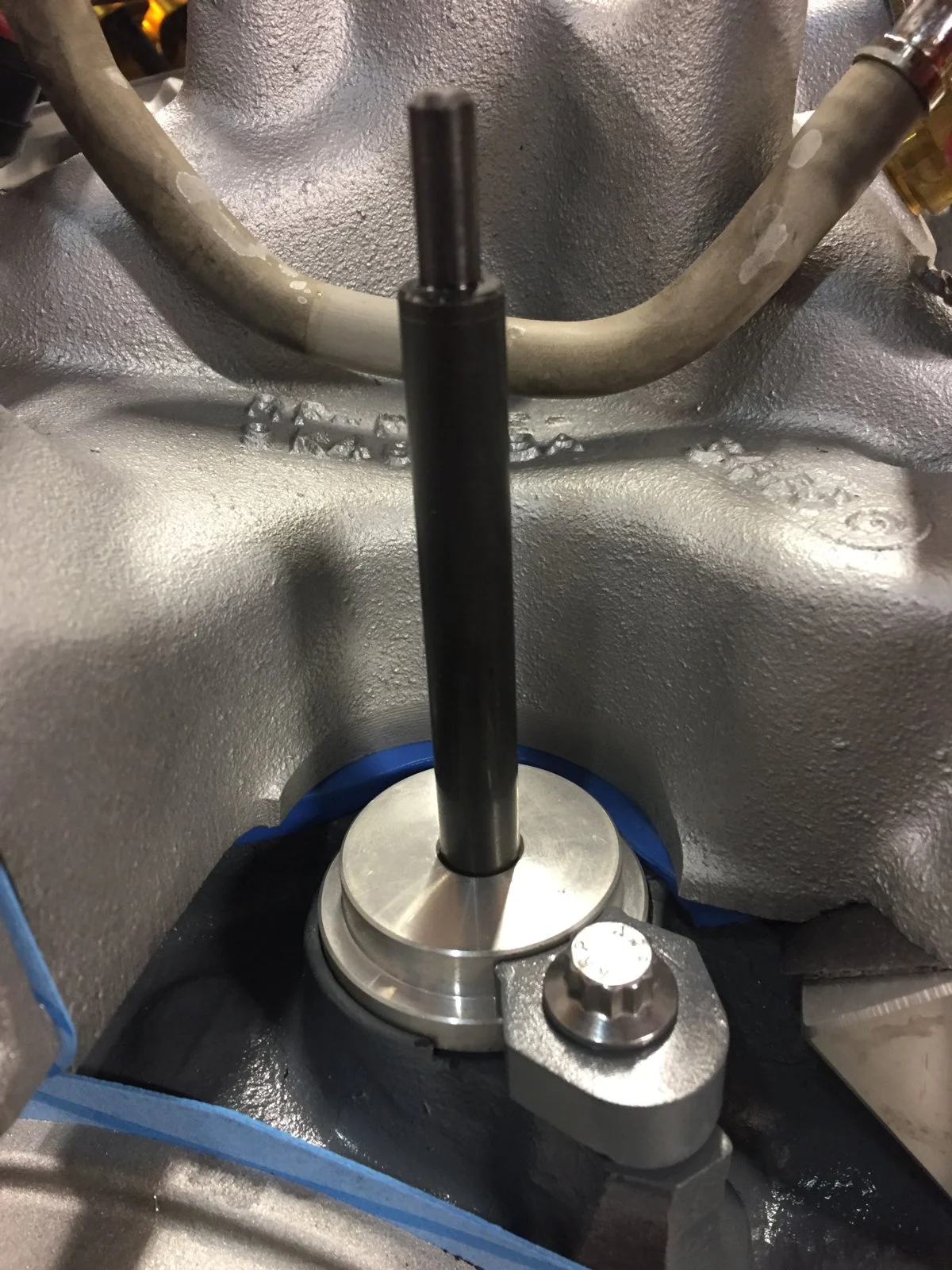

Another tool arrived today for the next step.
I like how this one seals the dist hole. I can leave it in place and circulate some oil once in a while while the engine sits

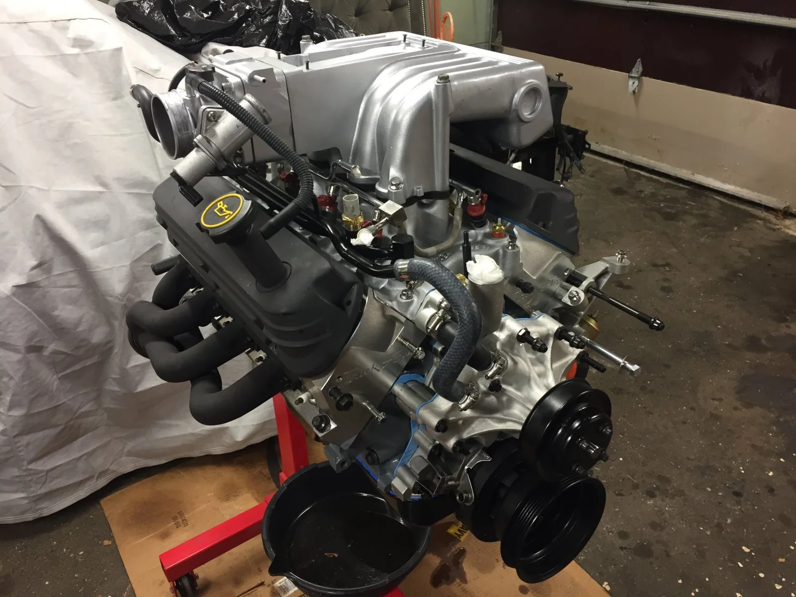

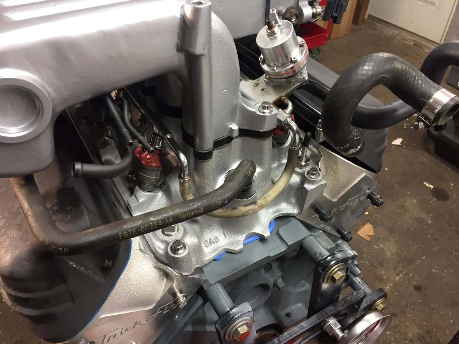

Did some stuff tonight.
Reactions: Boostedpimp, Reddevil91, Jersey Joe and 10 others

Pass side valve cover doesn’t fit. Not even close with the baffle removed.
So I ordered my valve covers. Should be here next week along with fresh gaskets.
Also measured and ordered some hardware for bolting the intake on as well as the other brackets and such.
Priming the engine after setting preload was no big deal. All 16 valves began to ooze oil after 10-15 seconds. I had one valve with a very strong stream. Reset preload on that one and the second time it was more in line with the other 15. Interesting.
I’ll wait til engine is in car to bolt on all the brackets. They need to come off anyway. Next up is to put engine down and work on RMS/flywheel/clutch/bellhousing and bolt trans on
