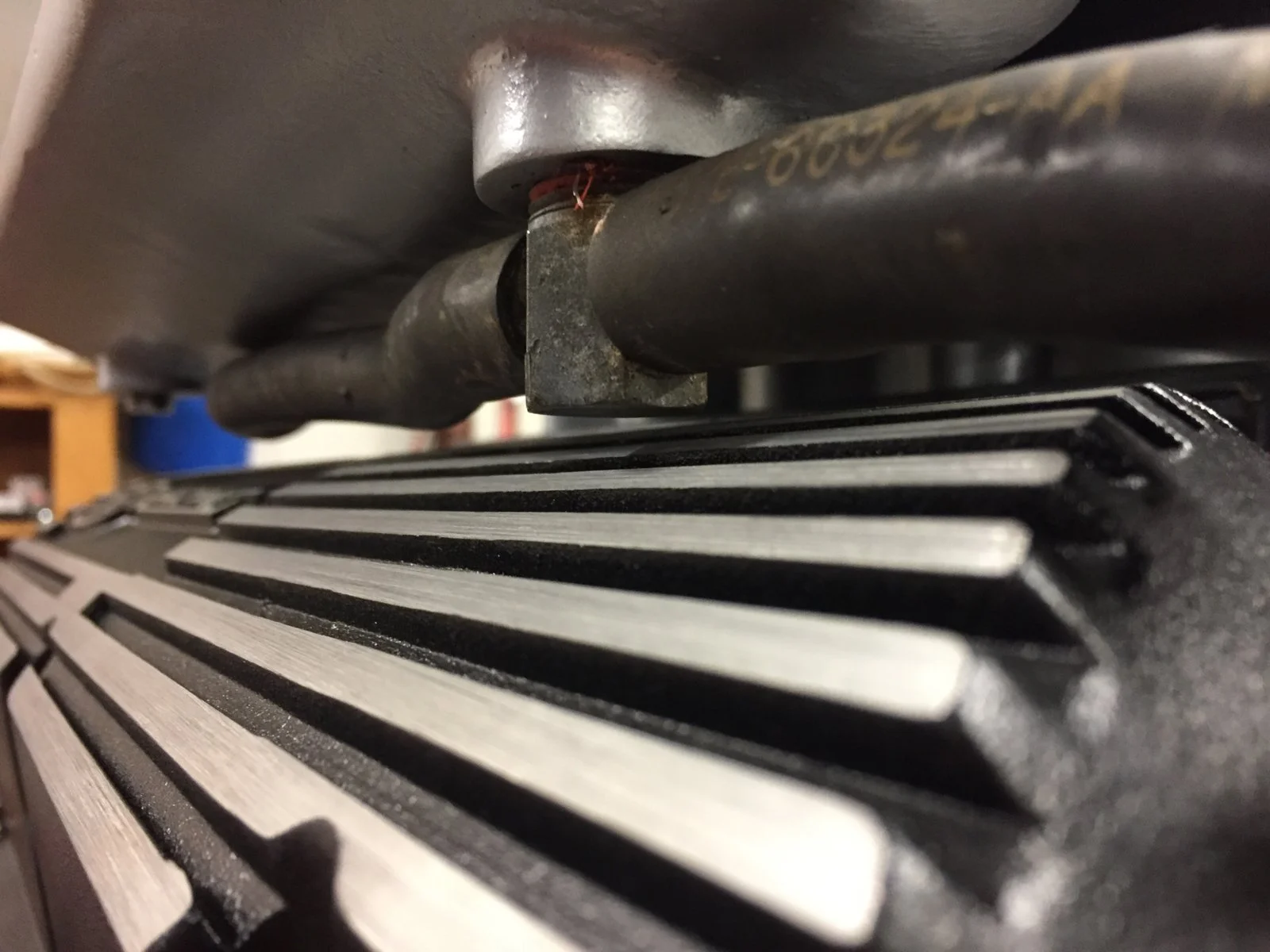

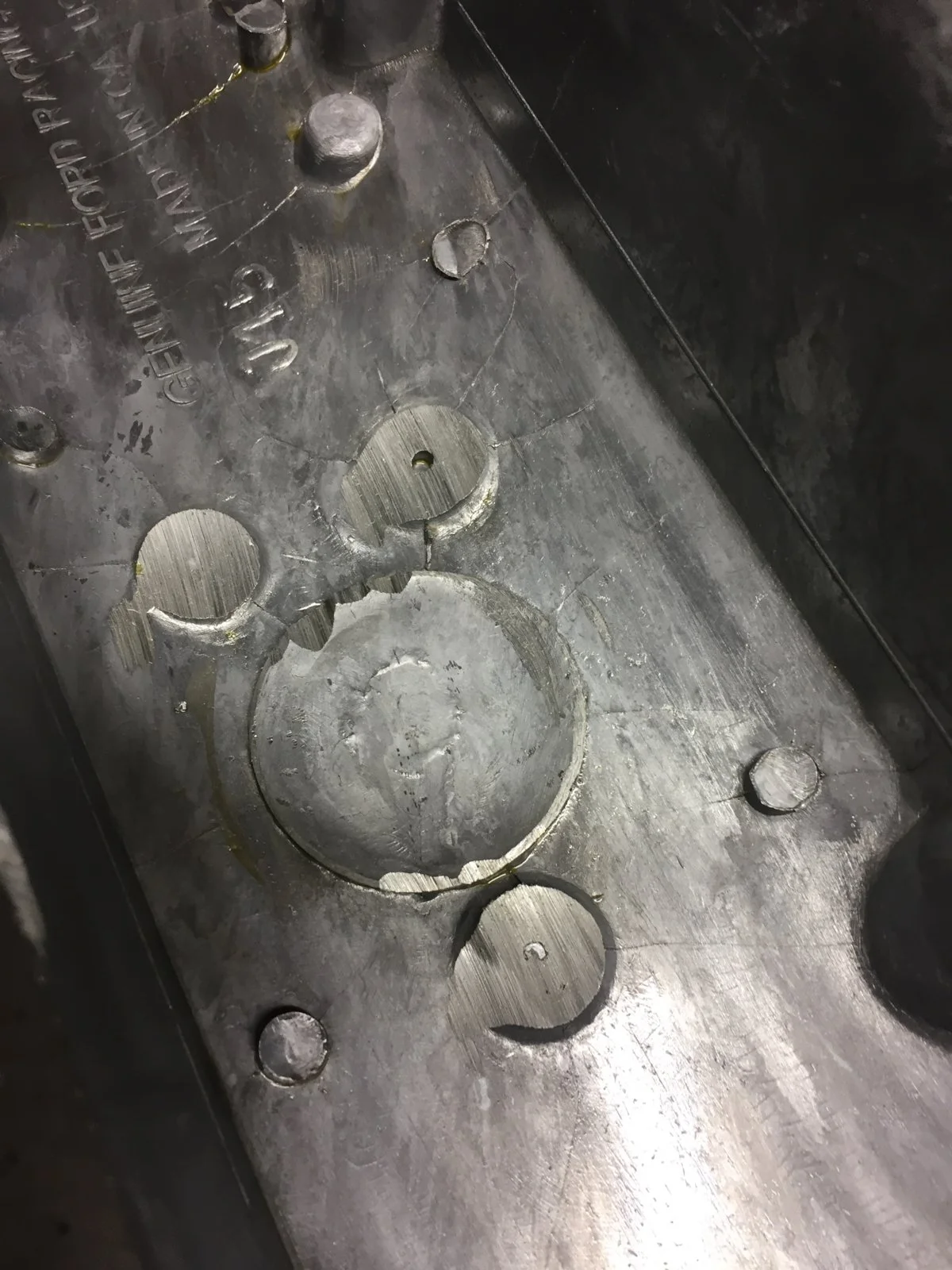

I'll take the grinder to the driver's side cover and remove those bosses. I'll take some playdoh to check clearances after. Since the covers are the same casting, if it works on one side, it should work on the other.
No where the hell is my grinder?

Mustang5L5 said:
Nice. I'll likely do the same.
that grinder is right over there.

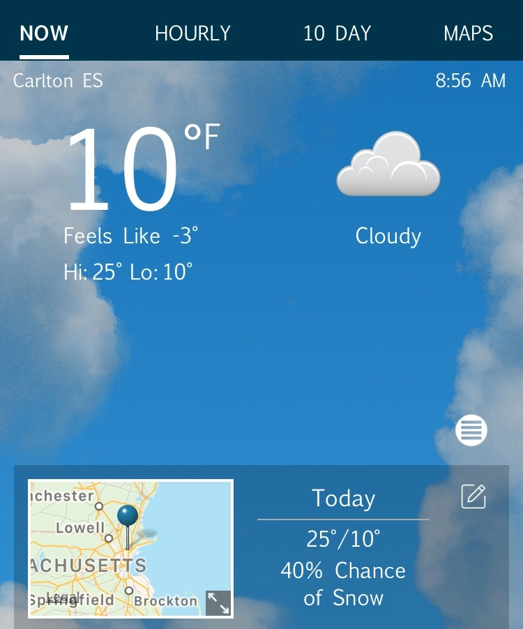

THis is about that time of year I post about it being -5 out and 24” of snow on the ground.
Not today. No snow anywhere, sunny and 70
And a week later.
Snow inbound

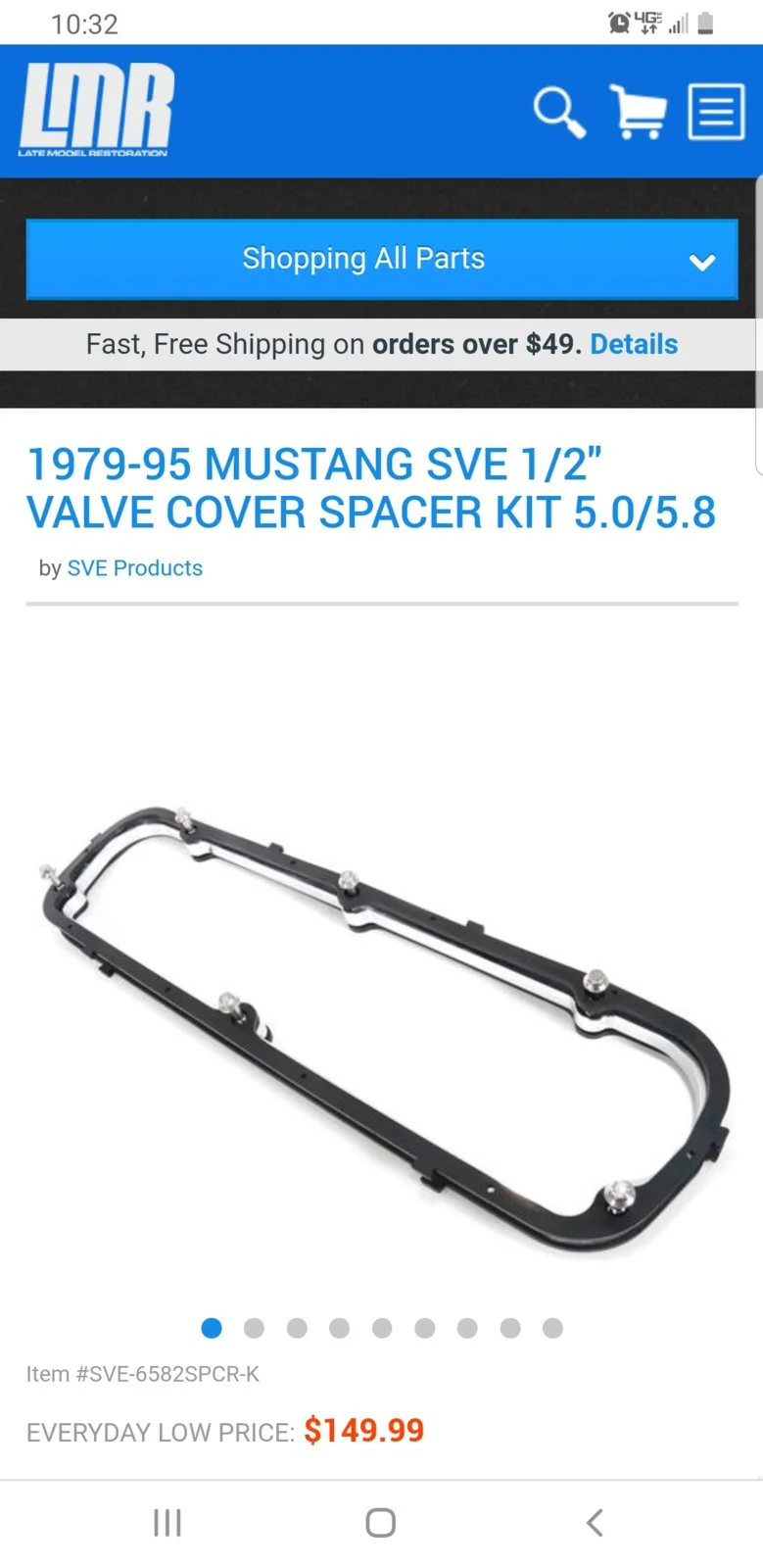

I bought aboit those too, but didn’t like the gaskets on those and the fact I’d need to put a large spacer on the intake. I’m running a 3/8” spacer now and that’s as much as I can go before I am rubbing on the hood.
If I am gonna run a spacer that big anyway, I’d prob sell these and just go with the Proform/Ford racing slant covers.
Got my grinder ready. Can’t tackle it til Monday. I’m confident these will work when I remove one problem boss

Well, consider this....I currently have one stock OEM valve cover bolted down on the drivers side.
So I know once I grind down the offending boss, these will fit fine.

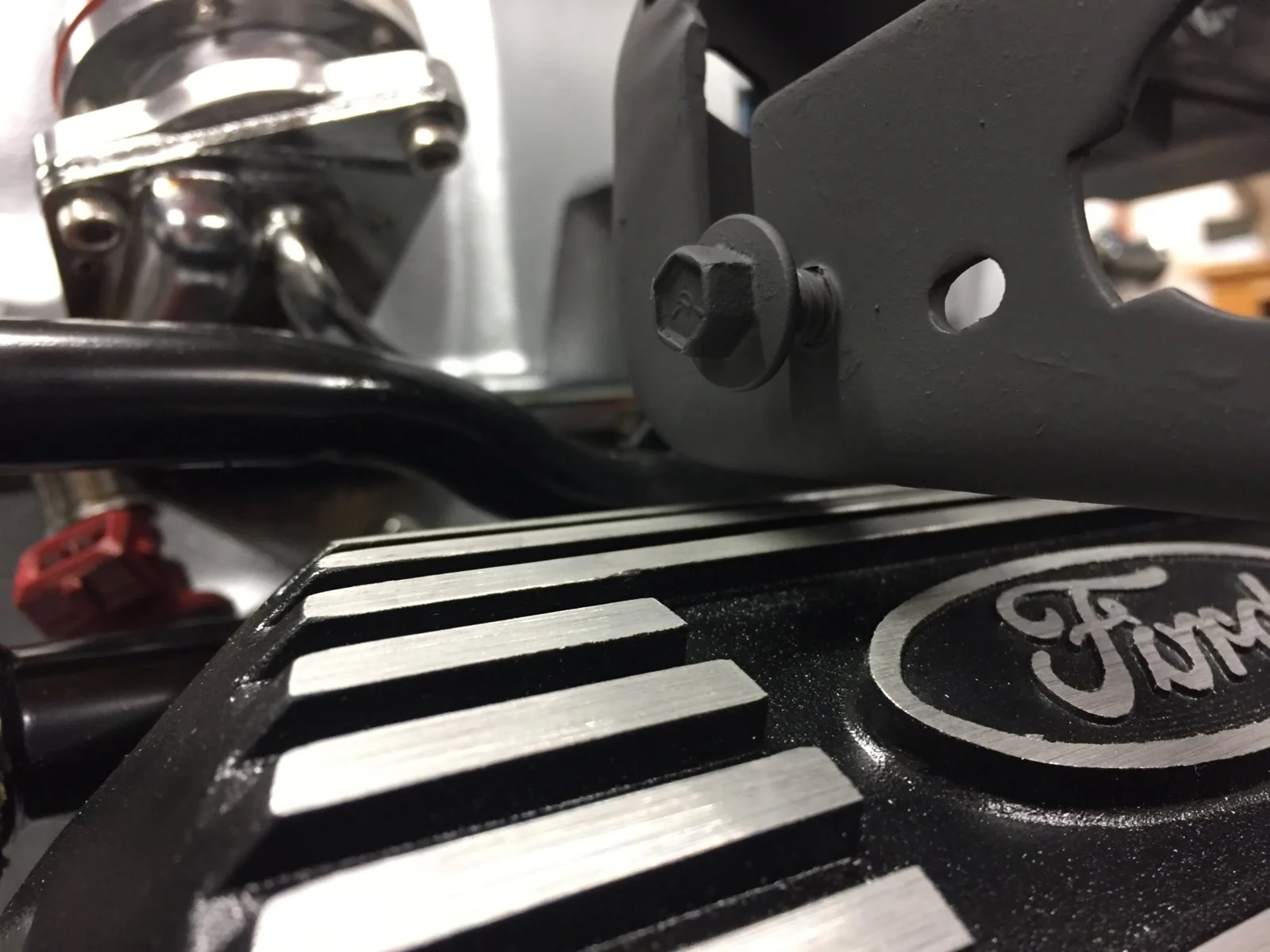

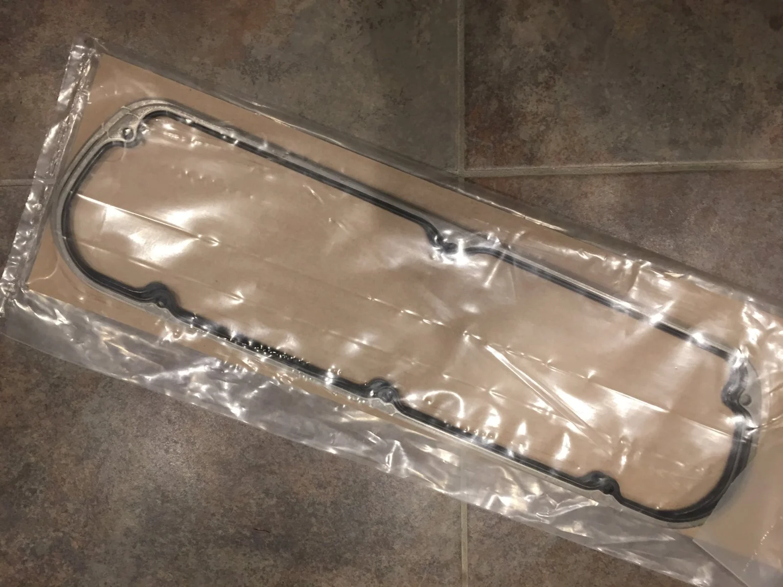

Valve covers on. Only needed to take off 1/4” but i went all the way. No baffles though
Needed a 3/8” spacer to clear them, which I already was using
Btw, I used these gaskets

Anyway, I guess I’m done. Some small details but that will wait until engine drops in.
Some pics of new goodness. Damn thing cost me way too much $$ and time. Hope it runs

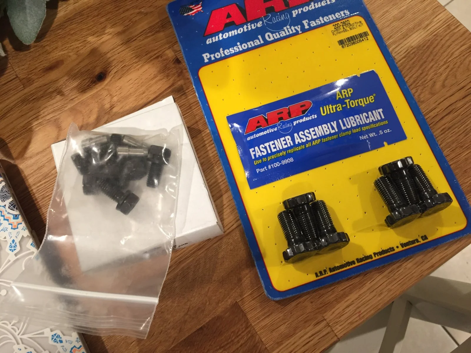

Next up. Drop engine off the stand onto the cradle, tap in the rear Main seal, install the flywheel and clutch and bolt the bellhousing on.
I need to open the trans up too, so you get to see that too. Some small leaks I want to fix. Stay tuned.
Even though only 1k miles since my 5-spd swap, I bought new hardware. Cheap insurance. Using the clutch I had though. Barely used
