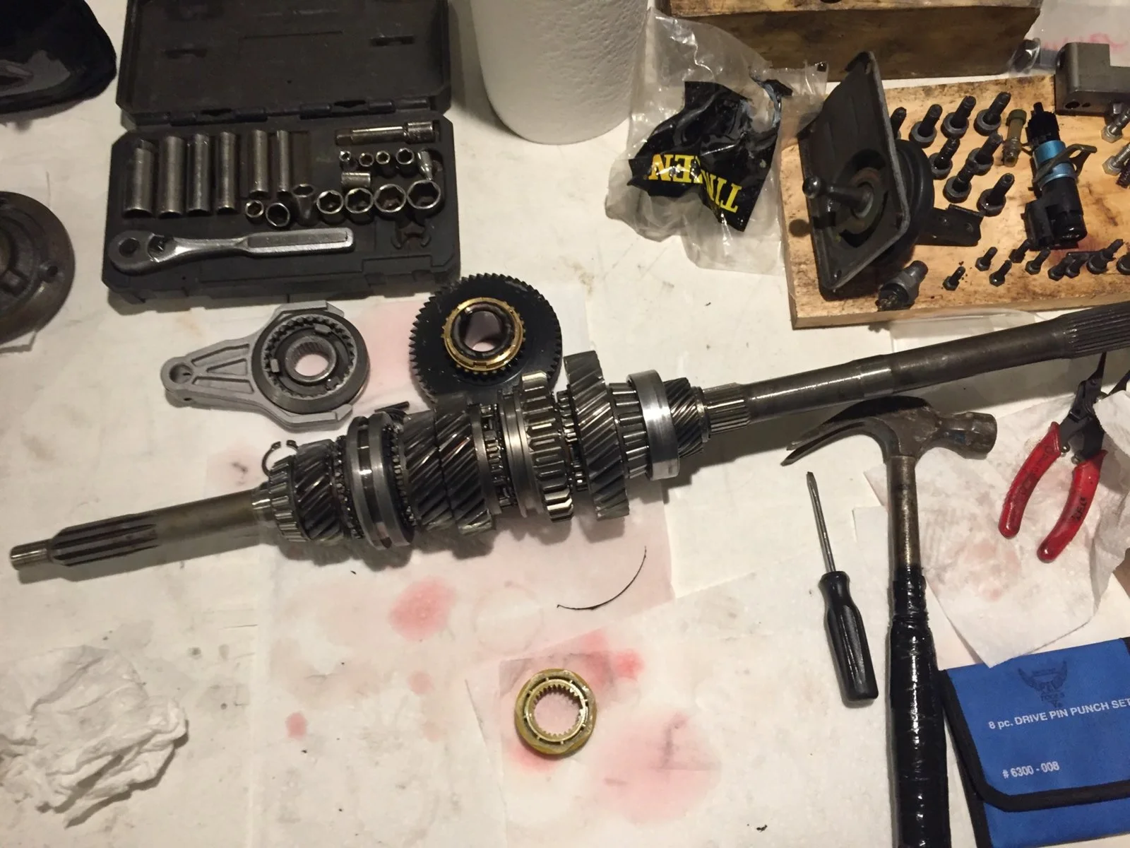

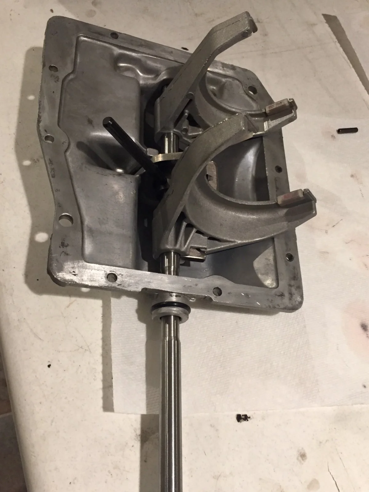

Disassembled the top cover, painted, polished the rod, and putting it back together.

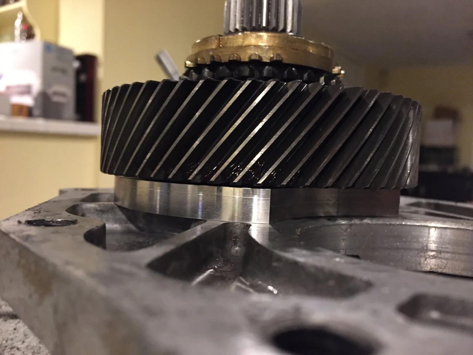

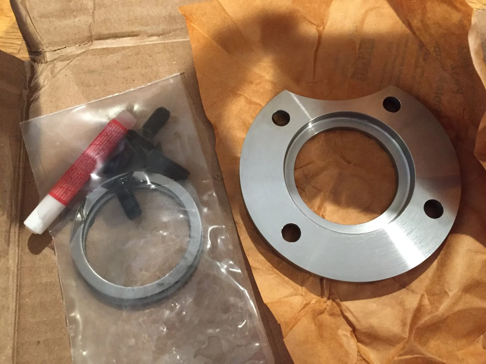

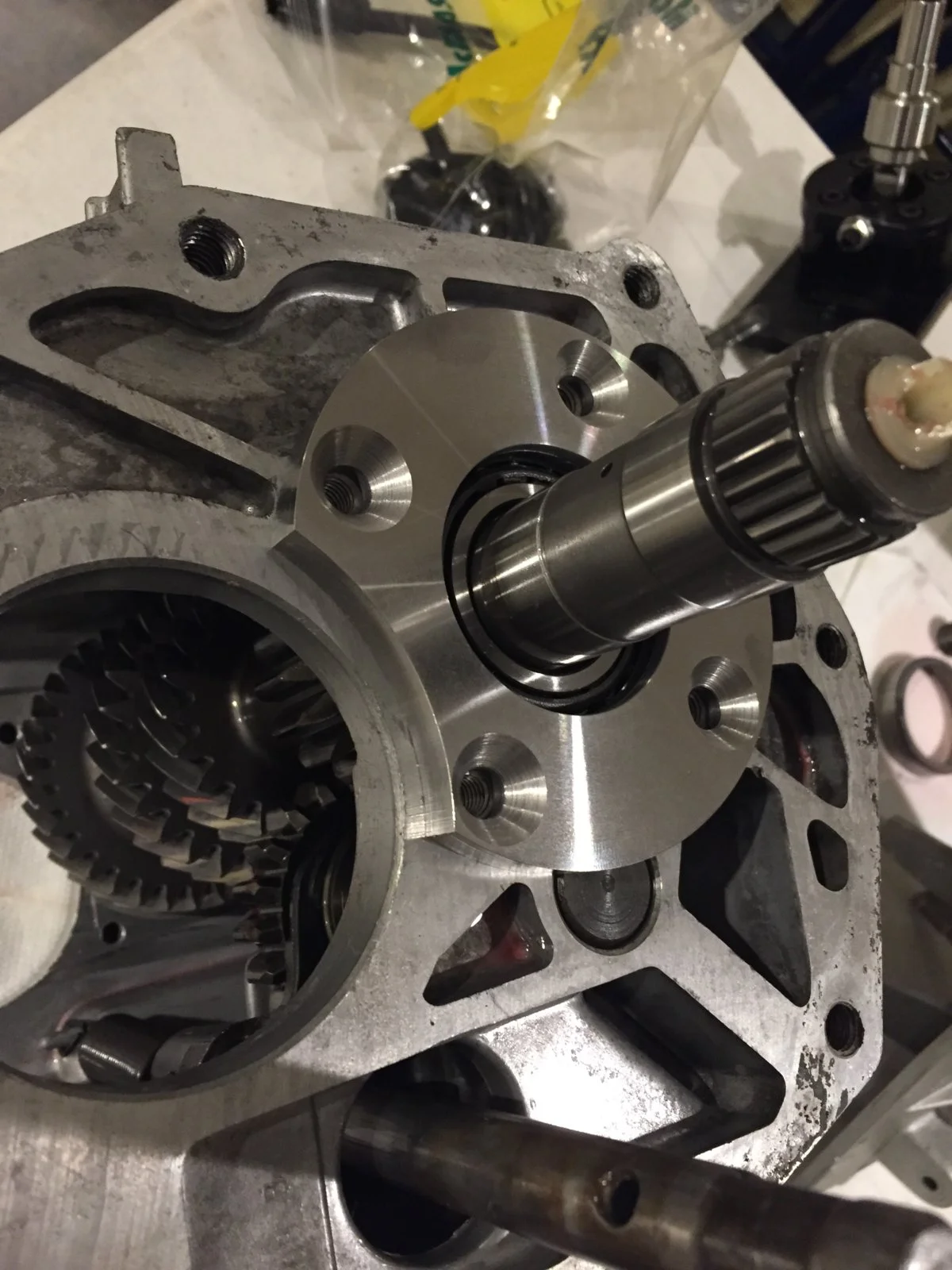

Got my countergear reinforcement plate. Found a little bit more endplay that I wanted there so good thing I pulled this apart.

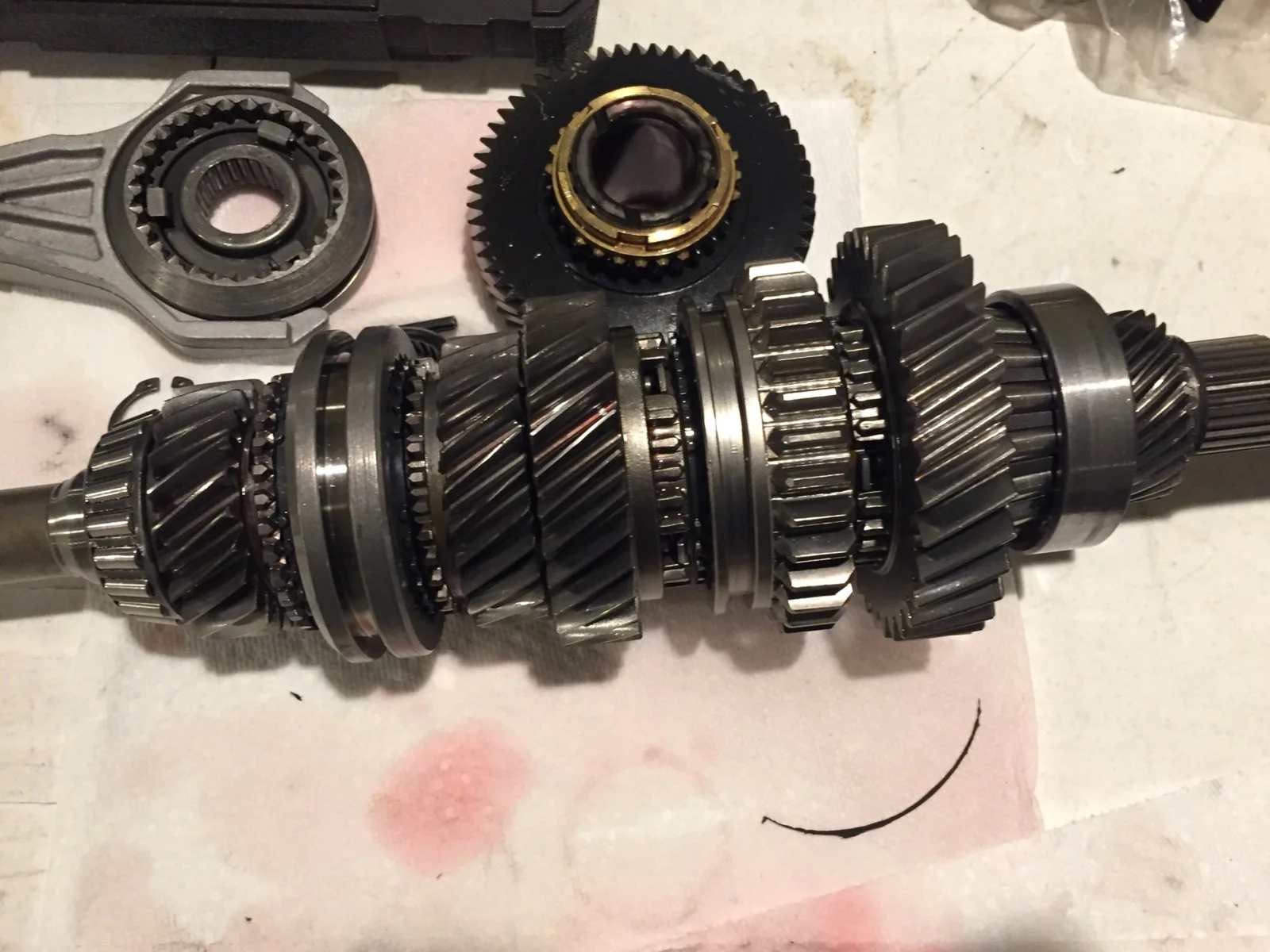

Went through the main stack. No surprises. Everything looks good so no need to replace a thing. I took it partially apart to inspect. Sorry no pics as my hands were fairly greasy.

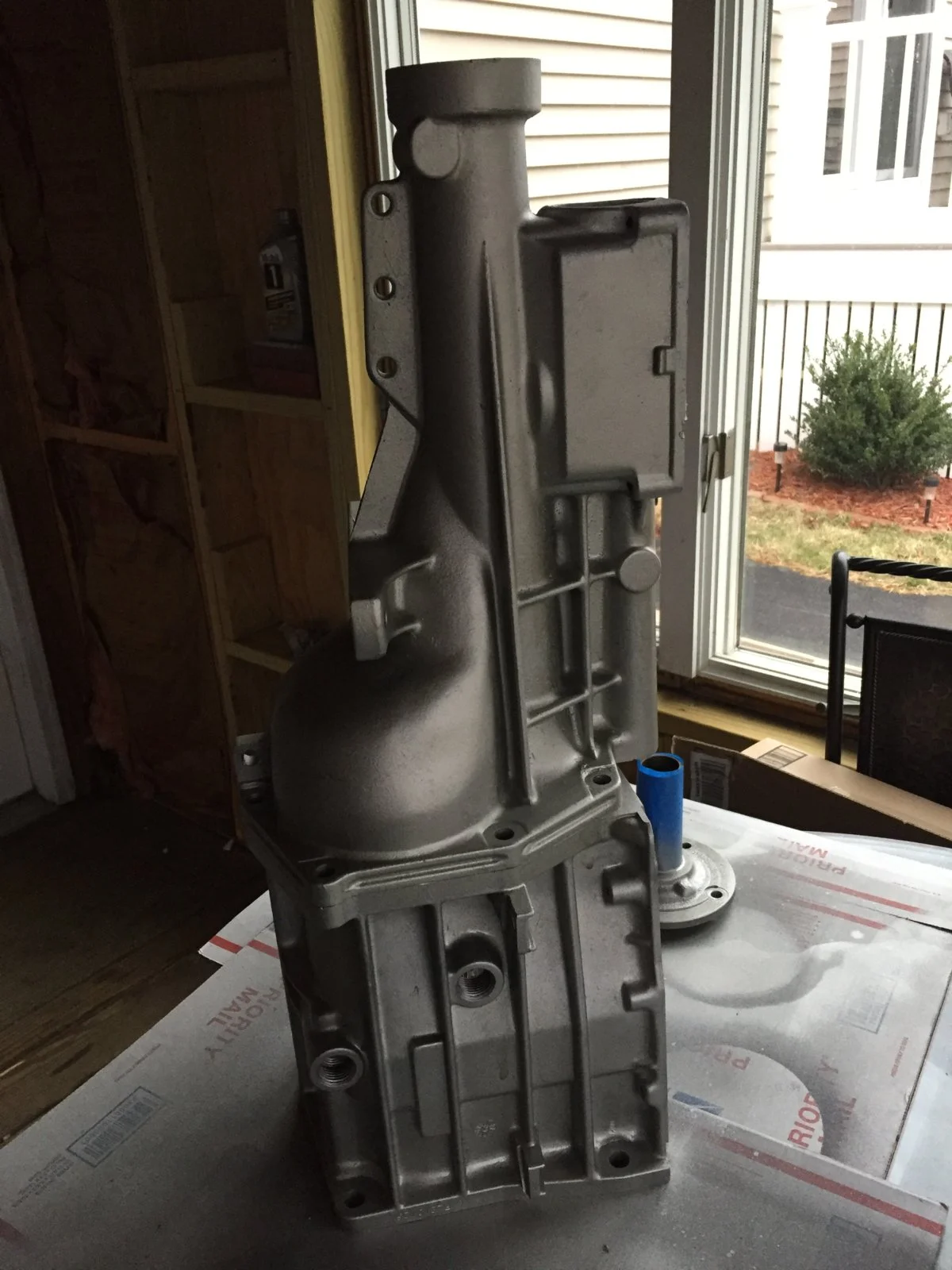

In the middle of painting the main case. Reassembly coming shortly.
Any thoughts about having the case hot tanked and powder coated? My luck with painting parts that see a lot of heat isn't great. Obviously there is a lot higher cost in the powder coating, but I would be pretty confident that it would last forever, too.
Not really worth it. I sandblasted the case last time it was out. Inside is spotless. I just wanted a quick touch up.

That piece is awesome, instilling confidence!
Really nice piece. You can really tell how it reinforces the countergear vs the original support

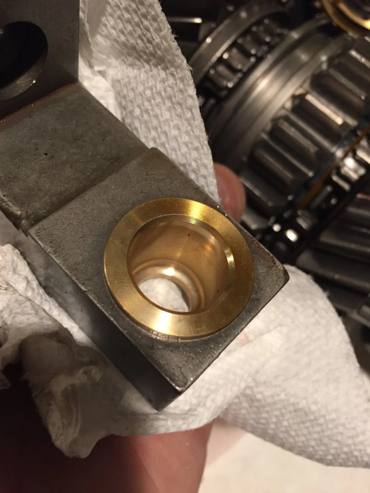

Bought a bronze shifter cup a while back. Finally gonna try it

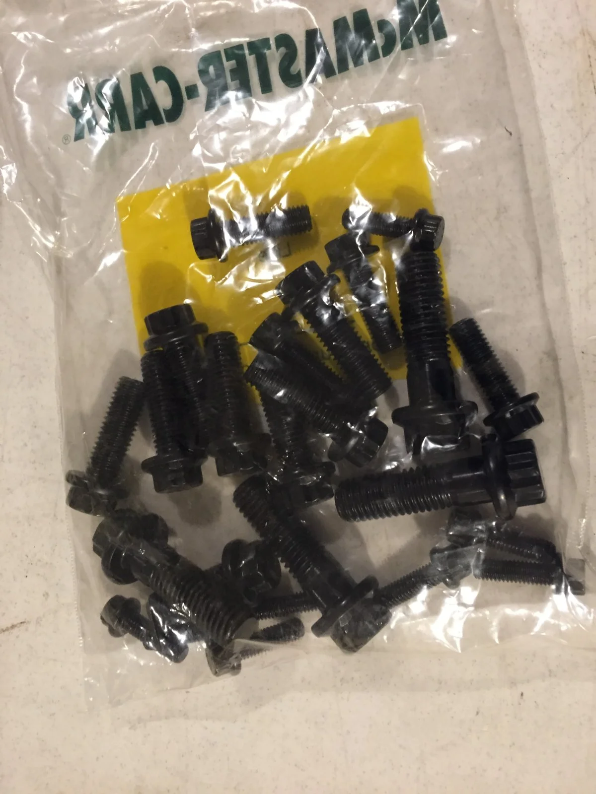

Of course ARP 12pt everything on the case. The original bolts are all rusted and gunked with RTV. I’ll be using anaerobic sealer vs RTV.

just curious if you’ve kept track of what you spent on hardware? I replaced all the bolts when doing my clutch, but never thought of going ARP for that. Kinda wish I would have!

I admire the countersinking on that piece. Very nicely machined.
