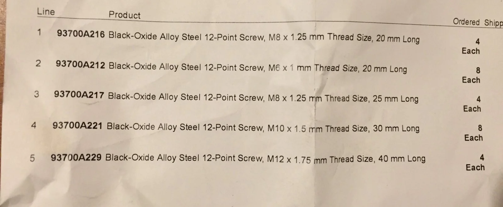

If anyone is curious on the ARP bolts for the T5.
Line 1: input bearing retainer
Line 2: top cover (reuse the dowel bolts)
Line3 : shifter
Line 4: tail extension
Line 5: trans to bellhousinh bolts
I didn’t list the speedo cable/VSS bolt. It’s 1/4-20 x 1/2”’long. 3/4” long should fit too.
Fair warning...not cheap.

Bolt reference thread material right there.

I’ll trade ya your bolt price for the cost of 24 little metal discs about the size of a half dollar, and twice as thick.

I'll stick to the bolts. They were cheaper than your metal disks
