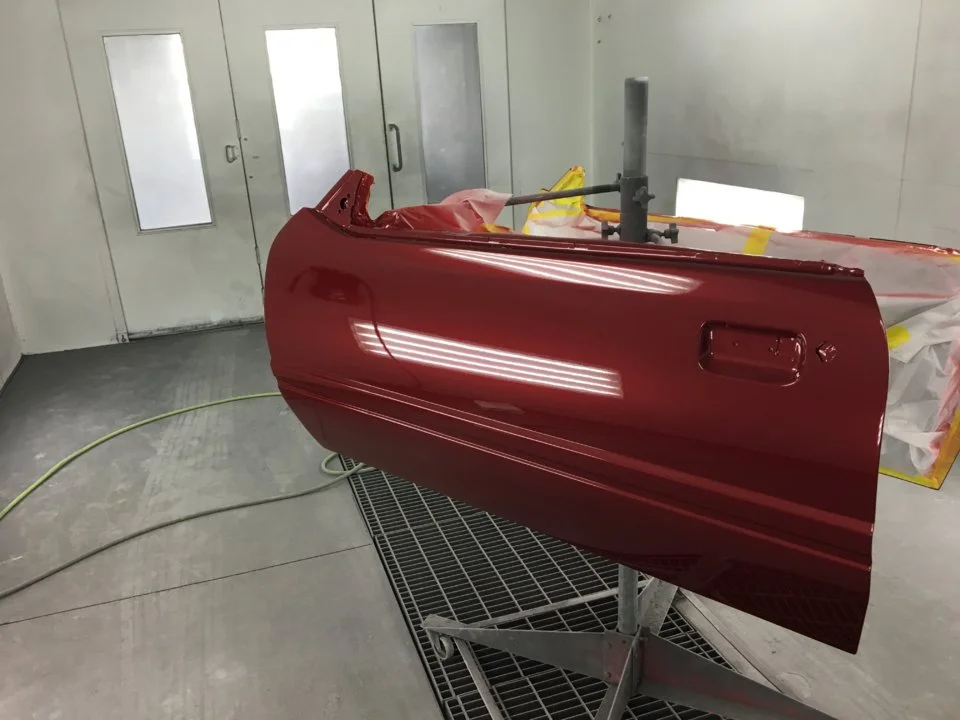

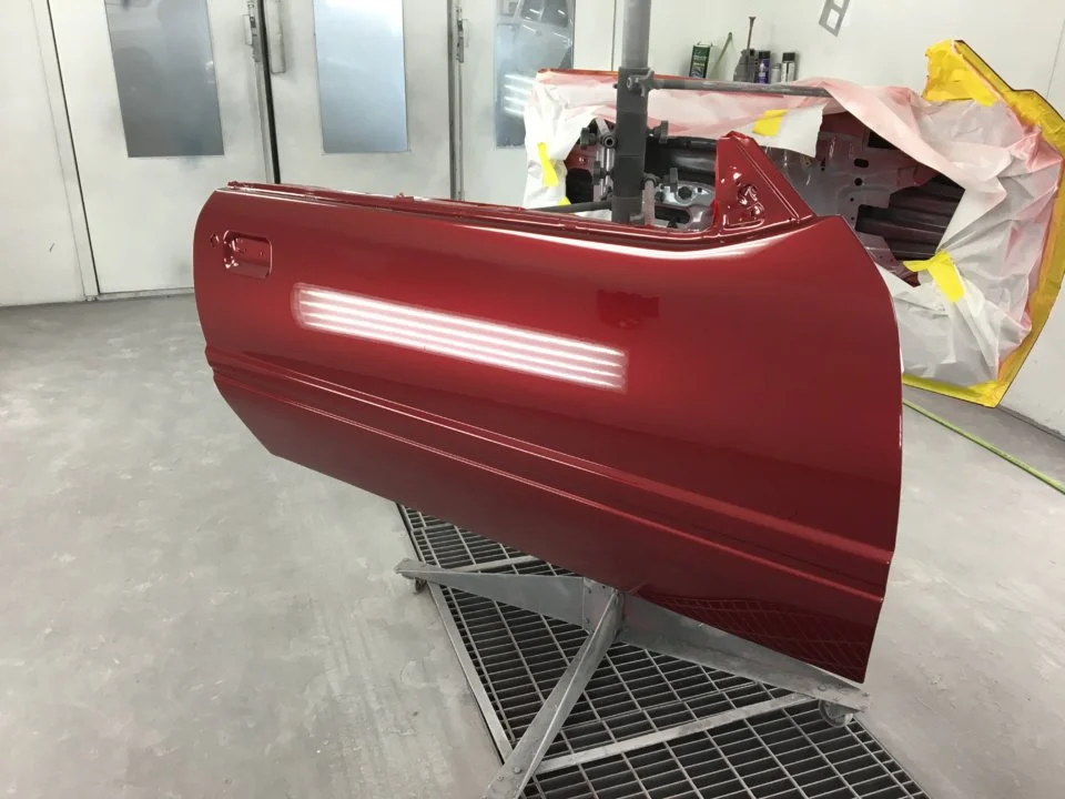

Well....almost got the doors painted today. They are sanded, cleaned and in the paint booth. Everyone with keys had to leave by 6PM tonight, so no go on the painting. Monday morning early though.
If my wife doesn't give me too much trouble, I may do some welding underneath the car this weekend. If I get to, I'll post pictures of my ever improving welding skills and my car's torque box.
Anyone got experience with UPR's shipping procedures? I hope I get the reinforcements soon.

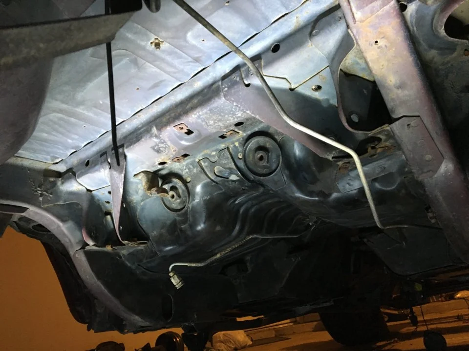

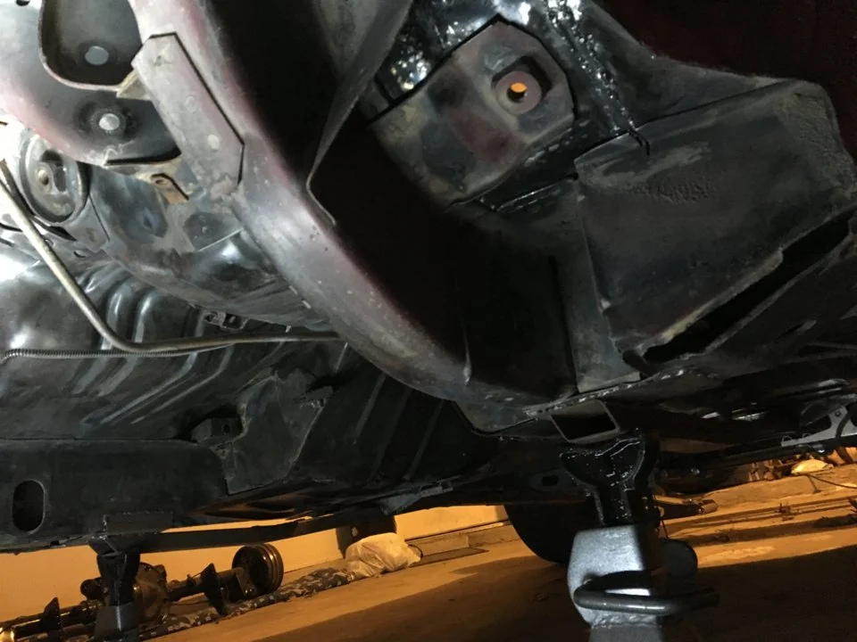

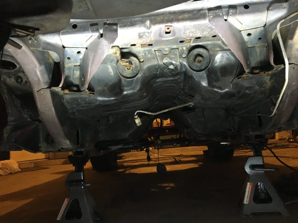

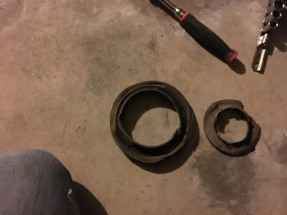

Well, today was a decent day for Doby (Dirty Old B***h). I dropped the rear end out and took off the control arms.
I spent the next two hours cleaning the whole back end underneath side, my car is called Doby for a reason. I scrubbed with brushes and scotchbrites and then took a bucket of hot soapy water and started washing the underneath side.
Lots and lots of red Oklahoma dirt. I displaced at least four more mud dauber nests and several spider nests.
I had to stop twice to sweep the floor out so my creeper would keep rolling, jeez, a car wash before tear down might have been a smart thing, huh?
So, anyhow, here are pictures, how about those spring isolators?! I've ordered new prothane ones.
I'll be pulling out the old fuel and brake lines this week, you'll see the old ones in the photo.
I'm almost considering painting up to the transmission/driveshaft tunnel the same red as the outside. I'm trying to decide if the smell of the paint will offend my neighbors a bunch or not. I'll need to do it before I put the differential back in. Hummmmm.......
So now I just need to wait for the UPR reinforcement kit to get here and I will weld them in.

Sweet progress man. Por 15 or roll on bed liner would hold up a whole lot better under there ->just my opinion, not stating as a 100% true fact lol.

I agree with you, and I will probably be going that route. Maybe a little red over the undercoating? I can't do anything until I get the torque box plates in anyhow. Give my brain time to remember this isn't going to be a garage queen, it's Doby.

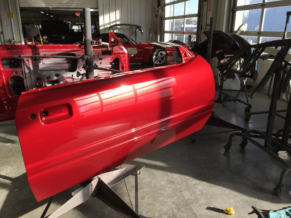

Here's my pretty doors all shiny:

Something to think about.. I welded in maximum motorsports full length subframe conntectors and the paint was a real pain to deal with. Getting it cleaned up enough for a good weld, I mean. I spent a long time with a grinder and a wire wheel cussing under the car. If you plan on installing those, don't paint the mounting points until after they're in... Then paint the welded area.. My .02.
Already got them welded on.

damn, you can paint. Frikkin amazing Dave.
wish you were closer. I'd have you paint my trunk and wing.

Thanks man, like I said before, Speis Hecker can make an average guy look good. But I appreciate the thought.
