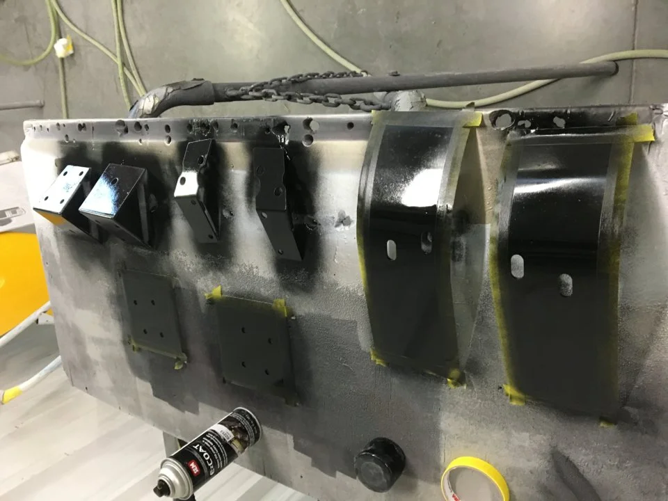

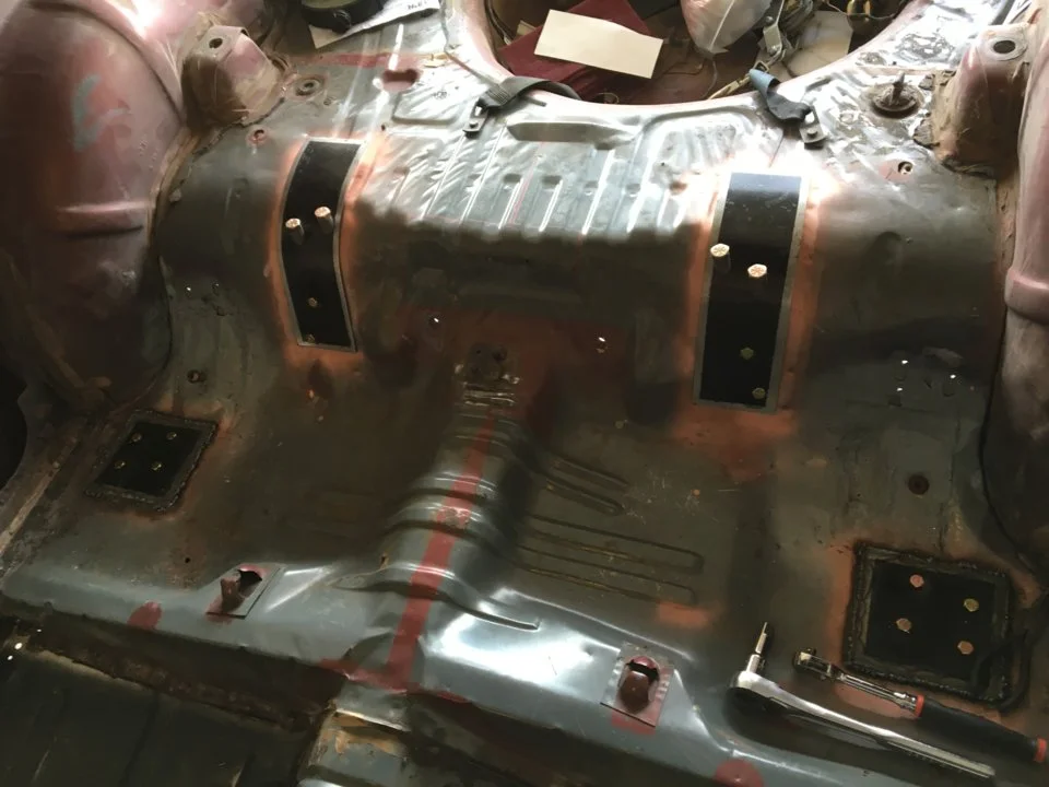

Got my battle box plates in, spraying them with some etch black at work first. Gonna try to put in one side tonight. It's cold here though....mid 40's.:cry:

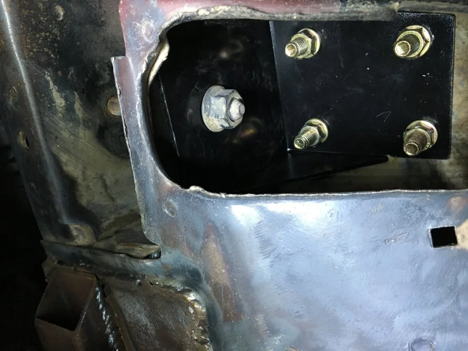

Okie dokie, got the lowers put in. I wanted to do the uppers as well, but failed to note that I do not have a 1/2" drill bit at home, nor a 1/2" drill to put it in. So I couldn't drill the holes for the upper. Uhhh...duh.:doh:

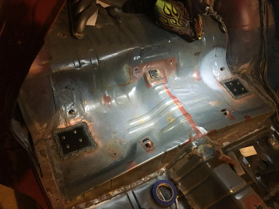

So here's the latest photo, my welds are getting better, though you couldn't tell from this photo!
I have a good excuses for their appearance though:
1. The floor is a bit buckled from beating the hell out of the wheel well to make sure my 285's will fit. Tough to weld an uneven surface for me.
2. There was a considerable amount of pitting in the area that didn't need a patch but make the weld sputter like a pig.
3. I suck at welding! I'm a painter for god's sake!!!! I am getting better though and am enjoying the learning process, just need a few more customer vehicles to refine the process:eek:.
4. HEY, the welds are solid so just back off!
BTW, I know it's been mentioned before, use weld through primer. Our shop uses U-Pol #2, good stuff, I highly recommend it.
I've ordered new emergency brake cables, spring isolators and the brake lines (stainless). Watch for later installs on this stuff.
Next things will be the upper battle box, seam sealing, cleaning up the interior for paint and coating the undercarriage (POR 15).

I was going to work on my car more tonight, weld in the upper battle box. My wife was supposed to be working late, so I had the perfect opportunity. Well.....she didn't, so I didn't.
Crap, I was wondering why my welds looked like popcorn, I was out of argon on my welder. Sometimes I wonder if I might have been dropped on my head when I was an infant. Could have been that "self prescribed medication" back in the eighties as well.
Oh well, the lowers are ugly, but solid.

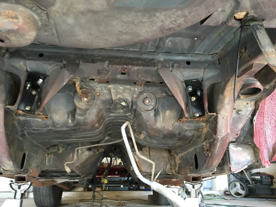

Got the uppers installed today with the help of my son. They were considerably tougher than the lowers.
They would be real tough to do with the rear end in there, glad I did it now.
I'll weld them in later, got to go get groceries now, my kids are giving me the stink eyeo_O.
I've ordered enough POR 15 to take care of the rear area. I need to weld the torque box perimeters first.

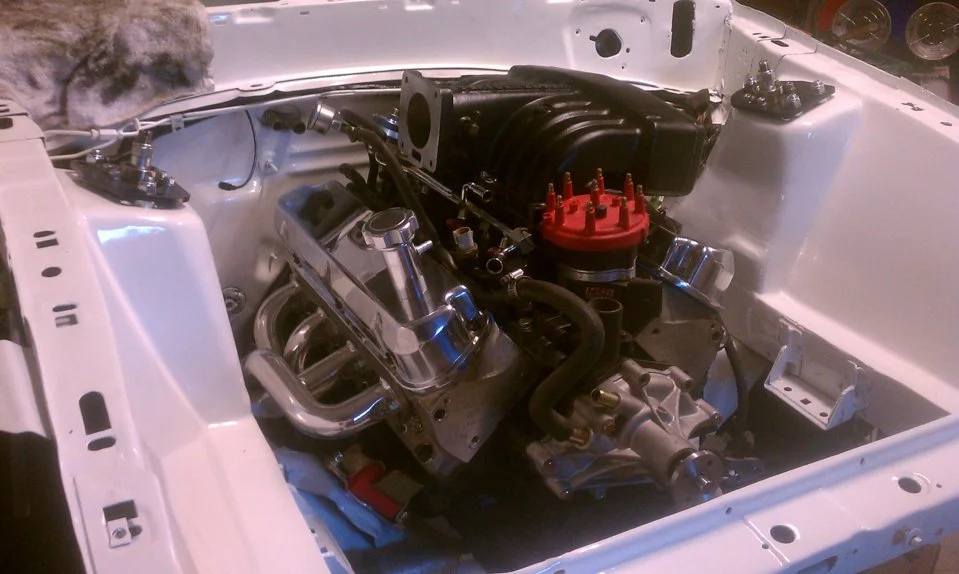

Help me....I'm thinking of smoothing the engine bay.....dear god, I have a problem....
What would you do?
do yourself a favor. Buy the scott rod weld in panels fender panels unless you enjoy welding about 100 holes in Just trim them up, weld or use panel ashesiive to secure them, filler, prime and paint.
@FoxMustangLvr could probably offer some advice as well to your smoothing dilemma , pretty sure I remember him doing it awhile back lol
I can't say I'm committed to it yet. I was thinking of just doing it from the shock towers forward. I'm crazy enough to end up doing it though. A smooth bay just looks so nice
What would you do?
Do it!!! Nothing looks sexier than a smoothed and tucked bay.

Nothing sexier than a smooth and tucked engine bay. This is from my previous car.
