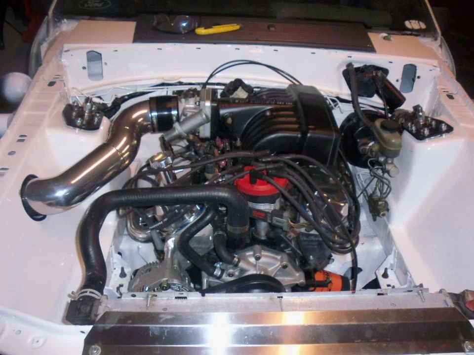

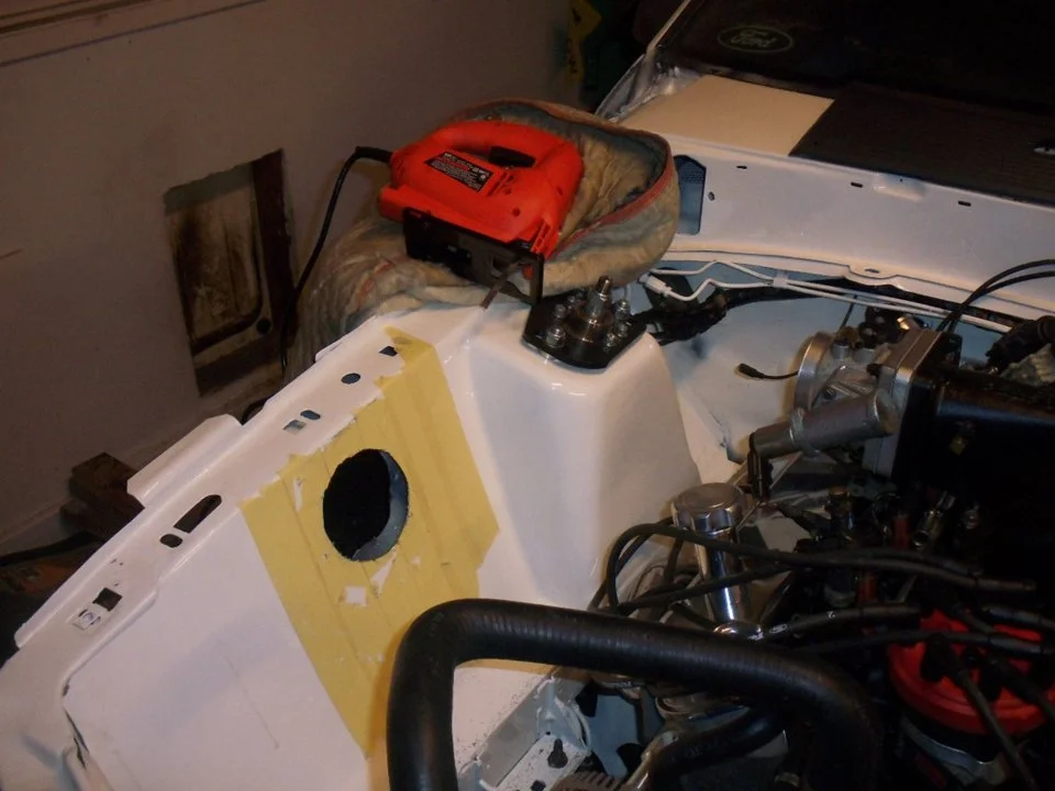

I've got a question for you engine bay smoothers. I was talking to one of the body men at work today about smoothing the engine bay, he said that I might want to use seam sealer to smooth out the welds along the shock tower due to flex from body twist on more aggressive launches. He says he has seen cracking along that seam. While there is some logic in my mind concerning this idea, have any of you had an issue with just using bondo to smooth the seam?
Looks like you're off to a good start with the engine bay smoothing. After I got the panels and holes welded up I used grinder over most of my seam welds to get them nice and low. I then used Evercoat Metal 2 Metal which is very workable and strong along all seams and holes that had any deviations in them. This stuff sands nicely too! After that was some light bondo then Etch primer. I'm sure you know how the rest goes.
Check out this page in my build thread,

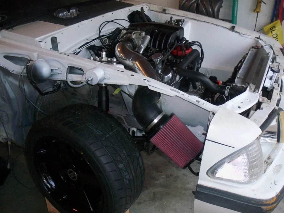

One more thing as your doing your panels. Have you thought about what intake setup you'll be using? If you can mock up the intake now and cut your hole for a true cold air intake now would be the time to do it before you paint the engine bay. I went with the AFM 3.5" naturally aspirated power pipe. You can mount your MAF in the fender well (you'll likely need to extend the MAF wires).
I didn't have a MAF for this car since my aftermarket ECU was speed density and doesn't require one. Some food for thought for you, good luck!
Jeez that's a pretty engine bay!
http://www.stangnet.com/mustang-for...had-to-do-it-90-lx-hatch-thread.878656/page-4
Thanks man, I'm eager to get back on it.
Too nice of weather here to pass up the chance to finally seam seal the inside and POR the undercarriage. I'll be back on the engine bay next week. I'll post some of my seam sealing stuff because I am finding under the original seam sealer that seems perfectly fine quite a bit of rust!
+1 to the evercoat.
