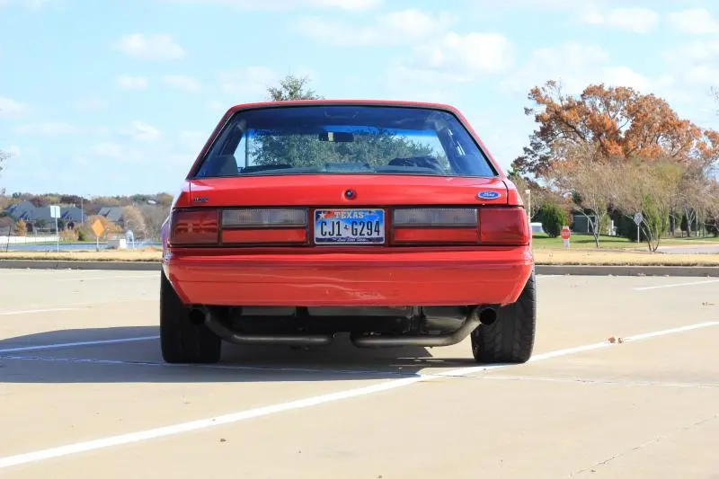

One more thing, I think 275's fill out a fox pretty dang well and proportionately too. Here's a nice view of @bird_dog0347 coupe with 275's

I really like your car, and I have big respect for the irs swaps. How did you get that much tire in there, I thought Scott @RacEoHolic330 had to go smaller?
Say what you will,..all you wheel tub restricted mustangers with your girly man 275's.....Nothing says " I gotta pair" quite like a set of 315's.
Whew,....I could barely get the tire in the whole picture.:doh:
