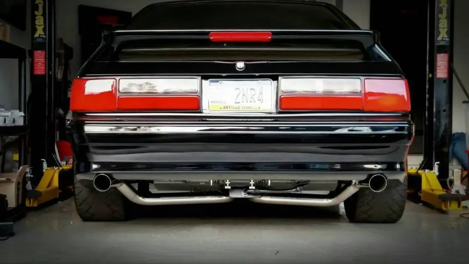

Say what you will,..all you wheel tub restricted mustangers with your girly man 275's.....Nothing says " I gotta pair" quite like a set of 315's.
Whew,....I could barely get the tire in the whole picture.
I've got a set of little 275's back there as well.

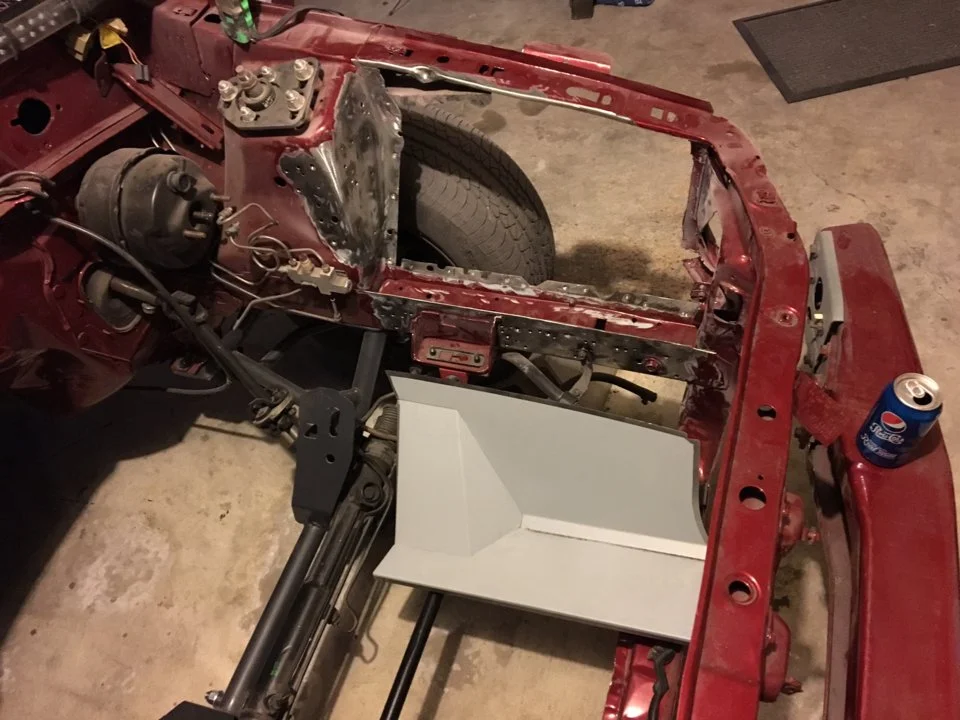

Okay, got the panel trimmed. I'll have to push it around as I tack it on the car to make the frame rail look "straight" as I can.

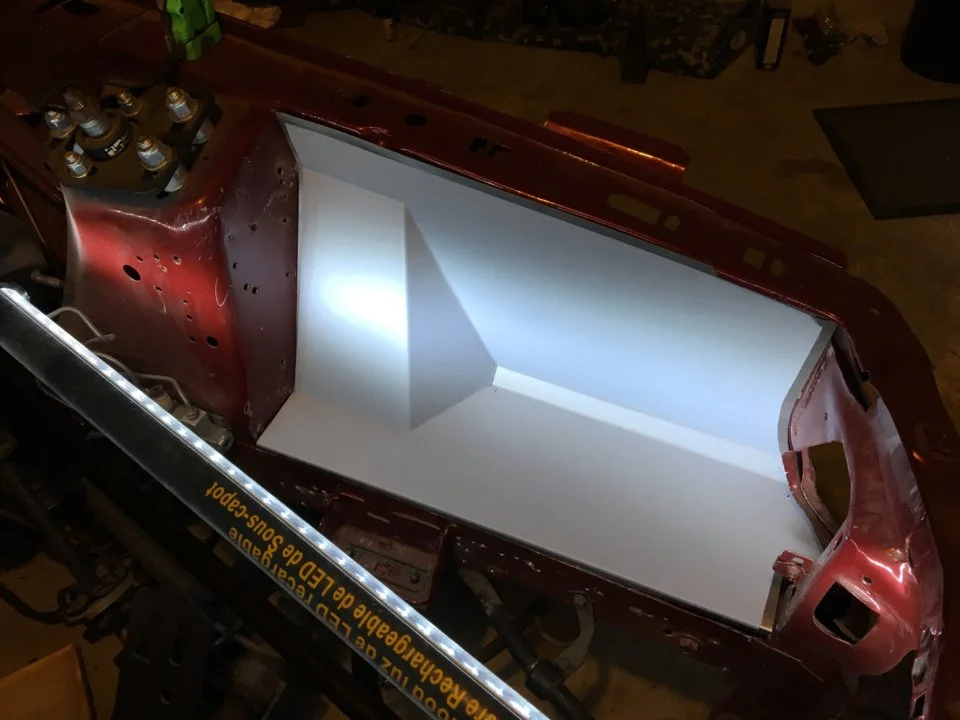

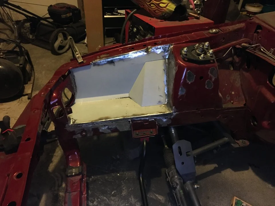

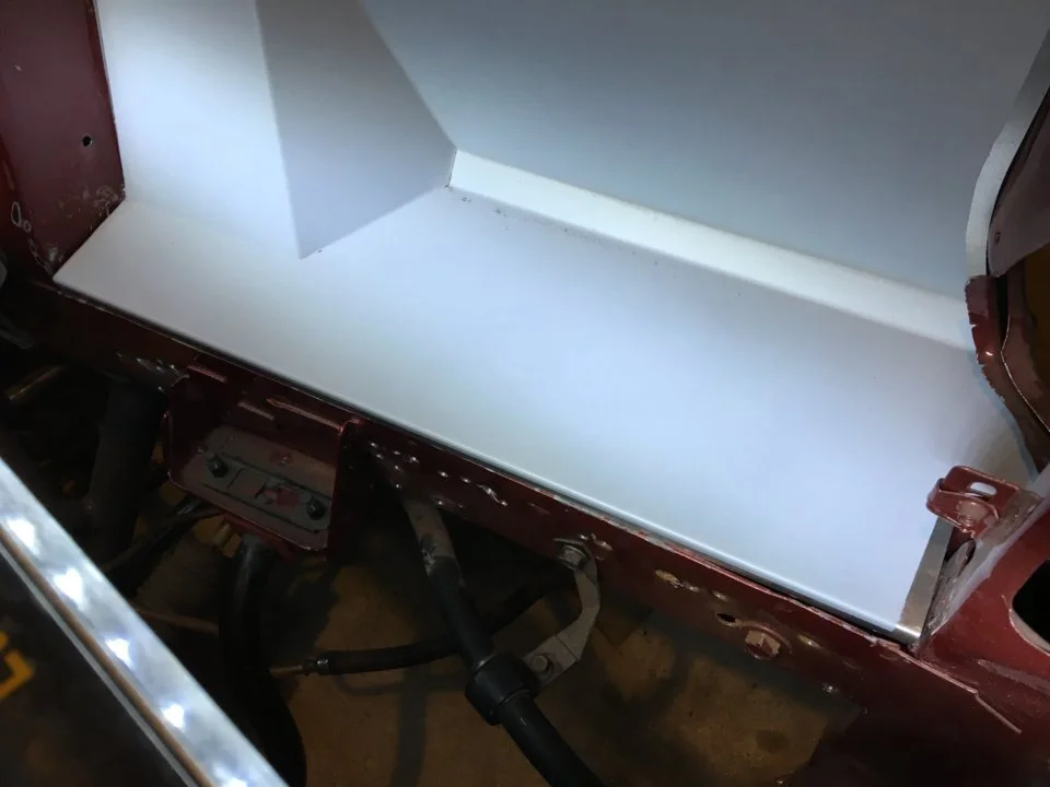

Ok, got the left panel all fitted. Cut out all the old stuff and ground around where I'll weld.
You'll notice I got the brake master cylinder out as well. I am going to put a semi gloss POR 15 on it, that should match the semi gloss black that we painted the block.
