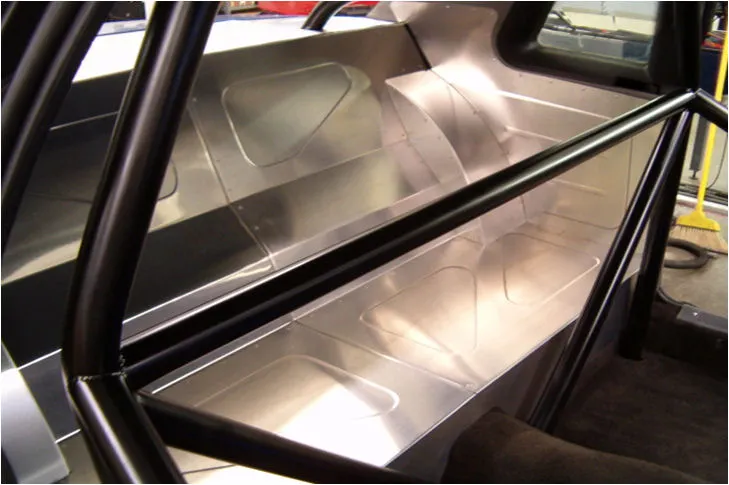

RaggedGT said:
Scotrod has the answer to your seat, interior issue- look how cool that is
I can hear the metal resonating from here . YIKES .
That's what Sound Deadining/insulation is for my internet Forumn friend

Street car? Then no to that "metal work interior". Insulation/sound deading isn't going to be enough for my tastes. Like toolow91 stated above...it's going to resonate/increase the db's,vibrate,etc more than I would want to listen to on a 50 mile cruise. That's just my thoughts and opinion.
And as far as the tub job goes...out of league. I've never done it. I havent ever really looked into it either, other than the few postings I've seen on here and on the corral. Personally I wouldn't do it for a 90% street car that would see plenty of twists and turns. Straightline performance and "easy" street miles it would be great. Relocating the springs,frame notching,interior reconfiguring,and the other "issues" is more than I've done. I'm a "bolt it in/on" guy and that's about it lol. But those wheel/tire combos will look sick! I absolutely love that look.
Lol
My car has Enough resonance as it is with all the factory stuff in it still . That looks like a big headache on a streeter .
I would agree on the metal interior panels, they look cool, but...I don't think so.
I think I'm channeling @madmike1157 with the fabrication thing. It would almost seem fun to me to try the 335's.

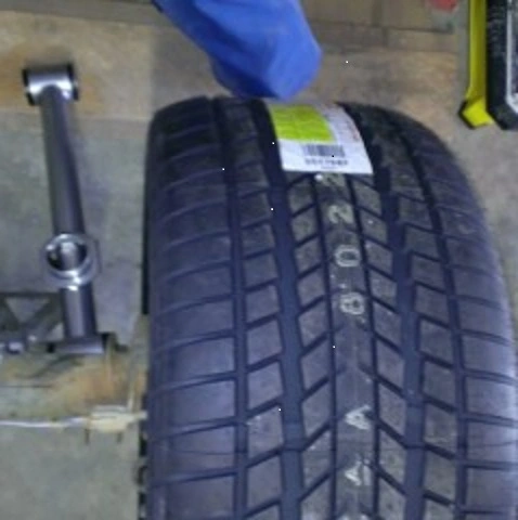

Thinking about 335's, how about the control arms? This might be my stopping point on this idea.
I'm going to do some measuring tonight to see what I have there for clearance. Even with aftermarket tube ca's with no spring perch, I'm not sure it would fit.

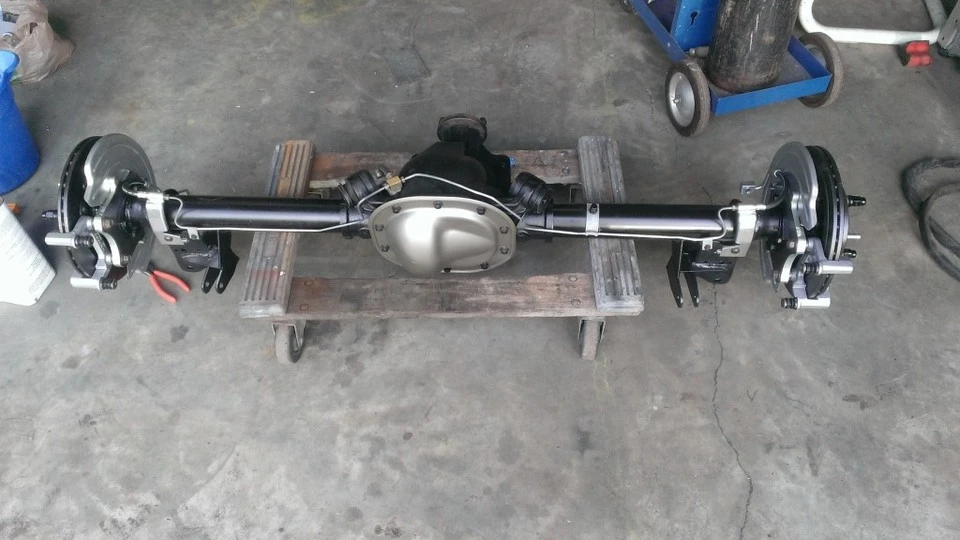

Relocating the torque box would be beyond even my crazy speculation.
I have to stop looking at that Viper we have in the shop! Jeez!
This is what I do when I read your posts.
I have thousands of pictures. Everytime you, or somebody else brings up something I was already thinking, I start looking for the pic to illustrate my point.
I wondered the same thing about the LCA with regard to tire contact if you continue the quest for a larger tire. The ability of the wheel tub to actually accommodate the tire is the lesser of the two evils. What you are going to have to do, and sacrifice with regard to possible suspension contact, and how bad you're gonna have to hack up the rear seat is another.
This is what the rear looks like after it was completely modified and the rear C/O mounts fabricated with the stand off that was needed to accomodate the 1.25" inboard straight up mounting.
Before it got to that, and right after narrowing, bolted a tire up to the axle flange.
There looks to be plenty of room,...except.
Your rear has been narrowed an additional 1.750". ( I think you said 2.5" on EACH SIDE, this represents a 1"-1.250" cut)
This is a 10.5" wheel with a 315 mounted. I'm not sure of the B/Sing, it is probably around 6.5, but it's what ever the stock SN95 BS is, as they are OTS replacements.
If I did read correctly, and you have narrowed the rear that much, You are gonna have to go with a custom BS wheel to push the thing positive. (something like a 4-4.5 BS on a 10.5-11" wide wheel)

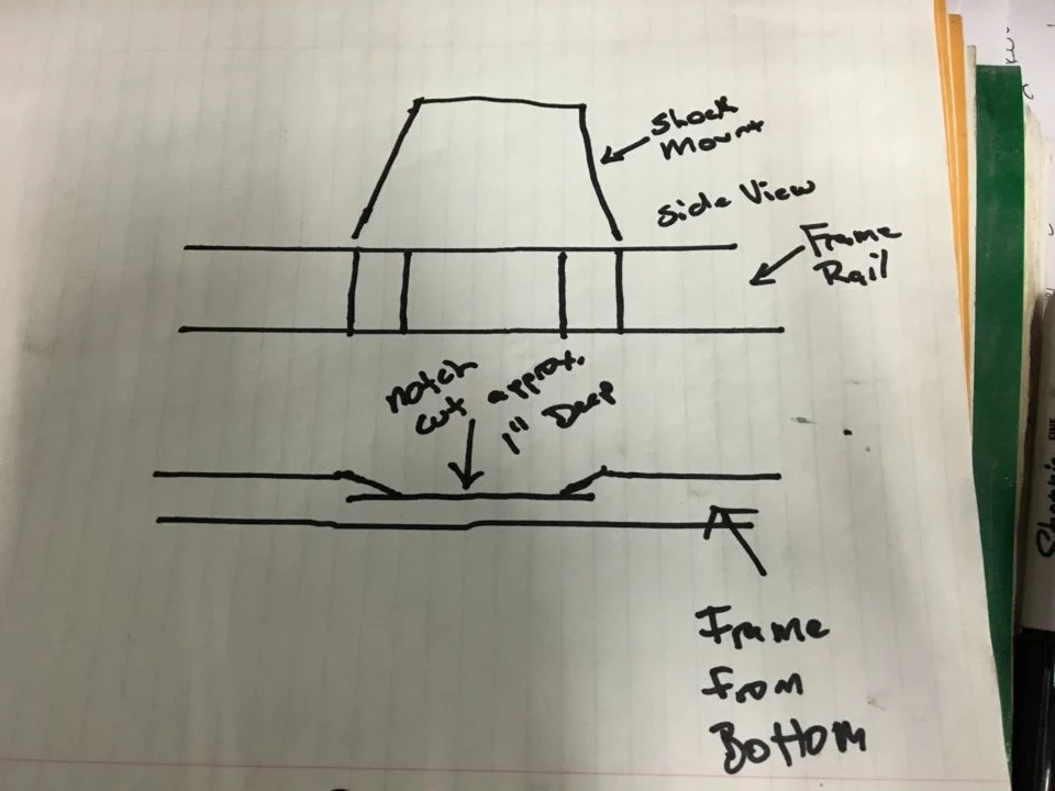

I believe I will need to notch the frame even for the 1.25" tubbing. The back of the shock mount is exactly one inch from the frame. I want to insure adequate clearance for the coil overs.
Here's my high tech drawing of what I was thinking to notch the frame.
I will of course put reinforcement plates around the outside of the rail as well.
What do you think? Why did you choose to use that pipe for yours? Is it stronger structurally than something like this.
This idea comes from the frame notching I have seen on lowered pick ups.
You all make very valid points, and I'm sure you are correct. But you have to admit it's cool looking... Lol
The tubing I had was .125 wall stuff I had laying around. I added additional plates to the front, back, and bottom to add strength back.
What you have looks like it'll work, and yes if you want to you can duplicate that pattern and make the inside follow the outside cut out.
