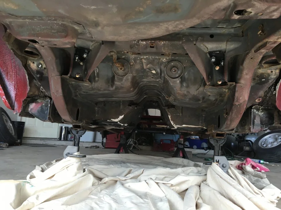

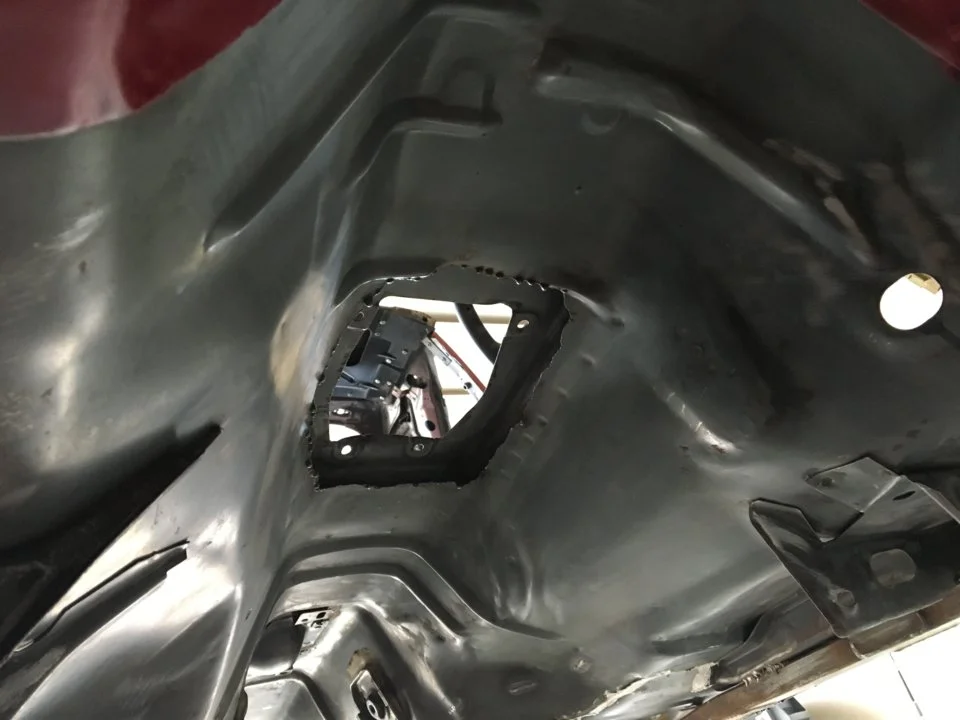

Alarm went of at 3:30, I got out of bed at 5:30. Oh well, late start.
While I was laying underneath the car yesterday looking around the trans tunnel, I noticed how much gap had been left when I got the rear floor pans welded in. I think I'm seam sealing underneath, as well as in the interior.
Big day today, I'm finally going to coat the undercarriage!
That is a big deal since I'll be able to hook the rear end back up afterwards! Doby will be on four wheels again soon (I have to let the POR 15 dry for a day or two first).
Big deal, you say? Yes! that means within a week I will start prepping the body for paint! Yay for Dave!
Busy week coming up for Doby. I will also glaze the engine bay and primer it this week.
I'm going to take my grinder with a knotted wire wheel on it to work on removing the undercoating in the rear wheel tubs. I remember @madmike1157 saying this was a bit of a bit*h. What worked for you Mike? I figured I would do this while it's still attached to the car, more support.

Mine is undercoated too, has been a pita dealing with it in the front fenders. I've found a wire wheel in my cordless drill works OK, if a bit slow. I tried a knotted wheel in my grinder, but gave up on that after this happened:

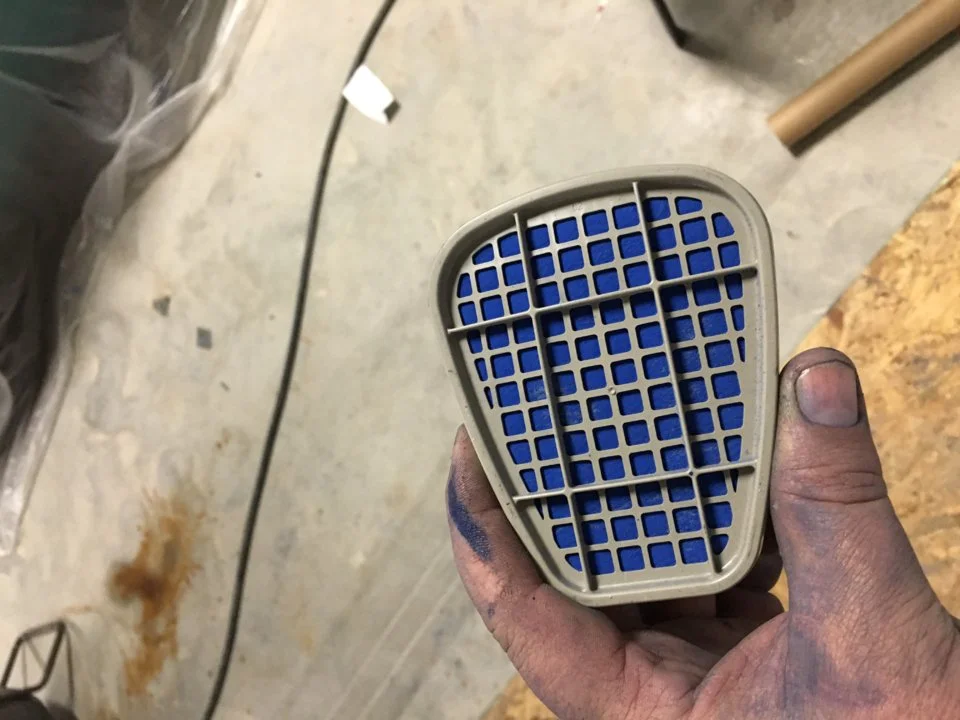

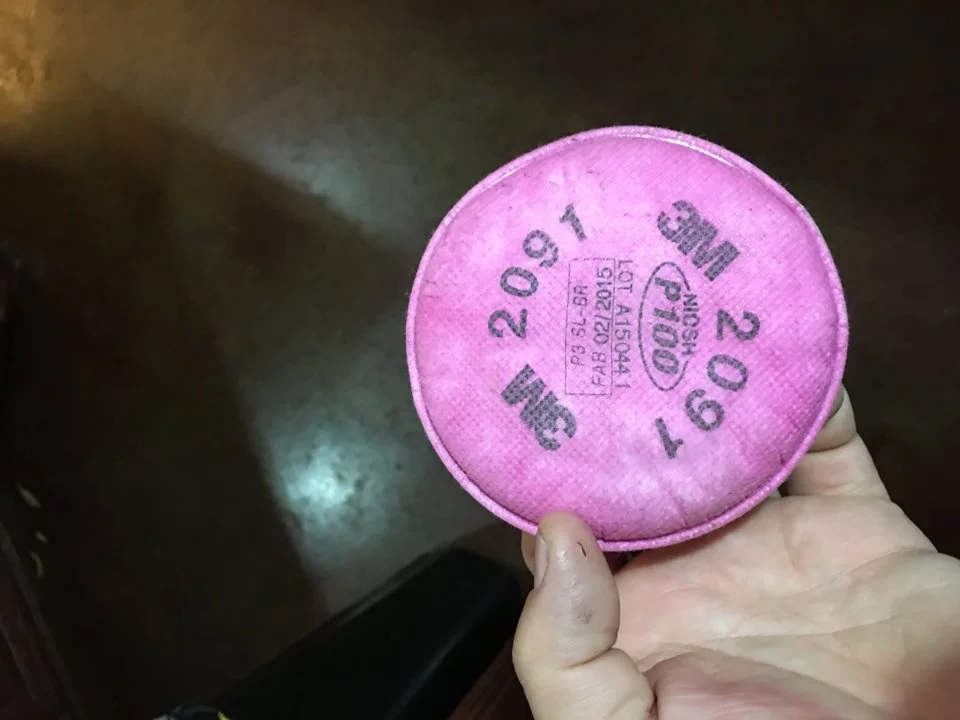

As far as respirators, (I get training at work because I have to use them) you need to know what you are trying to filter, be it particulate, vapor or both.
These are hepa filters. They do particles like sanding dust:
They don't stop isocyanates. Isocyanates. *tick*
You have to use an organic vapor cartridge for that:
This is one i loaded with blue paint. I should have used the attachment to stack the hepa on top of the ovc, but, *tick* I didn't. It still worked really well, though seriously. I couldn't smell any chemical at all while spraying. I did have to change cartridges halfway thru the job because they became obstructed.. But that was because the air in my booth was pretty saturated with paint, haha.

Looks like the filters weren't the only thing saturated with blue paint......Just one quick word of advice.
Glovies

Funny thing about that. We get to take safety gear home with us from work- their motto is,"Take safety home with you. " Cool. I got hooded tyvek suits. Respirators, and latex gloves. Got ready to spray... Left the gloves in my locker at the plant.

Got the undercarriage sanded and cleaned, getting ready to roll on the POR15.

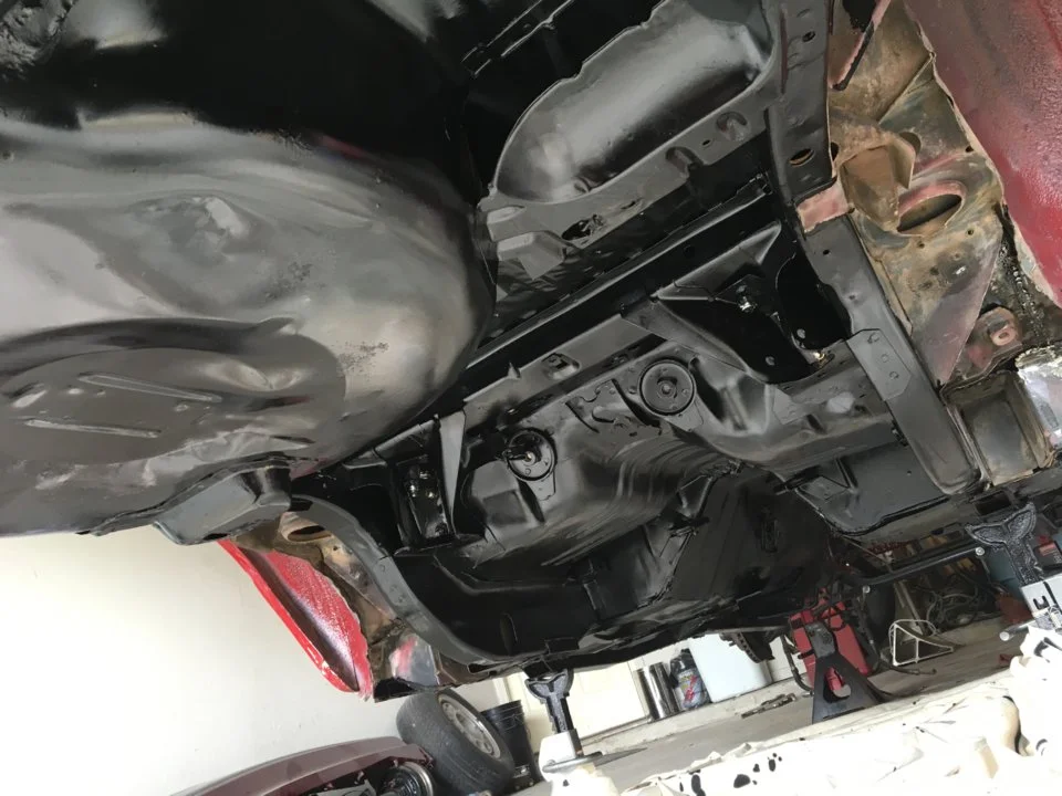

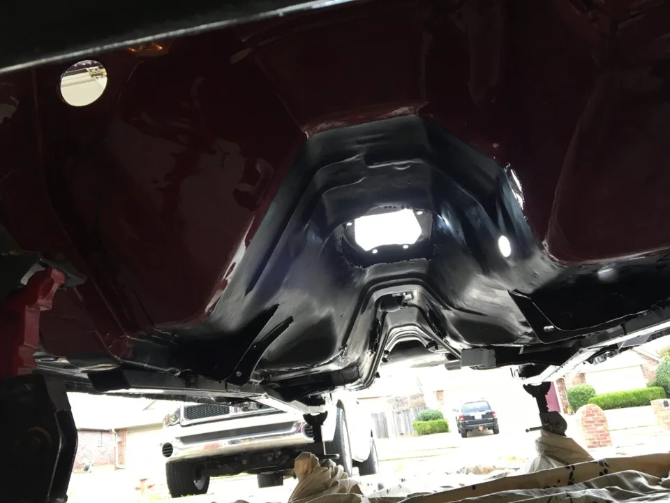

Boy that was fun, drip, drip, drip. Got it done except for where I will do the mini tub. Got to go clean some paint off my hair before it dries...
Subframe connectors are welded on and painted black.

just out of curiosity, what was the process? i'll have to do mine soon, and i have no idea how im going to get in all the nooks and crannies (especially all the overspray in the front fenders). mine was all ziebart stuff btw, not sure what yours was and how different they would be.
