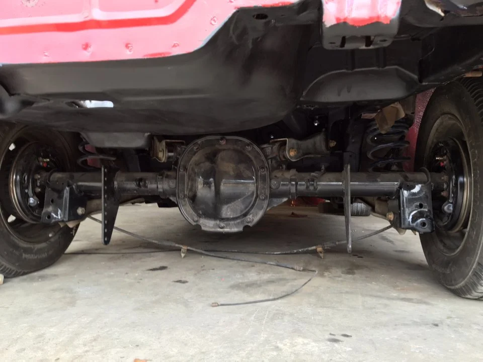

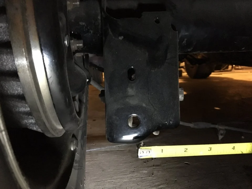

madmike1157 said:
This is what the rear looks like after it was completely modified and the rear C/O mounts fabricated with the stand off that was needed to accomodate the 1.25" inboard straight up mounting.
Ok @madmike1157 , I was doing more measuring with the rearend back on the car.I was thinking about moving the lower bracket over 1.25" as well (thinking hell, I have too). Couldn't I just modify this mount with out attaching a side bracket for the c/o?
I could cut the bottom couple inches off of the bracket and weld it to the other side, and take the other side and weld it to this side.
Ironically from measuring the bracket, this would move the attachment hole over almost exactly 1.25".
The coilover kits I've been looking at come with an adapter to attach to this hole. I could weld that little bracket on to give it even more strength.
What do you think?
BTW, I also measured for the clearance on the LCA's. They wouldn't even be a problem with 335s.
So....if I just swap out the rear seats for booster seats, of course using the same fabric as the front seats so they wouldn't look wierd...........

madmike1157 said:
What? You're talking about moving the entire LCA mount inboard? I'm not exactly clear what you are talking about here.
Nope, just cutting the lower back plate off where the shock attaches and swapping sides of the rear.

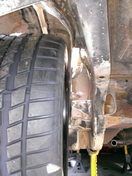

Here's what you need to factor in...
I moved the wheel tub to accommodate a 315. The pics I furnished shows that there was barely enough room on the inside for the tire to pass by
But look at the distance to the frame rail.
The instances where the tire could make contact with the strut really only occur at the top. Where you locate the bottom mount...(whether you use the stock shock location,...cut them, and flip them inboard of each other, or completely fab an interior mount) will not affect anything, other than the angle you'd have to notch the frame.
Reactions: Davedacarpainter
Hum...may not need to change out so much then.
The gap between the tire and tub is about what I'm expecting.
