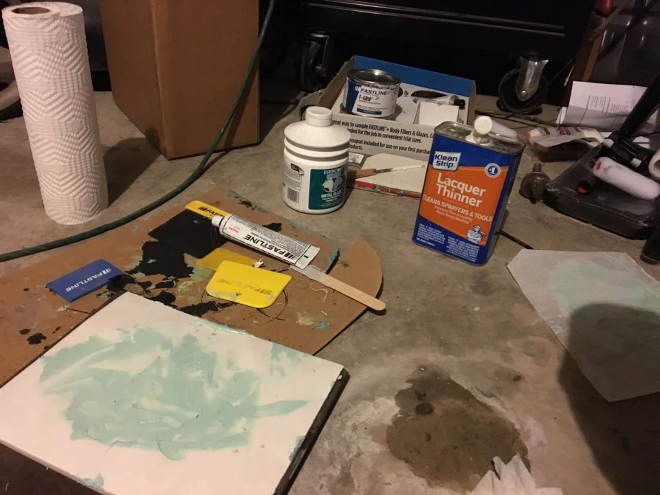

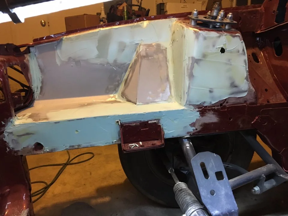

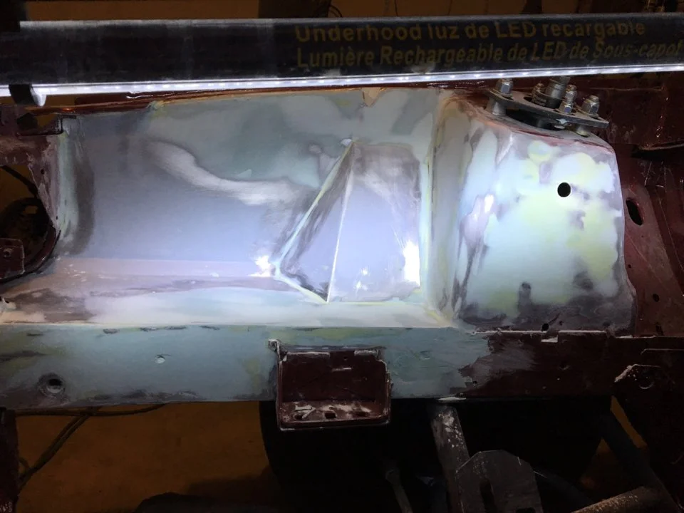

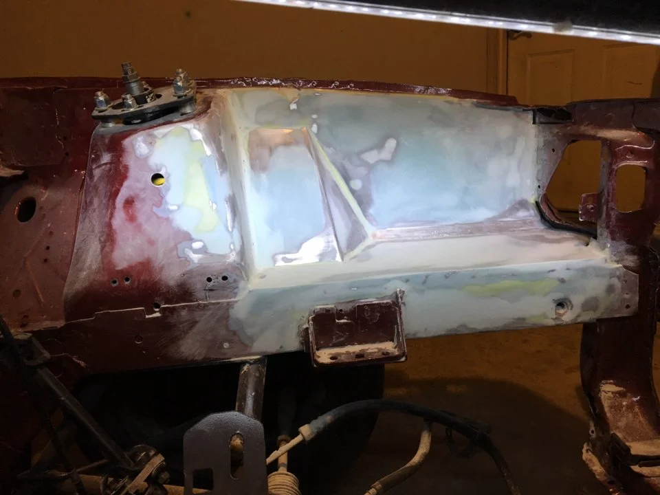

Back to the story...I have finished the left side of the engine bay! It was the most difficult thanks to me screwing up in various ways. It's much smoother than looks.
I glazed the right side and will sand it tomorrow morning
After I'm done with the glaze, I will prep the surrounding area with 320 grit for primering then wait for weather that's warm enough to catalyze the primer. Next Monday is supposed to be back into the 70's.

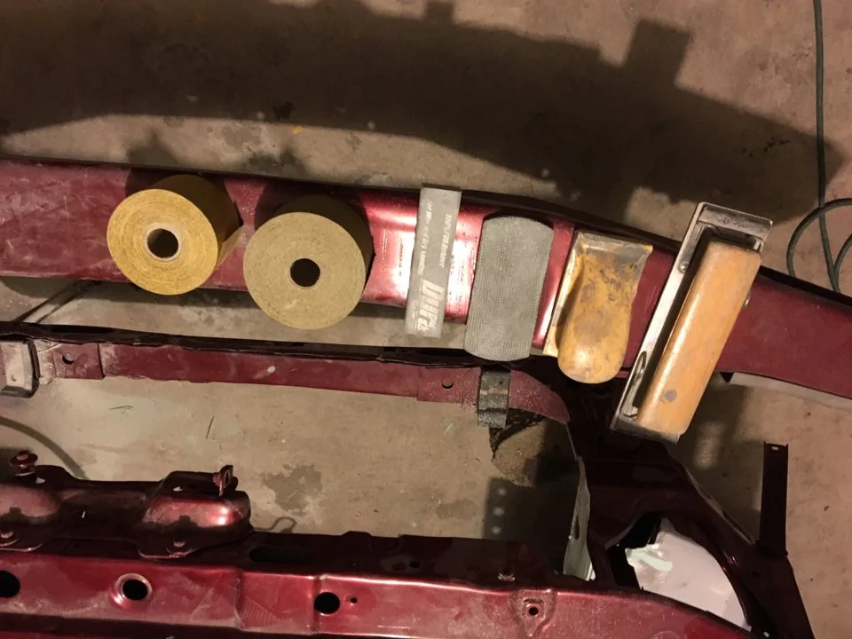

For those that want to see the blocks and sandpaper I've used for the smoothing, here you go. 80 grit and 180 grit sandpaper, btw.

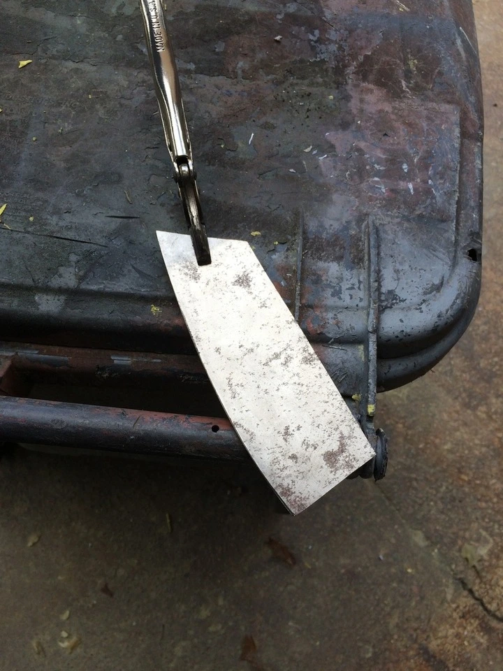

You got nothing on me. For the latest, most utilitarian in work surfaces, I almost always use the Trashy MacPherson model 17.
With two large wheels in back, moving the TM#17 is a breeze. The unit also features a built in handle that also serves as a attachment point for hanging painted junk. Probably the most convenient feature of The Trashy Mac is the flip top work surface that opens up to provide a perfect receptacle for end of day scrap, and refuse.

So I got most of the right side sanded down, I have a little left that I'll get tomorrow morning when it's too early to start grinding out the undercoating in the tubs. Plus a couple little anal issues on the panel that will be all gone tomorrow morning.
I'll be kind of glad to be done with ALL of the bodywork on Doby finally.:banana:
