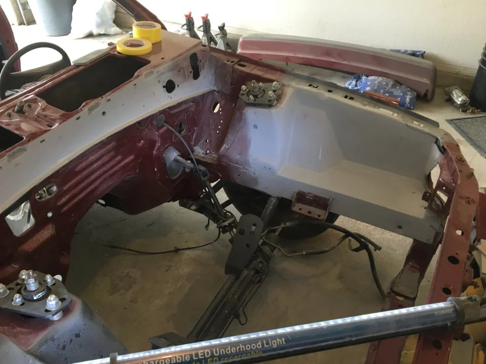

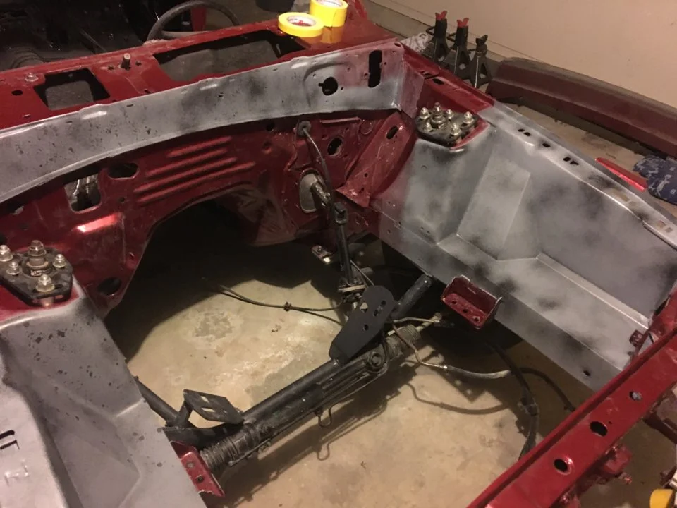

Ok, got a guide coat sprayed on the engine bay and removed the masking paper.
I'm going to block it with 320 grit. Let's see how far I can make it today.

So I got the left side and firewall blocked out.
The left side blocked out so stinking nice! After all it's been through! It gets me ultra hyped about painting it, when a panel blocks out like that, the paint job should just turn out magnificent. I need to stay calm......

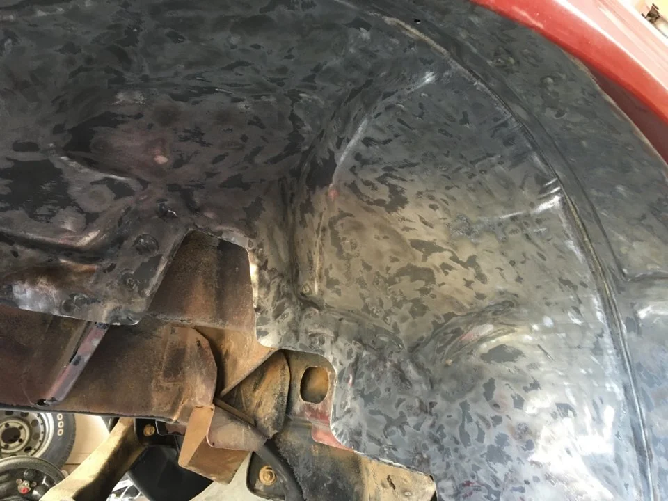

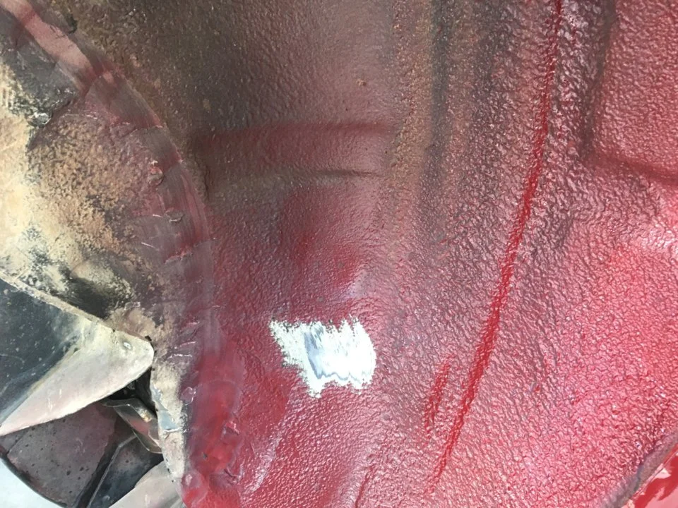

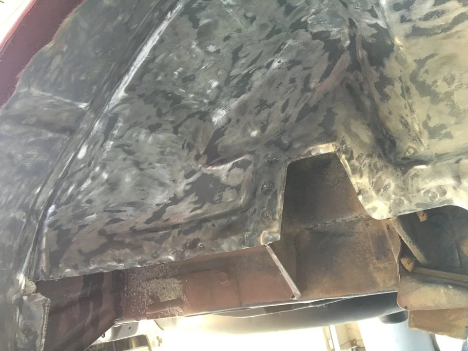

Got Doby's rear in the air again. Started grinding out the undercoating with a knotted wire wheel. It comes out easier than I expected, still though, I'm worn the hell out now.
First picture was just digging in a little to see how the knotted wire wheel would do, realized I could plow through it with the test.

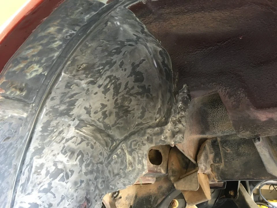

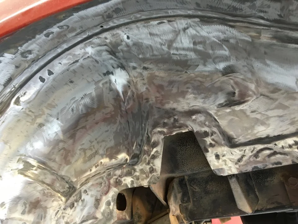

Next couple of pictures show that I finished off the right side and got about half way through the left. The wire wheel was worn out by then, got to go get a new one:
Got half way through the left side:
That crap is thick! Hey, @madmike1157 , what do you think about that? Progress, huh?
I'm cleaning out the undercoating to prepare for the min-tubbing for those who just started looking.
