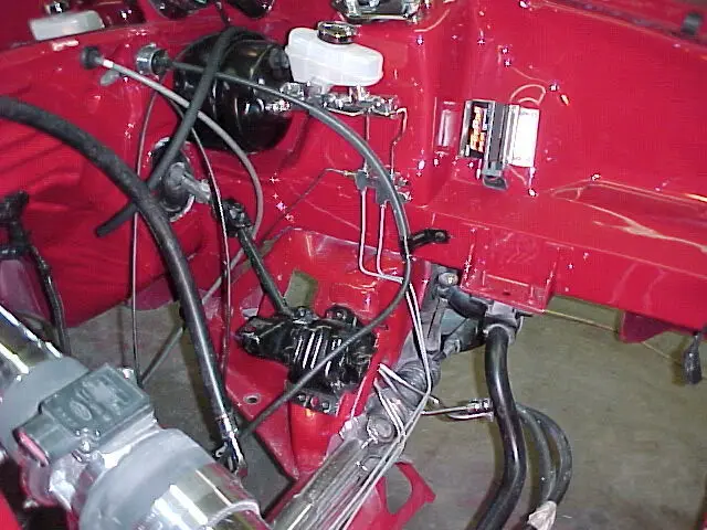

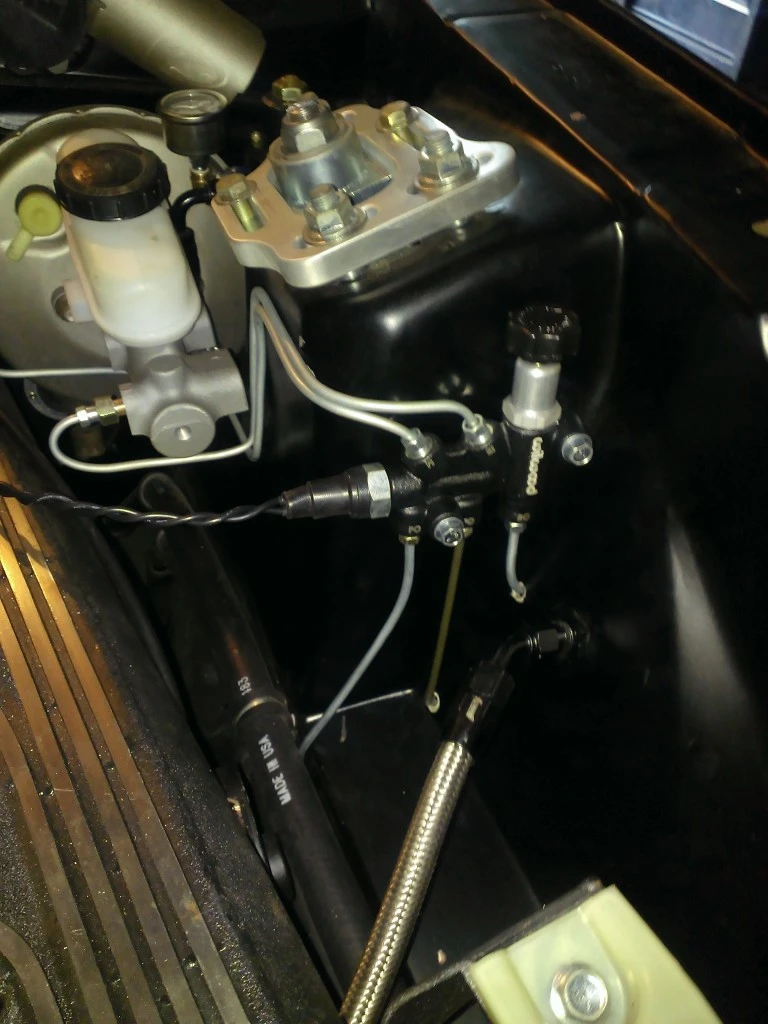

Or conversely,.....You could do it one of these ways:
(Can you believe that he actually went through the trouble of actually running the rear line over to the factory grommet on the passenger side by going down the frame, across the rack, (which shoulda went on after he ran the lines) back up the frame, and into that stupid ugly little brass 90 degree fitting?
RE-ROUTE THAT LINE TO THE DRIVER SIDE OF THE INTERIOR!
or you could be like this guy,...and go through all that shininess and just tuck the factory lines under the lip that (I believe) you ground some of it off?
Reactions: Davedacarpainter
