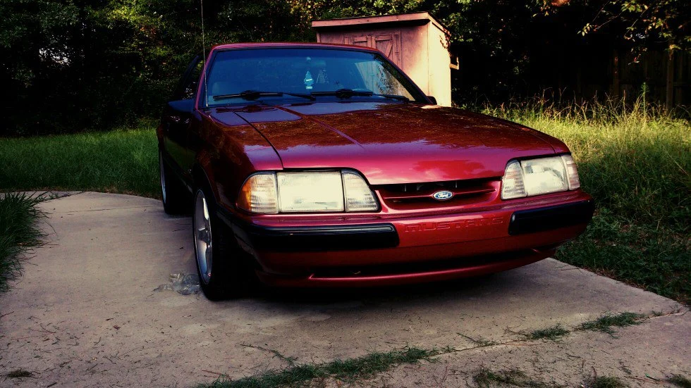

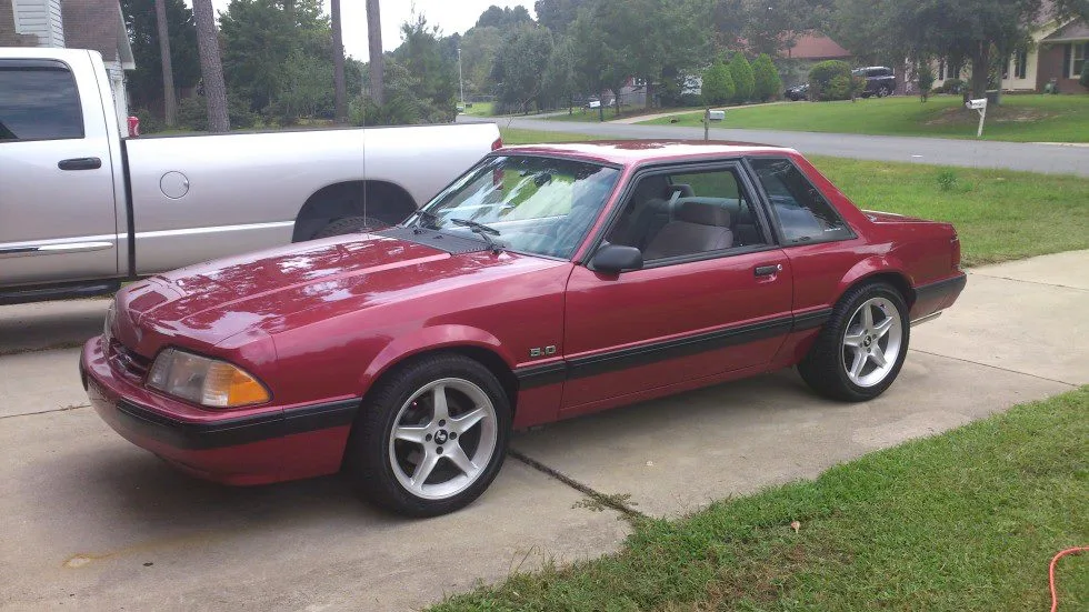

My name is Rob. Just bought my first Mustang. Just jumped ships from the Honda world. Been working on cars for about 6 years now, mostly Honda's but not completely biased when it comes to anything with a motor in it. Right now don't have any huge plans for the notch, but they will definitely come in the future.
1990 LX 5.0 Notchback 112k on the clock
B303 Cam

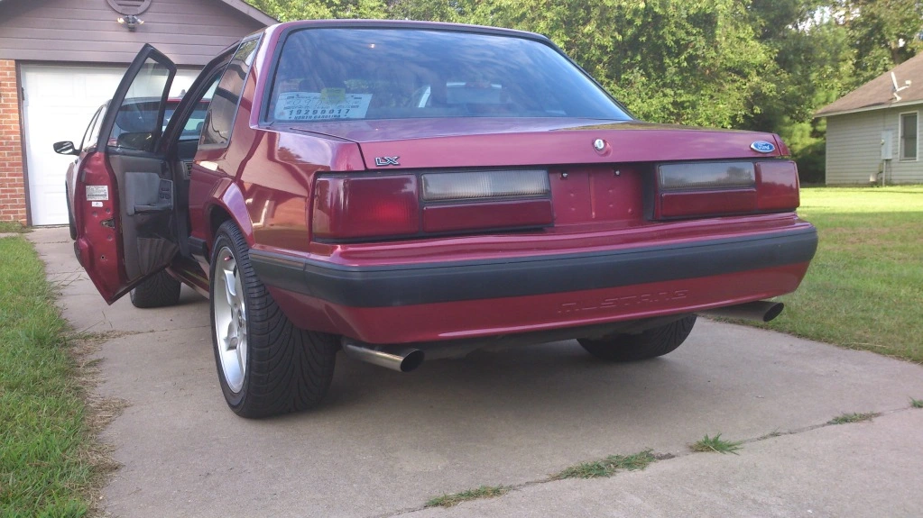

BBK Shorty's
BBK X-Pipe
Pypes chamber mufflers
2.5" Pipes
Right now getting used to the "lopey" feeling. It has a couple small things that I would like to fix right off the bat. Right now having an issue with coasting at around 20mph; it will feel like a grinding/jerking motion when I'm completely off the throttle. On the throttle nothing, but when foots completely off it has the jerking motion to it, not sure if it's because of the cam or something else. Going to trouble shoot it tomorrow. The alt output right now is in the "normal" window but sitting low. Oil pressure is not bad, but definitely would prefer that it's halfway in the "normal" part of the gauge.

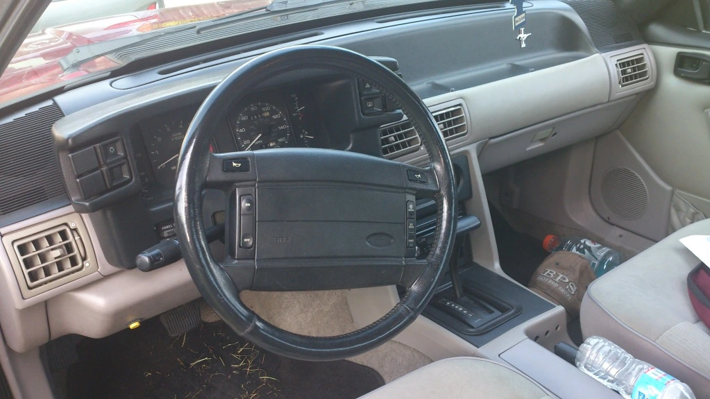

Replace Worn/Broken Interior Pieces

very clean car! Couple of things I suggest. ( did all of these myself)

Welcome to Stangnet! Nice looking Notch you have there.
