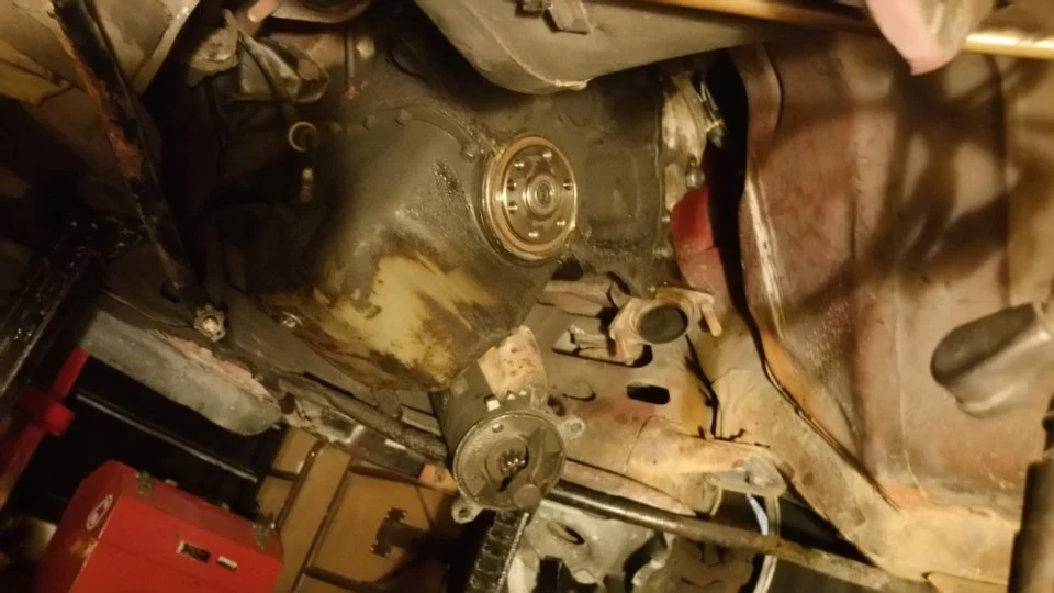

And here is the rear main seal. I read quite a bit about them before I installed it. It seams there is a lot of controversy surrounding this thing with some people getting good seals for a long time, some getting temporary seals for months to years and others that get a poor seal and leaking right away. Some say that the seal needs to be clean and dry. Some say that it needs to be soaked in oil and everyone says that you have to get it in there nice an even. Since the crank spins, I think the soaked in oil people are correct as dry=fiction=bad for rubber. So that is what I did. Also, a lot of people think crankcase pressure is the real problem. I dunno *shrug*, I just hope that it's not worse than it was before.

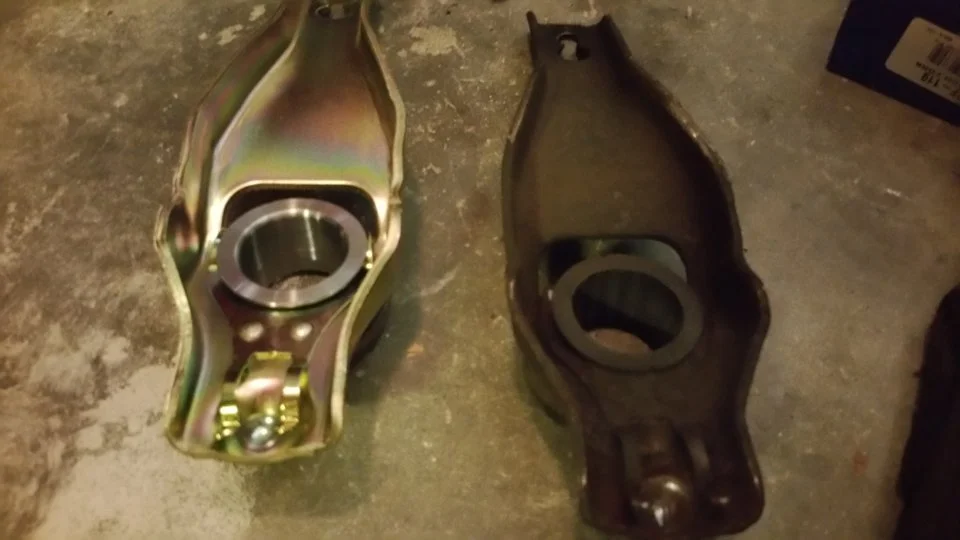

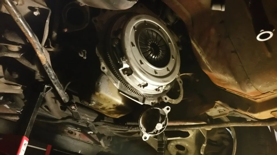

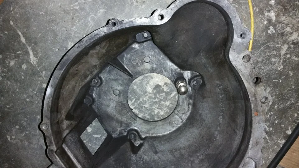

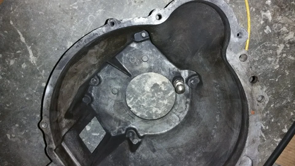

I got the new flywheel mounted and torqued down to 80 foot pounds. I also got the clutch installed and torqued down (25 foot pounds). I actually torqued the clutch down a little more as 25 foot-pounds felt really light. If you look at the throw-out bearing you will see striations from the yoke on the last tranny. Man, that thing must have had a lot of miles on it. It looks like it was driven forever, but must have been taken care of to last that long! I wonder if it was the original transmission? You can see I also installed a new pivot in the bell housing. The last one was galled. As dirty as that bell housing looks, that was after it was pressure washed! Fortunately, it’s underneath a lowered car, so no one will ever see it.

nice .. did you put some thread sealer on the flywheel bolts and some grease on the pvot ball of the clutch fork? Did you install a new pilot bearing?
I've aways installed the rear main seal dry but everyone has their own method.
I used anti-seize. I don't particularly care for thread locker and if you research it, you will see a lot of people use anti-seize on these. In fact, I think I got that from Clymer or Chiltons. I will put grease on the pivot ball and I already put it on the input shaft as well. Yes, I installed a new, greased, pilot bearing. The rear main seal is the only thing that I am worried about. Hopefully, I can get the car put together this weekend and we'll see what happens.
read my post again. I said thread sealer not thread locker. Glad you read a Chilton though, lol Did it mention the flywheel bolts go through the end of the crank and can leak oil out?
Oops, that's what happens when you're reading posts when you should be working. No, I don't recall them saying anything about that, I hope it's not a problem.
