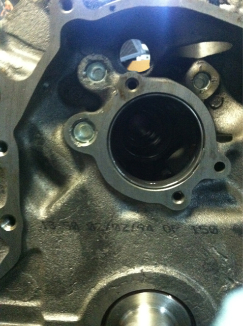

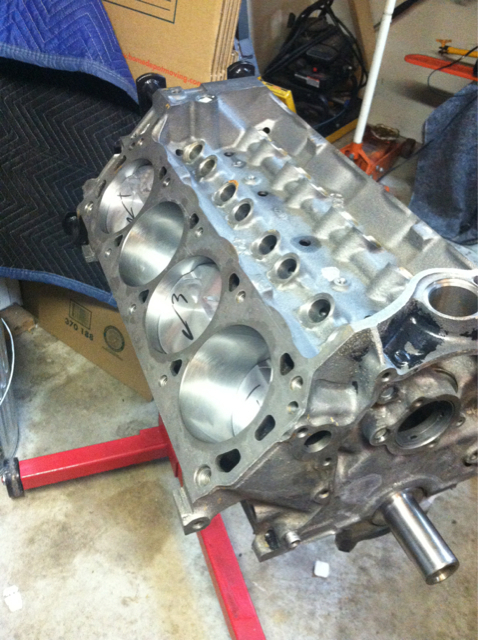

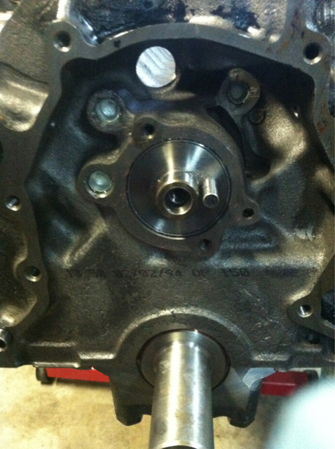

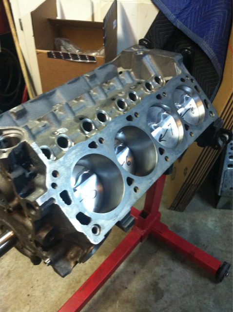

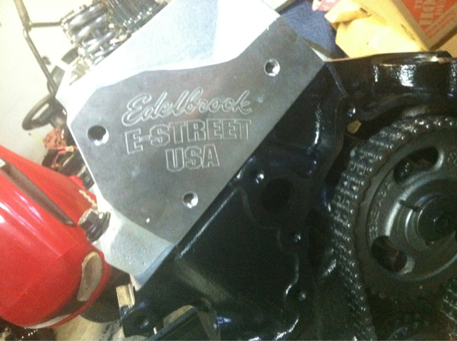

I stopped and picked up my block from my machine shop and it looks, well it looks like it did when I dropped it off except it now has KB flat tops pistons.even though it was a new, never ran short block to start with Everything has been rechecked, cleaned and balanced. I can't wait to start putting it back together.
Reactions: elarm1

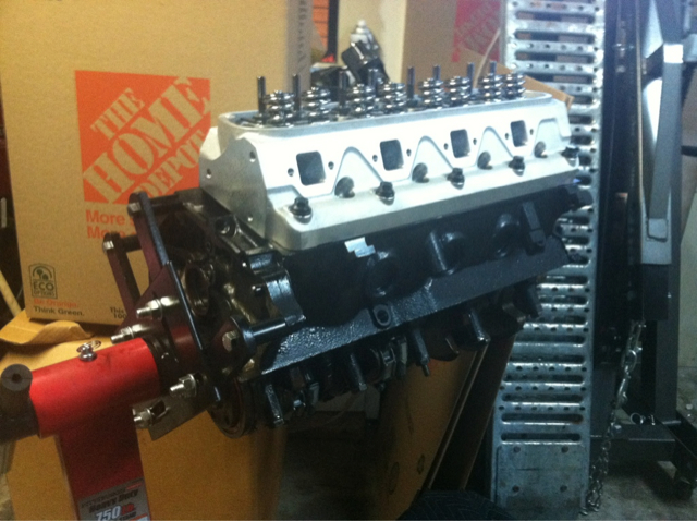

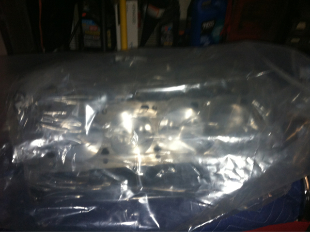

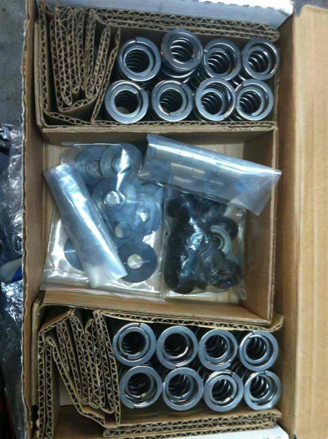

Got the heads together. Edelbrock E street heads that were gasket matched, ported and polished. I also put a new set of springs in them from Ed at flowtech.

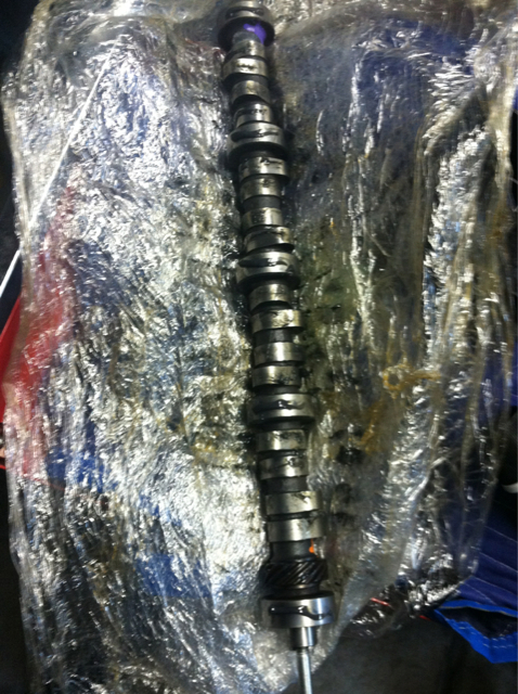

I hope to have the cam set up this weekend. Might even bolt the heads down.
That is also what I heard but even with the new springs I have less than 900 into them. It's going to be a summer driver for the wife other wise I would have a set of AFR heads and a stroker kit.

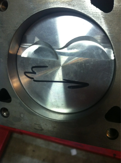

The 1.9 ones, it's been a little bit of a project so far. I was planing to just buy a short block and slap a decent set of heads on it for her but nothing is ever that simple. With the cam it didn't give me the valve Clearance it needed so my brand new short block had to be torn down to install new KB flat top pistons. Now everything is looking better and I checked the clearance before bolting down the head and its not an issue at all now.

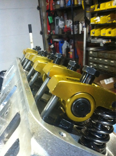

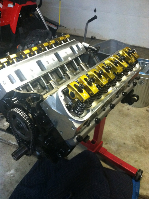

Well had time to work on the motor a little. I got the heads on, the lifters in with the dog bones and spider. I slid the push rods in and finger tightened the rocker arms. I used arp head bolts and cam/crank bolts.
I know the heads are on, but did you chase and blow out all the bolt holes? You'd be surprised what gunk is in there. Nice score on the E heads. I learned the hard way when they first came out how crappy their springs were. Make sure you plug the any thermactors holes with plugs and put loctite on them.
The block was new when i got it but Yes all the bolt holes were cleaned and chased out he even deburred and cleaned all the oil passages even though no oil had ever been run thought the block. I'm not sure what you mean by " any thermactors holes" I'm guessing spell check replaced what you meant to say. I don't see any holes that need plugged so far.
