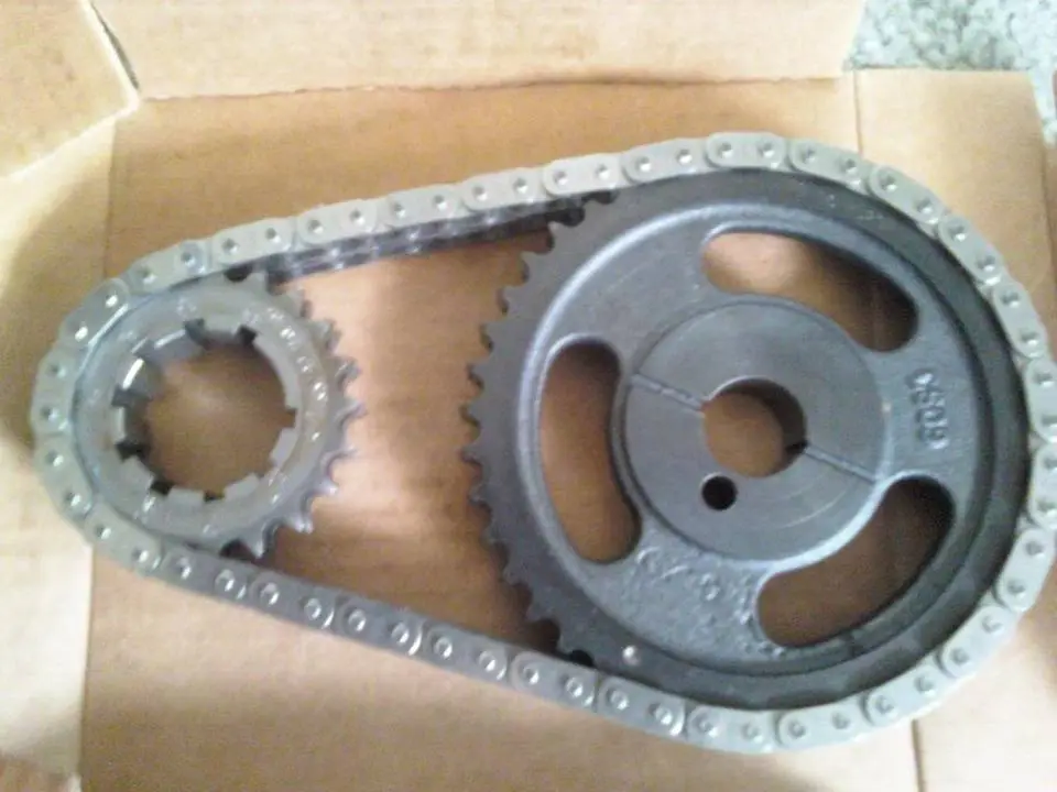

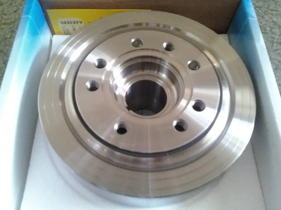

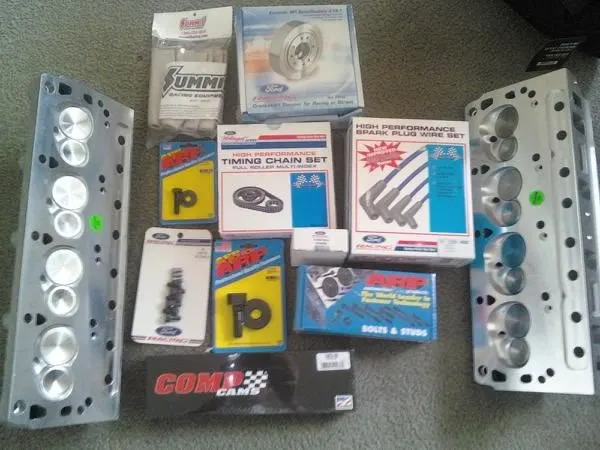

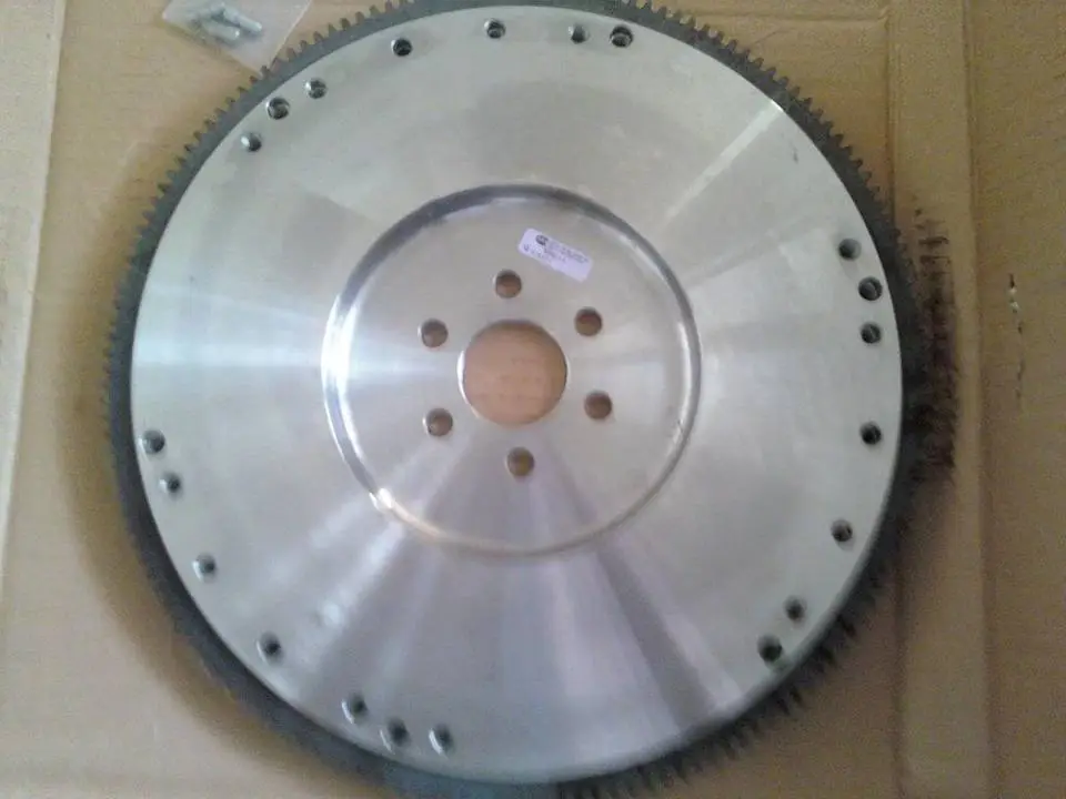

Ok well another update. UPS made a delivery to me today from summit! I got the AFR 185 with 58 CC chambers, comp hardened push rods FRPP billet steel fly wheel FRPP harmonic balancer,frpp 9MM black wires,ARP head studs,cam bolt,crank bolt,FRPP 8MM clutch bolts FRPP double roller degreeable timming chain. Still to come is the trick flow R intake and the comp gold race 1.6 roller rockers. All i need now is the dizzy and cam/lifter package. What injectors should i run? Will my 24# ones be ok? Heres some pics of todays shipment!

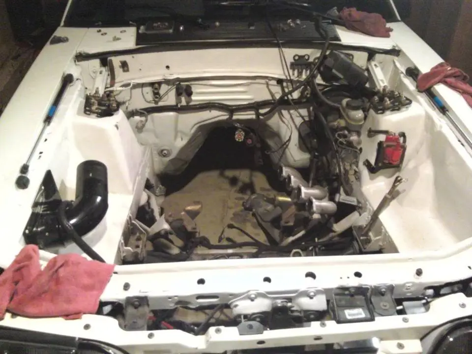

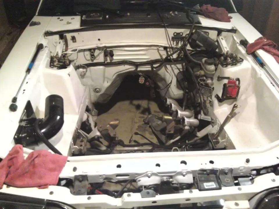

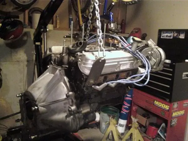

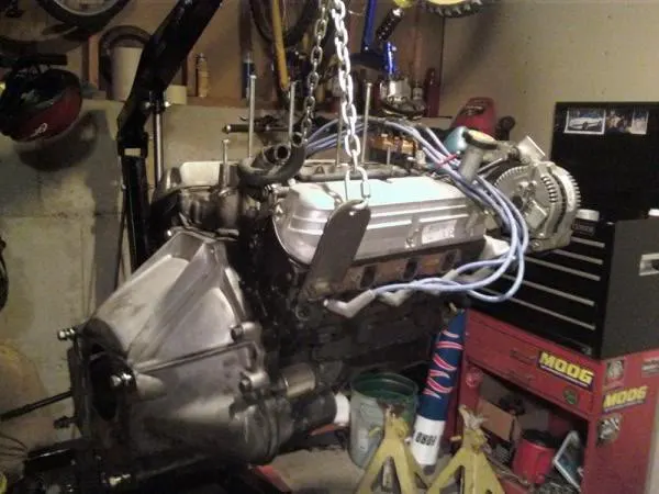

Well update. as of tonight all i gotta do is get the cherry picker from my buddies i might go tomorrow night to get it,i also need to get all the accesories off the front of the 302 and also the stuff off the lower intake. I did all the other stuff tonight it was a runinning/driveing car at 4:00 PM tonight and i had myself and thats it for help! So i'm thinking it should be a direct swap for what i've got so far. All i need is the cam/lifter and i will order that friday this week or monday next week. I feel i have a good set up so far but i am still woundering what size throttle body and injectors to use? I'm making my own fuel rails out of alumn at work. So whats everyones ideas for injectors and a throttle body? I have 24# now do i need to go bigger? peace
