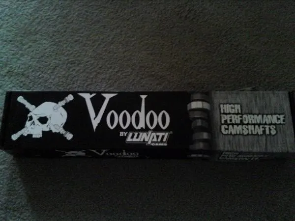

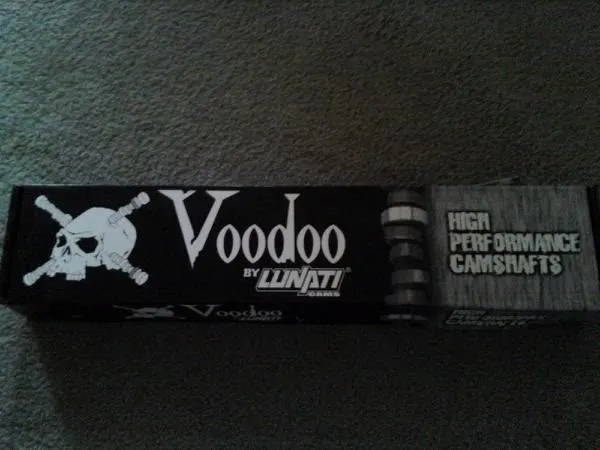

i got the cam/lifters friday. got all my acc. brackets painted all i have left to paint is the water pump. witch i'm doing today also. if i get around to it i'm gonna start the install of the motor today!
