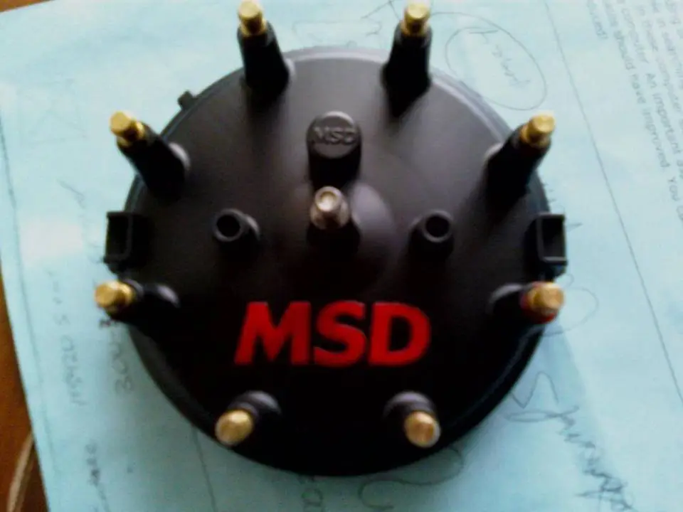

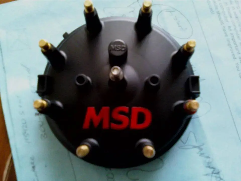

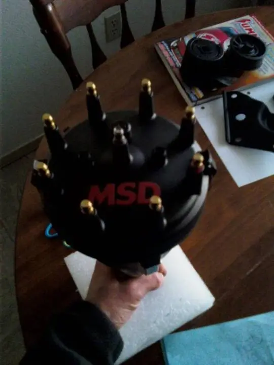

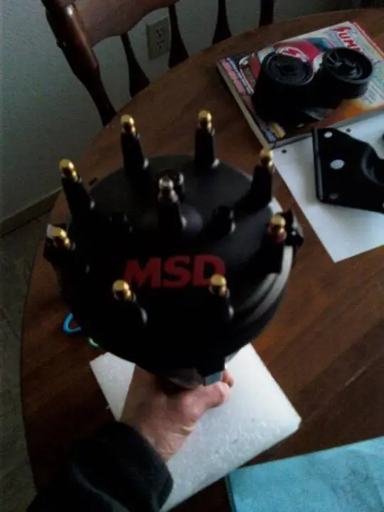

holy crap I have that cap and I hate the red.........how hard was that to do?? what paint did you use?
dude simple!all i did was masking tape off the prongs for the wires then i taped off the MSD and cut the letters out leaving the tape on the letters. i used regular ole flat black.I'm not putting the cap that goes over my nice new black FRPP wires tho!peace
