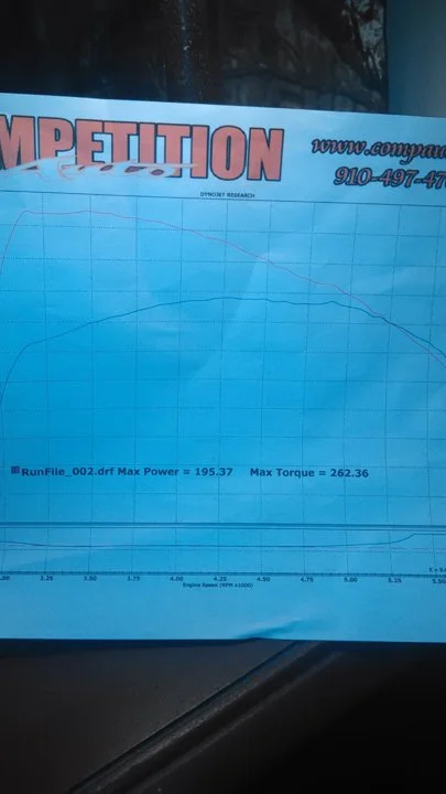

This is a progress of my 89 gt convertible build. First mods were off road h pipe and 10 series flowmasters. Second mod was 3.73 rear gears. I've done regular maintenance like plugs and wires. I'm now doing a gt40 head swap in the next month. Have to get all the parts for the swap. Got a baseline dyno all stock other than the exhaust and gears at competition auto. Its an aod daily driver. I'm hoping after heads and intake swap I'll be at 250-280 rwhp range and 300+ rwtq with 12-14° of timing

With the aod it will be hard to get above 250. But good luck! And keep posting! Always like looking at dyno graphs and it informs others of what to expect with similar mods.

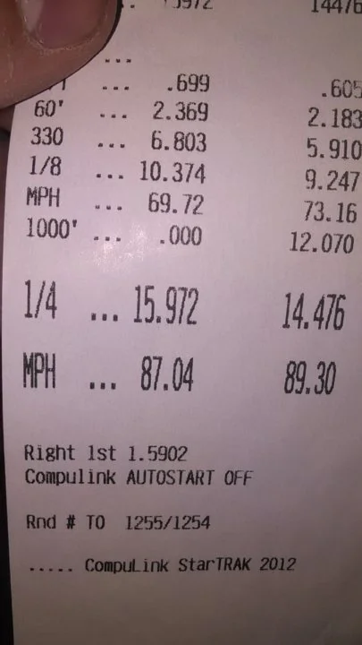

I'm glad you did a before dyno so we all could see how big of a difference there will be as well as a couple time slips. Do you plan on upgrading the cam while you're digging into the engine?

I'd highly recommend a silverfix valve body and the largest plete trans cooler you can fit. The AOD soaks up about 20% of power. To really help the AOD, an upgraded converter in the 2500-2800 stall speed range will get it out of the hole quicker.. I like Edge converters.
