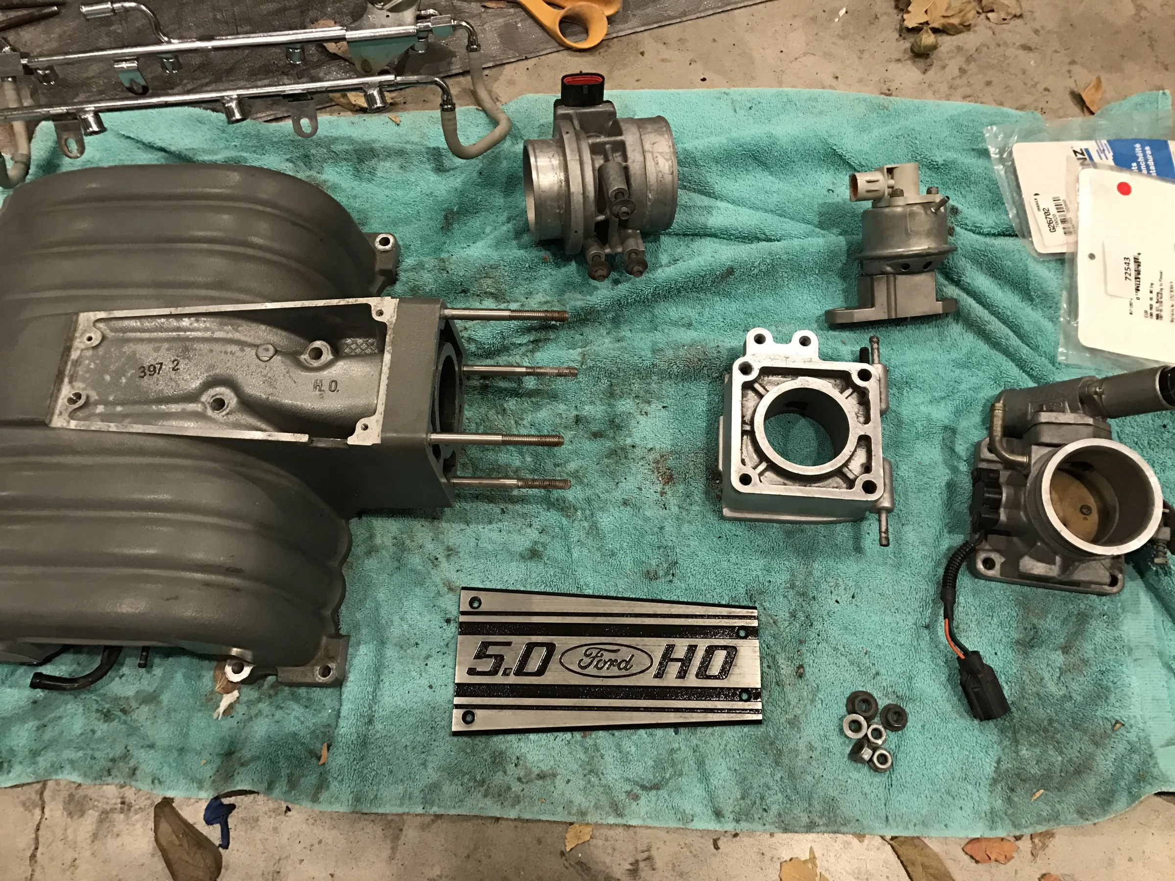

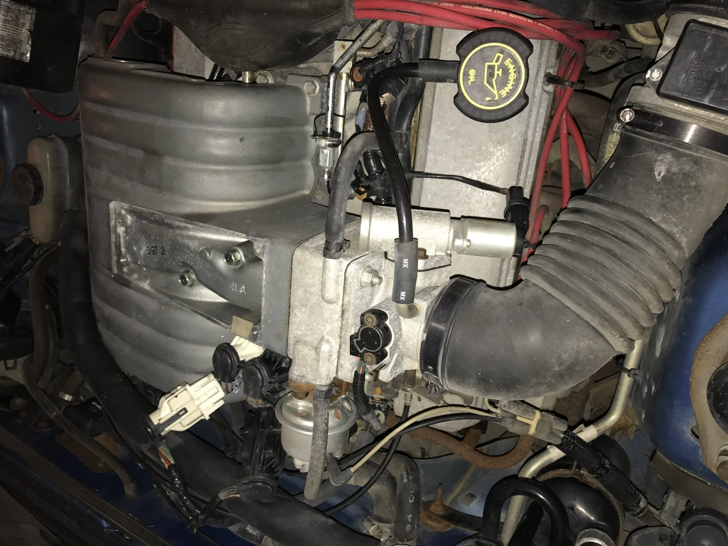

Everything cleaned up and ready to put back together.... Note the throttle body studs... I had a hard time finding those. Found the stainless ones at McMaster-Carr PN 92997A344
"Corrosion-Resistant Setup Stud 5/16"-18 Thread Size, 4" Long, 1-1/2" and 1/2" Long Threads" and even then had to extend the threads on one end
with a die
Reactions: RaggedGT

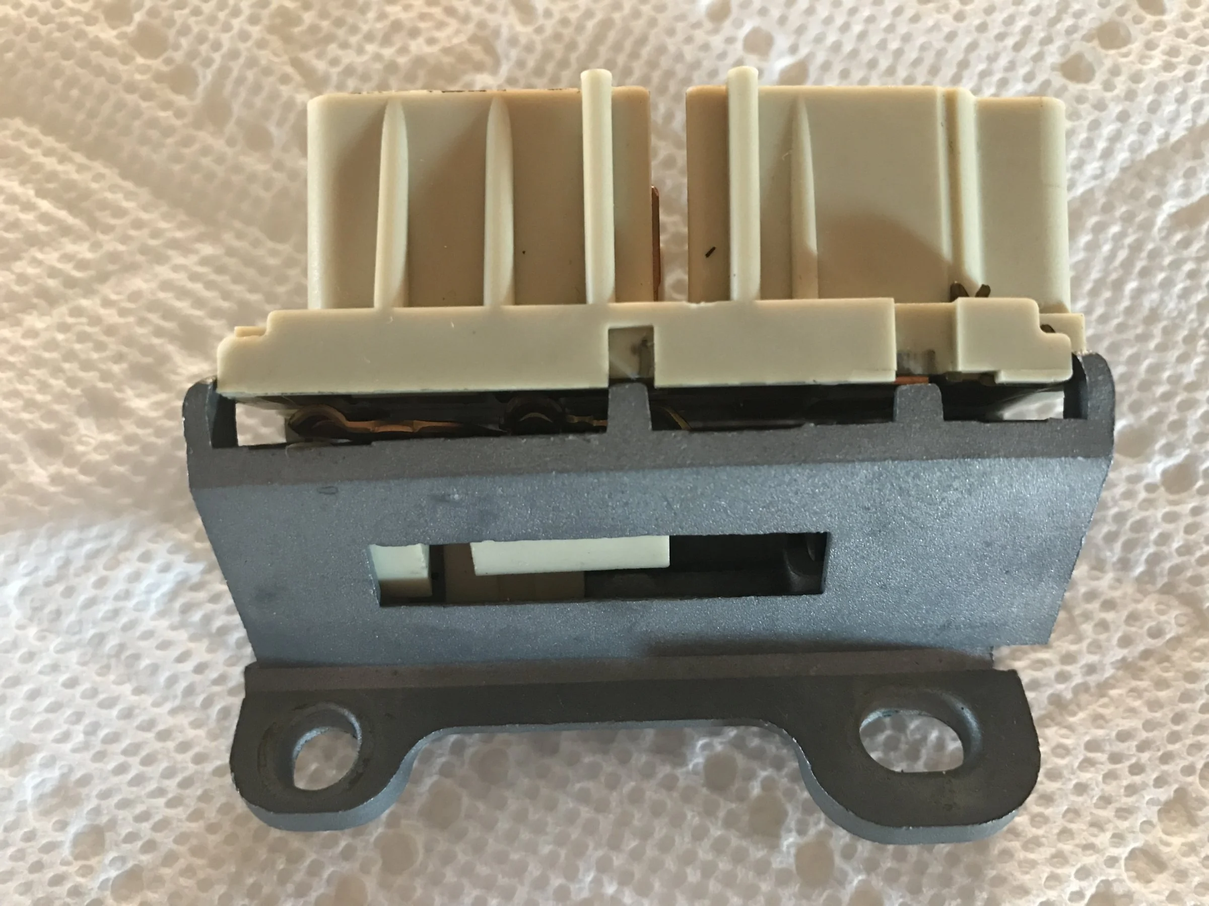

Immediately after this test... I let off the clutch pedal (In Neutral) and the engine died... this could be repeated multiple times... I have seen this issue reported but never a fix... Turns out the ignition switch assembly had separated (a common problem I understand)
and the computer thought it was still in Start Mode. A new ignition switch fixed this, only to be followed the next day with the smell of gas due to a leak somewhere around the gas tank... I guess I should not have expected less
