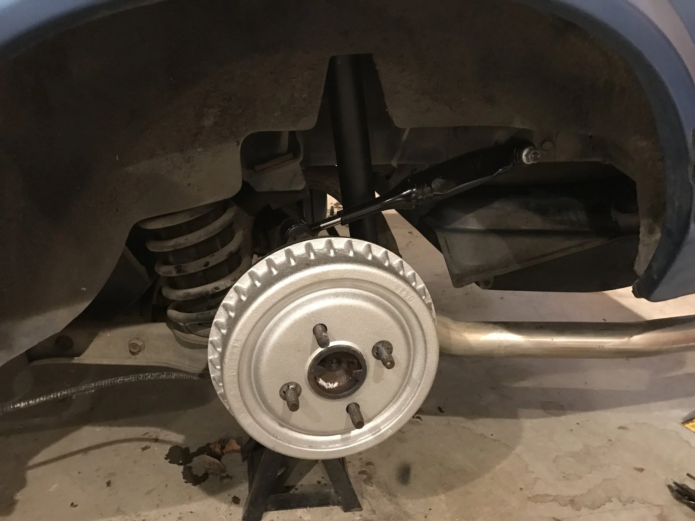

As for the rear drums. Maximum Motorsports makes a upgraded shoe that will help them perform better.

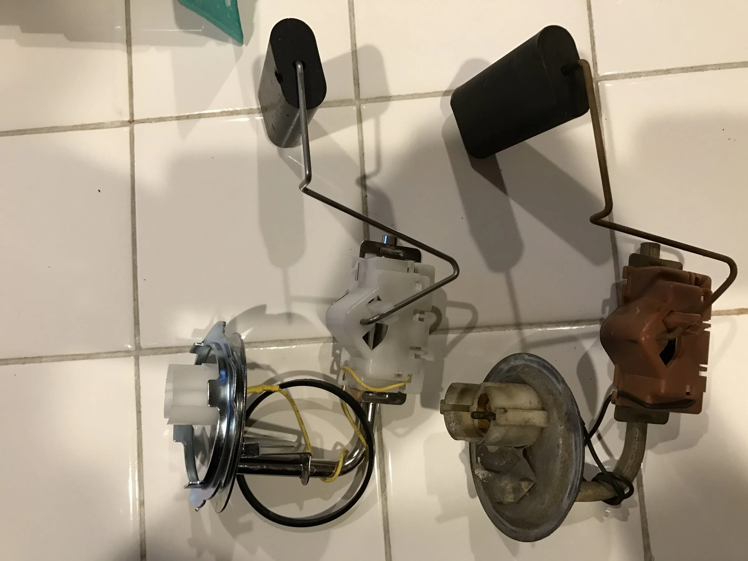

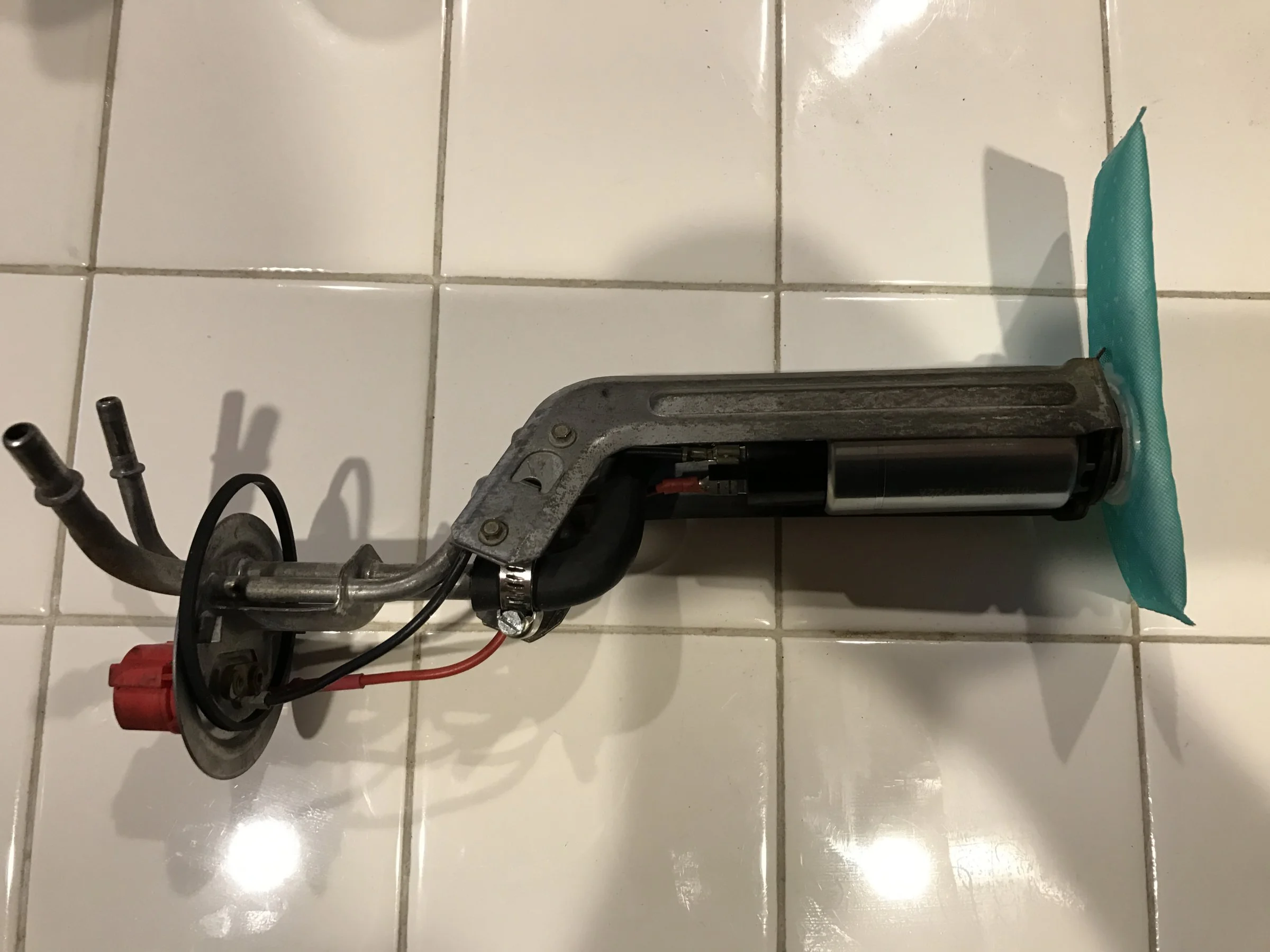

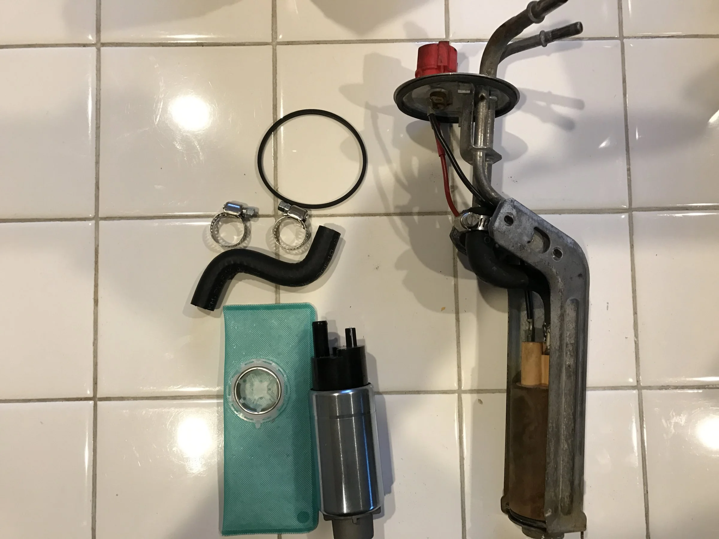

New sending unit, fuel pump ready to go back in the tank

My car sat for close to 20 years, with only the occasional start up and around the corner run. It was one of those project that, like you, I was always going to get to. My fuel sending unit was out of production when suddenly some nice company decided to start making it aftermarket. I was happy because the gauges wouldn't work with 87 - 93 sender. In many ways, you're lucky. Your year has more parts available.
