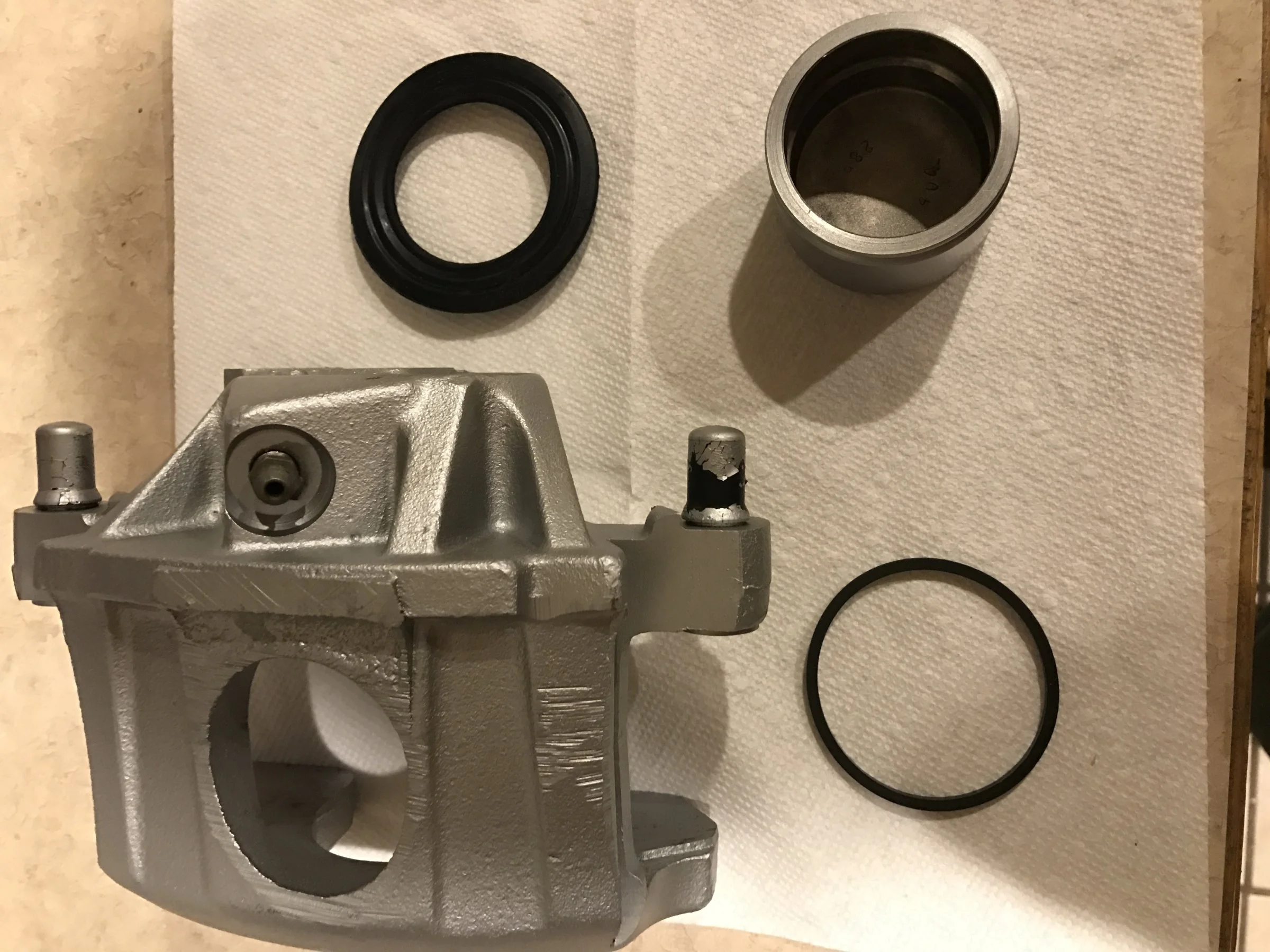

I know the Pics are now flowing at a rate that is acceptable but eventually the work will catch up and slow down a bit... After I got it running, having cleaned up the throttle body, intake, fuel rail, fuel injector rebuild, fuel regulator, spark plugs etc... While waiting on the gas tank parts I started on suspension, ball joints, and brakes....

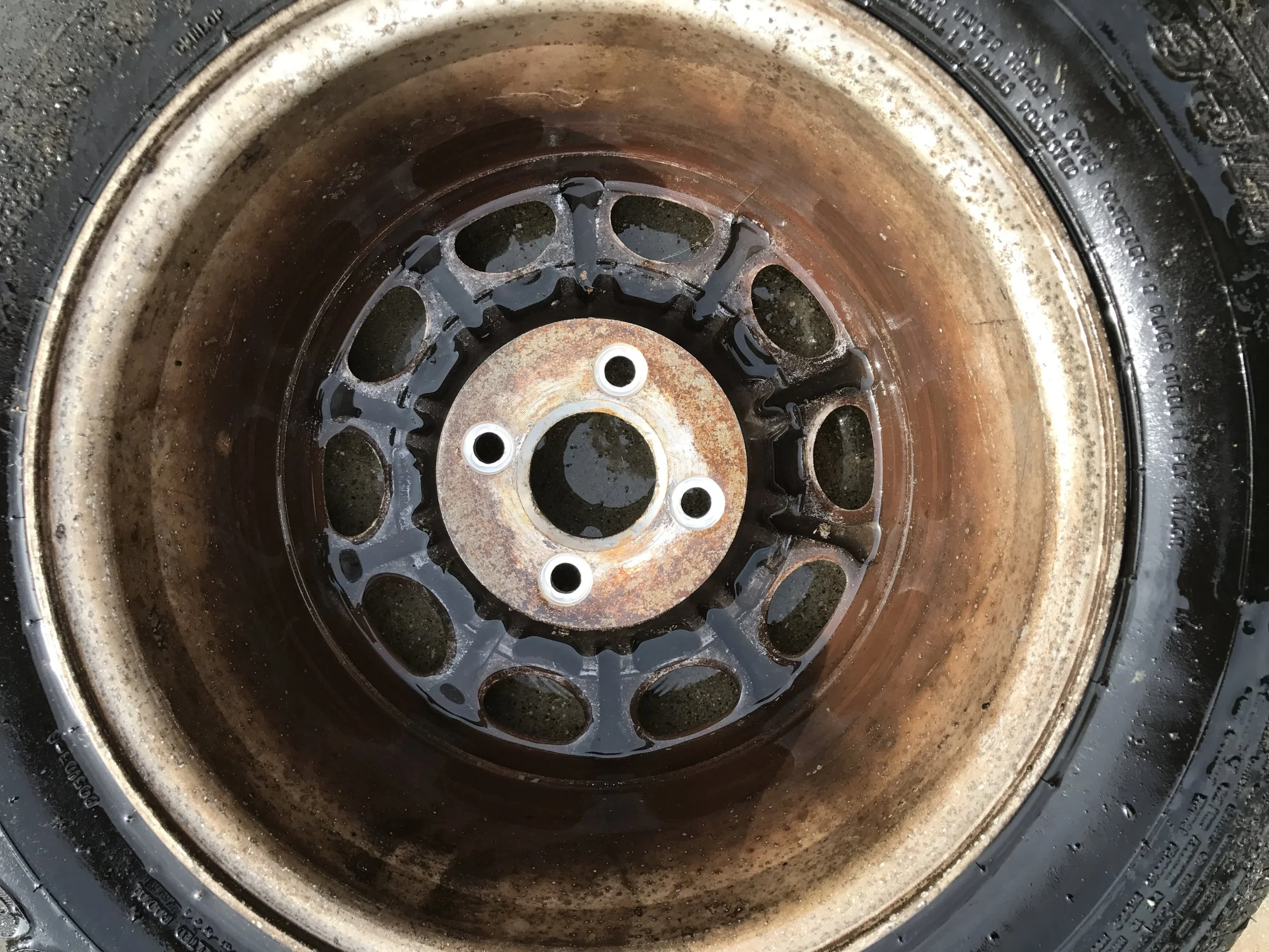

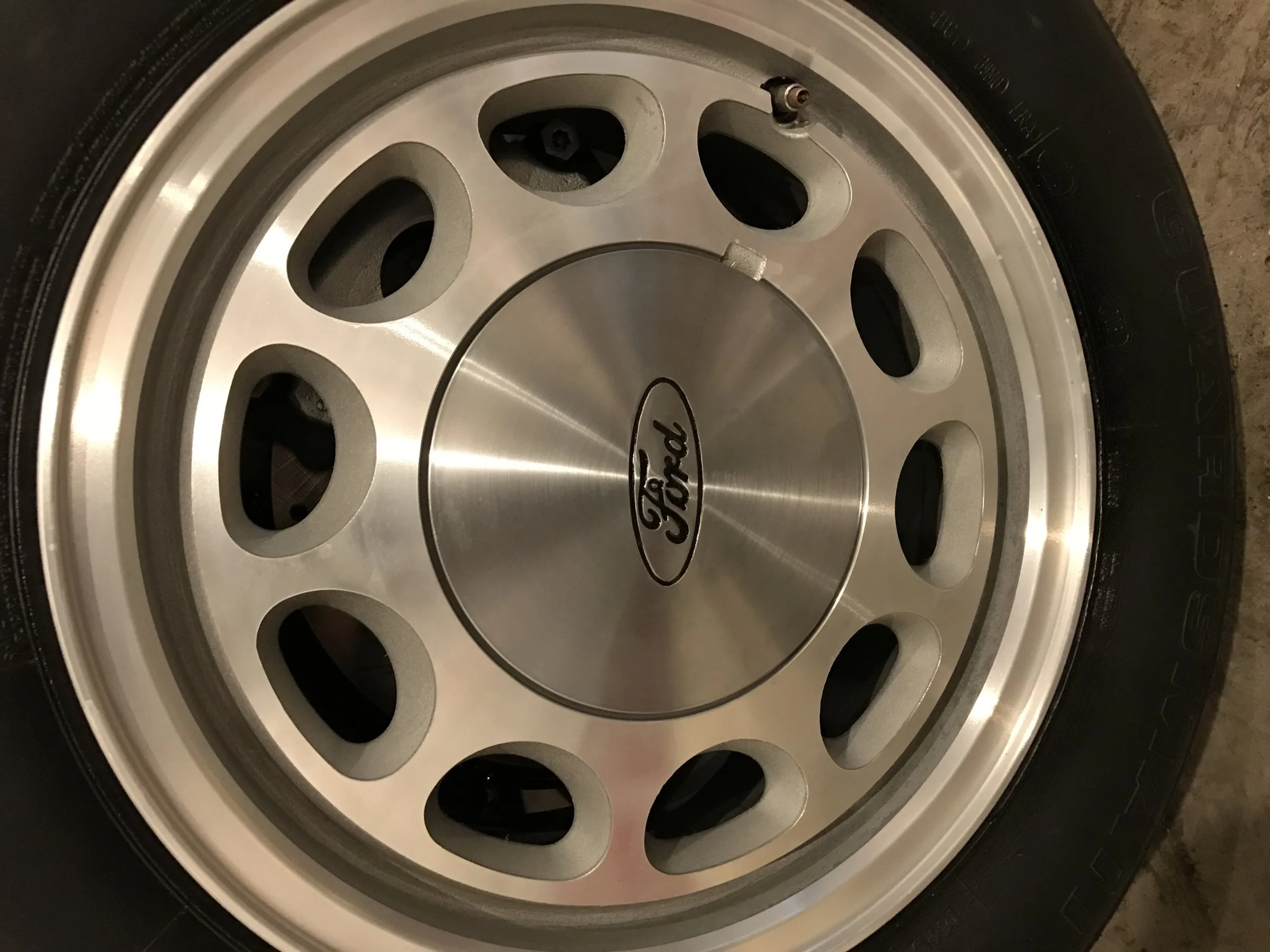

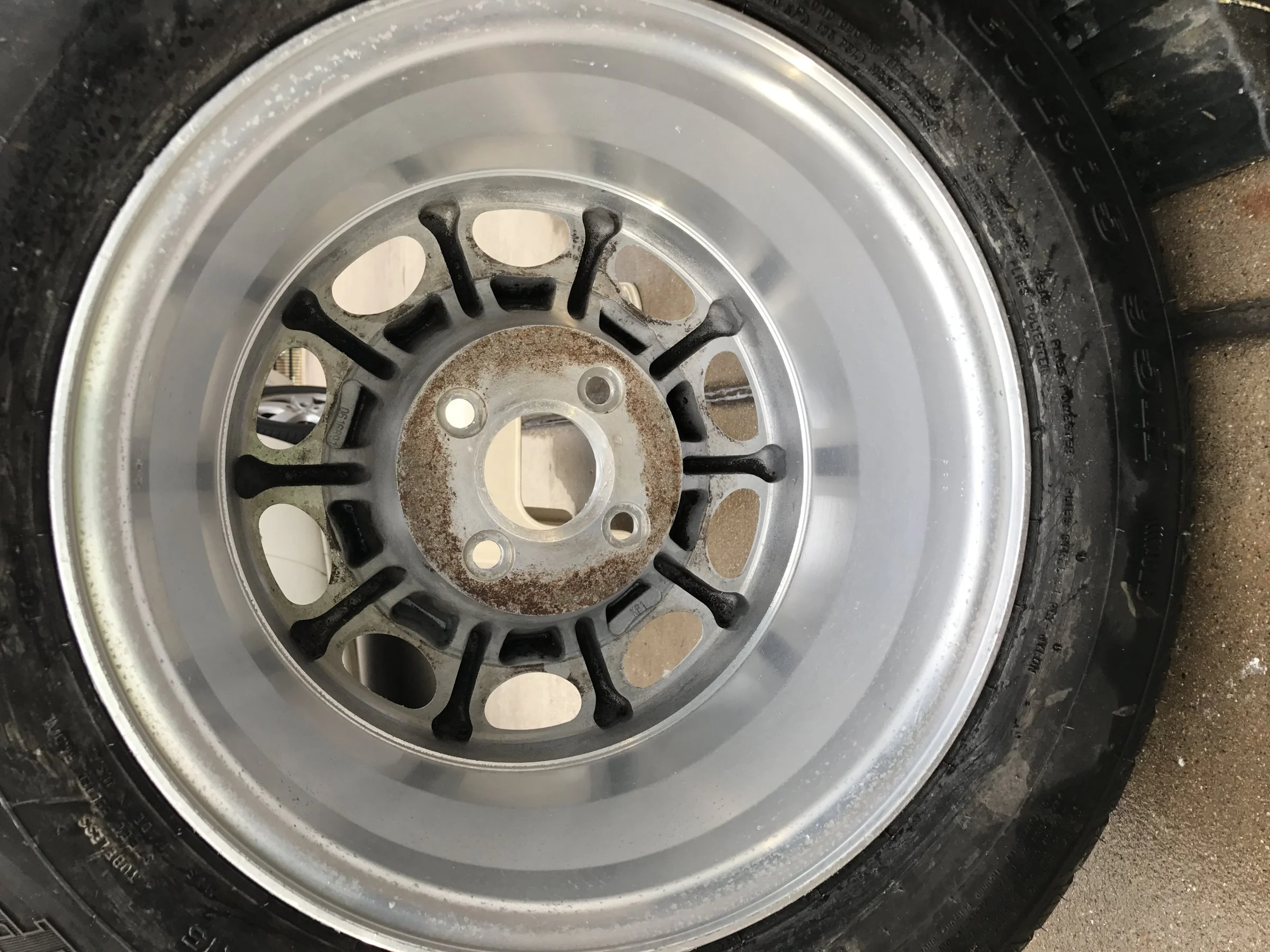

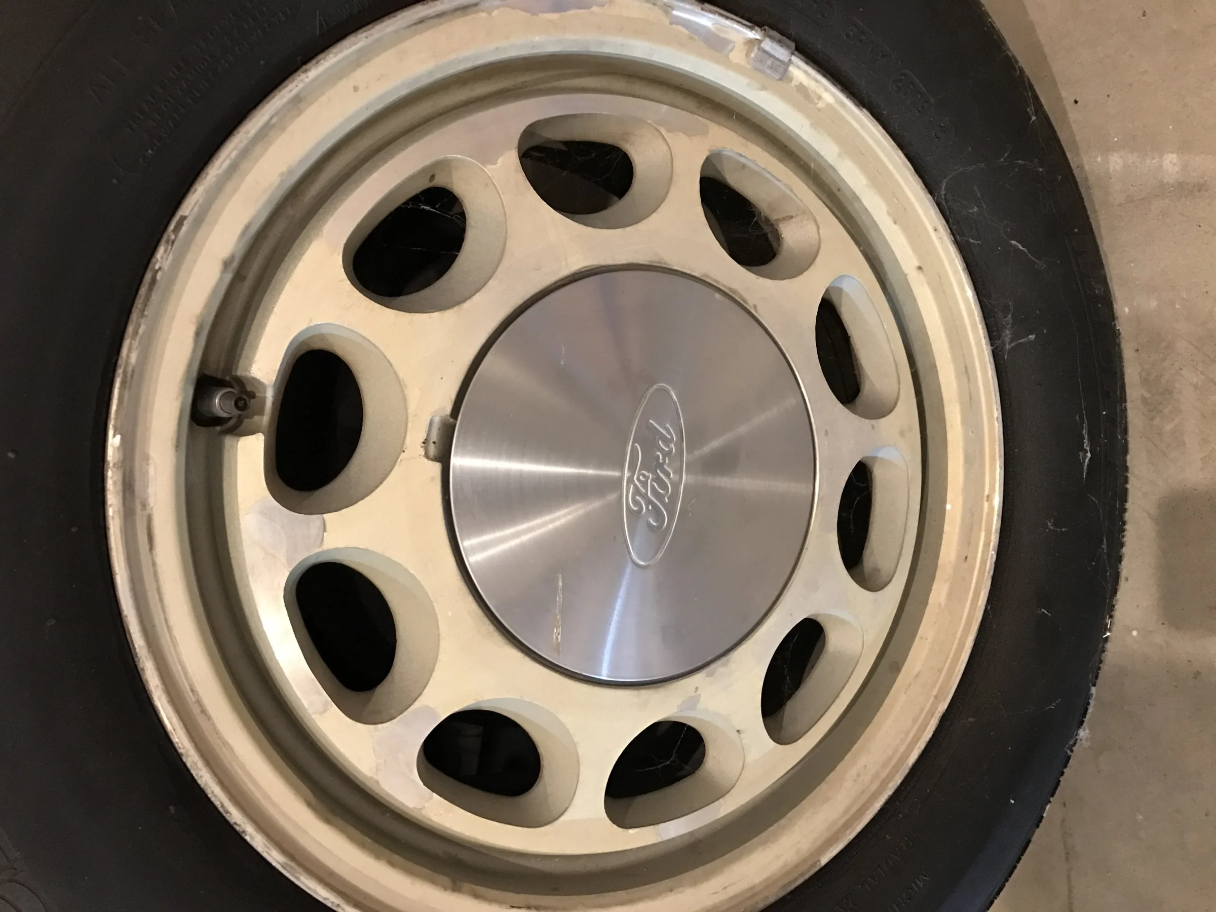

Cleaned up the wheels and repainted center caps while I was at it...

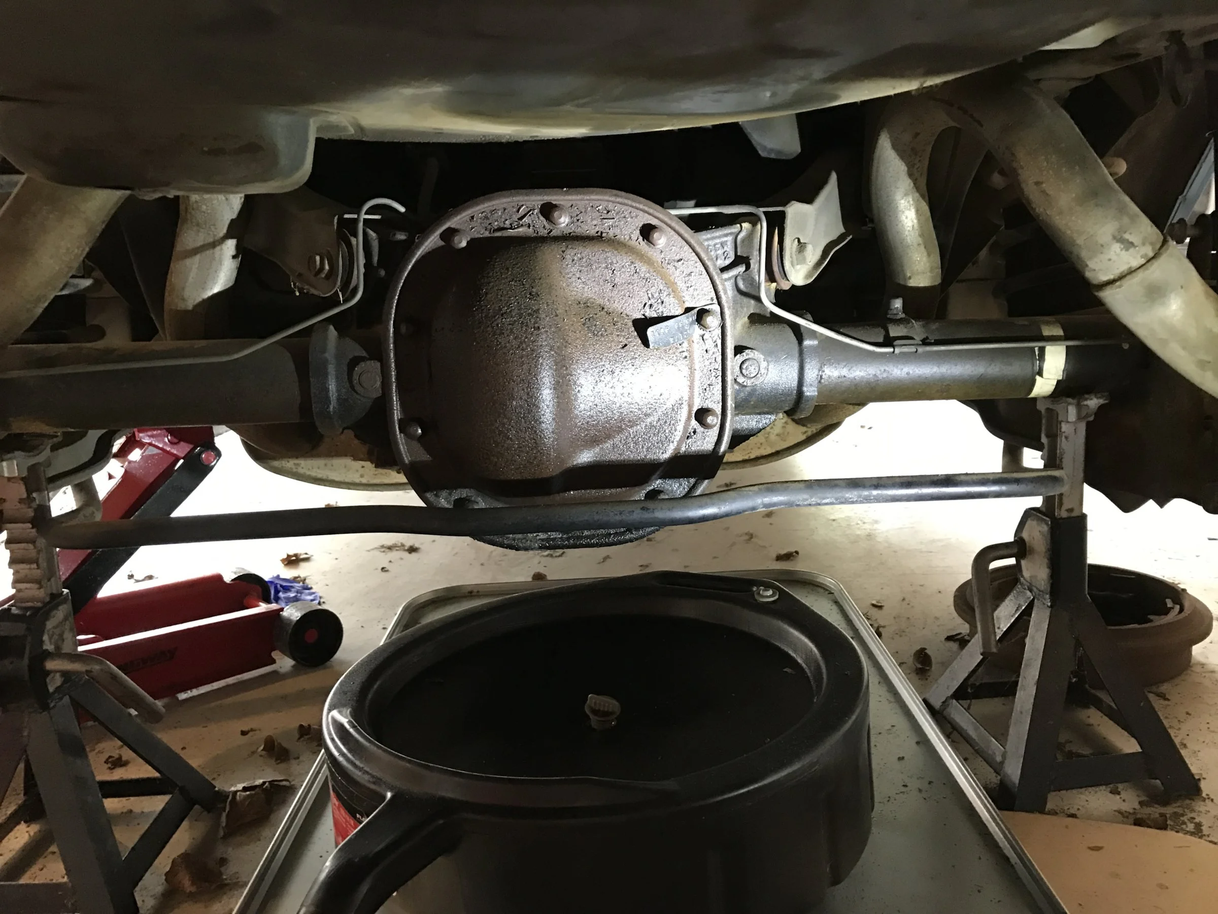

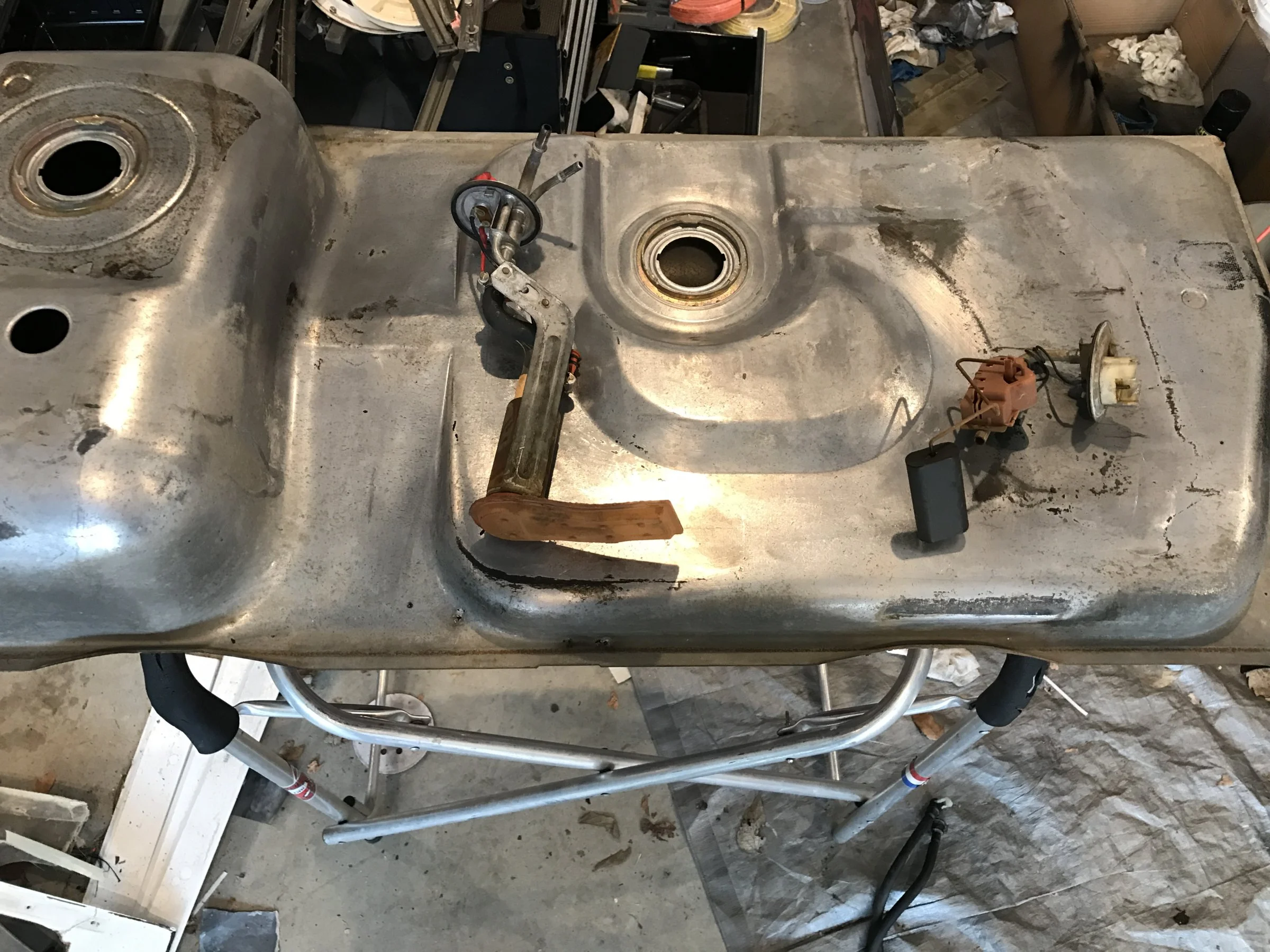

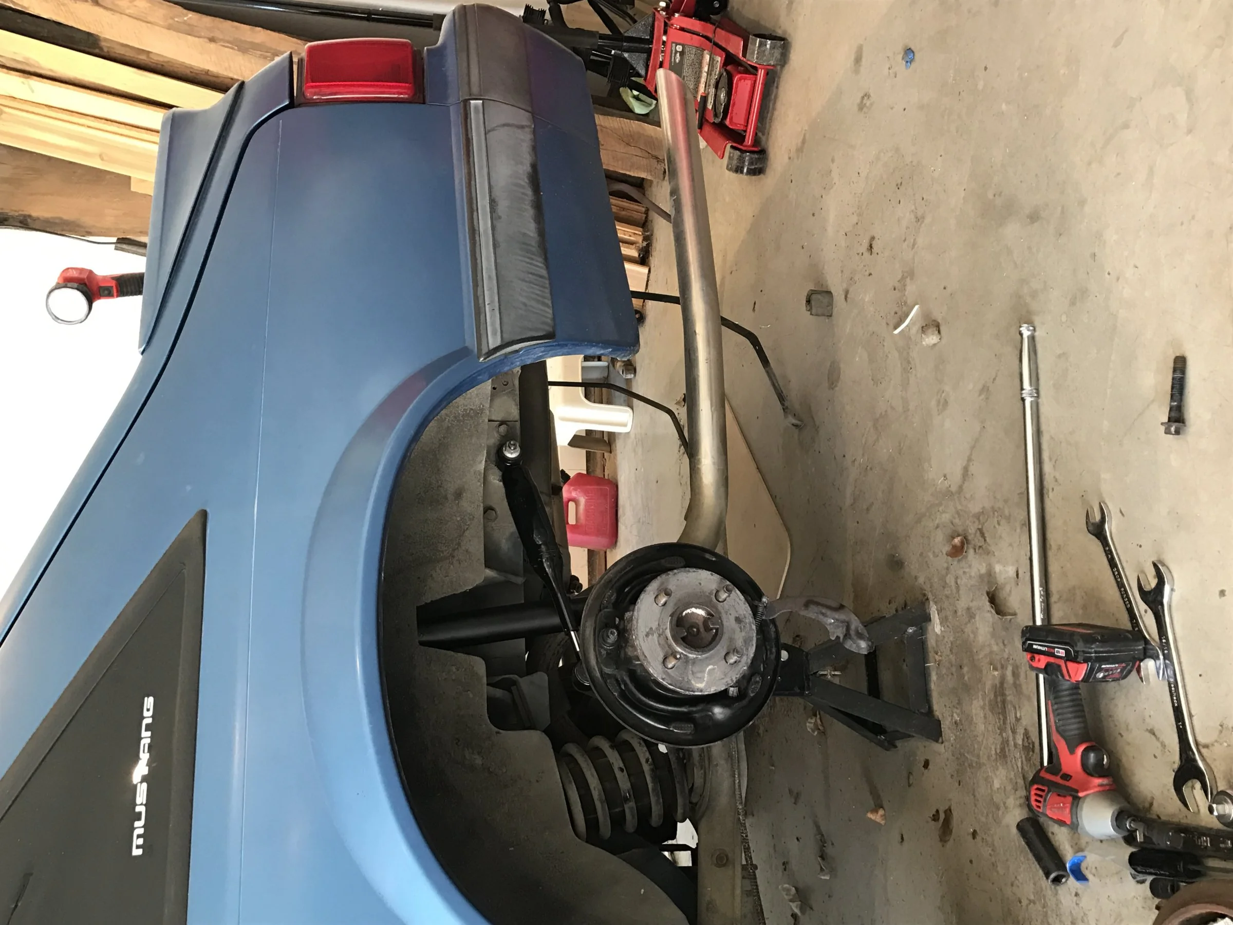

And then moved on to the back of the car... I almost couldn't stand cleaning up the drum brakes to keep them... But I am committed to keeping it stock... thoughts? should I have upgraded to rear disc brakes? When I took the gas tank out I thought it was going to be empty according to gas gauge... 10 gallons siphoned out later I realized I needed a new sending unit. :-(
Reactions: 02 281 GT

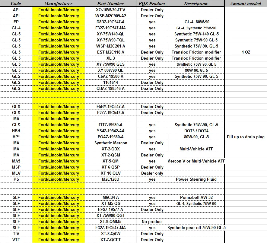

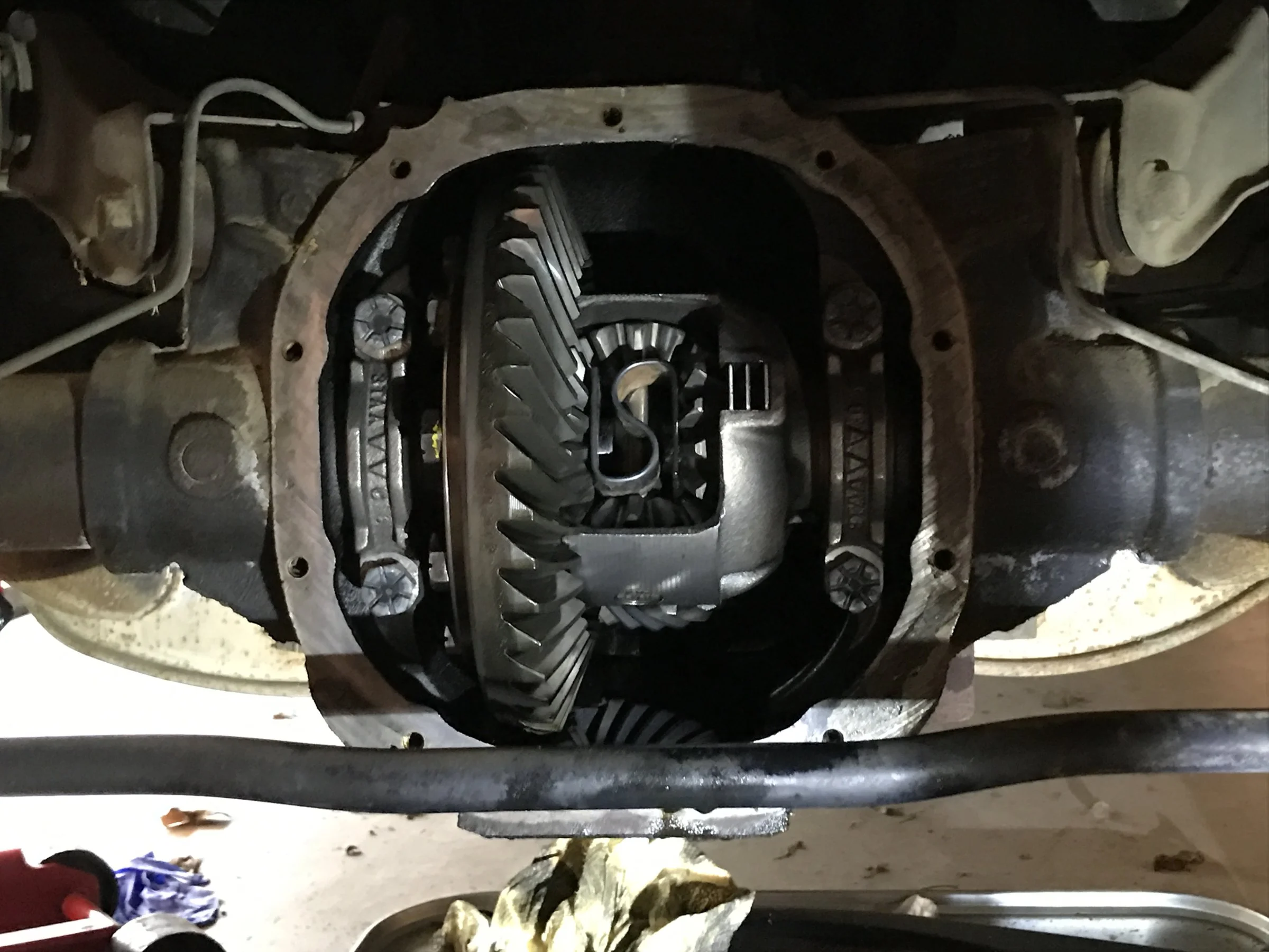

hmmm. some sort of error on the last post that created a duplicate... oh well on to the Diff... This is a first for me and I know I might catch some grief for this but it has never been cracked open on this car... After seeing some you tube videos on Diffs, I am a little frightened at what I was going to see... but after doing it... Wow, looks like the day it was sealed up at the factory!!! Gears are square with little wear, everything is tight, no metal!!! I guess those 159K easy highway miles paid off.

I had no idea transloc diffs needed special additive.. Ran across this that maybe people can use:
